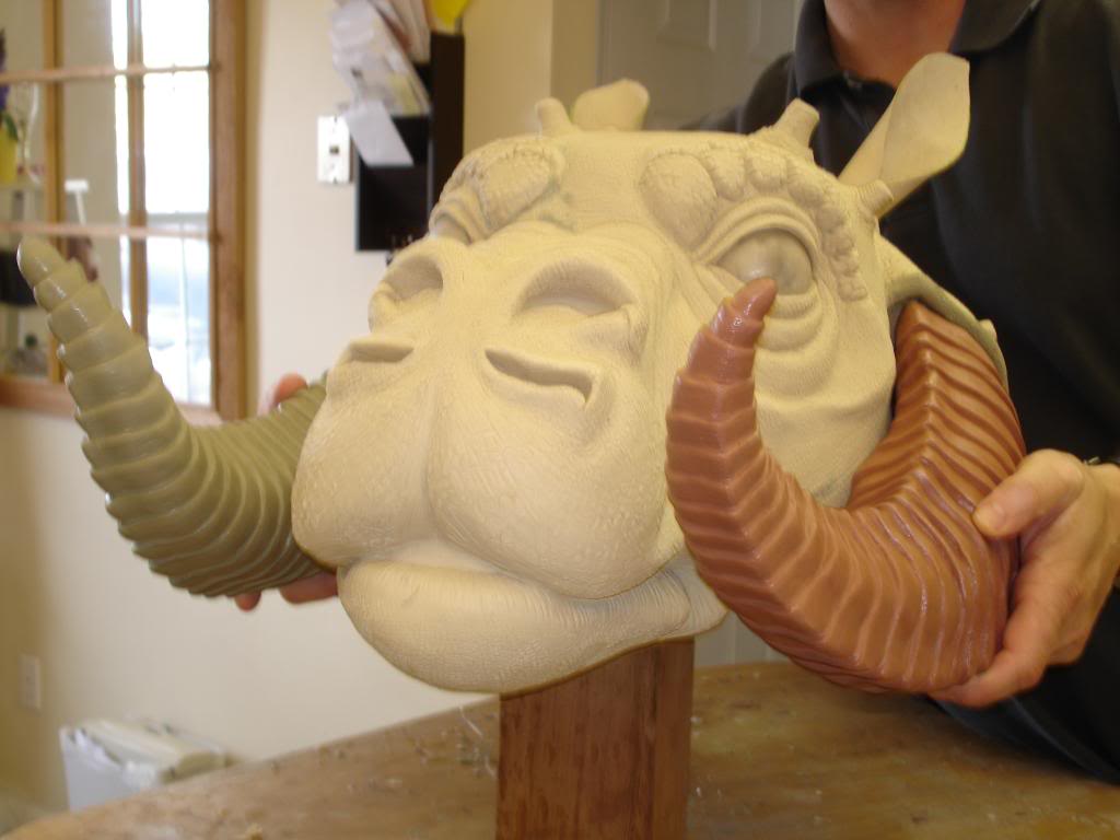

Taun taun taxidermy complete!/ Kit now ready pics page 2
you must be loaded to afford to be able to make a mold for that thing
That is truly magnificent. Hands down one of the coolest original pieces i've ever seen
No. not loaded at all. All I can hope for is to sell at least one or two to make up for my costs. It's worked out so far.;)
Thats absolutely amazing. Great work! A true artist :) I'll be checking regularly this projects rocks.

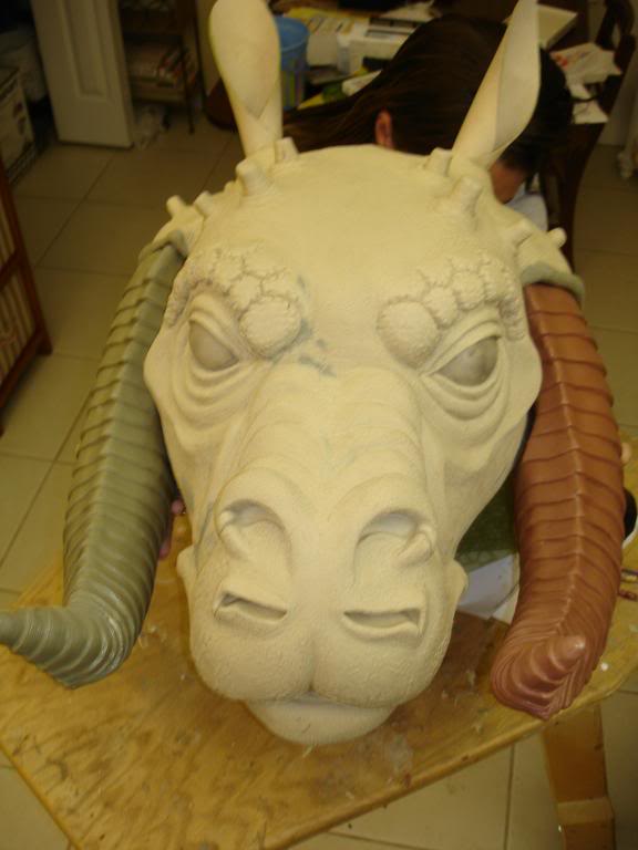

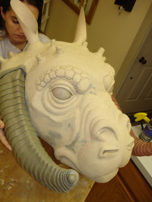

Here are some more pics. I think I'm close now. I changed some things. Added more eye detail, more meat in the back of the head, and over all I changed the skin texture to a more detailed, leathered look. Whatcha think?:D
Ehmm!......*speechless*
I find the eyes a lot better. I just cant wait the final result,keep up the excellent work!

Beautiful job. So you're going to solid cast them? Wonder what would need to be done to be able to add animatronics to one.
Not solid cast, probably fiberglass, with shell-shock as the print coat. Like my Briareos helmet. The horns will be smoth cast-roto, like my iron man lid.
There is the possiblity to animate this, even as a fiberglass cast. You can cut the bottom jaw off and hide the pivot with the fur. You could attached a silicone lip to the fg with spandex to make it stretch. You could also make eye lids out of laytex for an eye blink, and make the eyes move left to right.
I had even thought of casting a silicone skin for this backed by a FG skull. That way I could punch the fur into it for a more refined finish detail. Then you could go crazy with animation to include nostril flares, ear wiggles, etc..
For now though I'll start with just a static piece. If I turn it into a costume I may do some animation.:D

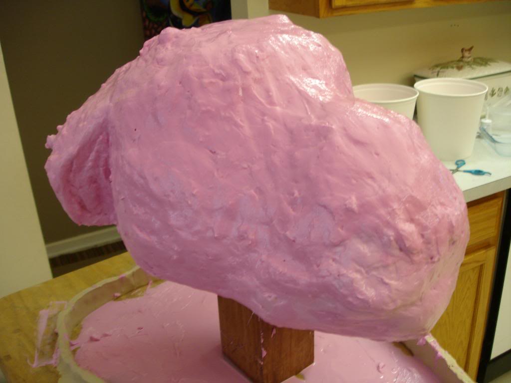

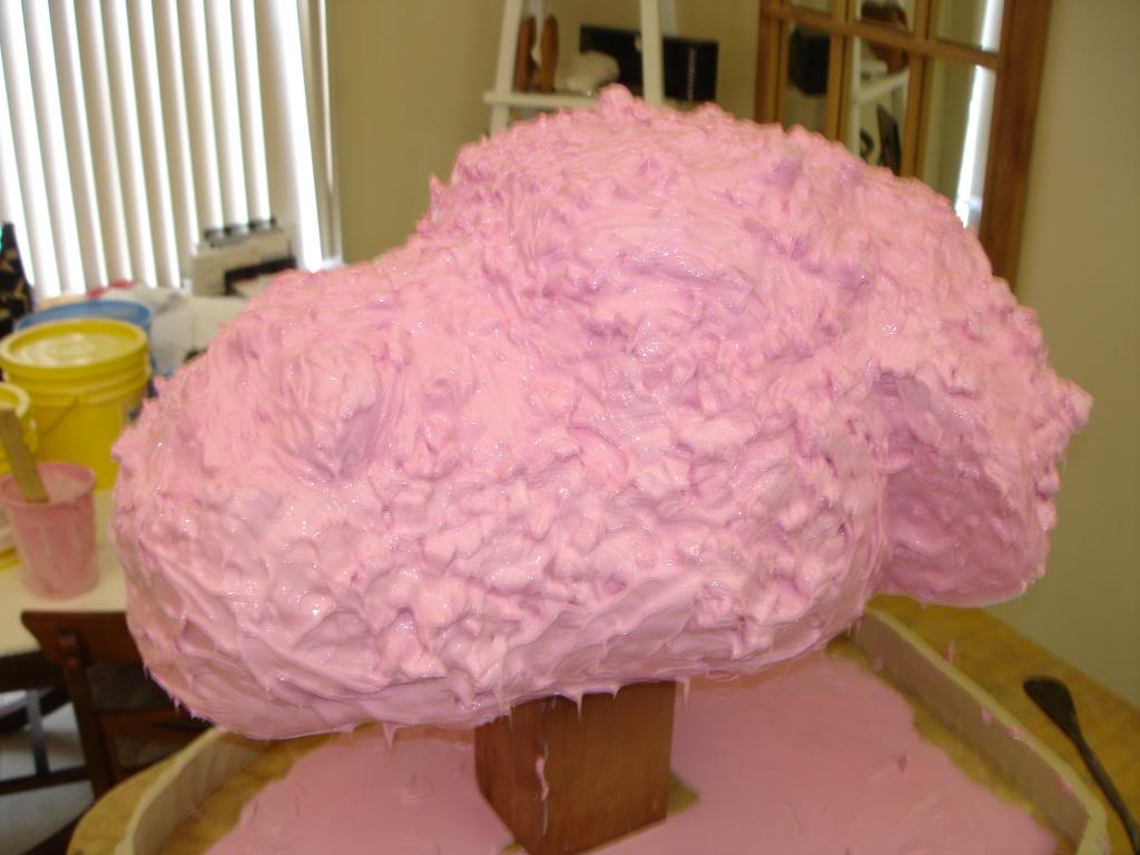

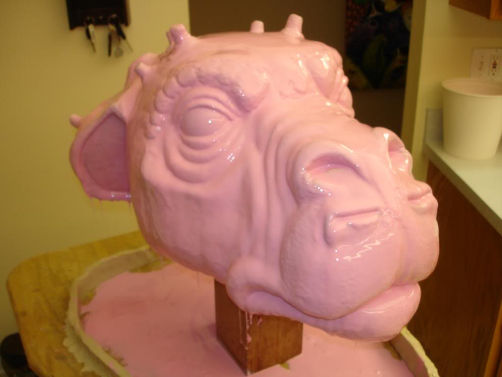

MOLD IN PROCESS:D print coat applied.:D

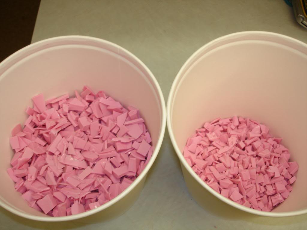

To make your silicone go further, try adding recycled, chopped up cured silicone, to a batch of silicone. Any access drip offs or trimmings from the mold can be used as filler the subsequent layers of silicone.
