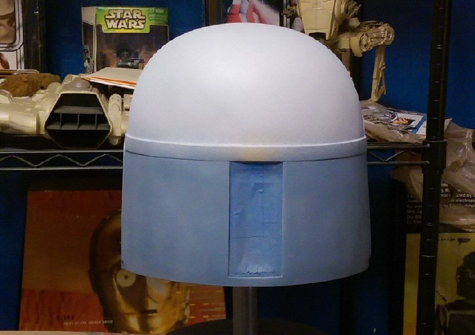

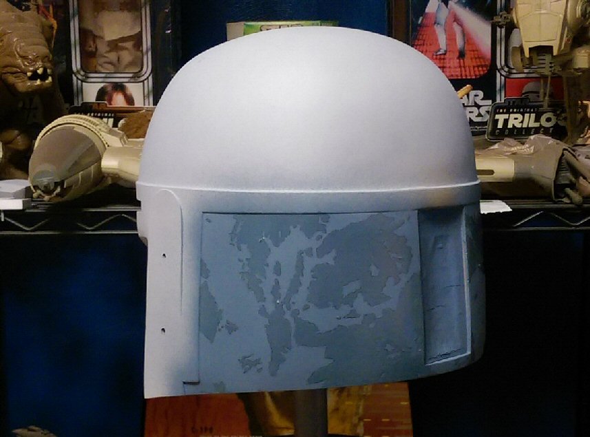

First colors are on. I airbrushed the keyslot area with Polly Scale Earth late yesterday.
Today I masked it off and laid down the base color on the rear panels. I'm using Polly Scale US Intermediate Blue.
I'll let this dry overnight, then I'll begin stenciling and masking so I can apply the dark green.

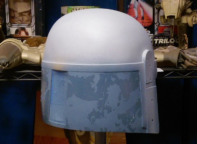

Slow progress during the week, but I've stenciled the rear panels and applied my Winsor & Newton masking fluid.
The masked areas appear darker and a little shiny in these pics.
Tomorrow I should have time to airbrush the dark green parts. :D

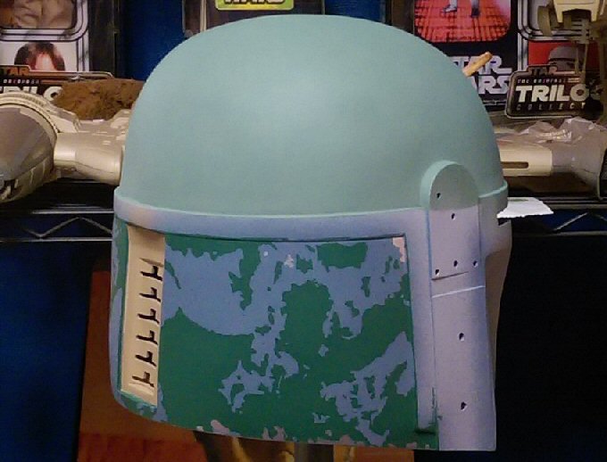

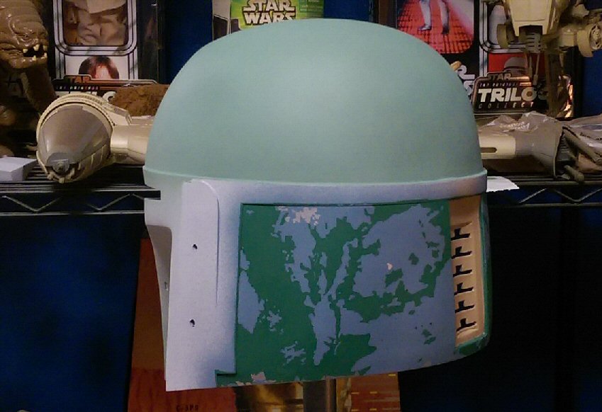

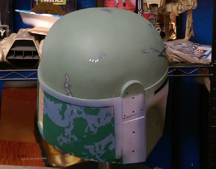

The rear panels are finished, and I've laid down the base coat on the dome and cheeks. This is just the first pass.
I'll add a darker weathering shade next.
After the weathering pass is finished, I'll begin the damage on the dome. That's the fun part!
Thanks! Got quite a bit done since yesterday, so here we go with the pics.

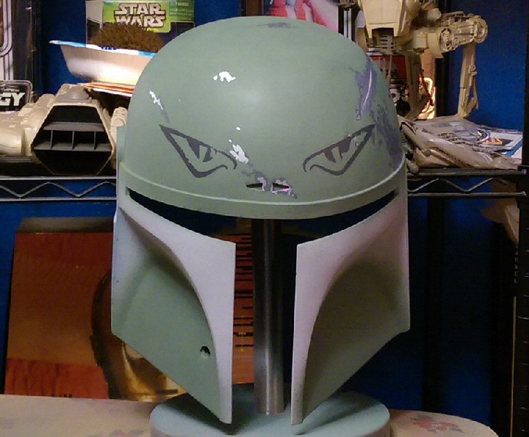

I did the darkening/weathering pass on the dome and cheeks and began the damage.
First of all. . . the eyes! Do you ever have the feeling that you're being watched??? :p

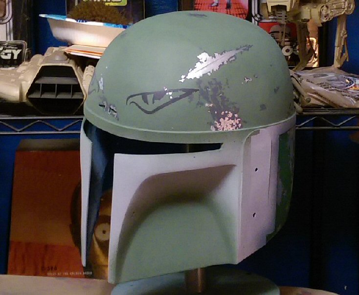

I've actually completed all of the damage on the dome, and you can see some of the detail in the above image.
Here are a few more angles showing different areas of the dome.
The "gouge" above the left eye was done with a triangular-shaped jewelers file.
