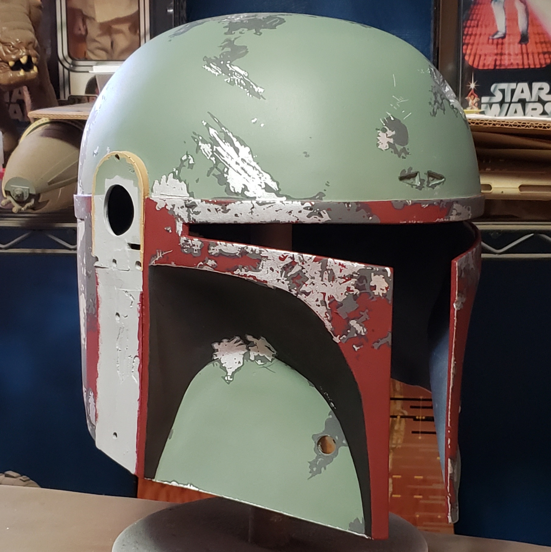

I got the RF lights installed and tested the setup. The red lights are red and the white lights are white. There's only one red light on in the pic because they're flashy flashies.
I do paint them. After all I'm trying to replicate a very specific look.
If you've gotten to see a casting of the screen used helmet, you can see there's a raised oval shape on the red band where the thumbprint is. It must have been some pretty thick paint that got dripped on the helmet.
I start by painting the oval flat white. It's very opaque white in the reference pics.
Once that dries I use a more translucent white and start building up the part that looks smeared. I do this on the upper mark too. The one that's smeared across the killstripes.
I make sure to let some of the underlying colors show through.

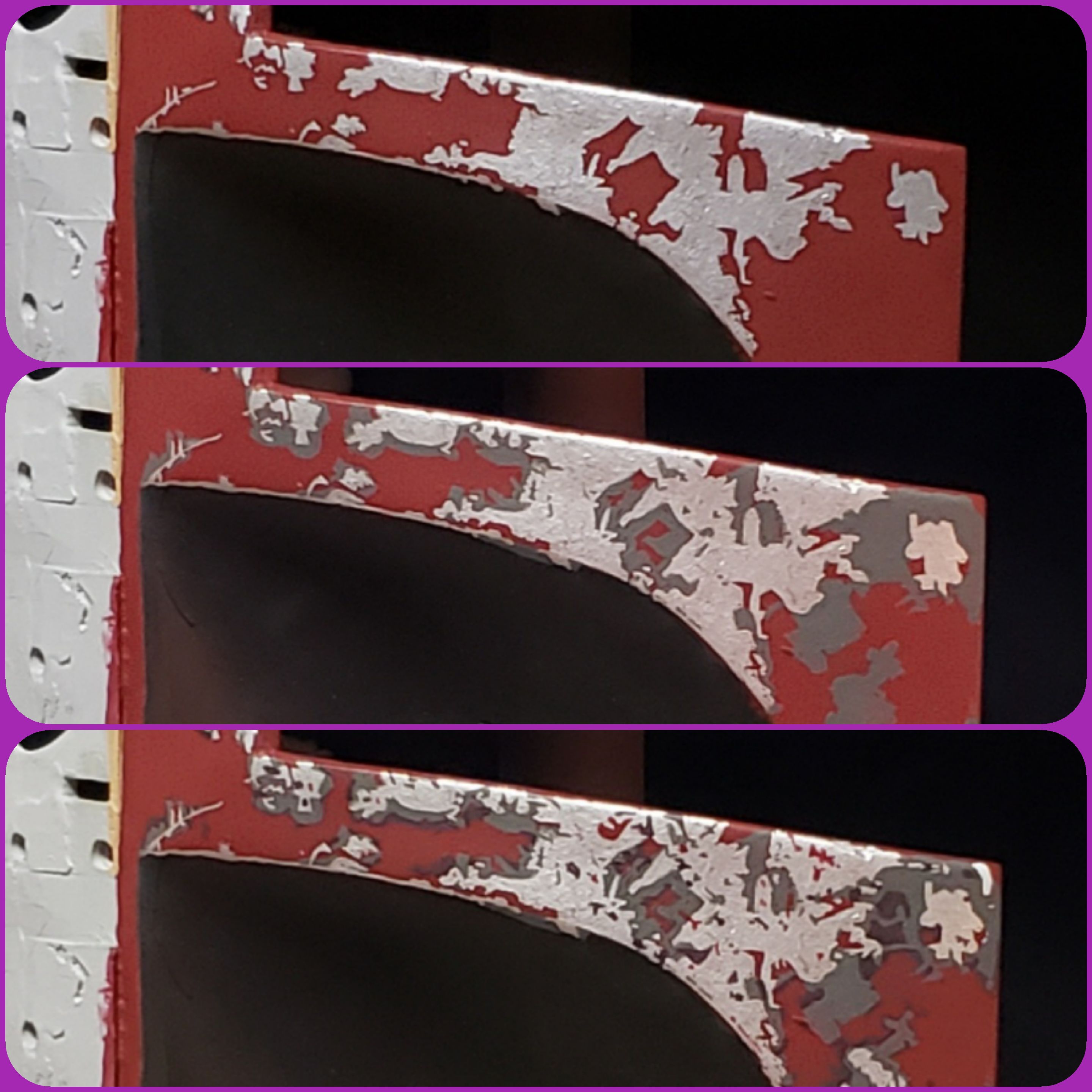

I got the right side of the brow done. This is my warmup for the mandibles!
I got the crazy upper part of the right mandible done! This area is really packed with detail. Also posting my collage showing how the details are built up using the topical technique.

I have finished weathering the helmet and all that remains is to install the visor.
