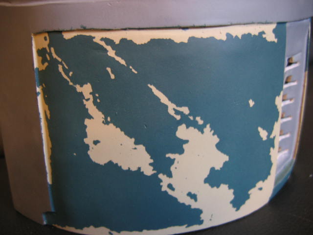

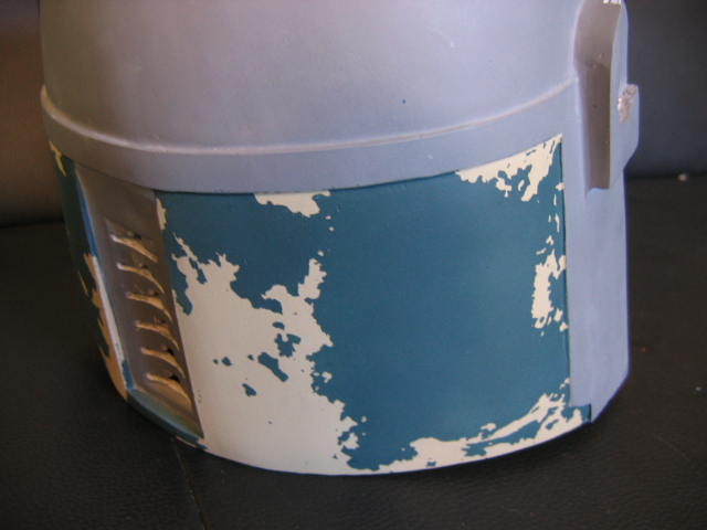

OK, I've begun painting the helmet itself. I started on the back. . . figured I'd do the most complicated part first. :lol: I'm a glutton for punishment I guess.
I started by mixing a beige-gray color and sprayed that on. Easy enough to begin with. Once it was dry, I followed in the footsteps of the mighty Steve the Swede and traced out the areas I wanted to leave exposed. Then I used the highly touted Winsor and Newton's masking fluid to cover these sections.
Once the masking fluid was dry, I sprayed on a dark blue green. It started out as Testors Euro I Green (from the Rogue Studios color list), but I didn't think it was blue enough, so I added some Polly Scale BAR blue until I felt it closely matched the reference pics.
Once that was dry, I peeled up the masking latex, and . . .
This is where it stands right now. No weathering or anything yet of course. Just the 2 main colors on the back panels.
Eric

Spidey. . . what can I say. I'm thinking about writing a love letter to Winsor/Newton. :lol: That stuff was so easy to use I couldn't believe it. And it came off like nothing.
I'm still shaking my head at how easy it made to paint the back of the helmet.

Masking is basically liquid rubber either use some latex you can buy at an art store or misket which was used on the originals. It's a very old method that has been used by modelers and industry professionals for decades. only problem you run into is keeping the scratches accurate and less random it's very hard to keep the paint from peeling in the wrong direction.

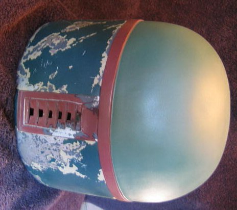

UPDATE July 2nd:
Whew! What a day. . . I didn't realize how much I'd gotten done till I stopped to take a good look at my progress. Figured I'd take some more pics at this stage.
Well. . . to begin with, all the basic colors are now sprayed on. I used Testors Panzer Olivgrun for the lower cheeks and dome, Polly S Brunswick Green for the upper cheeks (brushed on with a 1/2 inch brush by the way), and Polly S Boxcar Red misted over Polly S Rock Island Maroon for the mandibles/strip around the helmet. After all the main colors were dry, I put on 2 light coats of Krylon Satin Finish. Man this stuff dries smooth. :)
For detail painting on the back, I again penciled the outlines of the color breaks, and used Tamiya X-11 Chrome Silver, and when that dried, Polly S SP Lark Dark Gray for the darker areas. On the keyslot area there's some purple outlining mixed from Polly S BAR Blue and Rock Island Maroon, made to match my reference pics. Some of the smaller silver scratches are done with a silver Sharpie marker (thanks Spidey for that outstanding tip!!) I used the sharp end of my compass to make the small white scratches.
Still have washing and some more weathering to do but here's where it is as of now.
Eric

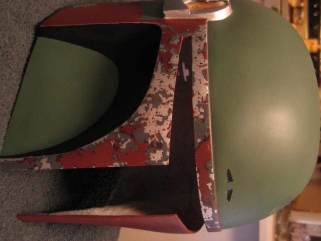

UPDATE July 4th
Well, I took advantage of the long weekend to put some more work into the helmet. :)
I've been working on the weathering around the Boxcar Red portions of the helmet. Just been following the reference pics and putting on more gray/silver/purple parts. The right mandible is done as well. . . man, that was a killer.

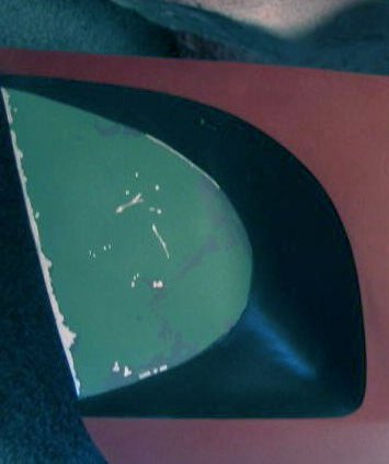

Also I wanted to do something besides the red sections, so I did the lower left cheek. I tried it first with the SP Lark Dark Gray, but as mentioned by Steve the Swede, it was too close to the Panzer Olivgrun to really show up, so I took his advice and darkened it up with some Brunswick Green. That made it contrast nicely!
Here's some new pics. They're taken indoors in fading light, so they may look a bit different from my previous pics, taken in brighter sunlight near a window.
Anyway, enjoy! And as always, critiques are welcome.
Eric
