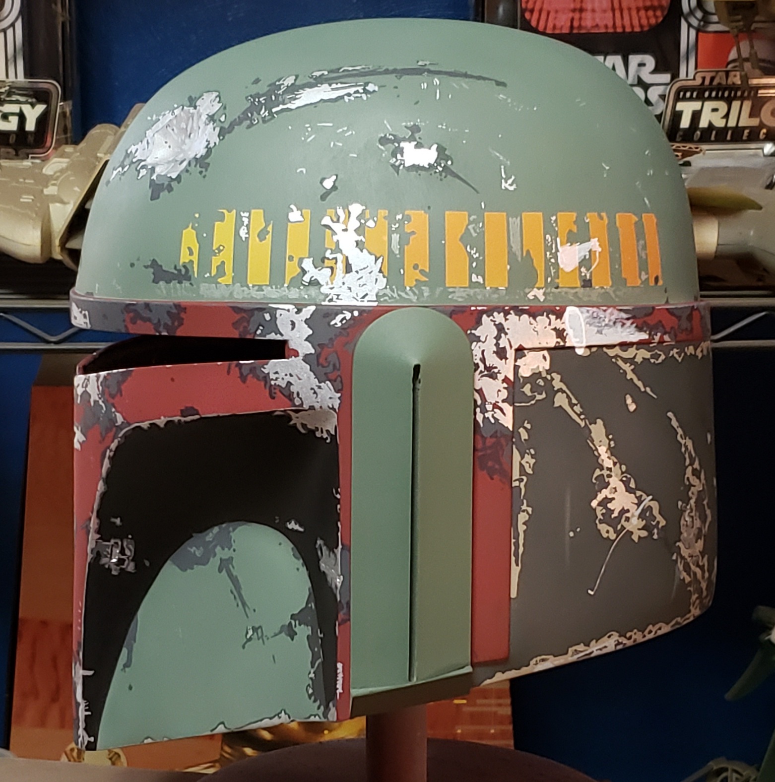

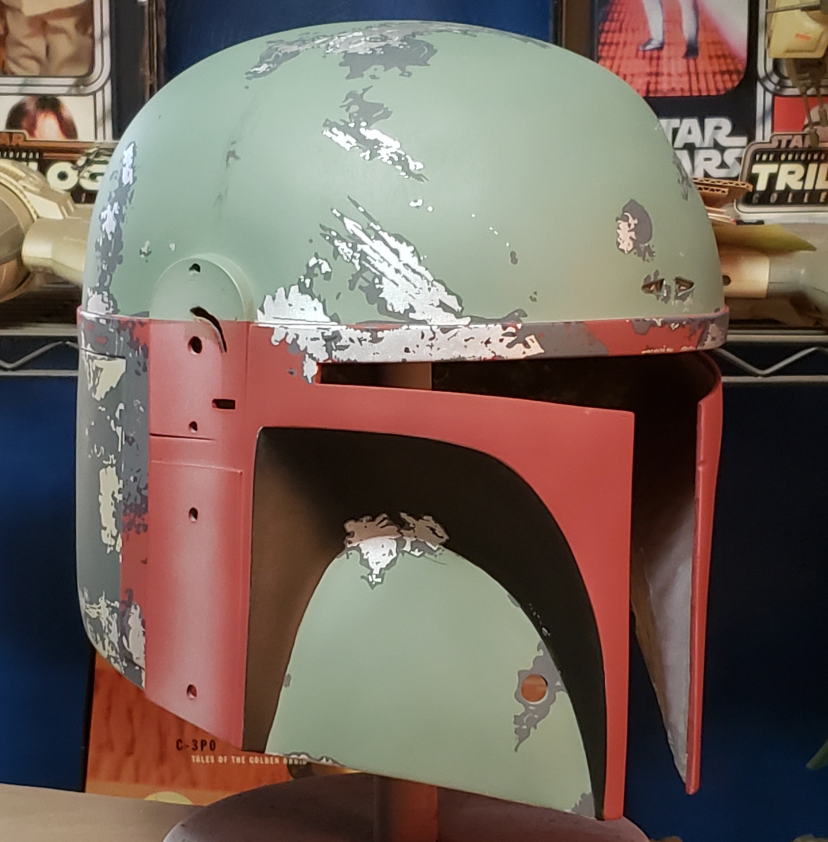

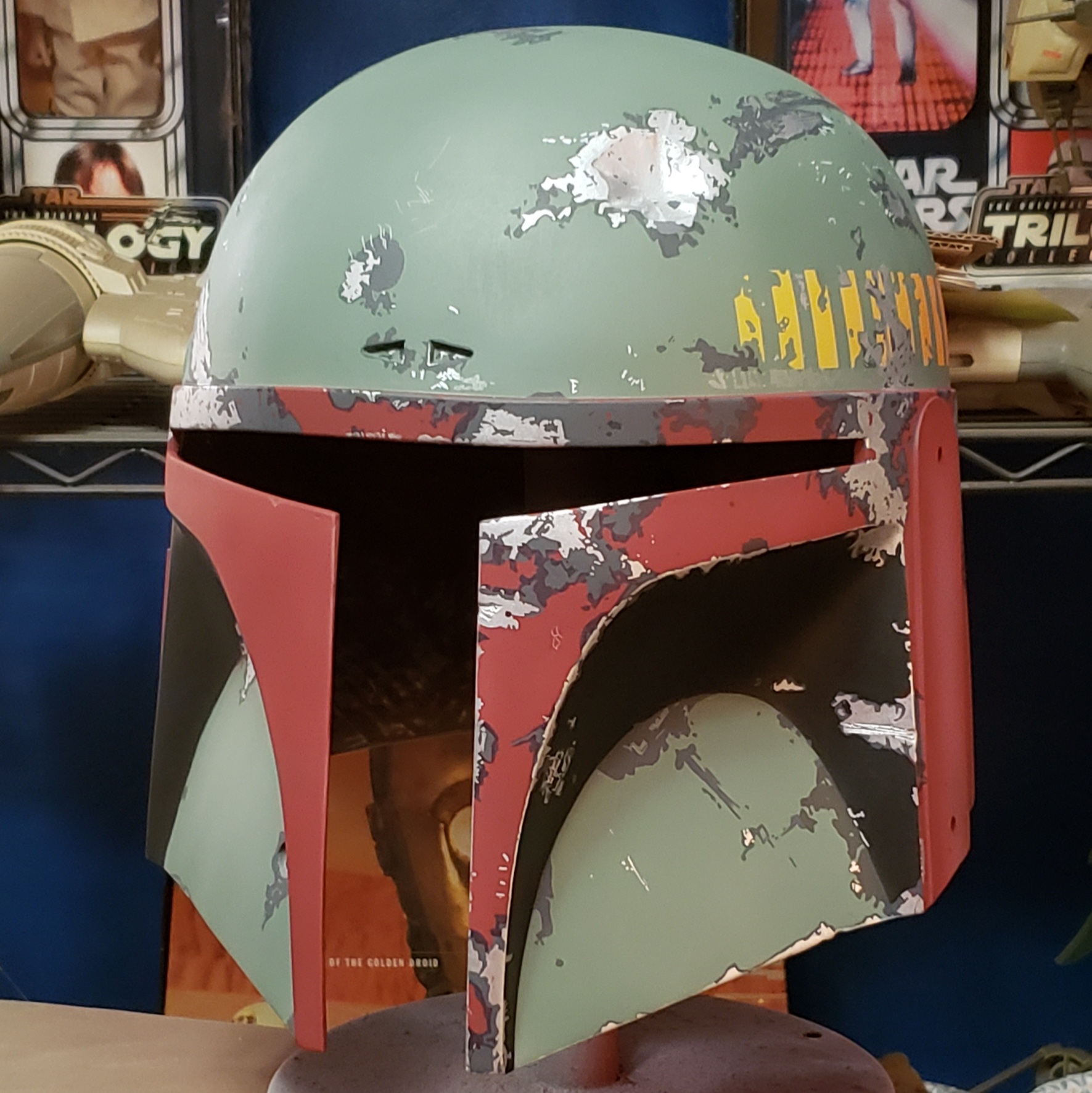

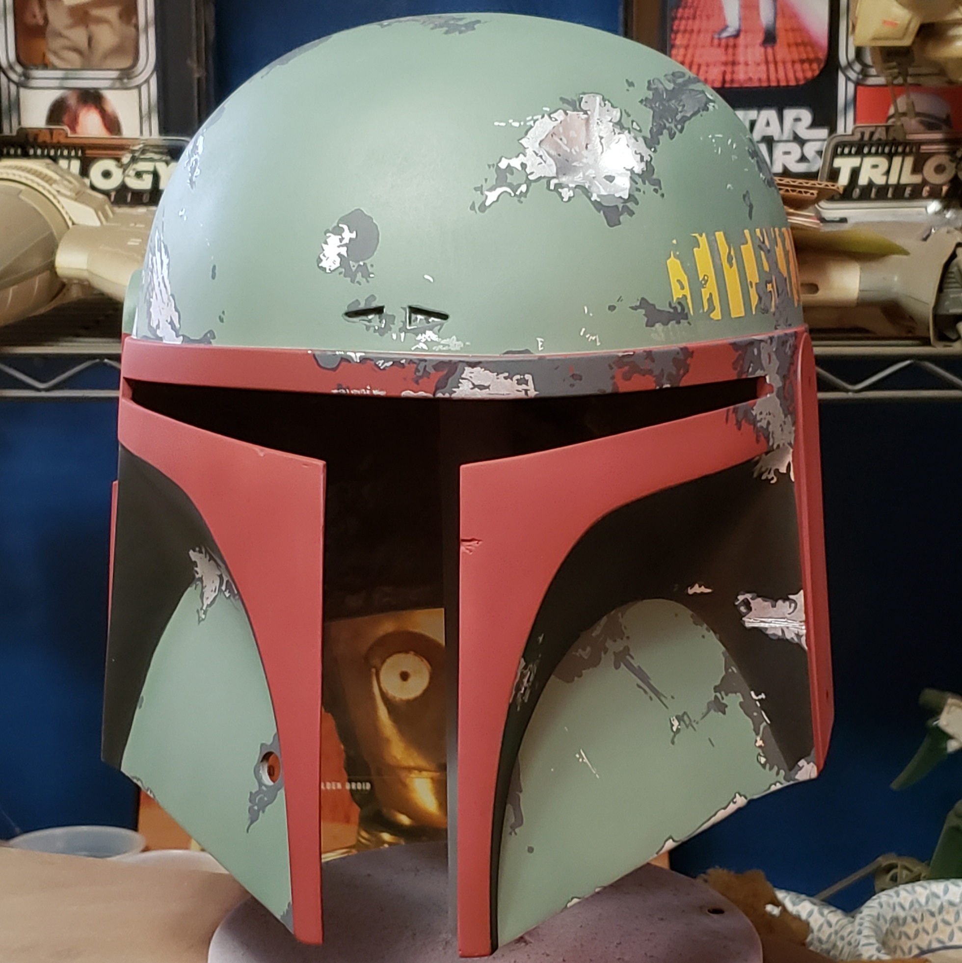

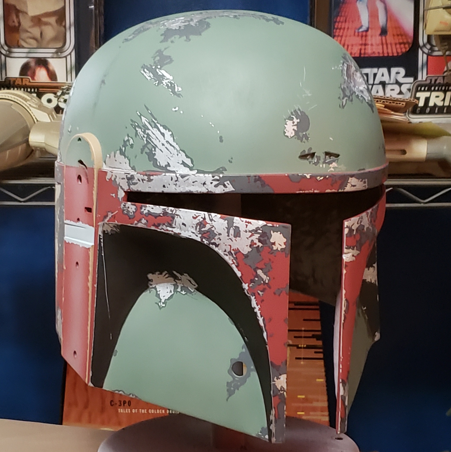

Starting to work my way across the brow area.

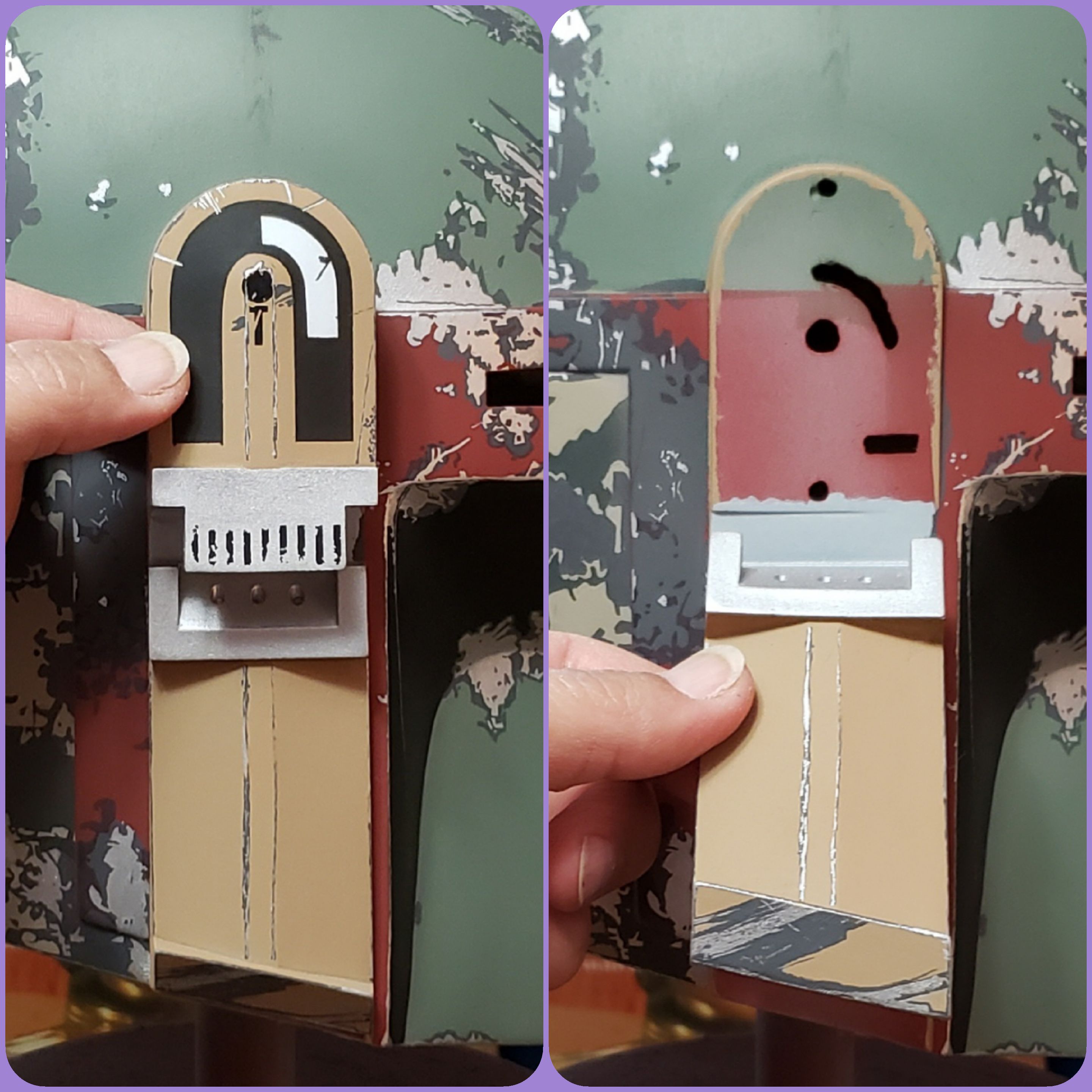

Couple questions. I'm sure you have probably been asked this a few times.
How do you go about making the checkmark scratch on the left rear panel? Do you just paint that?
Do you use something like a water soluble pencil to draw out the damage first or do you just freehand the paint?
Looking fantastic! I assume detailing is being hand painted topographically? Are you doing light to dark or dark to light colors?
Thanks! Yeah, I add the details topically. The color order depends on what area I'm working on. Painting light over dark or dark over light work equally well.
I use really fine detail brushes to paint the damage. My go-to brush is an 18/0 liner brush, so I can get some super fine lines.
I use a set of stencils that's drawn onto tracing paper. I redraw the lines on the reverse side of the tracing paper, then hold the stencil against the helmet and rub the pencil lines onto the surface using the back end of a small paint brush.
Freehand for something like this invites the possibility of too many errors!
