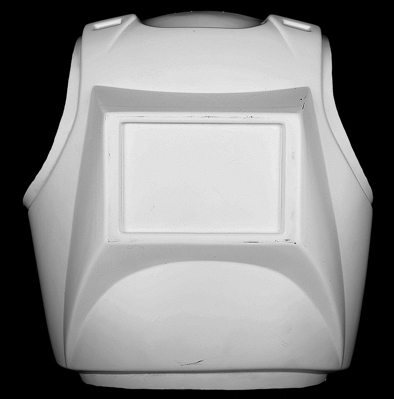

OK, here is a quick pic of the chest as well as the back. I am planning to start with these pieces. The pics below are the pieces as I received them.

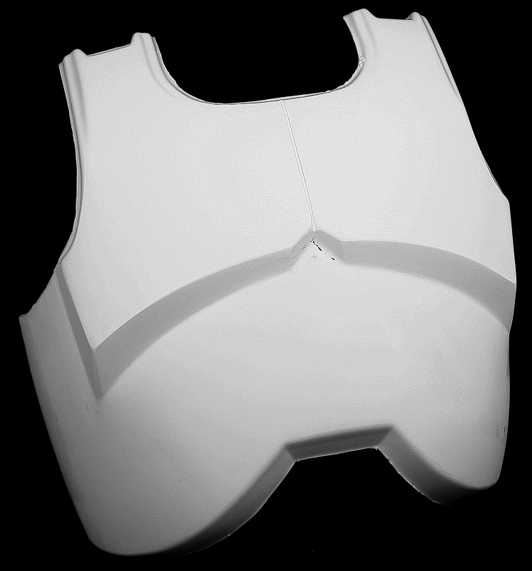

I sharpened the right breast and took a pic. It doesn't show up all that well in the photo, but standing in front of it, the right breast is clearly much sharper than the left! I plan to go over a few other lines with the 100 grit on the vibrating sander and then switch to 220 by hand to finish it out. I still have a ton to do and still need to clean all the egdes that I trimmed, but at least we are moving forward!

Here is the chest plate after another hour of the vibrating sander and some hand sanding. The sharpening is starting to take effect, but there is going to be a lot of detail and clean up work!
Just talked to dgasser and he suggested using a straight razor and scraping it along the edges to sharpen them! I might just give that a try!
Looking good so far. You are right that the bottom edge thins out as you go around to the sides. It never has looked to me that it thins out completely though. I have always thought it looked like there was a little lip there. You might also try just scoring the plastic with a metal straight edge and a razor blade to remove the excess plastic. I have gotten some nice edges like that. Keep up the good work.
