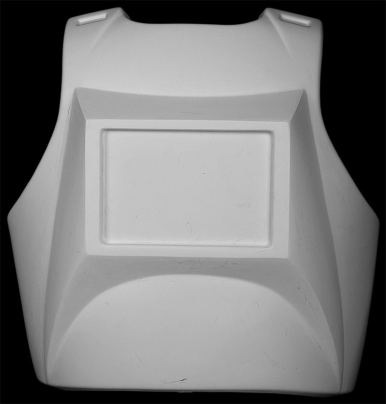

OK, a slight update. Started using the razor scraping method to sharpen the back. I have gone through one razor blade on the chest already and still not done with it. The back is starting to take shape, but as with everything else, I have a lot of work to go. I thought building something "perfect" would be fun as opposed to the wonkiness of a stormtrooper build... I am beginning to realize more and more that wonkiness leaves a lot of room for error where a perfect build does not. I am just hoping paint and weathering will cover my mistakes!

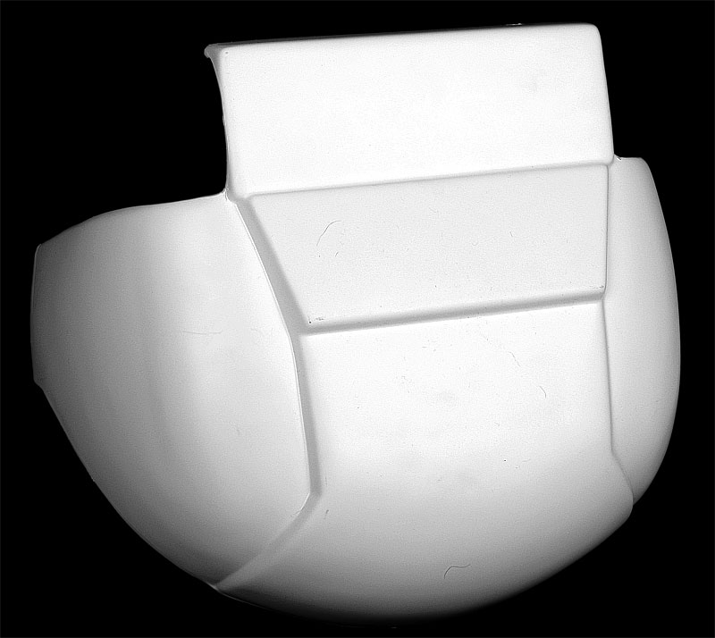

So, I started looking at the buttplate today, and did a basic trim of the flashing. No sharpening yet. All I can say is, if your butt actually fits this thing... whew... you got a BIG BUTT!!! I am going to have to do some SERIOUS surgery to get the butt plate to fit my skinny rump. I am very nervous as this is going to require major cutting... so I am just going to take it a bit at the time.

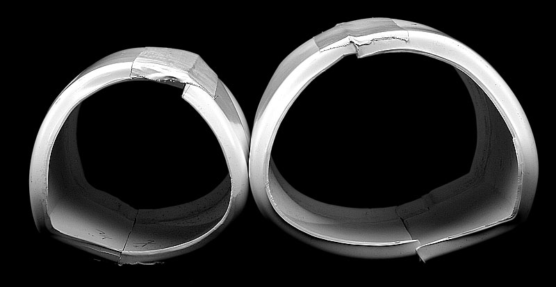

Well... since I am sizing pieces (really struggling with aligning the cod plate and the butt plate)... I took a look at the biceps... and then took 3" out of the bicep to make it fit! here is an after and before pic to show the difference in the circumference. After cutting so much material away, I had to heat the halves and press them back into a circular shape. I am very nervous about all the pieces working together since there are some pieces I can really cut to size and some pieces I can't.

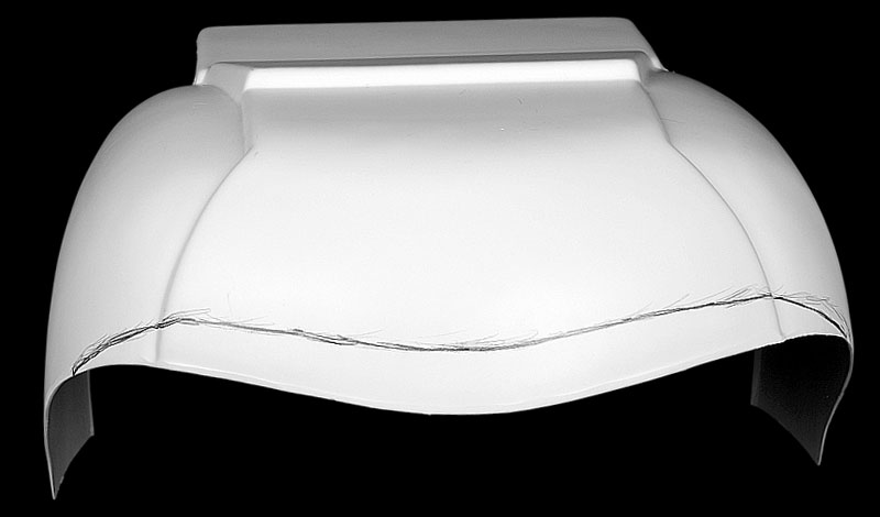

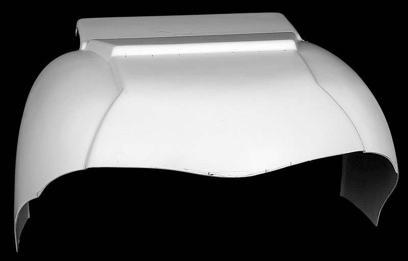

I took several inches out of the bottom of the butt plate. It now fits considerably better and doesn't quite feel as much like a diaper as it did. I still might need to do some final tweaking so I can walk around without it cutting into the back of my thighs. Here are pics of before and after.
I myself removed alot of material on the biceps, and as a result they are now to tall in appearance, over referrence. I am going to use wide shims to recapture the width prior to finalizing the seam. I have the same issue with the butt plate, now I can study yours before I execute final trimming on mine. :thumbsup:

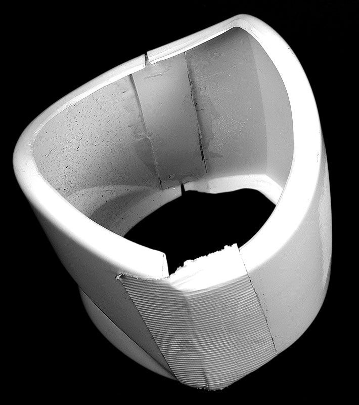

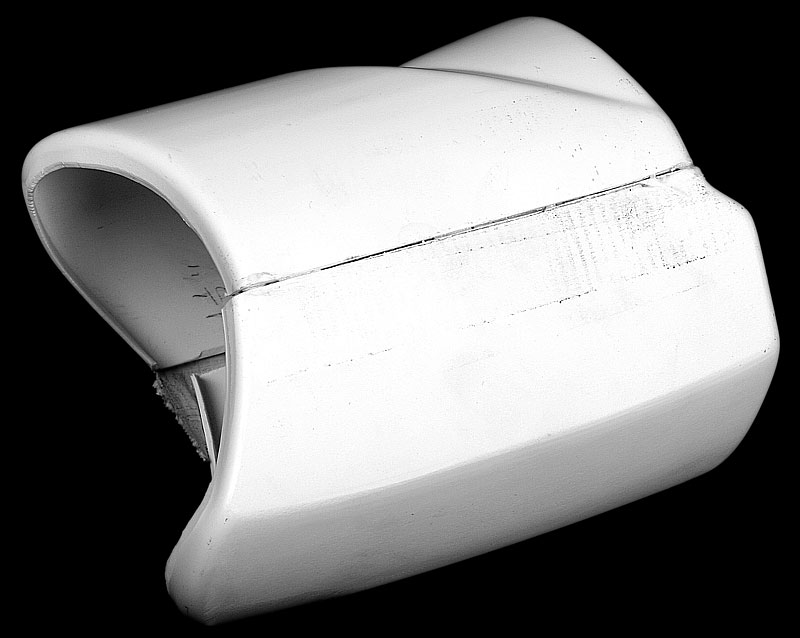

Because I cut so much material out of the biceps, they no longer created a circle but had a somewhat football shape with the joins being pointed.
I used a heat gun (be careful of the fumes!) to mold them into a more cylindrical shape, then added a strip of styrene to the back to support the joint. I used 60 grit sandpaper to roughen the surfaces to be glued then used a small paintbrush to apply a heavy coat of the glue to both surfaces.... gave it about a minute and then stuck them together.
Because my surfaces aren't perfectly flat I still needed to use clamps to hold the pieces in place for 24 hours until the glue fully cured. After an hour the initial curing was done but I gave it a full 24 to insure it was set.
Below are photos of the outside and inside... still messy and not at all cleaned up, but I wanted you to get an idea of what it looked like.
NOTE: After trimming down the two halves, I laid a full sheet of 150 grit sandpaper on a flat surface and ran the freshly cut edges of the pieces over it. This created a smooth flat joint that matched up with very little gap. Don't just rely on making a straight cut! Sand until it is perfectly straight so you have very little gap to fill later!
