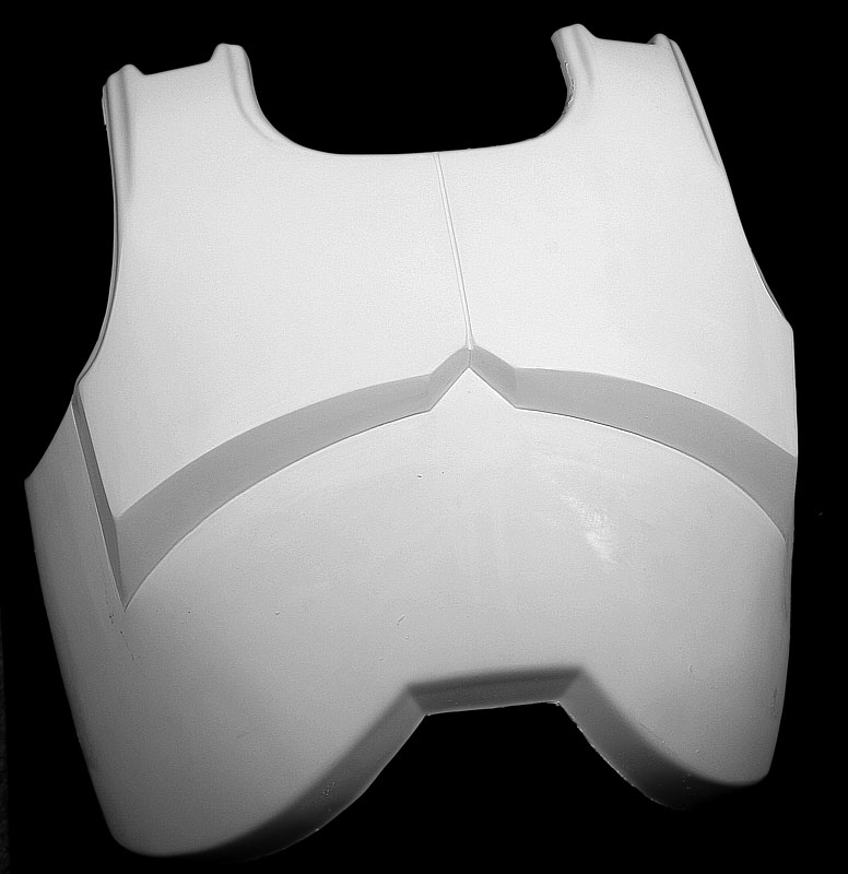

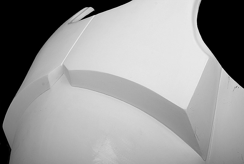

OK guys... spent about 2 hours using dgasser's method with a straight razor and lets me tell ya... that is the ticket! Really took the sharpness to the next level! I actually went a bit farther than I expected to go but after looking at the reference, the breasts almost look like they are separate pieces from the ribcage, so I went in with the razor and small flat files and the square file and etched out the breasts in more detail. I am going to have to go back and fill a few bad spots, but overall, I am pretty pleased with the results and the progress I have made today.
My tendinitis is killing me, but the chest is starting to shape up. Will I have this ready in time for Comic Con? I am thinking no way at the rate I am going, but at least when I am done, I will be happy.
Bingo!!
That's fantastic!! There's no way any vac table will pic up that sharpness in the chest. That's what Dana & I did with ours in order to accomplish that sharpness.
Great job man!

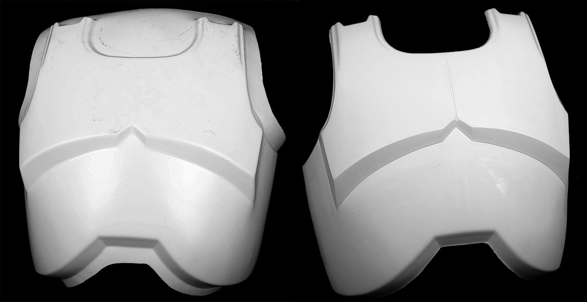

Since I am working on a stormtrooper build alongside the clone build, I thought it might be interesting to see the crazy difference in size between a typical trooper chest plate and the clone chest plate.
That looks really good, Art. I like the way you've sharpened the edges. I did the same for the legs and chest on mine as well. This is one benefit from having very thick armor pulls. I actually used a needle file set to work the chest on mine.
Thanks John! I too am using jeweler's files on some of the chest. I have pretty unsteady hands so while this stuff looks good in pics, it is a bit rough in person. Hoping to get it cleaned up along and along. I am a bit apprehensive about doing this to the whole suit but it is nice to know that most of the other parts are just simple line sharpens, and not as complex as the breasts.
wow... i'm guessing that, details aside, the AP and Gino chest are about the same size.
i found the AP chest fit me pretty well.
so it seems that the clone one would just be ginormous.
how does it actually sit on you? not necessarily front to back, but side to side?
Yup, the Gino chest plate should virtually be identical in size to the AP since they more or less came from the same source.

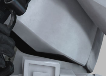

The chest has an "issue" at the bottom that I haven't been able to properly determine yet... On the bottom is a very thick wide ledge that runs the entire length of the bottom edge. I don't have the ab plate or belt yet so I don't know how the chest will sit on the ab with that ledge. There is no clear photo ref but I think the ledge should thin out as it goes around the body which would completely change the way chest fits. Right now the chest end just under my ribcage and that ledge digs in very harshly under my ribcage, but if I thinned out that bottom ledge, I would end up having to heat the whole chest and pull it in tighter.

The area at the bottom does have a cut-in, at about where the main belt boxes start, thinning that ledge signifcantly. I have a picture up in my thread that shows how I trimmed it.
Thanks for the heads up RS! With this post and a PM, RS directed me to the perfect reference shot that clearly shows the cut on bottom of the chest! No doubt about it now! The ledge on the bottom of the chest cuts away exactly as RS cut his!
