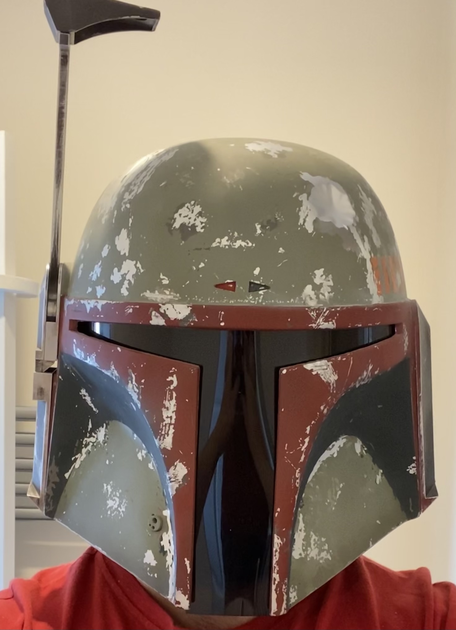

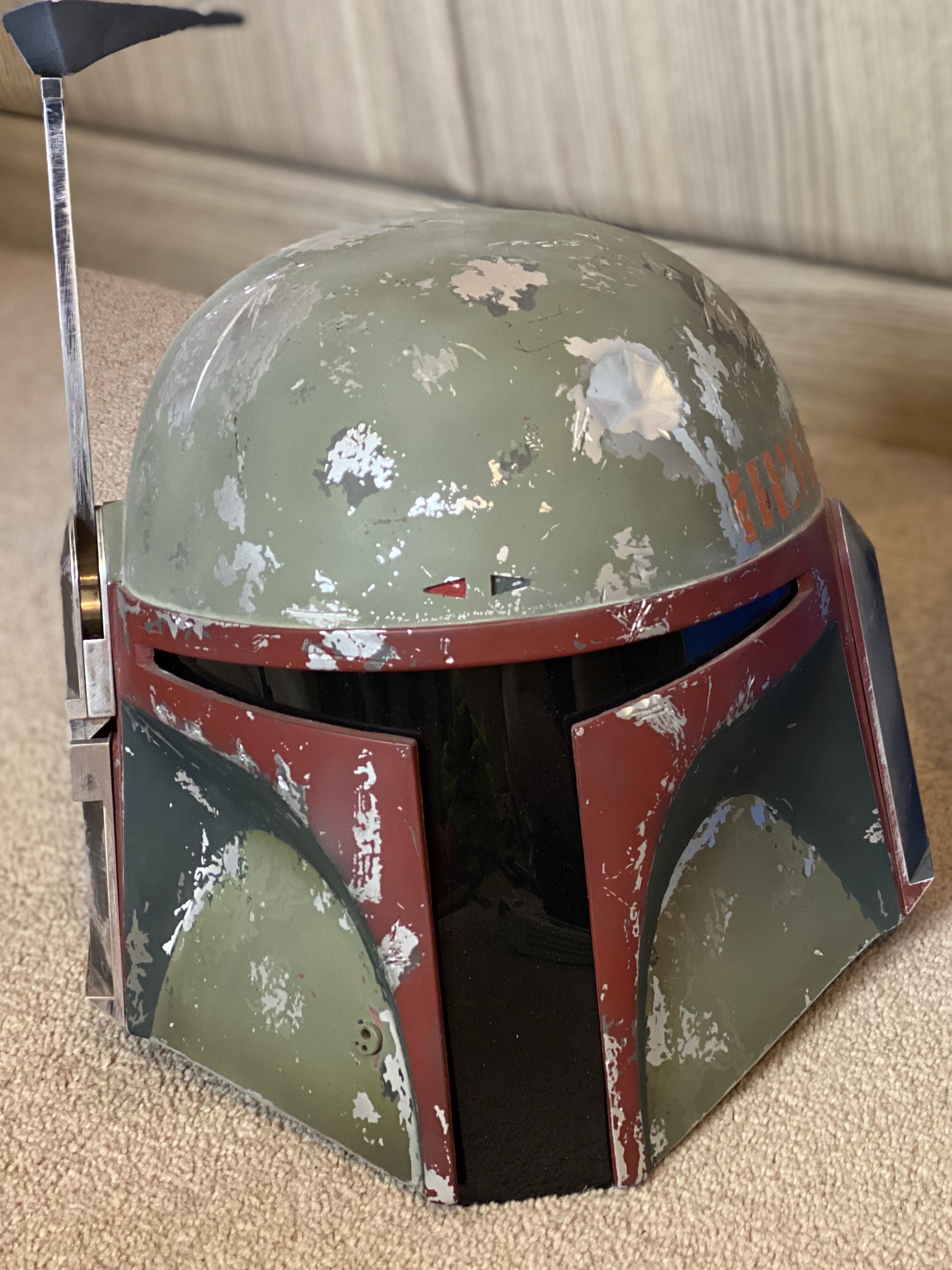

Archive-X is the best paint around in my opinion. They’re enamel based for now, thinned 1:1 with White Spirit.
Pictured is my FPH2 painted with Archive-X.
Colours used: Base silver and grey metallics are Humbrol Spray Acrylics Silver 11 and Gunmetal 53.
Dome and lower cheeks - GN Grey Green/Grime 60/40 misted with Coach Green and Pullman Green Lt, this over SP Dark Lark sprayed in patches of different amounts.
Light Green/Grime 50/50 for the lighter green on lower cheeks. Toned back with the base green for cheek.
Upper cheeks SP Dark Lark on first then Dark Green/Engine Black 70/30 approx. Same for turn signal above visor.
Red turn signal is Caboose.
Kill stripes Reefer Orange
Visor and mandibles is SP Dark Lark first then D&H Caboose/Caboose 50/50.
Lower rear/Back Plates of helmet is Humbrol 53 sprayed in patches of different amounts and then Dark Green.
