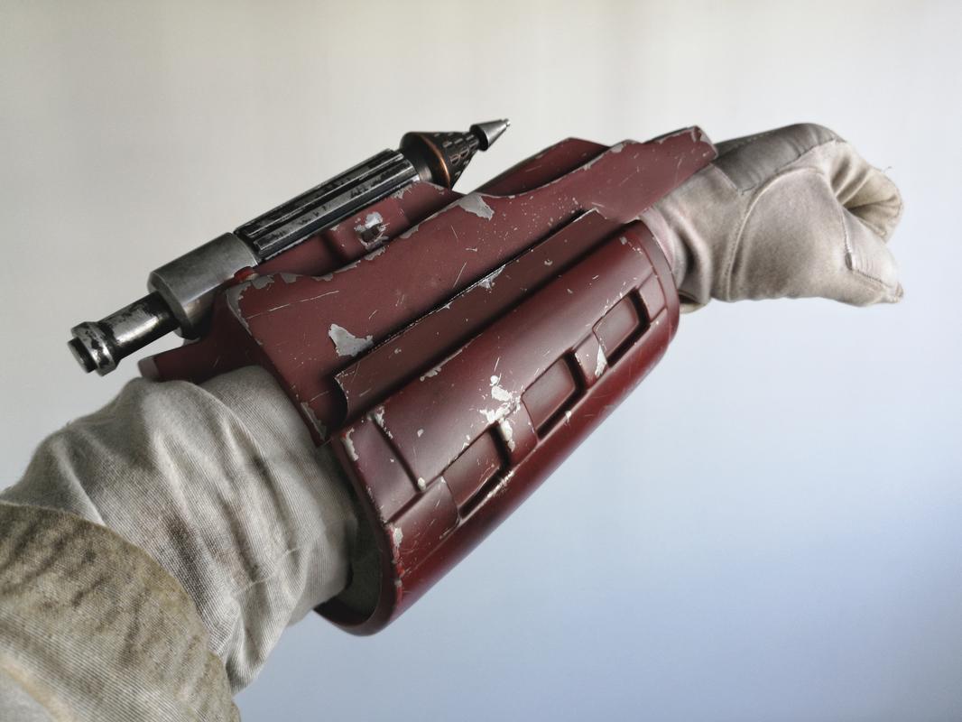

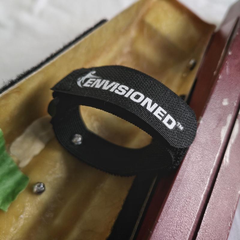

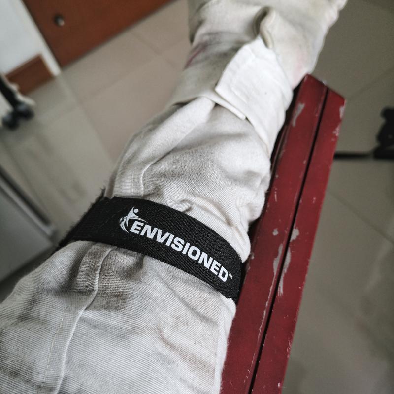

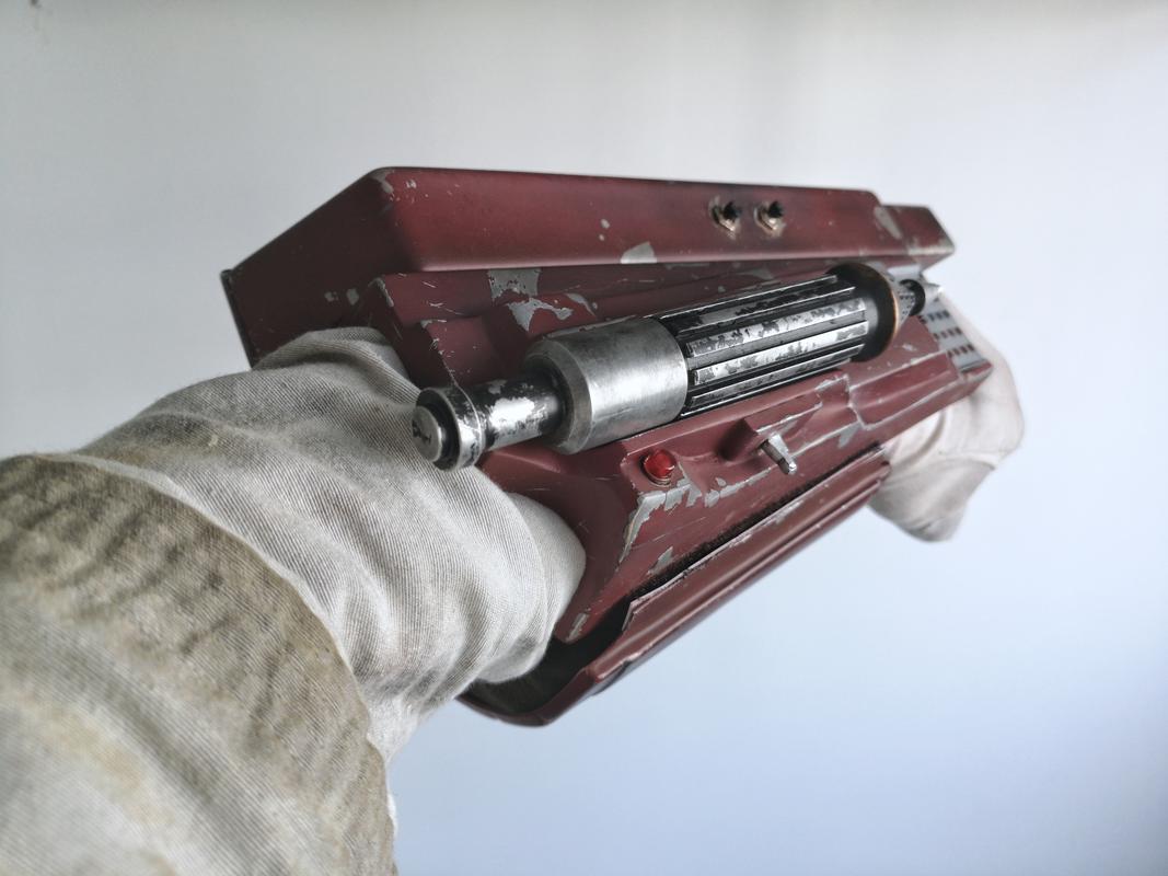

Installed an elastic velcro strap into my left gauntlet and the test fit is a success! It takes a bit of effort to put it on myself, but it is possible. With the sleeve and foam filling up the space, there is hardly any slack and hence reducing the lateral roll. The elasticity of the strap will not cut my circulation off completely...I hope...
*After this photo, I trimmed down the foam on the bottom so it's not visible anymore.

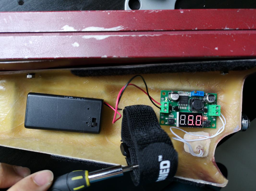

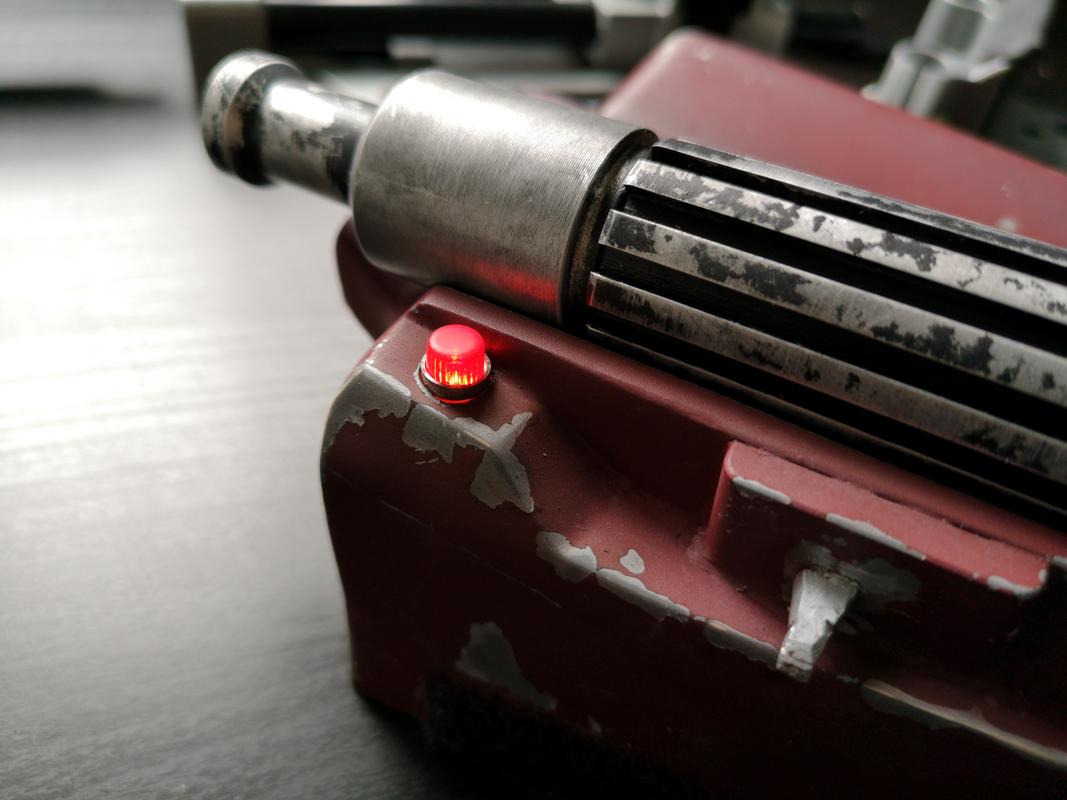

I had initially not planned for working electronics on my left gauntlet, mainly because I know next to nothing about such things. But hvacdon convinced me otherwise and had generously gotten me a step-down board to complete the rig. Even as I installed it, I was concerned about the limited space in the upper and the multitude of ways I can screw this up royally. Well, having seen how cool it looks, I am now determined to make it work. I will clean up the layout later, but here's the rig as it is now.
Electronics always adds that extra touch of bad assery to the build! Looks great and glad you went through with it!
Looking Good "T" !! Could you fit the pack and the board over in the flame thrower ??
My board just came in yesterday. I also have a flasher selector I'll be checking out.
I'll let you know how it goes...
Thank you gentlemen. There are definitely ways to improve my rigging so I'll look into it at some point.

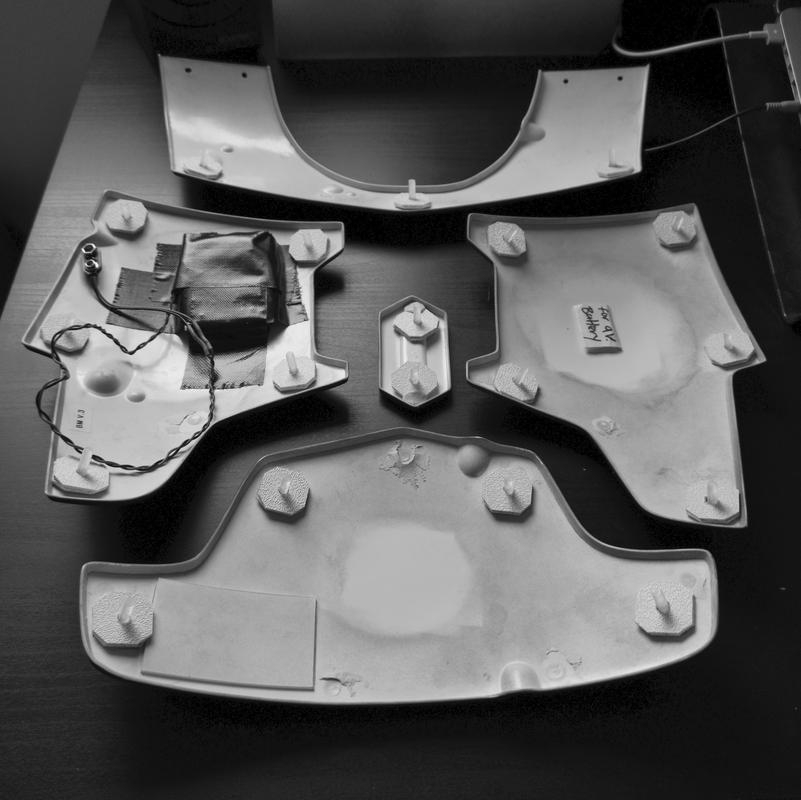

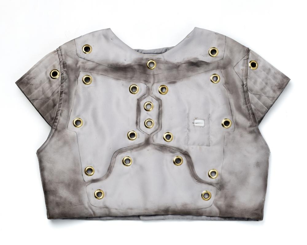

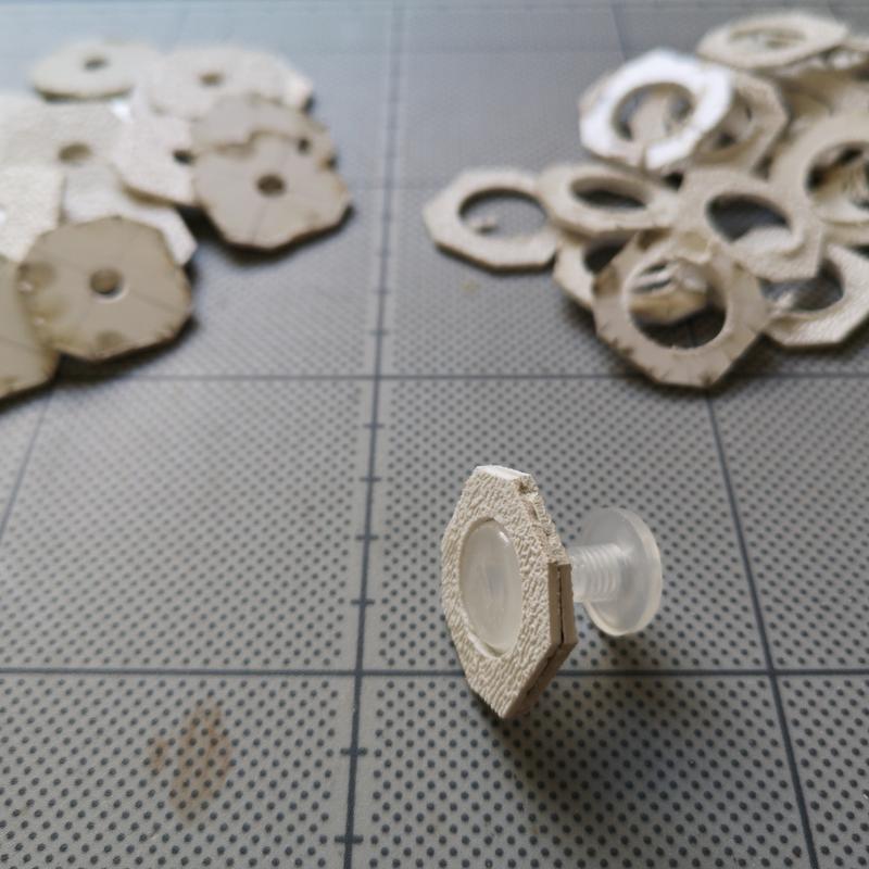

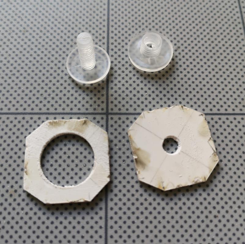

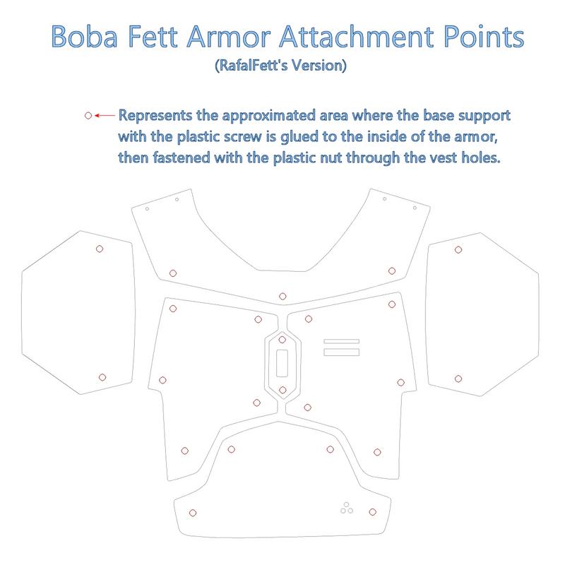

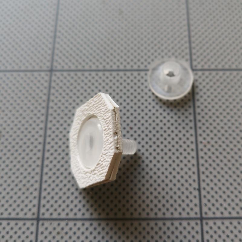

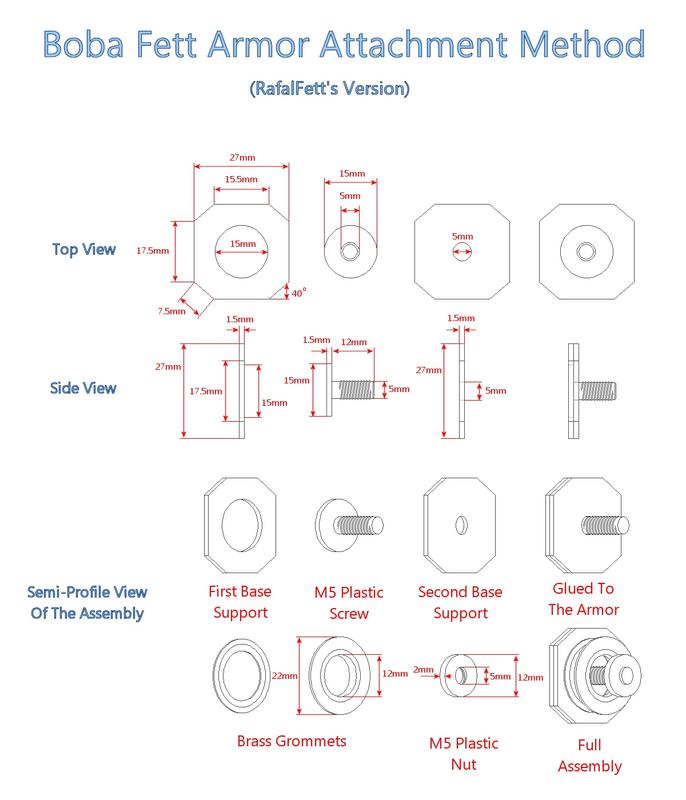

I finally got to work on the armor attachment assembly. Specs are based off RafalFett 's blueprints. It's a tedious process as it requires 23 sets of 2-part plates that house the M5 plastic screw. Thanks to Major , we got most of the work done by laser cutting the base squares. I trimmed the corners and drilled the holes for 46 pieces!

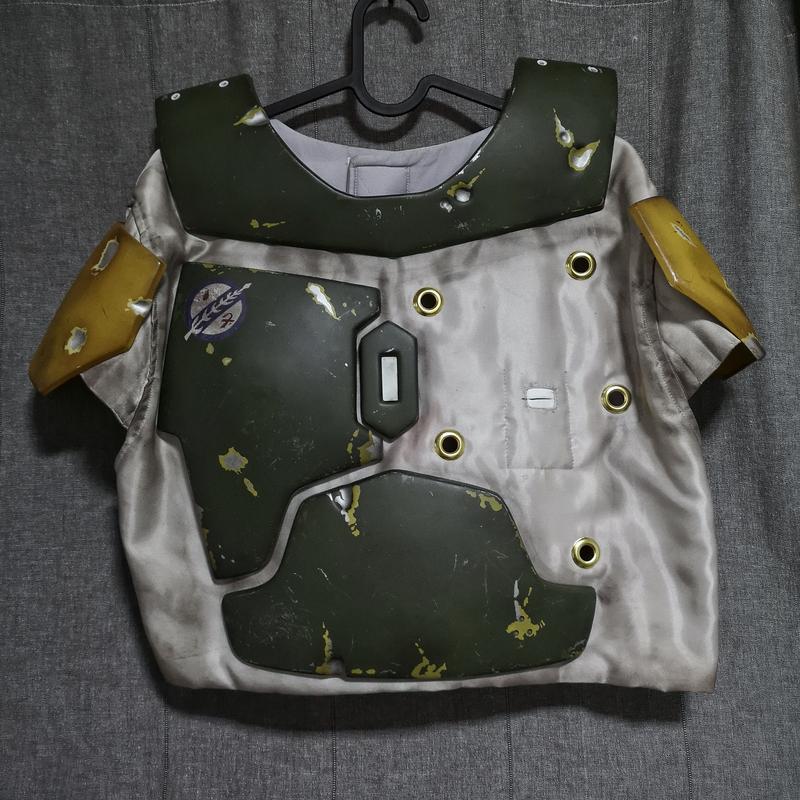

I installed brass grommets onto my vest, stuck the plastic screw units onto the armor plates, and assembled them except the left chest plate.

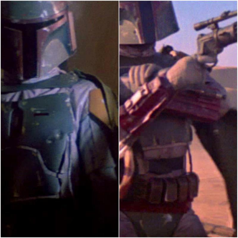

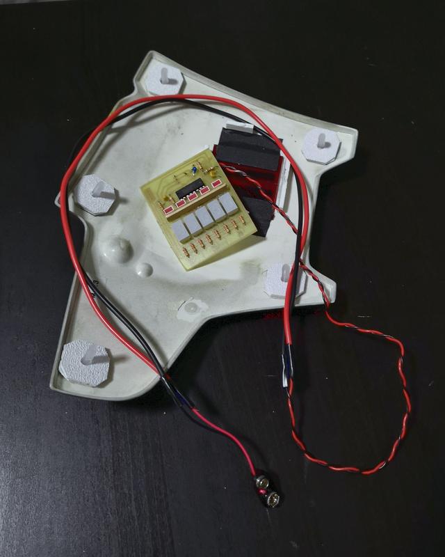

These screencaps clearly show a cable wrapped in silver tape exiting the left chest plate and running under the girth and ammo belts. I am guessing, and it seems logical, the cable supplied power to the chest display from a power source in the left thigh pouch or in one of the ammo pouches.
To replicate the silver cable, I removed the chest display unit and lengthened the cable so it's long enough to reach my left thigh pouch.
I'm going to look for silver tape tomorrow to wrap the cable and attempt to complete the vest, along with the wookiee braids.
Great build so far! I think this is the best method to use for the armor, because the diameter difference of the grommets and the plastic screws allows the plates to move slightly and sit "naturally" on the vest/torso.
They used that cable to power the chest light, which had a power source (as you correctly assumed) in the left thigh pouch:
