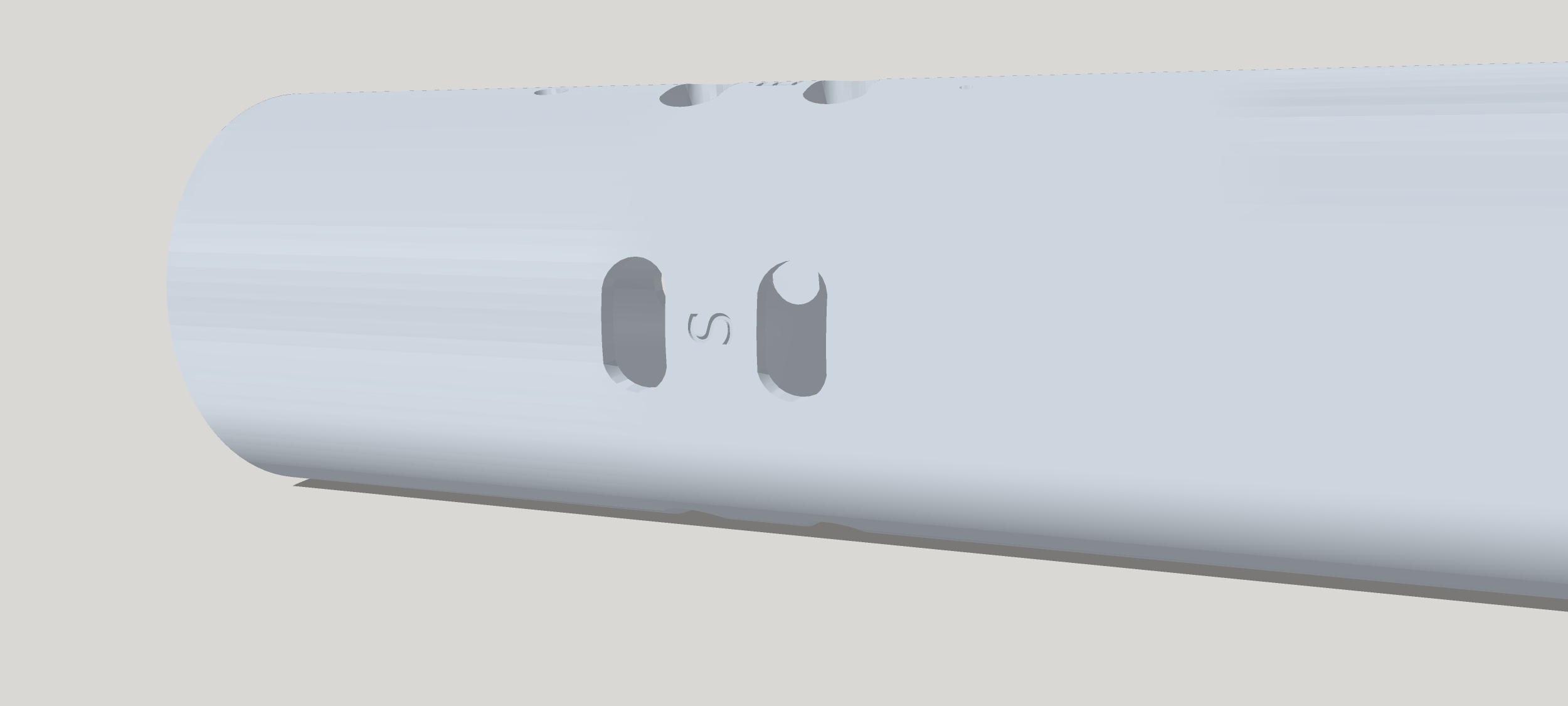

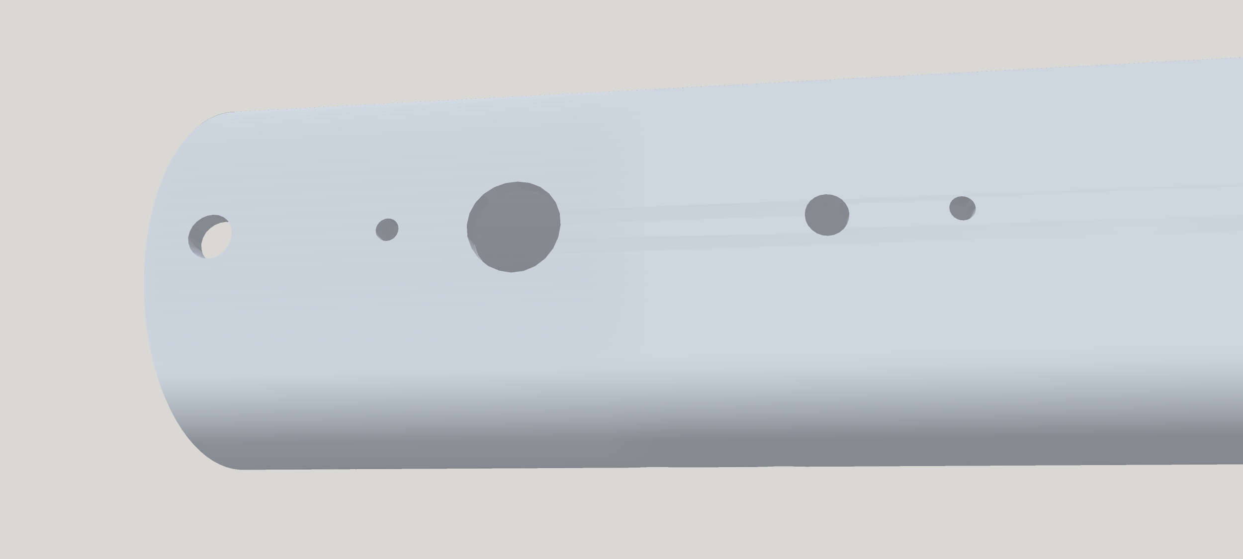

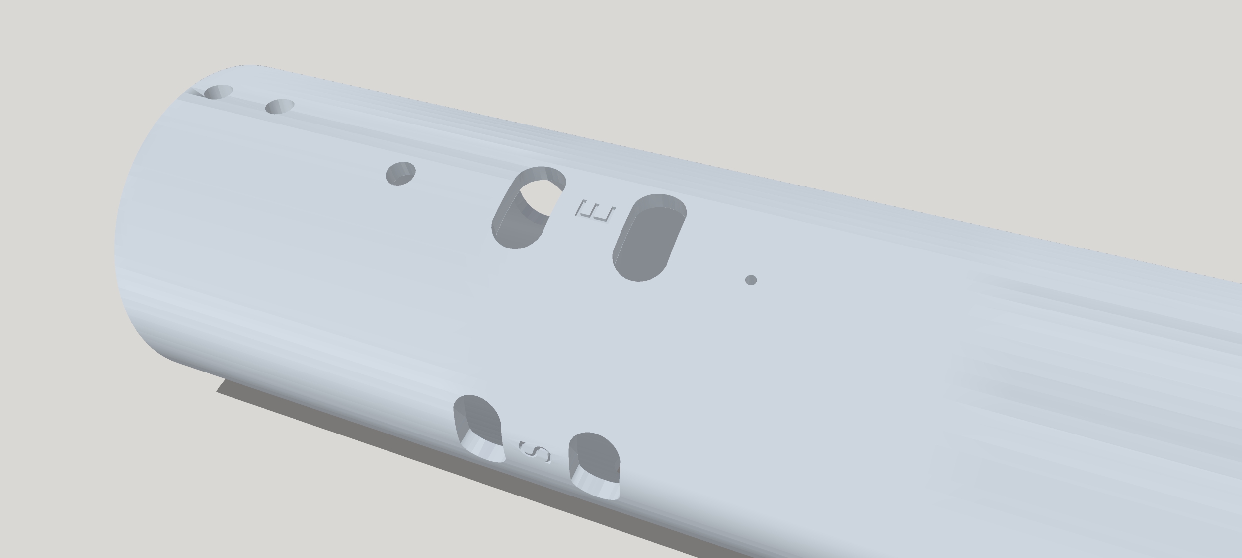

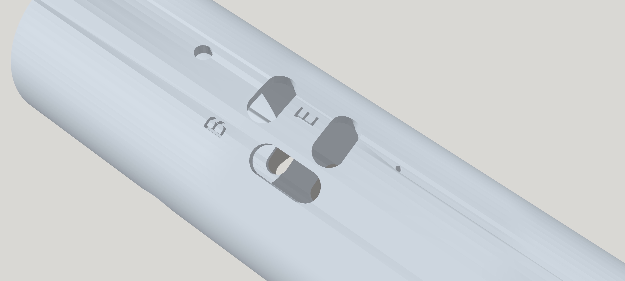

The model of the MPP flash tube (used for the ESB EE-3 blaster) was updated on Shapeways and now contains all the etched letters, but I also reduced the 2nd hole on the side with 5 holes:
ESB EE-3 MPP Tube 08.jpgESB EE-3 MPP Tube 09.jpgESB EE-3 MPP Tube 10.jpgESB EE-3 MPP Tube 11.jpg

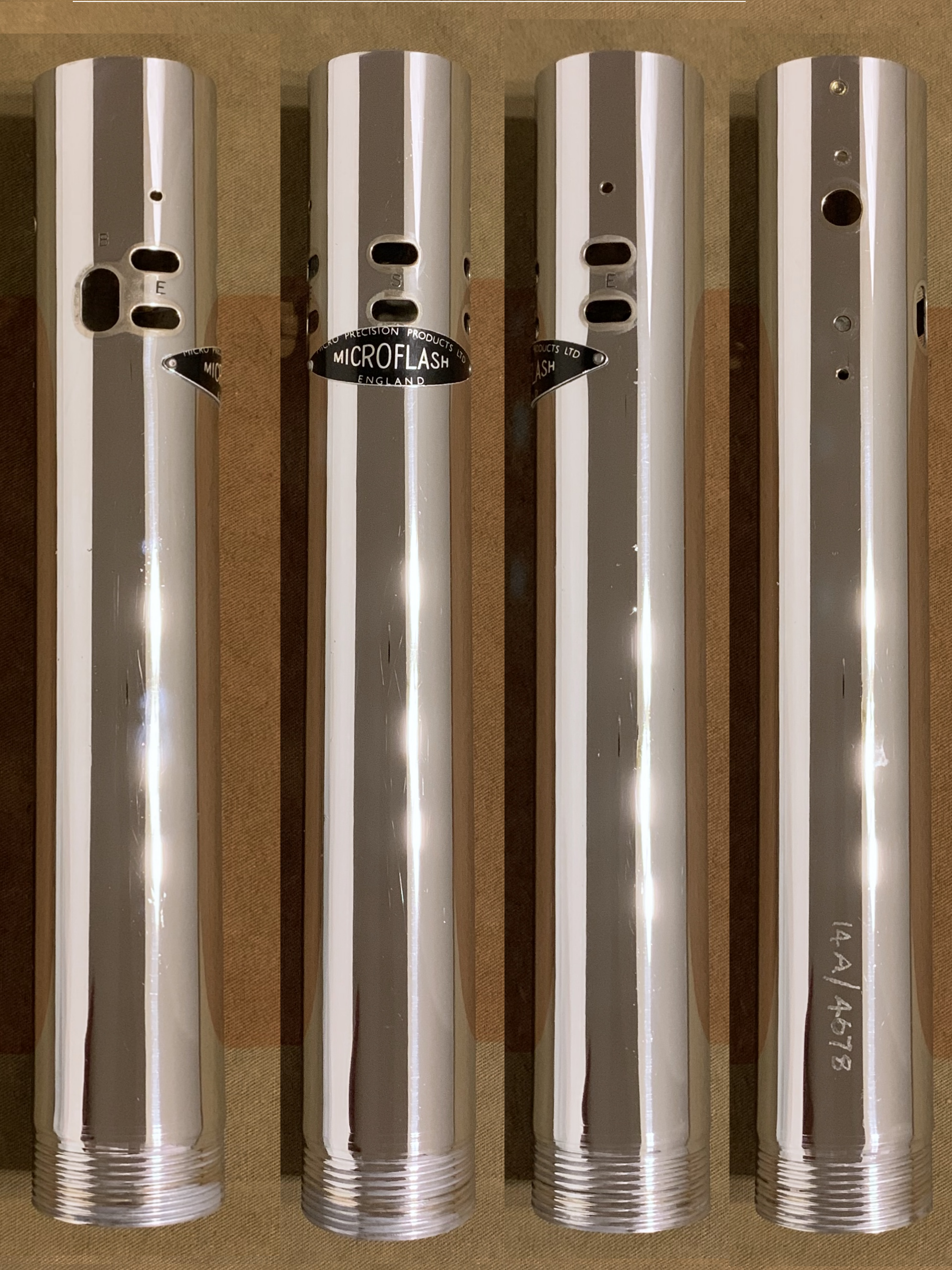

I used this image (compiled from Fettastic's photos) to do the changes:
It looks to me like the B port hole should be larger. Also, the very top hole on the "bottom side" witch you have labeled as five holes, is not actually a hole but an indentation.

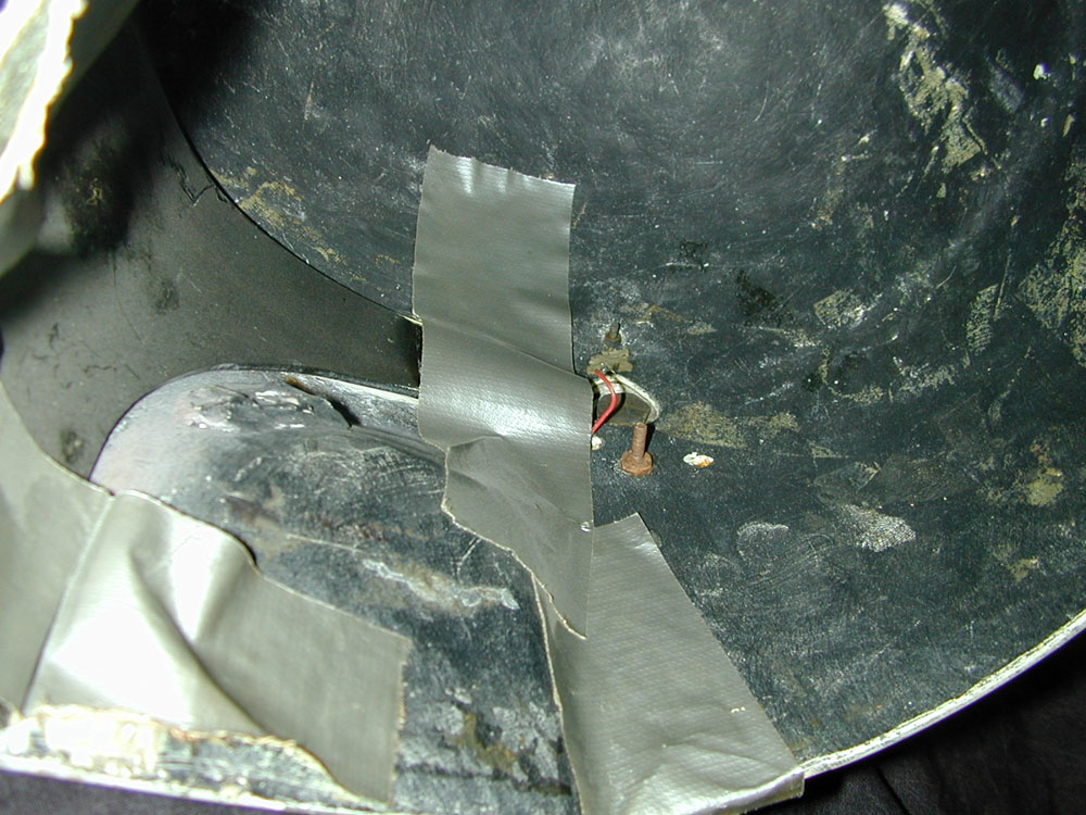

How is the range-finder stalk attached? Is there a bolt? What keeps the rangefinder stalk from falling into the forward position? How do we paint the rangefinder ear assembly in a way that doesn't rub against the stalk as is is moved down? washers to add space? Thanks! These models have been awesome.
The rangefinder stalk was hold in place by a screw inserted from the inside of the helmet while the right upper ear cap replaces the nut (it has a threaded hole on the inside):

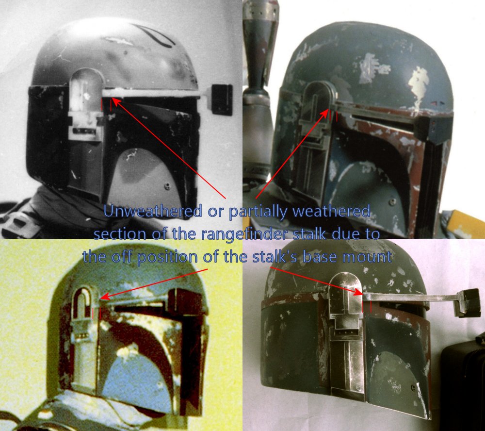

All the original stalks had the wear and tear made by the repeated movement against the right upper ear:
