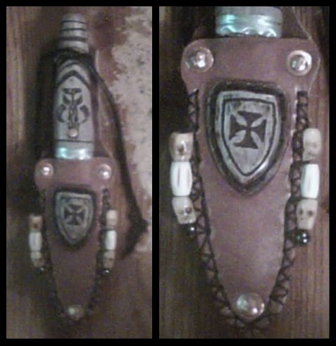

Mandalorian Boot Knife Sheath:
(By the way, the Knife will now shave)
I also constructed this from scratch. Leather, Copper nail and washer rivets, sewn with waxed twine. The Coat of Arms is carved from a slice of antler, and the skull beads are from Tibet, hand-carved from bone. The back of the sheath has a dual rig system that will allow it to either be worn on a belt or strapped to a boot. The Coat of Arms is my registered SCA Coat of Arms, sans the colors. The colors on the real coat of arms are "Argent, a Maltese Cross Sable within a Border Purpure", or "White field, black maltese cross, purple border".

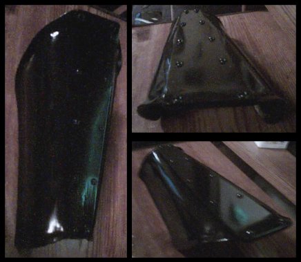

I also hammered out the left Shinplate, unfortunately, I didn't snap any progress pics of it. I'll get progress pics of the right one. Here it is smoothed out, with the basecoat applied:
I changed some of the contours for comfort and safety reasons, flaring the edges outward much like medieval greaves often were. I also used the same riveted construction as I did with the codpiece, both for continuity and durability.

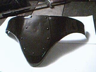

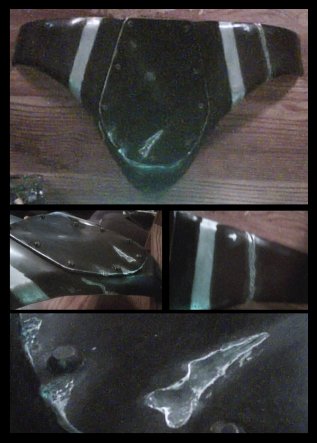

I finished the codpiece, continuing the color scheme and weathering patterns:

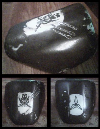

And no armor is complete without a set of "cat scratches". I finished weathering the shoulder bells:

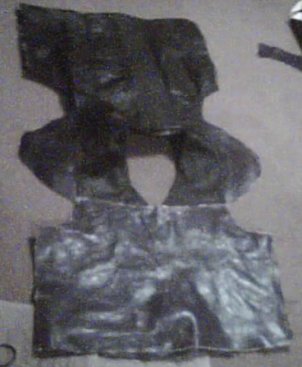

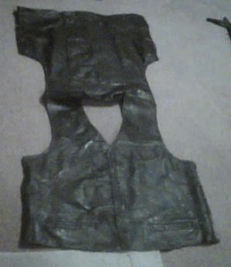

Found a black leather vest in my closet that I had forgot about... Since it was a western cut vest, I had to trim it down a bit and add to it. All leather. I sewed up the front, cut the sides open along the seams, and trimmed the little V's off the bottom of the front, rounding it out a bit:
Then I cut shoulder flaps and a front panel out of leather and sewed them on, also hemming the rest of the vest. The front panel is so that there will be one continuous texture under the plates:

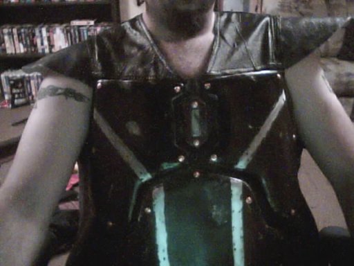

Went around the edges, trimming the uneven spots and dual-stitching the added pieces for durability. Here's a test fitting of the chest armor on the vest:
I added underlap flaps to the sides (the flaps are attached on the sides of the front, and the back of the vest will overlap the flaps.) They'll be held in place with both velcro and buckles. Plate test fitting #2:
I know the V neck isn't proper. The collar plates will be attached to my gorget, which will cover the V neck, while allowing the neck to remain large enough for me to slip the vest on. The plates will attach to the vest with copper nail rivets, which I'll paint and weather to match the rest of the armor.
Got the Chest pieces attached to the vest. Still have to paint the rivets:
I also still have to get velcro for the sides, attach the bottom side buckles, shoulder bells, etc.

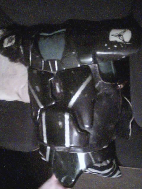

Finally got new batteries for my real digicam. I know the picture collage is large, but I configured it lengthwise so as not to mess up the width of the page:
I picked up some velcro for the sides, finished sewing up the edges, modified the shape of the shoulders, and finished attaching the chest/belly plates. The shoulder bells and collar aren't permanantly attached yet, but they're taped on to give a rough "finished" look. The collar will actually be on a gorget that will overlap that area:
