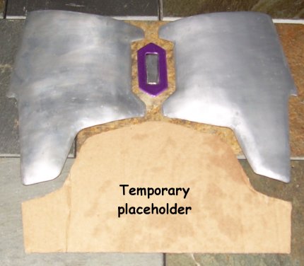

I've been lurking for a bit now... not asking too many questions (since most newbie questions are answered by searches...) But, Here's my armor debut. I've read pros and cons for fiberglass, sintra, sheet metal, aluminum, etc... Being an SCA fighter, I'm used to metal and leather. I'm also a bit picky when it comes to my projects. I want my armor to be able to take a beating.
Under ideal circumstances, I'd be able to buy raw materials and go from there, but being on a tight budget, I scrounge and salvage what I can. I'm making my armor from an old highway sign that had been hit by a semi and left on the side of the road for several weeks before I "helped clean up" the side of the road and salvaged it. I think it's some kind of aluminum alloy... it's tough as nails, 1/8 inch thick, and hard to bend:
Today, I made a rough cut of the left breastplate:
it's not much so far, but it's a start. :cheers

Just broke my last saw blade... but here's what I have so far:
Thanks, and yeah, I still have to clean up, round the edges, most of the corners, and then the back of the plates will have a *thin* layer of closed-cell foam after I shape them to add some cushion and keep them from cutting into the leather undervest, which will also be armor-grade leather.

Evened the edges up a bit... now comes the hard part of getting the contour right.
The really tricky part is going to be finding an SCA combat-grade helm that looks even vaguely Mandalorian... *maybe* a barbuta. I'd *really* like to have one custom made for SCA combat, and then have my regular metal "costume" bucket (once I get it made) for trooping purposes, but a custom SCA helm is lots of $$$. It would have to have a 14 guage steel top, and 16-14 guage steel cheeks and back, a bar-grille across the wide part of the T visor, etc. But it would be wicked once it was done.

This set of armor will actually be lighter than my old fighting armor (which was all steel), so I'll also have a bit more mobility as well. :thumbsup: I'm going to pound out my own aluminum elbows and knees, which will take quite a bit of weight off. I may even go with kydex for the fighting set of elbows, vambraces, and knees, and my round shield will be aluminum as well. Should have quite an advantage over the heavier steel. I'm debating on whether to reinforce my kidney belt with an aluminum belly plate, or just make the belly plate and kidney belt all one piece out of leather. I wouldn't think adding an aluminum belly plate would add that much weight though.

On to progress...
So far today, I made a planishing stake, re-surfaced one of my hammers, and pounded out the right breastplate:

Just finished shaping the other breastplate, fixing to start cutting the belly plate:
