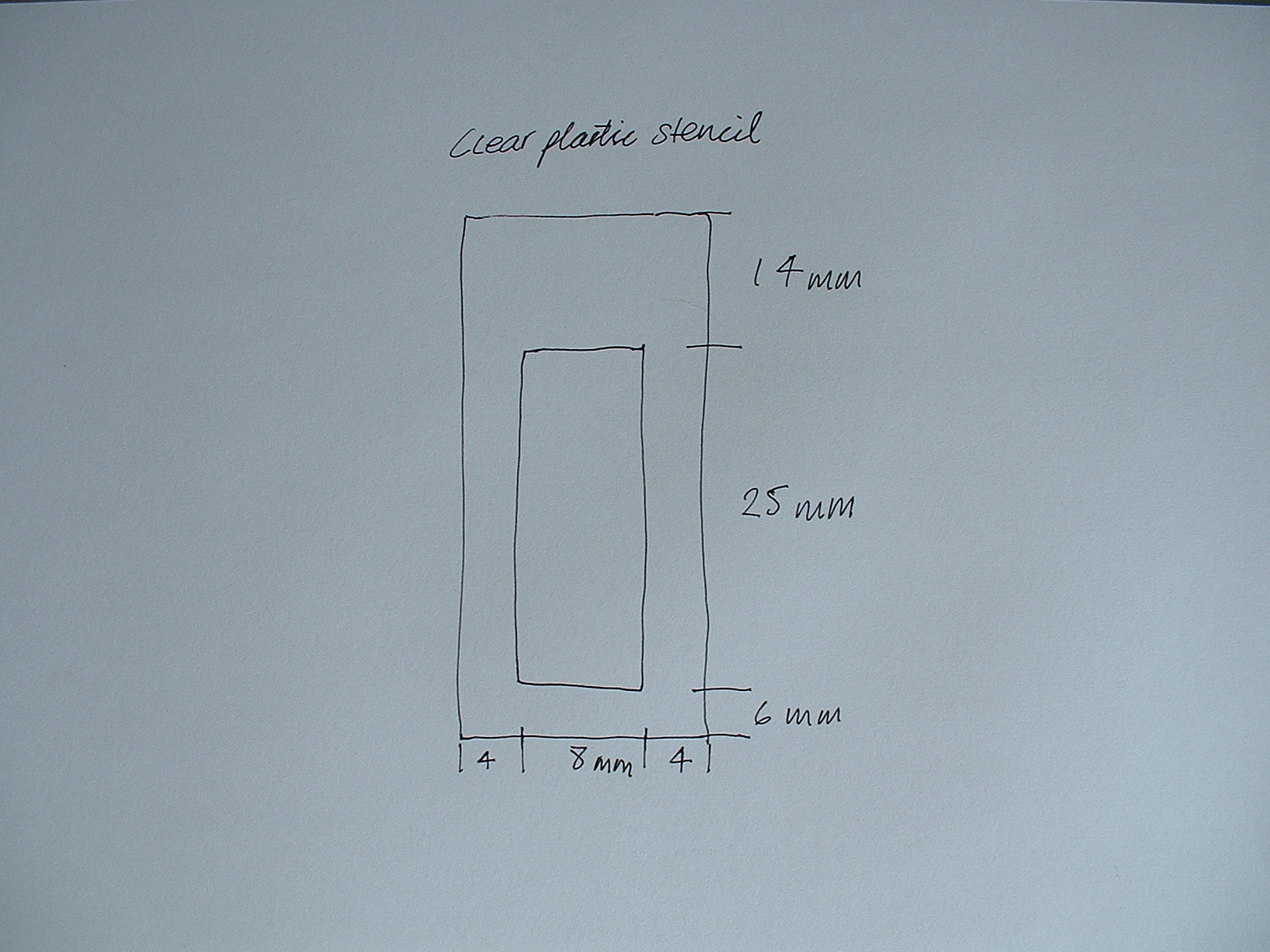

Hi Garrett, I was wondering if you could post your kill stripe dimensions. I've laid out a masking tape guide on my helmet, but it doesn't look right.
I guess I need the height and width of your stencil, the distance the stripes are apart from one another, and the distance above the red band. Do you start on the left one , right one, or middle ? I tried to line up the 7th stripe using the center line of the ear as a guide, but it looks off on one end or the other.

Hi Tim, here's a sketch of the stencil and dimensions. I used clear plastic as you can line up the layered details below. The bottom of the stencil sits on the brow. I start by adding the first kill stripe below the dent, the one above the corner of the t visor (no. 4) No. 9 which is almost in line with the edge of the trim behind the L/H ear and no. 14, the last kill stripe. Once you're happy with the position of these stripes, just add the ones in between, the spacing varies ever so slightly by the odd mm here and there but you would never know...I then masking tape around the edge, using two thin strips between kill stripes that over lap to take up any differences, use liquid mask for the missing parts and scuff the masking tape with a sharp knife to achieve the bleed effect...

Thanks so much Garrett ! I'm also re-painting my back panels per your guide. It's not 100 % match, but it will look much better than my previous attempt.
