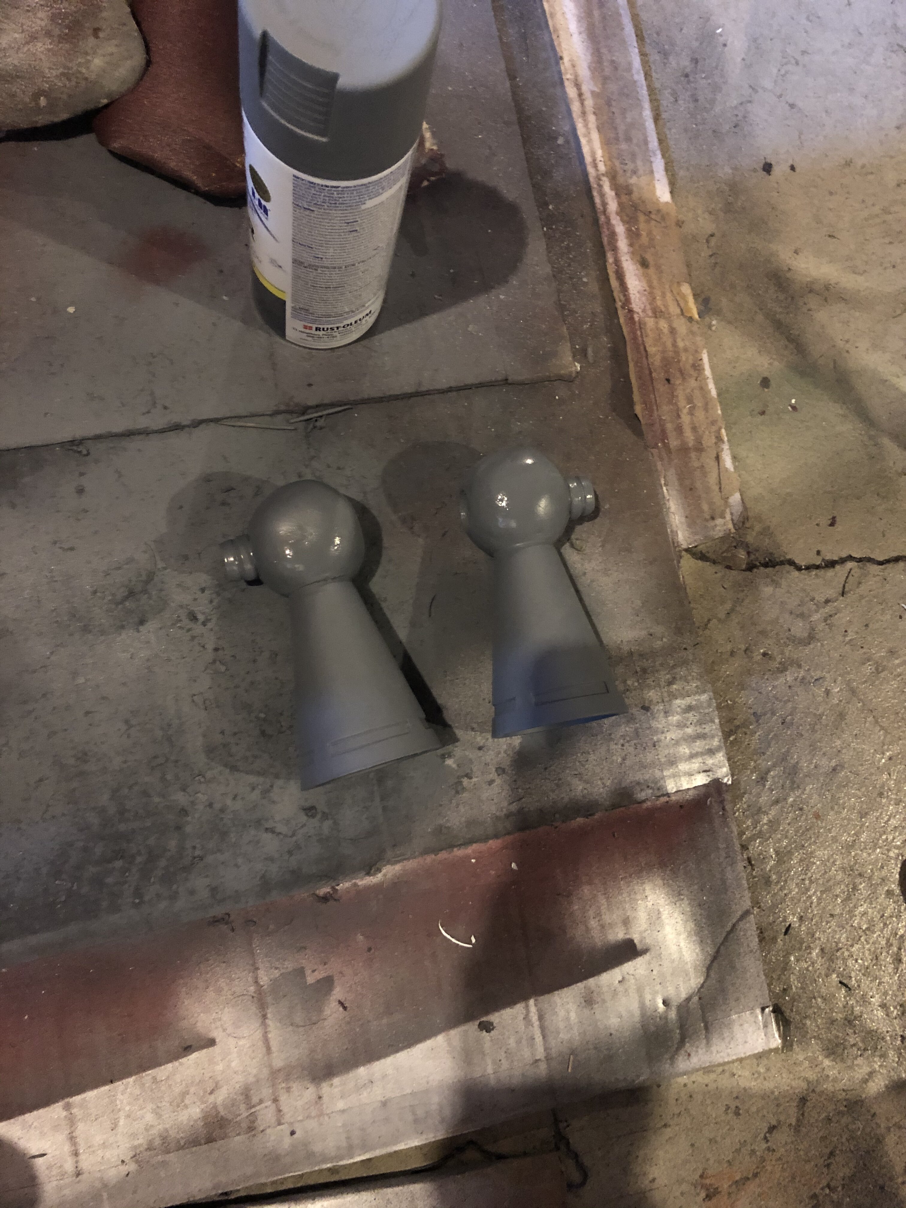

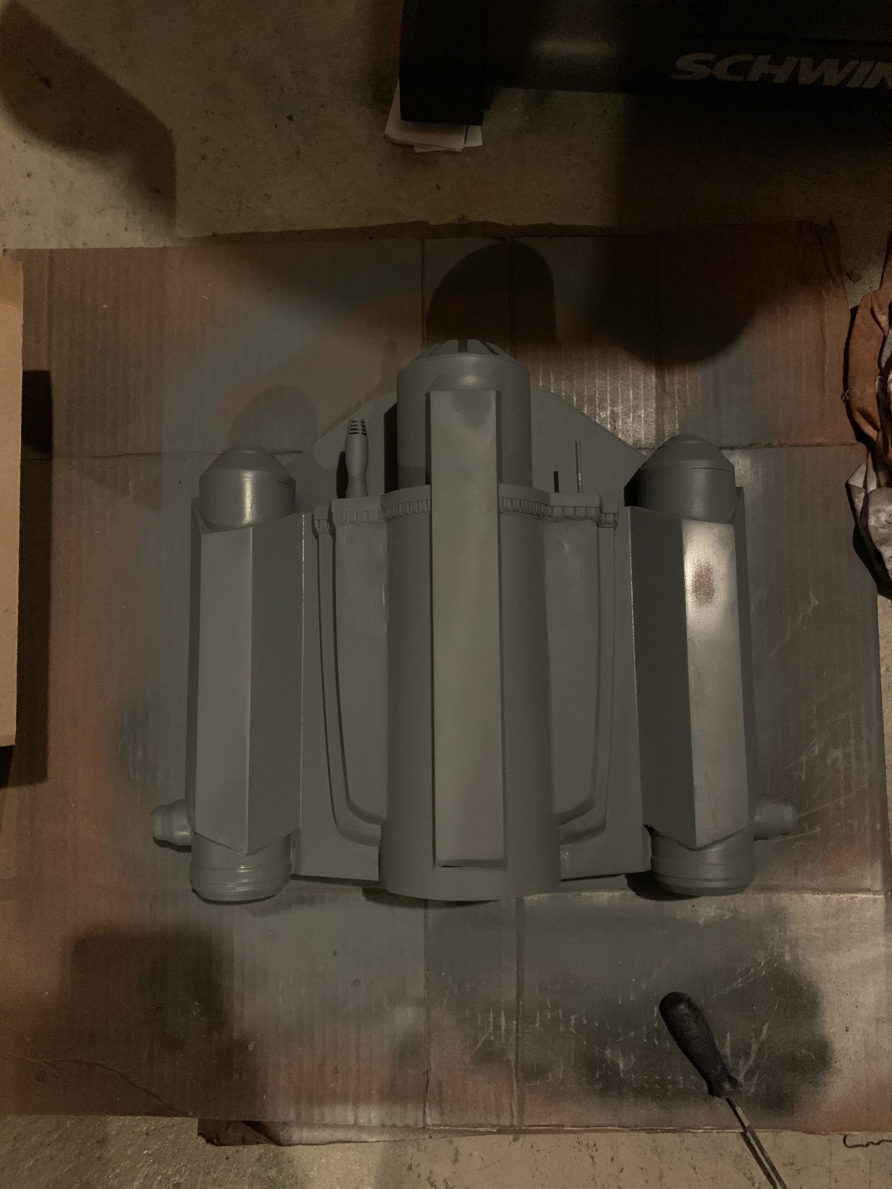

1/4 - Hey everyone! Sorry it has been awhile, I hope you had an awesome Christmas and New Year! I was in Florida for a week, visiting Disney and going to Galaxy’s Edge for the first time with my girlfriend. It was really awesome! Unfortunately, everyone else in my house got COVID just after I had left so I haven’t been able to return home just yet. However, my armor has finally arrived from MinuteFett! Once I get home, I’ll be sure to open it up and send pictures. Also, my brother was kind enough to sand down the apoxie on the jet pack and get it some primer on it. Result is attached!

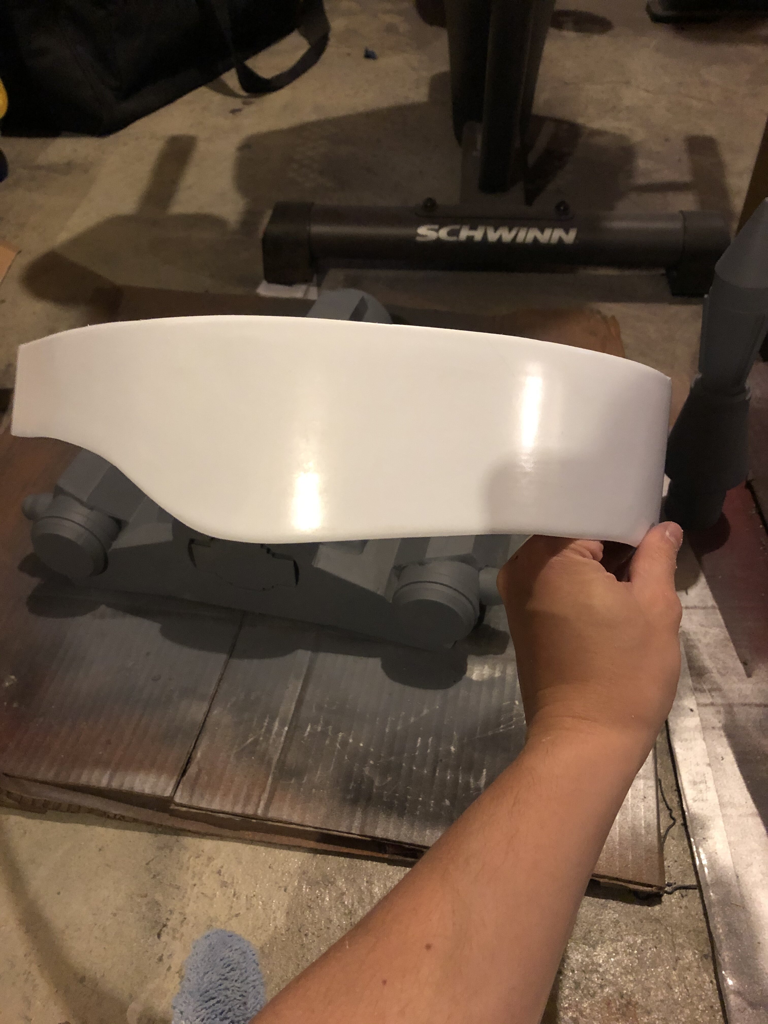

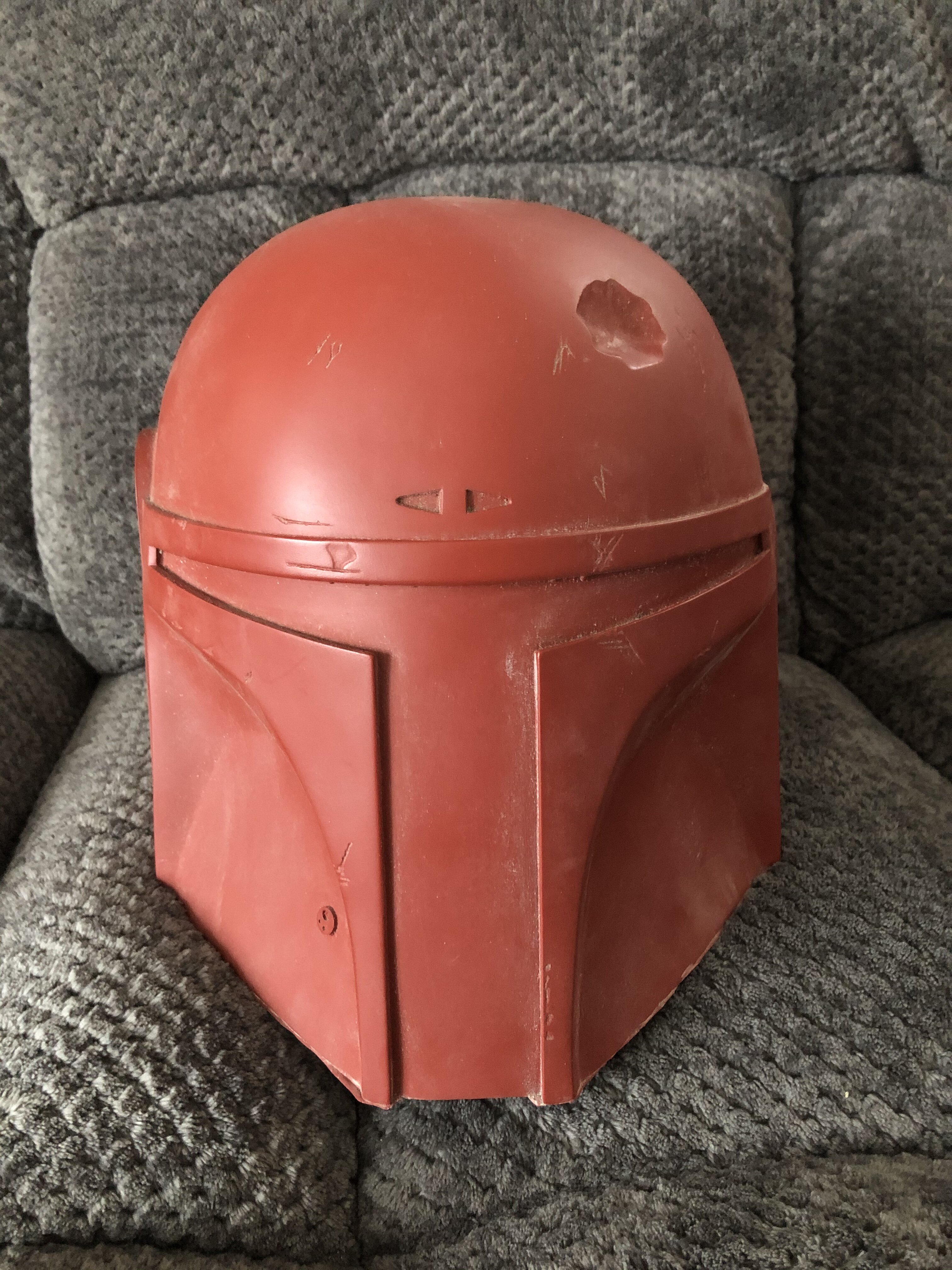

1/10 - hey everyone! Finally was able to come home and crack open my new boba armor! I gotta say, I’m pretty pleased with the way everything looks! It’s going to be a lot of trimming and sanding but I’m looking forward to the task. Also, MF accidentally sent me a pair of gauntlets so I got another set of those (not pictured).

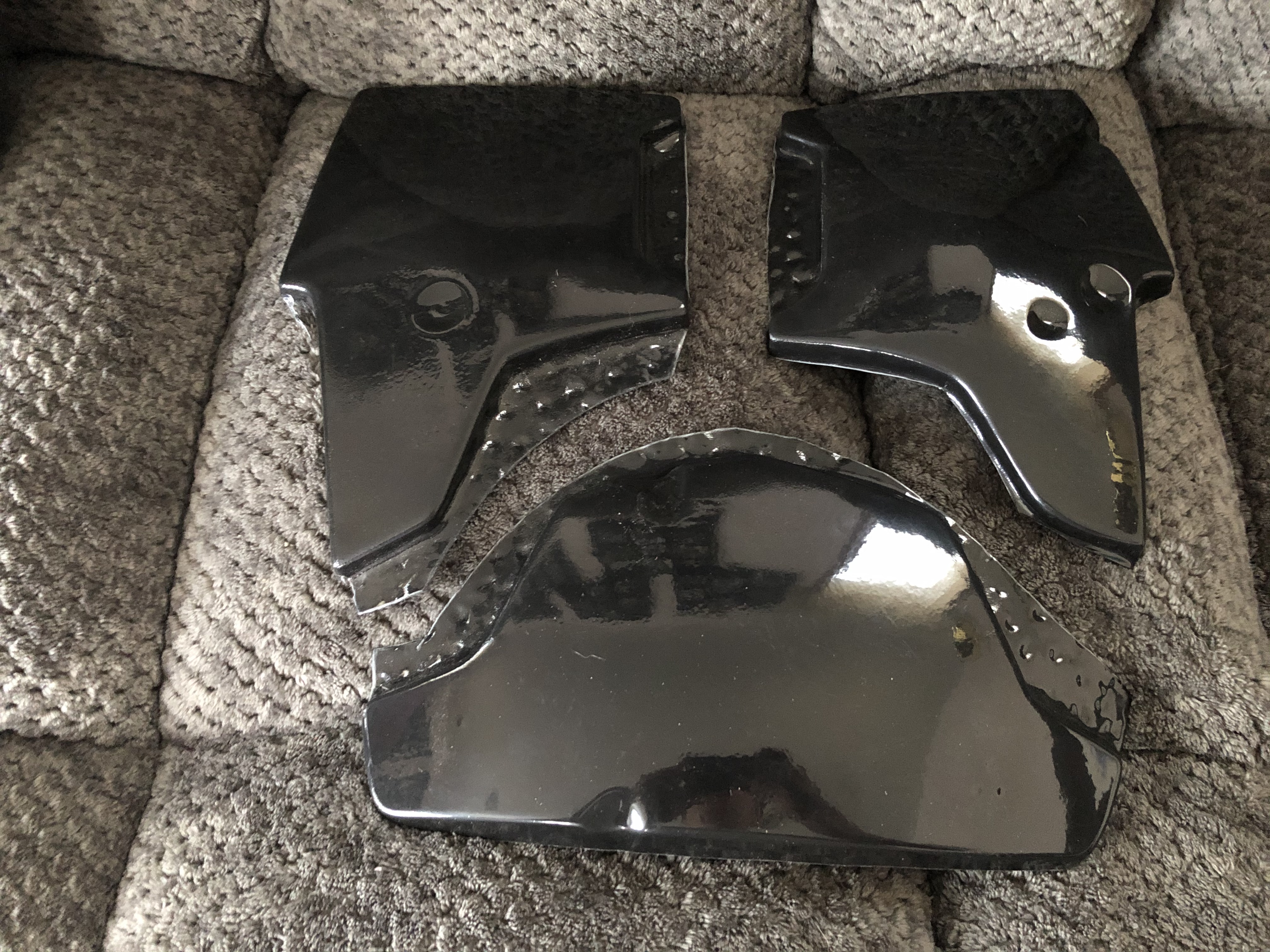

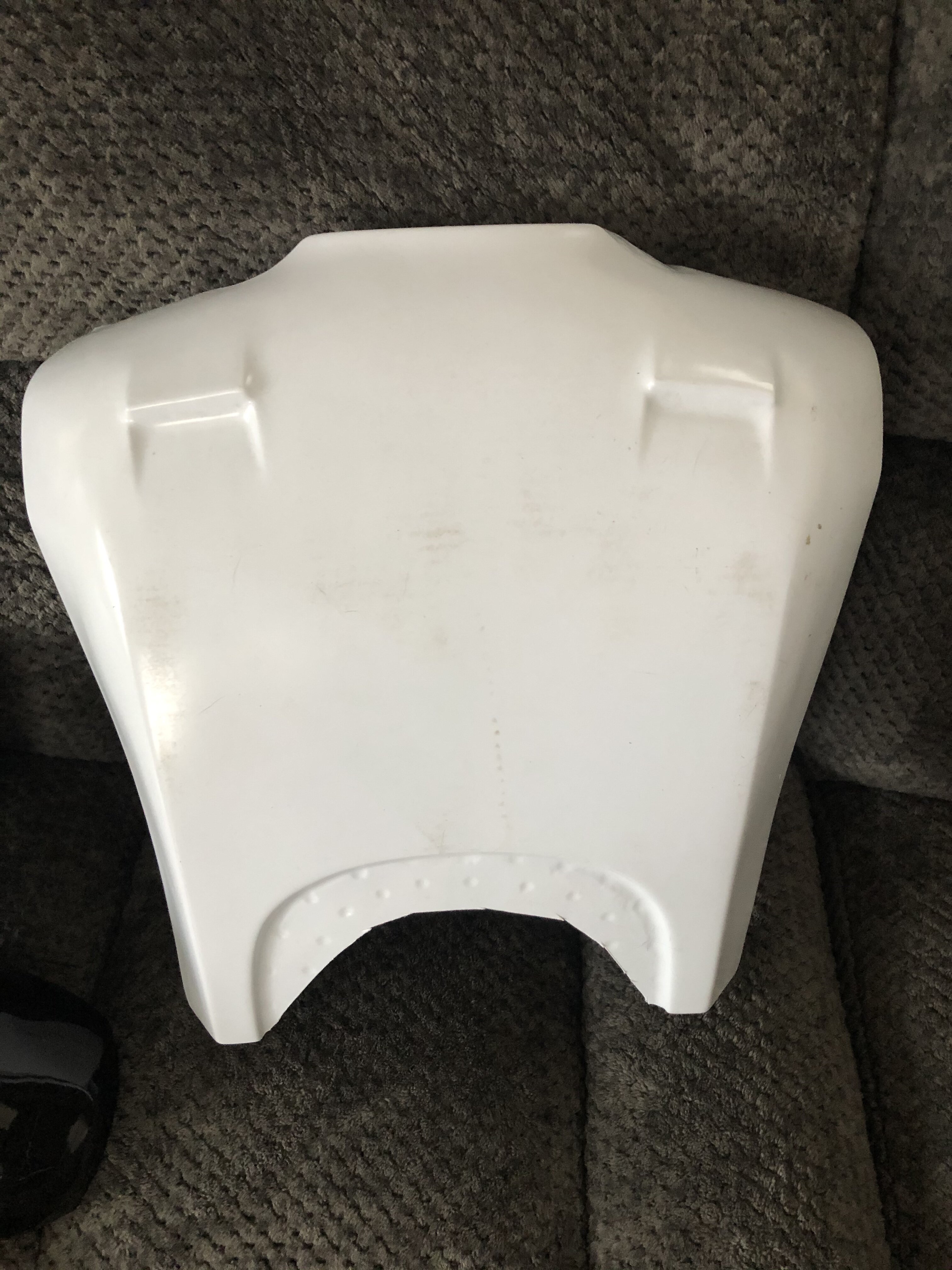

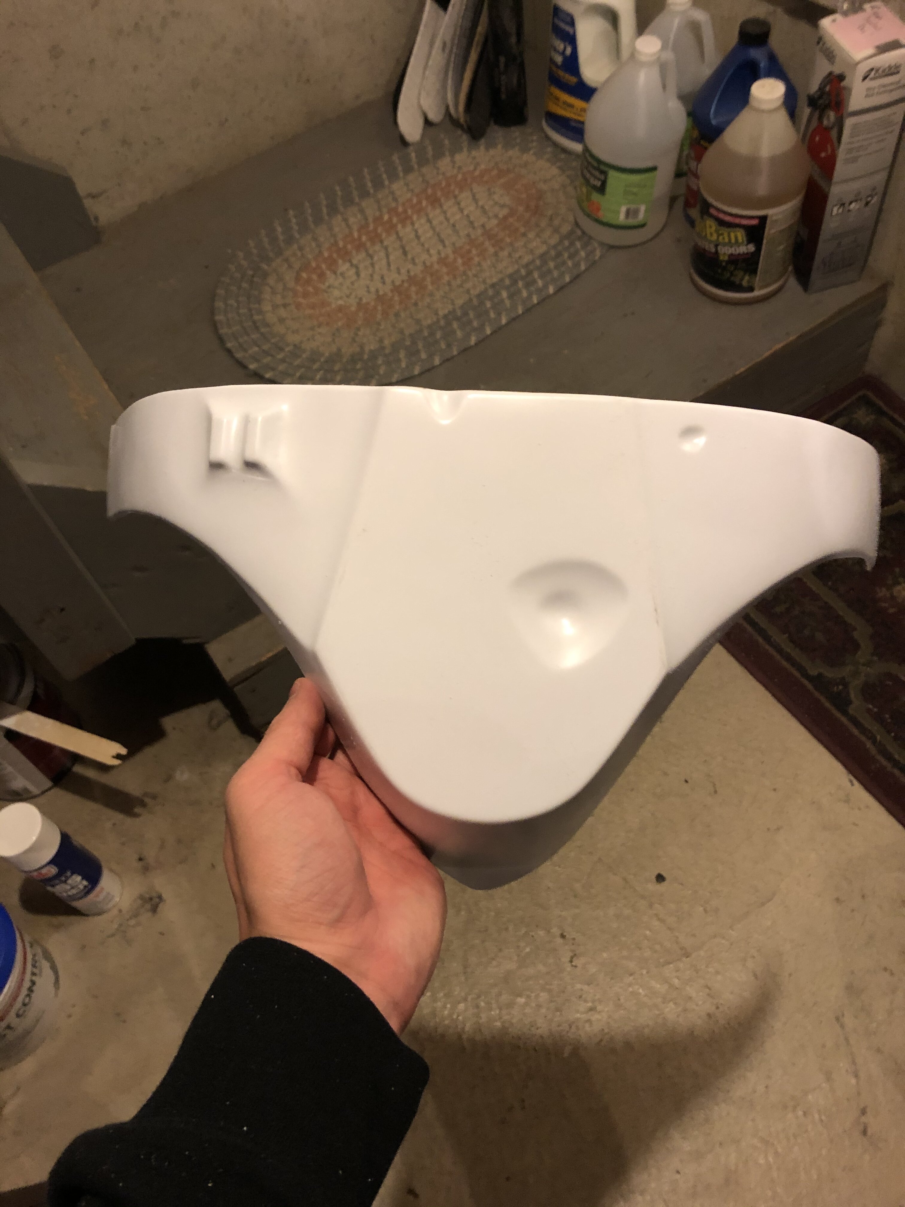

1/11 - got some trimming done! Overall pretty happy with the result, this stuff is super easy to work with! The strap slots on the back plate were tough to cut, but I tried my best. You won’t even really be able to notice them anyways with the straps hanging out the back.

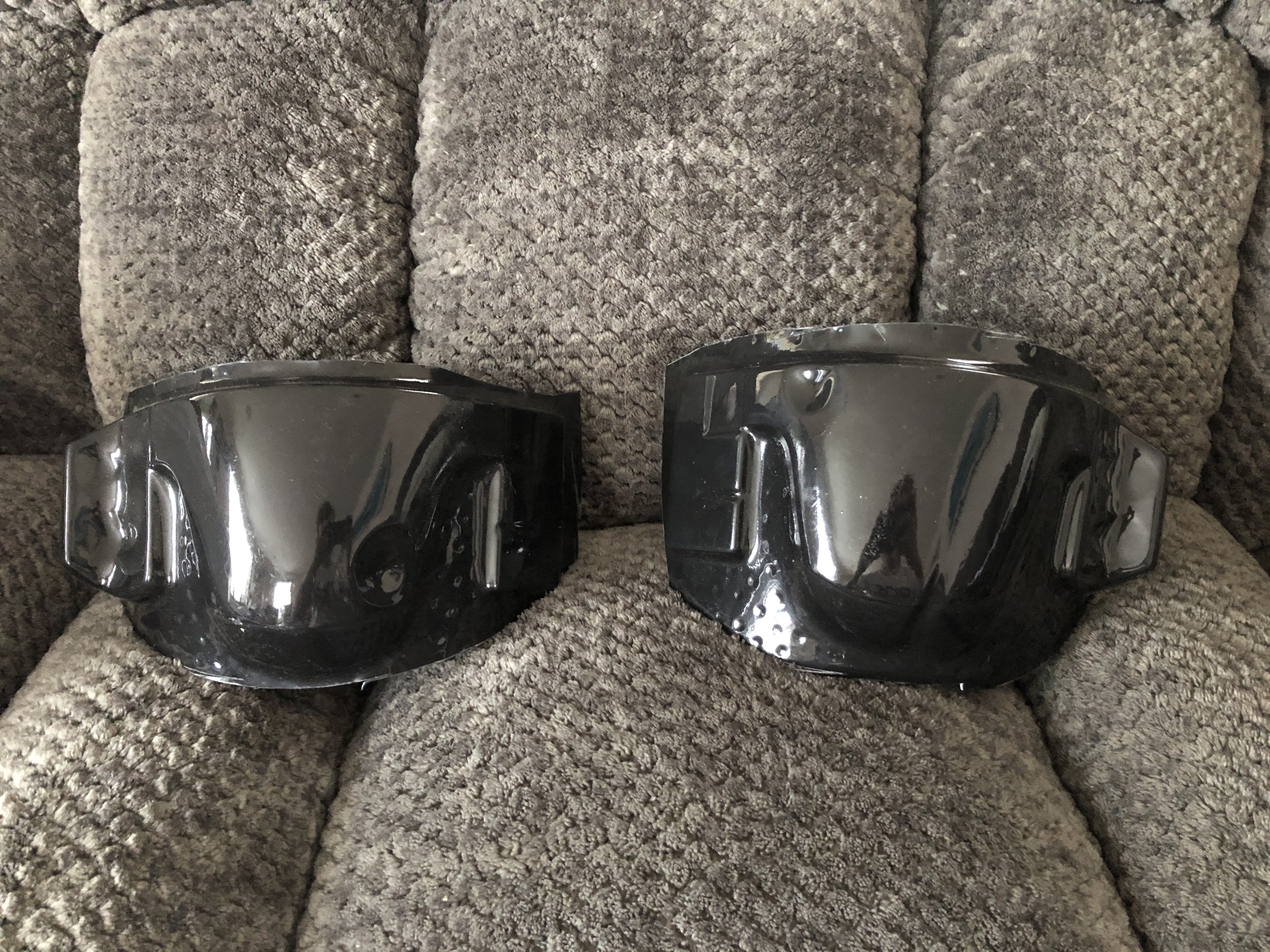

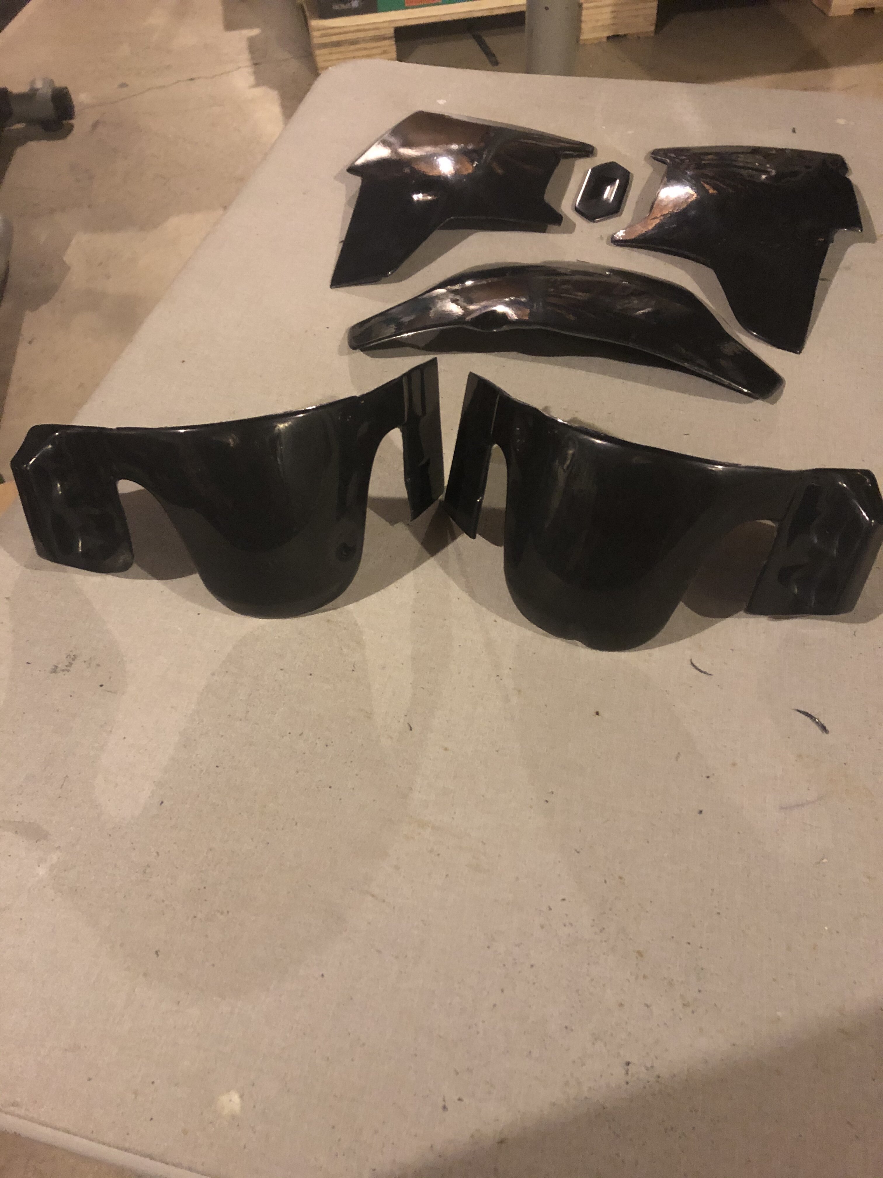

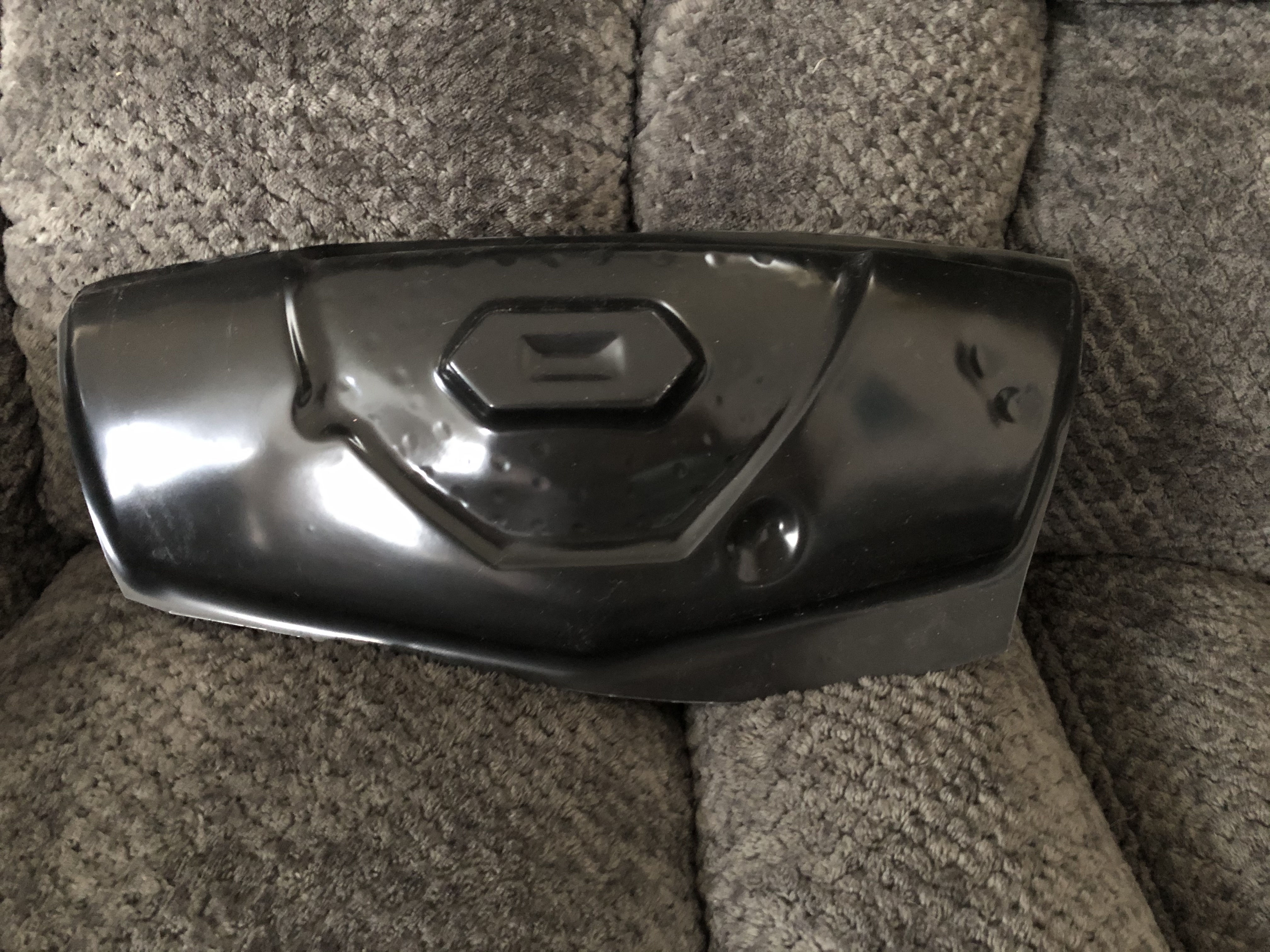

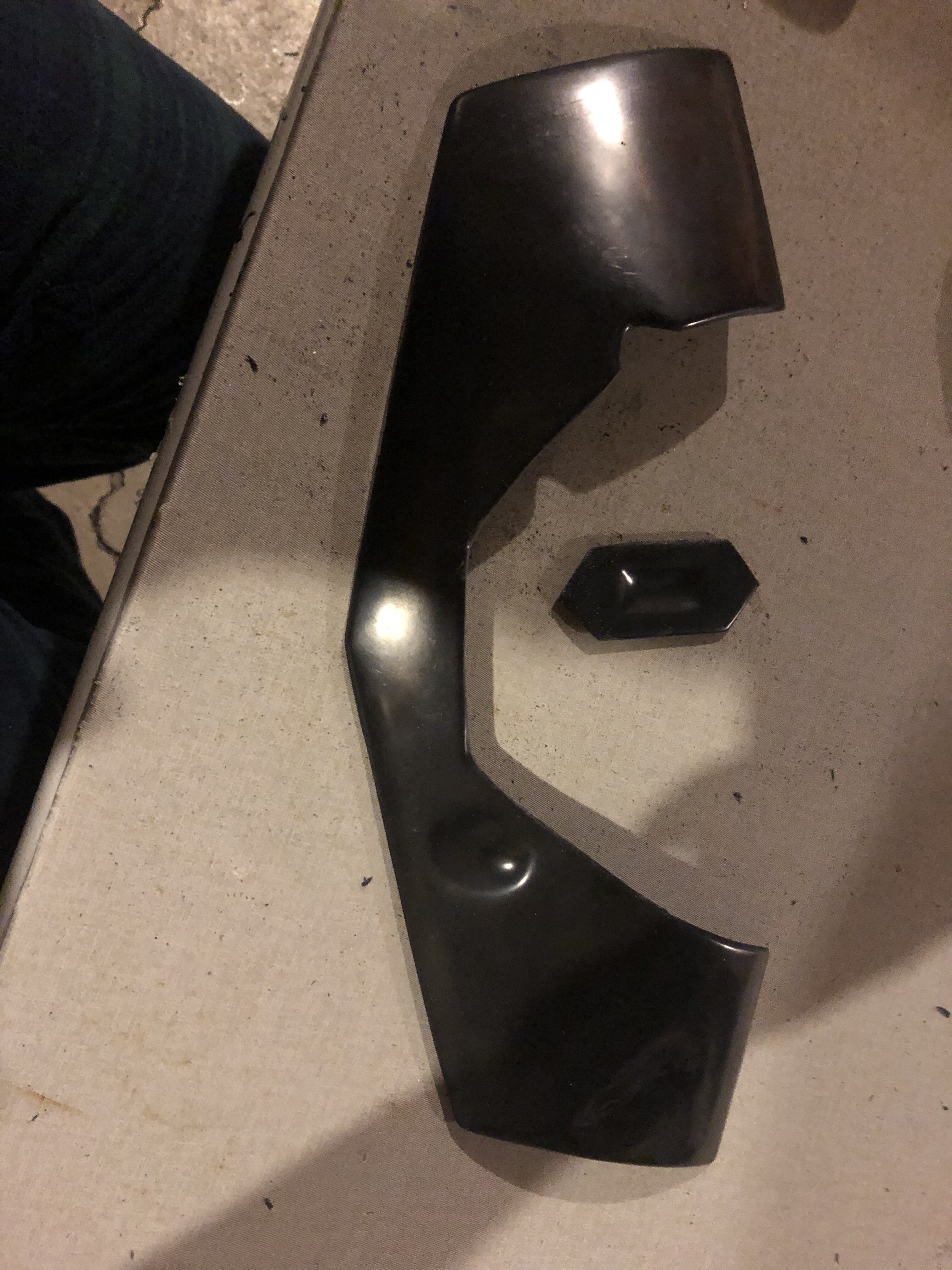

1/12 - got some more cutting done! Shoulders, collar, and diamond are finished! Shoulders were the toughest so far.

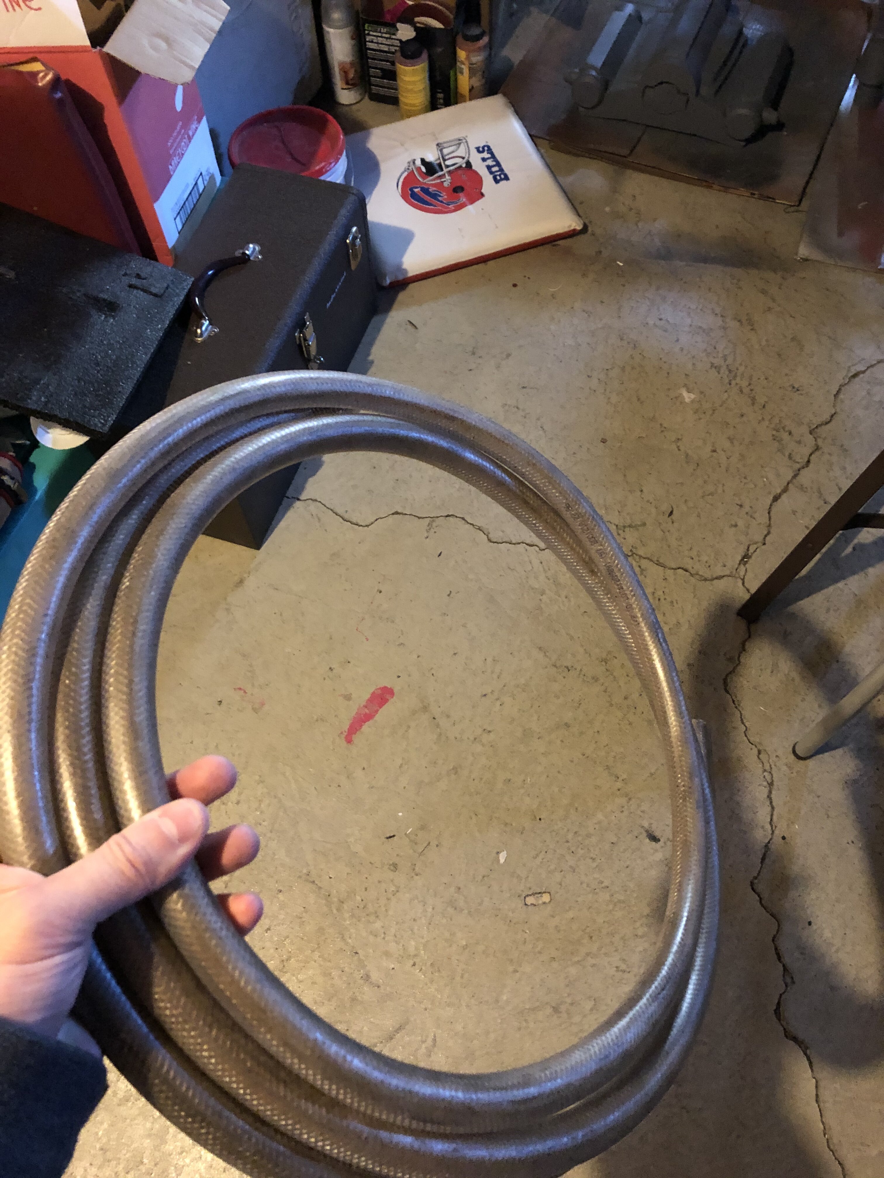

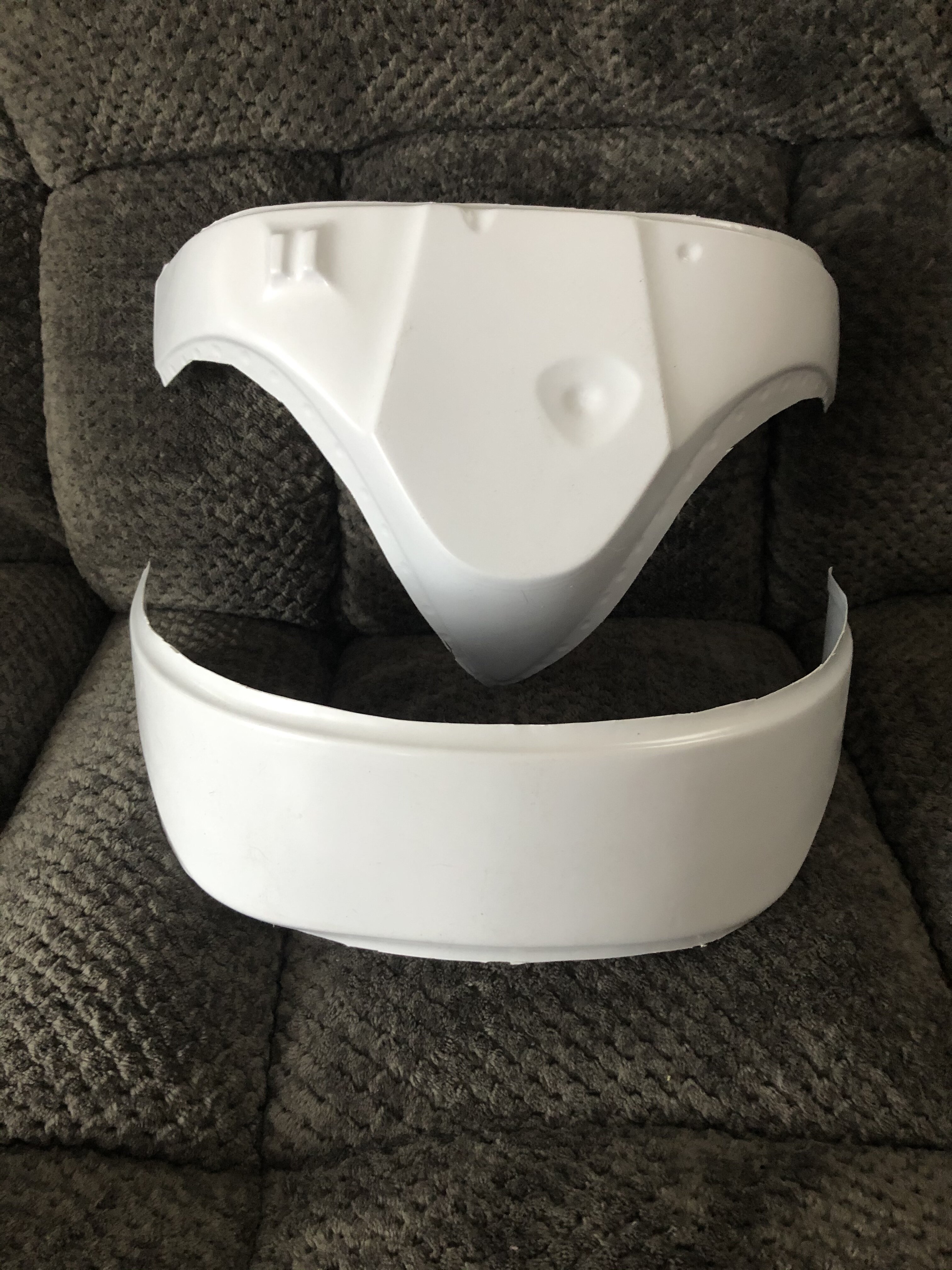

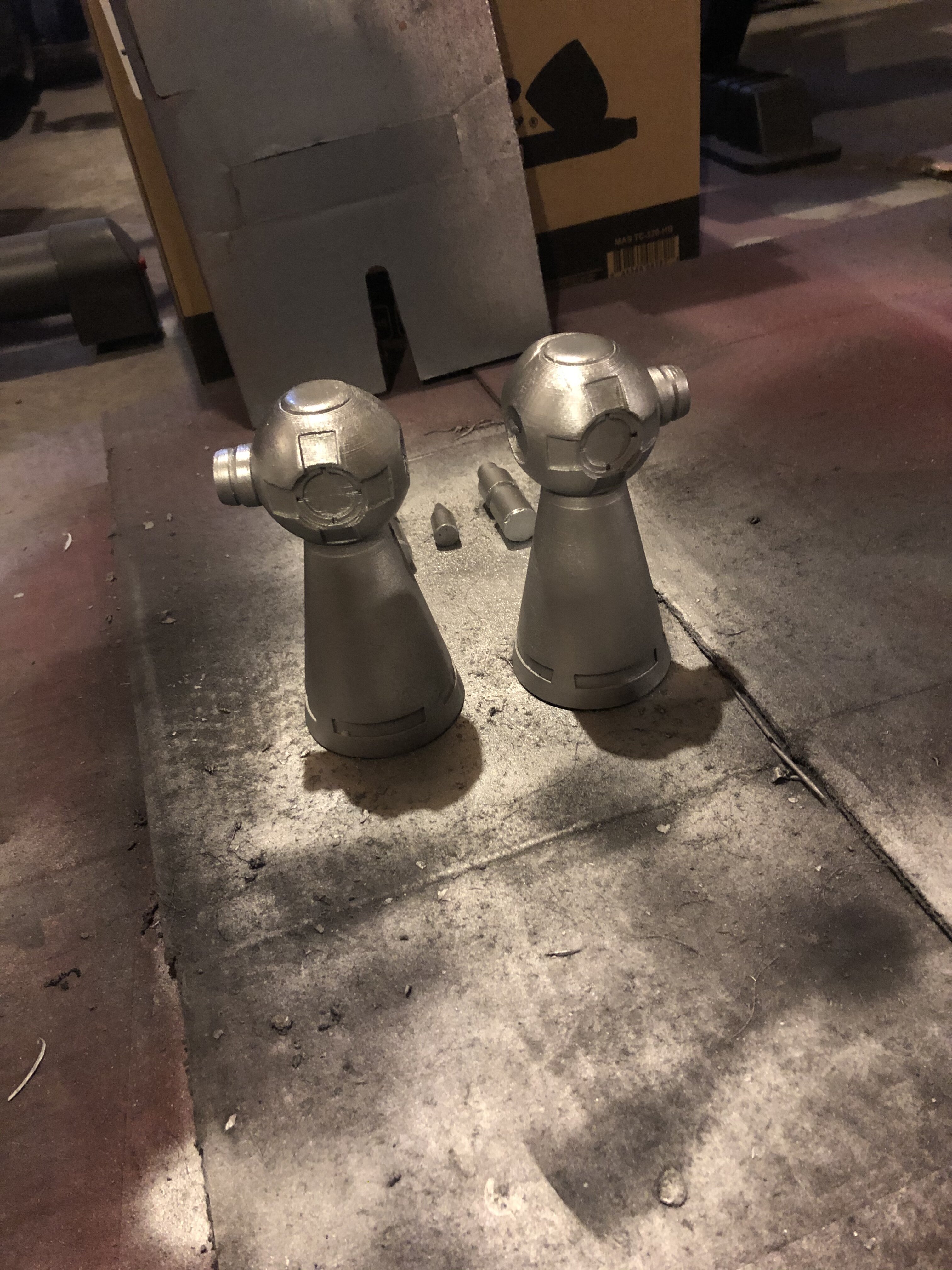

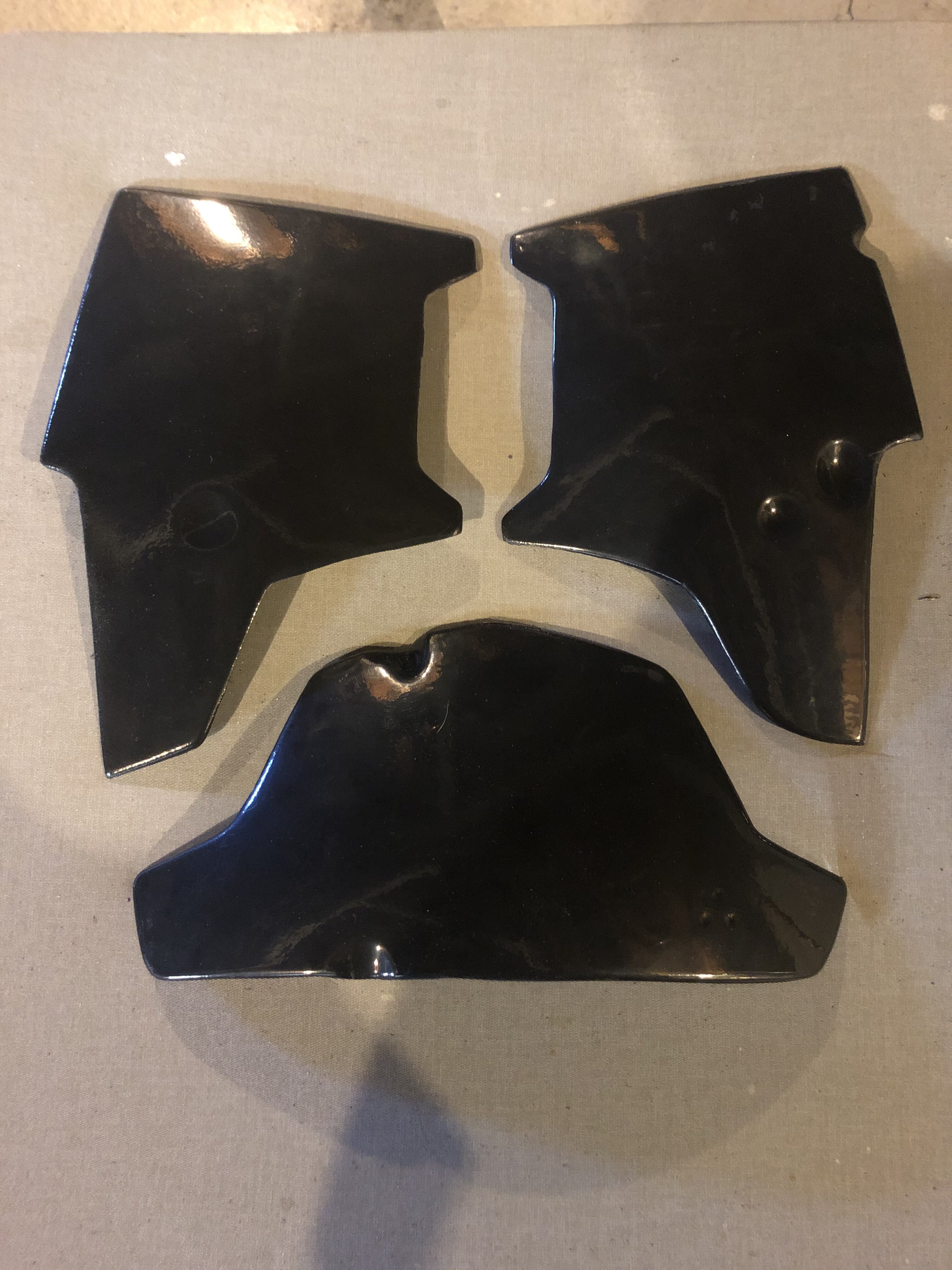

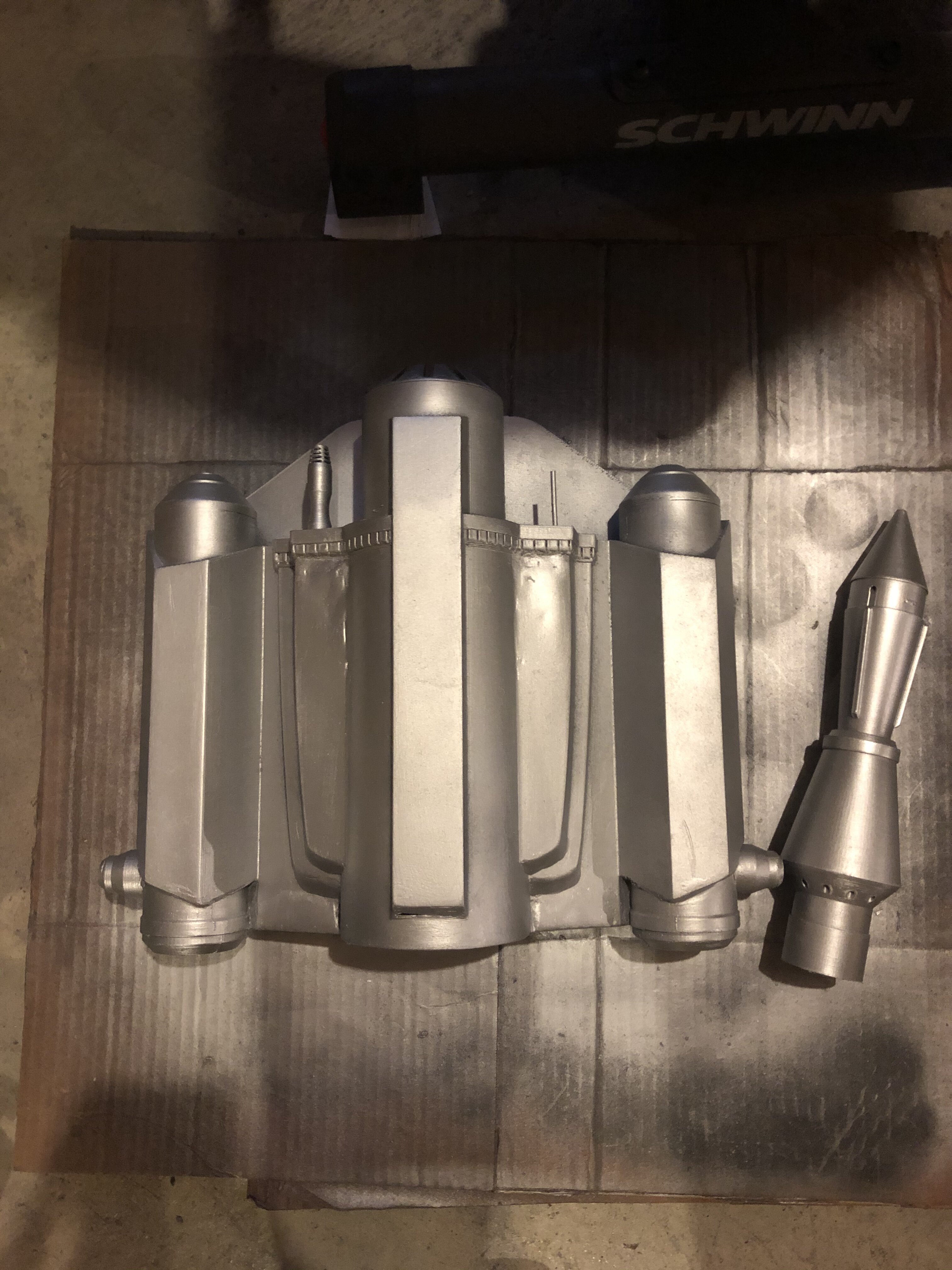

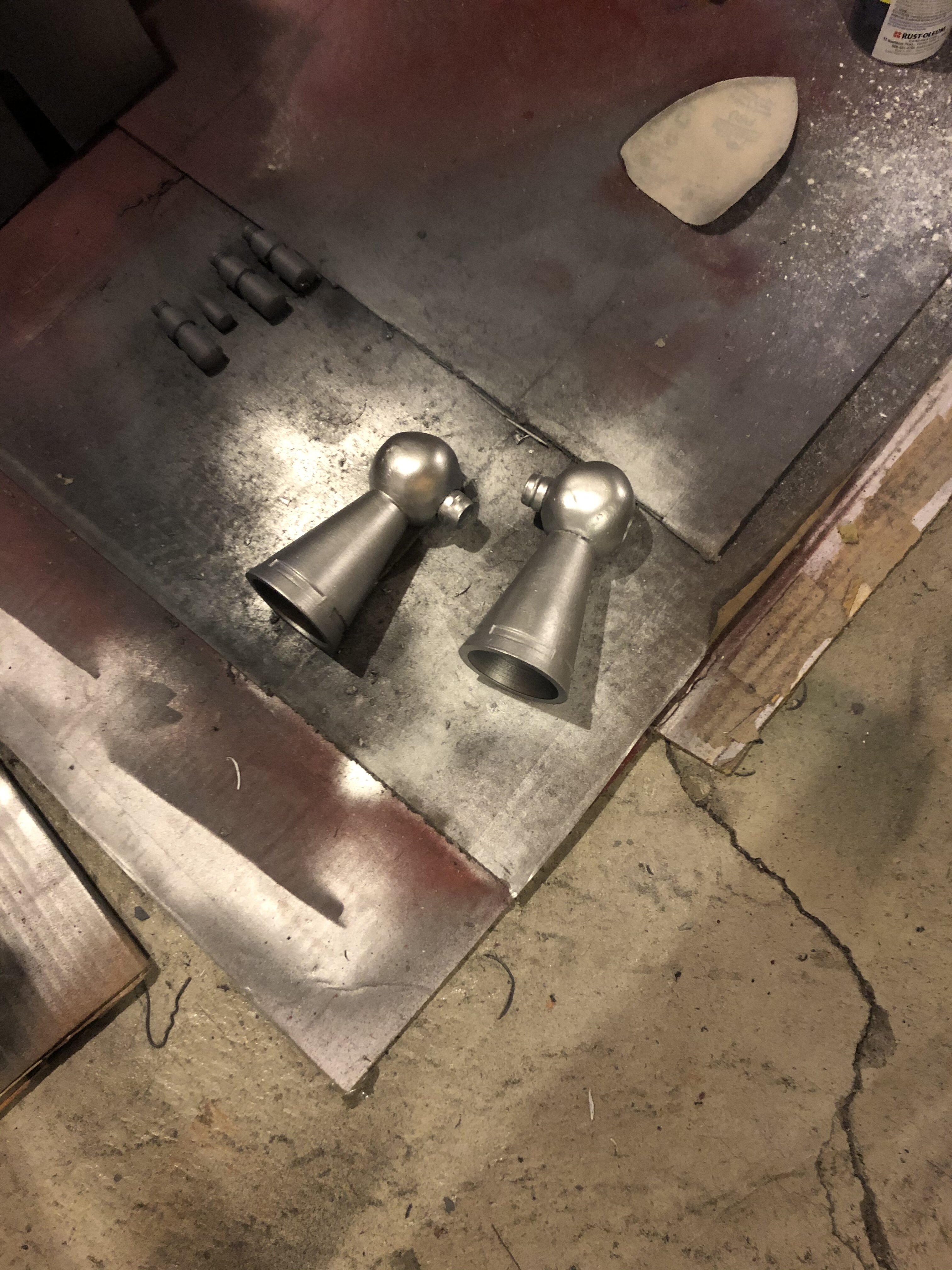

1/13 - Chest and abdomen plates are trimmed! Still have to cut the slots on the left chest plate out still, we will get to that. Also pretty pleased with how the jet pack thrusters turned out with the apoxie. Those are drying from another round of being sanded and primed. Also my hoses have dried from weathering; I lightly misted a mixture of black and brown spray paint to get the desired color. Knee pads are next!

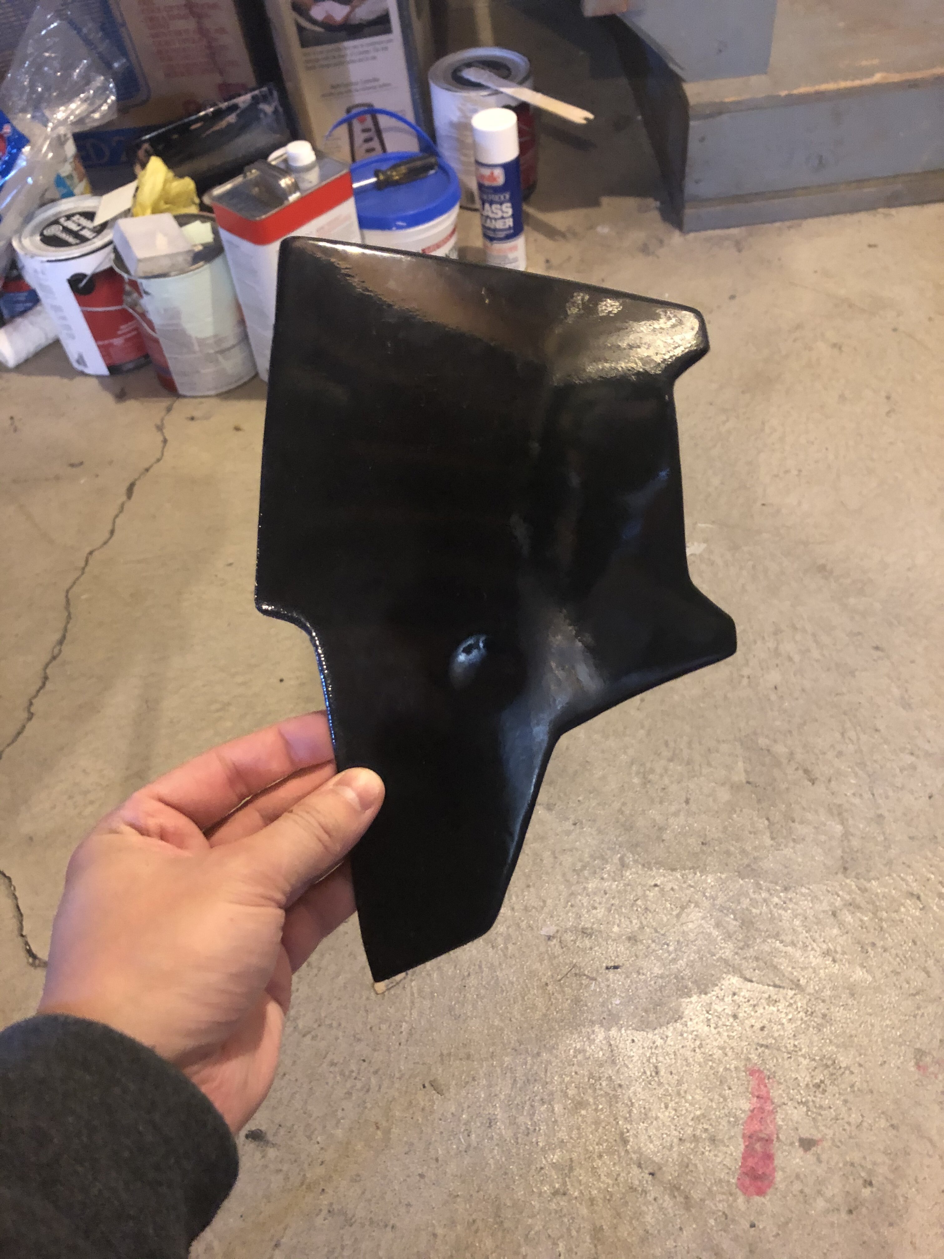

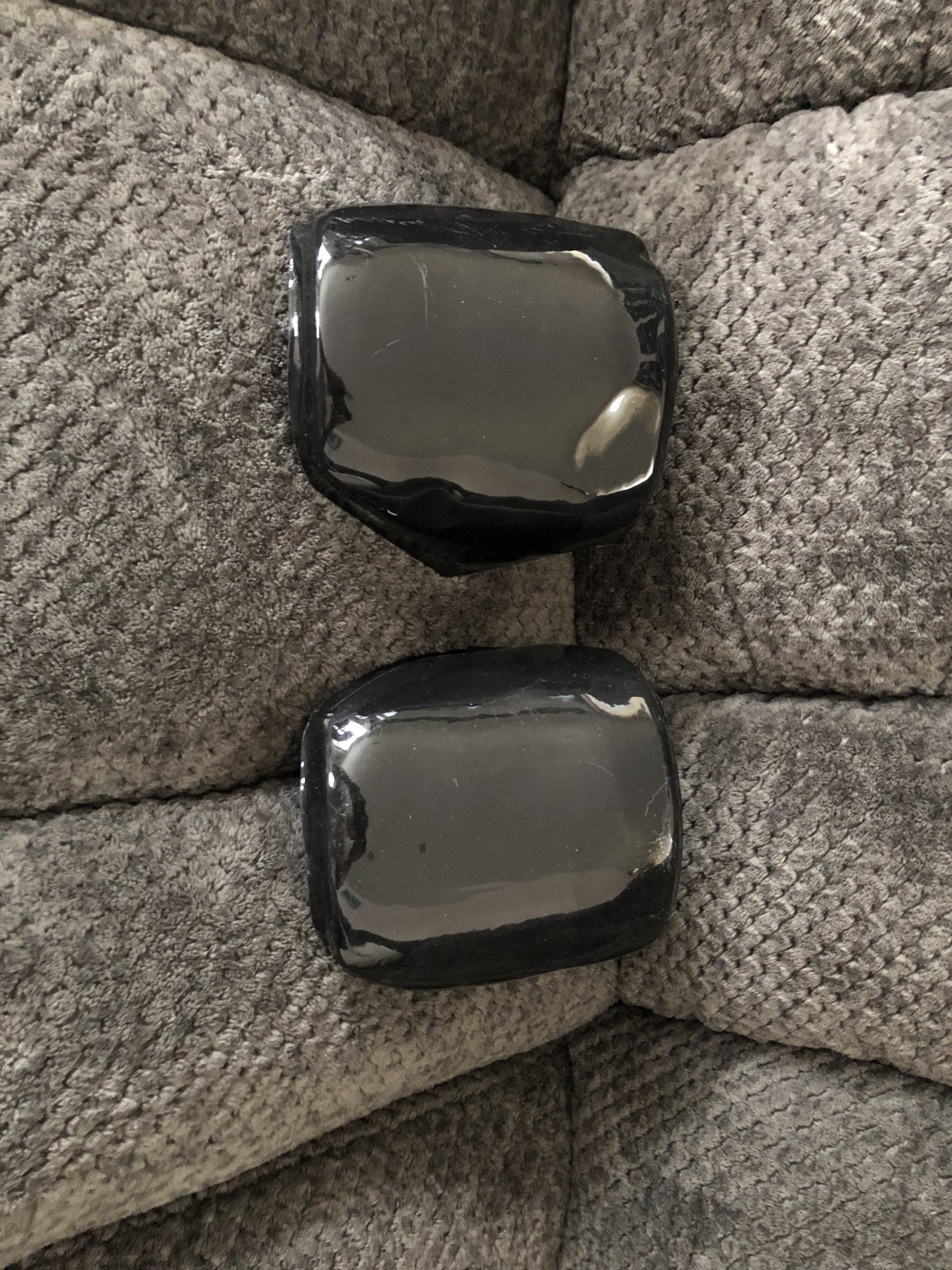

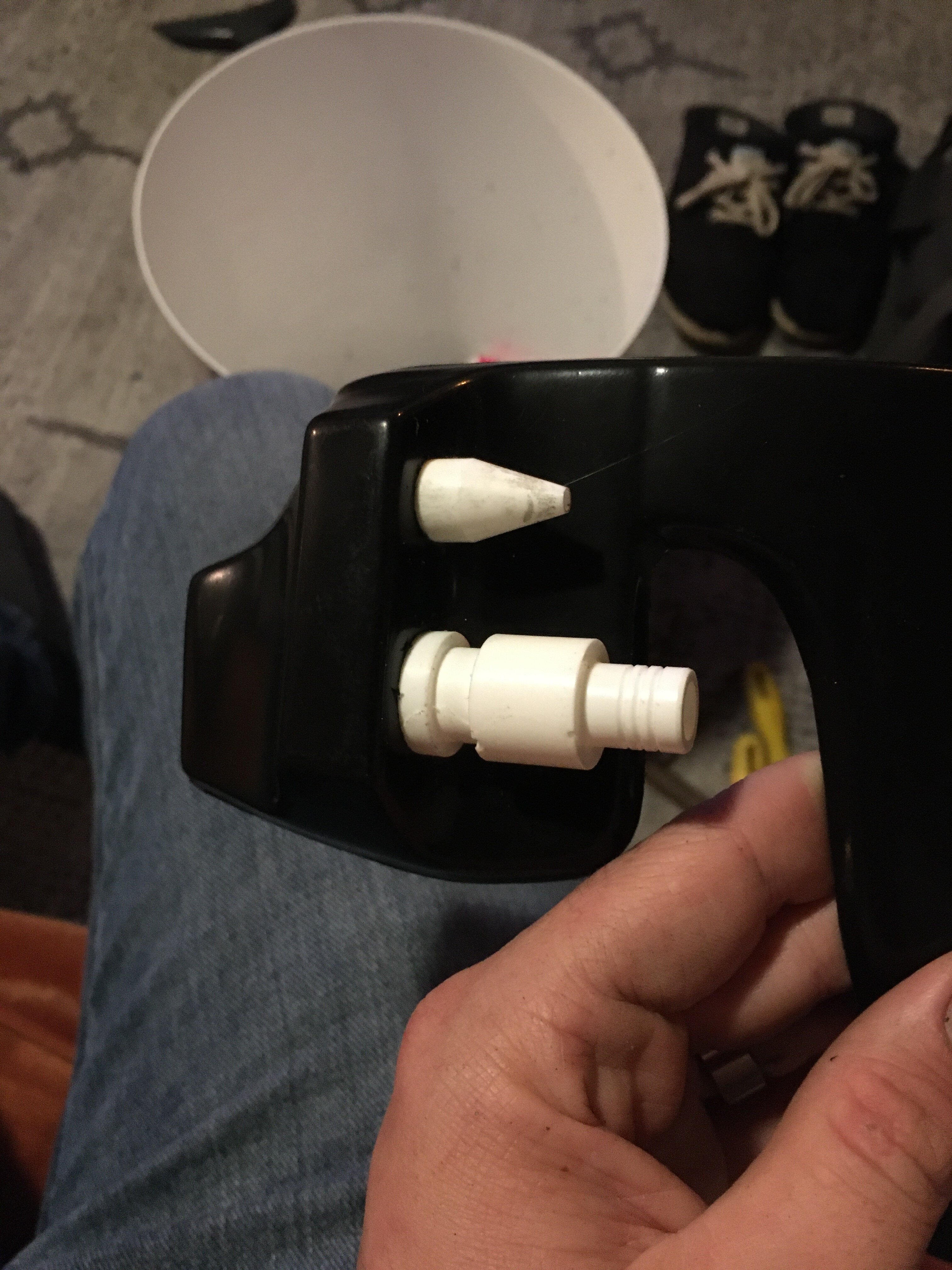

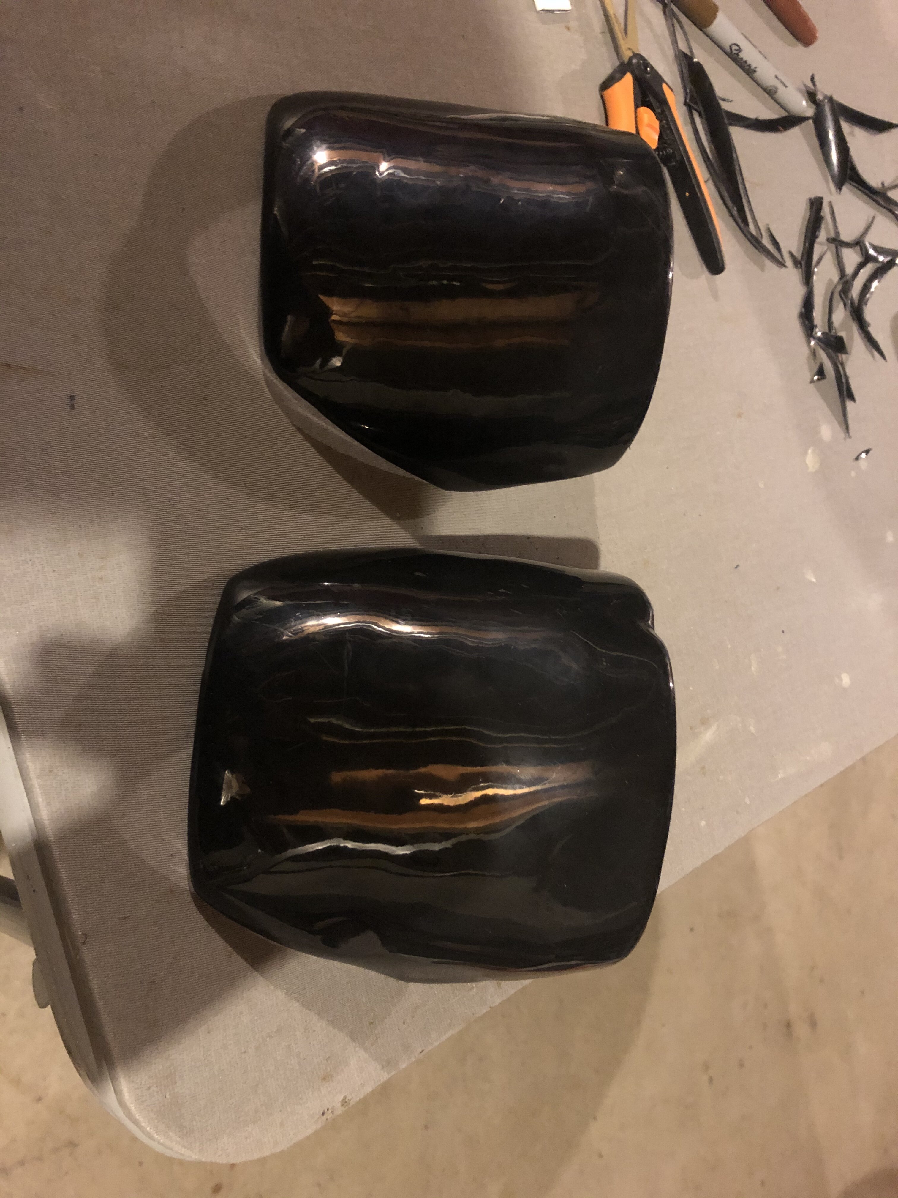

Knee pads are done! Man, what a process it was cutting all that excess plastic. Very pleased with the way everything turned out. I’m going to give the armor a nice bath before starting paint! Also, does anyone have a preferred method for getting the knee darts attached? I’m wondering if drilling holes is the preferred method or just gluing them right on? I feel as if they’re put into a indent or hole, they’ll be more sturdy and less likely to break off.

I got MF armor as well this is how I did the knee armor I drilled a small pilot hole then put the resin block inside of the knee and got a bigger drill bit and cored out the remaining plastic to match the holes and slid the pieces into the knees with the resin block inside the abs plastic armor. I can send more pics if that will help
Ahhhh I see! Thanks for the tip, also a plus that you got MF armor as well so this should work perfectly. Thank you very much, if I need more pics I’ll let you know but I think I should be good for now!

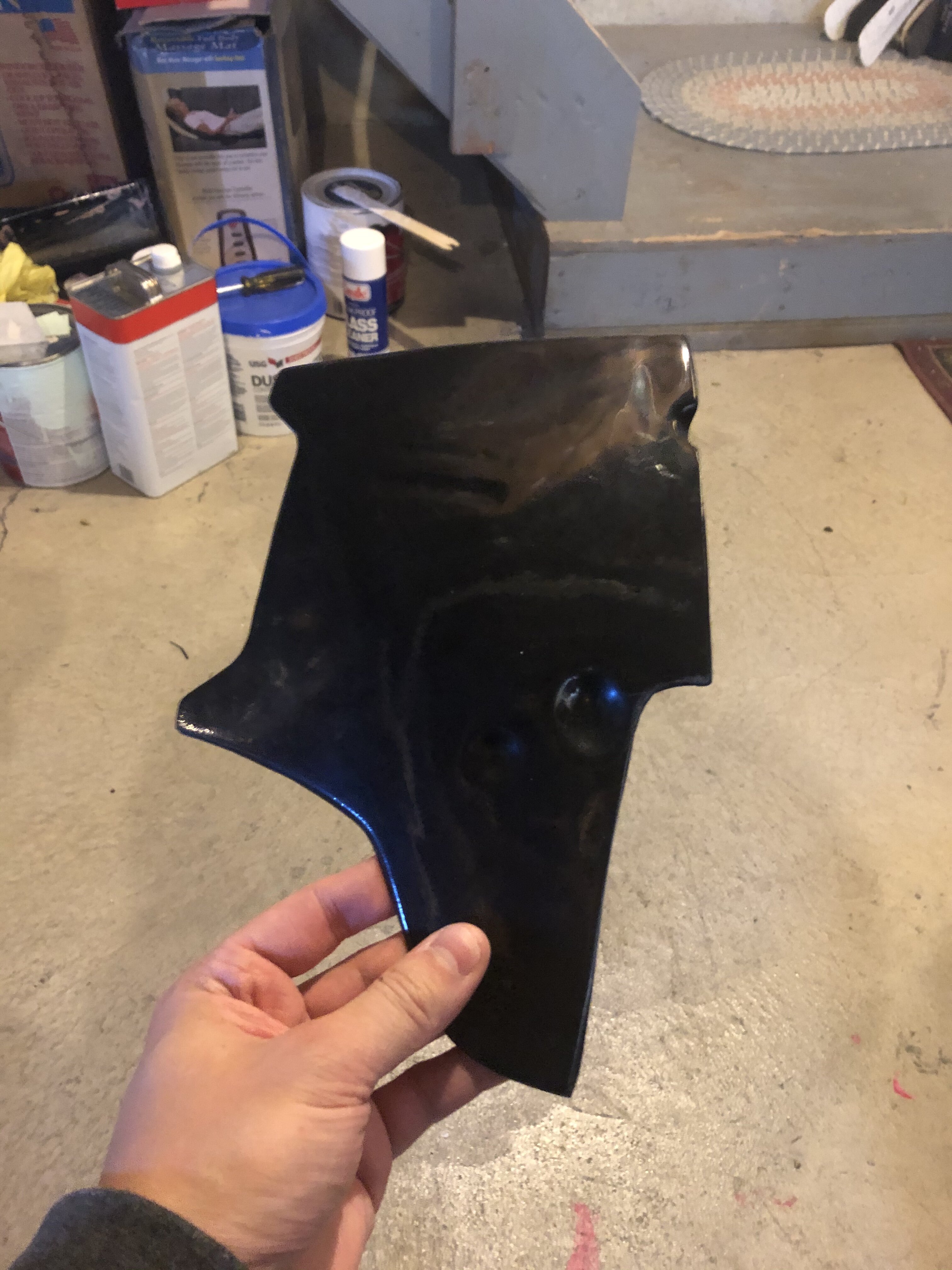

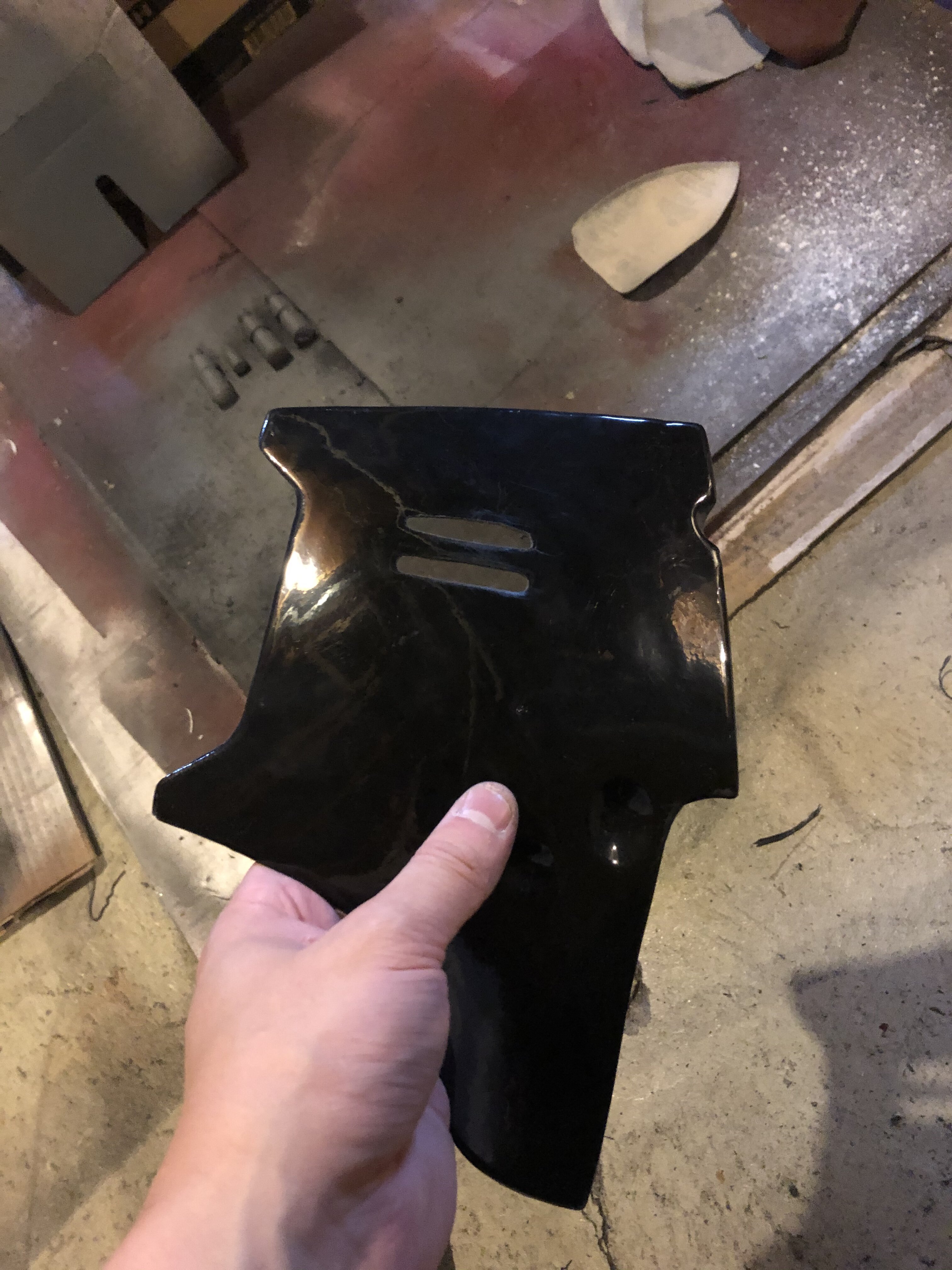

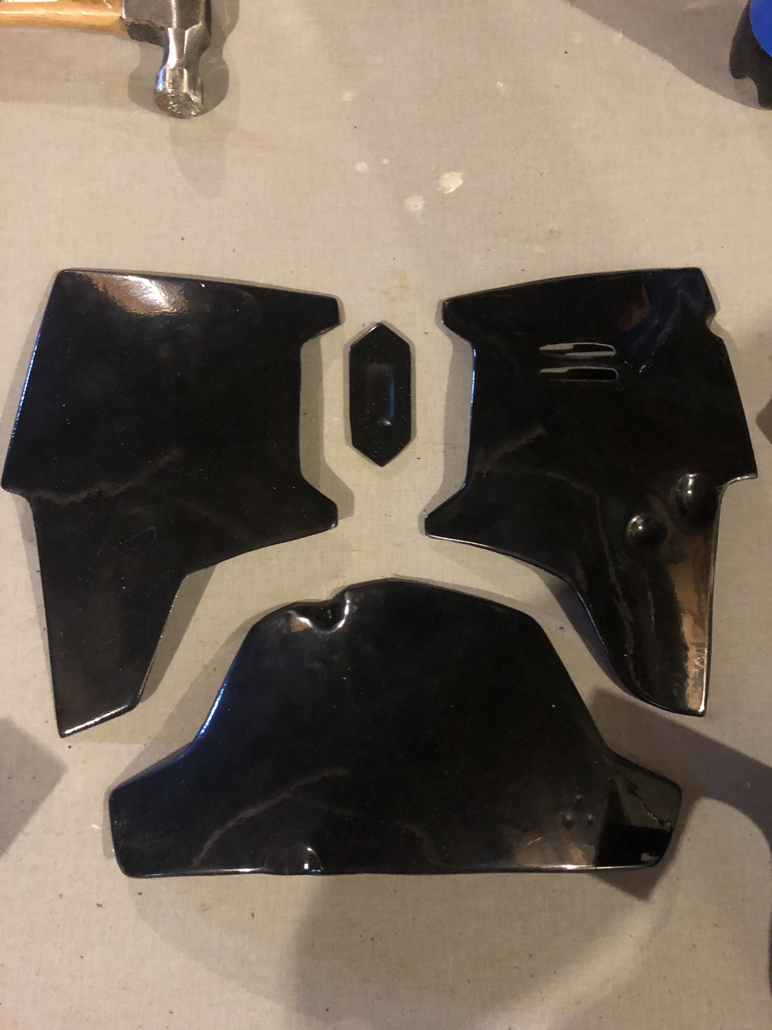

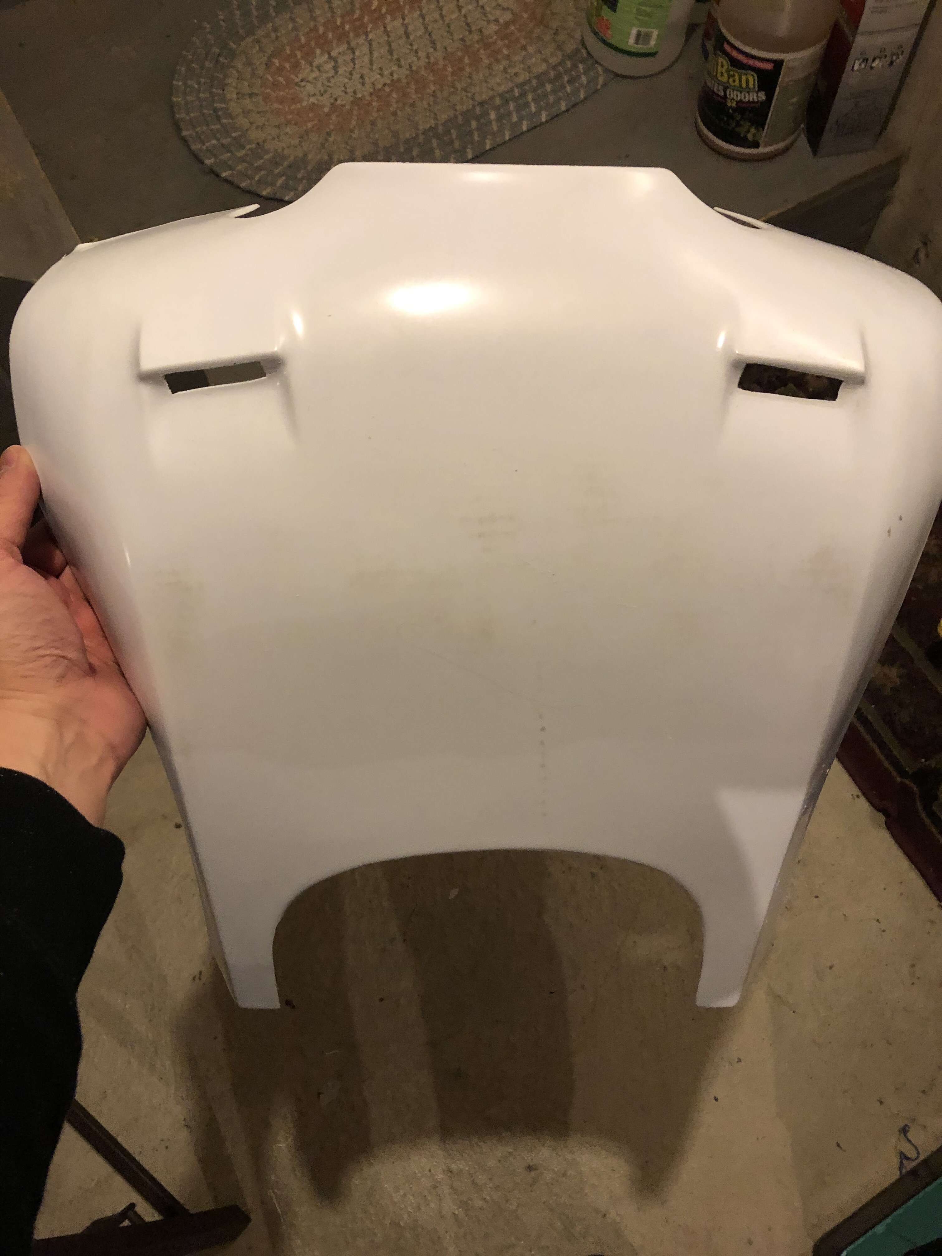

1/16 - I got the slots cut out on the chest plate! Thank you Lazerjock for the tip using the drill. That’s exactly what I did and I think I turned out pretty solid! I also laid down some silver on my jet pack. Also begun the initial holes on the knee pads, I’m using Spicy Fett’s method (not pictured).

I would use a square file to clean up the slots in the chest piece that’s what I used and it worked very well on the ABS plastic that the armor is made of!
I’m gonna try and see if I can clean them up a bit more, do you just use a normal file that you would use on nails LOL sorry if that’s a stupid question! I did use a little bit of sandpaper, tried to get in there as best as I could.
