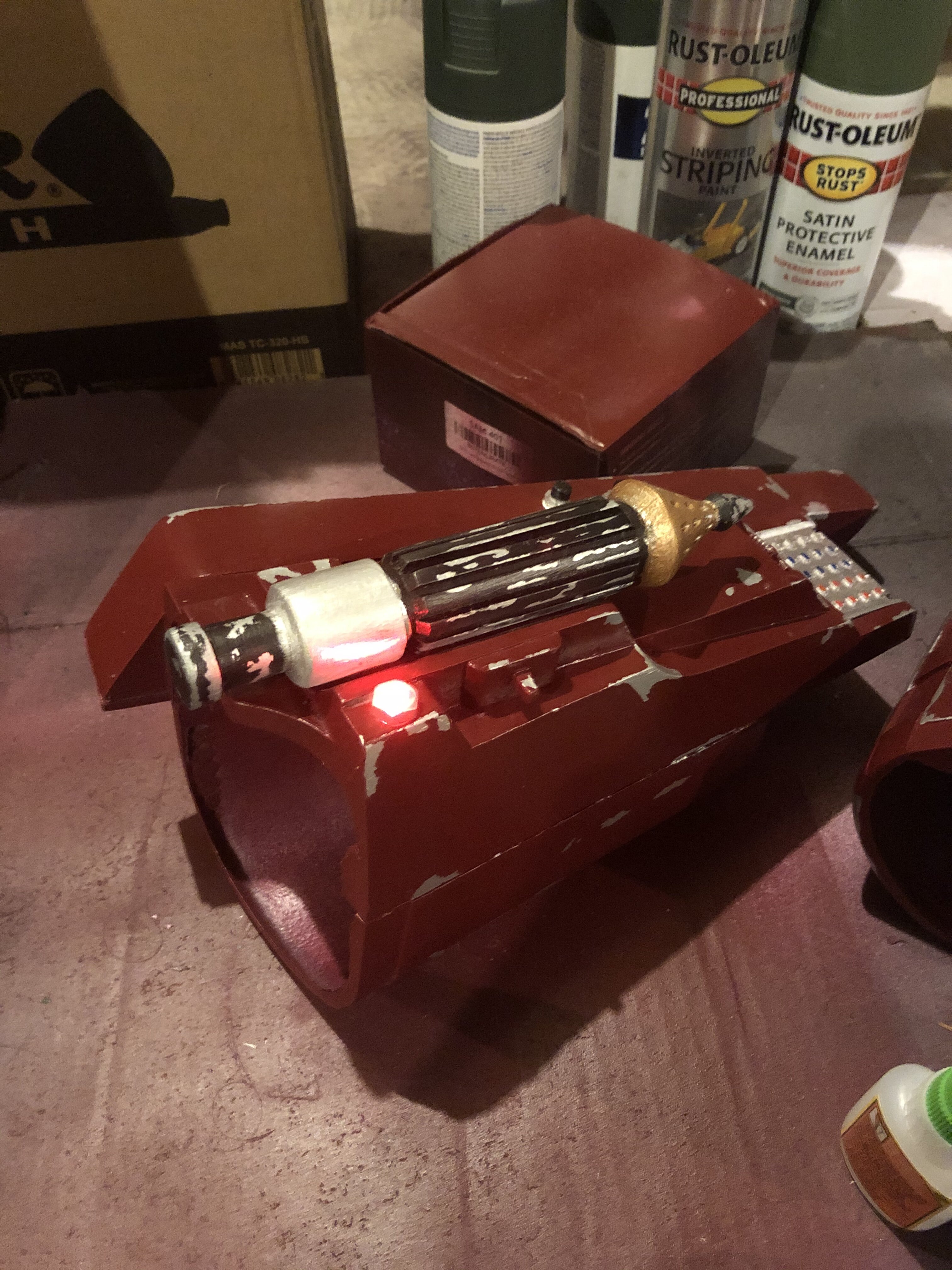

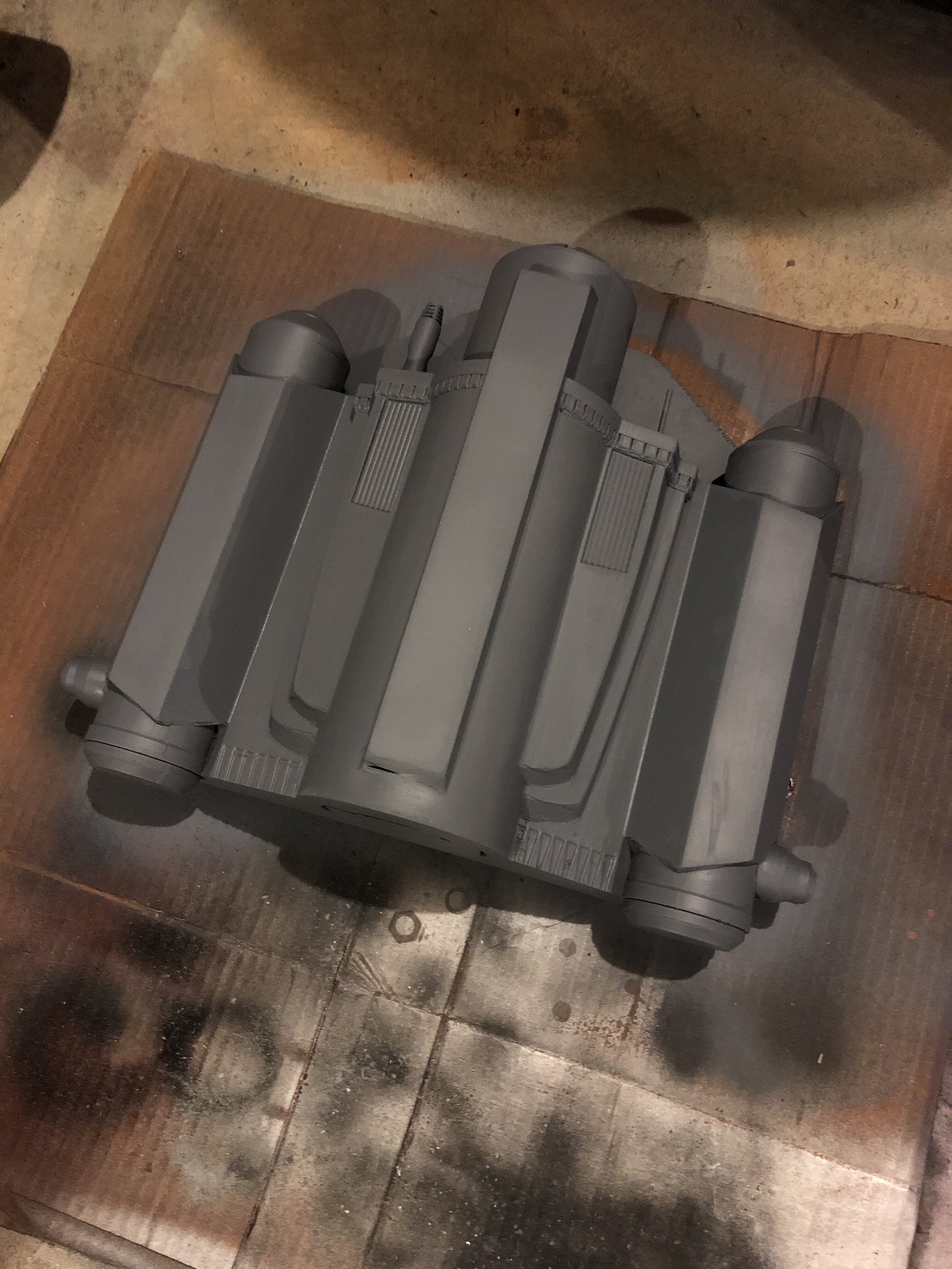

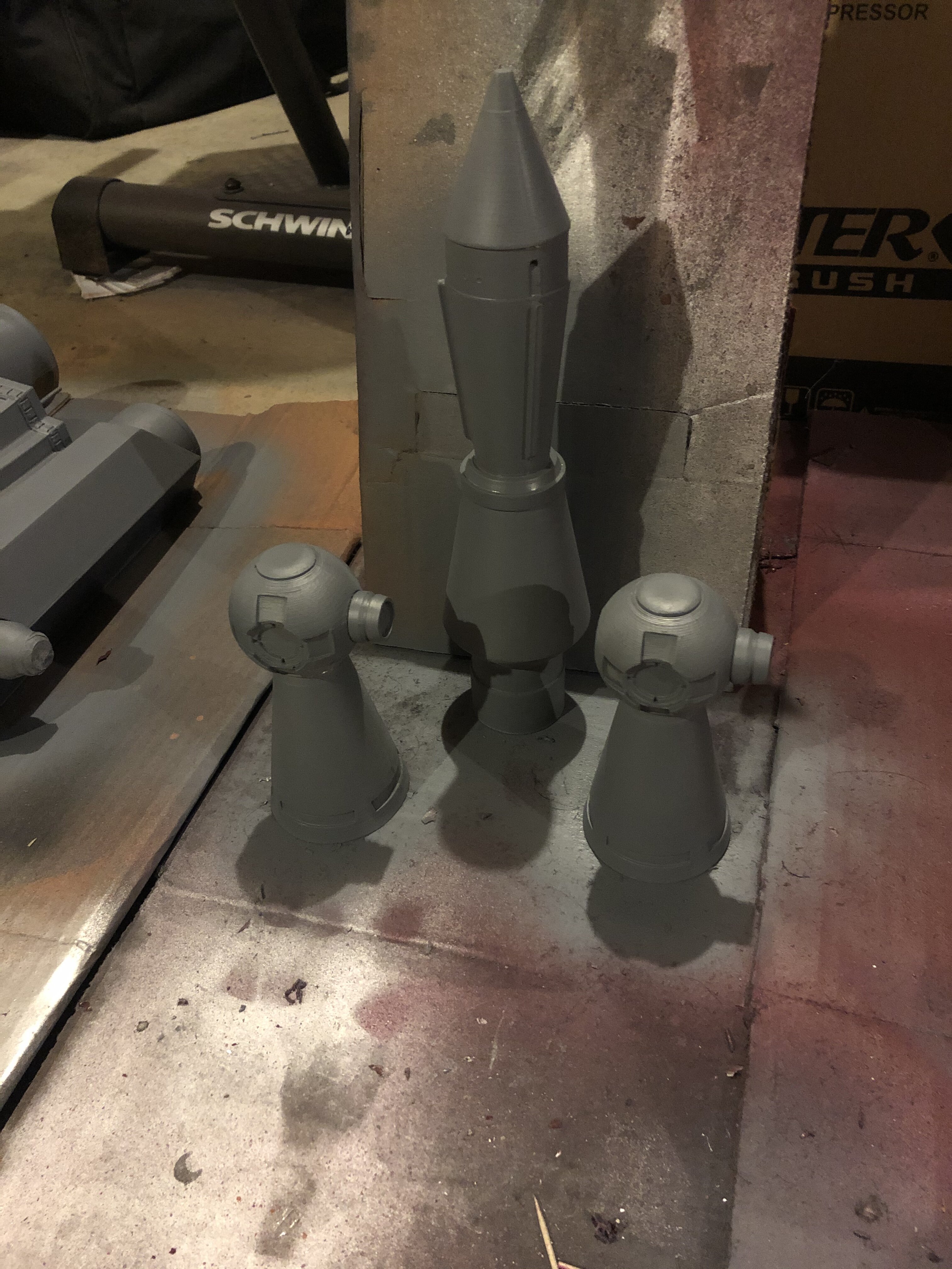

12/15 - another update! I’m starting to redo my jet pack, laid down some primer for tonight. Also got an LED hooked up to my gauntlet! I was told my armor was shipping out today, hoping to get it soon!

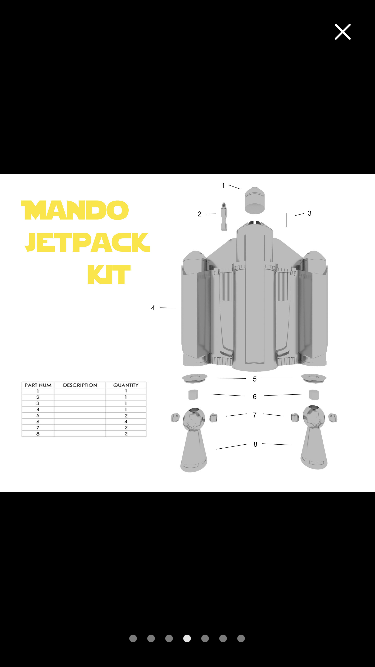

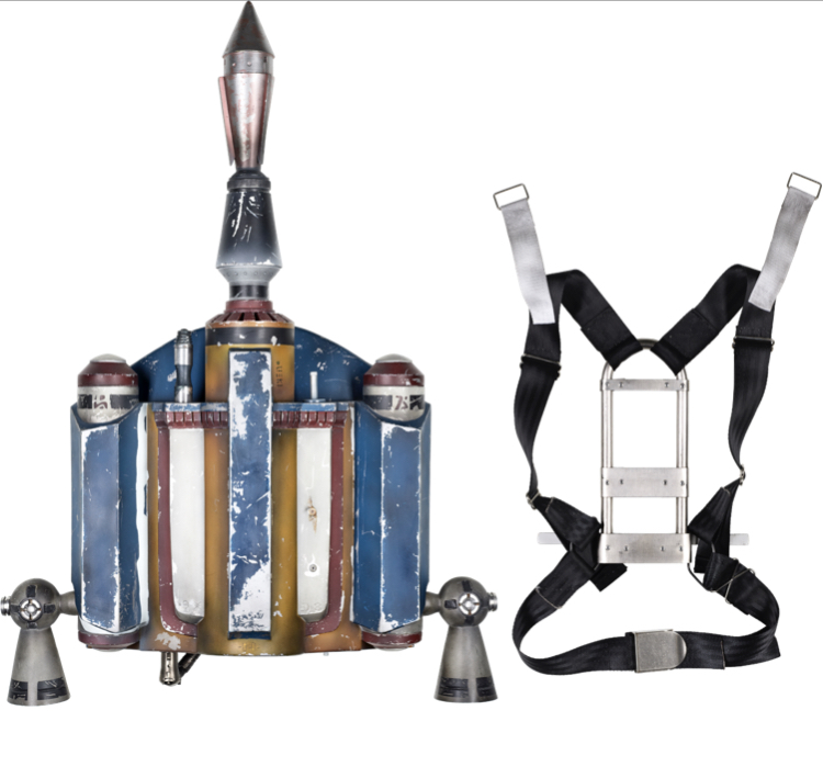

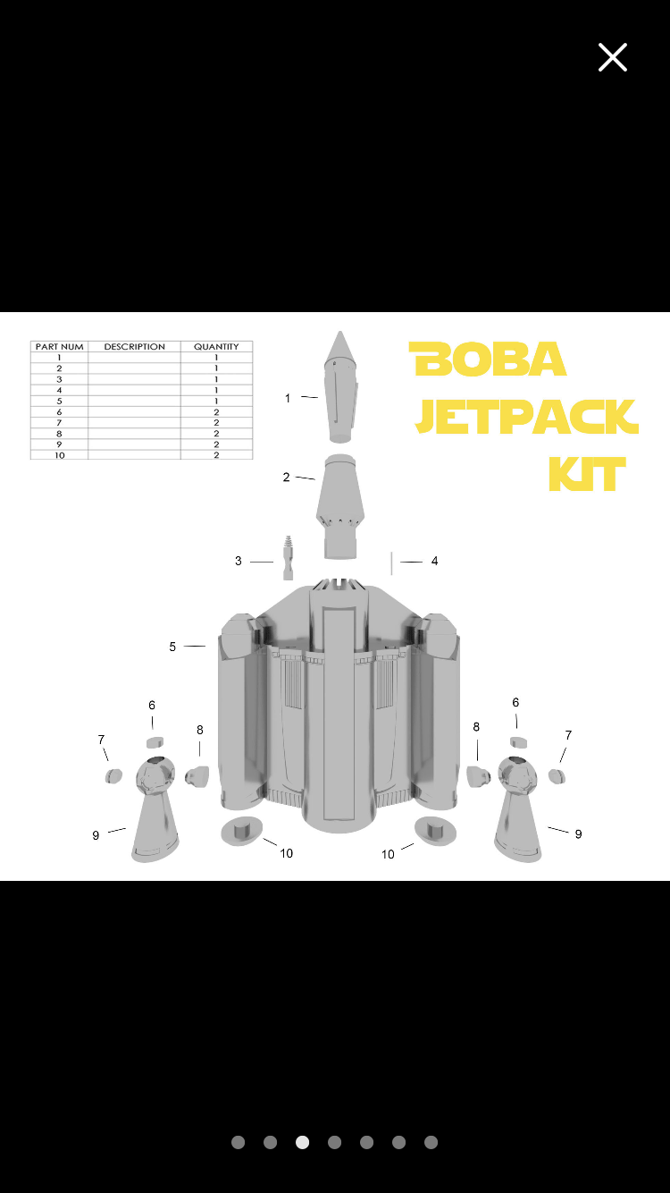

Looking good mjwierzb - wondering what version of Fett you are building? The Jetpack is the Mandolorian pack I believe. Not too familiar with that pack, but the thrusters are IDENTICAL. Are they supposed to be that way with the adjustment knobs on the same side like that...?
Hey! I’m doing the ROTJ Hero! From everything I’ve seen (other costumes on here) this is the right style pack for Boba. The Mandalorian pack looks a tad different, I included some photos to showcase the differences!
