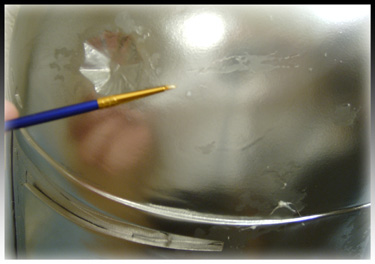

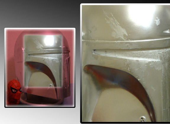

Normally I would draw the the scratches first, but for this I'll just apply it Per the REF PICS with different size paint brushes..I do recommend drawing them on lightly first though.
The fluid does tend to build up on the brush...remove the build up throughout, making sure your brush is pretty clean..This makes each application easier..
The reason I like this stuff is because:
1. It dries fast
2. If you mess up or don't think it looks right then just let it dry and take it right off and reapply.
3. And the detail you can get with this stuff is great.

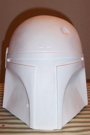

I did A LOT of Sanding ...Different Grades of sand paper......No wet sanding. STILL COULD USE a Little MORE.
Those that own one of these know that the thickness of the MS2 is SO MUCH MORE compared to the MS....
Once I started to see VERY Tiny BUBBLES on the top I knew it was time to stop sanding.....I ended up filling them with Bondo though...
AND if you haven't noticed I moved in the Mandibles in to make the visor not So wide and more parallel......With a Heat GUN, (be careful with that, could distort your Helmet)

Michael's Arts and Craft...Any Craft's store that has a Water Color Section...
I use Winsor & Newton's "Colourless" Masking Fluid...It's been posted somewhere here before..:thumbsup:

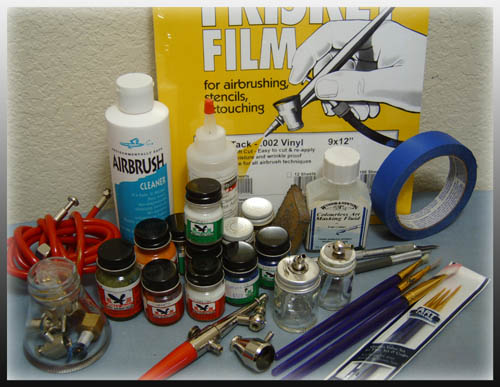

HERE ARE JUST A FEW OF THE THINGS I USE TO PAINT WITH...
INVEST IN A GOOD AIRBRUSH.....Or TWO.

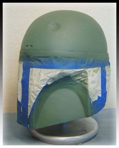

MASKING with a LOW TACK Tape will allow you to tape right over the masking fliud areas...If it lifts off when it's time to remove then you can always reapply....I LOVE this stuff.
I Mask and paint the DOME and under Cheeks first...as every one seems to do.
I like to use NEWS PRINT to help mask...It bends really easy.
I use Panzer Olive Green right out of the Bottle for the 1st Coat...a little Acrylic thinner if it's too thick.
I apply only 2 to 3 SOLID coats ..Waiting at least 20-30 minutes between coats.
The Panzer Green Color tends to dry DARK.....This is a Good thing because we will then spray a "MIST" of Panzer Green and Ital. C GR MIX. This gives it that "light look" in some areas per the Reference Photos..
The MIST of this mix should not be thick, and Spraying should be a good distance away and low pressure on your Air Brush..a well lighted room will enable you to see the application.
