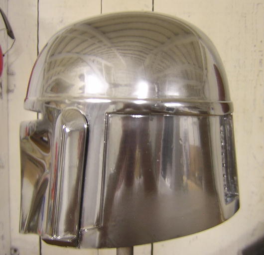

It's actually fiberglass painted with an automotive product called Mirrachrome from Alsa Corp. The paint is a little on the expensive side. I was thinking about painting my car with it and decided to test it on something smaller to make sure that it actually looks like real chrome. So far I think it does the trick.
The helmet I may end up putting on Ebay when I've finished it. That's where I got it from and the paint job it came with left something to desire. Also, it looks like whoever did the recast had a poorly made mother mold since the back of the helmet is a little on the misshapen side.
The other trick is before it can be sprayed with Mirrachrome, the helmet needs a flawless, glass-like black finish. This stuff shows every single mistake you make in fairing, priming, or painting. It's a little more noticeable in this photo from behind where I didn't quite buff the bottom edge to a perfect gloss before the chrome paint.
