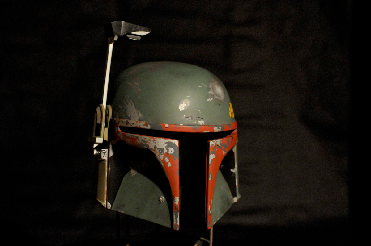

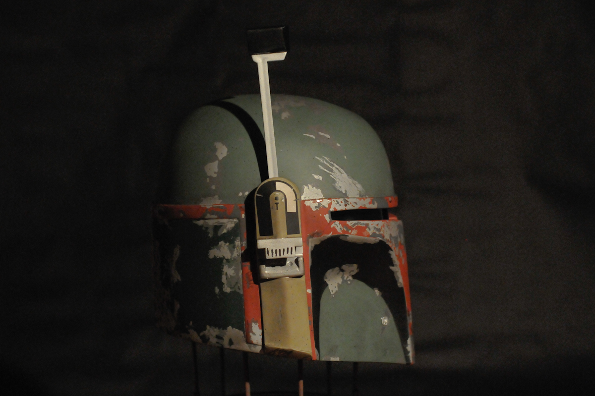

About a year ago, I decided I'd try to improve it and see what would happen if I put some effort into it. I started with the helmet, as I figured anything I did would be an improvement on the stock paint job. That's when I began surfing around the internet and I came across this site.

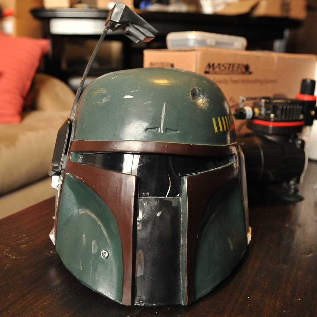

Here's what I was starting with:
The first order of business was cutting out the "visor" area. I tried using a Dremel, but I found it awkward and not very precise (my skill may have had something to do it). I ended up just using a sharp utility knife. The edges were much more clean. The trick was making the inside edge of the mandibles even. By inside edge, I mean the edge that faces inside the helmet and what the visor will eventually attach to. I didn't really get my head around that before starting out, which would have helped.
I subsequently ordered a visor from tvisor.com.
I think this is the single biggest improvement that can be made to this helmet. A full and proper visor looks way better. This isn't to say that there isn't a ton of other improvements to made, but it just looks "right" with a real visor.

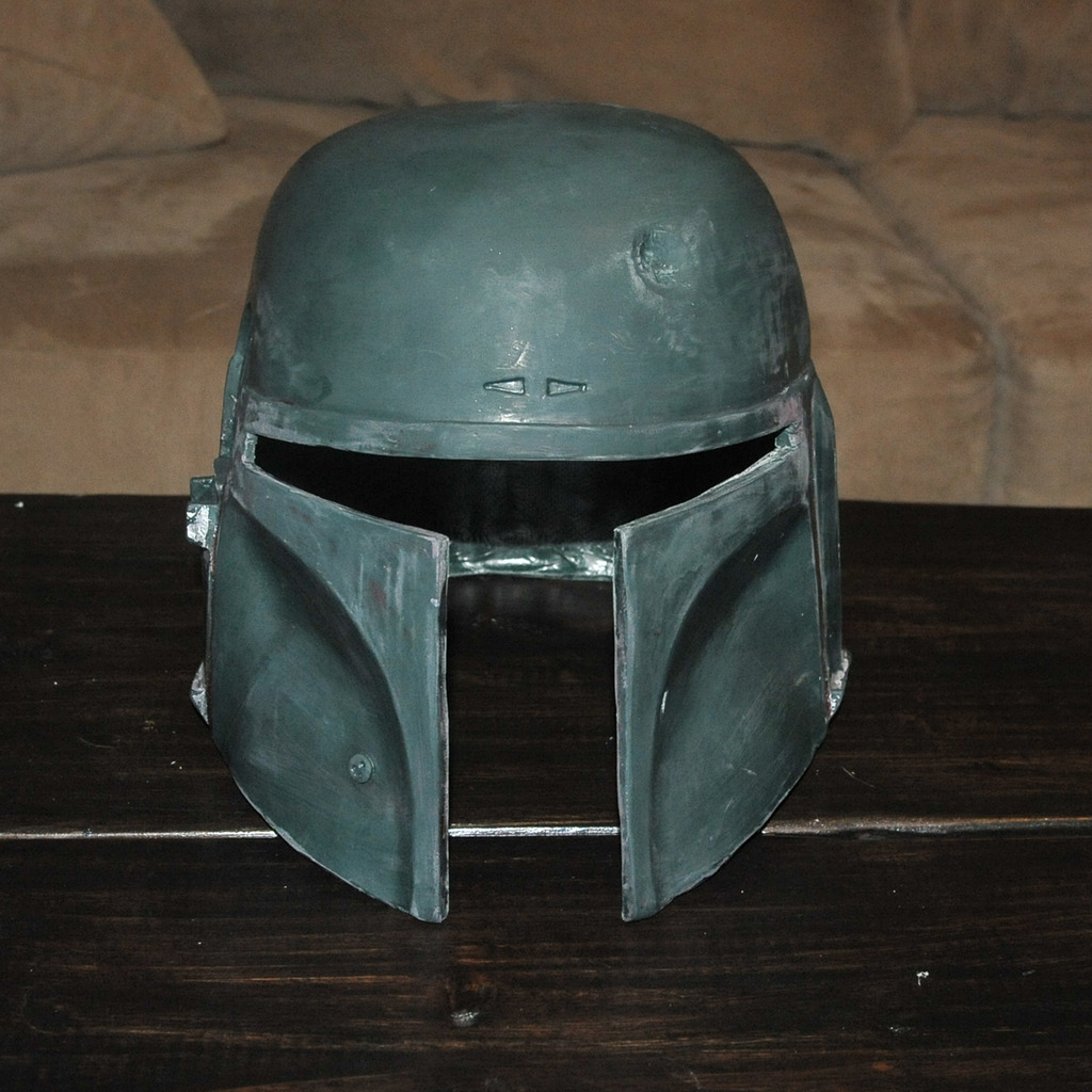

I used acetone to remove most the silver paint and some of the green and red paint. I could have removed it all, but I wasn't a big fan of handling the acetone and I don't think it made much of difference in the end (thankfully). After thoroughly cleaning the helmet, I applied Rustoleum grey primer.
It already looked much better :D.

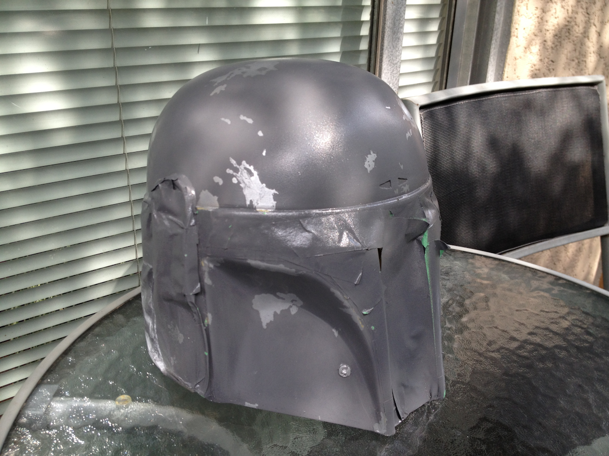

I started with the back panels and applied Testors Chrome spray paint, I used RafalFett's templates with reverse tracing paper to mark out the layer, applied liquid mask and then applied the next layer of spray paint (grey). I would peel off the liquid masking fluid, repeat the process and apply the Hunt Club Green. WelshWarrior explains this process well in his videos.
[/ATTACH]Helmet -12.jpgHelmet -13.jpgHelmet -14.jpg

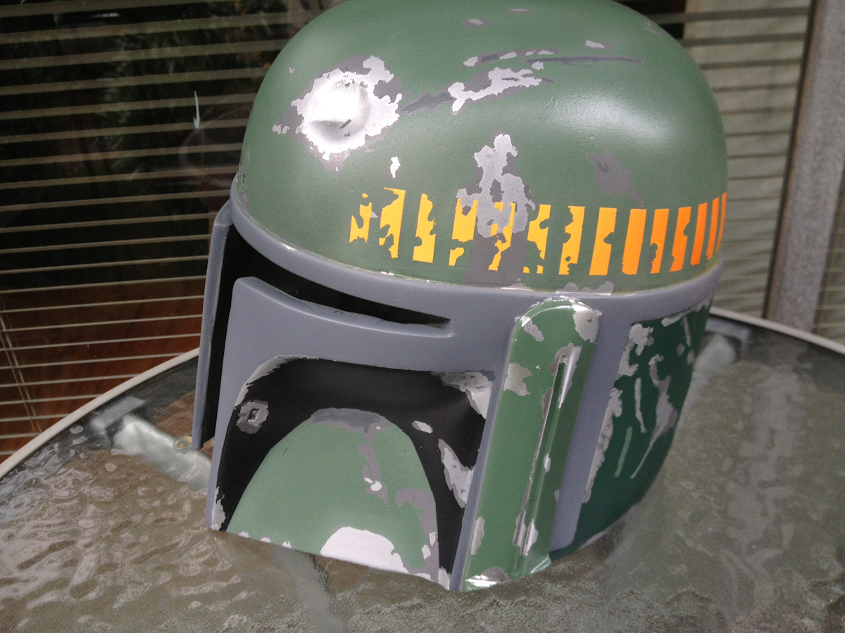

I painted the right ear with Krylon Ultra-Flat Khaki, taped off the kill stripes and used Rustoleum Yellow Inverted Striping Paint with misting Rustoleum orange for them. I painted the left ear with the same Spruce Green as the the dome.

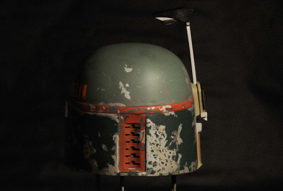

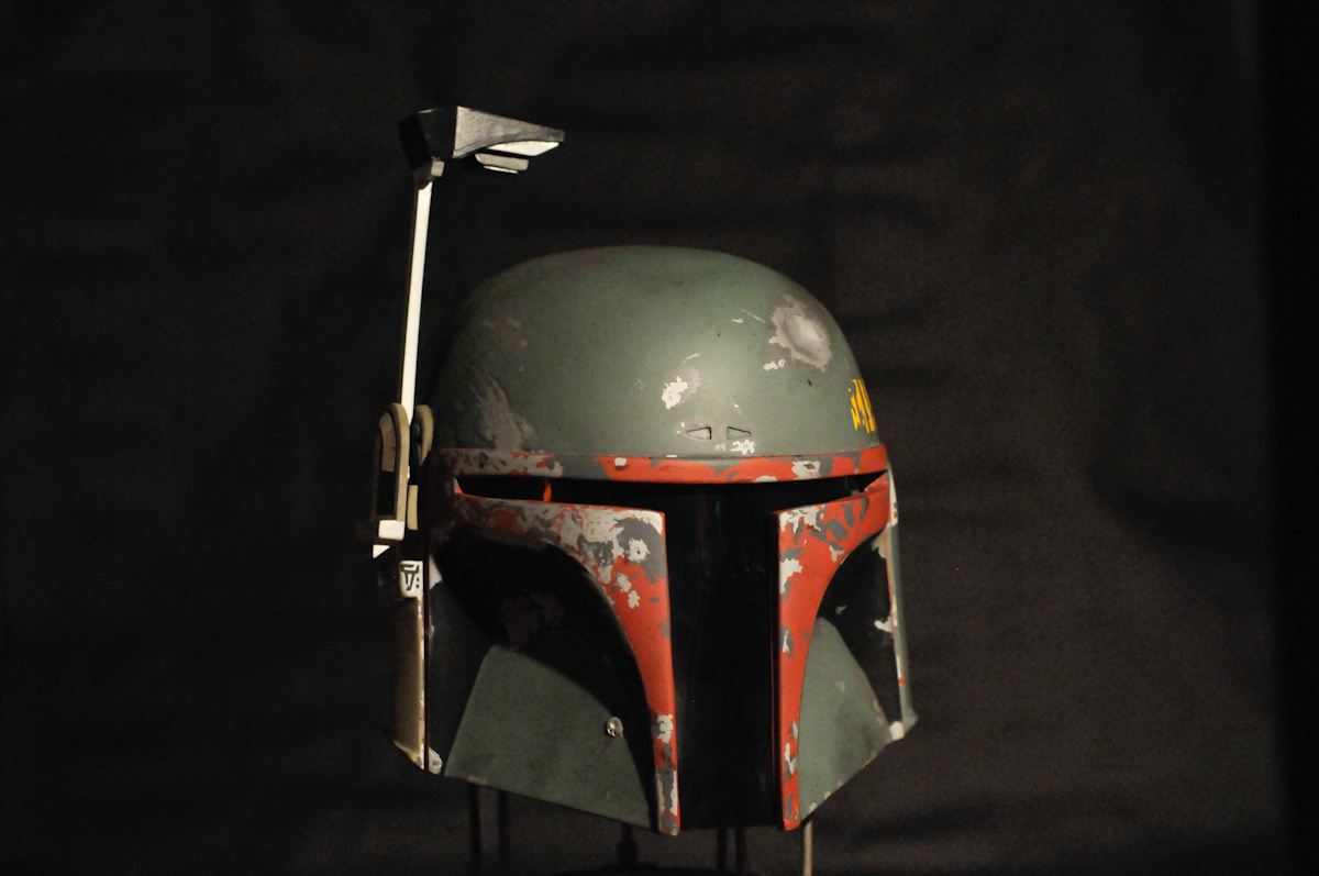

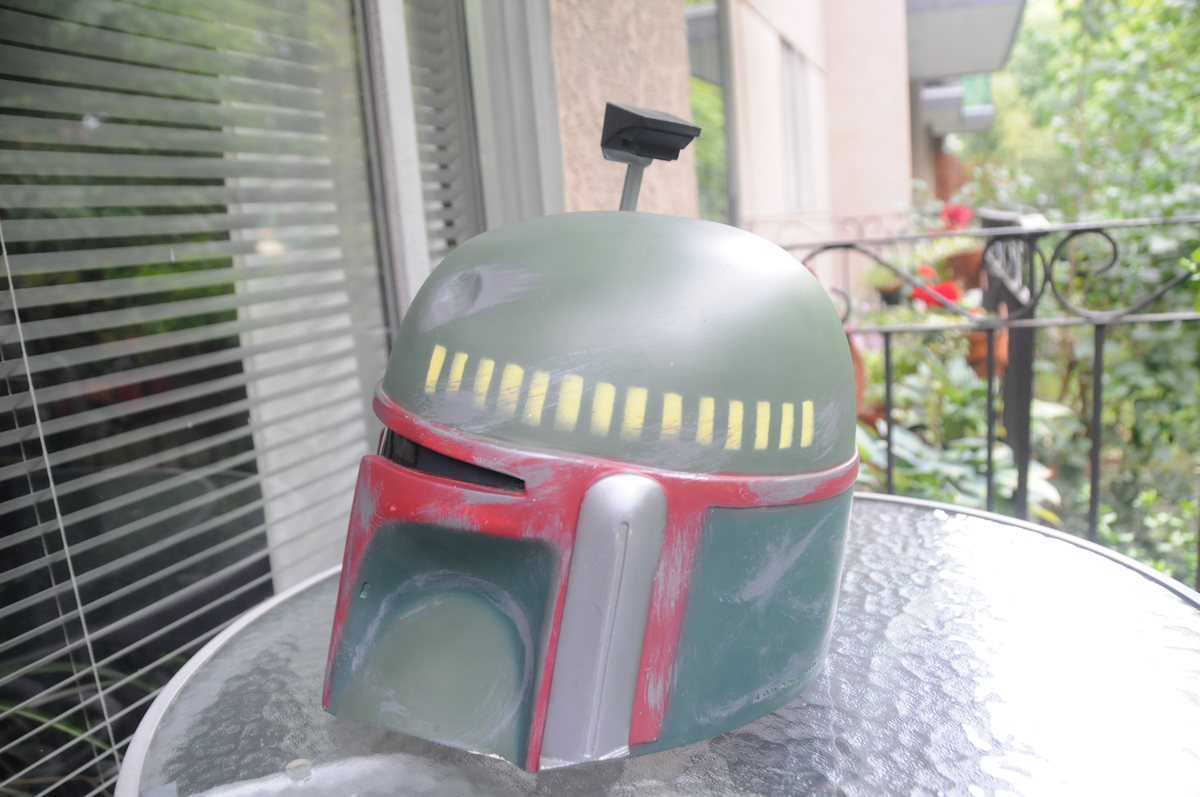

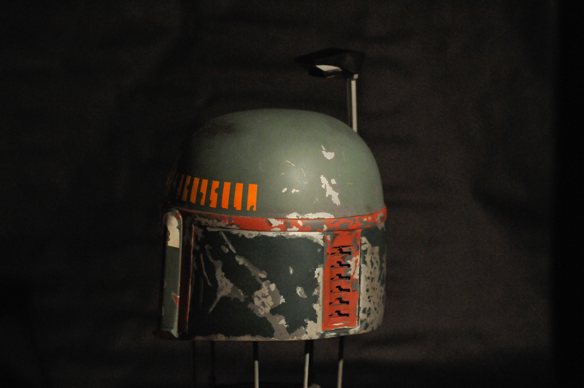

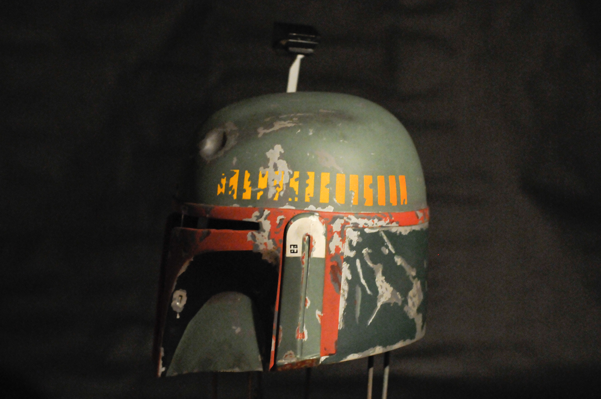

As promised, here are some pics of the finished product.
I'm pretty darn happy with the result. It's not 100% accurate, but it's a big improvement on the stock DP 95.
I used ultra flat black spray paint and ground up pastels to dirty it up and finished it off with Testors Dullcote.
I like how it knocked down the shine and gave it a nice finish.
Helmet -1.jpgHelmet -2.jpgHelmet -3.jpgHelmet -4.jpgHelmet -5.jpgHelmet -6.jpg
Feedback is welcome, but be gentle :)

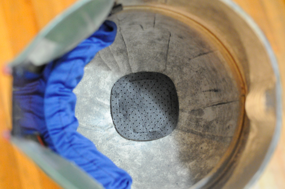

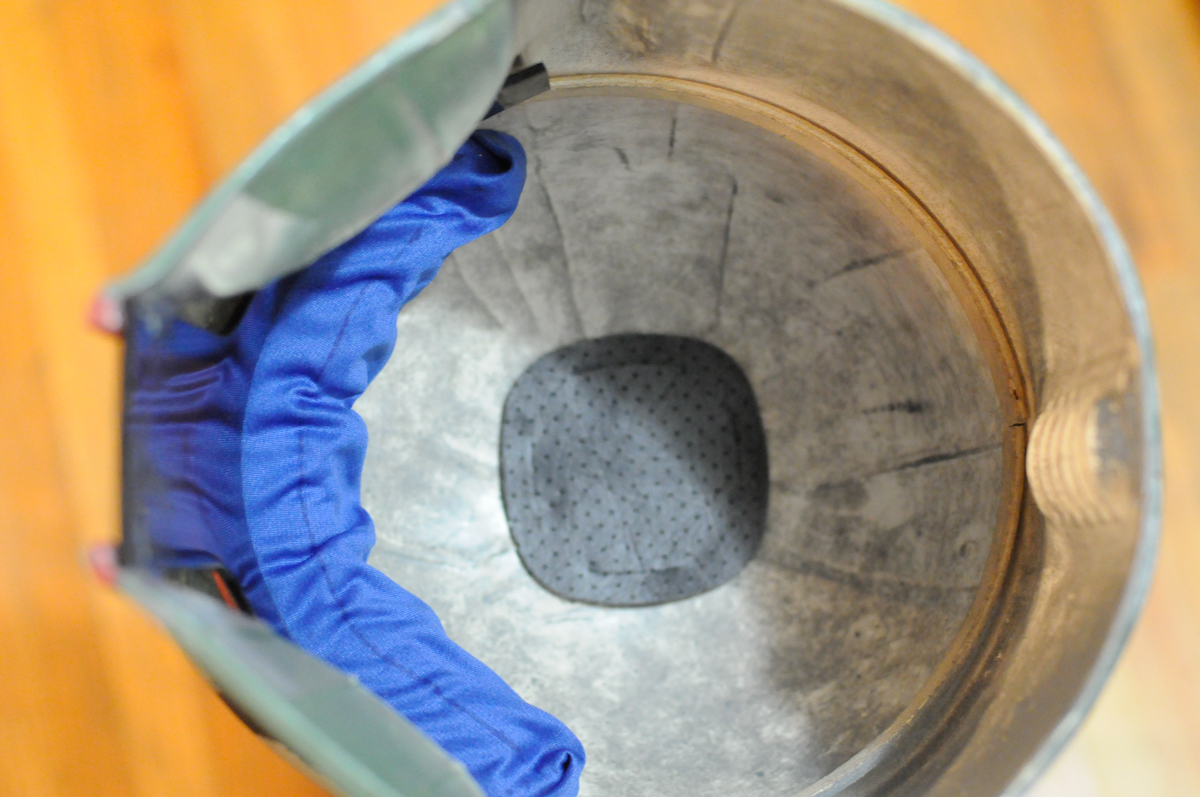

This was the experience I needed before my Boba Maker armour arrived. I have plans to replace this one day, but it will be a long time before I finish the costume and get to point where I'm upgrading.
One thing I didn't expect was that the new visor made the helmet a bit smaller on the inside. I found my nose was up against the visor when I first put it on. To fix this, I covered a strip of foam with moisture wicking material and velcroed it to the front above the visor. It works well and is comfortable. It changed the angle enough to get my nose off the visor, but it doesn't look askew.

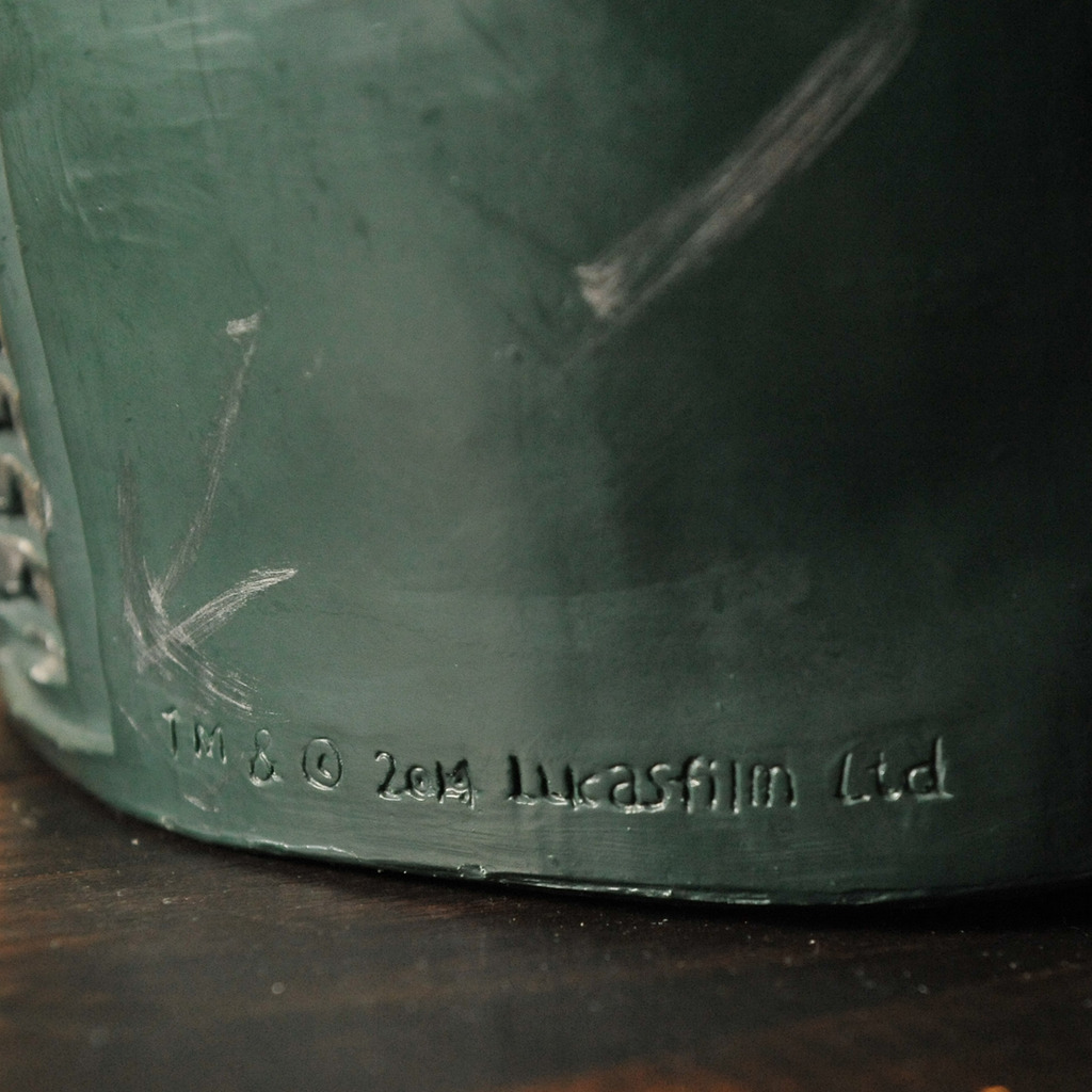

After I acetone washed it:
It had the same Lucas imprint, which I bondo like you suggested:

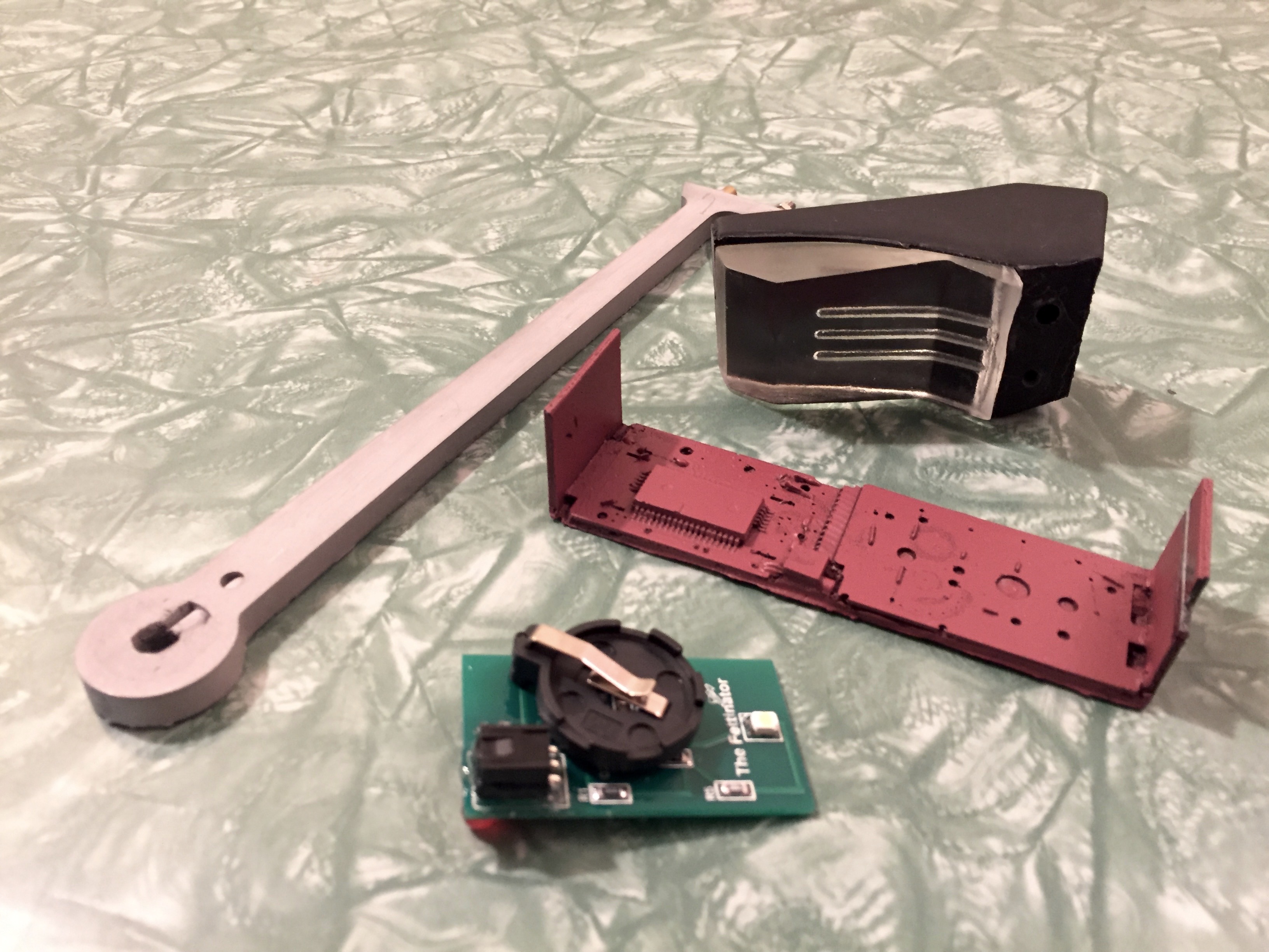

After a pretty big break from my Boba after Star Wars Celebration, I resumed work a little while ago.
It's probably time to finish my helmet and build, and my goal is to have it done by The Force Awakens on Dec. 17 (I just got tickets to the 7 pm showing on Dec. 17 instead of having to wait for a midnight showing on Dec. 18, wohoo)
I picked up cast MQ-1 Circuit Board from Darth Vorhees that I painted, as well as a cold cast stalk and RF topper from Anime Fan. I also picked up one of the self contained LED light kits from. Jc27.
I cut out the slots in the back of the helmet and attached the painted circuitboard with E-6000, which is my new favourite adhesive. Please note that I had to trim the "tabs" that Darth Vorhees includes with his cast circuitboard so that it sits closer to the cut out slots.
I'll post more pics soon, but I wanted to get this up while I had the time.
