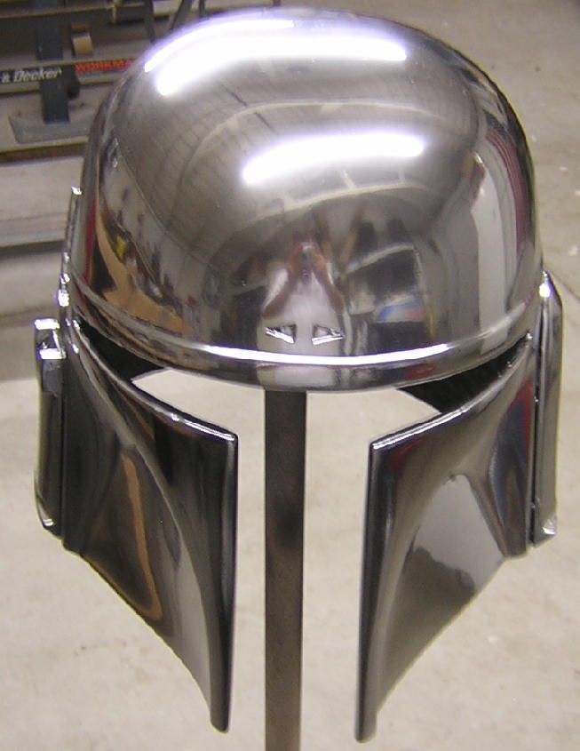

I was not a big fan of the rub'nbuff so I used this Alclad paint!
Also the Blues are not of the "American Classics" variety, but hand mixed and matched to a ref. photo I have. I left a formula for the color in BKBT's "helmet build up" post!;)
For the Alclad II info go to www.alclad2.com or should be available at your local hobby store where RC cars/planes can be had! It is expensive for what you get ,but comes in a variety of "metal" finishes and is also available by bottle ( for airbrush) or spray Can (for those without airbrushes!).
You Can Clear Coat it ,however this does Dull it down some!
I'll have more info for you guys here later this afternoon! thanks much for the comps.;)

Mirax H,
Depends on what you mean by scratch!
For weathering: it works ouyt pretty good as I took a Scotchbrite pad to put in the "brushed" alluminum look and depending on how heavy you want to weather, the harder you should scrub.
If you mean resiliance: It is a thin paint! By nature it is of an almost water/thinner consistancy, however applied in several coats on top of a GOOD High Gloss Black Base it handles very well! I would'nt toss it across the stones or nothing like that of course unless you intended to Top coat it first!;) Then again would we do that anyway?LOL
Hope this answers you question!?LMK
sincerely, shunned/BH-8899
Shunned, dude you need to send those pictures to Alclads site...That looks more impressive than the ones they have! Sweet looking bucket!
Yup, sure does. What about water- does it ruin it at all like if it got water drops on it or something like that? It really looks beautiful. Wondering if this would be do-able for armor- I love how it has the brushed aluminum look with the scotchbrite. Awesome work.

Water is not a problem Mirax-H. I've got caught in the rain before for very brief periods of time and have not had any problems! All my armor is painted with this same paint!:) More Pics coming as soon as I can grab some!

I'm not sure if you mentioned it, but is it alcad chrome or (polished) alluminum?

im seriously debating on painting my armor and helmet in the alclad II as well.
wasp,
shunned mentioned in another post that he used the chrome but im interested in seeing how the polished aluminum might look too.
