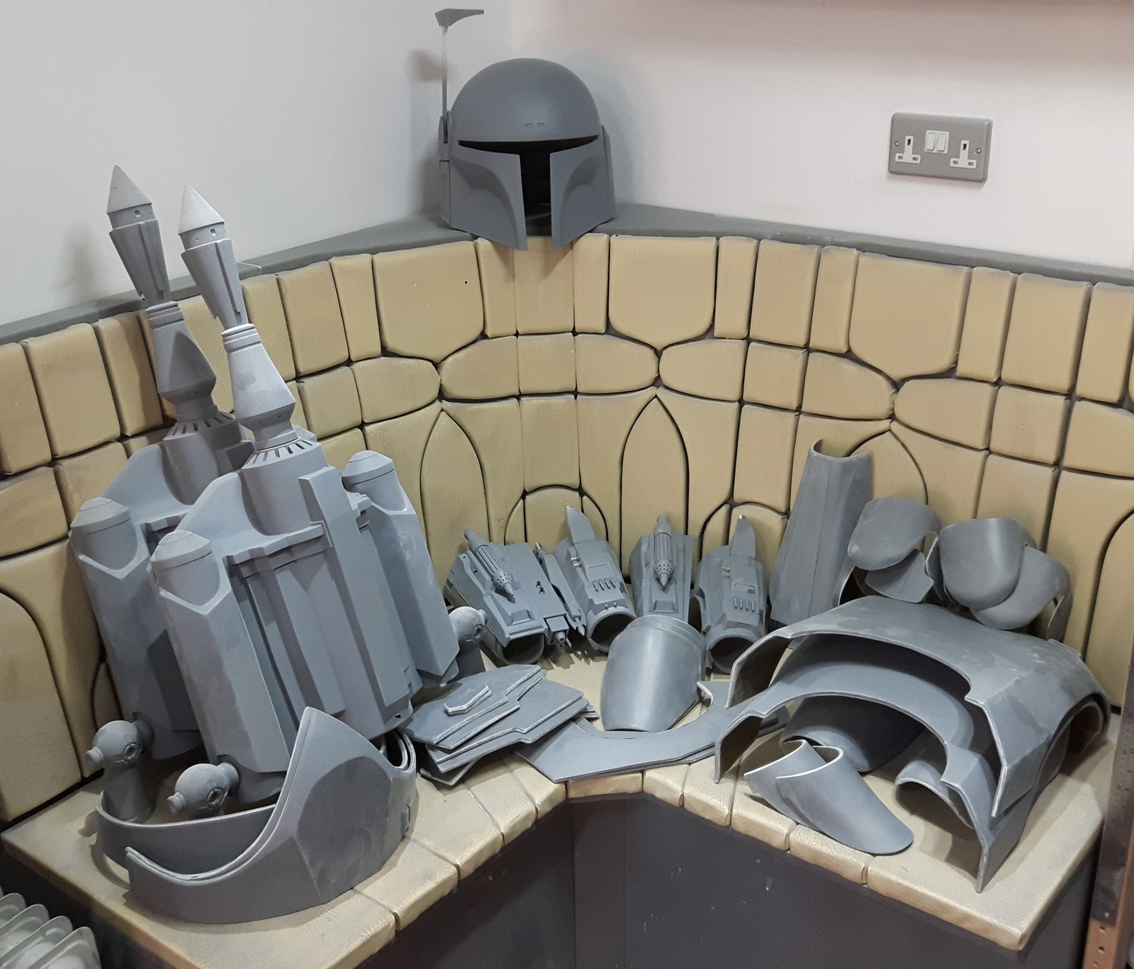

Hi All!
I'm building A Jango Fett costume from scratch, along side a Boba Fett costume. I have another thread for the Boba build which covers the majority of the armour making processes...
The majority of the armour moulds I made were to Boba specifications (with the exception of the Jango specific parts [boots, thighs, shins etc...]) so hopefully I can modify them into something suitable...
Here is my collection of parts... Time to turn them into a costume!
Hope you enjoy! :D

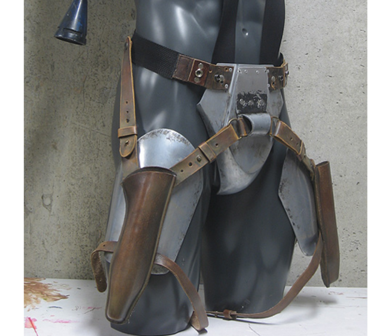

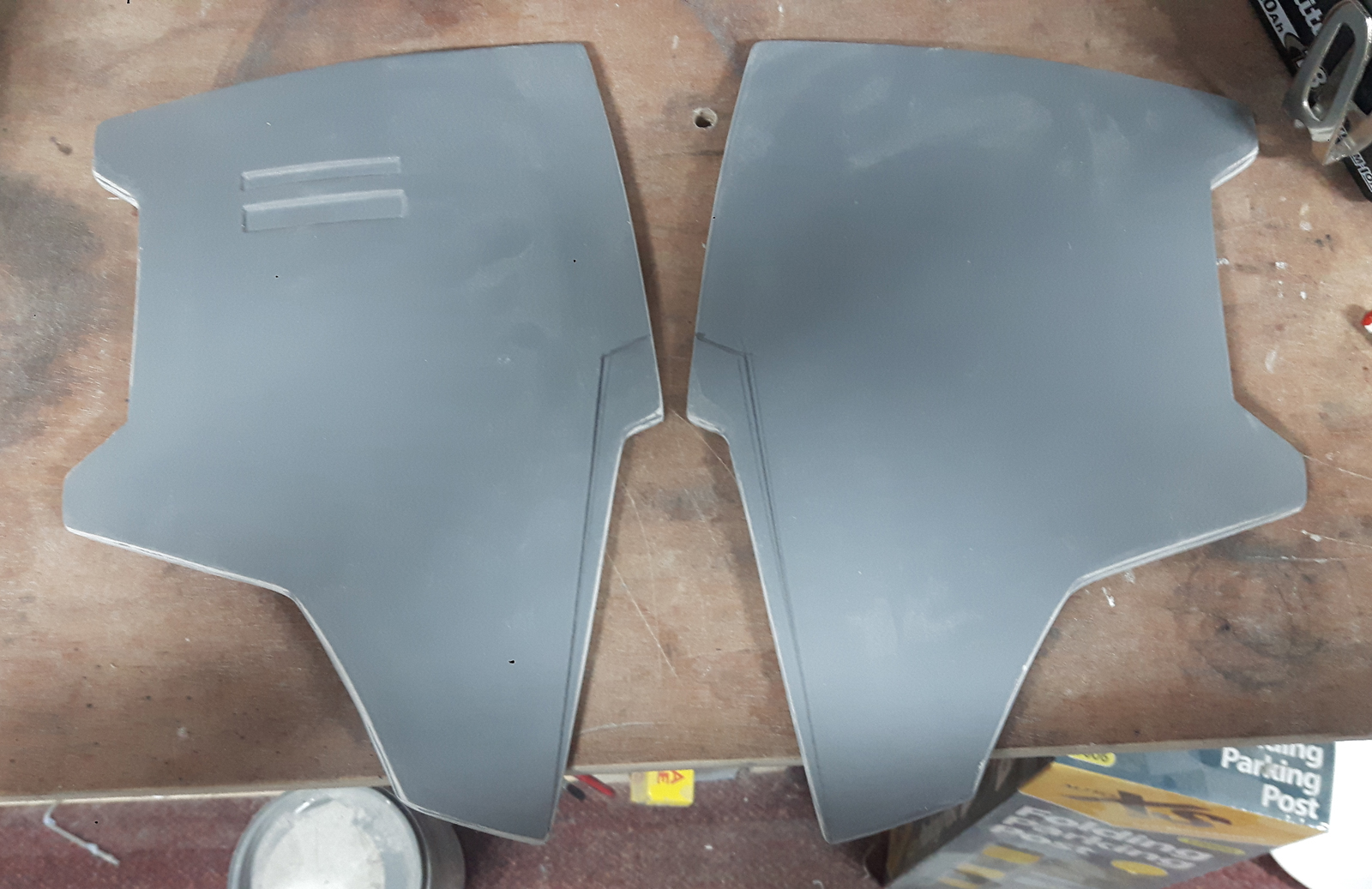

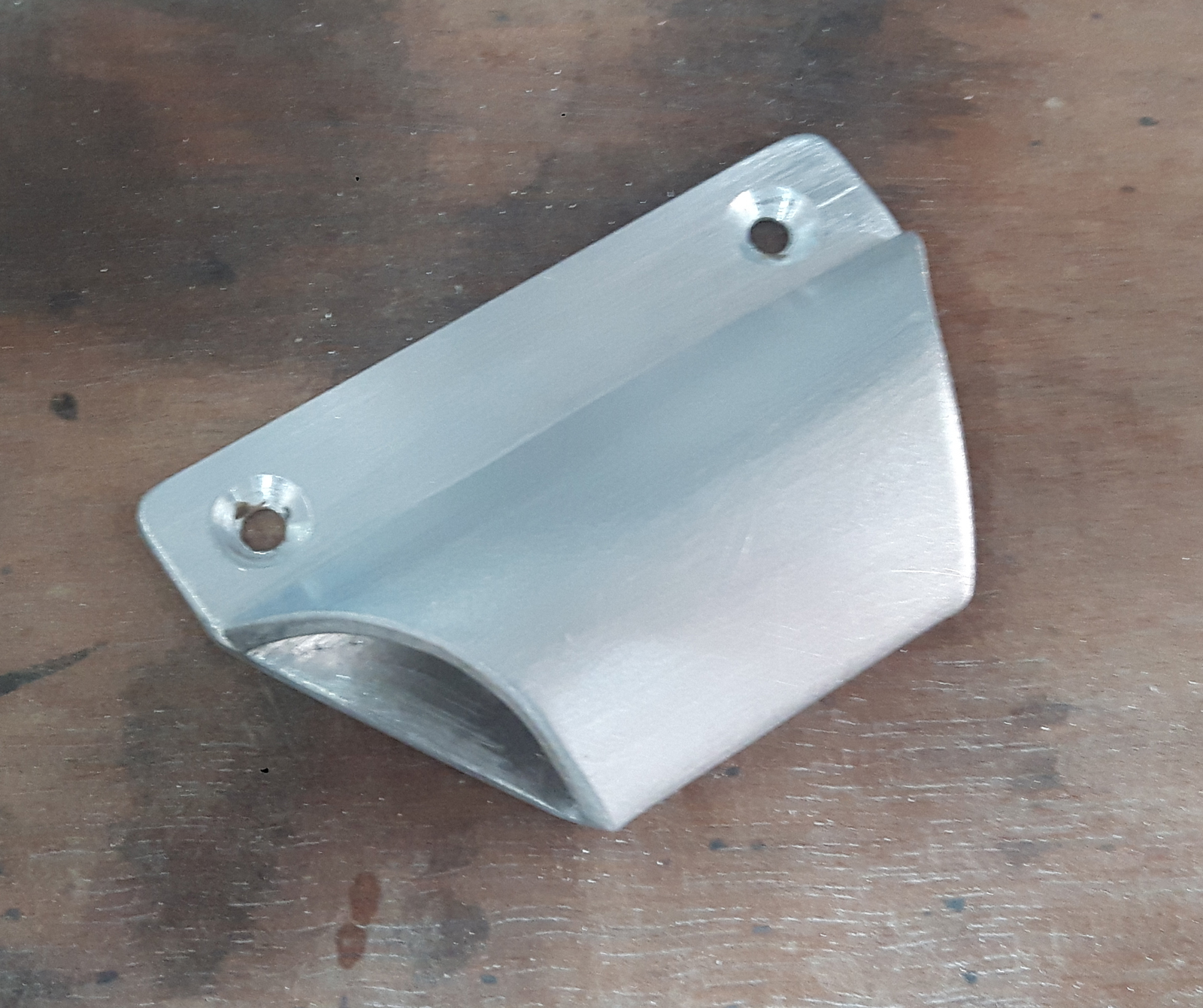

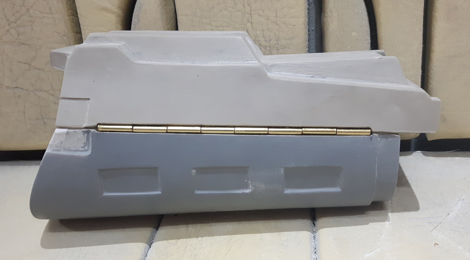

I began by cleaning up the cast parts and installed brass hinges on the gauntlets. Magnets were also attached that allowed them to snap closed.
Modifications were made to the gauntlets to make them more accurate to Jango and the various resin and 3D printed parts I made were then attached.
Modifications continued onto other parts to achieve the correct Jango look.

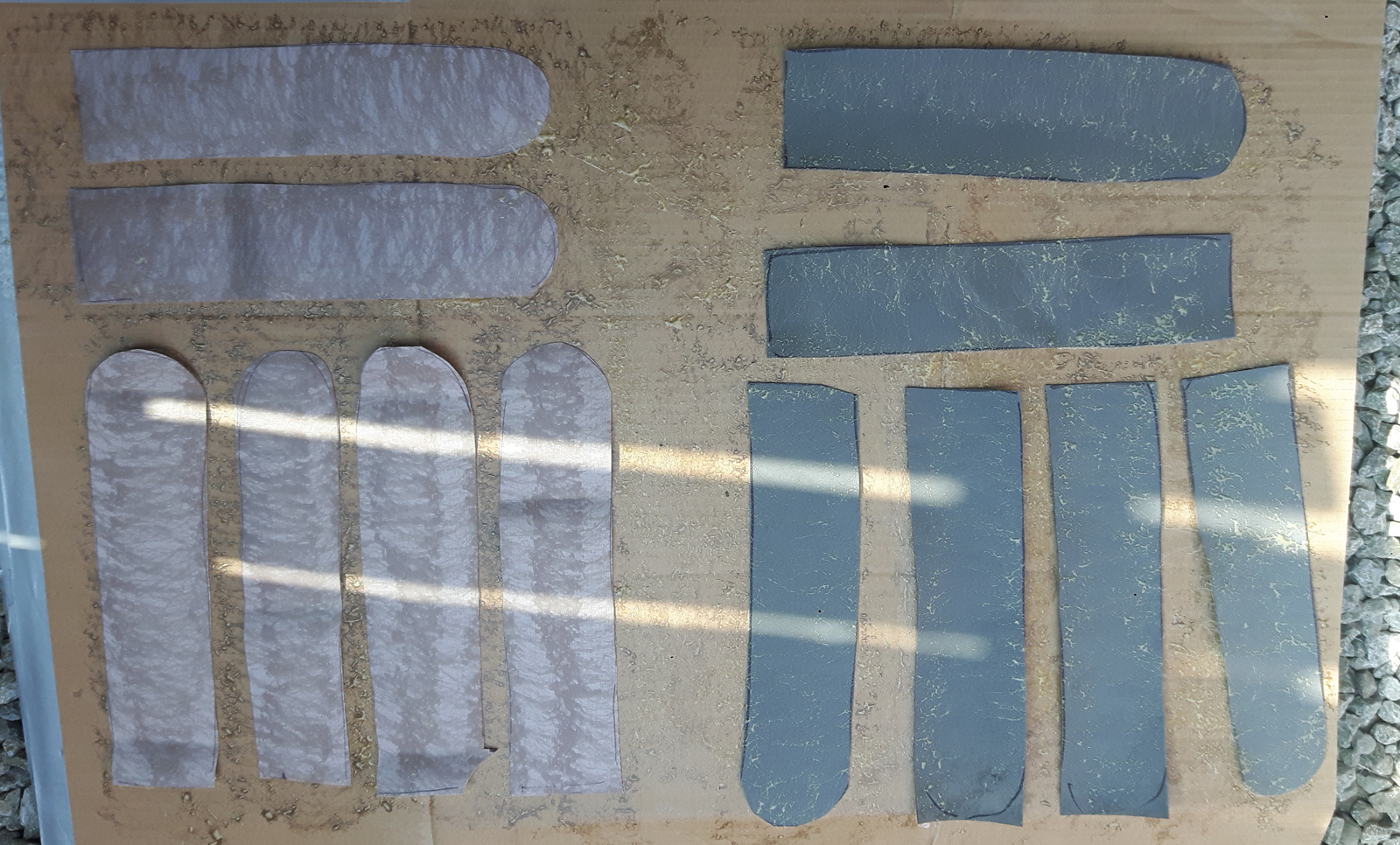

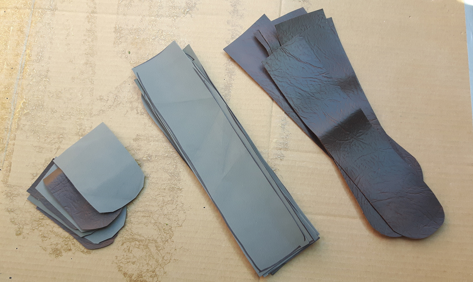

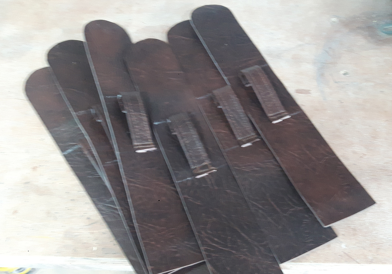

Once the armour began to take shape I made a start on the leather work (or rather faux leather work).
For the leather parts I used a distressed faux leather and thin foam.
I used spray adhesive to bond the foam to the faux leather.
I made a template out of card and trimmed off the excess. Faux leather belt loops were then stitched on.
As the belt pouches have no stitching on them in the film, I used super glue to attach the side pieces.The edge was then painted with brown acrylic paint to match the faux leather.
A Velcro fastening was also added.

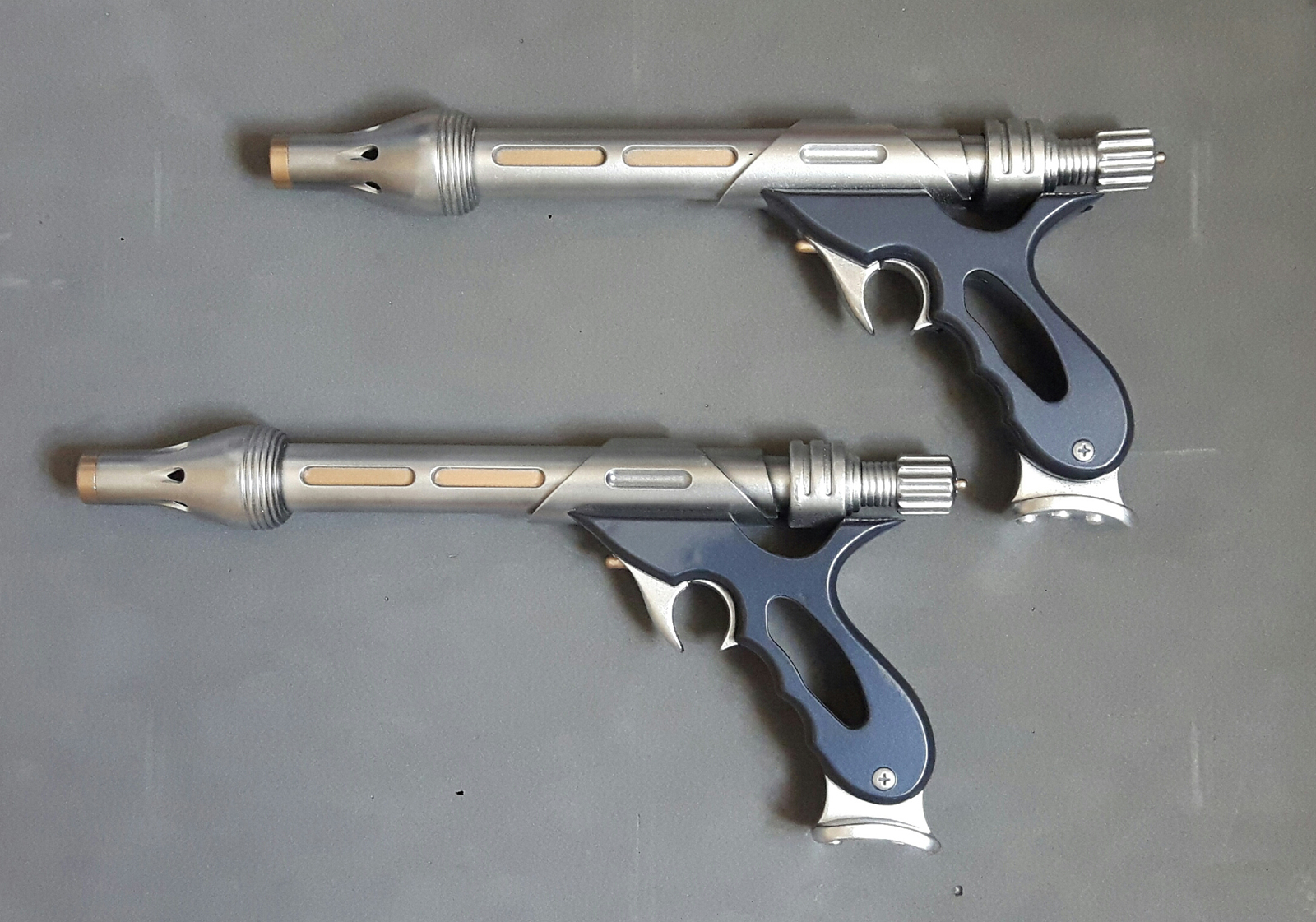

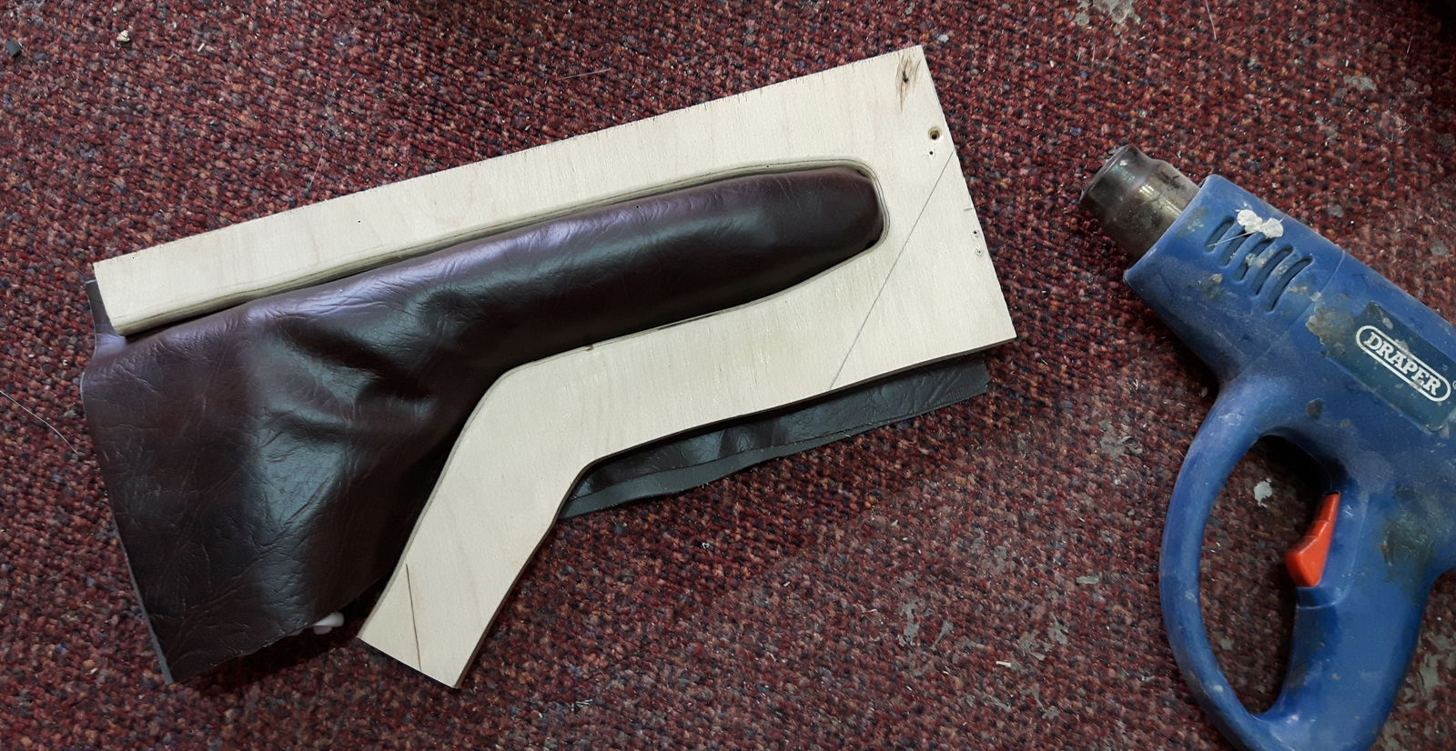

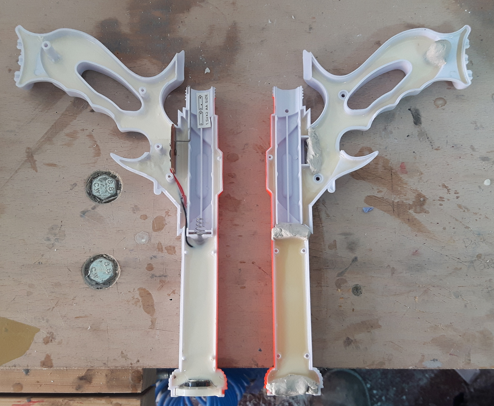

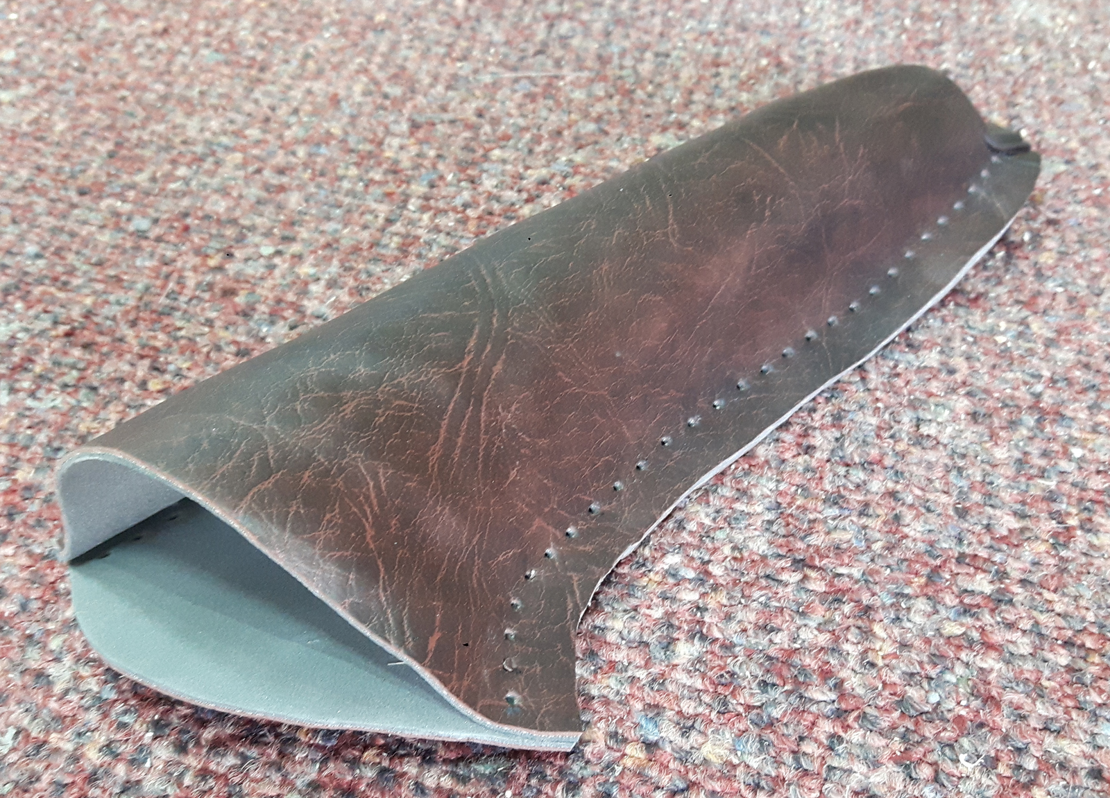

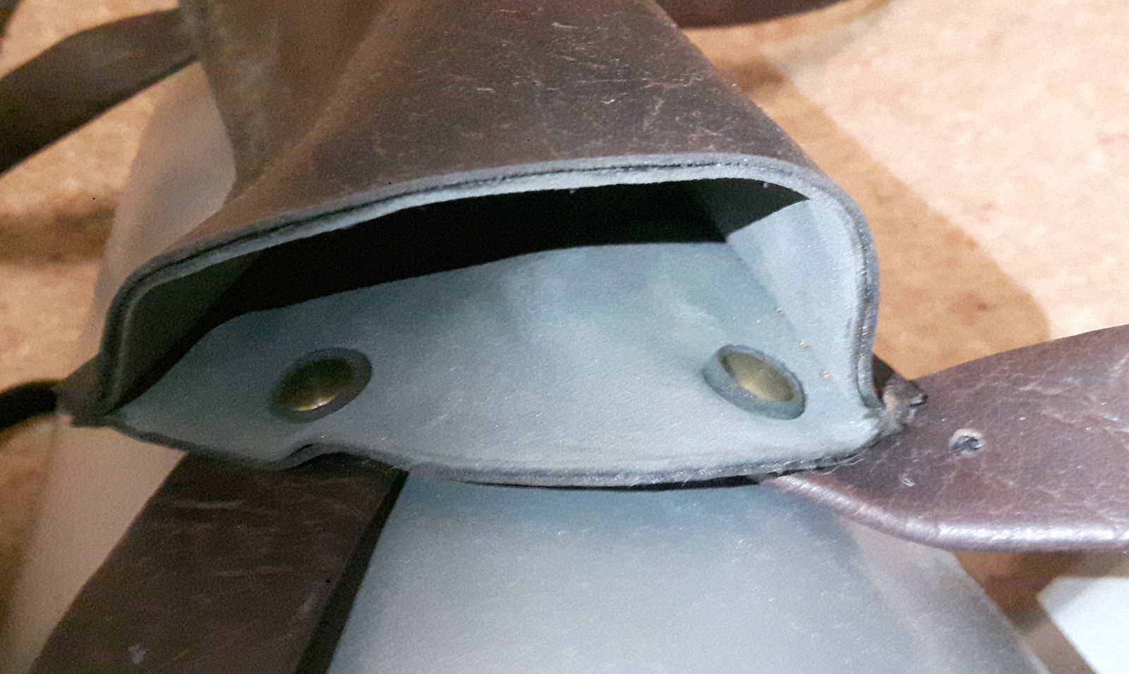

The same faux leather and foam process was repeated for the belt and holsters. I bought a pair of Rubies Westars and wrapped the barrel in newspaper and masking tape to make it slightly wider. I then made a plywood jig to fit around the blaster. I carefully heated up the foam and leather until malleable and sandwiched it between the blaster and the jig which formed it into the correct shape.
Once cooled, the jig and blaster were removed and excess was trimmed. I glued a flat piece of foam and leather to the back and punched holes through, to allow me to stitch the parts together. Though the holsters don't have stitching in the film I wasn't confident that glue would survive repeated wear and tear.

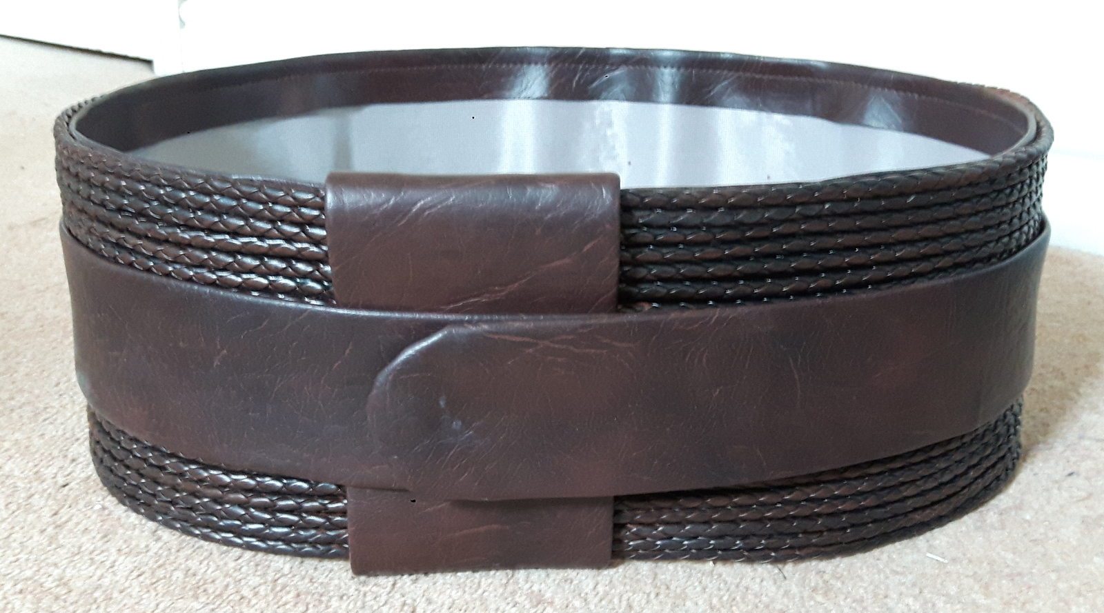

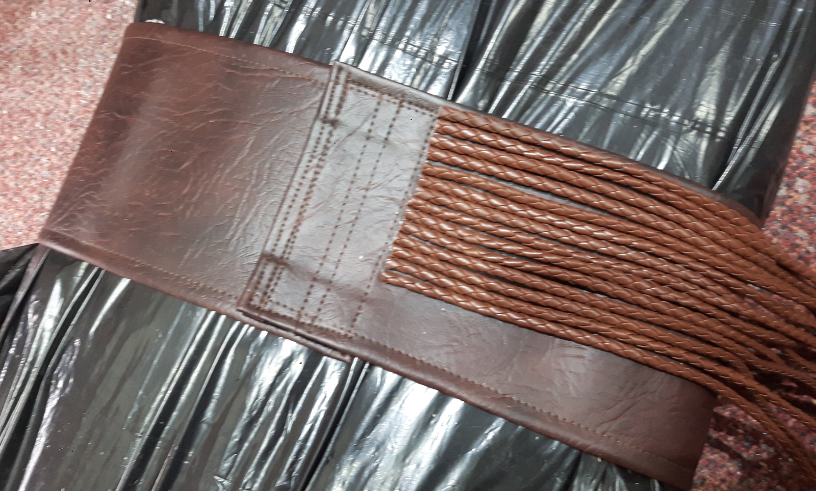

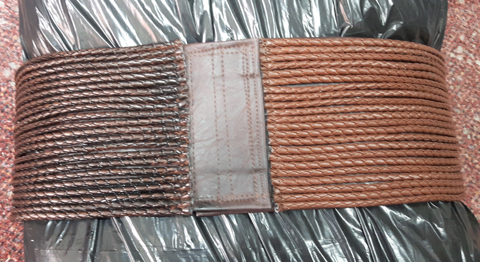

The girth belt was proving difficult to make without spending a tonne of money, until I found some braided faux leather on ebay.
These braids were super glued onto a faux leather belt that I made to suit.
The braids were then weathered with black acrylic paint.
Then BOOM! a pretty decent looking Jango girth and pouch belt at a fraction of the price of a real leather one!

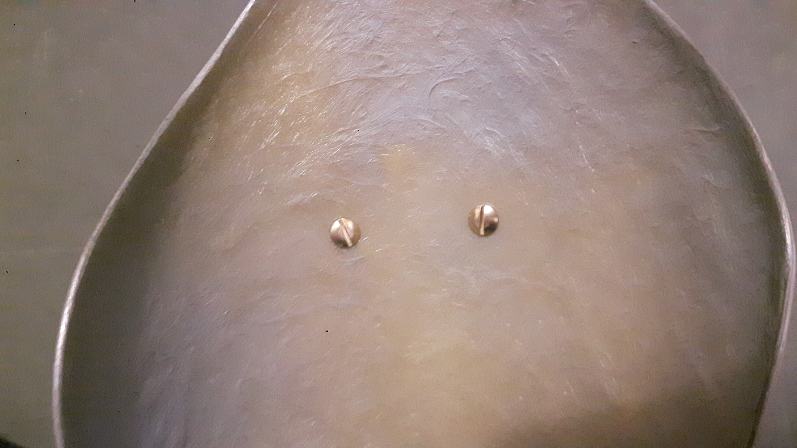

Jangos holsters had two stitching holes right on top to strengthen them, the rest was presumably glued?
I personally would have gone with stitching all the way down, too. Check the Media Gallery here on TDH. You can find it in the top navigation.

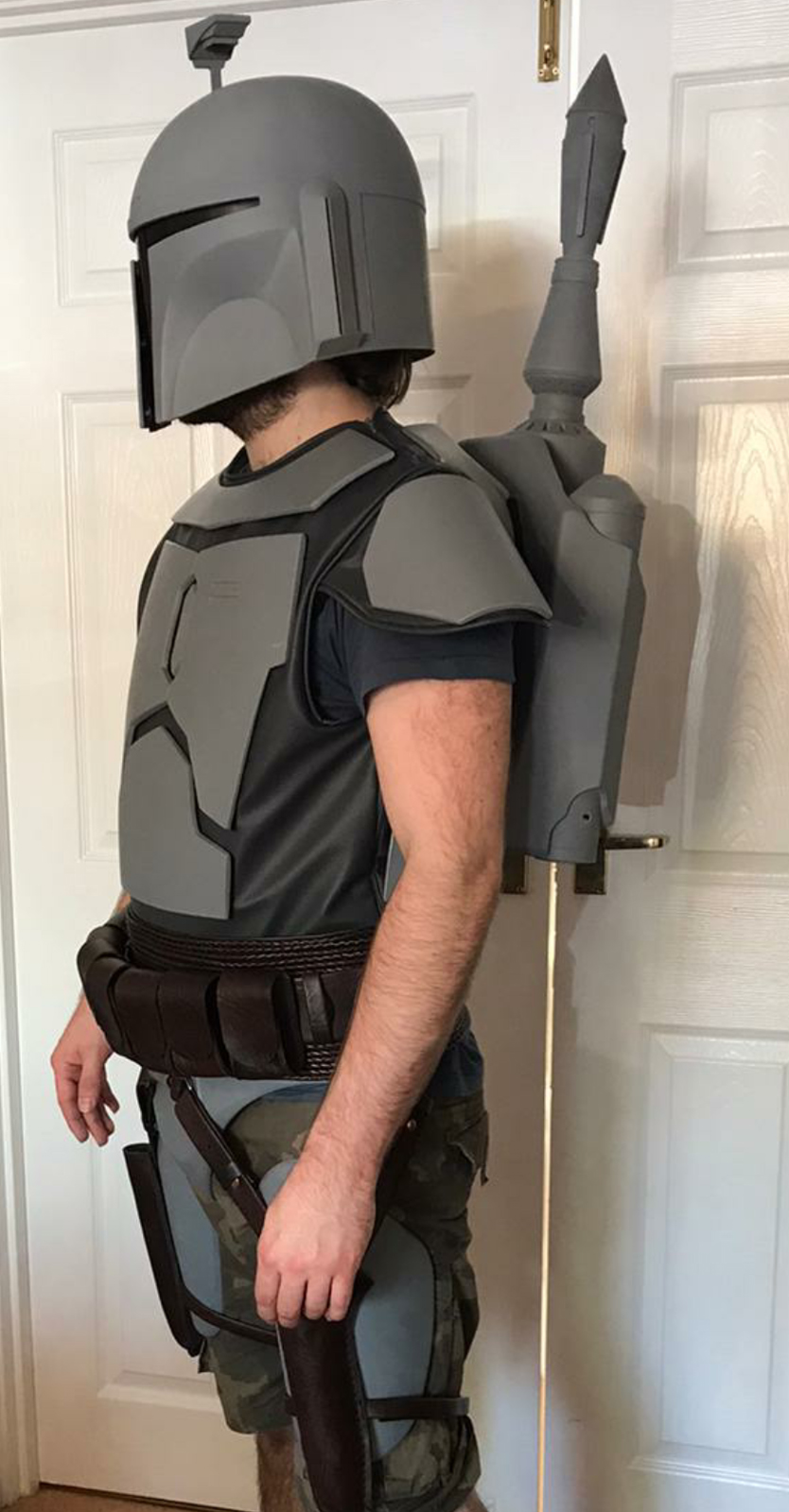

I have made some good progress on the flak vest!
I made a template using an old shirt to get the measurements from. I then used this template to cut the shape out of some grey faux leather and black polyester (for the lining)
All the parts were pinned together and sewn on my sewing machine.
I had to learn a new technique to do the piping around the edges of the vest, which was interesting...
I installed an invisible zip down the left shoulder to allow my head to fit through and another zip down the left side to allow easy access (hard to see from the pictures).
I opted to attach my armour plates with Velcro. However I found that I couldn't get the vest on with the collar attached, so decided to attach that piece with poppers for easy removal. I pretty much copied Cruzer's method exactly for this part.
I then stuffed the vest with a pillow and marked out the armour locations with chalk...
Poppers and Velcro were then applied.
Once the flak vest was completed, I proceeded to spend many hours prototyping a harness that was comfortable and kept the jetpack from sliding down my back... After a while and a lot of swearing this set up proved successful.
The jetpack has female webbing clips attached, that fasten to the male clips that poke through the back plate.
All in all, things are going pretty well! I'm sure something will trip me up soon... haha! :lol:

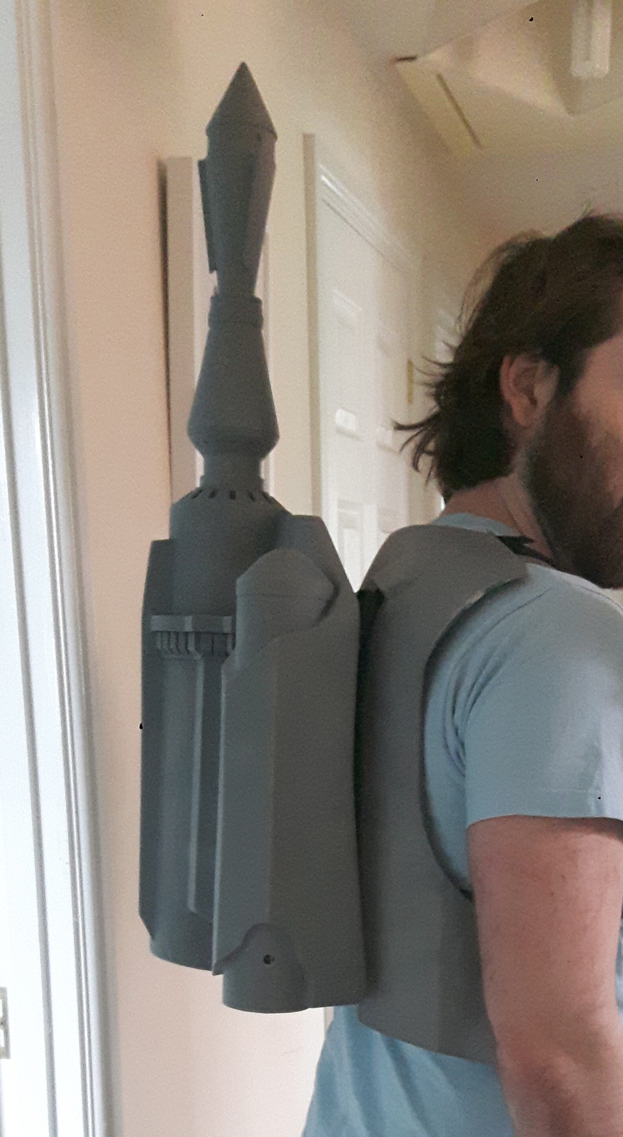

I've added some slots to the flak vest to allow the harness clips to fit through and also some Velcro patches to stop the back plate from slipping down.
I also made some more changes to the jetpack harness. The previous way it was rigged caused the shoulder straps to be visible through the flak vest collar when tightened. These mods also made it comfier!

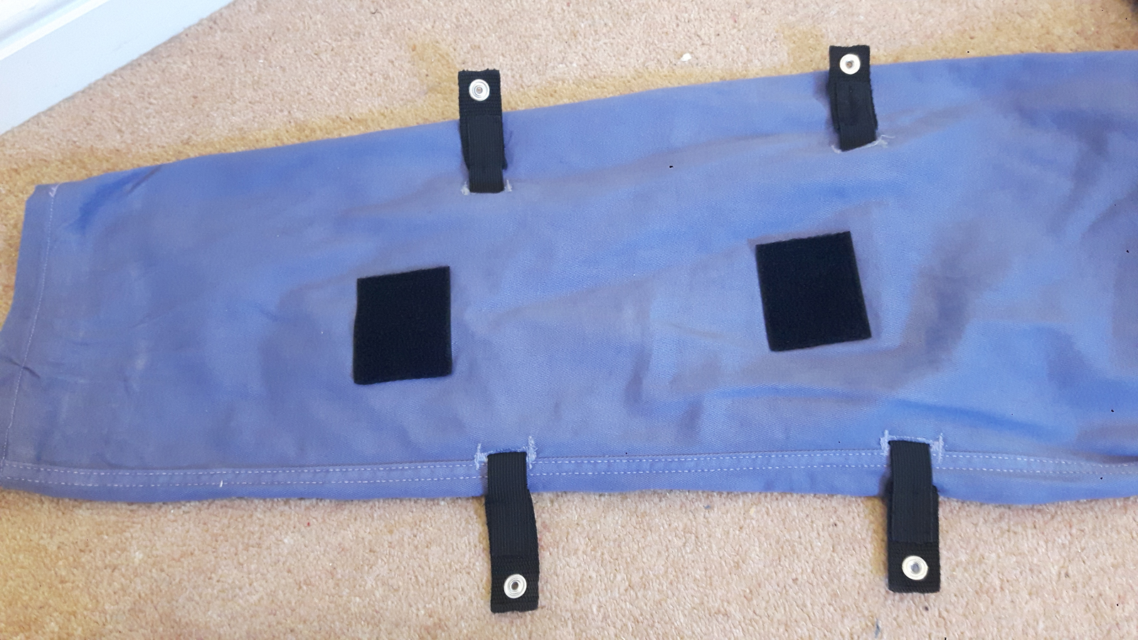

I acquired some lavender coloured thread and added slits for the elastic for the shin and knee armour to go through. (this is the same as what was done for the film). I added Velcro patches to add extra support for the armour too.
I'm really happy with how this turned out!

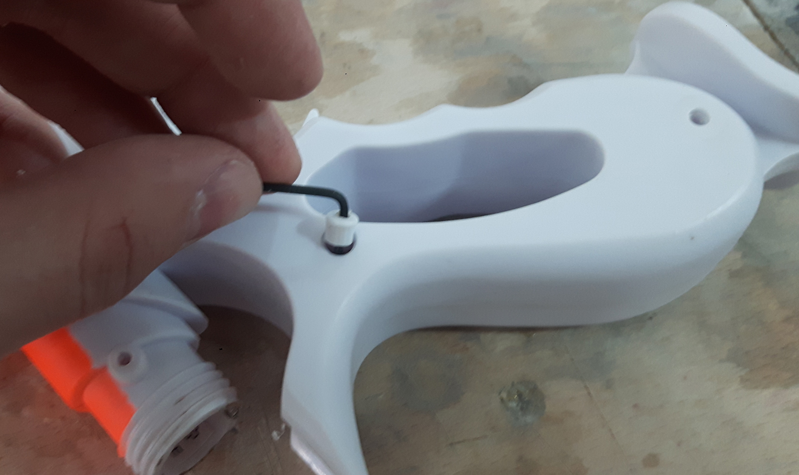

Whilst looking at doing some mods to my Rubie's Westars... I couldn't find many pics of people having done the same, so I decided to take a load of progress pics just in case anyone else was looking to do the same...
I began by removing the screw covers. Though these were only pushed in, I didn't want to damage the blaster trying to get them out. I drilled a small hole through them, so I could hook them out.
I then had to break the (glued?) seal around the tip. I carefully worked my way round with a Stanley knife.
Once the seal was broken, I used a flat head screwdriver to carefully pry the tip off.
Once the tip was removed the rest came apart pretty self explanatory.
I wanted to add a little more weight to the blaster to make them fell less "cheap". I added polyurethane resin to each half to achieve this. Areas that needed to be kept clear (such as for the batteries and circuit board) were blocked off with Plasticine, that was removed once the resin was cured.
The halves were then super glued back together, and the join lines and screw holes were filled in and sanded.
To paint them I used Allcad 2 chrome for the first time and it's wonderful stuff! I wish I had gone the extra step and really buffed them up super smooth before painting so the chrome would really be shiny... This may be something I do in the future as I went a little too dark on the handles... :oops:
They still make the pew pew noises though! :lol:
I made a start on the cod section also! I cut the little belt loop out of some 3mm aluminium and bent it around some steel bar.
I chopped down the wings of the cod piece (as previously discussed in this thread (y)). I opted to leave a bit extra on as I found it helps to stop it from sliding out from under the girth belt.
I made various belts for the holster set up by wrapping the same faux leather used previously, around webbing straps.
The thin ones had Velcro glued on and were sewn onto the holsters.
Holes were punched and brass rivets were used to achieved the correct look.
As seen below, I used poppers to connect the holster belts to the webbing belt that holds the cod piece on.
Brass rivets were used (along with a custom foam washer) to secure the holsters and belts to the thigh armour.
Outside...
Inside...
Of course a test fitting was necessary... ;)
I'm loving how this is turning out! I'm also really excited to get some silver on it!
