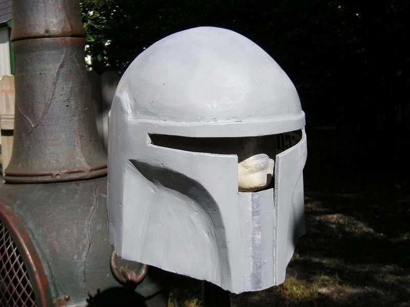

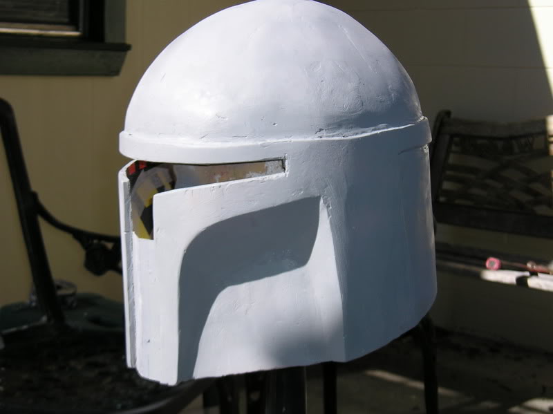

My attempt at a WOF scratchbuilt...
I got the first coat of primer done this morning.
Next: the fine sanding...

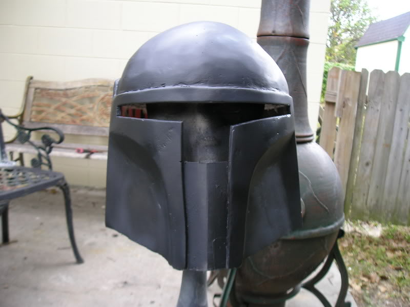

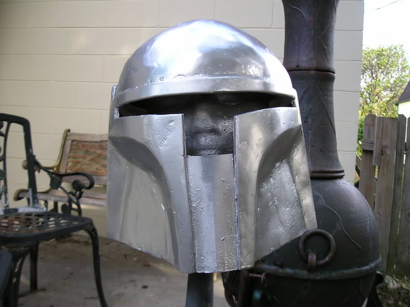

I finally got some painting done today. I started out with a silver base coat.
And, since this is going to be a variant, my other base color is black.
I need to give it a while to fully dry before I mask it off for the other colors.
David.

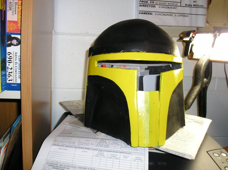

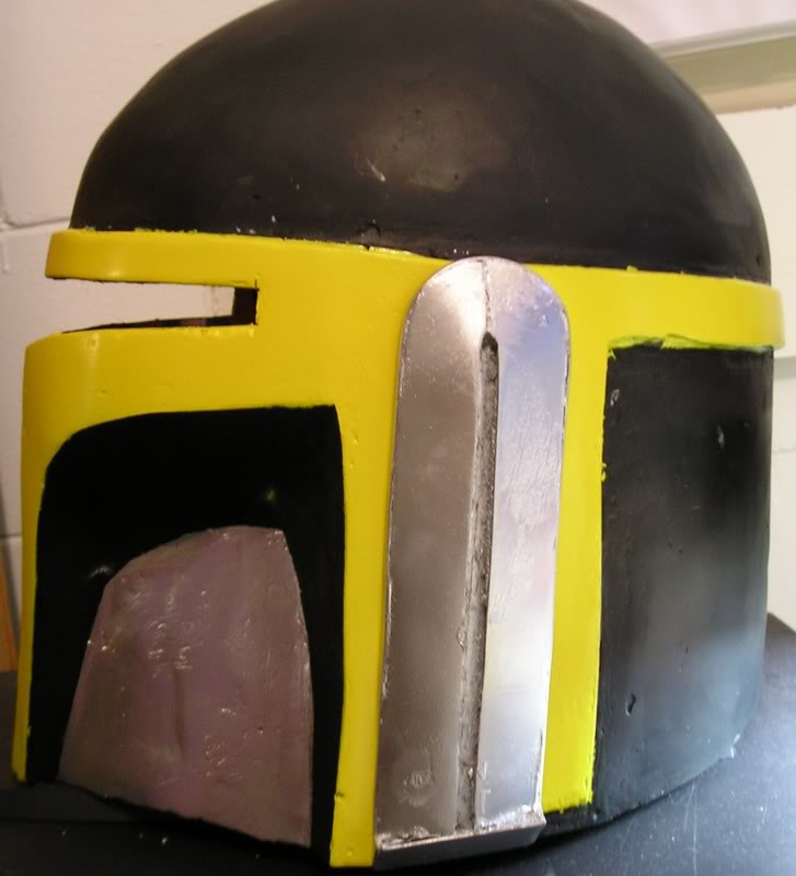

Okay, I've officially reached a stopping point. I am now at 75% complete on this bucket. I'm going to set this aside for a while to work on the ears and the keyhole insert.

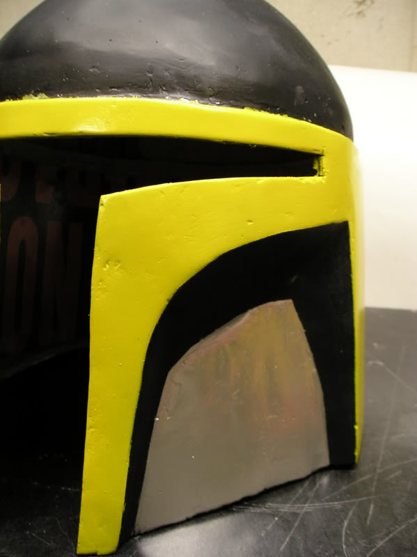

Here's the yellow face...
...and the silver cheeks.
A closeup of the left cheek.

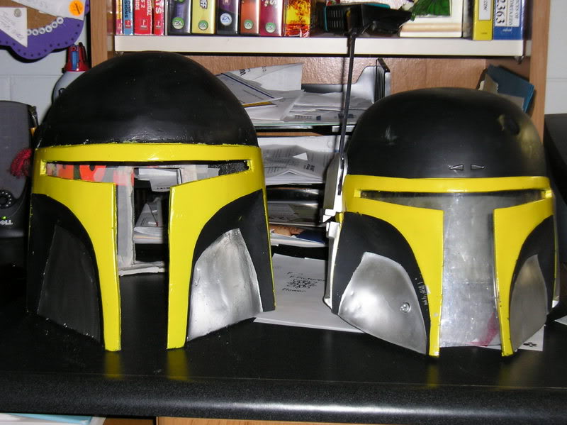

And just for comparison, here is my WOF bucket next to my Rubies.
Once again, many thanks and kudos to Alan for his templates.:thumbsup:

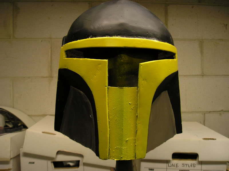

I mounted the left ear. This is the one I covered with the sign material to make it paintable.
Next I'll be working on the right ear getting it ready to paint and install.
David.
I got the right ear finished and installed.
I do have the upper cap done as well, just not in the picture.
Someone asked me if this was going to be the final product.
Once I have all the parts done, I will be casting this bucket to make copies for friends. It will be done with glass and resin. The parts look less than stellar now, but they will be used as molds.

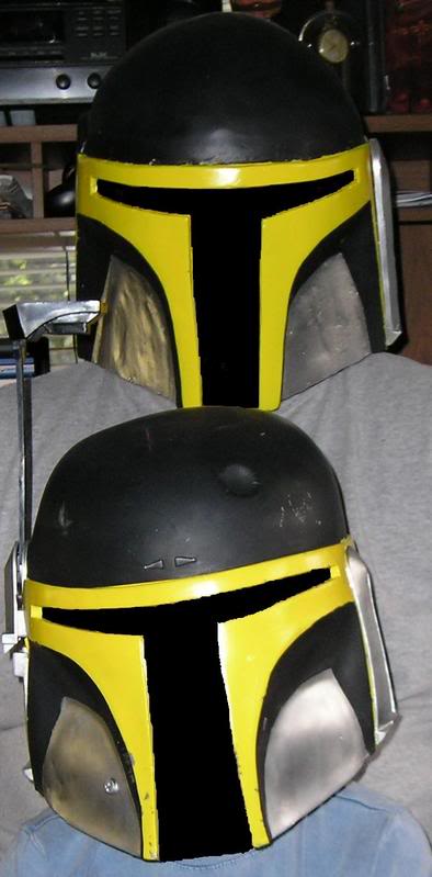

Oh, and just for fun, here's a pic of me and my son in our matching buckets. I used MS Paint to color in the visors and this was before I put the right ear on mine.
David.

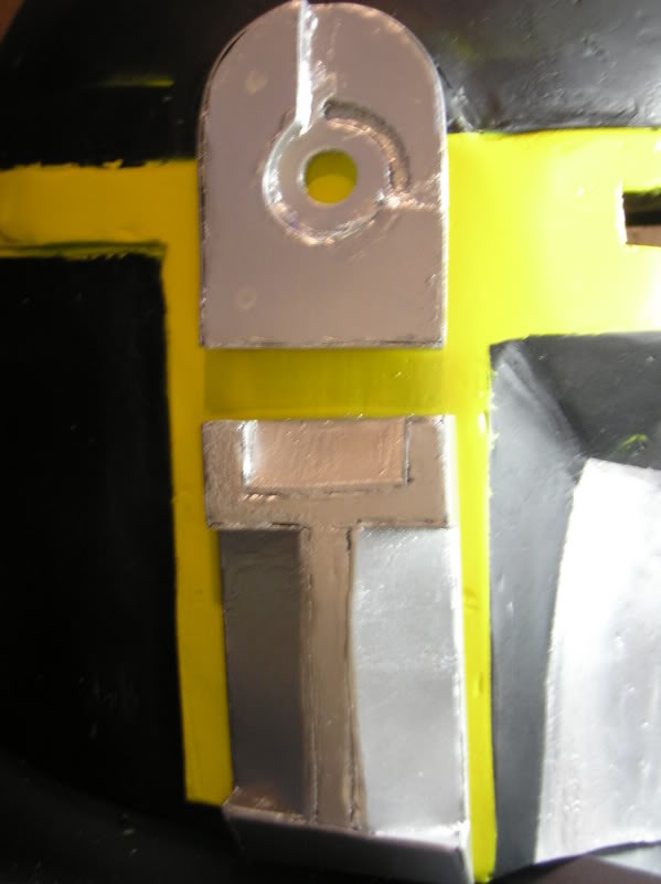

I decided to work on the RF pieces today. I forgot to take progress pictures, but I do have the finished (so to speak) pieces ready to cast. If I can't get scrap aluminum for my stalk, I may look into getting one from someone here - if they are still selling them.
What I did was use more of the sign material. Luckily I was able to find scraps big enough for it. I put masking tape on the outside edges and hot-glued the bejesus out of the inside.
Here's the top and bottom pieces separated.
For comparison, here are two views of mine next to the '97 Rubies RF. (The top and bottom of mine are taped together. I did that so I can cast it later.)

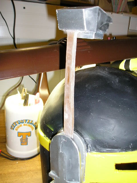

And here is my bucket with the pieces all put together temporarily. I cut a stalk out of foam board. It holds up for a while, but is WAY too flimsy.
Questions? Comments?
David.
That looks sharp, Dave!:thumbsup: Yeah...that stalk could use some Viagra!:lol:
Rob

But for now, this is what I did...

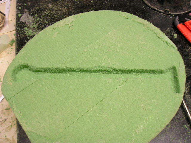

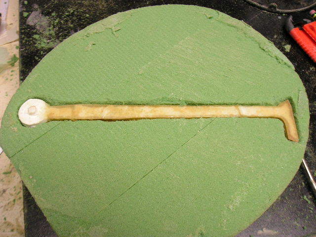

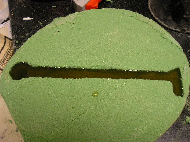

I got some advice on making the resin stalk from someone who messes with fiberglass as a business. He said to use floral foam, so I chopped the dome off my failed IMP guard helm and shaved out a stalk form using my foam one as a template.
Here it is with the foam stalk inside.
I mixed up a one ounce batch of resin and poured it in.

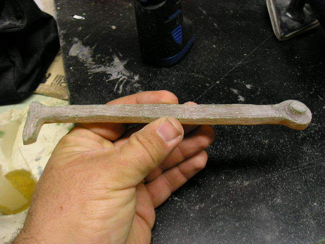

After about three hours of drying (really less, but it's Christmas and I had shopping to do), I pulled the cast. I knew going into it that each time a cast is done it's a one-time shot, but that's okay for one or two pieces.
Here it is after a little cleaning with a Dremel and sander.
I did have to sand down the thickness to make it fit inside the ear...
...but after painting I think it turned out pretty well.

The colords do match pretty well. I love Mechanix gloves. :-P I wore a pair of them in Iraq on foot patrols rather than the nomex flight gloves.
And I'm... a mechanic... ? *evil cackle*
Good job on the RF stalk, man. Only thing I'll say about it is that the "foot" isn't supposed to be sunk all the way into the RF.
You're absolutely right. I didn't think about that. I'm going off of Alan's templates and that's the size of it. But, it shouldn't be too hard to modify the pattern when I recast it for wiring.
Thanks for the heads up!

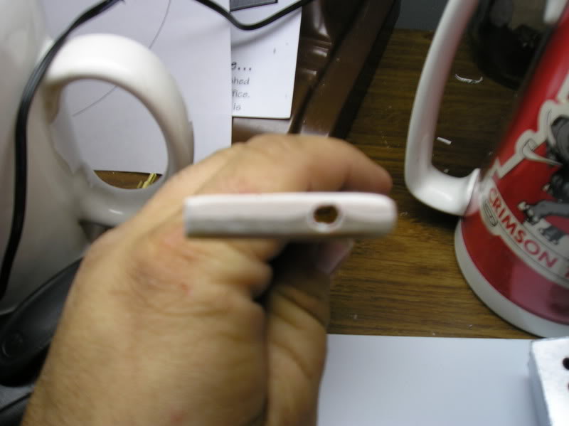

So this time (sorry, no repeat pics) I used a bendable straw for the wire conduit, half resin and half bondo for the main body.

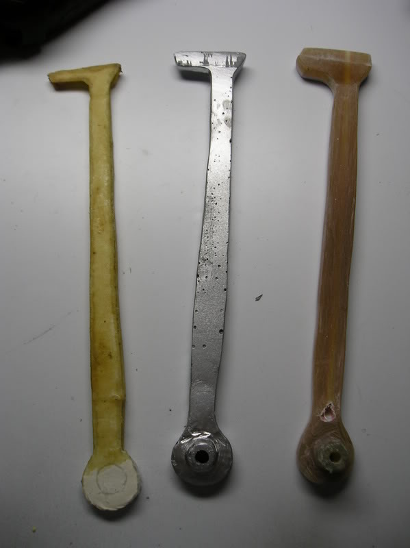

Here is a pic of my stalk evolution...
On the left is my first one. I used foam core board coated with resin. It's stiff, but the resin melted the foam around the edges. In the middle is my second one - the one that leans. You can't really see it in the pic, but I also had a lot of bubbles from not mixing properly. And the one on the right is my latest one. I also added about 1/4 to 1/2 inches of extra material at the top to properly seat the RF.
Here is a close-up of the top with the straw conduit. (Sorry it's fuzzy. My camera hates me today.)
And here's all three stalks again, but the new one has a temporary wire through it to show my success.
