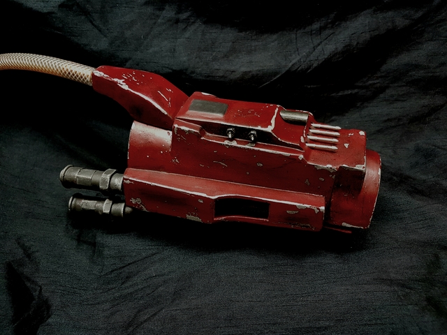

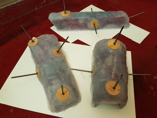

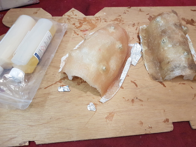

Anyway one thing I have been doing is upgrades...well experimentation to be exact, I haven't settled on anything yet but I have a working prototype for my new gauntlets I been making, I have always had issues with my current gauntlets pinching my wrist and making my thumb/hand go numb. so I been working on a lighter set, these will be cast from the ones I have now, refined a little and hopefully solve my issues.

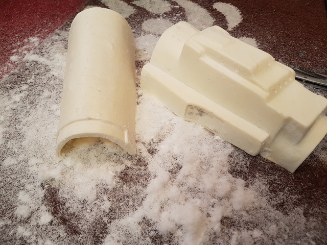

So I made a silicon mold of my original gauntlets with a fiber jacket and roto cast the two half's
I have lots of room to play with these now, because they are just shells of the original I now have more space inside and that gives room for padding, they are much lighter (for now) but I think once I have added all the greeblies and such they will gain a bit of weight, now its plastic I can smooth off all the edges and remove any imperfections in the plastic that transferred from the original ''and there are lots'' !!! seems like they have taken a beating over the last year....
Anyway this gives me something to work on and hopefully iron out all the issues I had in the past,

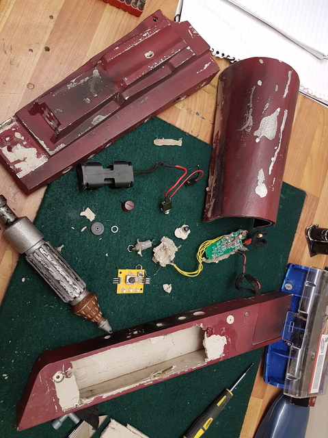

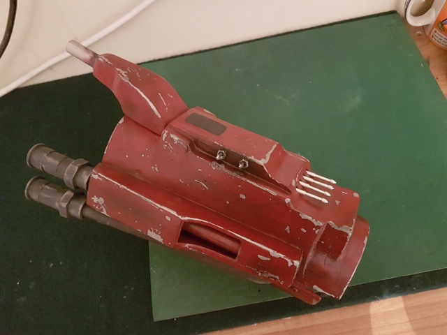

I put the red on it and its the same paint as I used on the original used ''VW Gambia Red.''.... and it has a lot of curing to do by the look of it, I cant ever remember it being that light in color when you set it next to my old gauntlet it looks way off, but it is the same red!...... I had to pull apart my old gauntlet to cast it, looks in a horrible mess now :( I will put it back together ....its screen used after all :lol:
will see how this new cast off turns out in the end... if all goes well I will do the left one.
ok the red is still quite red, but I put the clear coat on it and it seems to be going the right tone of red....

Thanks man, I have the left side out the mold but there has been an issue, the silicon has moved during the roto casting so I have a wonky edge and the two half's don't line up, :facepalm but they are thick enough that I can sand out the imperfections and get it back on track but its going to take time....
Be warned folks home casting on the cheep is fine if you have lots and lots of time to do it slowly, if you were rushed one evening like I was it goes wrong real bad real quick....:unsure but then again its all about learning new things and now I know what not to do. :lol:

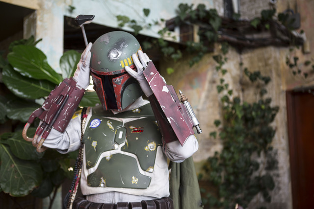

Gauntlets all finished, they are a little lighter than my previous ones, the seem a lot stronger... I have smoothed them out more and made better padding, I also moved my range finder switches about a bit and sacrificed original aesthetics for a bit of practical magic when it comes to operating my range finder...
Also only using the one pipe as its more in keeping with the SE fett
other than that Gauntlets 2.0 seem ok at the moment I need to get a long troop with them on and see if they still make my hand go numb :behave
:thumbsup:
Two minor things. The silver at the oval thing that sticks out on the right guantlet extends horizontally across the front face of the guantlet. Also the left gauntlet dental expander is red. Good job getting it all figured out.

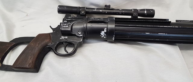

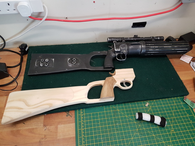

I am also working on my EE3 I was never really happy with the handle and stock, I built it for comfort and lightness but to hell with that now I need it to be more accurate so I am working on that at the same time...up dates to follow.

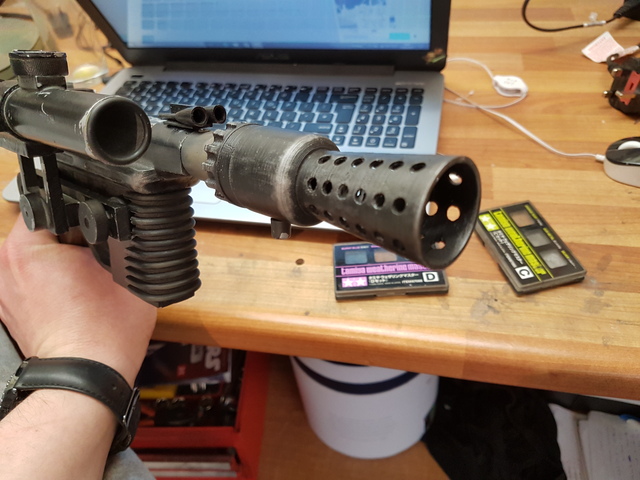

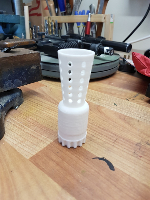

Also I got me a 3D printer, in the past I have said this will kill off all creativity when its so easy to simply print stuff off, and yes you can easily just find an object and print it! and so I did
I ts a replacement flash hider for My home brew Dl44, I wont say this will totally take over my build ethic of 'recycle and reuse' but it does have its place for them awkward little greeblies...
took me about a week to get a decent print by the way, much respect to people who use this method full time!!!...

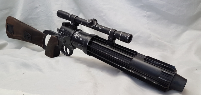

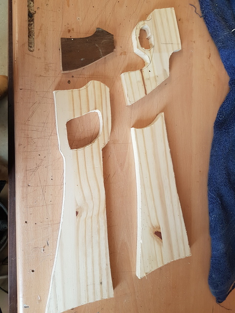

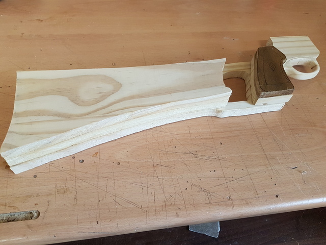

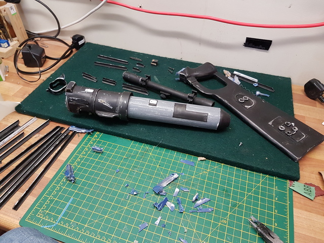

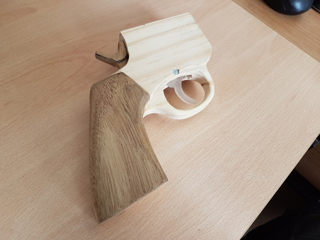

So I was never truly happy with my blaster, it looked ''ok'' I originally made it super light and thin so I can troop with it and take a beating.....but I have decided after a good year of trooping in this I can make it look a lot better and to the right scale.
as you can see the handle and stock are way off, and I think the barrel came up almost 2 inches to short :confused (I think I rushed this step of the build a little)

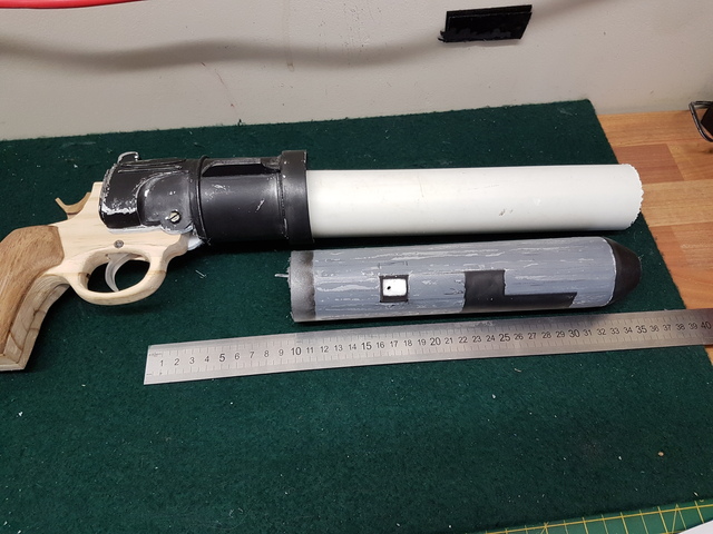

Pine board for the stock and a teak handle... ... and this is going to need a lot of sanding and shaping....
And then this........ :eek:
next will be the fins and I will reuse the ones I had but 12 this time and not the 16 I had before! (man I really did skip the details on this bit) ....

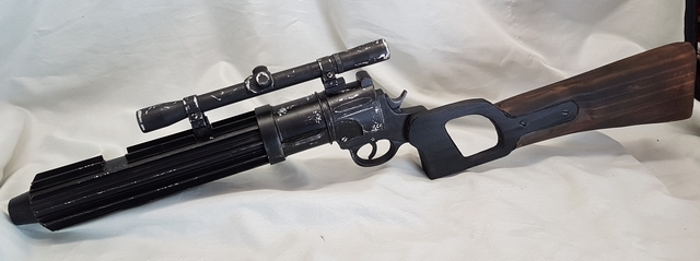

All finished, lots of research into the original blaster and the one thing that stuck out the most was the stock, the ESB carbine looked great with the wooden stock but when they made the ROTJ version that was just a cast, it don't really look all that great if your trying to replicate it 100% that's why I decided on my version I would keep the stock brown as I have stained it anyway but give it a light going over with the weathering so it looks like a rifle that's got all dirty, I just think it adds a little more dimension to it in a public setting. Its not 100% accurate this is true.
But....I like it..
