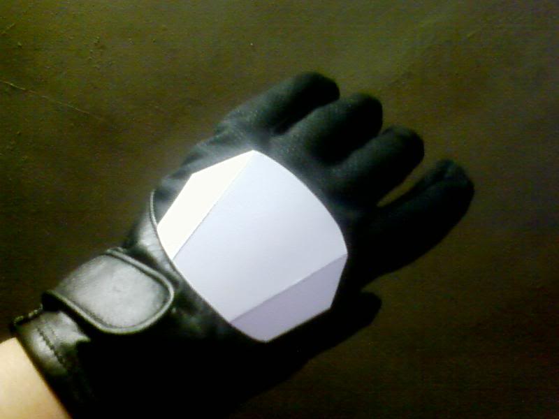

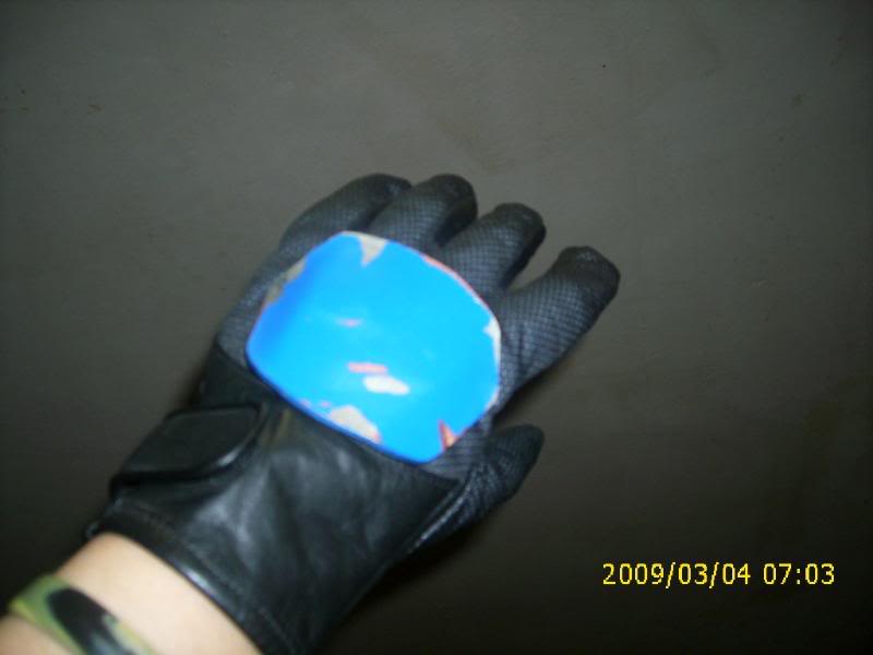

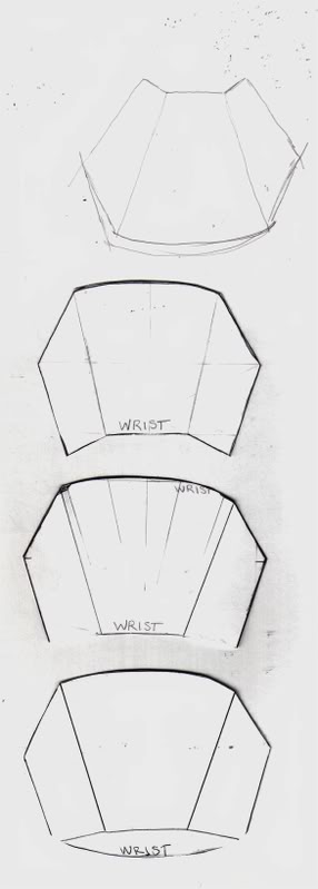

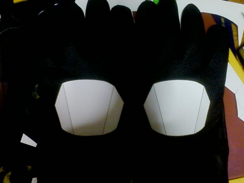

I really don't remember where the heck I got my pair of gloves, but they are all black with a Velcro closure, no patches, tags, or anything like that, so they should work well. From a shoulder bell design that was cut out for one of the ladies at the armor party, I used it as reference, and modified it to a design for my gloves. Larry (Ge'tal) and I both agreed that the "angled" design of some armor plates looks pretty cool.
It took me a couple of tries, but after measuring my hand and using the curve along some stitching on my gloves, I came up with the final version, on the bottom. In the process, I taped the templates on my glove to see how they worked.
Here's pics of what I have done so far, though I'm planning on getting these done today!
I got them cut out, sanded down around the edges, shaped, and painted with a first coat all yesterday.

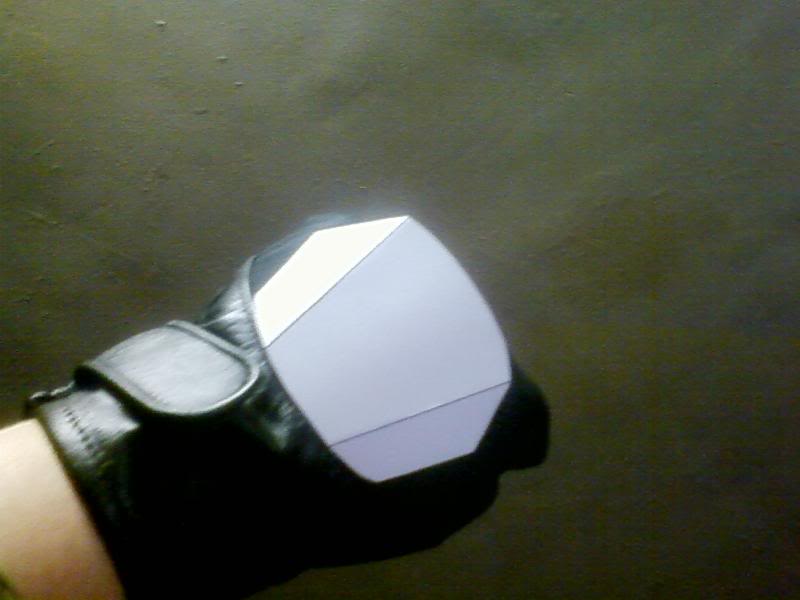

Gloves with templates on them:
On hand:
In a fist:

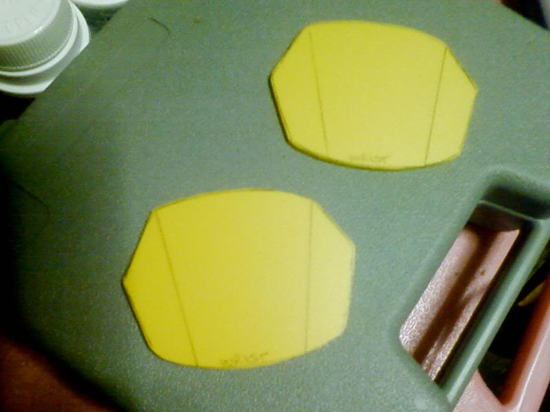

Cut out:

The pink you see in the pictures is my all-pink tool box. Yes, I actually own something pink. :rolleyes: It's a toolbox that my late grandmother bought for me so my husband will keep his hands off. I got it out of my car so I could use the razor cutter.

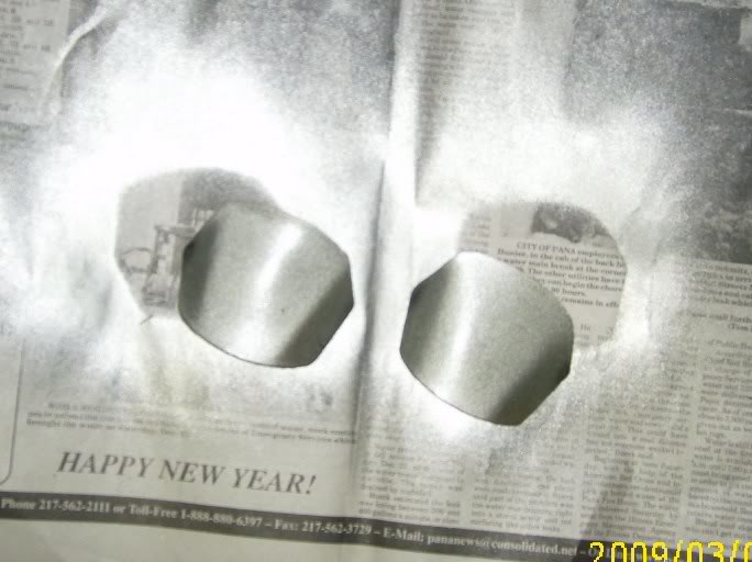

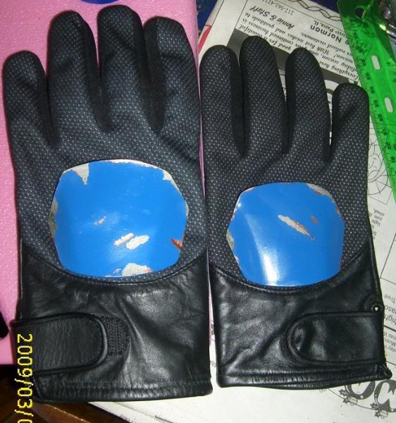

Glove plates are done, and these are just taped to the gloves for now...
I did paint the underside silver along with a coat of bright copper--I really like how they turned out!
It was suggested to me at Mercs to use toothpaste to help in weathering, and it works wonders! ;)

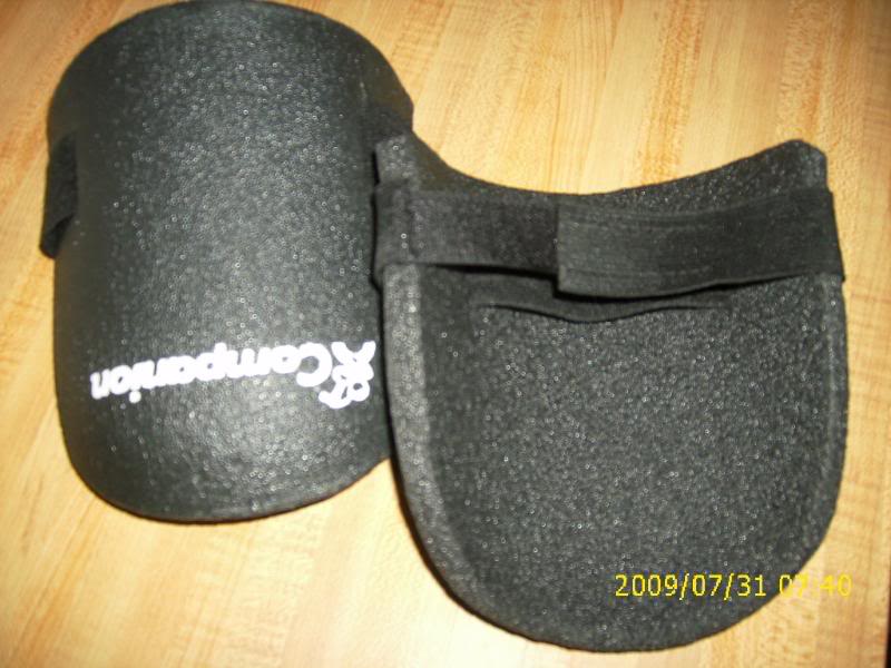

Inexpensive foam kneepads I bought at Sears. They are so very light, I can hardly tell when I have them on. The foam is a durable material, yet I believe it can be trimmed to whatever size or shape I need, if I need to do so. They cost around $7. They seemed to be a very nice base for knee armor!

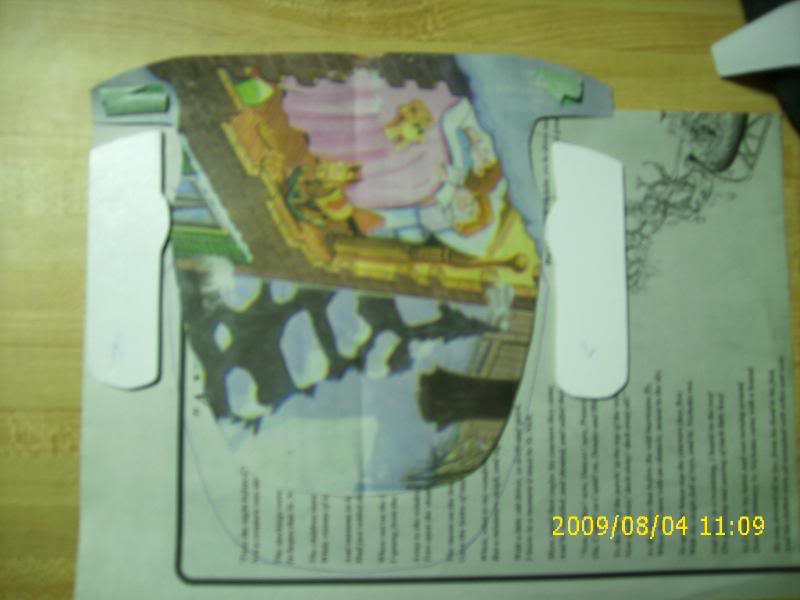

I used newspaper to draw out a design for the knee armor, keeping in mind the foam kneepads' elastic band.

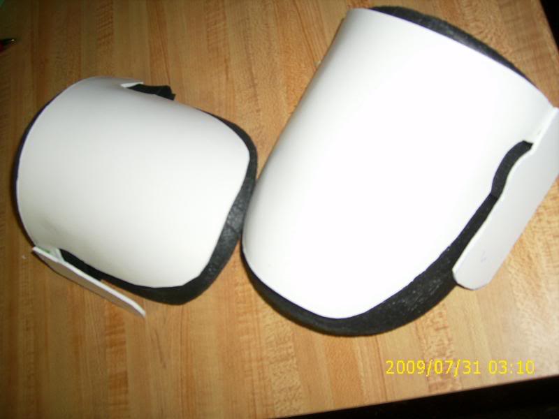

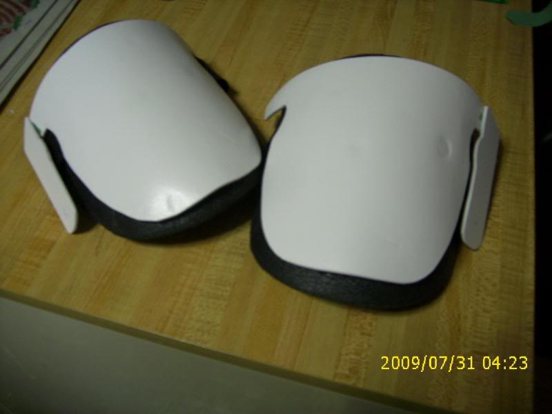

Before sanding, taped together to get overall look.

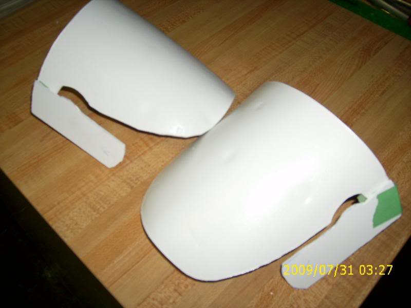

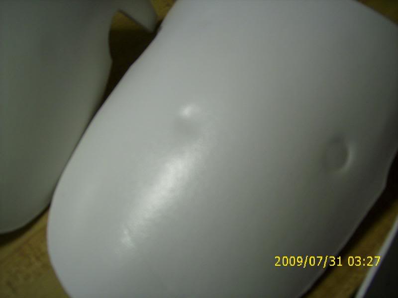

After heating again and adding a few dents.
As far as I am for now, all sanded, glueing and painting are next. I might cut them down a bit so they are not quite so big, but I think they will work anyway. I need to heat up the top of the left one to get the tips curved a bit more.
For the forming, I wore both kneepads and labeled the armor pieces left and right. When I took the armor pieces out of the oven, I used gloves to form them around the foam kneepads to get the right curved shape. I don't have pics of the drawn out design on the pvc board--those are on my phone and I'm having issues getting images to my sd card. I added the "sides" just on the outside of the armor knees as I thought they might get in the way on the inside leg.

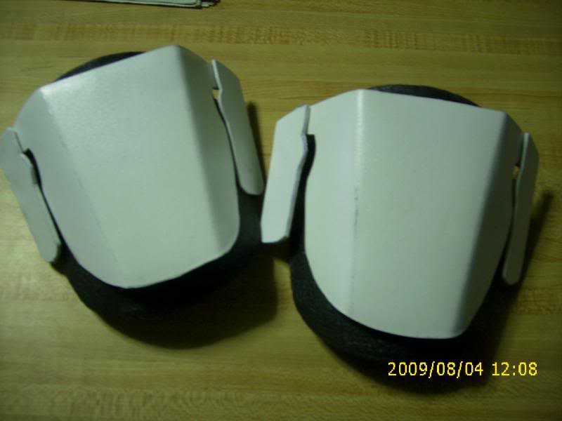

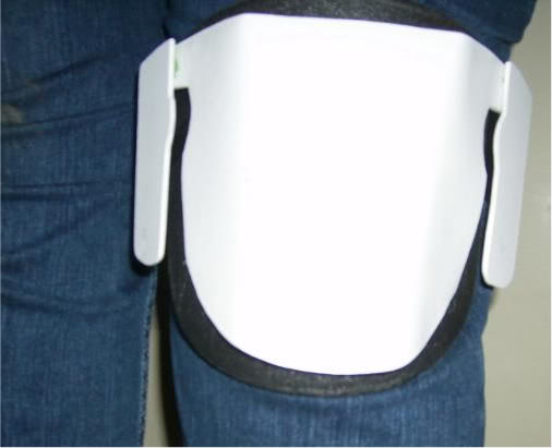

I re-did my knees. They are not done, but only sanding, glue, and paint left. I'm now happy with the way they look, so this is it:

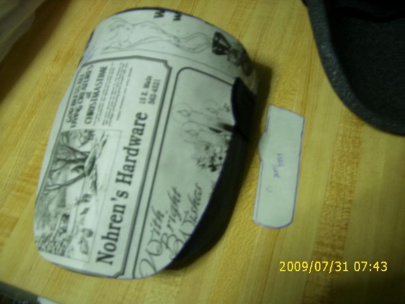

First, I made a new newspaper pattern. This will be about the same, but shorter.
Shown on knee armor before cutting, along with the sides.

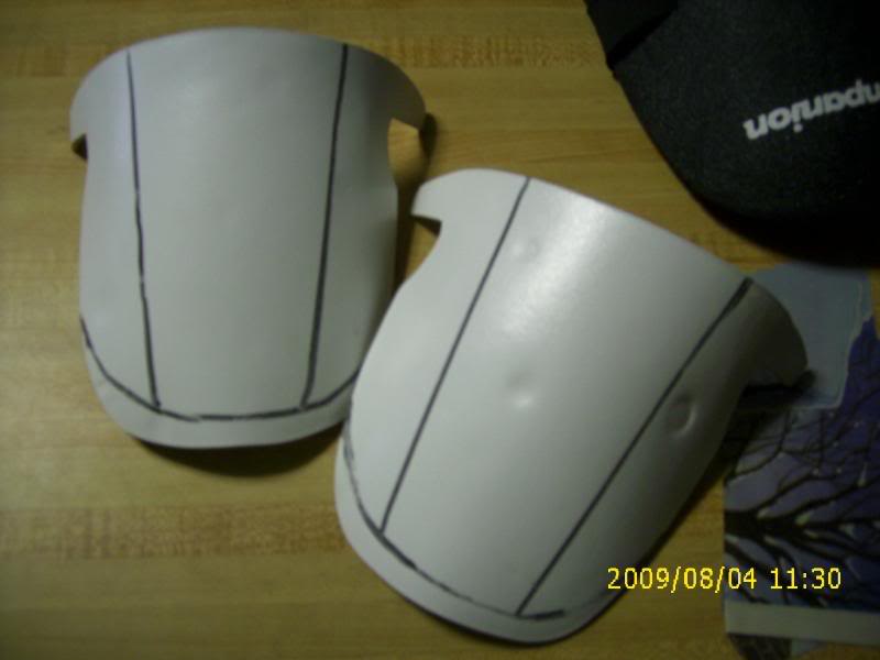

Next, I marked lines (with dry erase marker) for creasing and where I wanted to trim them on the bottom.

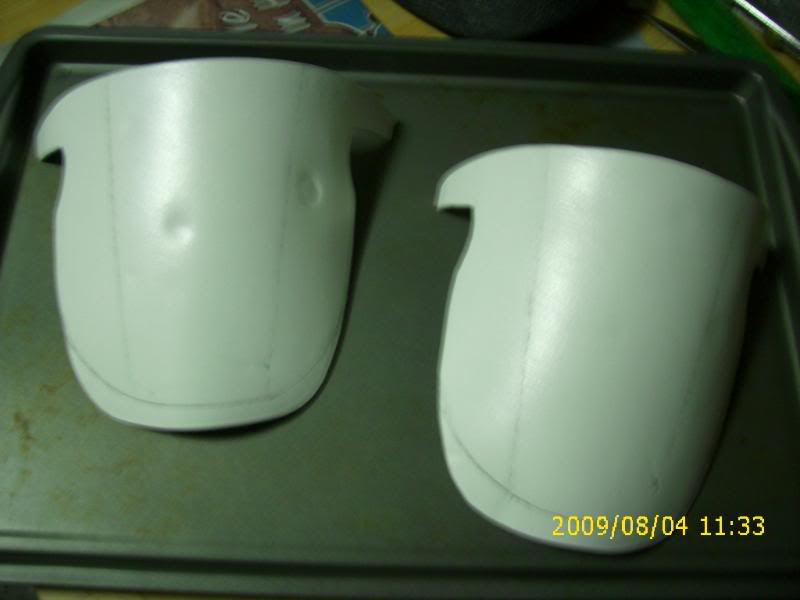

Wiped off lines after scoring a little, and ready to pop back in oven.
After creasing/trimming
On my knee
I will still use a heat gun to work on small areas a bit more, but other than that, just sanding, glue and paint, and these will be done! (I might add a few extras, though not sure yet) I swear, my oven hasn't seen this much action in a LONG time! :D
