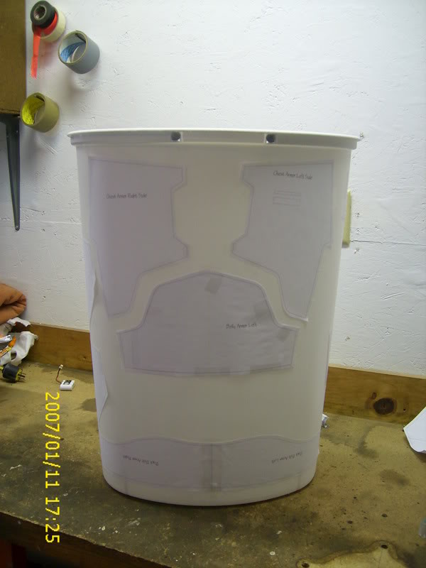

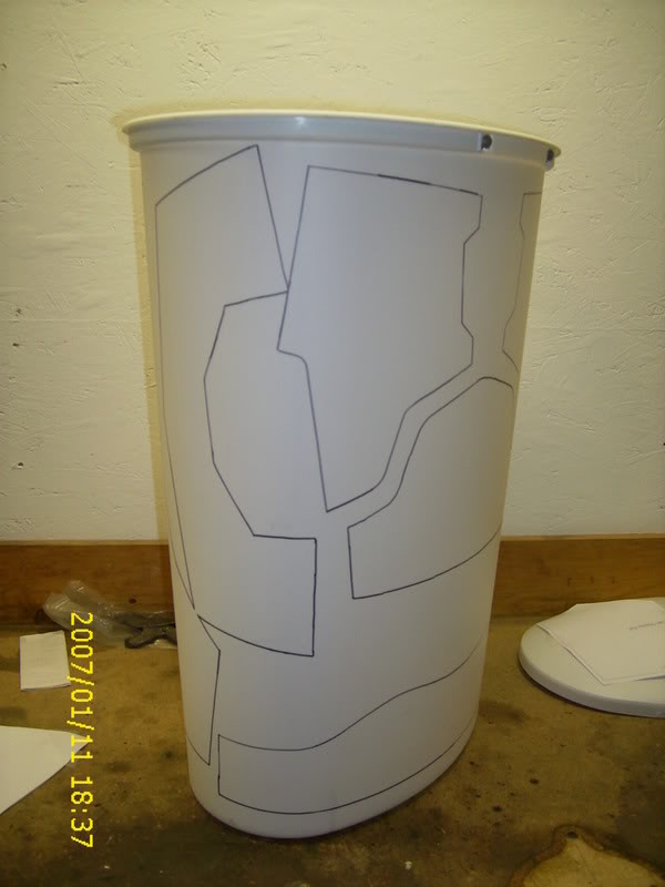

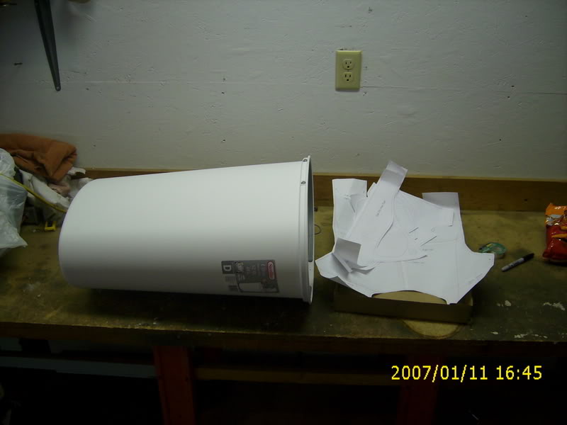

Anyway, I wanted to get a thread started for my own armor progress, starting with pics from the beginning:

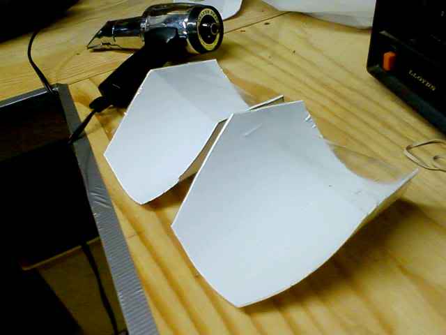

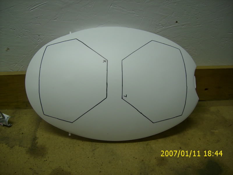

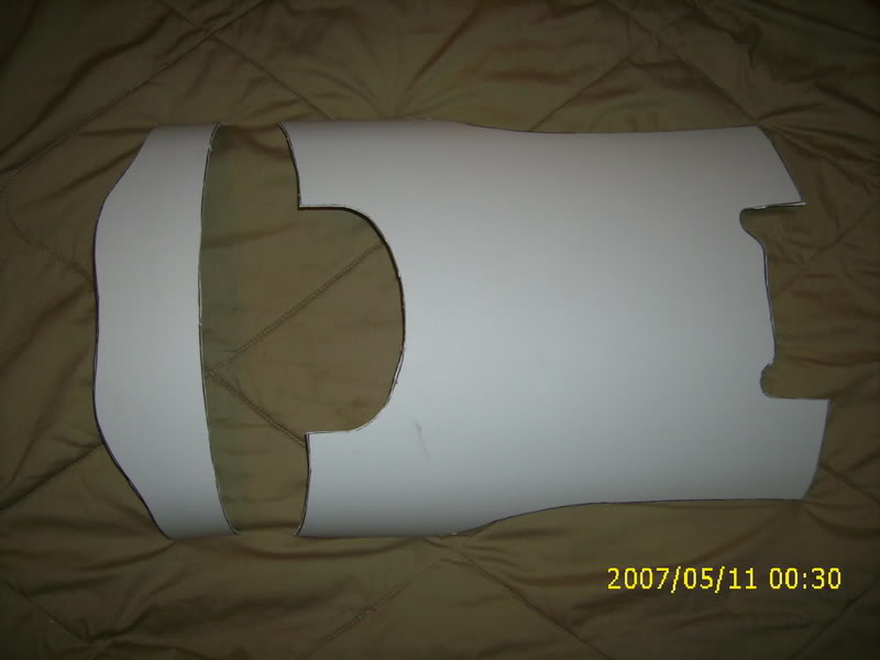

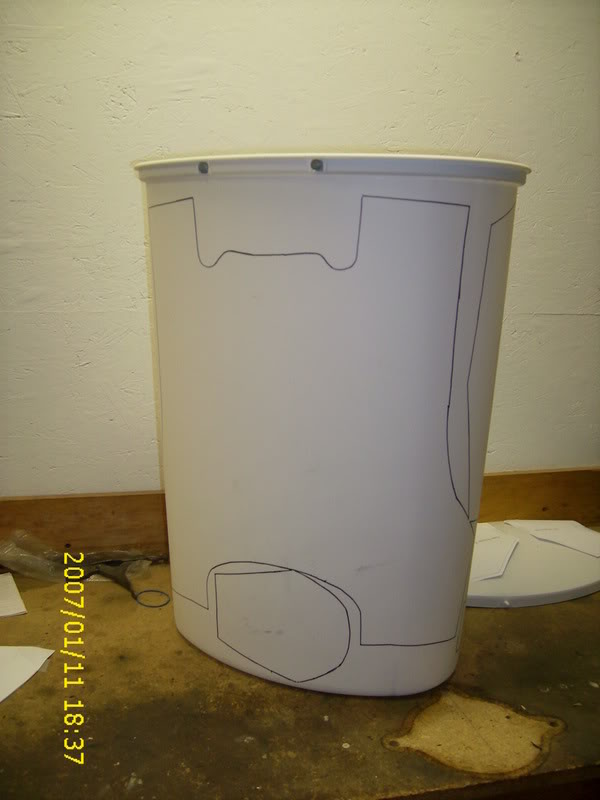

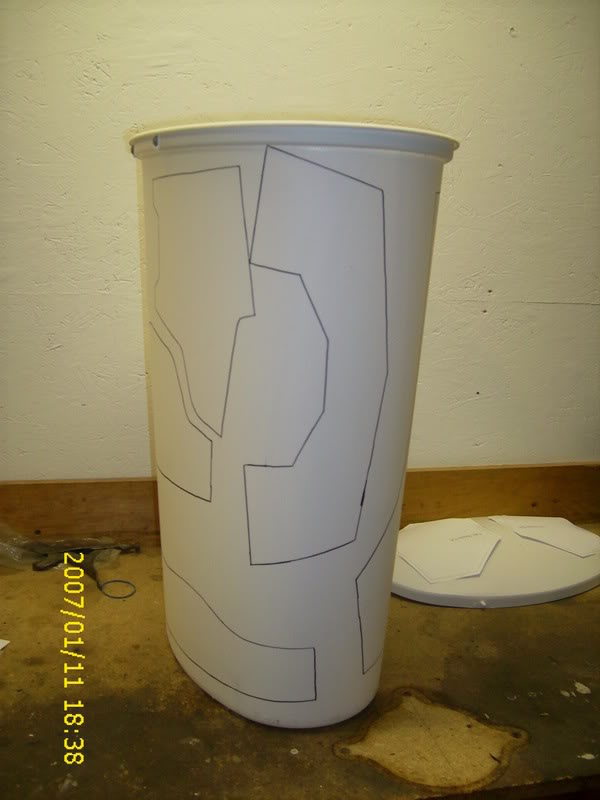

As you can see, I basically just started out with some trash cans, used WOF's templates, traced them--fitting as many pieces onto one can as I could. I kept in mind the curves of the can in association with what piece went where. I does help down the road when it comes to bending/shaping if necessary.

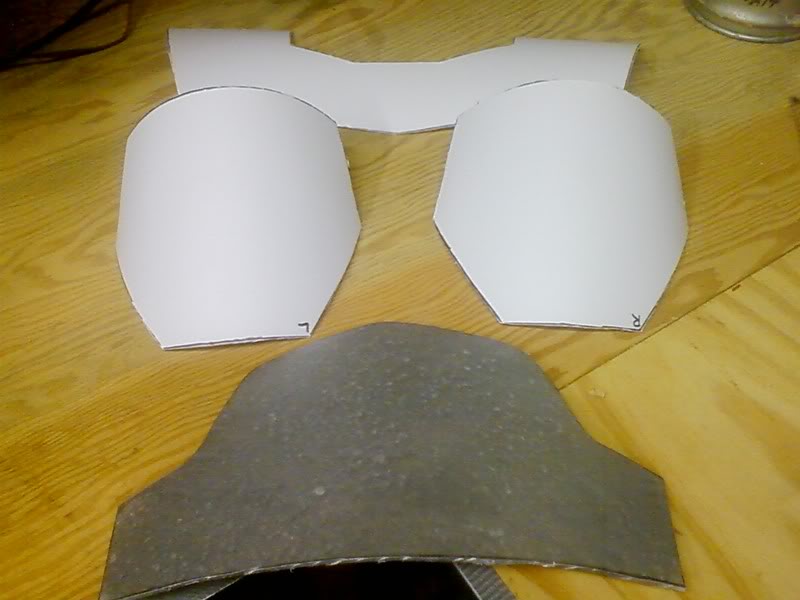

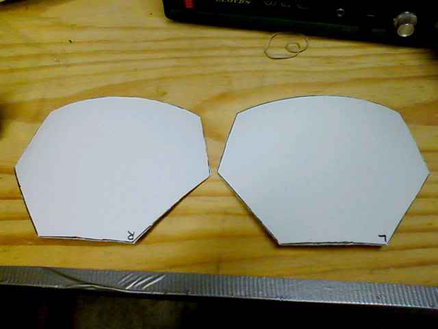

Got the pieces cut out:

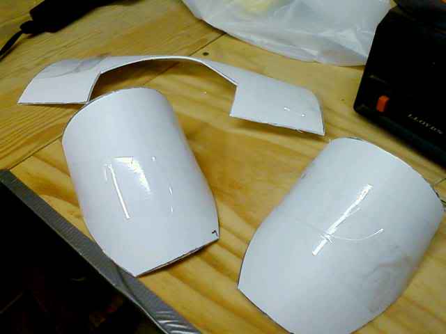

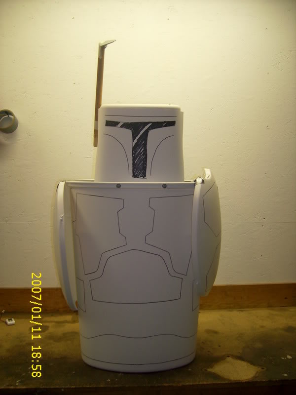

And started shaping:

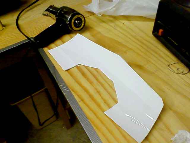

I basically just used a nice heat gun to soften the plastic a bit, curved it the way I wanted, then held that in place with tape (would have used duct tape, but had clear packing tape on hand, so used that instead).

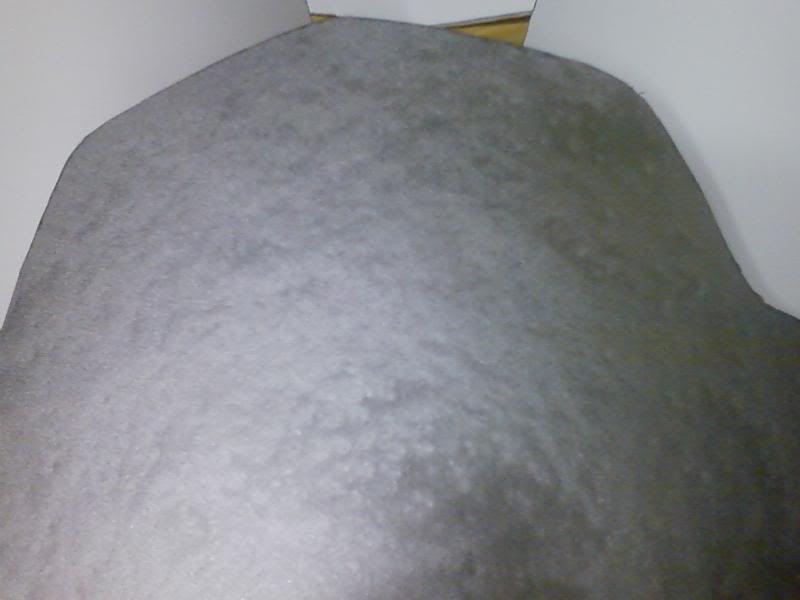

I also have the "belly" piece cut out and an actual coat of paint on it, but I don't have a pic yet. I don't have every piece of armor from the templates cut out yet, I believe, though I'm not sure what I'll do as far as a full cod piece goes anyway--probably just use what I have cut out so far. I'll hold off on any further progress with the body armor parts until I get my helmet done. I want to try to keep focused on one area at a time . ;)
And here's more updated pics:
After bending the collar and shoulder parts (what is the official name for those, anyway?) This also includes my belly piece with a coat of hammered metallic paint:
Close-up of belly part:

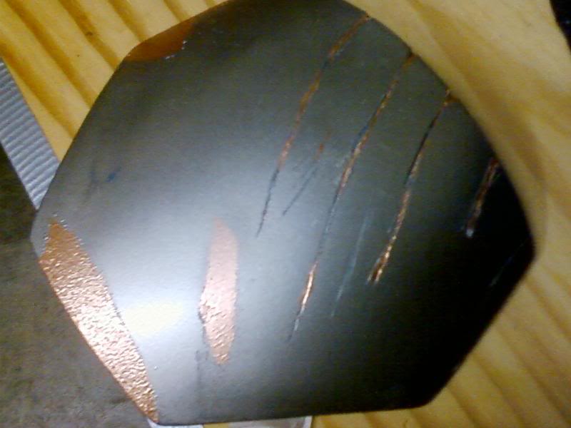

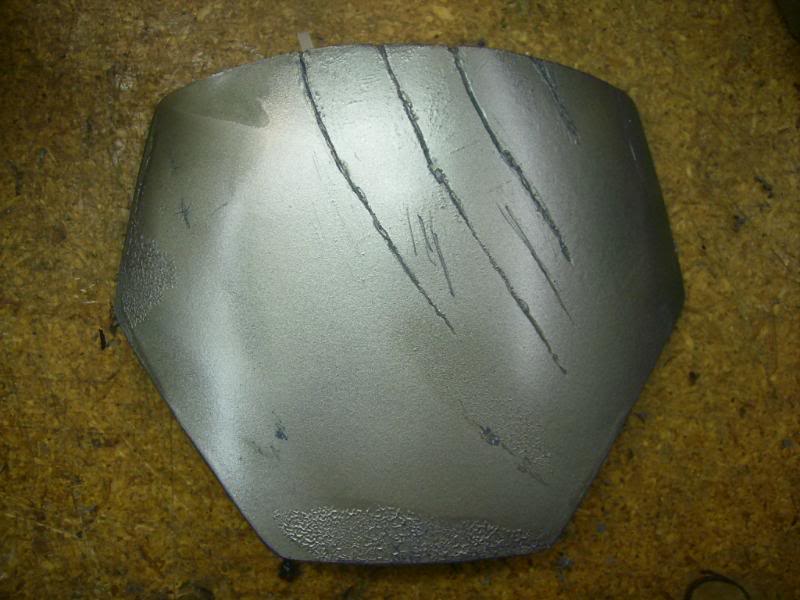

I decided to add some scratches to my right shoulder part--used a trusty dremmel tool! Man, those things are fun!!

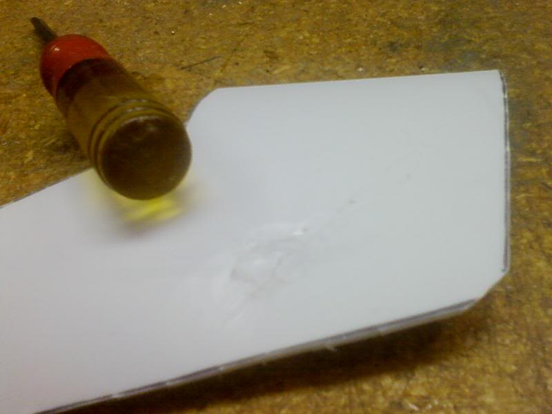

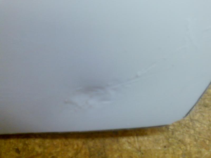

...and I decided to try my hand at adding a dent to the collar piece. I used a heat gun to soften one place on the plastic (almost too much--nearly melted on me), then used a rounded screwdriver handle to press a dent into it. I wanted to use a ball-peen hammer, but couldn't find one in my stepdad's stuff at the time, so I'll try that on it some other time:
Dented Collar (though will make more of a dent before painting):
Right shoulder part after top coat of paint and before using a razor blade to scrape away at the existing scratches to make more prominent: (I need to get a pic of the finished piece--thought I had one...

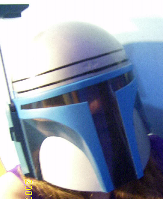

The day it arrived from eBay. I'm using the Jango Fett Rubies two-piece to start with.

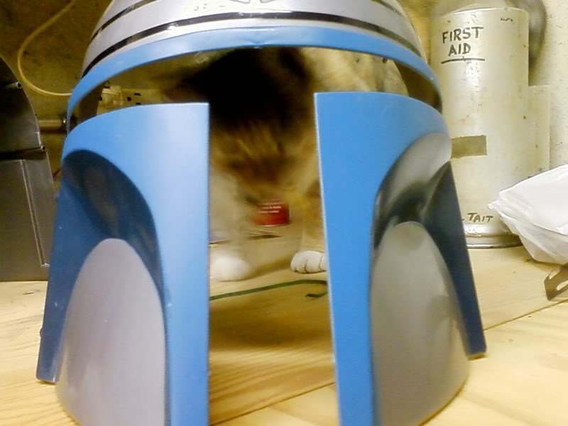

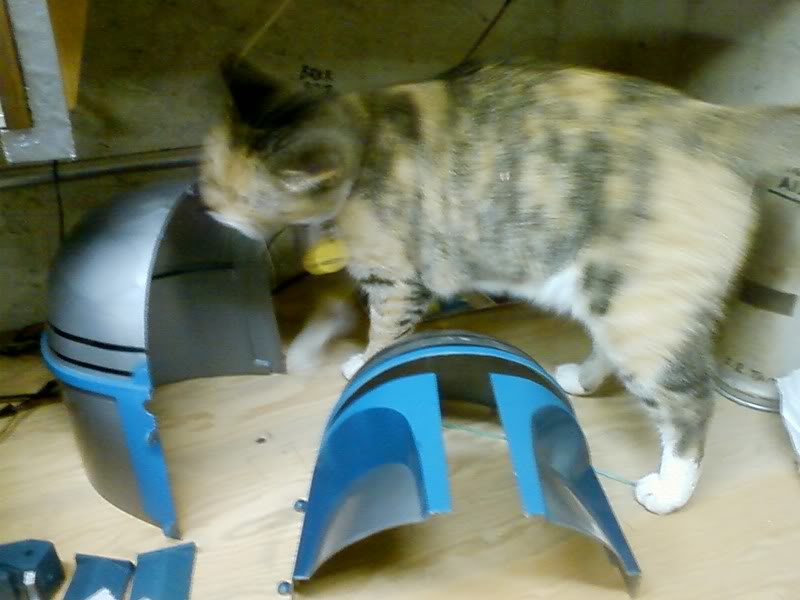

Here's my pics so far. I worked at my mom's, down in the basement in my late grandfather's official "larky farkin' " area.
Their cat, Scampers, is quite nosy...she kept me company though. :rolleyes: Sorry a couple pics are blurry--taken with cell phone.

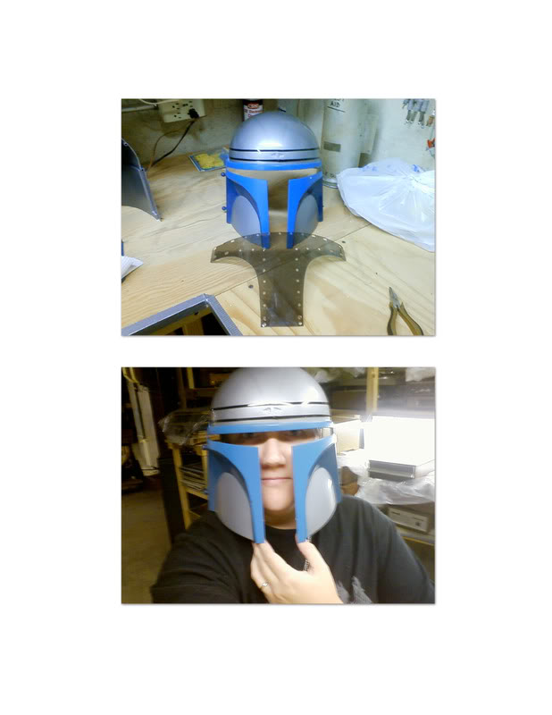

I couldn't help it--I wanted to get some paint on my bucket...but I avoided the seal area as I really want to get the visor tinted and put back in before I seal it together. Easier to work on when the helmet's apart, but, I wanted to test the paint and see how it might look when finished:
...and what the blue is going to look like:
One thing I forgot to do is remove the black striping on the helmet before I got started. OH well, I can still do that as I'm not done painting by far. They seem to be fairly easy to remove--some sort of really thin tape or something. Don't want them peeling off after I'm done! I'm not too worried about the paint layers, scratching, dripping and so forth as it will all add to the weathered look later on.
Why I didn't check out window tint when we stopped at a Menards on the way back from IN, I don't know. I didn't think of it until we were leaving the parking lot, but I did see a cool pair of black and blue work gloves that might be perfect for my Mando, with a little tweaking.
(Yes, all my painting is done on the floor for now--my stepdad is really into R/C model airplanes, so I wanted to make sure I avoided getting any overspray on his planes)
Helmet is pretty much going to be put on hold until I find the tinting I want and get the visor taken care of, then I'll seal the helmet together and be on my way! :D

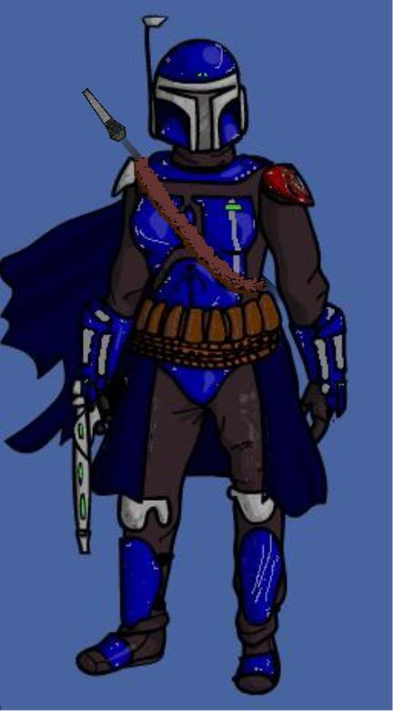

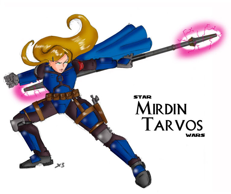

Yes, I do have a concept put together. Mirta Gev at Mandalorian Mercs made a MandoMaker template program, so I used that (great for trying out color schemes!), and then commander-13 at DeviantArt made up an awesome character drawing for me.
commander-13's drawing:
MandoMaker version, which I also added a few things in Paint:

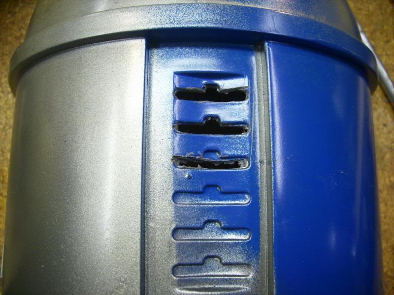

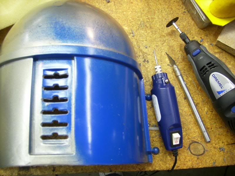

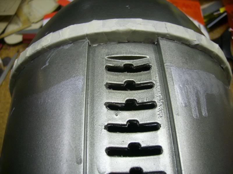

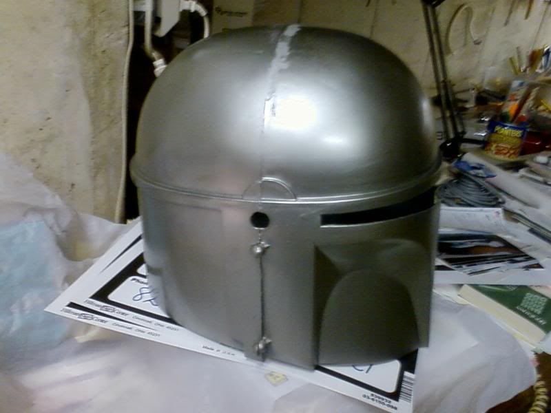

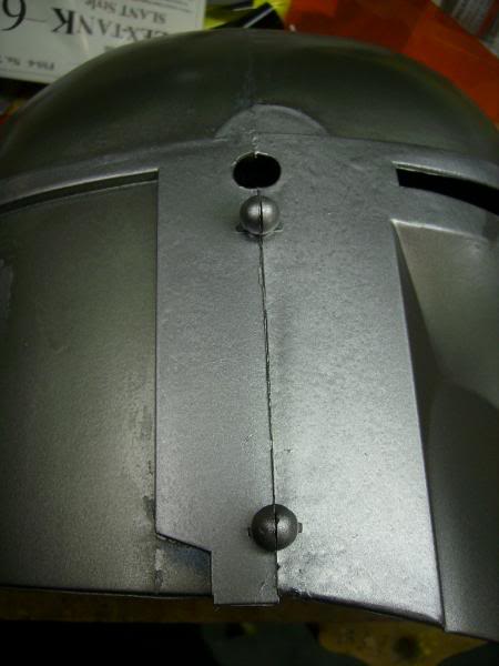

I cut out the keyholes--will put screening inside. Thought good for ventilation.

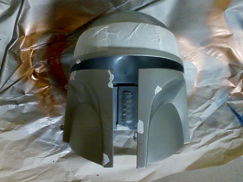

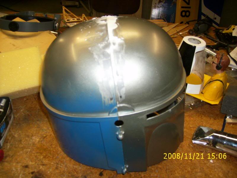

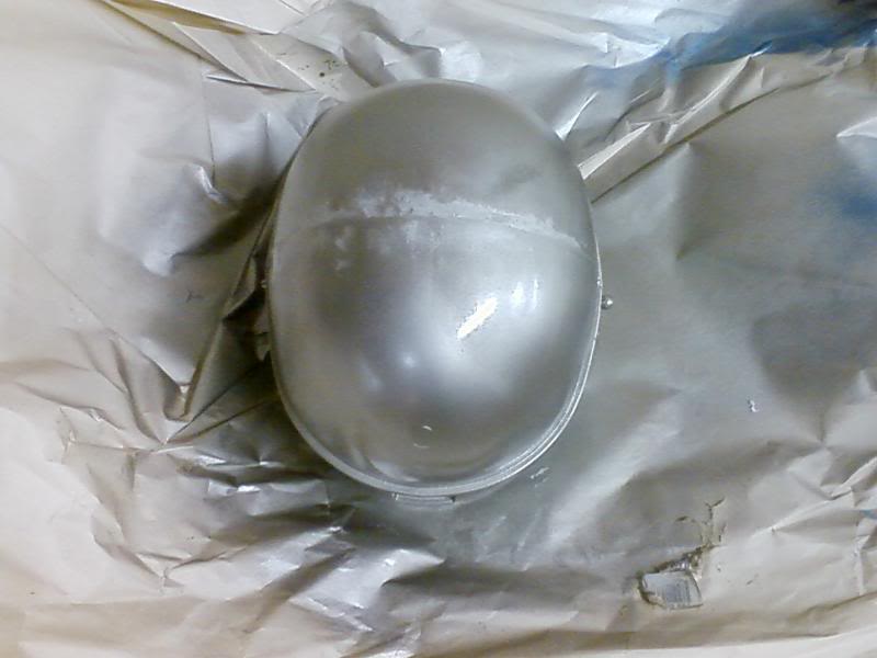

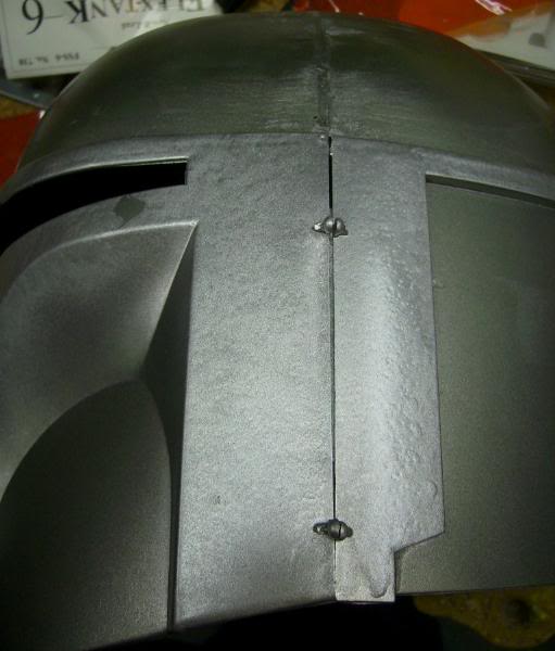

Starting sealing the two halves:
I'm probably going to have to sand it down a bit more. My stepdad helped with that part--we used a bondo type stuff made for balsa wood, but it's working well so far. He does a lot of model airplane stuff, so he's got a nice setup for tools, glues, and everything. These last ones are after spraying with a layer of metallic silver as an undercoat.
These are after masking and adding a layer of hammered metallic silver as the color for the visor surround.

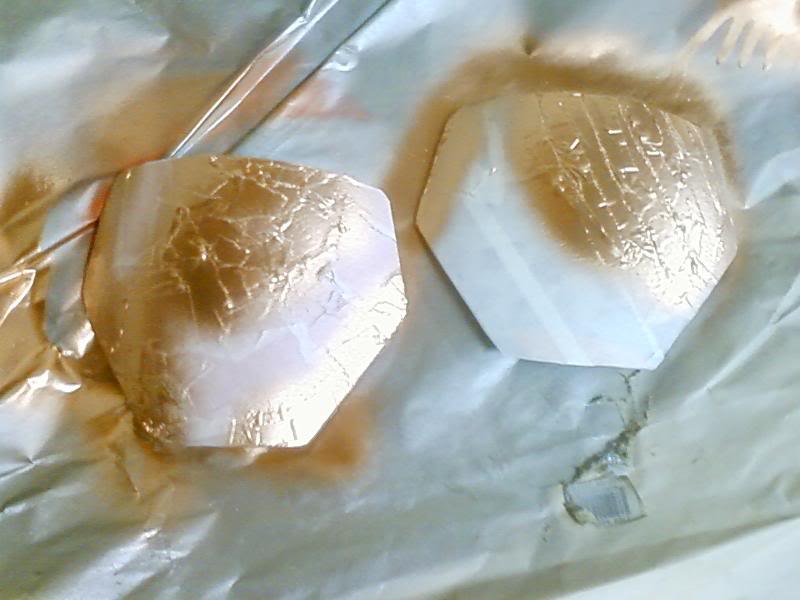

After adding some copper paint, though I'm going to cover up the big areas, leaving the claw marks as they are. It looked better without the copper. The bottom and side edge where the paint looks burned is actually from just how the paint happened to settle,and I liked the look.

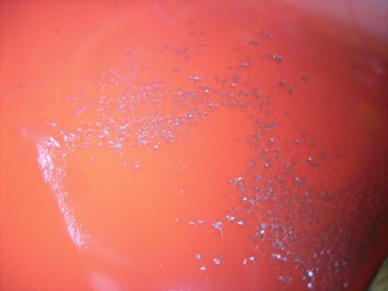

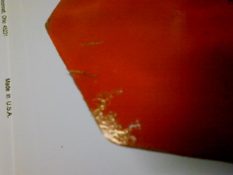

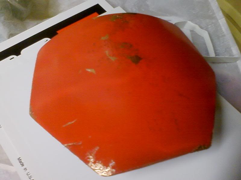

Left Shoulder before copper, and effect is from paint reaction. I used Kilz spray on top of Krylon Fusion, and while it is a bad reaction, it looks good for this!
After adding copper (copper color is Rustoleum for plastics--looked too pretty to pass up!)

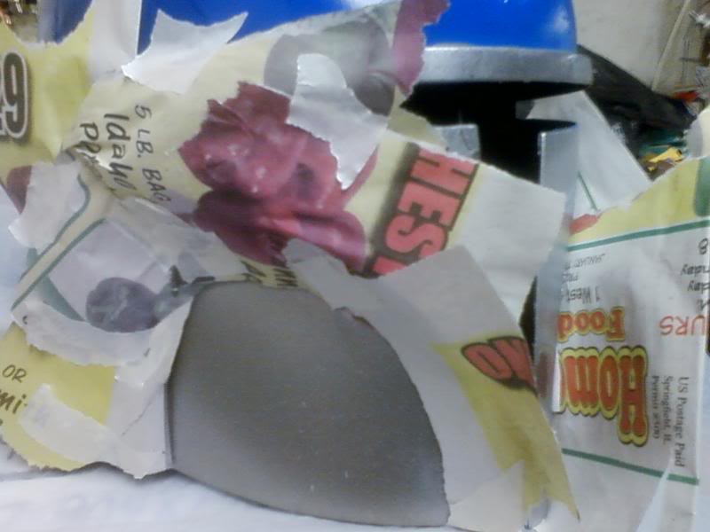

Masking
I only had a roll of wide paper tape at the time, so that's what I used, but will use newspaper or plastic bags in the future for larger areas :facepalm

Shaping: I think I'll need to shape the pauldrons again as they seem to have flattened out a little, but I'll just see how they work on my shoulders first.
I did finally get a few "For Sale" signs at the store as has been suggested by fellow forum members, played with a piece of one just to see how well it performs when heated and formed, how well it keeps shape, and it looks like I could have a lot of fun with them! oohhhh I have pieces big enough to make my chest armor (y) *I've got to focus on one thing at a time--helmet first! lol* I might get started on the ear pieces this week.
A good technique for shaping the pauldrons is to use a large crystal ball, something around six inches or the top half of a three liter soda bottle, just cut the spout off. I work for a leather shop making armor and that's one of the processes that we use for shaping the leather with excellent results.
I might try one of those, Lath. I just heated up the plastic and taped it in the shape I wanted for at least overnight the first time. My mom might actually have a crystal ball ;)

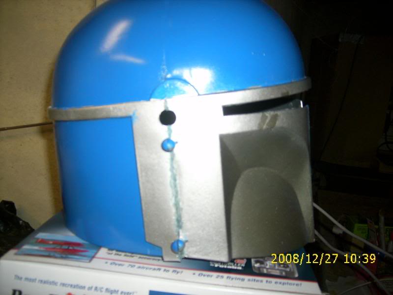

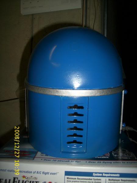

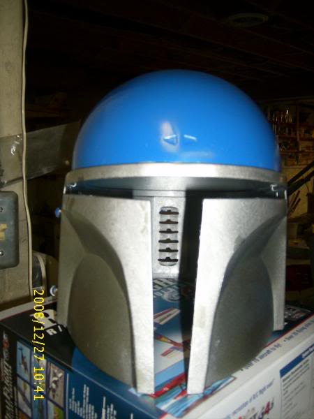

Here's some more pics of my helmet WIP. I did some more painting, though still a ways to go. Now that the holidays are over and a new year has begun, I'll hopefully get this done soon.

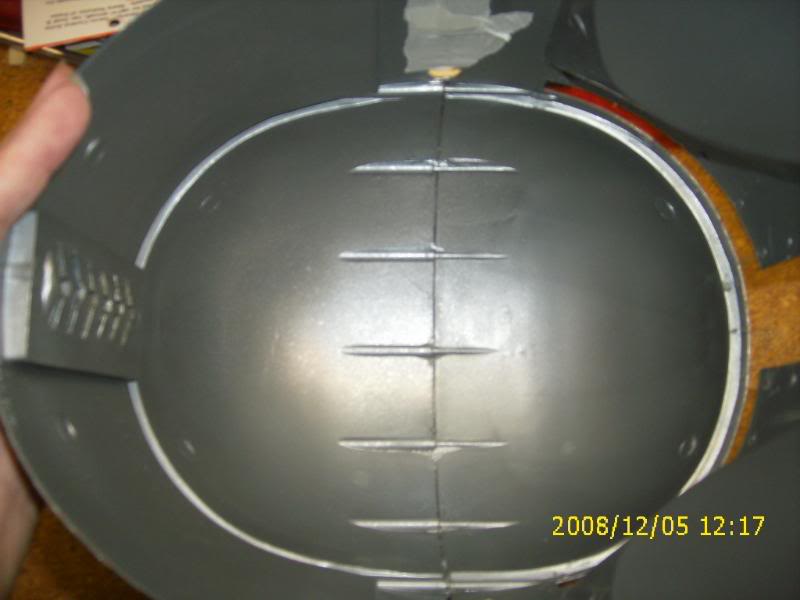

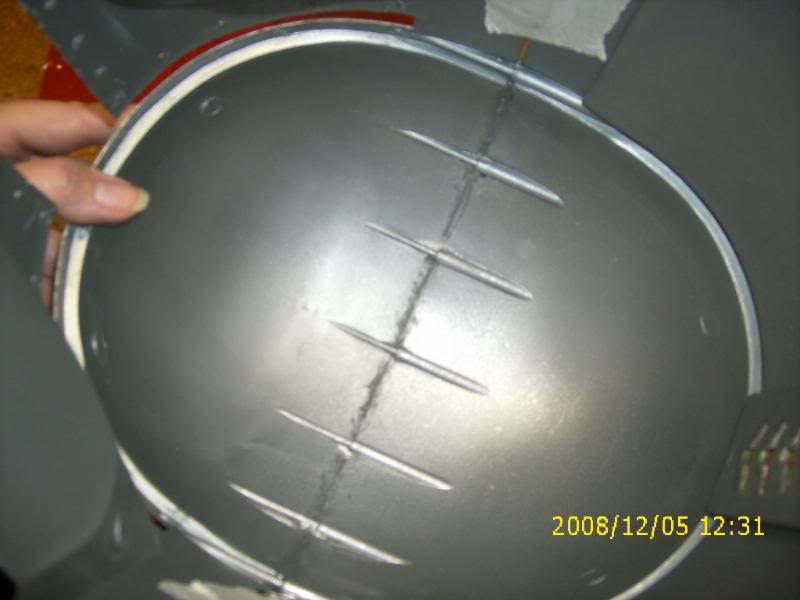

Helmet interior before I sealed it up a bit more. The outside seemed to tighten up a bit too (didn't get a pic of that), and looks better than it did before. Not pretty, but it's inside--won't be seen. This was a stinky operation--melting plastic... :-X I do usually wear a mask and safety glasses when working on this stuff.
After

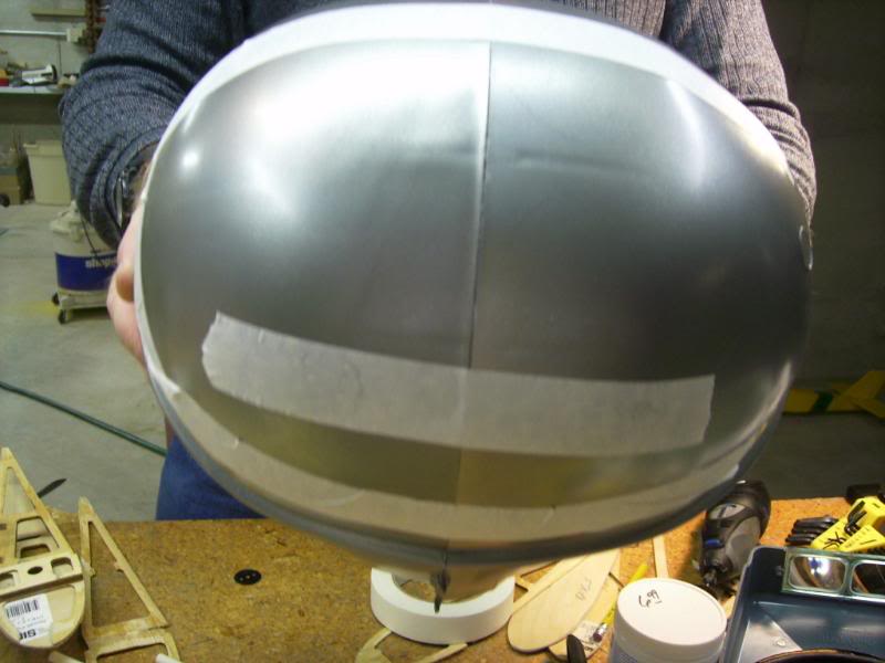

Right side/Left side exterior--you can see the difference between the two silver colors I used. I sealed the sides up a bit, but they won't show much anyway after the ear pieces are on.

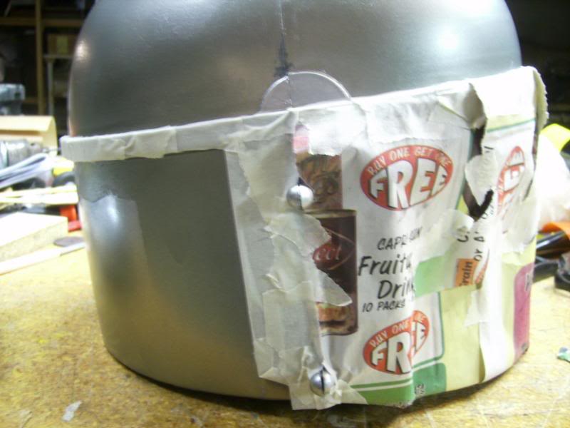

Masking took most of the time. I covered the band that wraps around the back as I wanted that to stay silver, so I used the tape for the small stuff, paper for the larger areas. Looking at detailed pics, I think I'll go back in to smooth out the keyholes as there's still a few rough parts.
It's alive!!!...uh...blue!!
And as my record is going, I neglected to mask any weathering, so I'll be using the same technique as I used on the shoulders. It seemed to work well anyway. I might use some steel wool to add scratches to show silver and mask to add copper. I did something similar when I painted my daughter's clone blaster for her costume. It looks like the blue will not stick to the balsa wood filler, so I'll try to paint that in with some acrylics when I'm at a touch-up stage.

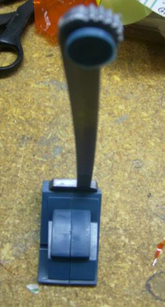

Grabbed the range finder to get started on at least one more part. I just painted part of the base coat.

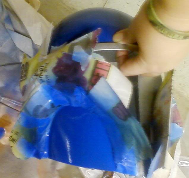

I can't wait to peel the masking off and see how the blue turned out.

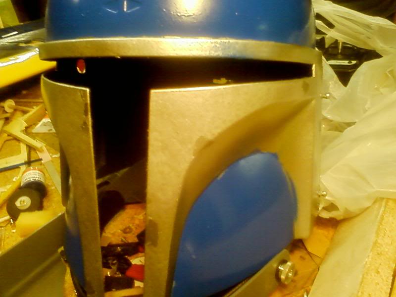

Worked on my helmet just a tad during the busy holiday time. This I did just on Saturday after a couple weeks' hiatus from working on it:

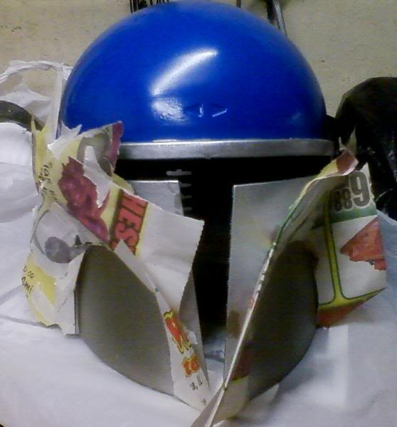

Helmet front after tape masking taken off:
Right side:
Left side:
Back:
There's a few spots I need to touch up, (like the top of the "ear" on the right side) but overall it's coming together nicely. I still need to paint the "cheeks" the dark blue, and then the majority of the painting will pretty much be done--the rest is pretty much just detailng.

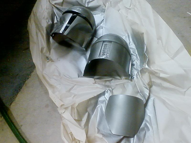

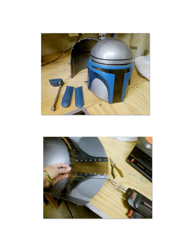

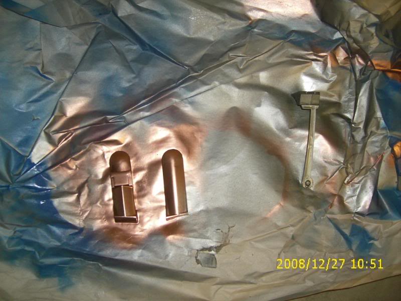

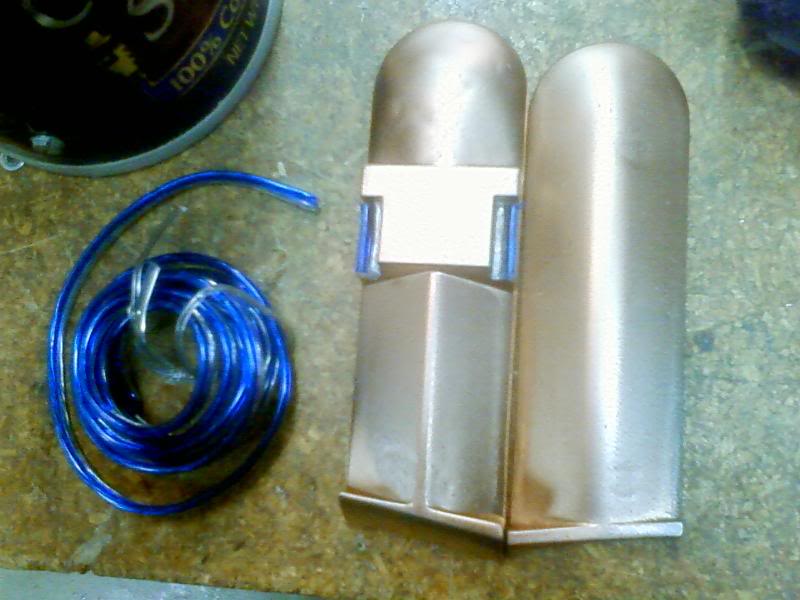

Here's the ears and RF. I painted the other side of the RF and finally started on the ears. The copper paint is not for plastics, and I forgot that, so not sure if it will stick--we'll see. I meant to do the silver first, THEN copper, but I'll get it to work.
And doesn't the protecting paper underneath make it all seem like a work of abstract art? lol

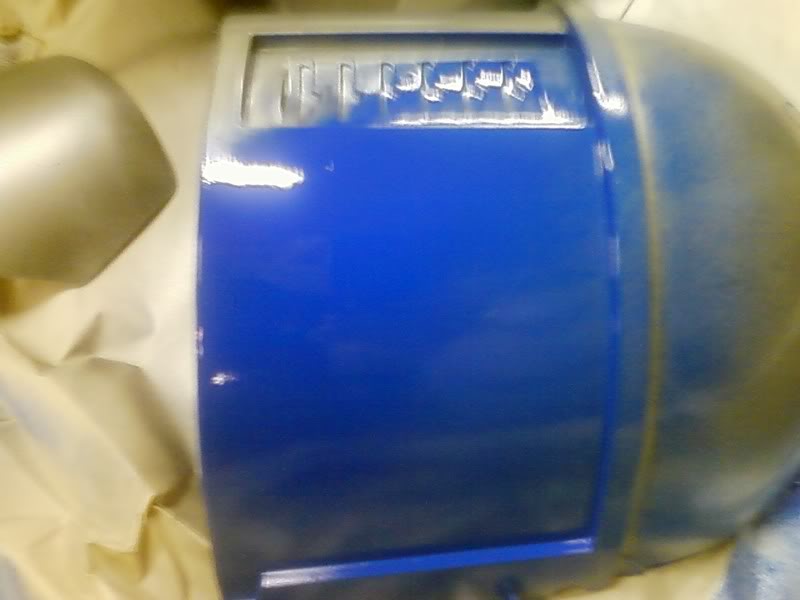

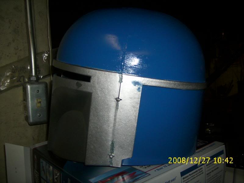

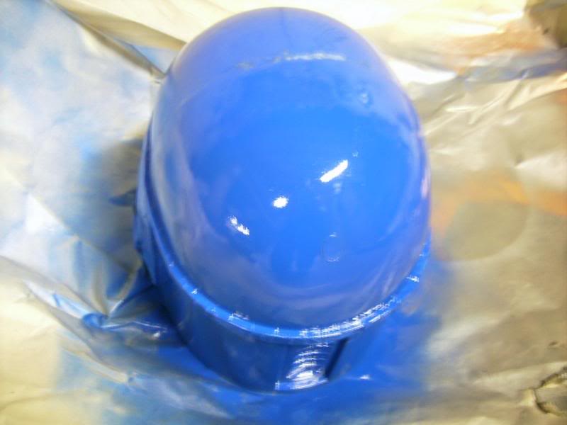

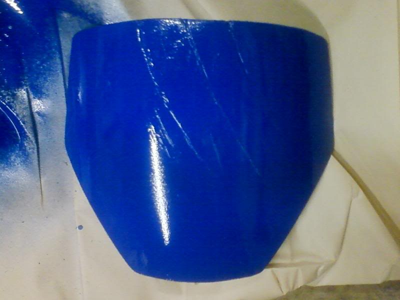

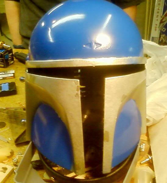

Masked the cheeks then painted the blue
I need to do some touchups, but I'll be painting a dark blue on the mandibles, so that'll cover any of the other blue that might have oversprayed, and I'll be more detailed with the masking.
The blue paint looks like it might work okay after all! Here's the latest pics I have from when I did some work on the ear pieces:
got a tad more worked on this past weekend---

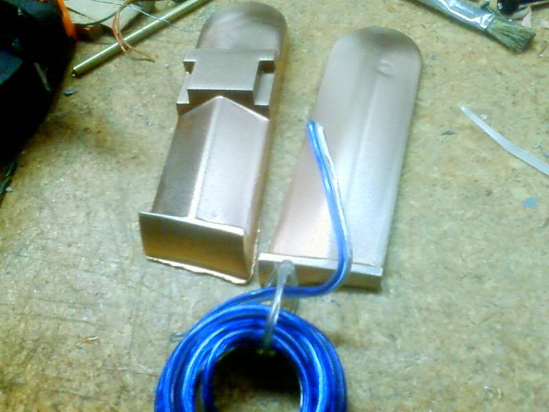

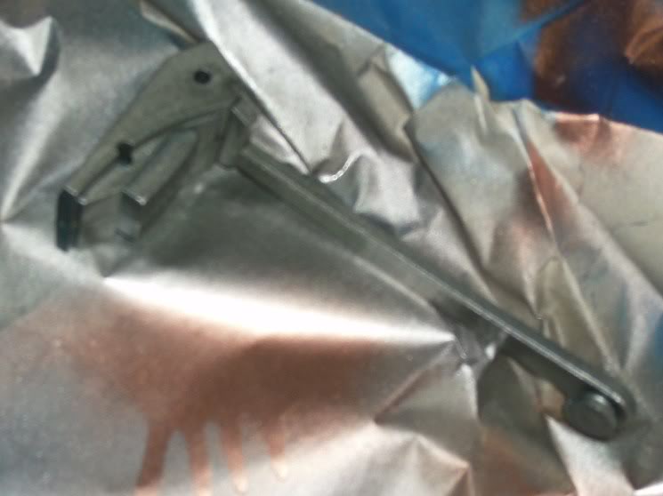

The "ears". I found some interesting wire remnant that was blue and silver in color, so I thought it'd be a nice little addition to the ear piece.
I still haven't done anything on the inside nor finished the visor, still still plenty to do!
