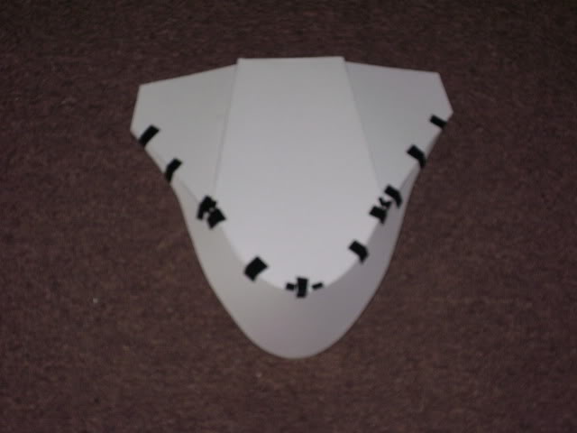

since i'm waiting on my mow jetpack to get here, and i need to make some money before i can order cruzer CC gaunts, i thought i'd try out making some parts of the armor myself. i plan on making the cod, thighs, shins, and boot armor out of sheet aluminium using the WoF templates. but before i jump in and start cutting on the alu, i figured i should make up a mock out of poster board just to make sure i've the the templates figured out.
so i started off with what i consider to be one of the more difficult pieces, the cod. after printing off the templates and getting them all taped and cut out i realized there were going to be some modifications necessary. i've seen plenty of people make really good armor using alans templates, but i'm always a little disappointed with the cod. it seems that most times they're just bent back at the bottom. i wanted something with a bit more "cupping;" i want a cod with the appearance of keeping the boys safe. so i cut up the templates and started making changes where i thought it would work best... i've got a better idea, i'll just show you guys.
any thoughts, comments, or criticisms? please share.

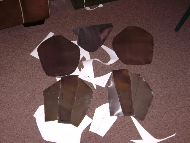

i know what i am capable of with making myself, and i'm doing up a good chunk of the armor for this out of sheet aluminum. i've been playing with WoF's jango templates in paper form and now i've drawn them out on the aluminum sheet and rough cut it. here's most of the cod, the thighs, and shins. i have to get another smaller sheet for the cup of the cod and the boot armor. my plan is to get at ace hardware again on monday for that. until then i've got some dremeling to do to get these cut a little better, and if i get done with that early i could start bending and folding what i have so far.

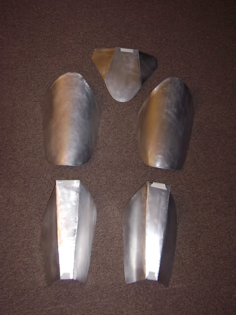

here goes with some more progress on cod, thighs, and shins. everything is fine cut and rough sanded (320 grit so far, going to up the grit after i give the insides a thin layer of fiberglass to give it a bit more rigidity). everything is held together with masking tape right now. i'm going to the hardware store later today to find a good epoxy for aluminum.

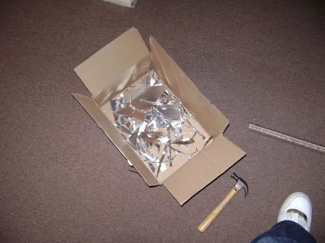

and here is a box of flash i'm showing off as my WIP.
part of me really wishes i made this out of stainless steel so i could use a big ol' magnet to help clean things up.

That looks great! What tools did you use to shape the Aluminum? How thick are the Aluminum sheets?
they're not very thick, .025, i don't know what gauge that equates to. but the tools i used were a pair of tin snips for rough cuts; a dremel with cutoff wheels for fine cutting (i learned that you don't need to cut all the way through with the dremel, just get a good score line going with it and then you can snap the rest of the flash off with your hands or a pair of pliers.); then along the lines that i need to bend i would lightly score it with a box/utility knife (because that's made of stainless steel it's harder than the aluminum and cuts through quite easily.); and small flat head hammer with a block of wood to help bend the edges; and finally i used my hands for getting the shapes correct. a few extra items you may want around while you're working on this is a good pair of gloves because aluminum is sharp when it's cut with snips and gets hot when you're running a dremel over it, a face shield cuz snips or dremel you don't want to run the risk of something flying into your face or eyes, a mouse sander because you will find a use for it sooner or later. i foolishly bought an angle grinder that i didn't need just for this project, i'm going to keep it because i know i will figure out some project that it will be perfect for.
