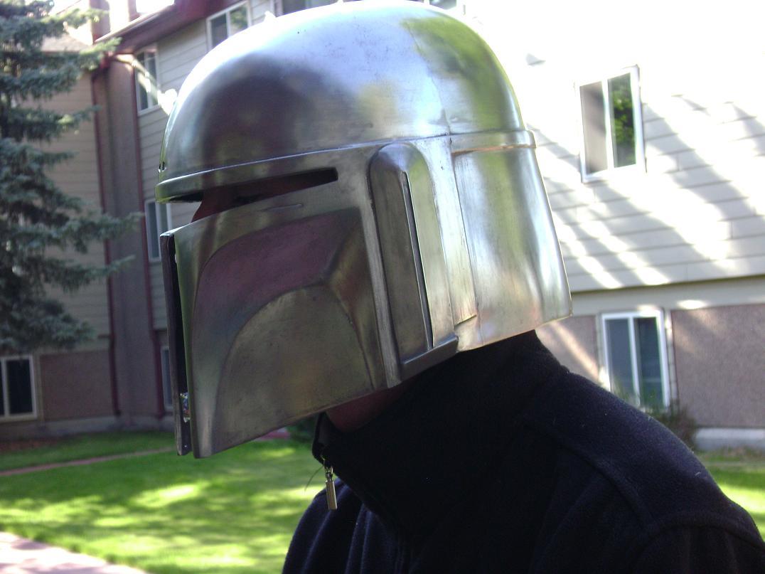

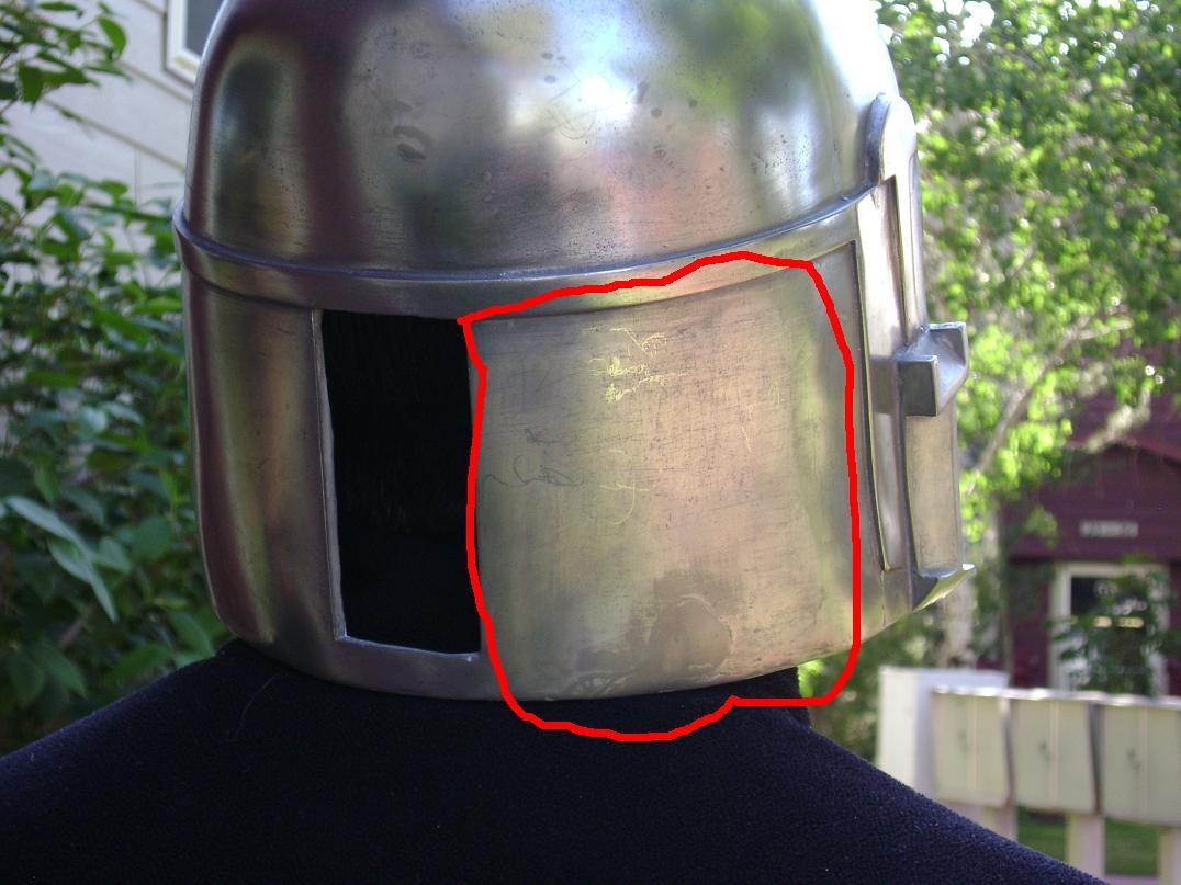

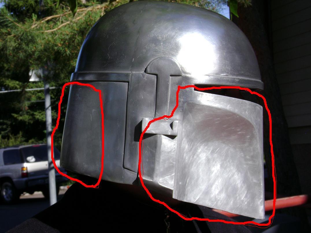

found my camera and got some pics while i still had plenty of daylight.
the red circled areas are where i haven't used the metal polish yet. those parts are sanded to 800 grit right now.

Looks pretty sweet buddy! I've been working on my asok jango bucket quite a bit as well. I'm really itching to paint and weather it, but I still need to get that cut seam blended!

Good job! The polished parts look really nice.
Asok does a great job on those helmets.(y)

I've heard several different things on the sanding of CC; which is suppose to be better for it though; steel wool or the sandpaper?
TLobe00
usually you sand it to get it smooth then "shine" it with 0000 steel wool.
