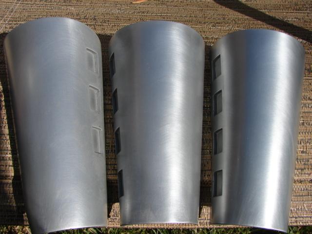

Actually, these pulls are taken from my kid gauntlet molds. I figured I'd use them for the test pulls since they're just like the big boys that will be finished soon!;)
Autosol car polish is great for bringing out a good finish on cold cast parts, I use it monthly on my dr who cyberman helmet, it sounds like you got the mix right it needs to be around 80% aluminium, thanks for sharing the progress:thumbsup:
Just wanted to share a comparison of the cold cast test pulls.
Pictured below are the three test pulls placed side by side based on aluminum powder ratio: 66%,90%,& 125%. And a close up pic of the 125%. I'm satisfied with the 125% mixture for my Jango gauntlet molds.
Other than a small price difference and the required buffing, there really wasn't that much difference between working with the cold cast materials and the aluminum filled resin from Smooth-On that I already use for my backplates and kid gauntlets.:thumbsup:

That looks fantastic, where do I sign up for gauntlets? :lol: Im a huge fan of cold casting as it really does yield great results, all those years trying to get a good metal finish with paints
Thanks guys. I like seeing how the shine intensifies from left to right in the comparison pic.
I had some left over aluminum, so last night I actually mixed up a mixture consisting of 150% aluminum. It was difficult, however possible, to brush into the mold, but I'll be sure to post pics of the results.:thumbsup:
