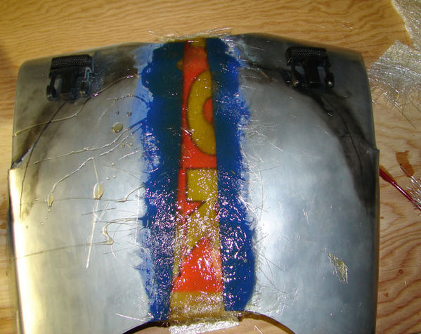

okay...so now that ive had some time to take a deep breath and try and figure out a solution....i began to come up with something...not sure how it will turn out cause ive never done anything like this before...
today i cut my back plate in half...from top to bottom...i then heated up a curve in the armor so they side would come closer to my shoulders and create the actual curve that was missing in the backplate ive got atm....i then used a sintra sign to hold the two pieces together and then fiberglassed in the void with resin and matte...here is the progress thus far....
i will then fiberglass inside to create more strength in the repair and then bondo the outside for a smooth finish. I also have to bondo near the arm pit area cause both sides bent and cracked when reshaping the backplate.
I was able to reshape the backplate by using a lighter to heat up the curve i was looking for. once it was hot enough and was able to bend, i warped it and ran that section under cold water to set the new shape. It's not perfect but it allowed the shoulders of the backplate to curve properly and it works better for my shoulder placement.

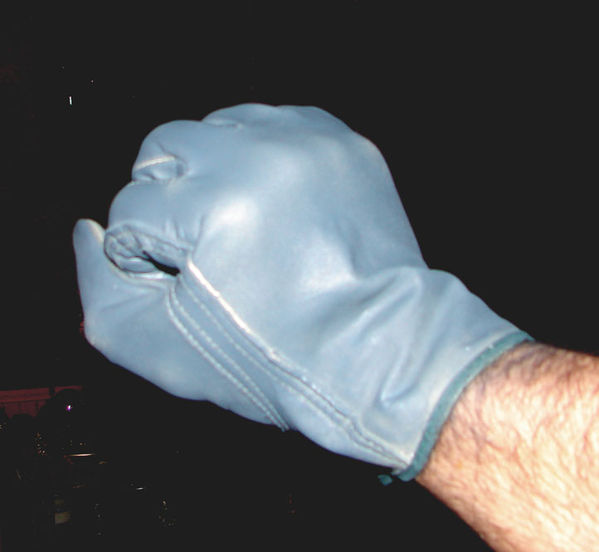

i also finsihed up my gloves...simple gardening gloves...same as jamie's zam gloves...I used an upholstery spray color that was close to get the color i wanted...it's a flexible paint...it needs touch ups every now and then but it will do seeing as i can't fit my hands into girly gloves..lol
flash
no flash
