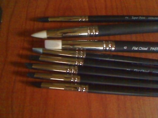

I guess it may be a combination of both. I don´t have experience with other maskign fluids as I always used this one and it works perfectly. The technique of brushing it on may be a point too. I use a very small brush that I have cut at the tip in 45°. this way I can put on very small points and bigger areas with the same brush. After I have put on the base form of a scratch, I use a latex brush and somethign very thin (e.g. a tip of a self propelling pen) to add some little edges and scuffs into the still wet fluid. This way you can achive the desired look for all the scratches. Just bobbles would look too simple and not authentic in my eyes.
Hope this helps bro!
That's what you need for the masking fluid. It's basically a "rubber brush". It's absolutely awesome, as it doesnt get stuck and clogged like a regular brush, and it's very accurate as far as where you want your strokes to go. Terminal Fett uses these (specifically the Angle Chisel 0 Soft).
Looking online ive found them...any tips on what types are the best all around to have? Dont really wanna buy a ton of them as theyre not cheap as with any nice brush
I really need to look into those rubber brushes! That would speed up my painting progress 10 fold. I currently just use a toothpick, and that can take forever.
