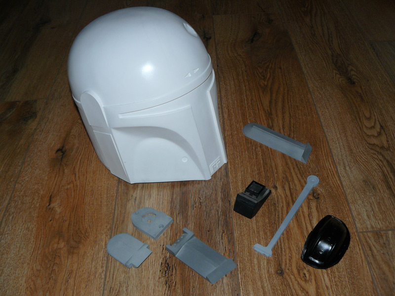

Step 0: The base kit as delivered by FP. You can see no visor, because this order was placed before the premium got the visors too. Sometimes it´s hard to be one of the first ...

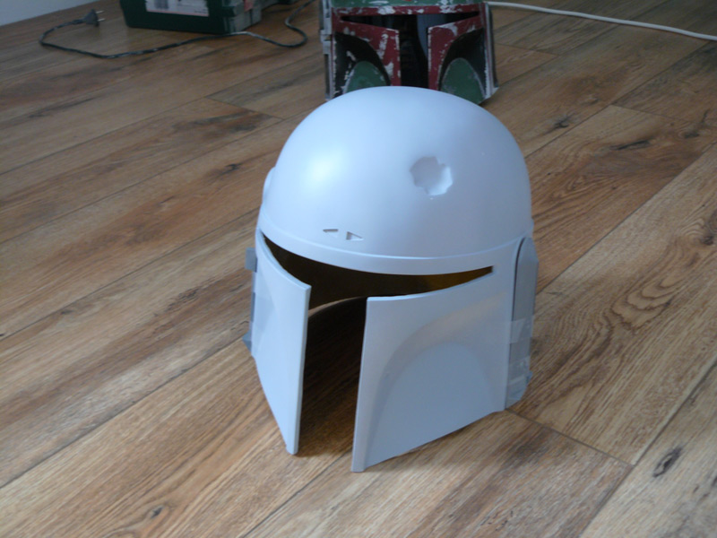

Step 1: The visor is cut and first layers of light grey primer are on (fixed the ears with tape to get the feeling)

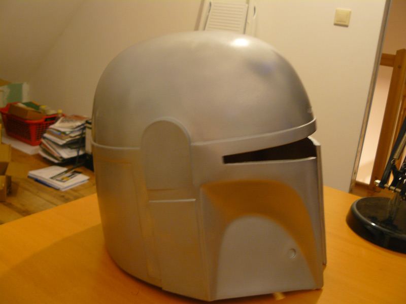

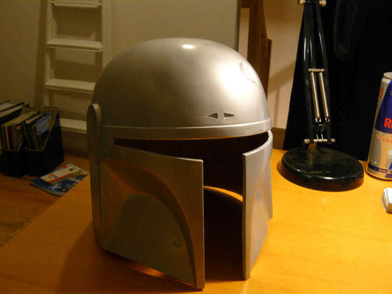

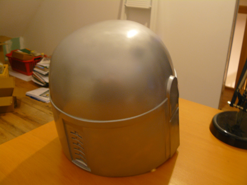

Step 2: Two layers of silver [Humbrol No. 11] as the first (visible
) Paint
