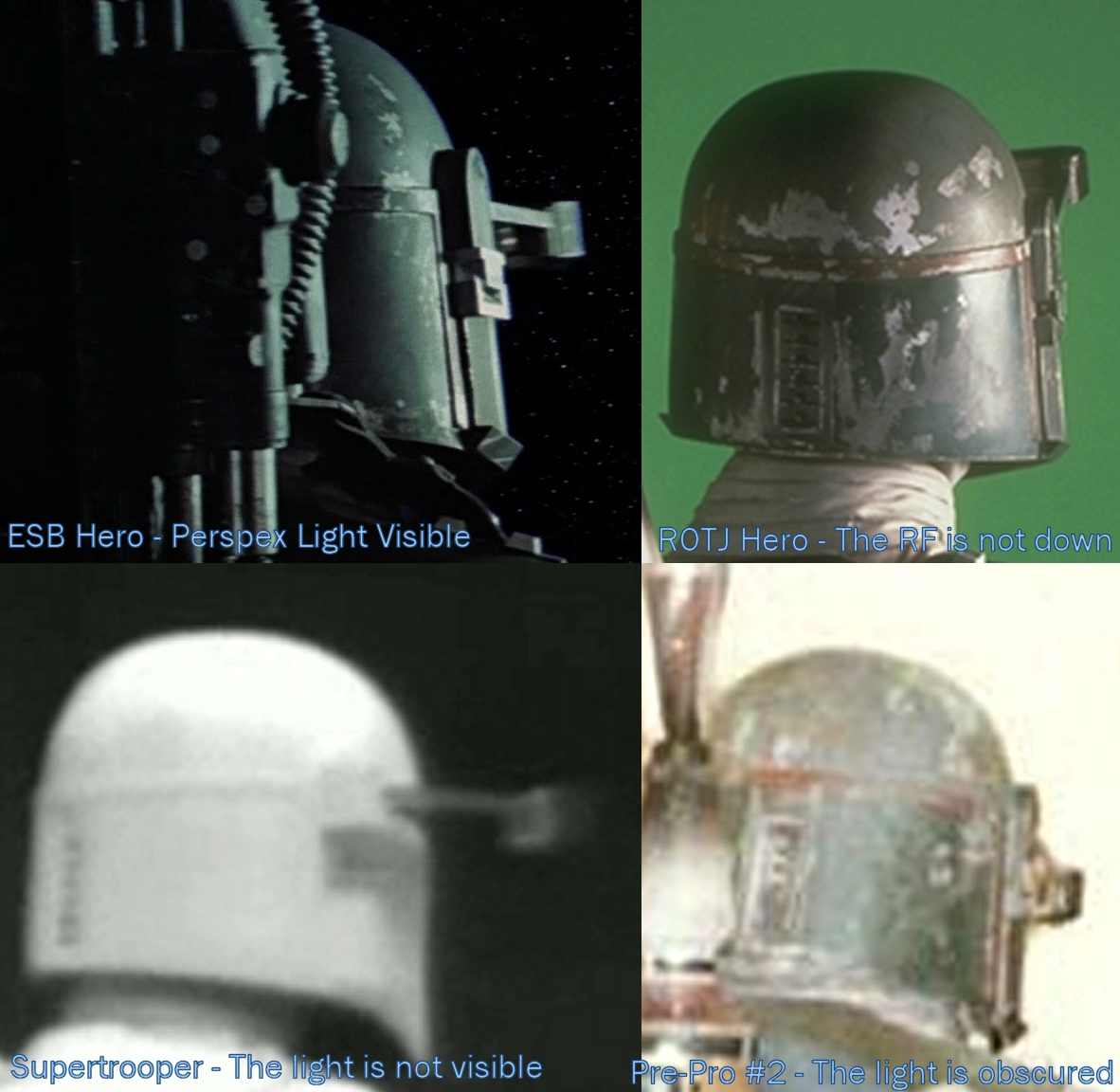

So, all this madness started when I replyed in this thread ==> My ROTJ Fett build WIP. It was OK at first, but while I did my second reply...

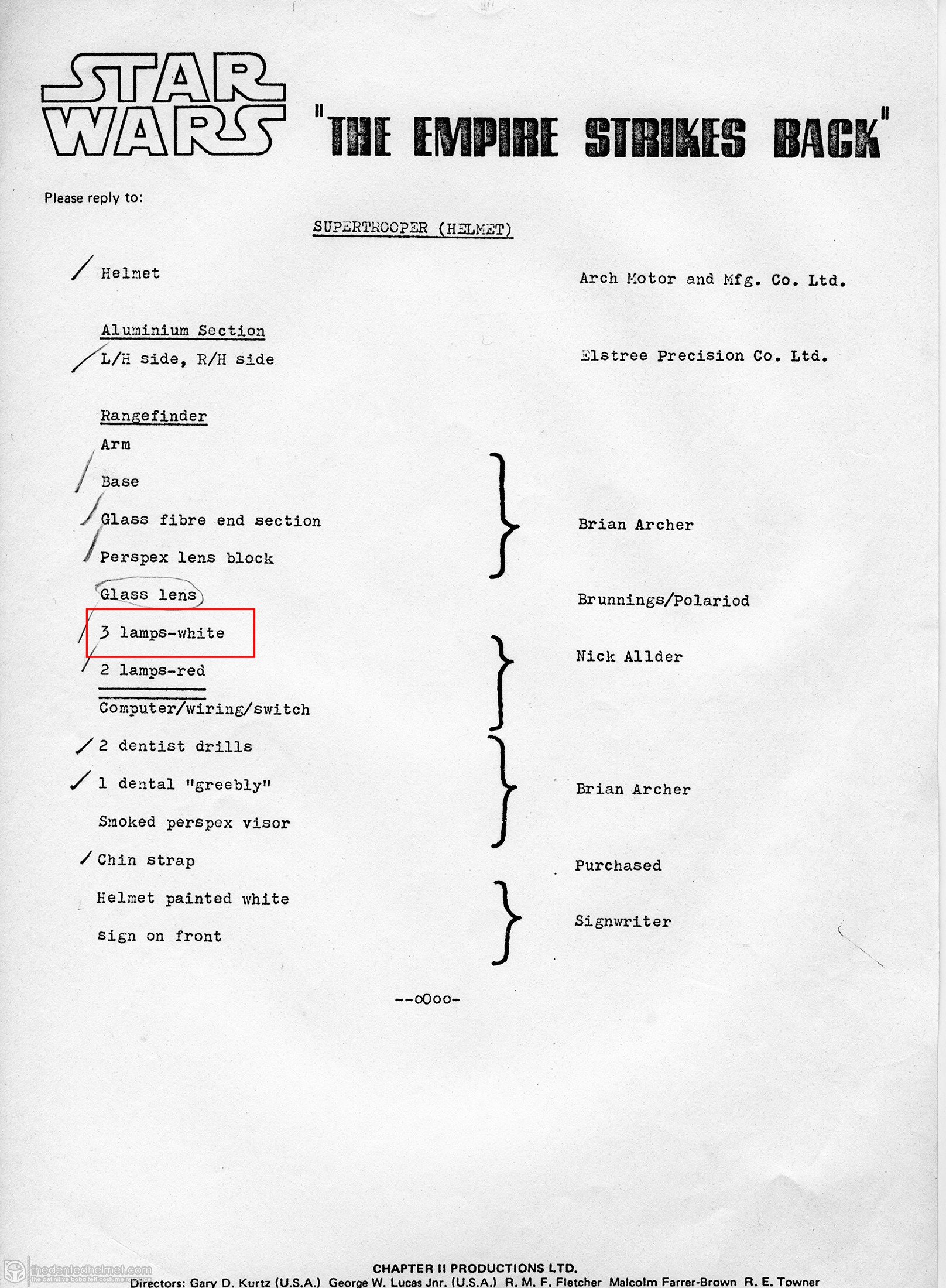

...I also took a better look on some images saved in my PC and I stopped at this image:
Then I looked at the Supertrooper Documentation - Helmet image, more exactly at the '3 lamps-white'...

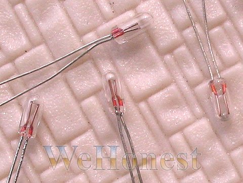

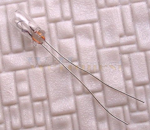

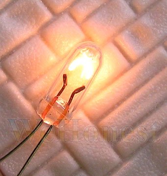

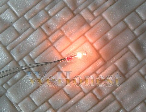

...then again at the first image and again the Supertrooper page and again the first image, and then... it hit me! I did a quick search on the net and I got this term: GRAIN OF WHEAT. This is the name of the light bulbs (diameter varying from 1mm to 3mm, or bigger) used by hobbyist, in some fields of the industry and even for medical or optical instruments; I'm pretty sure they used these lamps in the Star Wars studio scale models too.

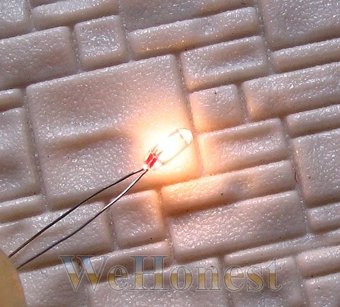

3mm diameter/7mm length GoW light bulb.
2mm diameter/6mm length GoW light bulb.
1mm diameter/3.5mm length GoW light bulb.
And some images of older (I'm not sure about how old are these) GoW light bulbs:

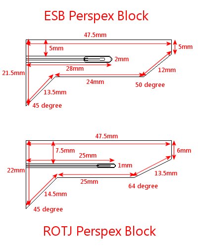

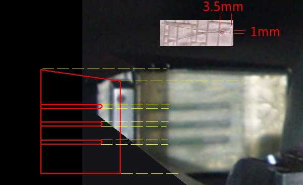

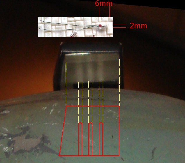

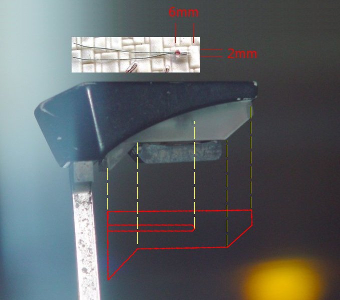

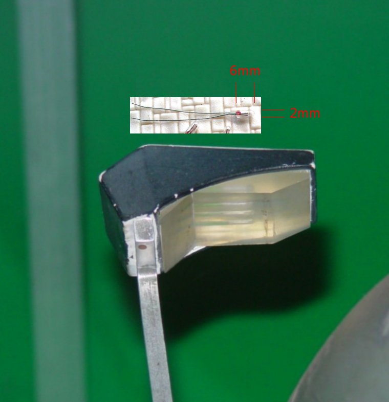

Here are some comparison images of the ESB and ROTJ perspex block channels and some 1mm and 2mm diameter GoW (Grain of Wheat) lamps:
The ESB channels looks closer to the 2mm diameter GoW lamps, while the ROTJ channels are in the range of the 1mm diameter lamp.

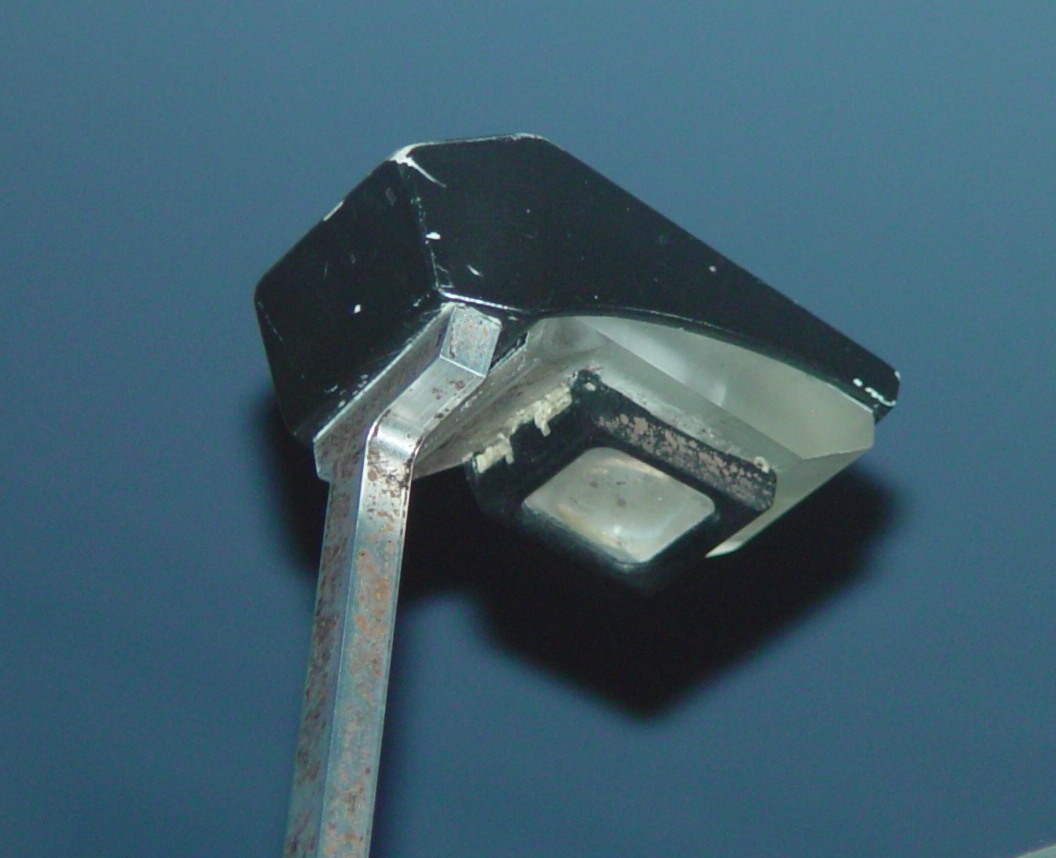

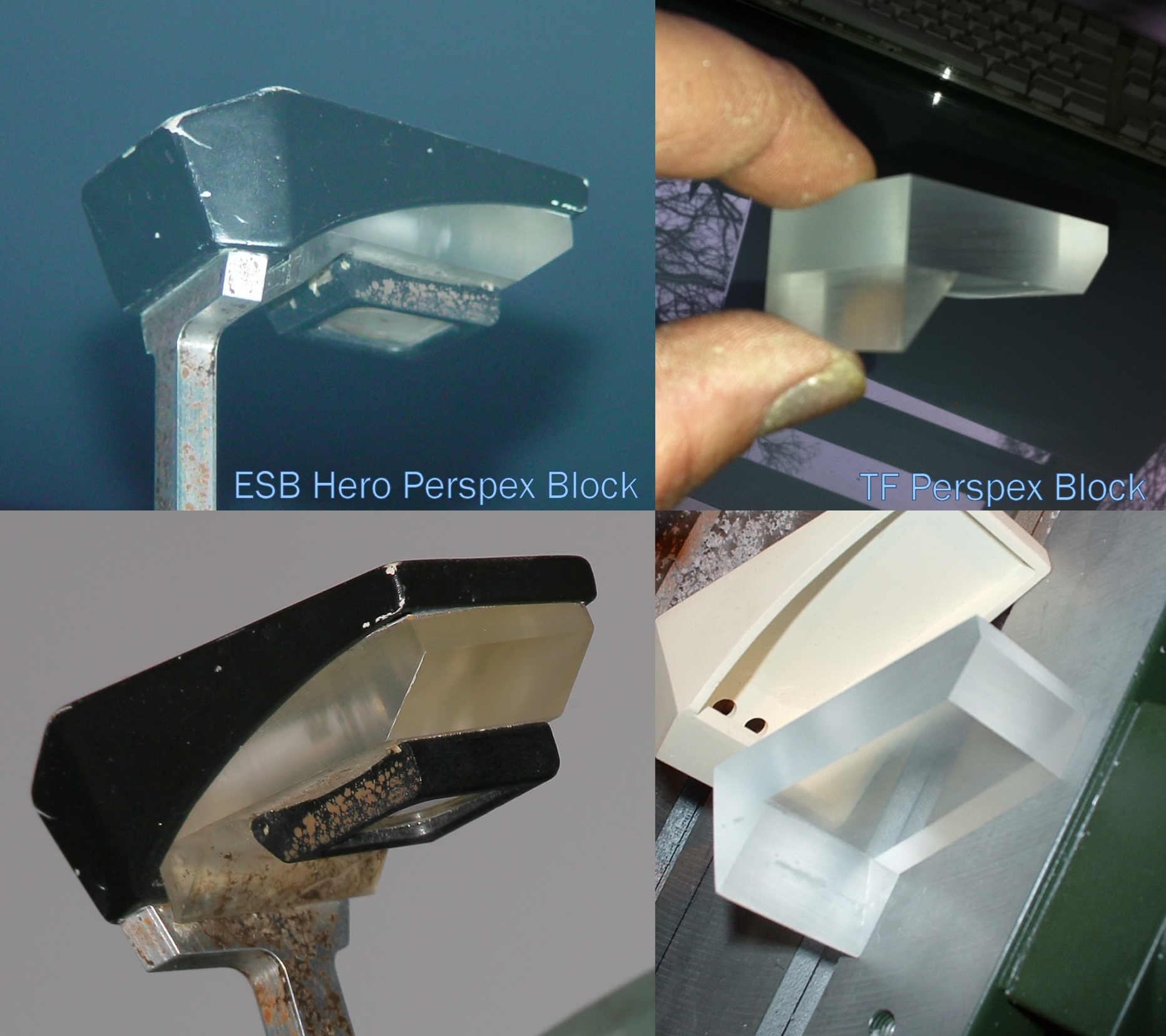

We know that the ESB perspex block does not have the same shape as the one in the ROTJ rangefinder body (the original image was replaced with a better one):
The ESB style is (was) also present on the Supertrooper/Pre-Pro #1 helmet, while the ROTJ style is (was) present on the Pre-Pro #2, Pre-Pro #3 and Sandy helmets.

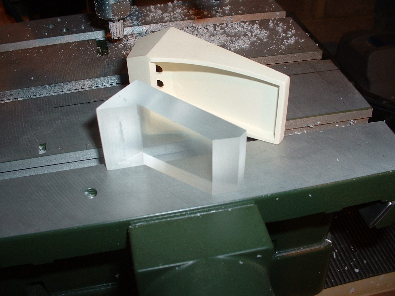

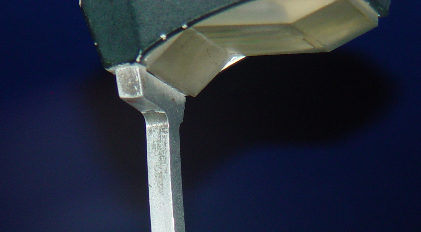

And another fact: did you knew that the perspex block was made from 2 pieces glued together? Well, then here's the proof:
Additional images of the 2 part perspex block:

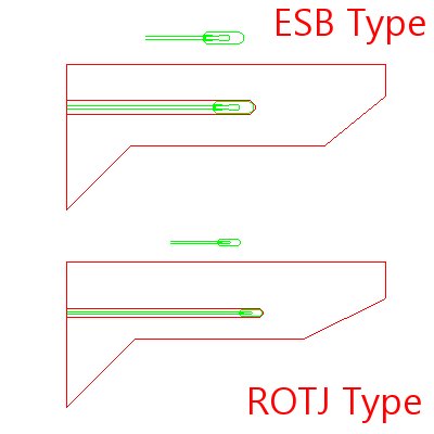

The idea is that whatever these light bulbs are called now (GoW - Grain of Wheat, GoR - Grain of Rice or micro lamps), our task is to determine the exact size (mainly the diameter) and the position of these light bulbs in the perspex channels. My interpretation is based only on images from the Gallery and because the nature of the perspex block to magnify (+ or -) or to distort the inner channels, my measurement are not set in stone. Some of the rangefinder templates (WOF - WizardOfFlight and SS - SingleSeat) has a 1.5mm diameter for the perspex channels (somewhere between my 1mm and 2mm light bulb sizes) but these measurements might be off too because of the inner distortion seen in the images.

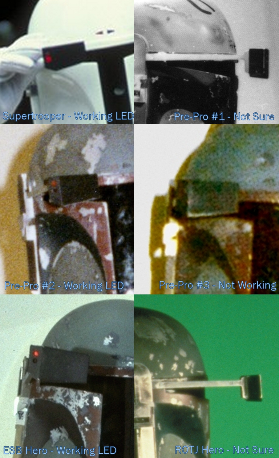

Here are some images with the working (or possibly working) Rangefinder red LED lights:

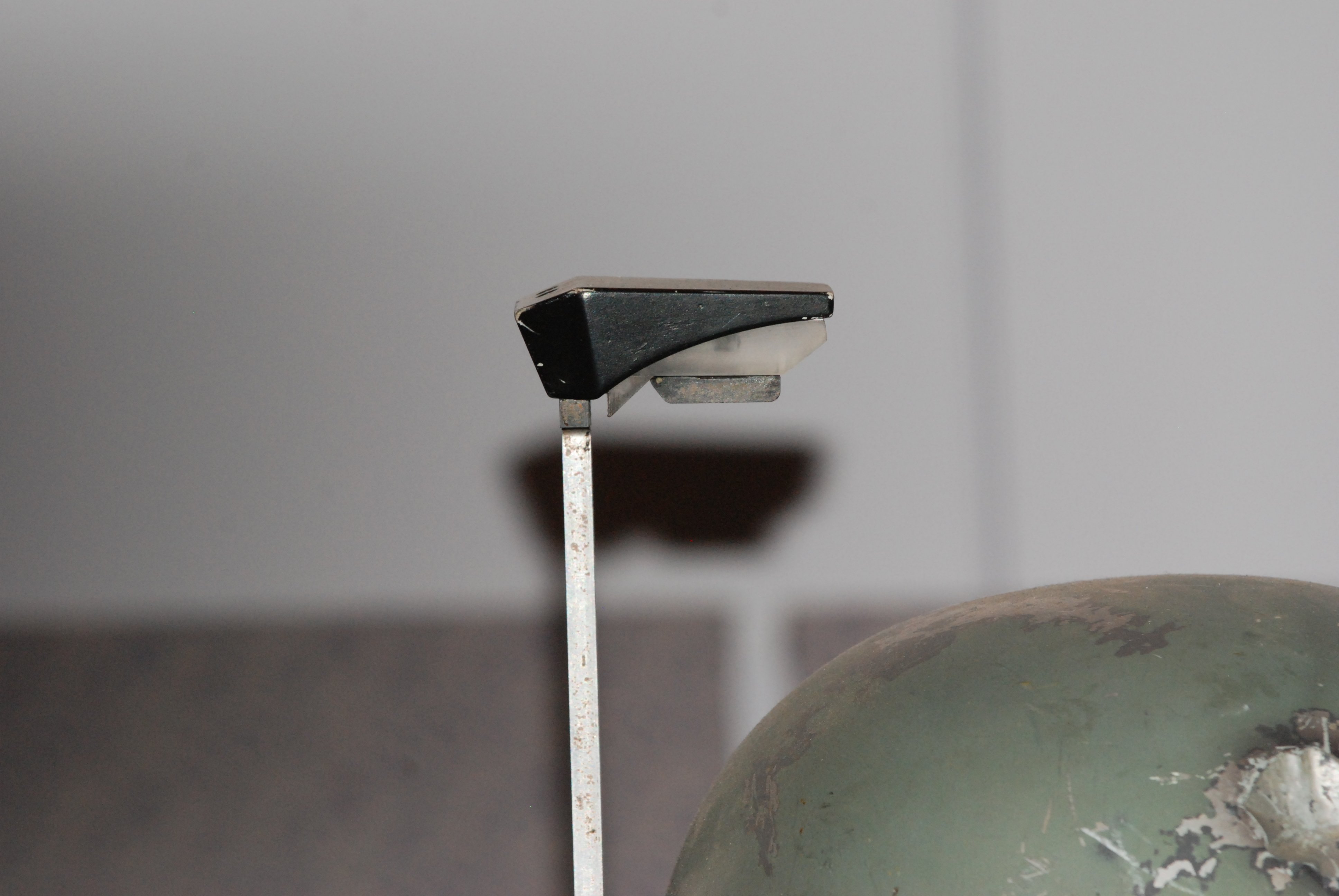

And another image with the perspex side view (more or less):
