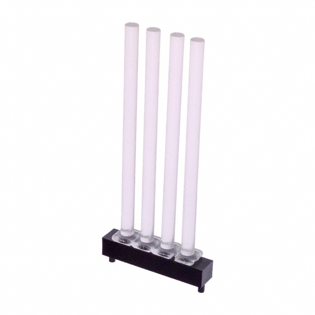

What about LED light pipes? I know it's not movie accurate, but they would disperse the light better, just a thought.
I found a LED light pipe with 3mm diameter and 50mm long 'pipes', but the problem is again the diameter:

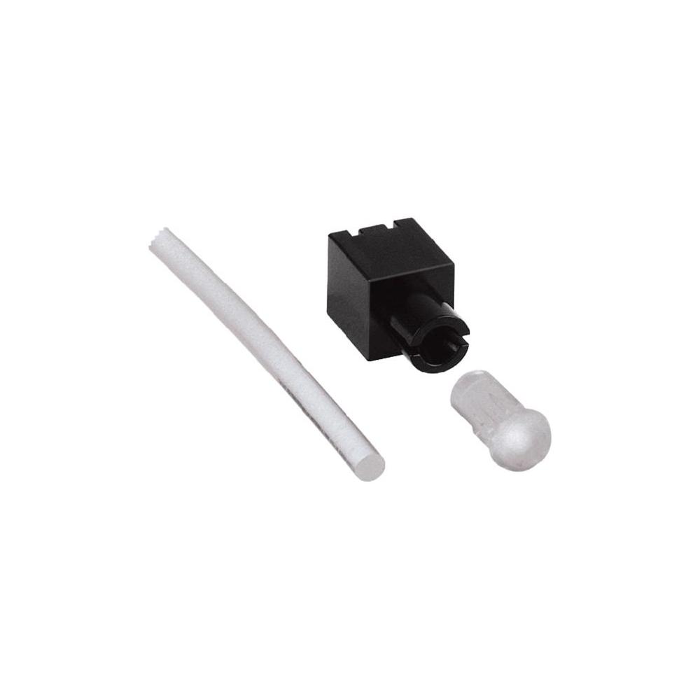

Another one is called Flex System with THT LED's and it has the correct 2mm diameter flexible light guide and this might work as a replacement (see PDF file for product data sheet):
View attachment 1316.2001-Mentor-datasheet-576803.pdf

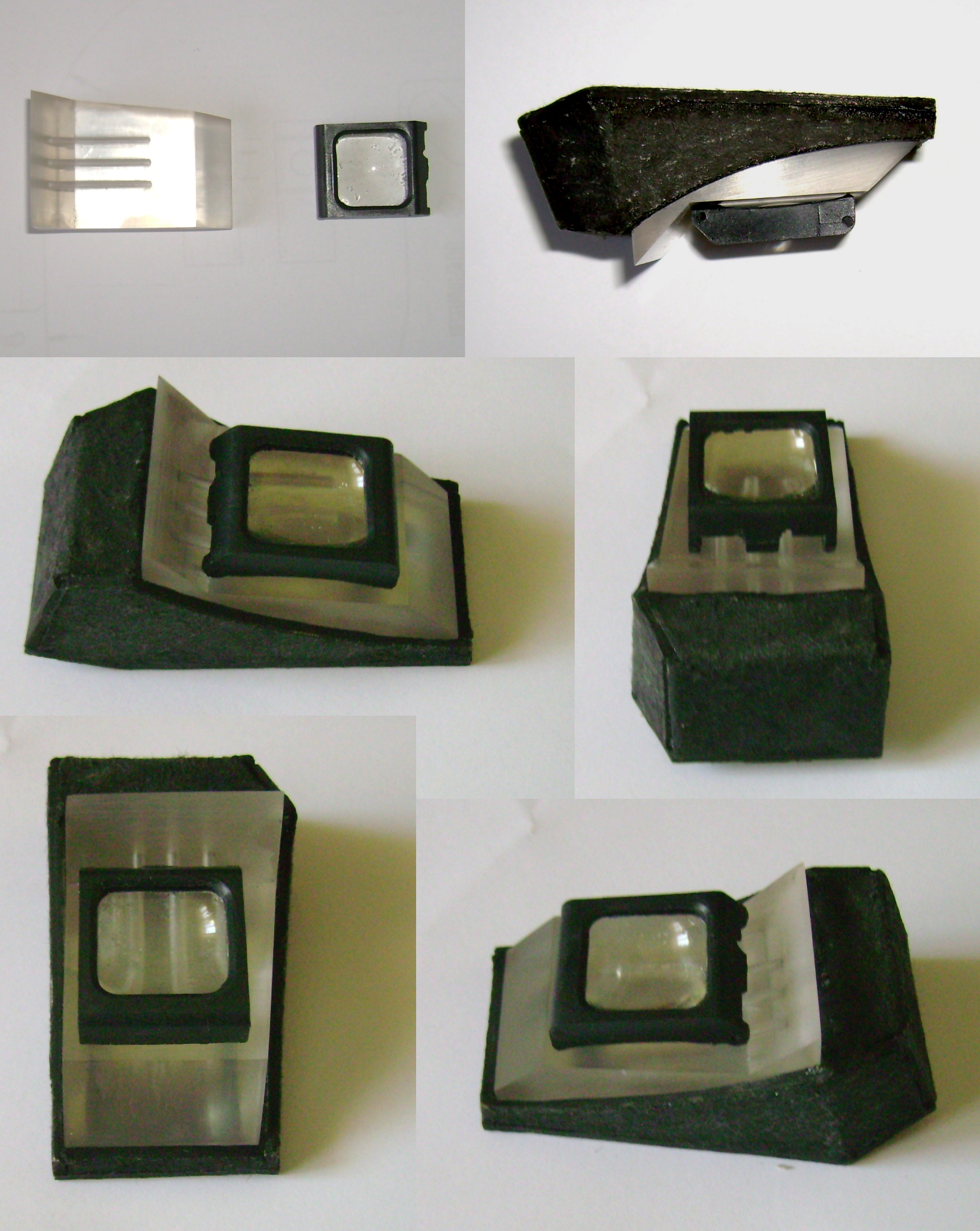

This post is not exactly an update, but more like a show off of a beautiful piece I received today from Garrett (terminal fettler - thanks again!), more exactly an exact replica of the ESB Hero Perspex lens block and Polaroid Viewfinder (the RF casing is my cardboard replica):
I have no words to praise the craftsmanship involved in these pieces, especially that these are so tiny and I highly recommend them for anyone who strive for accuracy (the images don't do justice for them). It has the correct inner channels, the metal foil (or sheet) glued to the bottom of the block, which is made with 2 separate pieces glued together. We just need to find the correct GoW lamps and made them light up!

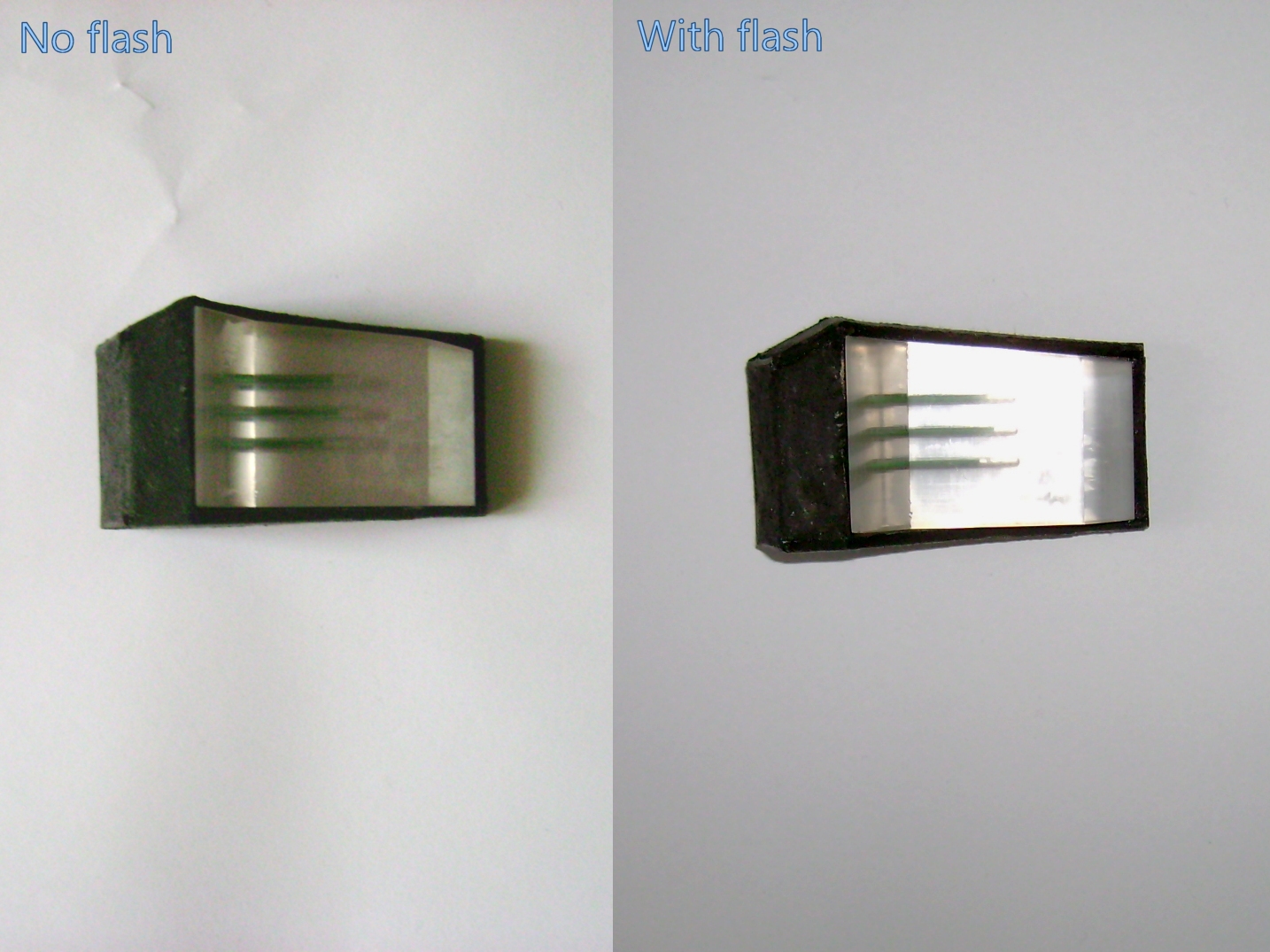

And for fun I did the ROTJ Perspex block 'replica' by inserting 3 piece of green elastic (didn't find wires with green isolation):
I'm so happy (and fortunate) to own these perfect replicas!

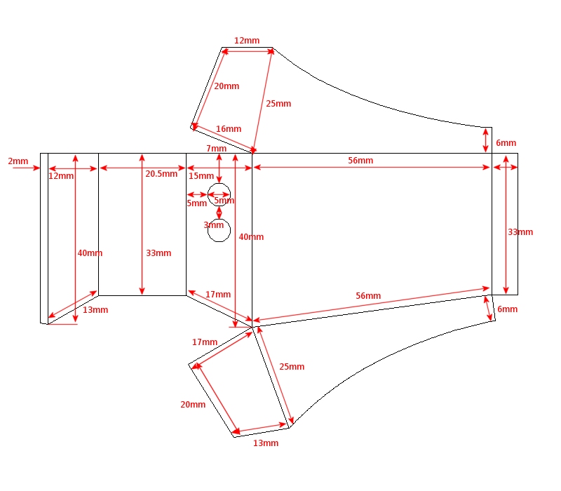

Raf, how does the TF rf compare size wise with the Asok rf? Right now I'm designing a self contained led board for the Asok rf and would like to know if it would fit in a TF one.
I don't know the Asok RF measurements but from what info I got from TF, his setup has the correct values. But it also depends on the thickness of the materials too. Here are my measurements of the rangefinder casing and perspex block:
Note that the RF casing should have a 2mm thickness.
