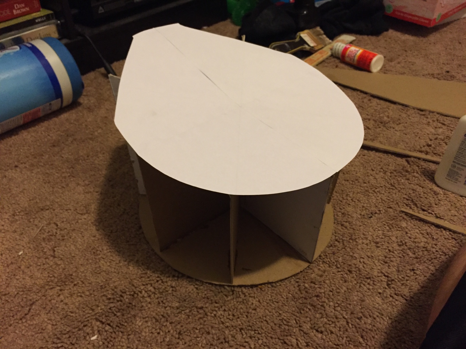

Time for helmet #2! For this one I used Rafalfett's V2 helmet templates on the advice of Le1120. This is what I have so far:
For my last build I used the WOF templates so this is a new experience but it seems to be working out alright so far.
More to come, stay tuned

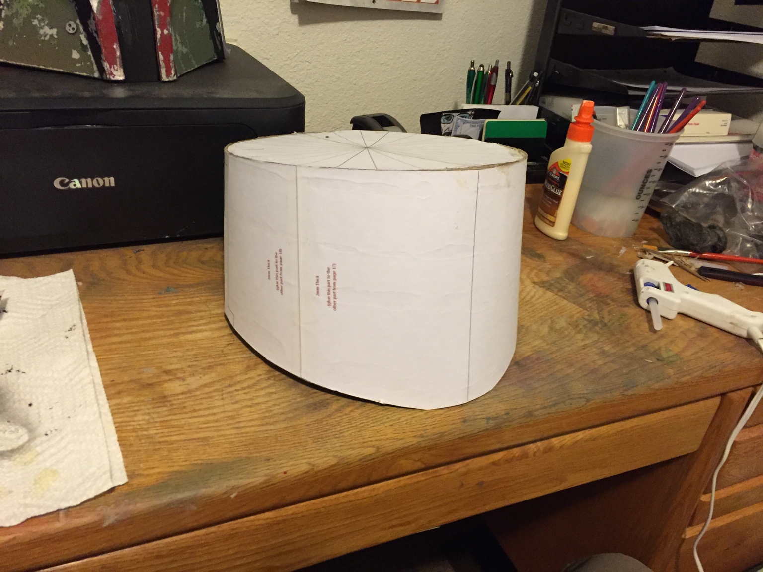

I got the outer layer cut out but for some reason it didn't line up. So I had to tear it off the inner layer and reprint the templates. Setbacks this early in the build are annoying
Bright side: I'm a full member now! Granted... That has nothing to do with this build, but I'm pretty stoked!
It was a printing or a line-up problem? It is important when you do the line-up to follow the lower contours of the inner and outer layers and not the top one (as some did by mistake). The build looks good so far and congrats for the full membership!
It was a line up problem. The first thing I lined up when gluing was the outline of the right ear. But by the time I got around to the left ear, it was too far forward.
When cutting out the outer layer I cut out the entire back, the cheeks, and most of the visor, so it may have lost its shape in the process. When I redo it I will keep the cheeks and visor intact for now and just cut them out later.

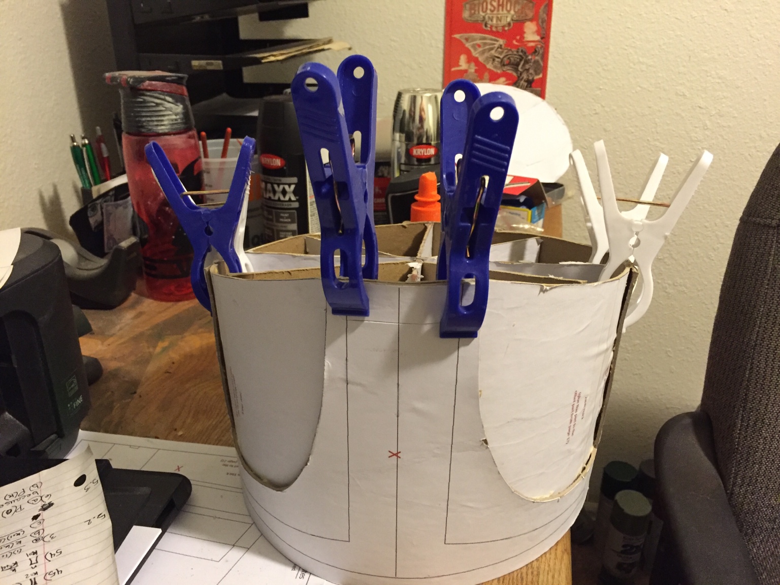

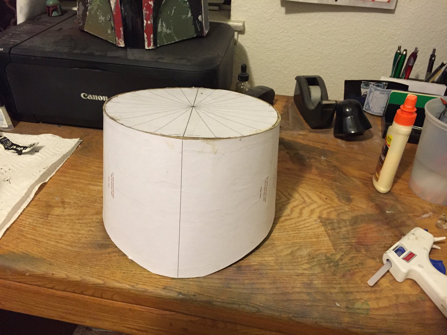

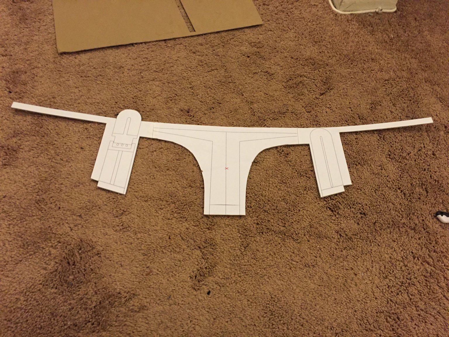

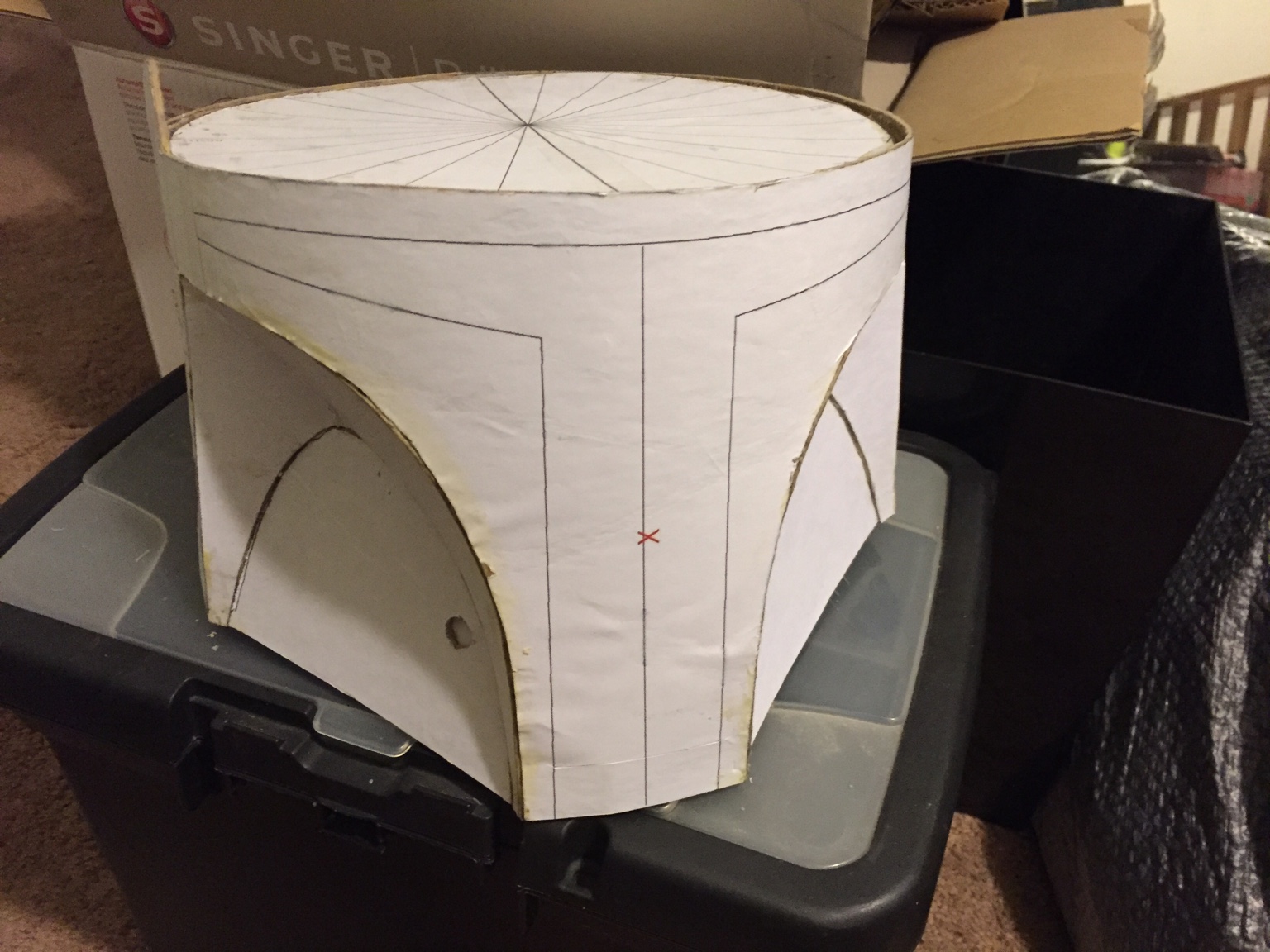

But I was finally able to get the outer layer on.

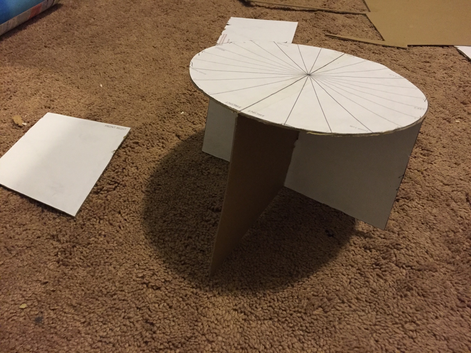

Learning from previous mistakes I left the cheek and visor on the template when cutting the cardboard out
Made the decision to cut the cheeks and leave the visor

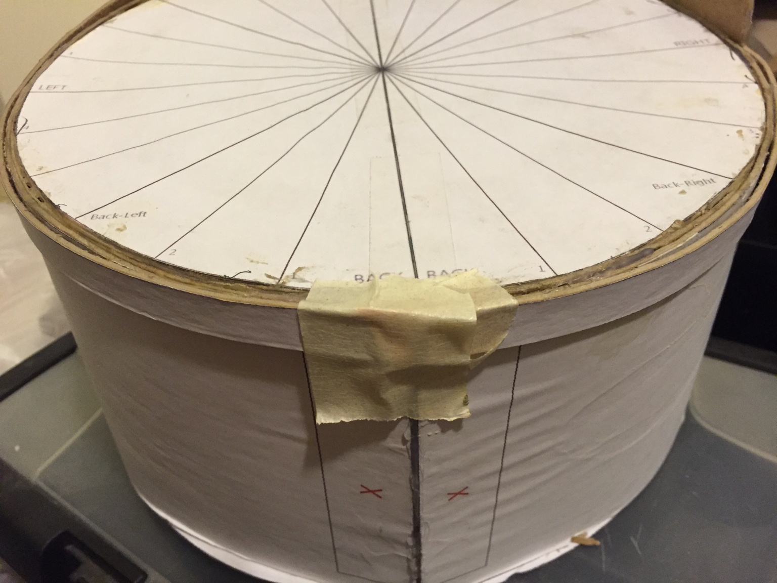

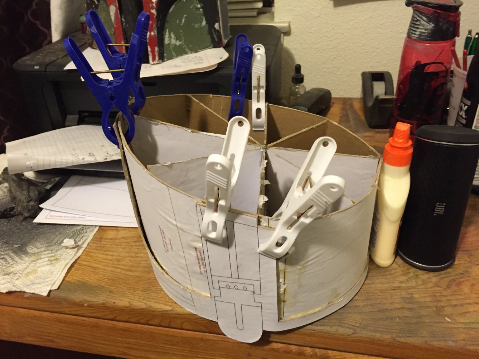

Sprayed the cardboard with water and curved it into shape. I taped the back to help it keep shape until it dried
Once the outer layer dried I hit it with some wood glue and put it on. Per Rafal's advice I lined it up according to the front center line of the t-visor as well as aligning the bottom edges of the inner and outer layers. I didn't quite get the red rim around the helmet perfect but it's close.

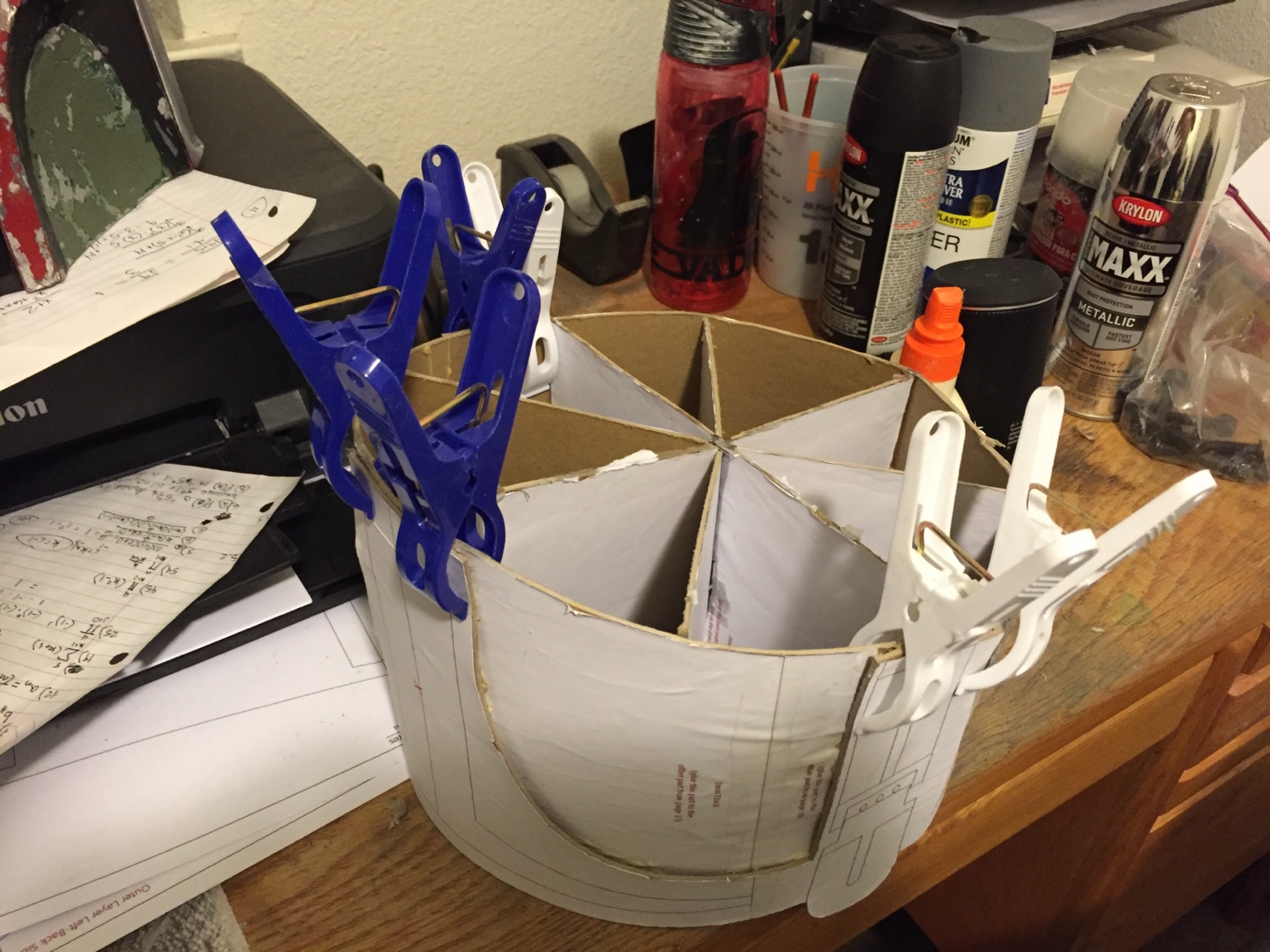

Up next I'll be removing the inner support and cutting out and putting in the upper and lower cheeks

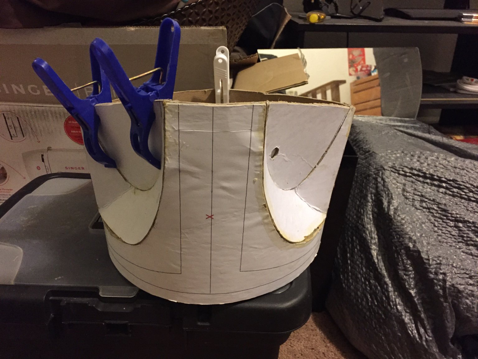

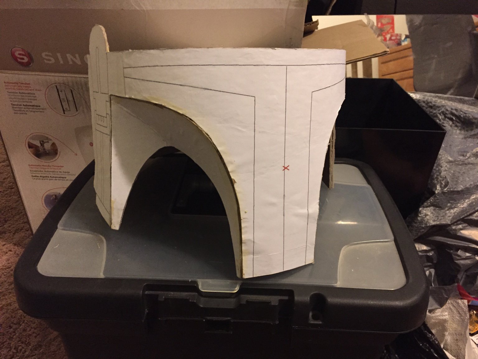

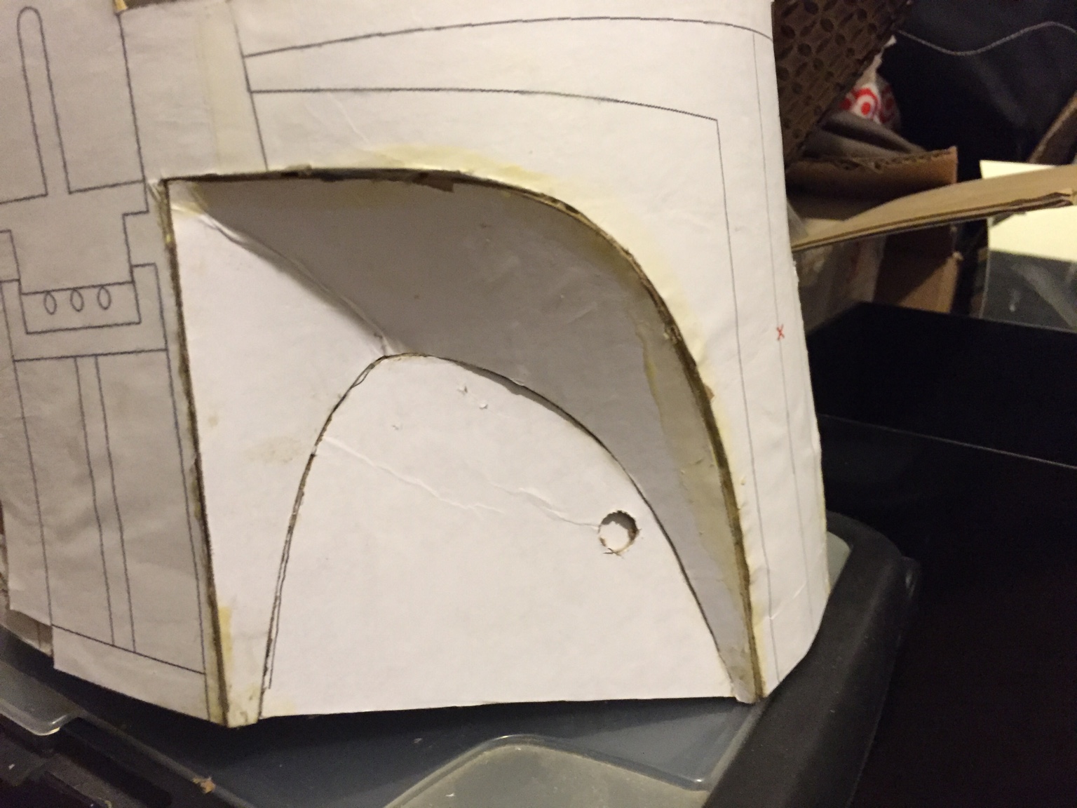

One of my favorite parts is getting the cheeks in because to me that's when the helmet really starts to take shape. But holy hell was this a hassle. Let's get to it
First things first. I had to cut out the existing cheeks

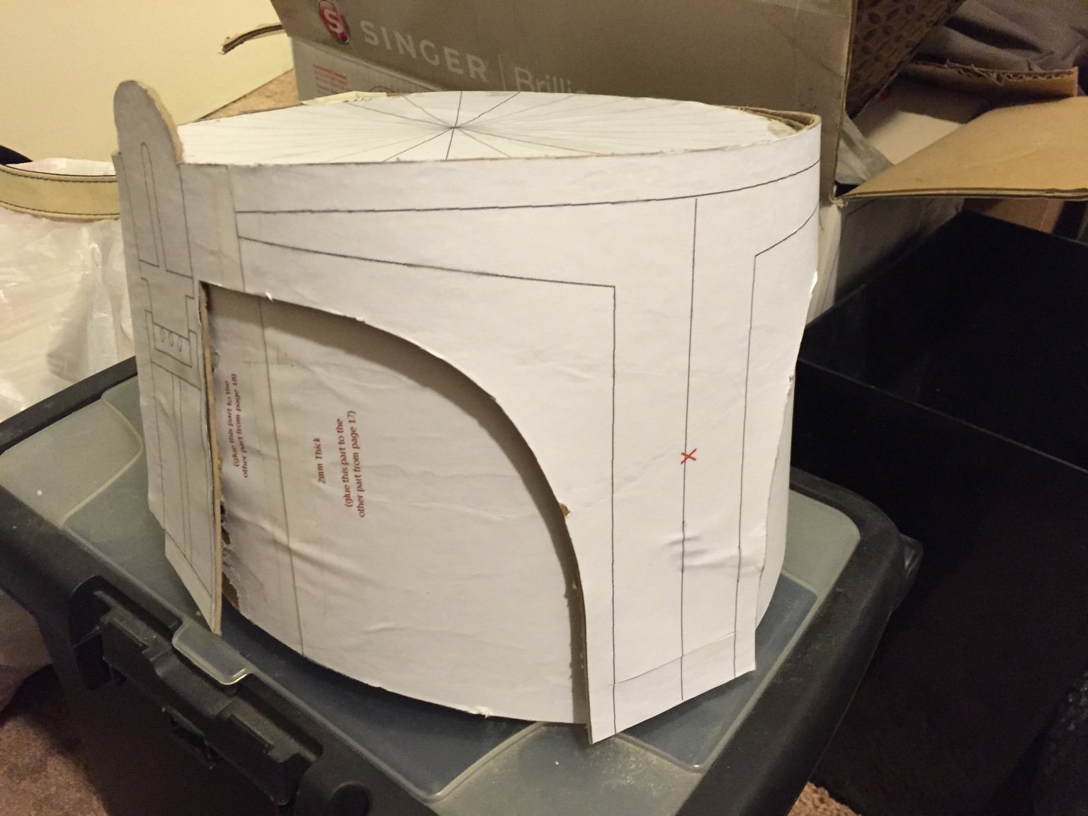

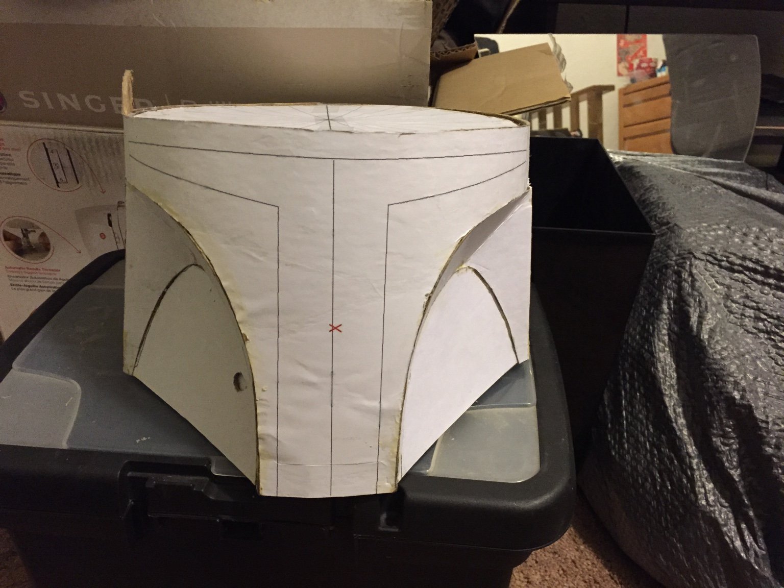

Putting in the upper cheeks (particularly the right one) was a super pain in the ass to put in. I was finally able to get it in, and there are some small gaps in the fit, but nothing that can't be taken care of with a little bondo.

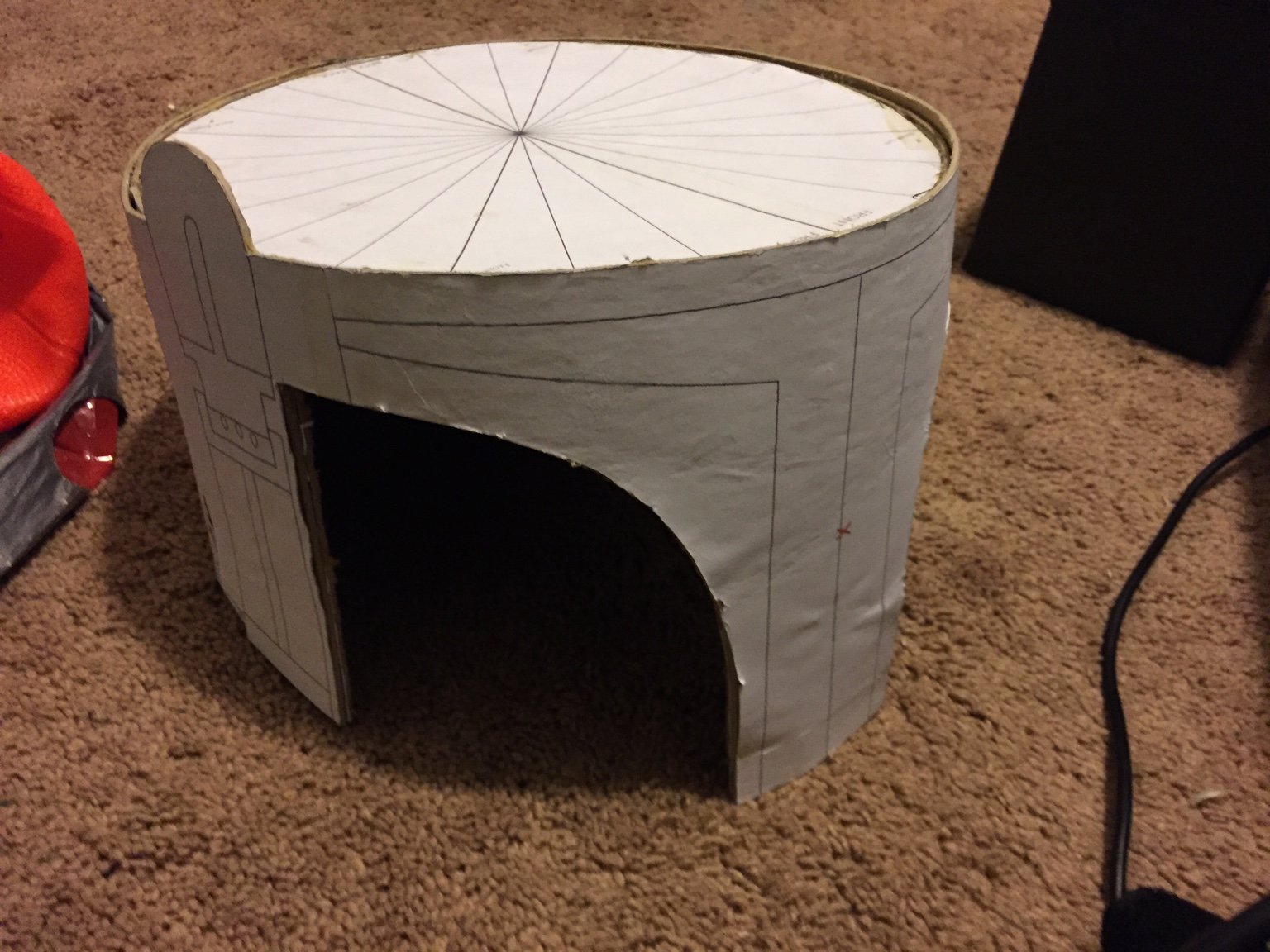

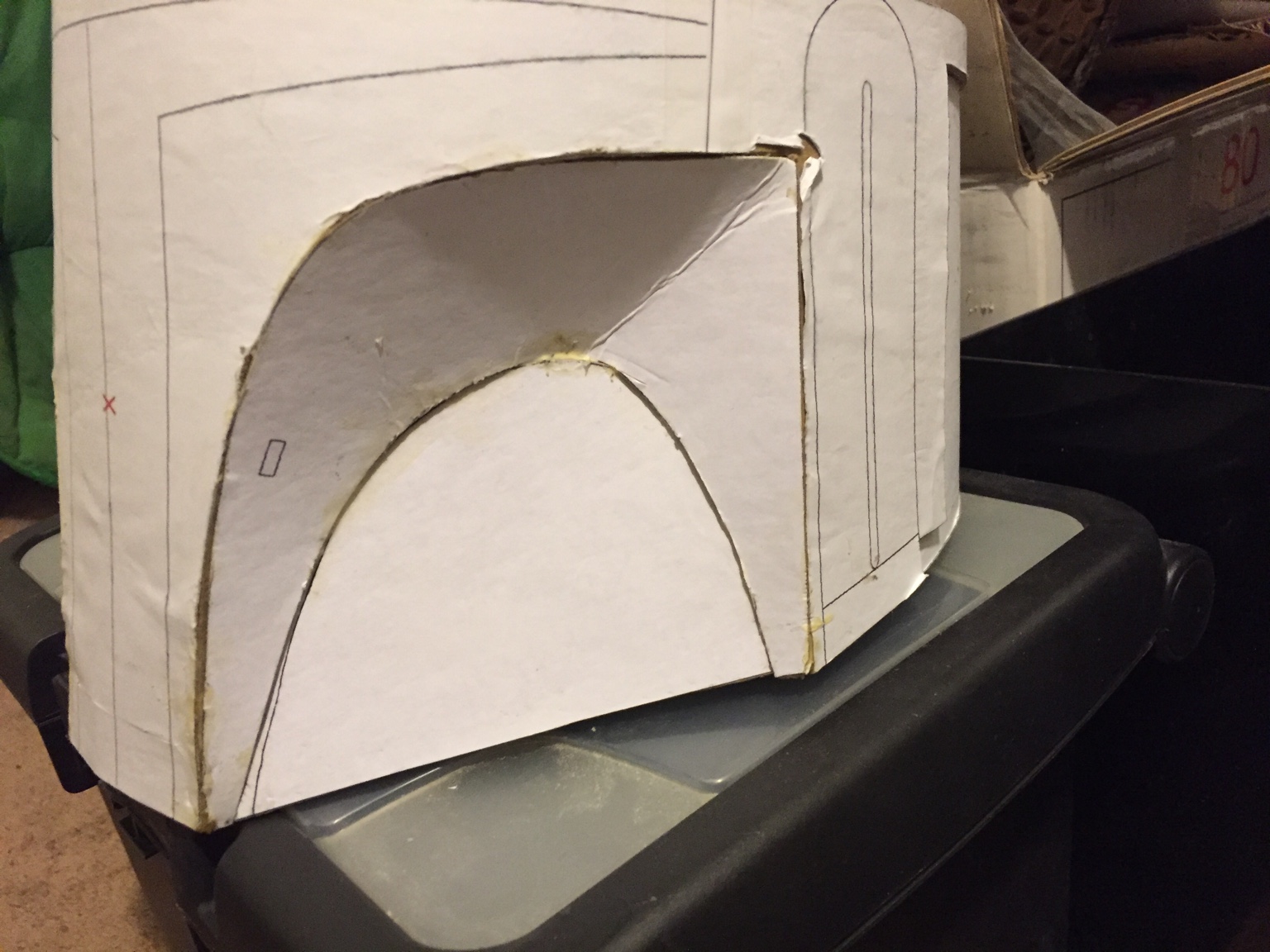

After letting those dry it was on to the lower cheeks, and these were even more difficult to fit than the uppers, but with some trimming and a "can do" attitude, I got those bad boys in there
After letting those dry I just had to fit in the inner lower cheek supports and the cheeks are good to go!
Here's the final result

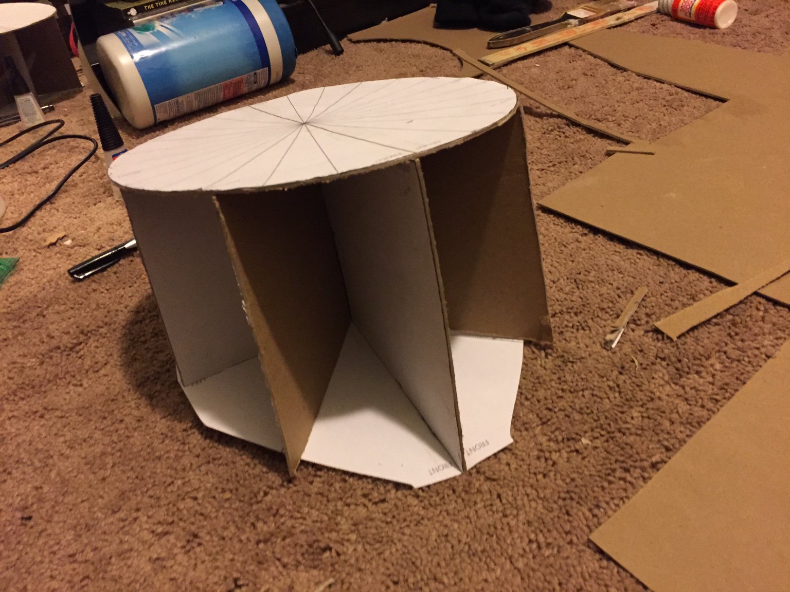

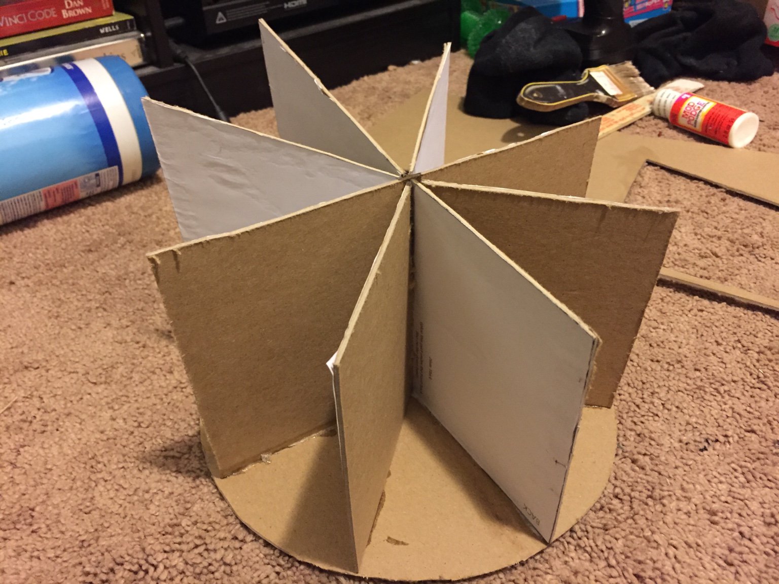

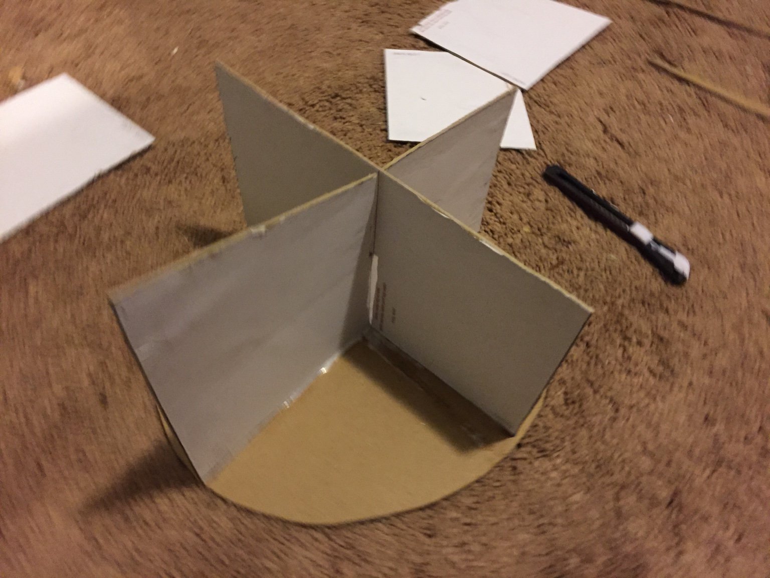

So next time it's on to cutting out the dome base, putting in some dome supports and then finally the dome. I remember this step being a nightmare on my last build, so I'm hoping I fare better this time! We shall see
