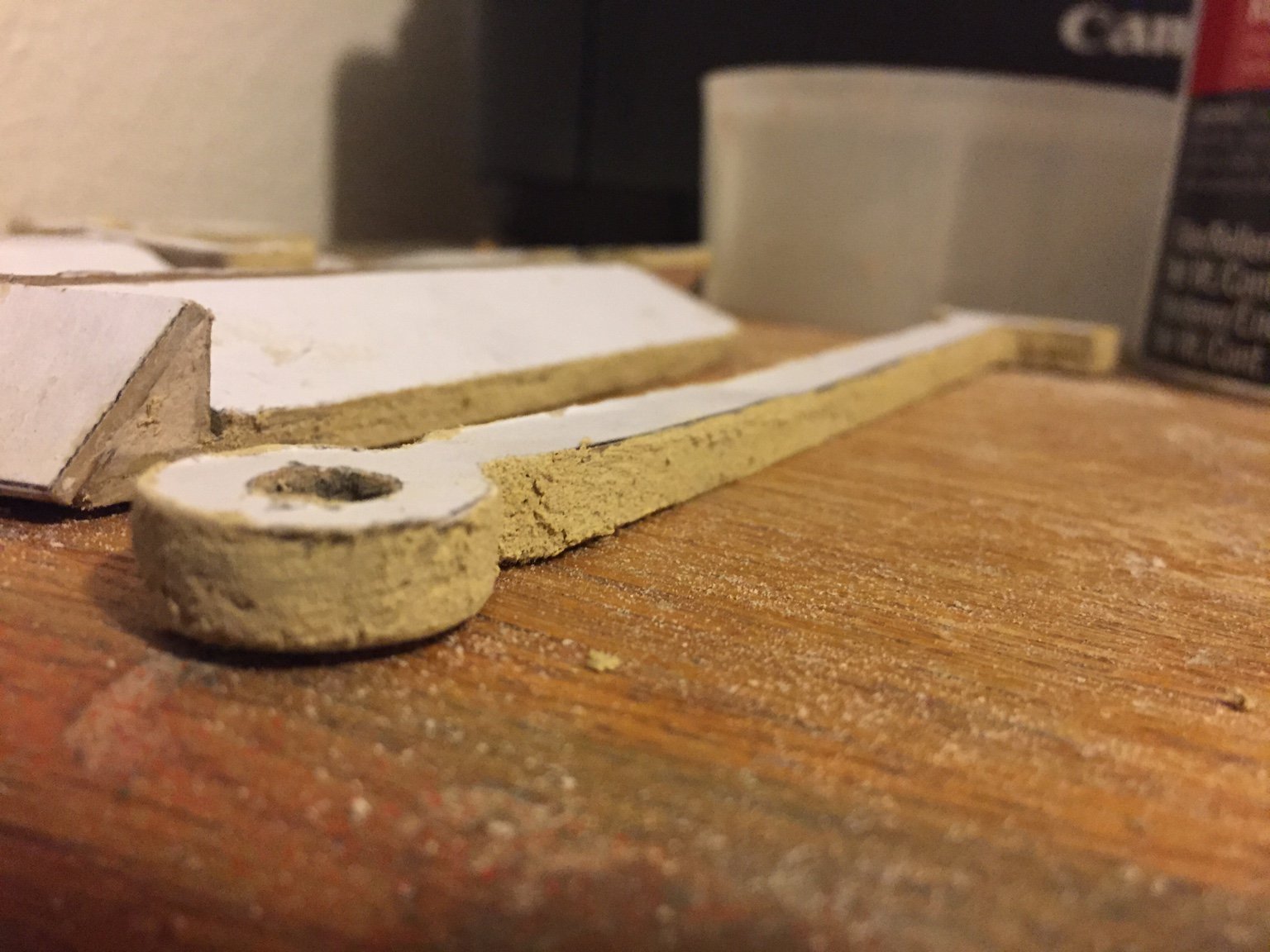

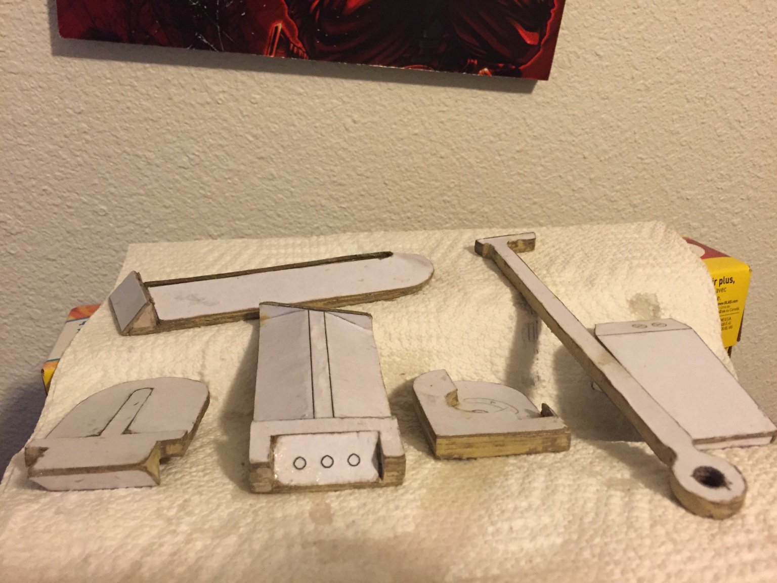

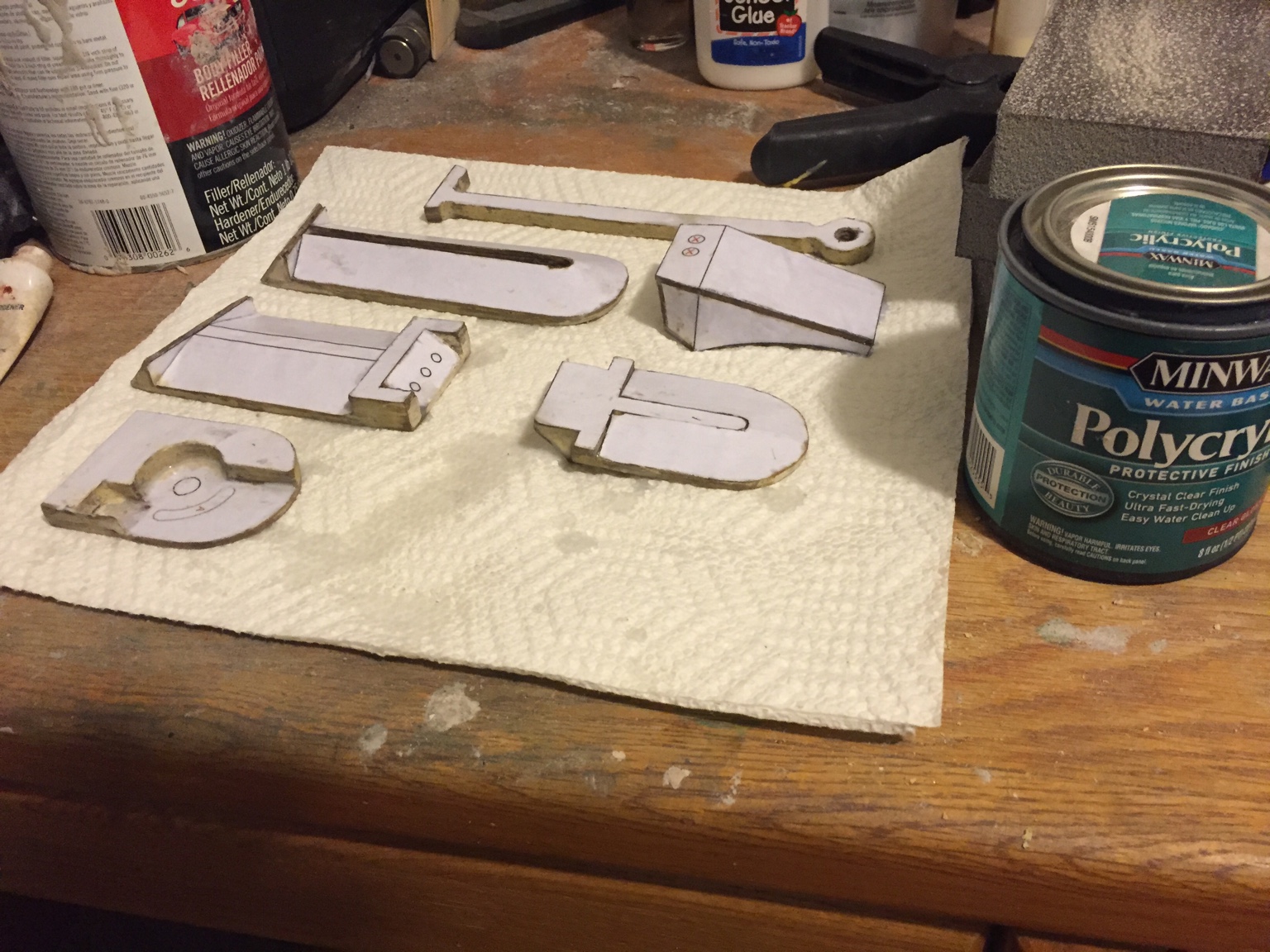

While waiting for the first application of bondo to cure, I decided to hit the ear parts with wood filler and then sand them and seal them
This was after applying filler
And this was after being sanded with the dremel and sandpaper as well
And then the first coat of sealer

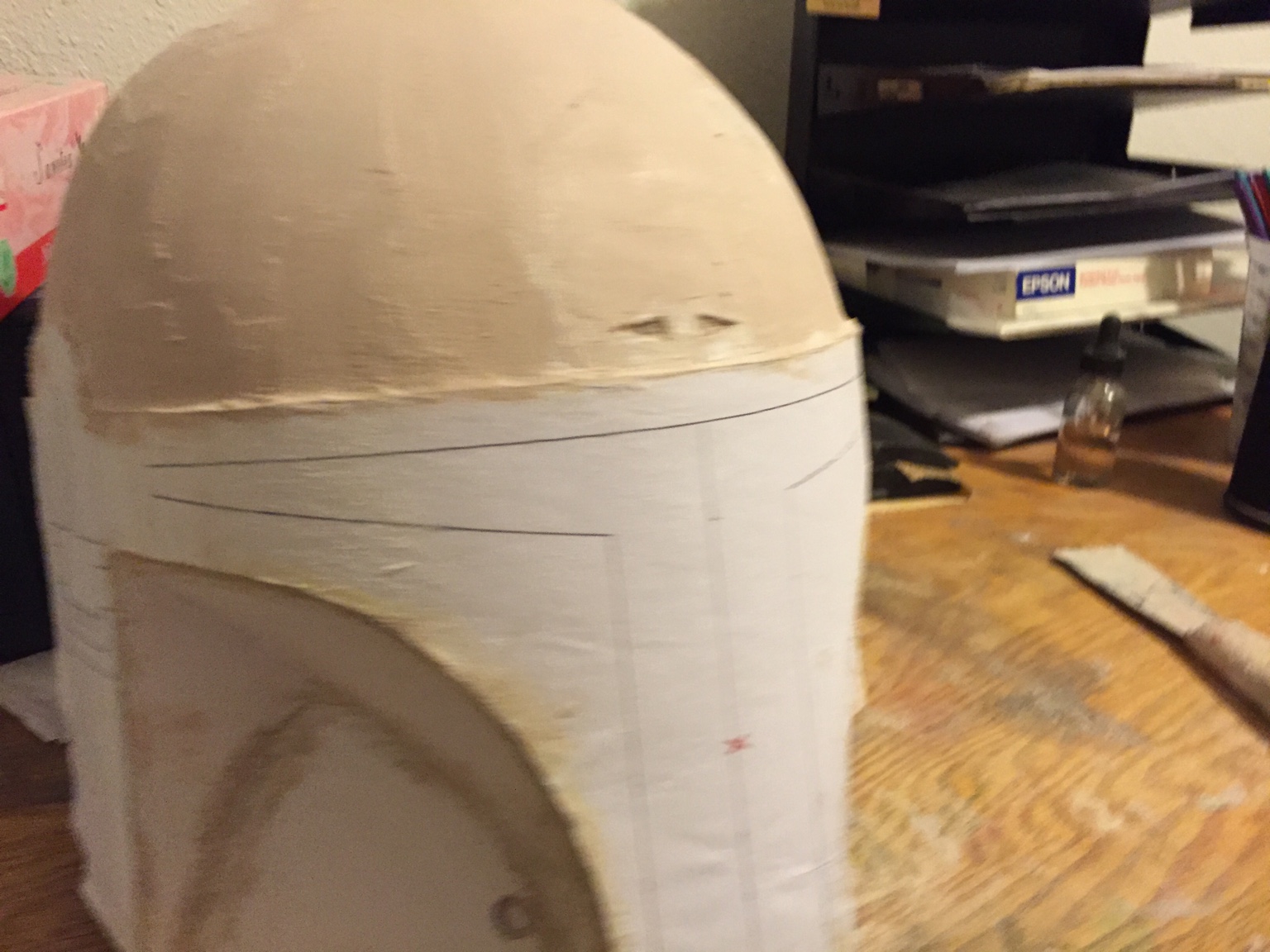

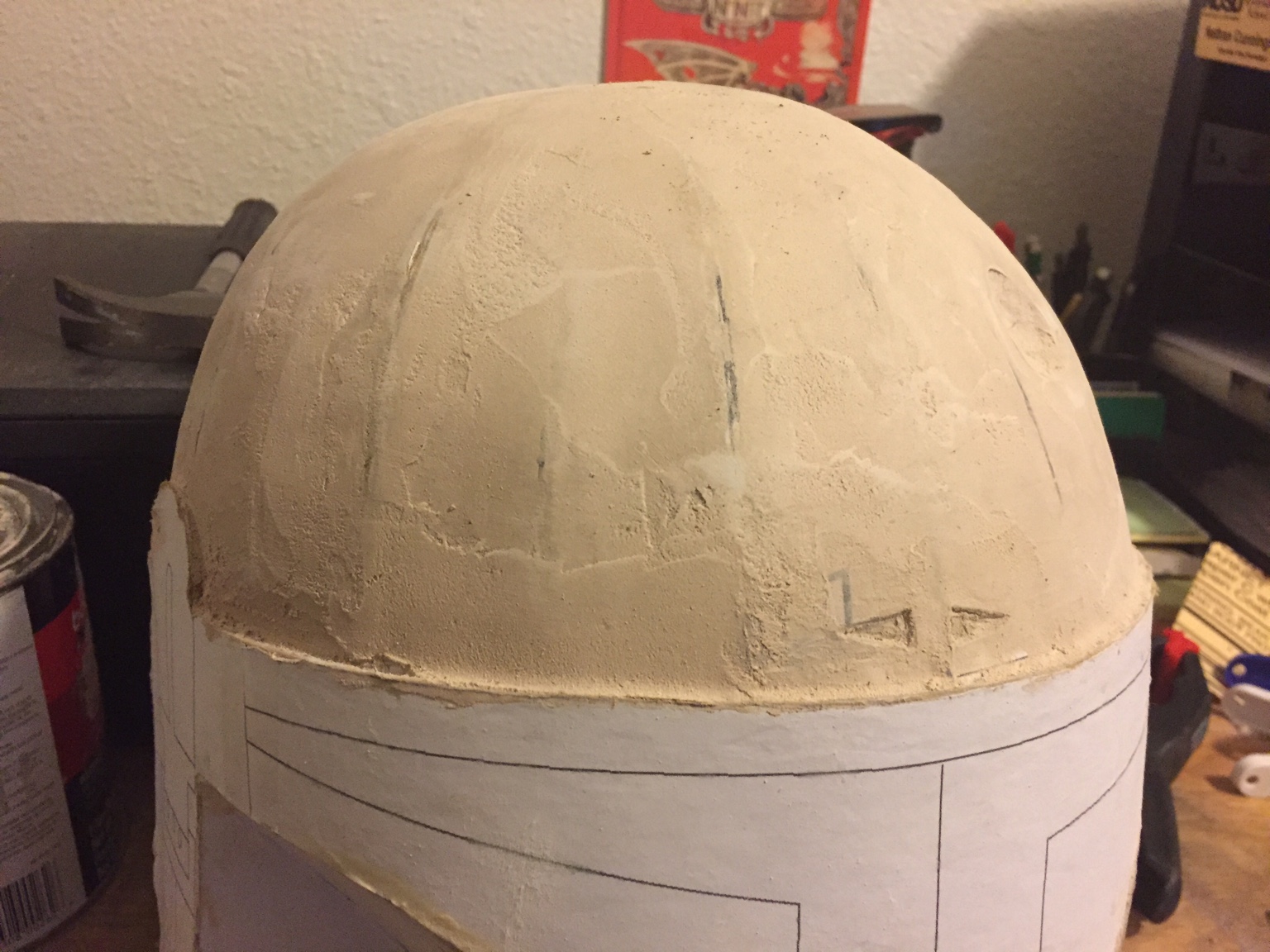

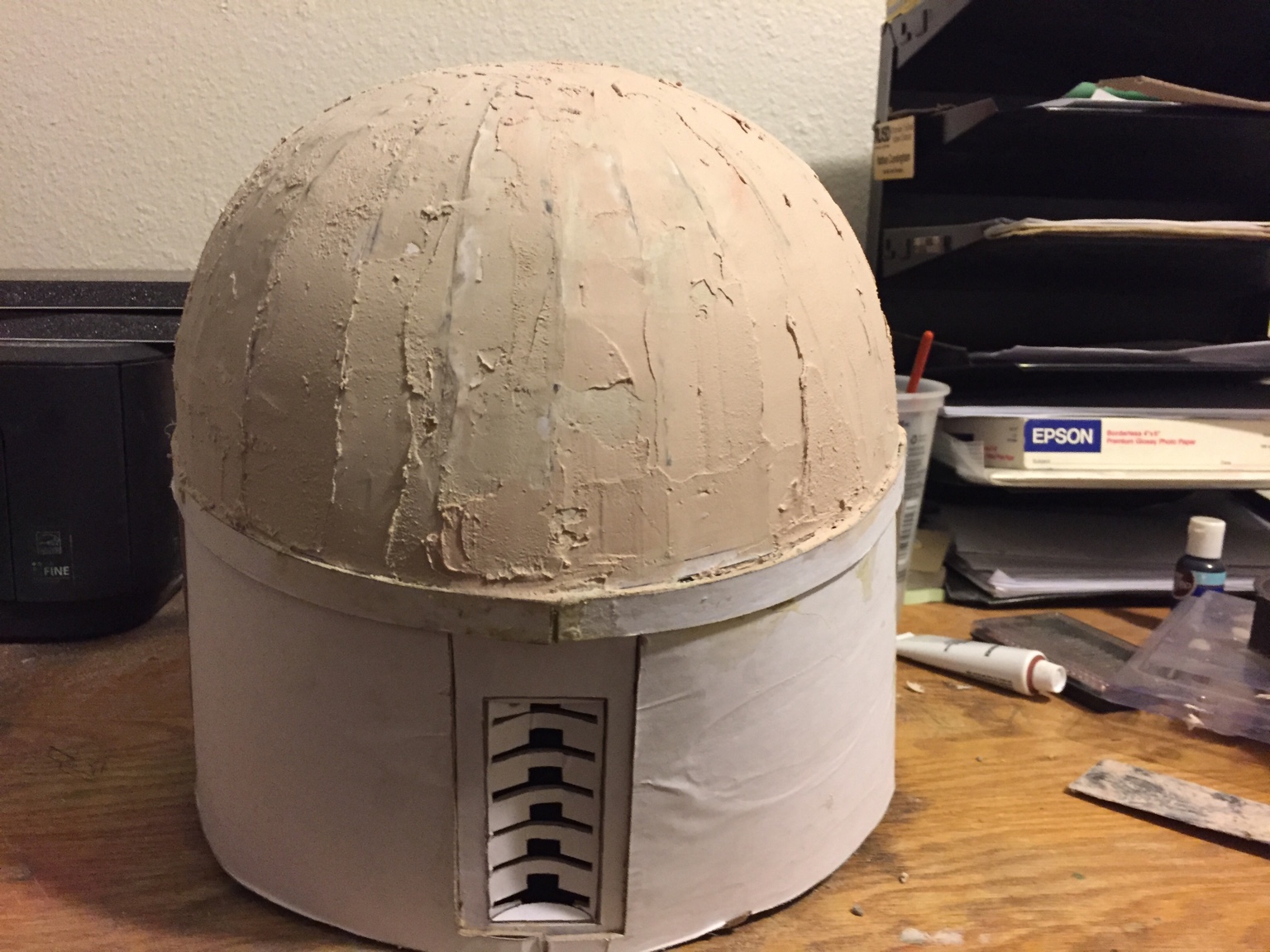

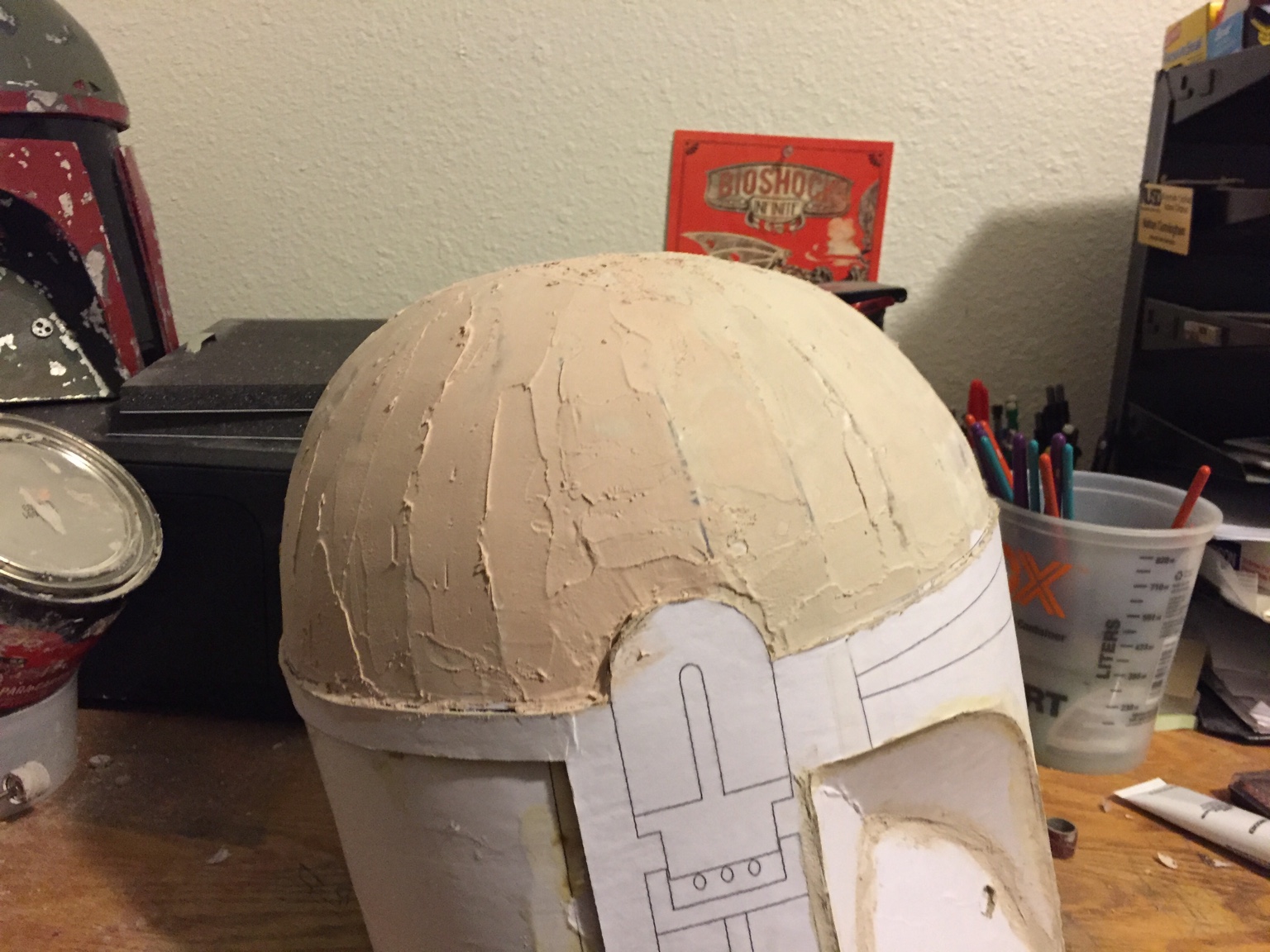

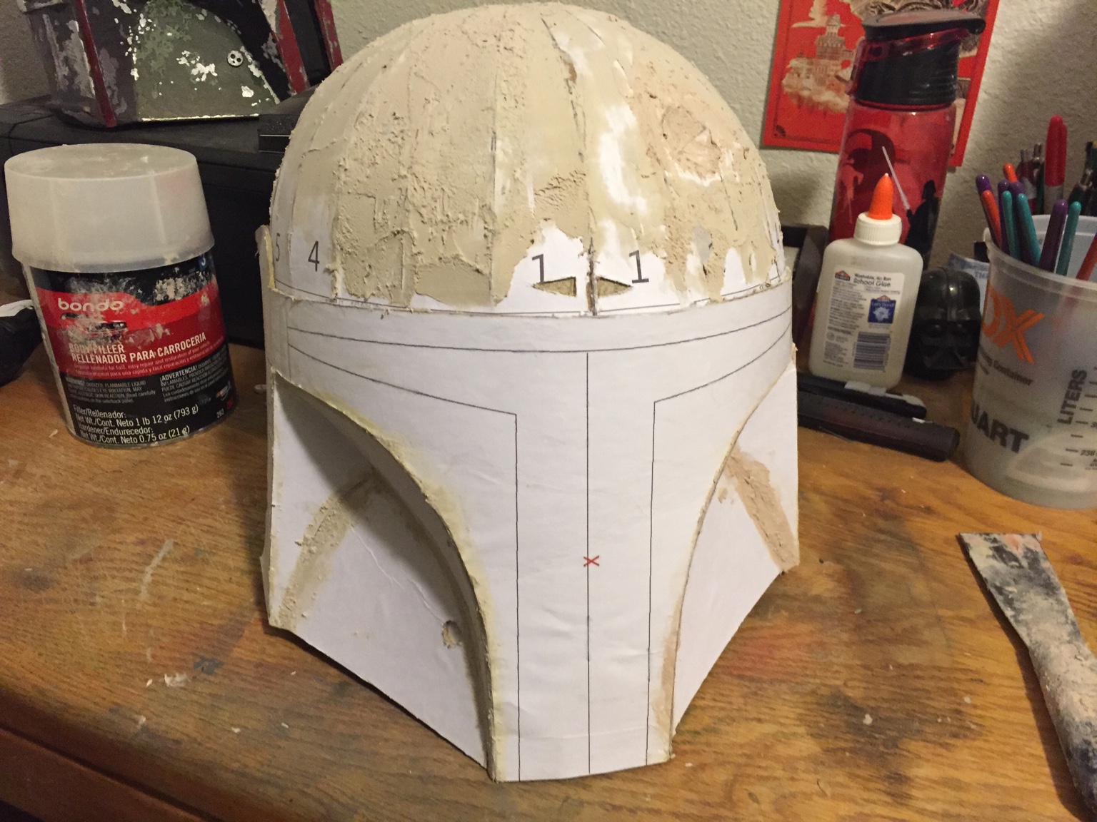

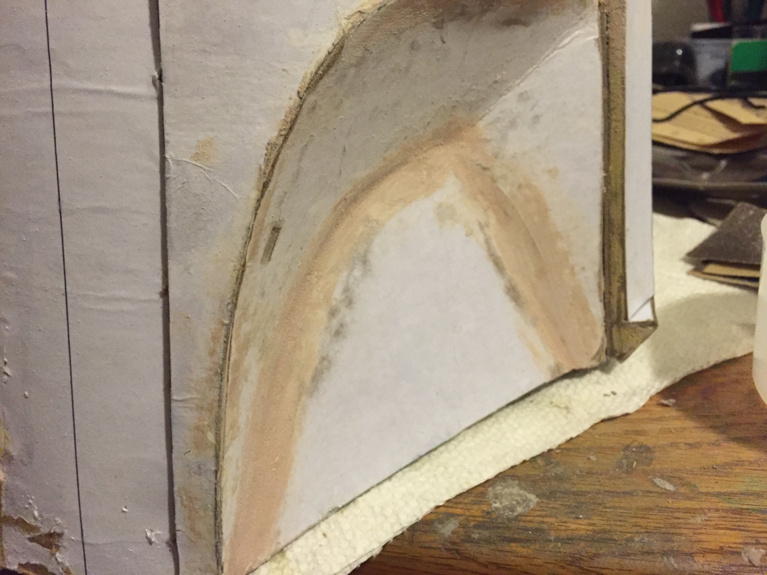

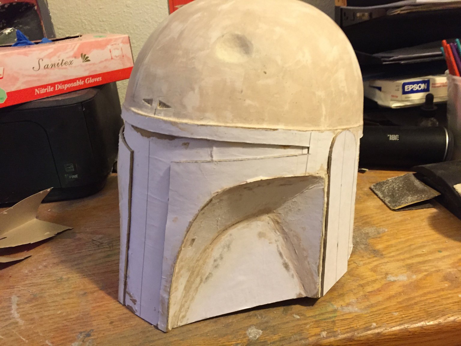

I decided that instead of putting a lot of bondo on at once and then sanding forever, I would put multiple thin layers on and take my time with it, sanding between each layer
Layer two
Layer 3
Layer 4
Layer 5
I'm currently waiting for layer 5 to finish curing so I can sand it, but it's the last layer that's going on. I like the general shape of it, so it will just need lots of sanding and spot touch ups where needed

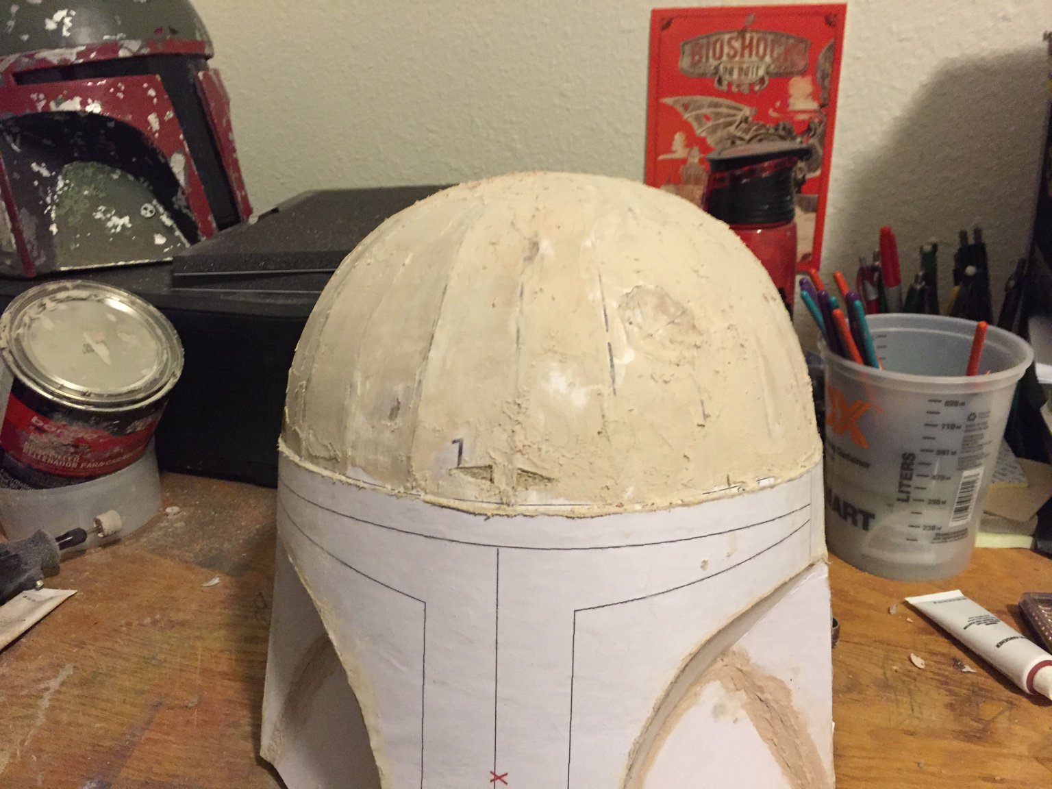

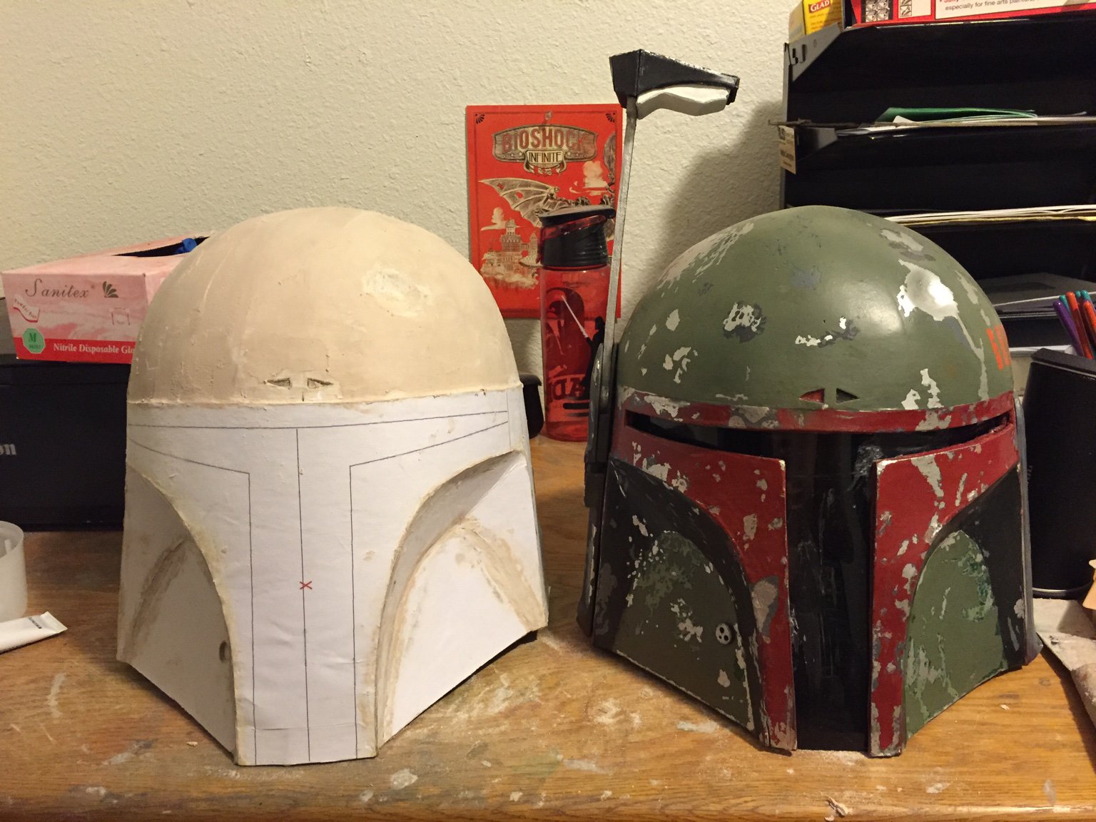

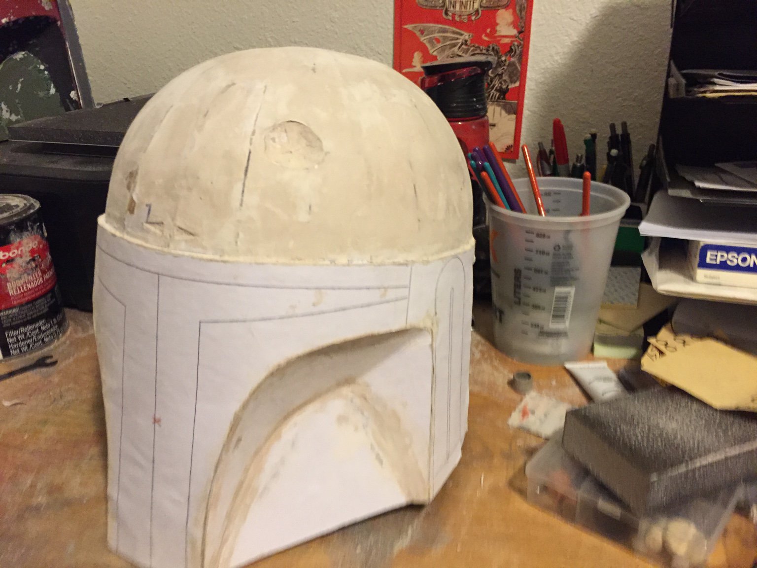

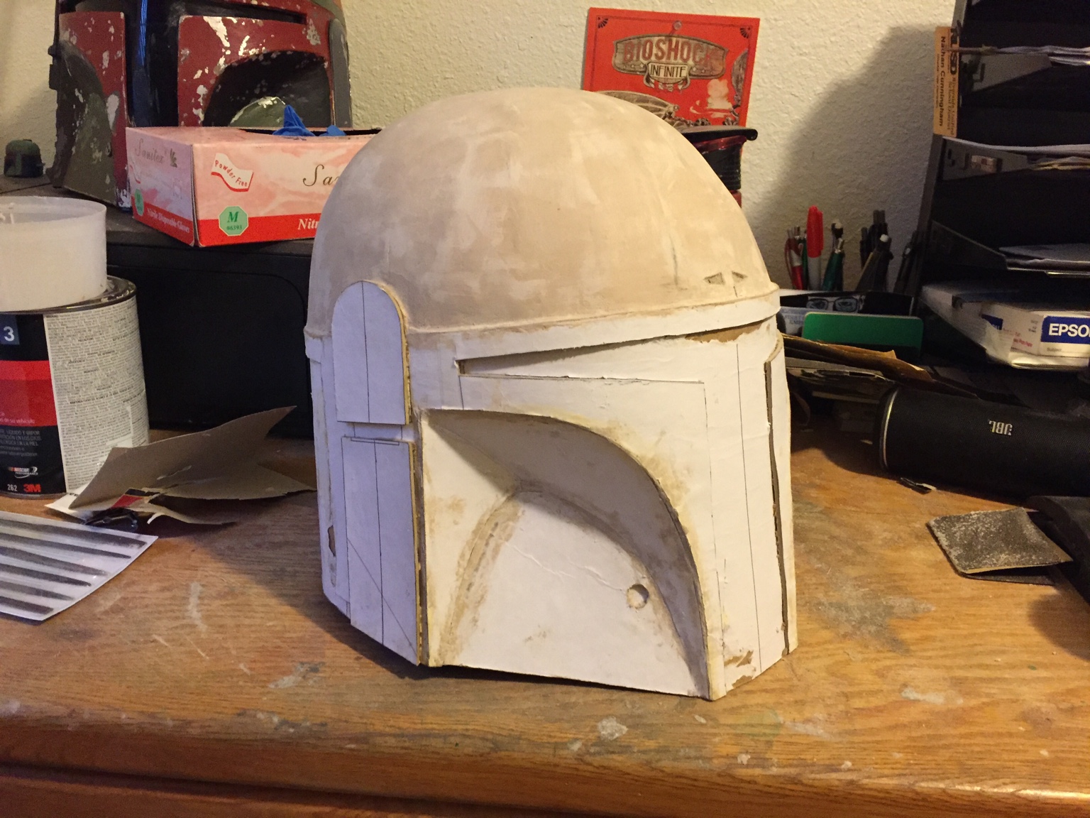

Here is a comparison next to my V1 bucket.
That's all for now. I'm going to finish up the dome, make sure all my holes are cut out where I need them, seal the bucket, and then it's on to the painting!

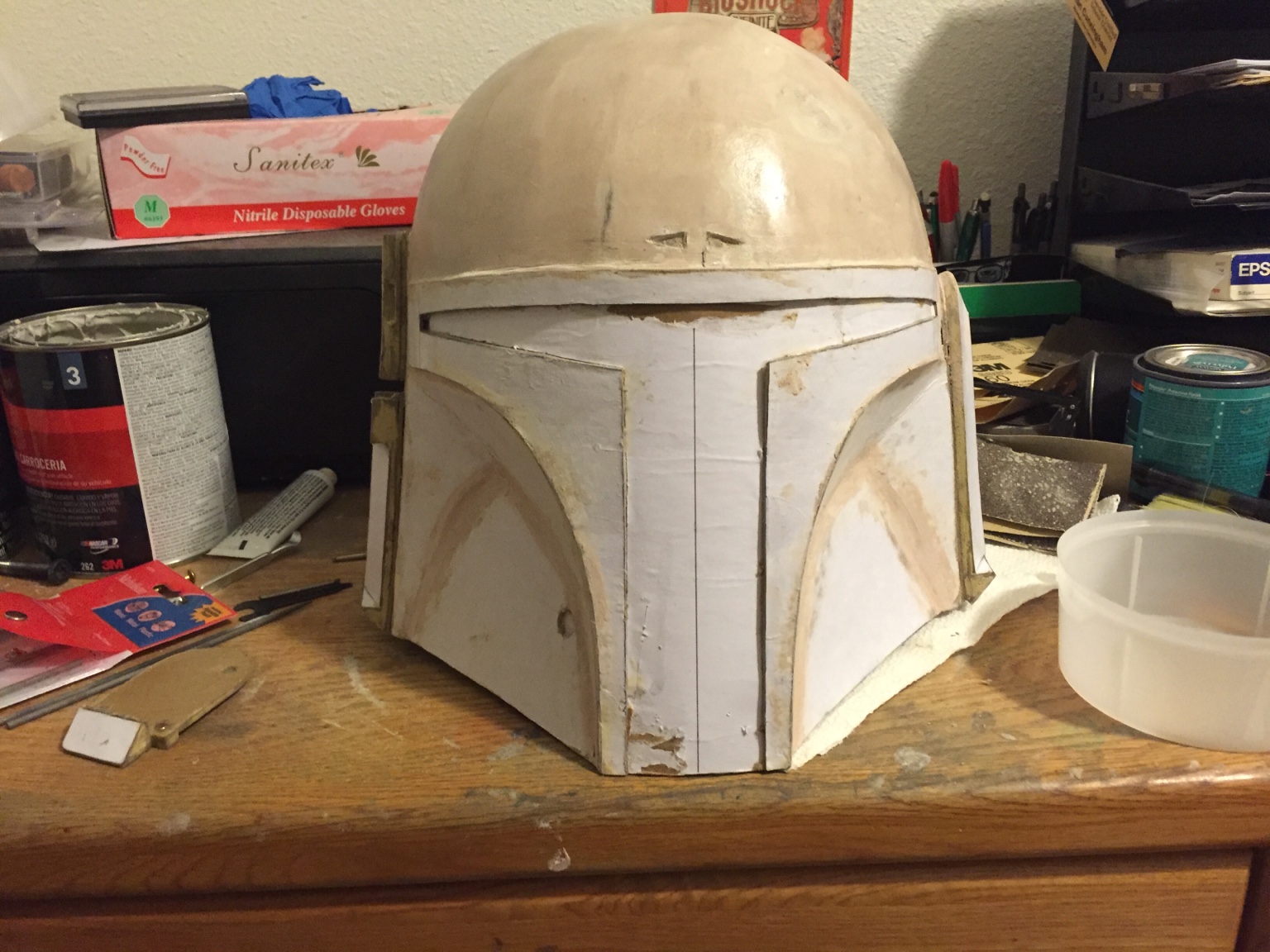

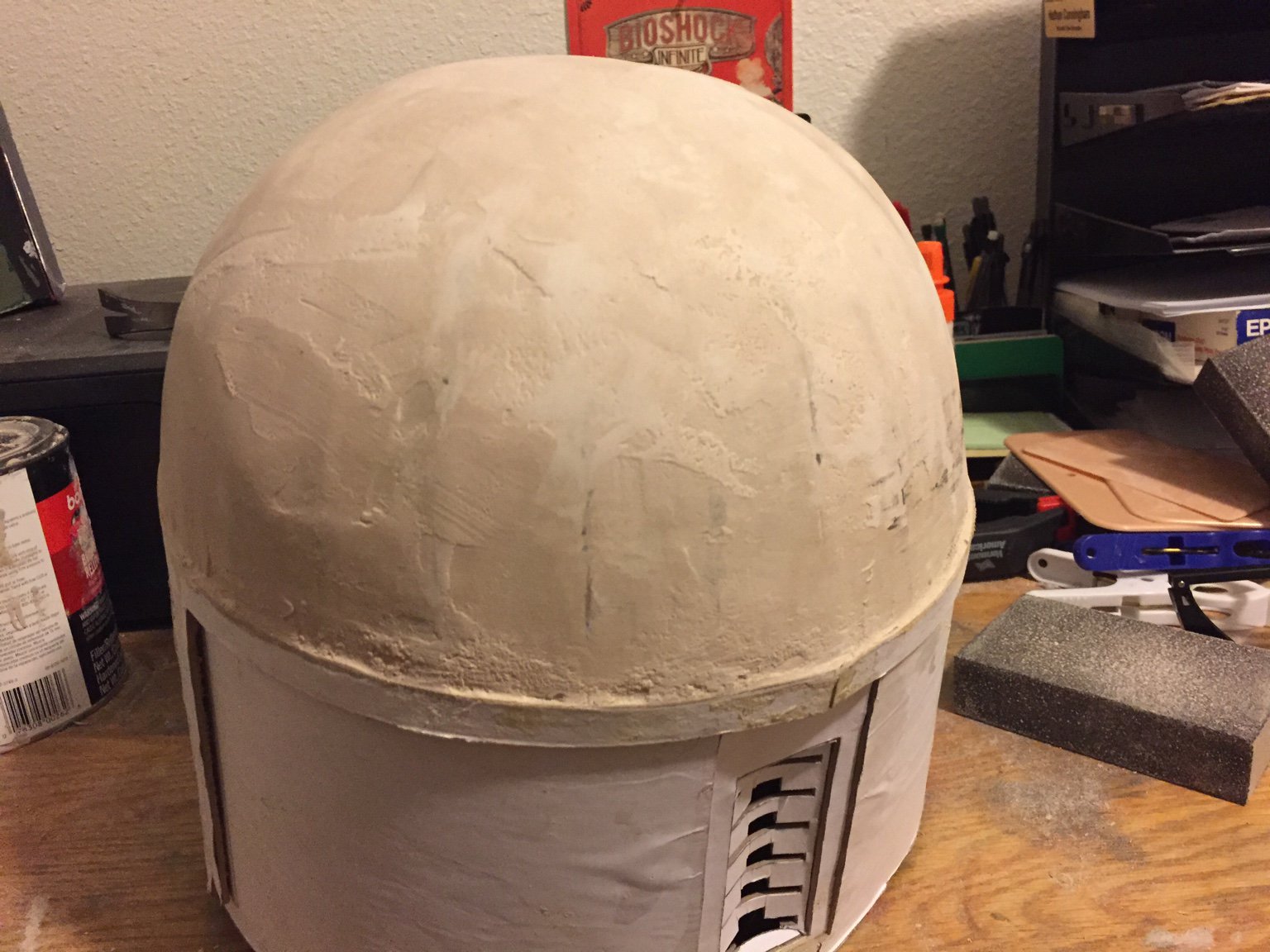

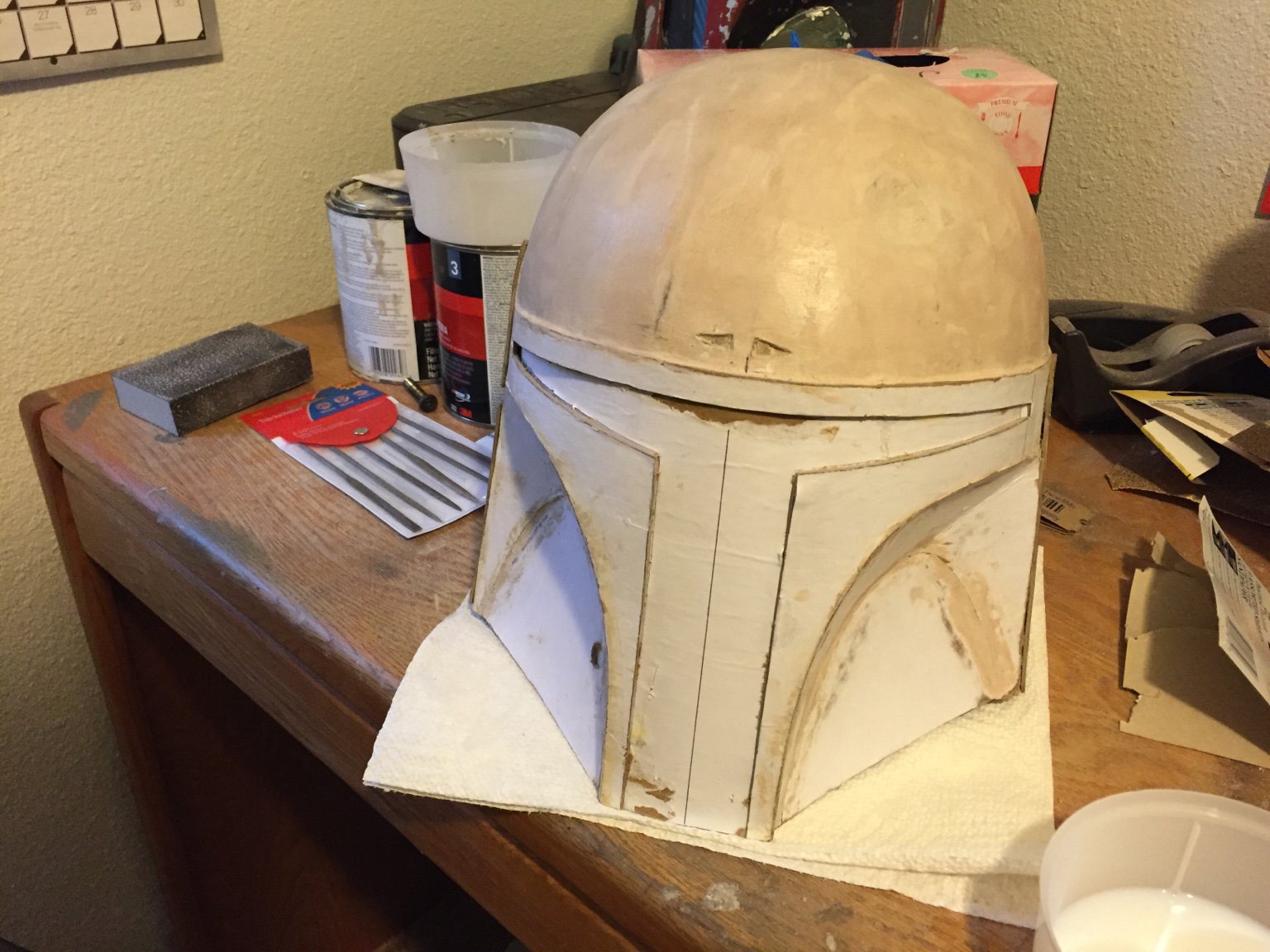

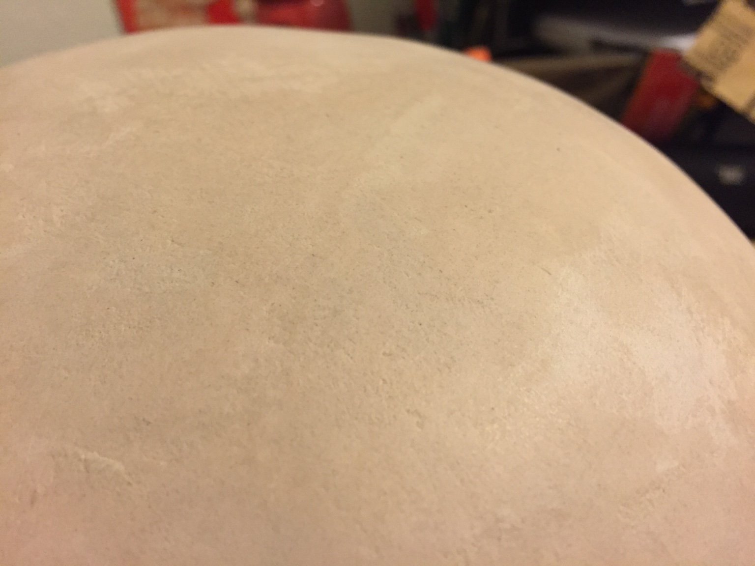

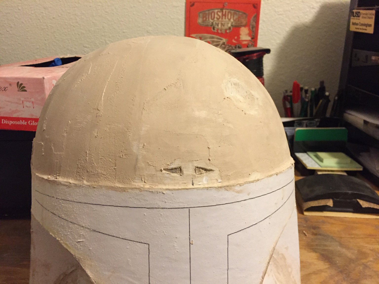

Okay well I got the fifth layer sanded, and have done a couple of touch ups
Smooth :)
I also cut out the outer layer from the visor so that when I primer I won't lose the visor placement
I would say this is pretty much my end product. I like it
Knowing myself I'll do a few more tweaks here and there.

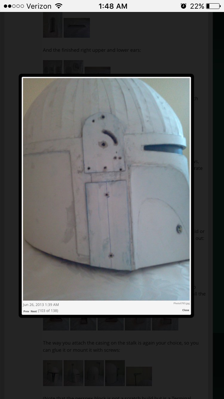

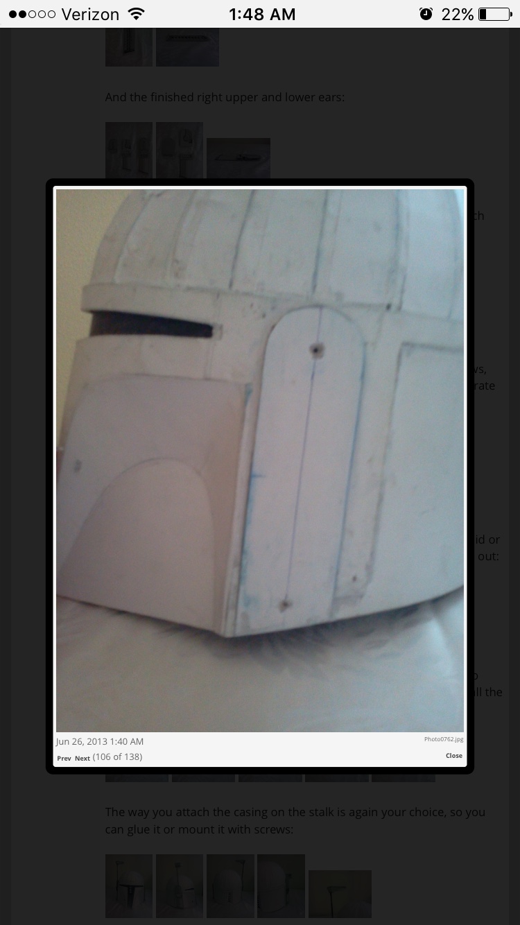

Now I'm gonna put on the bases for the ears, like in these Rafalfett example pics

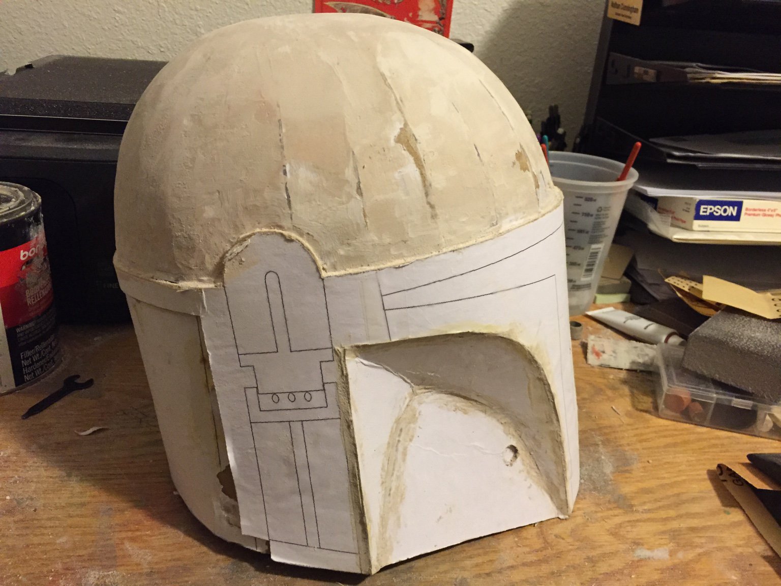

Short update because I'm bored at work:

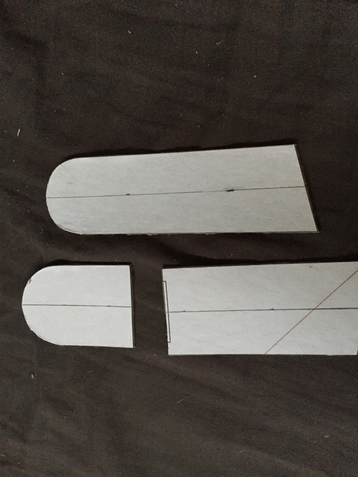

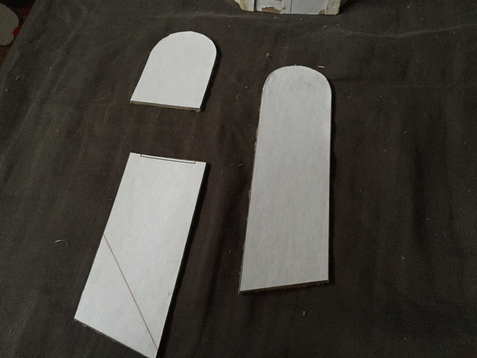

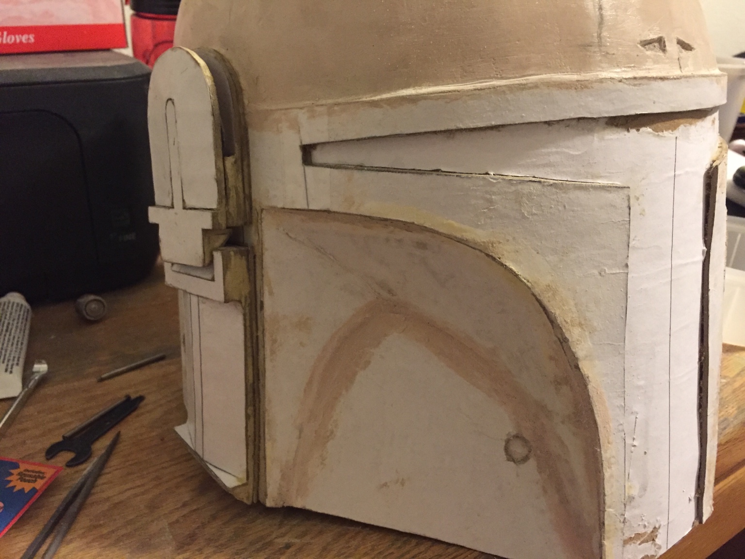

I cut out the ear bases for the left and right ears, and used a ruler to measure and draw a center vertical line for later reference when putting the screw holes in
Got them on the helmet with generous amounts of wood glue :)

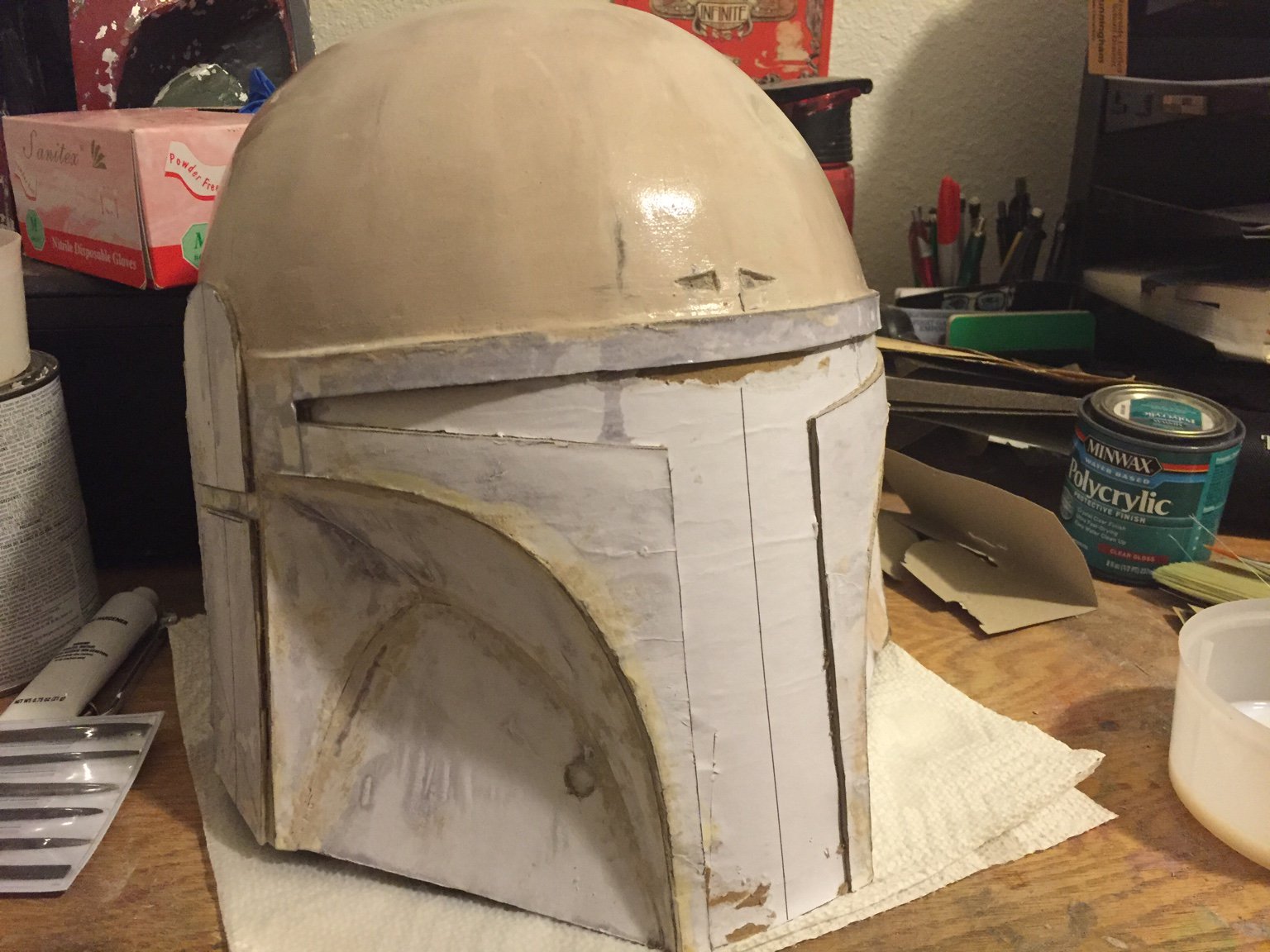

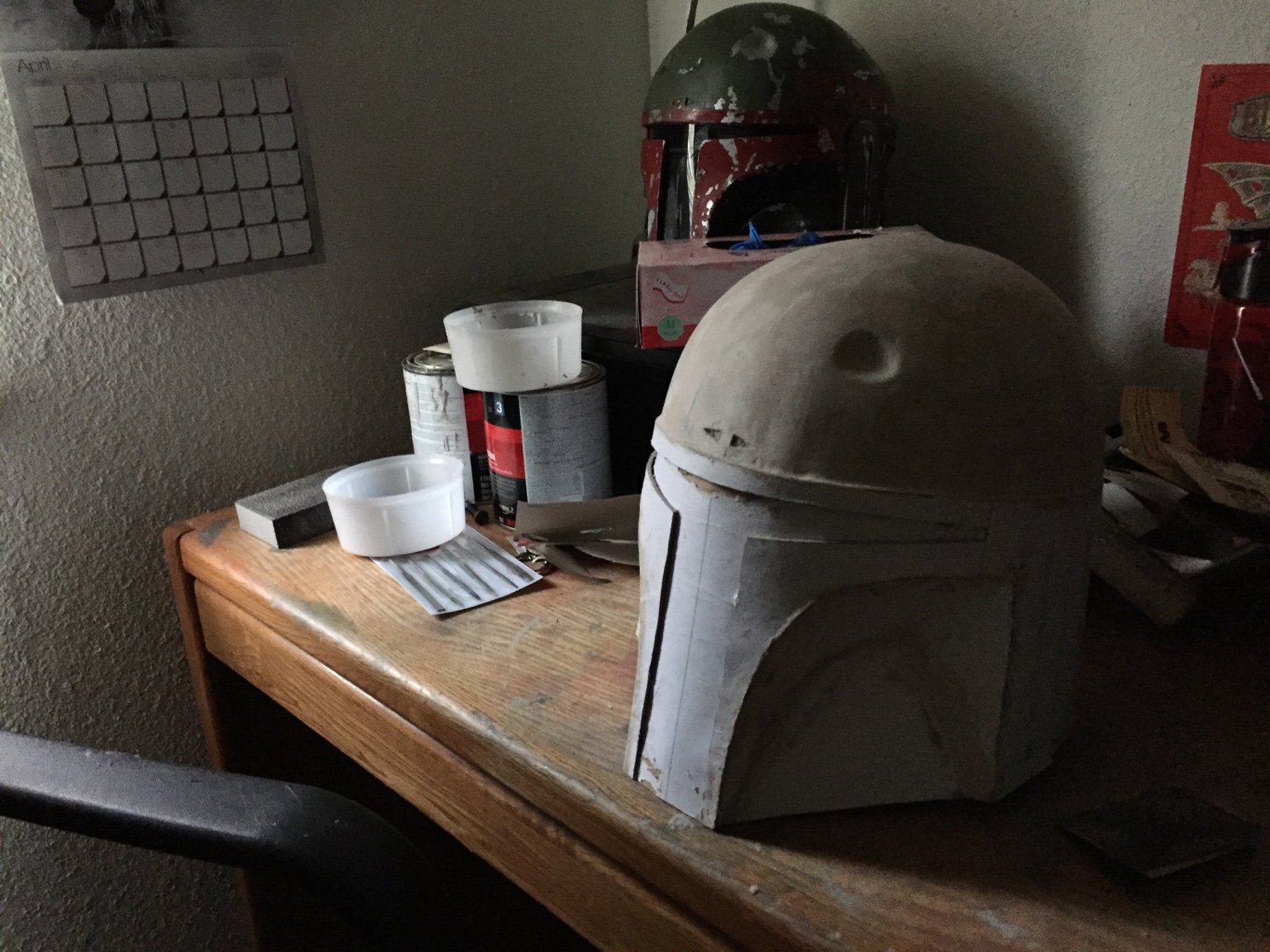

The helmet looks pretty good to my eyes, so I decided to go ahead and seal it. I was worried because applying the mixture of Minwax sealer and water directly to the paper (which is still glued to the outside of most of the helmet) made it soggy and start to deform. Only the paper on the outside did this, the cardboard was fine.
But when it was all dry the paper returned to its original form so it worked out fine! :)
And I gave the ear pieces a quick coat as well

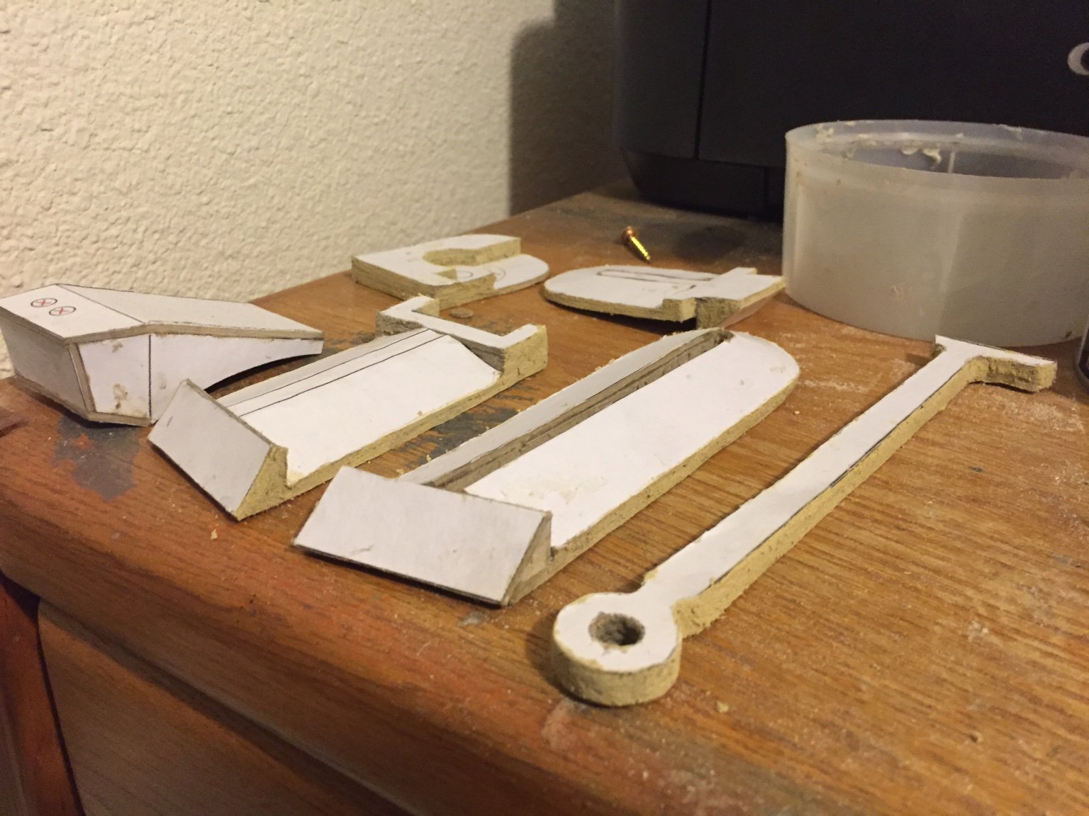

Honestly I would say they are different, but comparable. I think the WOF build is SLIGHTLY easier, mostly due to lack of inner supports (and none of those damn ear part supports!), but Raf's seems like a higher quality and sturdier build.
For example, the left ear took forever in Raf's templates because of all the supports on the inside, but that thing is sturdy as a rock and looks very smooth and high quality as well
My opinion is that if you're okay with a little extra work and some extra headaches here and there, Raf's build is the way to go. But it's personal preference.

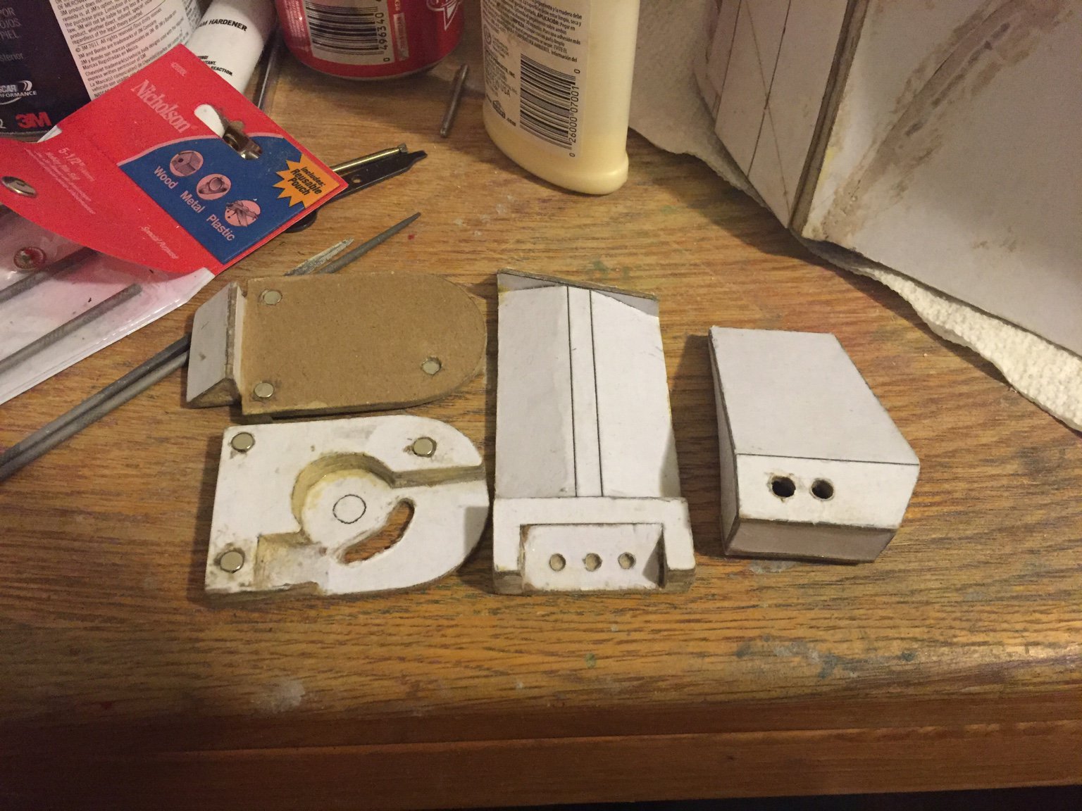

So I have hit a bit of a snag as Far as figuring out the electronics is concerned. I was trying to wait on doing a ton of work on any of the ear pieces until I had that figured out, but it's not going well so I'm pushing on for now

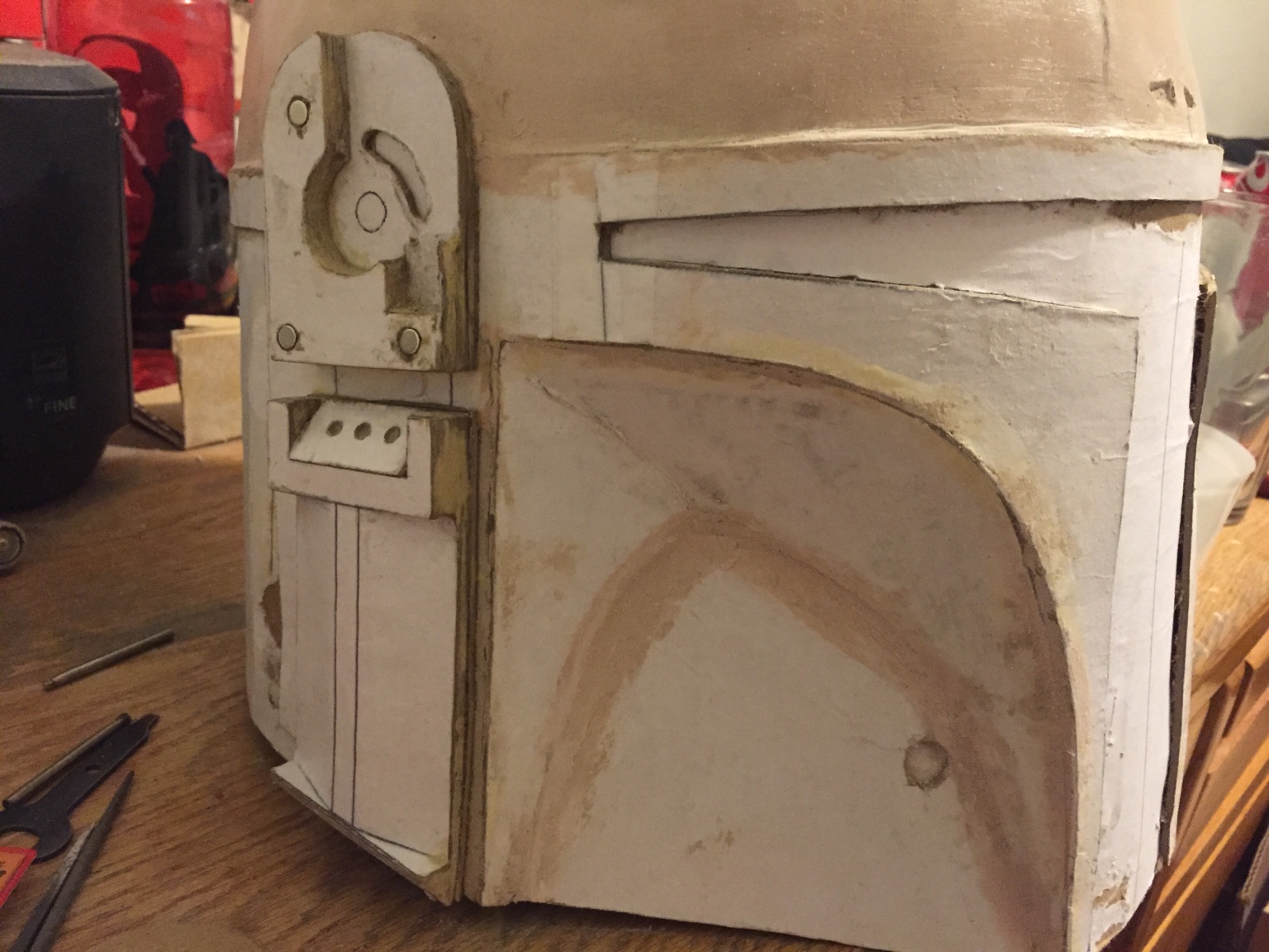

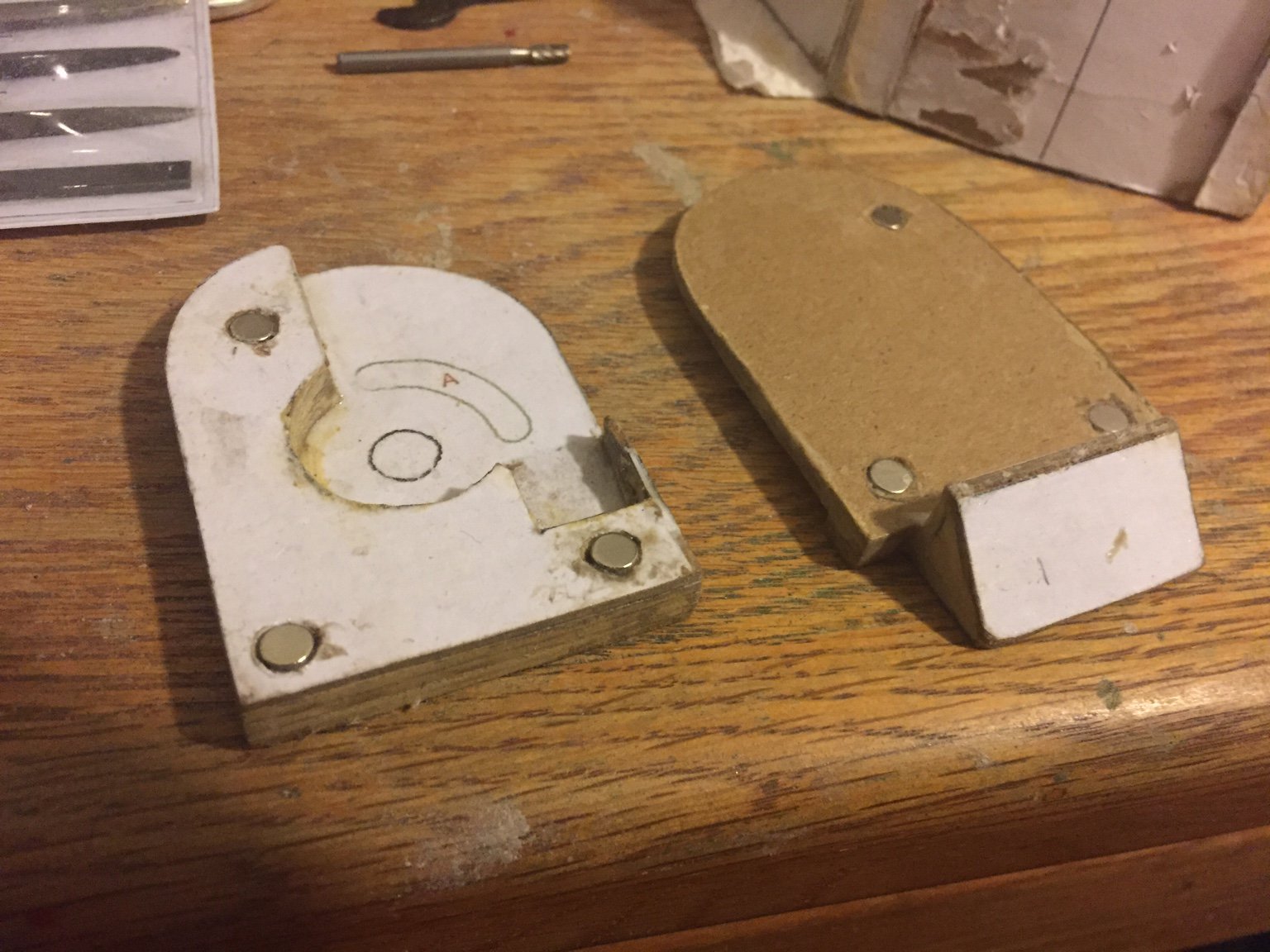

I need to get some screws in order to attach the ears to the helmet (which I will actually attach after painting). So for now I just went to work with the dremel, putting in some rare earth magnets in the upper right ear as well as knocking out a couple of minor details
Once I get those screw holes drilled out of the ears and ear platforms, im gonna move on to painting. If I find a way to make it happen I'll add the electronics after that
I was going to use screws to attach the ears to the bucket, but I couldn't figure out how to do it and have it look good (mostly on the left ear and lower right ear) so I decided that for this one I would just glue them like with my last build. I know screws are more accurate but that will have to be an improvement I incorporate on the next build

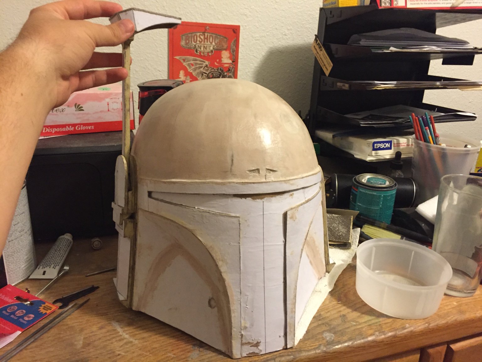

Holding the RF on to see the final product :)
So I haven't gotten the RF assembled yet. That will be done after painting it. And I still haven't figured out what to use as the post that the RF stalk rotates on. I'm not sure how the servo fits in with that so I'm leaving it as is for now and I will move forward with painting.

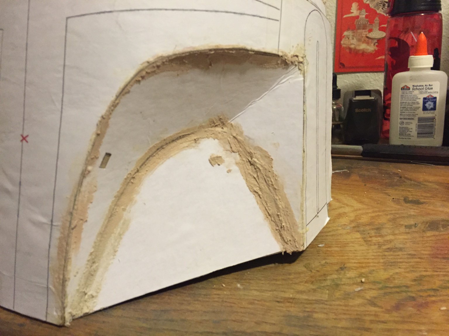

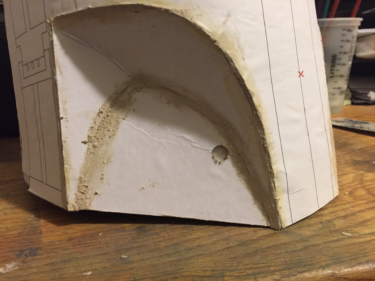

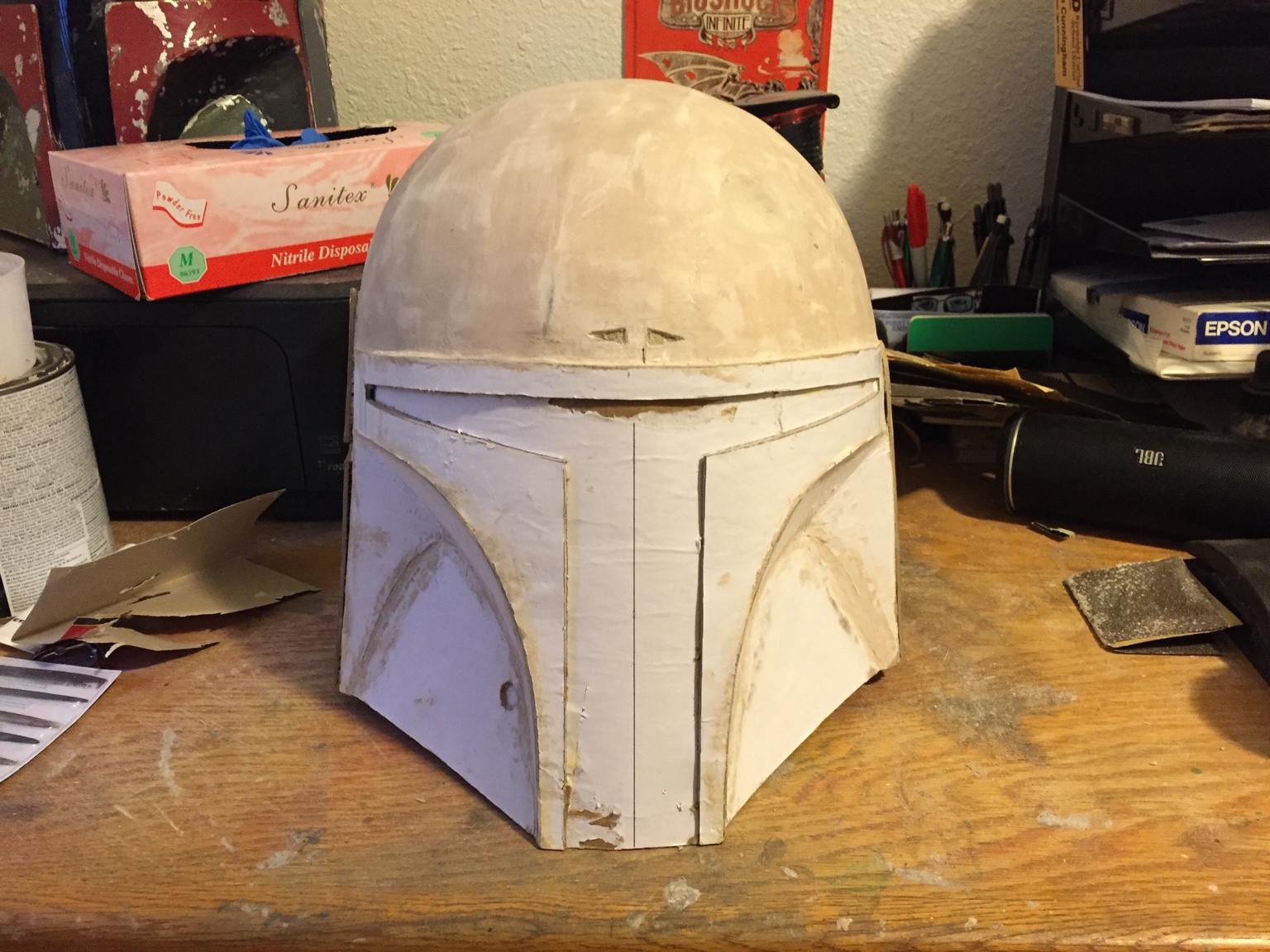

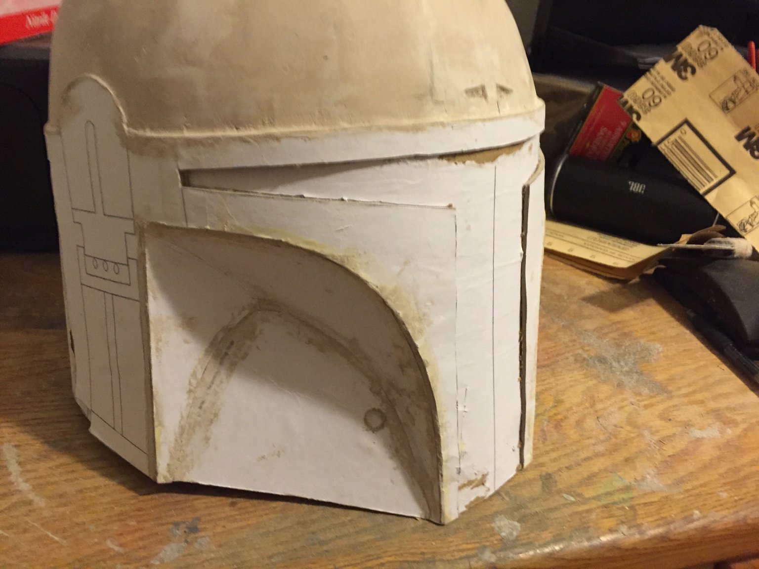

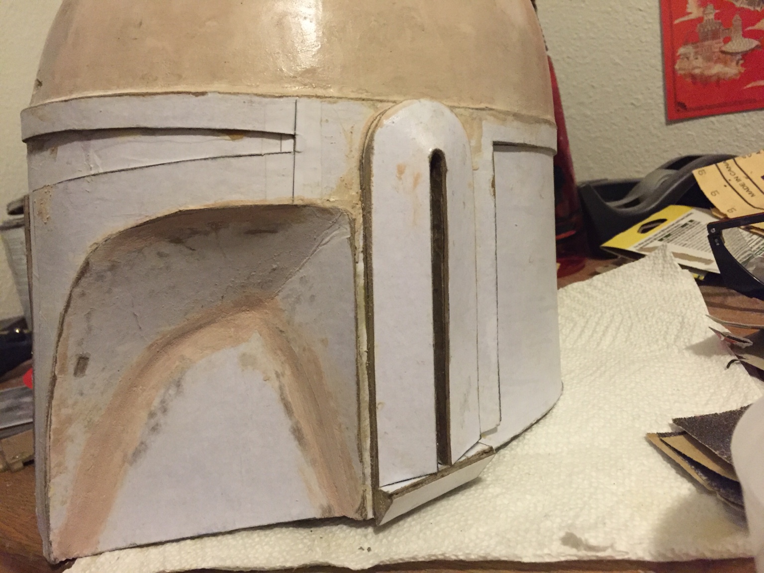

I also touched up the bondo work on the cheeks
Pain in the ass to match the contour of the cheek
Next update: last minute touch ups and then the primer layer and the silver undercoat!
