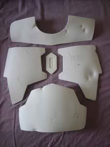

I put my Sintra peices in the oven.. after about 5-10 in 50 degree Centigrade the edges of the sintra begin to flex upwards (why it does this i have no clue) but at this point its soft enough to bend but ard enough to give you some resistance. I then picked up the peices (with gloves) and placed it on my chest and i bent the edges a bit..
Works really well... oh.. and i use an electrical oven.. don't know how it would work with a gas oven..
Here is a pic of my armor
