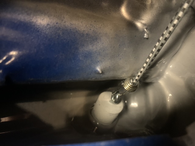

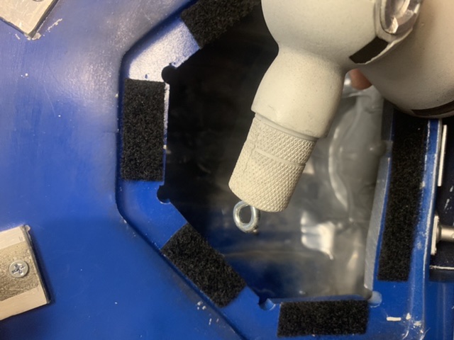

I’m not familiar with the construction of DVs jetpacks, but on mine I attached eye bolts into the ends of the thrusters that go into the JP and then on the inside I used a small bungee chord hooked into the eye bolts to add tension to the thrusters to keep them in. You don’t really want to permanently attach the thrusters to the JP because they tend to hang up on things and break off, causing a lot of damage to the jetpack.

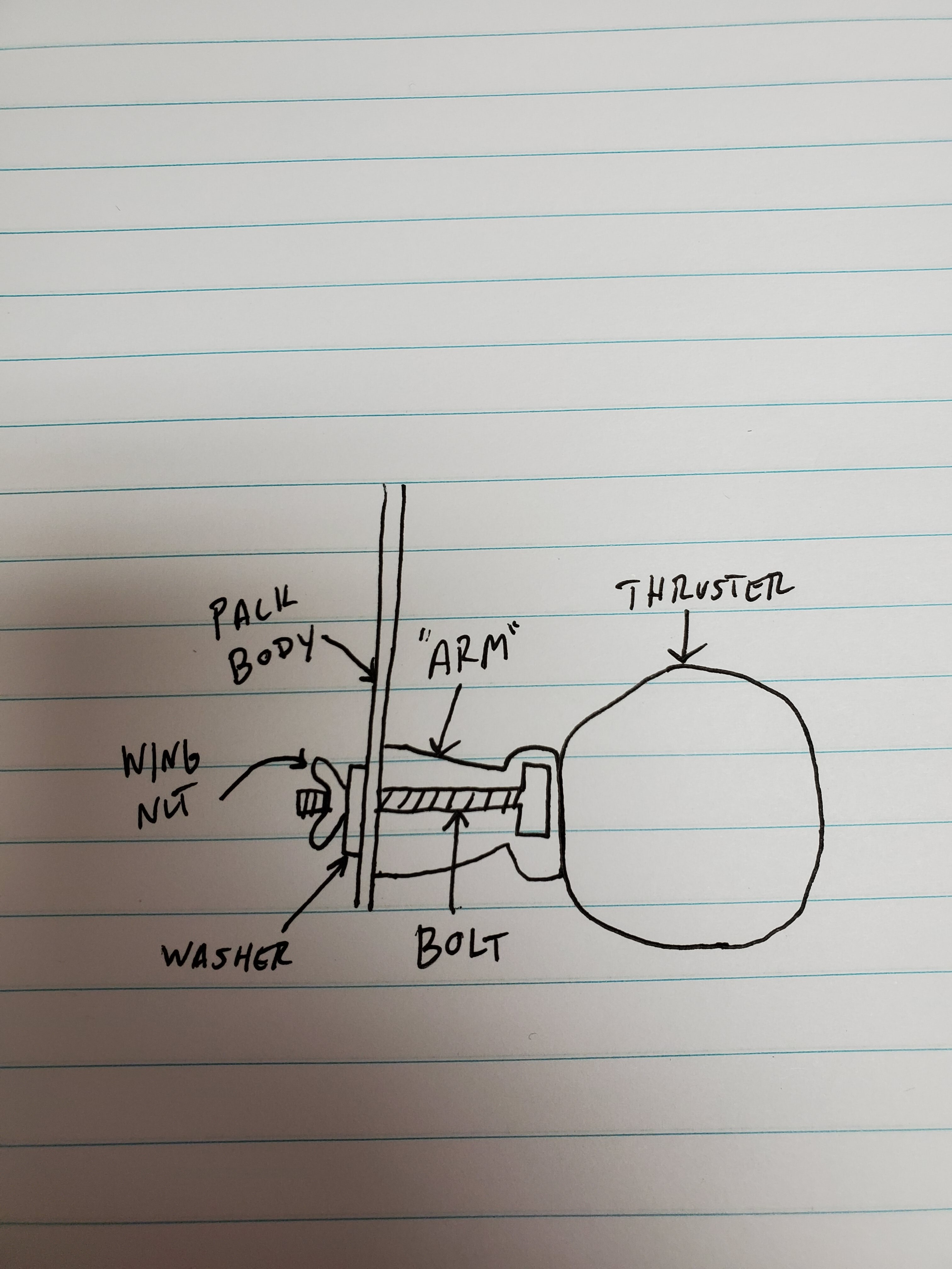

How I did mine was I epoxied a longer bolt inside of the arm with the bolt head countersunk on the outside end of the arm. Then epoxied the thruster body to the arm. I did it this way so when you tighten the wing nut inside the pack, the bolt head pulls the arm inwards. I felt like doing it this way would make it more secure.
Hope this helps!
