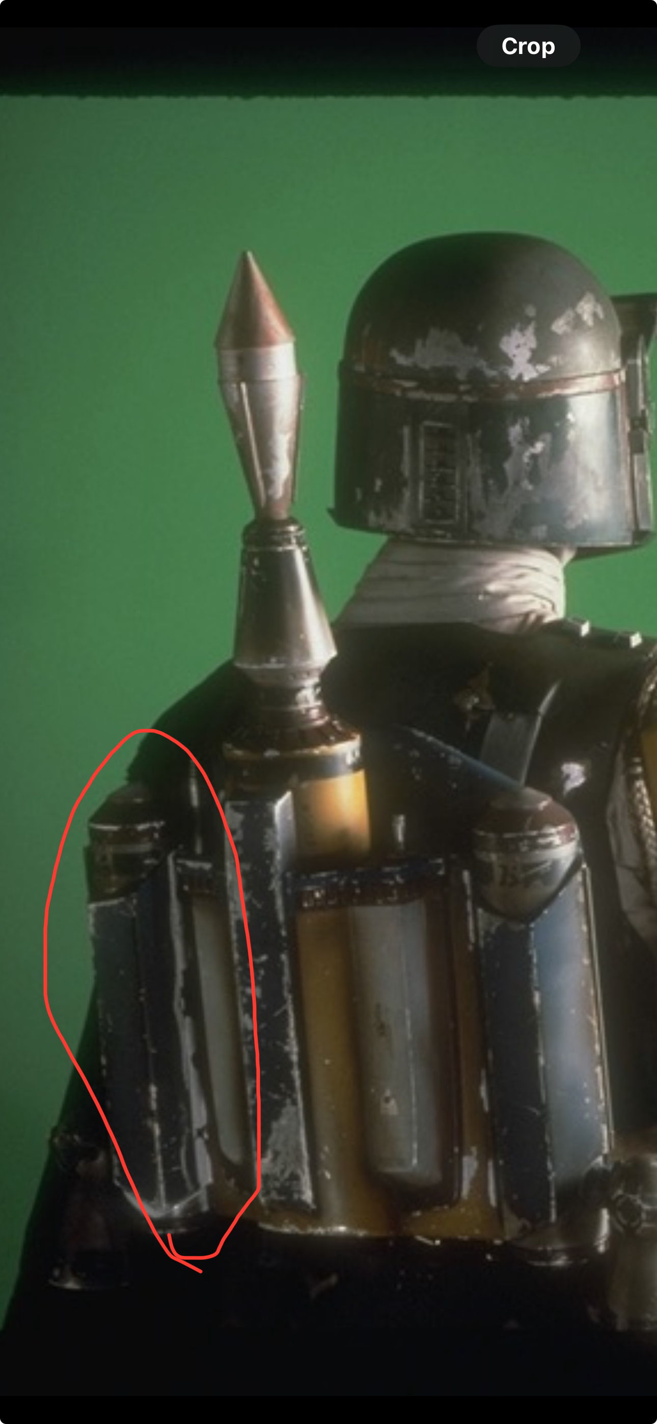

Silver. Some people believe this area marked is white, but I think it’s just silver reflecting light. There’s area of clean and dirty/weathered silver.
I went the silver route.

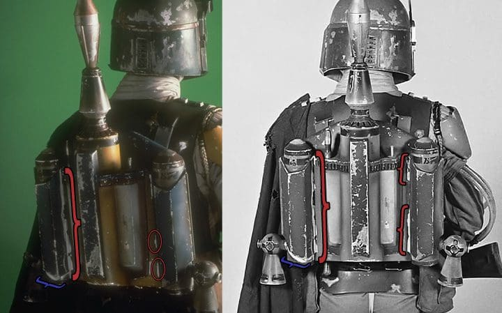

The area circled in your first image is white. It's the paint naturally chipped off reveling the gelcoat of the fiberglass. The chipping wasn't there earlier in production and it was fixed before filming. You can even confirm this because the tank is slipping out showing the white gelcoat, which it also does in the SE photo shoot - also white. There is a lot of smaller white chipping around the pack too because it was handled so roughly before actually making it on screen causing a lot of paint to naturally chip off.

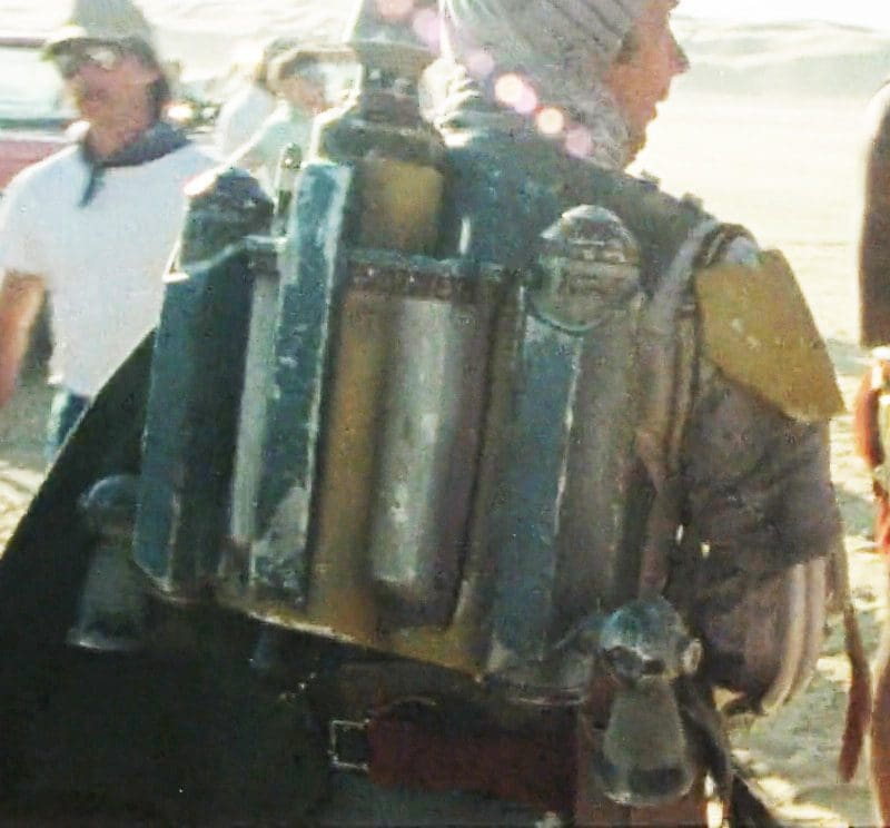

All the accidental damage
Fixed before filming, Glenn seen here wearing the Hero pack during filming.
You can still kind of see it because they very quickly sprayed over to hide it.

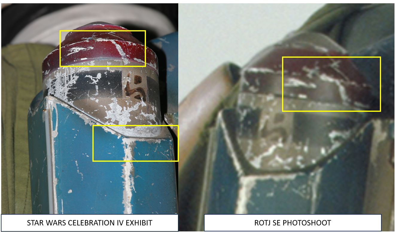

I've been burning my eyes looking at jetpack reference in preparation to paint my ROTJ SE, and it took me long enough to realize the left tank slipping down on the SE Promo tank. I couldn't understand why the weathering/chipping looked so different to the Star Wars Celebration IV photos on that area, but I guess it was just hiding!
Also interesting thing I noticed, the top left red fuel tank cap appears to have been rotated sometime between the SE photoshoot and the display of the pack. You can see the white damage has shifted over. Possibly when they "repaired" the sunken fuel tank?
All in all it's been incredibly tough for me as well to differentiate what damage is silver and what damage is white, I feel almost colorblind sometimes lol Neo Fett's recommendation of close up reference and comparing to the fresh ROTJ paintjob has helped.
