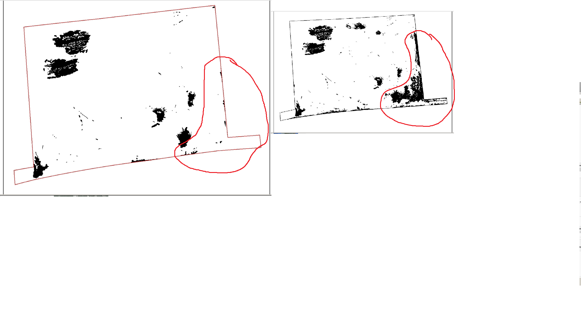

Hey Raf, the damage templates for these modified back panels looks to be more updated than the ones you have in the main post of this thread. Have you updated the stencils but not posted the changes here, yet?
The modified stencils are the v1 ones, while the stencils from the 1st post are the v2 (the better ones). I will update the modified files in the next few days.
RafalFett
Highlighting what I mean in red. This will be in the update?
If you look closely in the files from the 1st post, you will notice that there are 4 colors vs. 3 colors in the modified files. Some of the silver scratches are replaced by the base gray color and also I added the misted transition between colors.

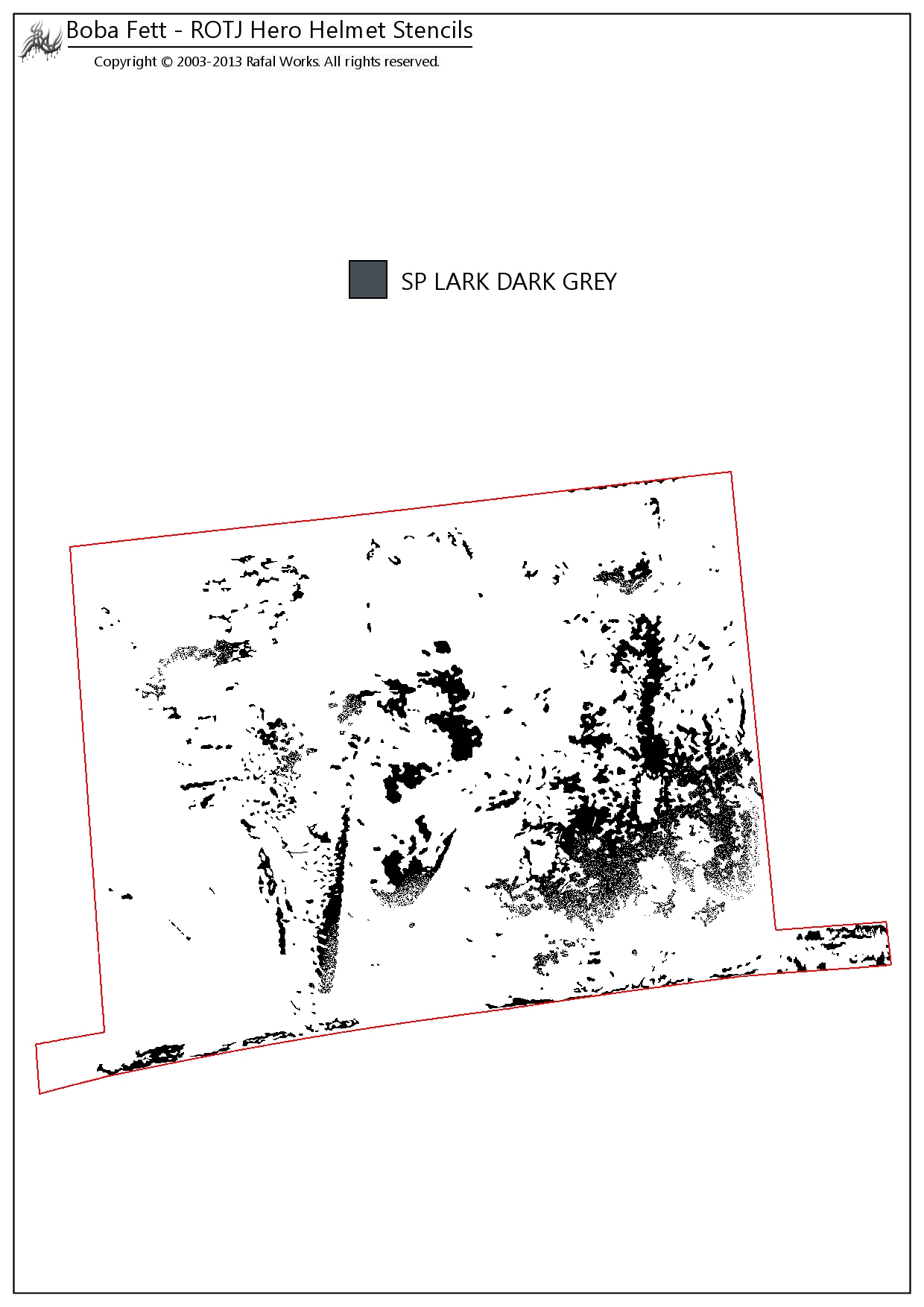

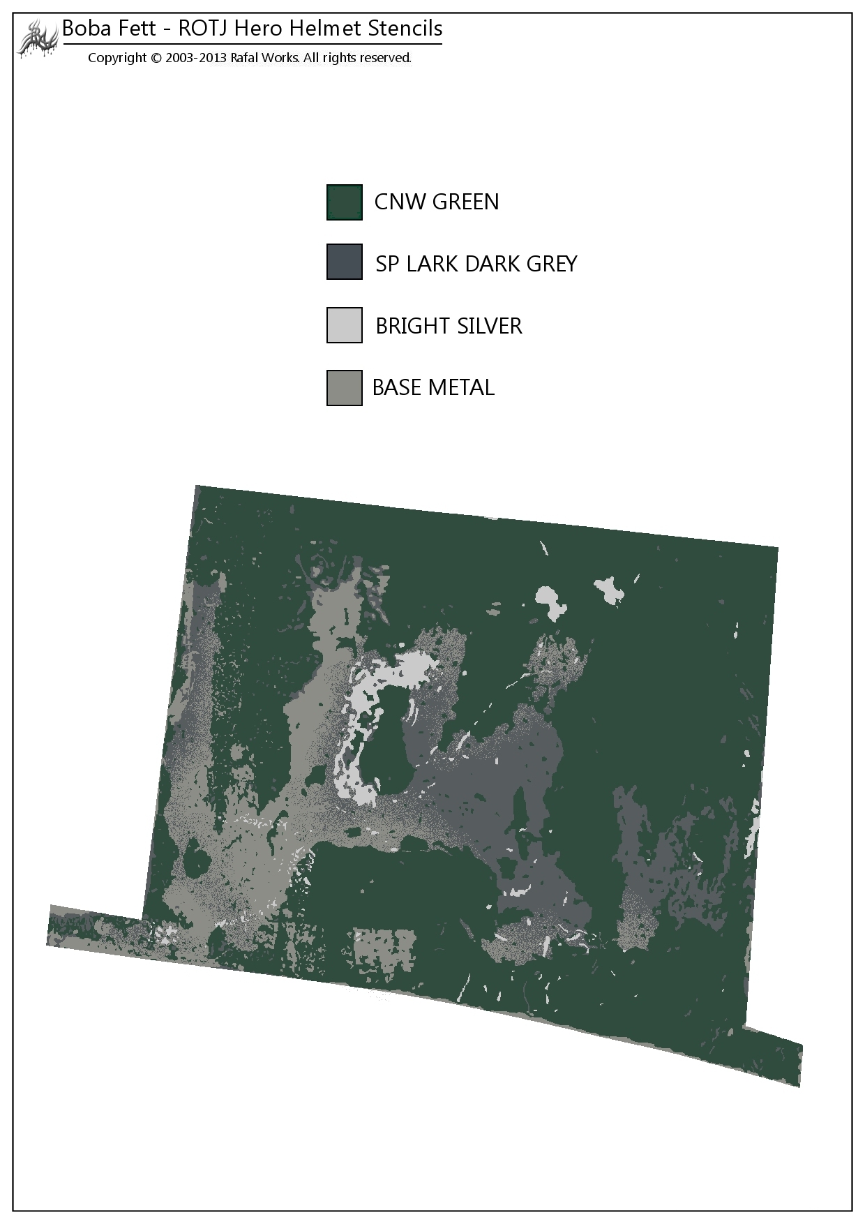

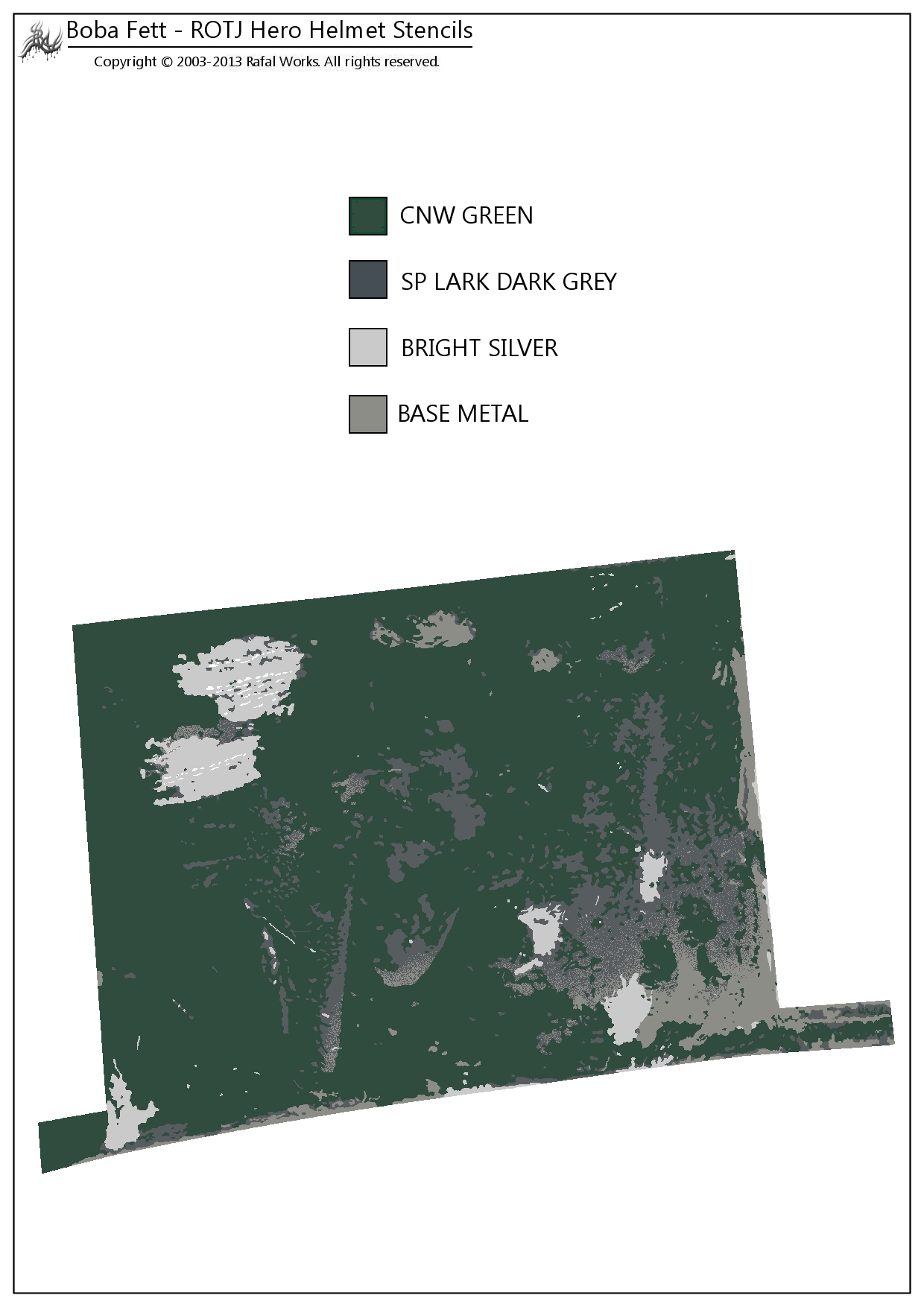

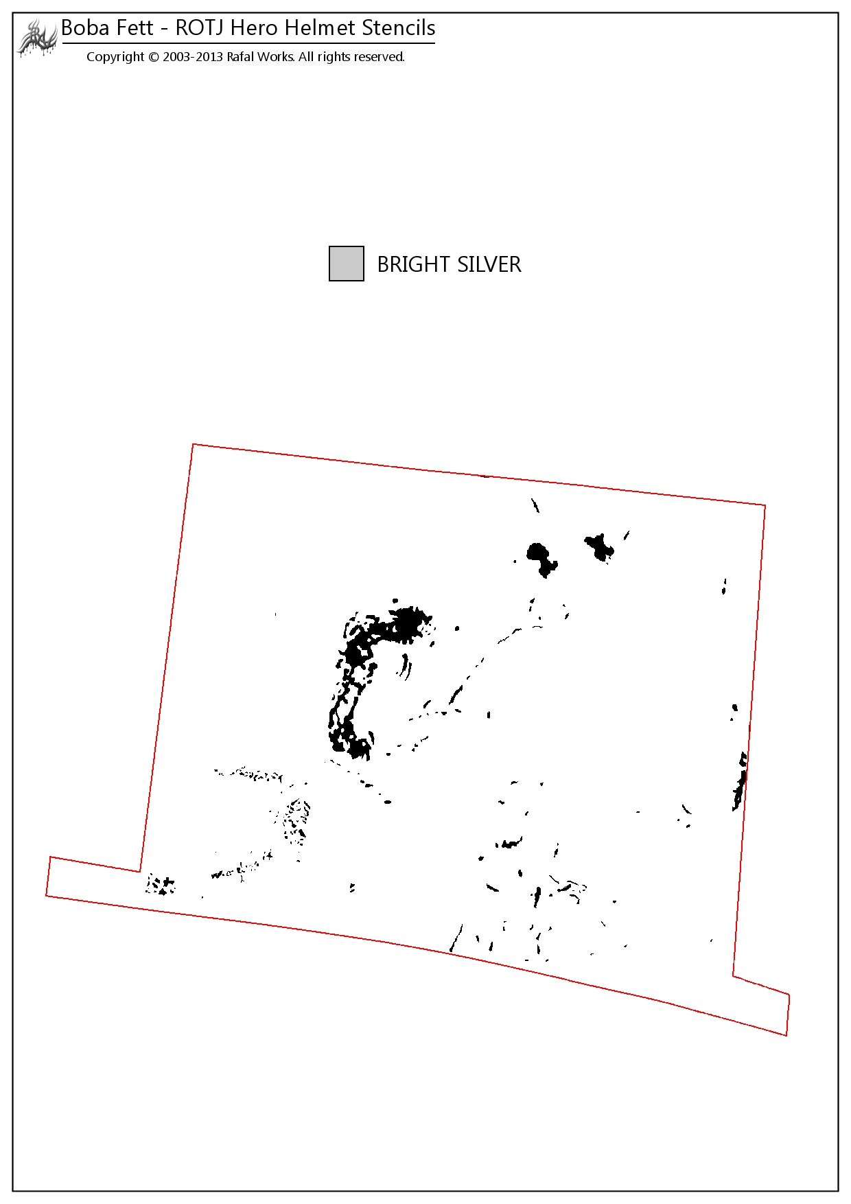

RafalFett

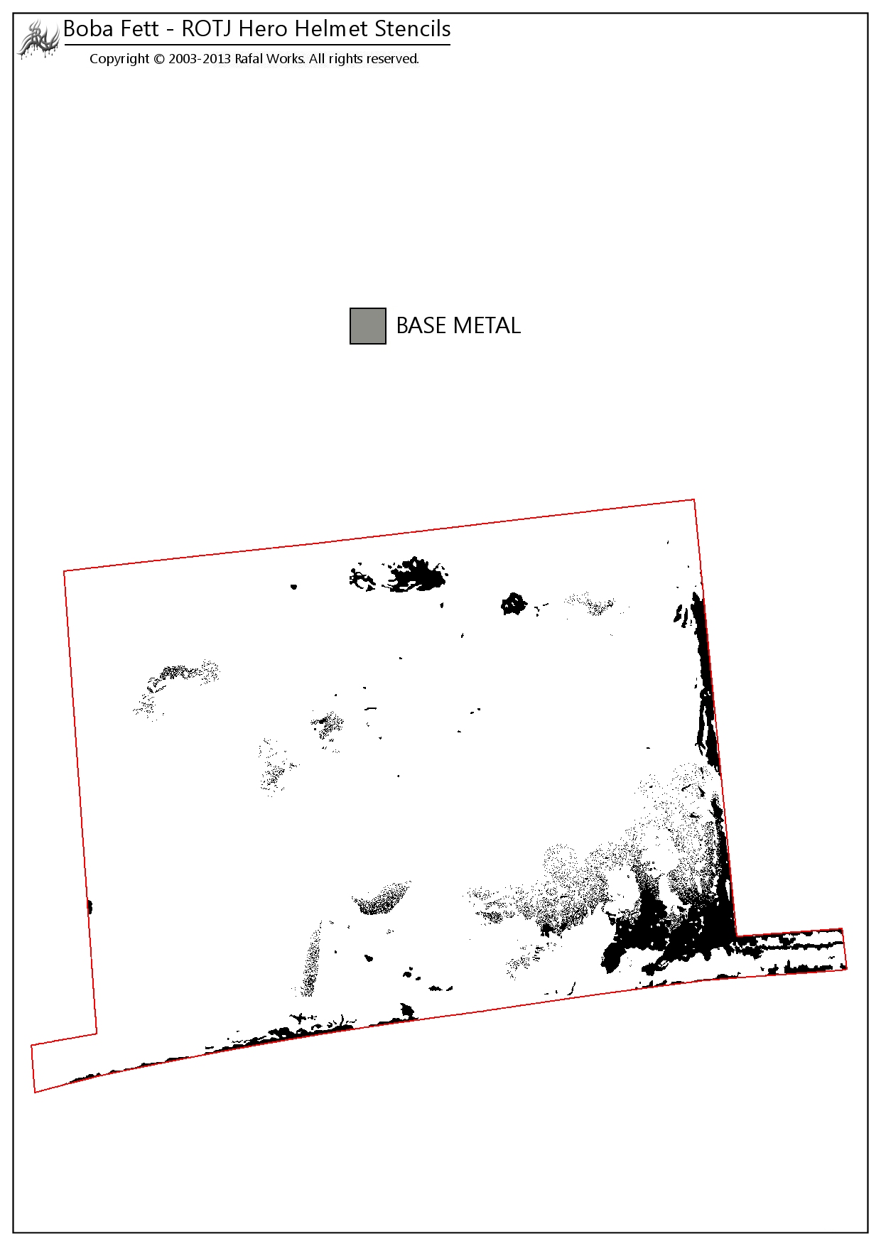

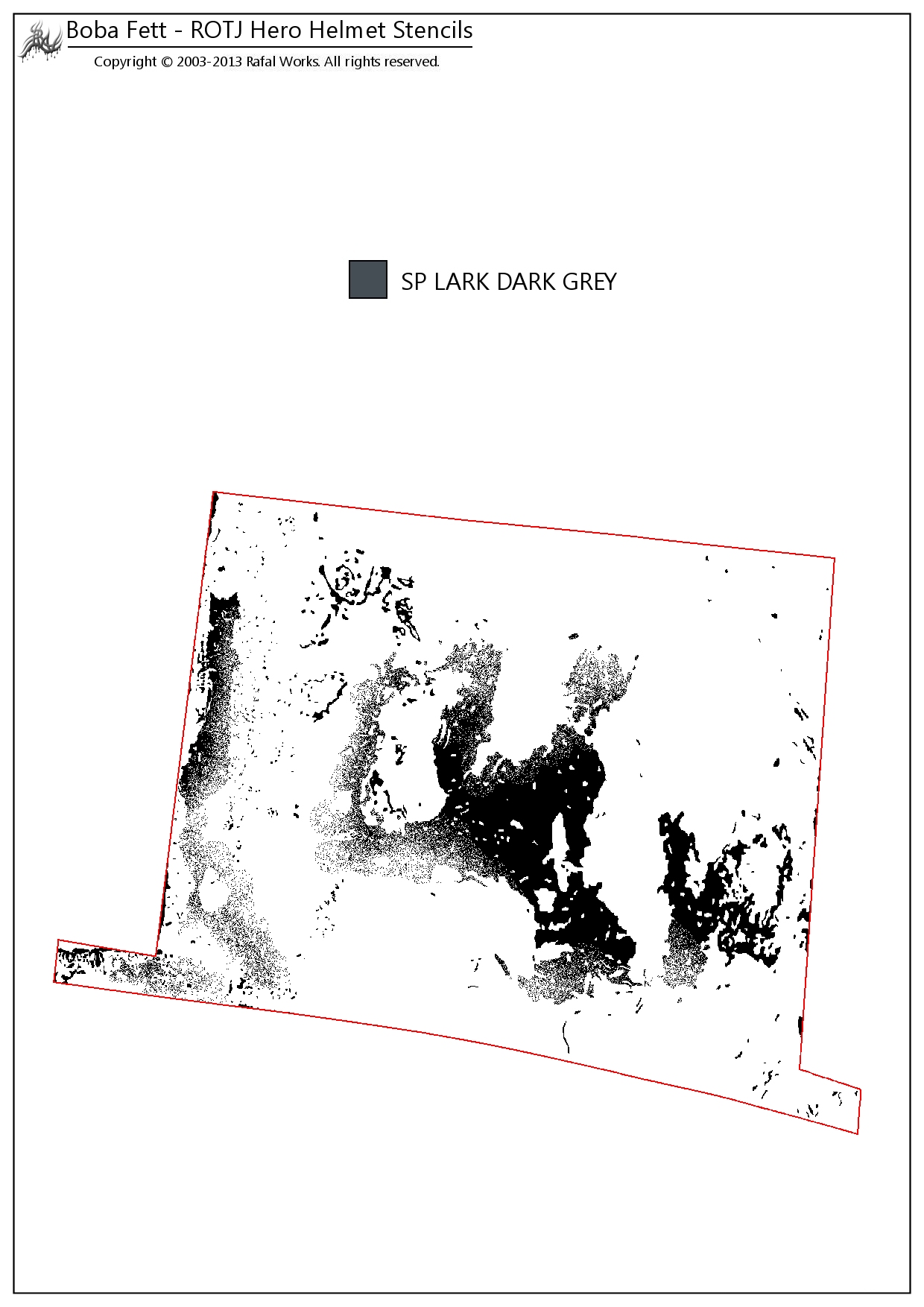

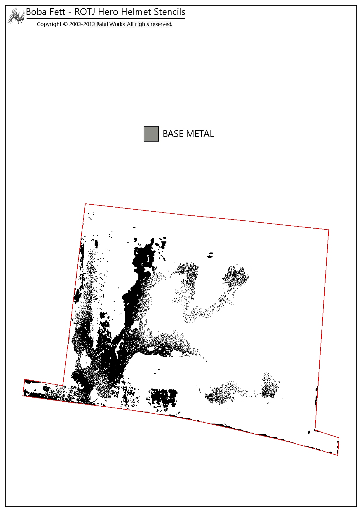

The first pages of the stencil file shows the finished paint scheme, the rest of the pages shows representations of each color separated from the final paint scheme:
Back Plates 01.jpg Back Plates 02.jpg Back Plates 03.jpg Back Plates 04.jpg Back Plates 05.jpg Back Plates 06.jpg Back Plates 07.jpg Back Plates 08.jpg
