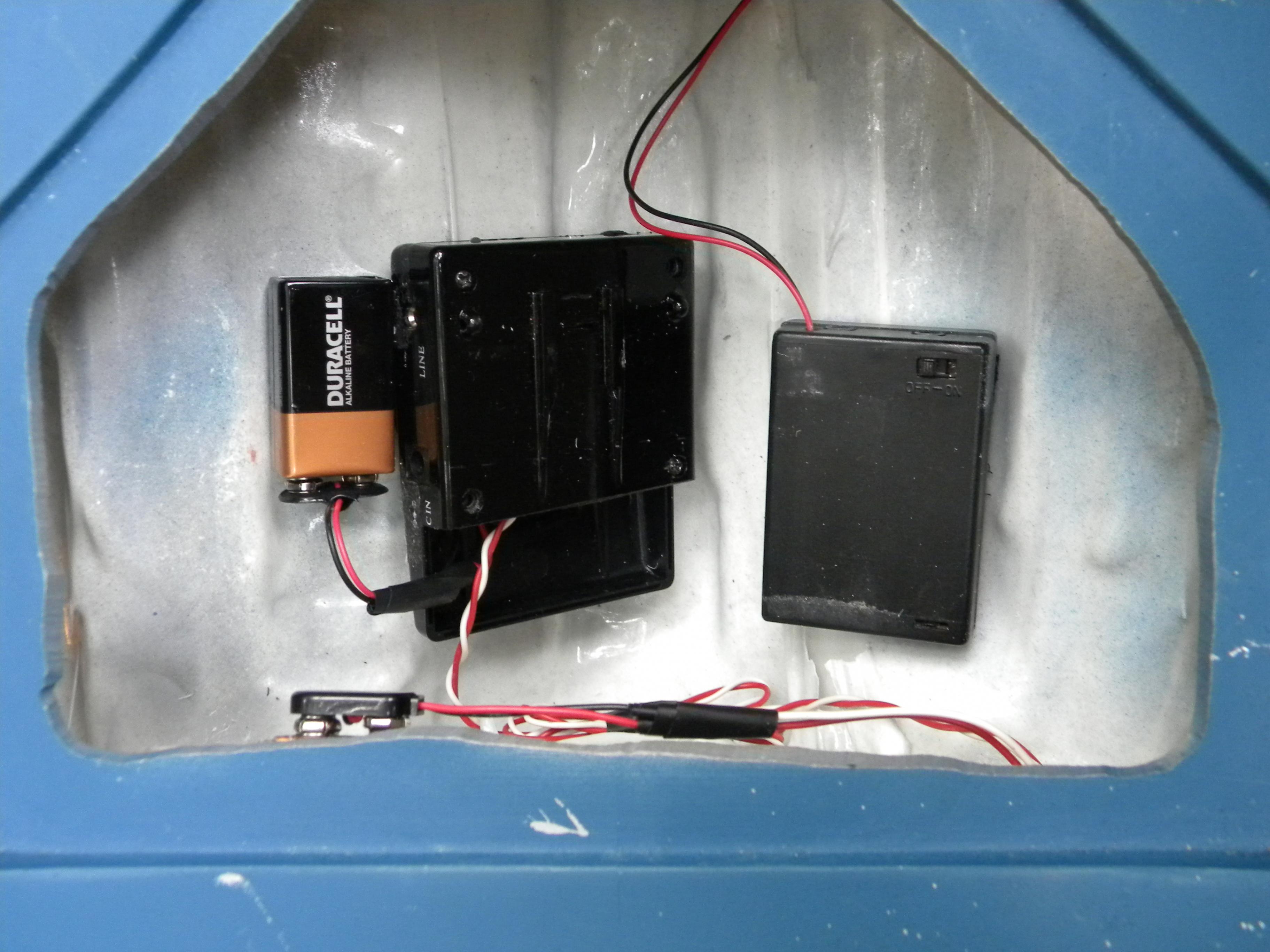

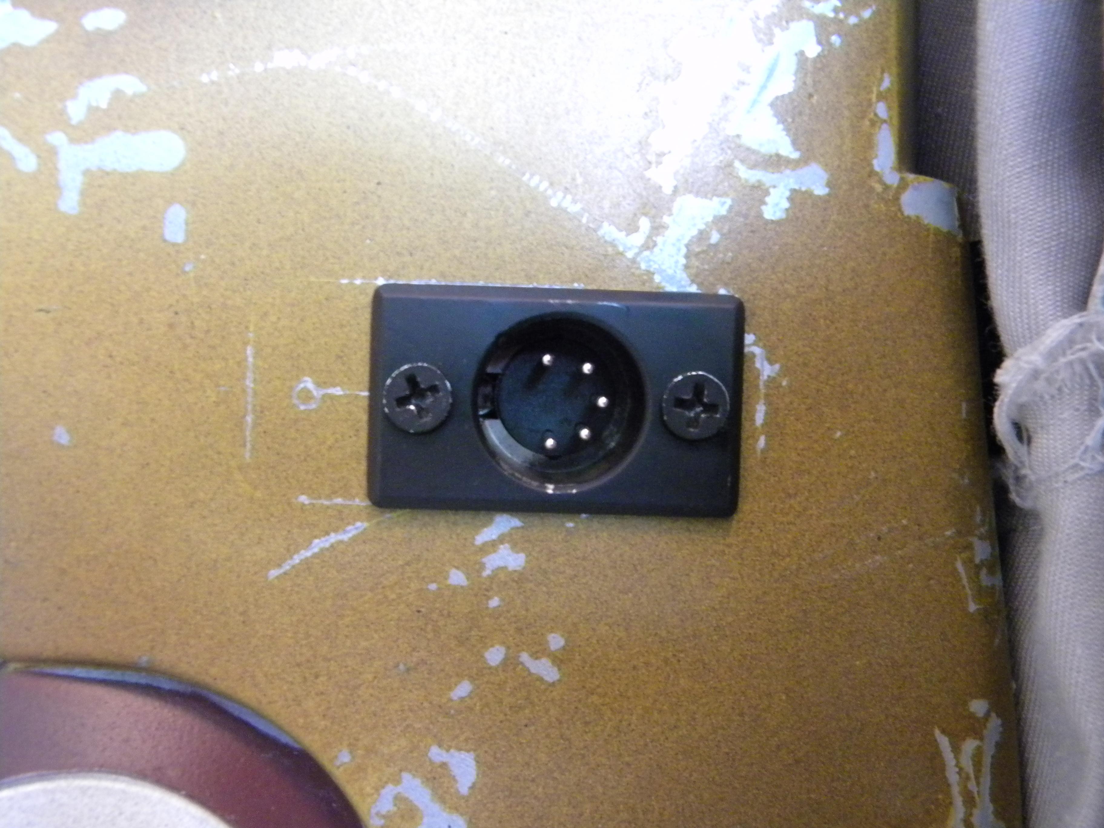

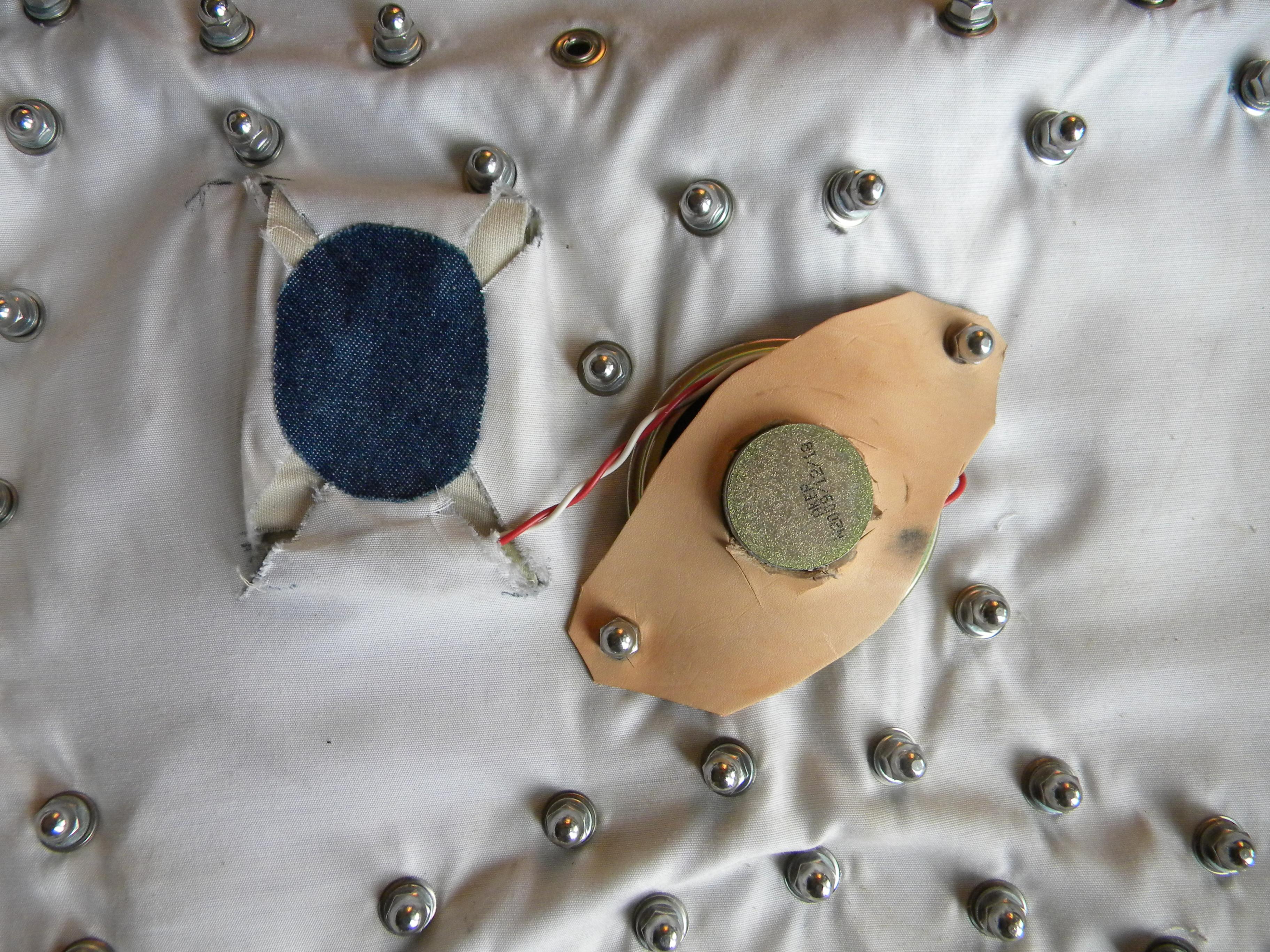

SOUND ADDED TO VEST !!!
Have been using my Aker amp inside of my left belt pouch. But having people talk to my crotch got old.
- I disassembled the amp, removing the speaker and also replaced the original rechargeable battery with a 9V (the thing just wouldn't hold a charge longer than an hour).
- The speaker was then mounted in the vest, directly behind the center diamond plate.

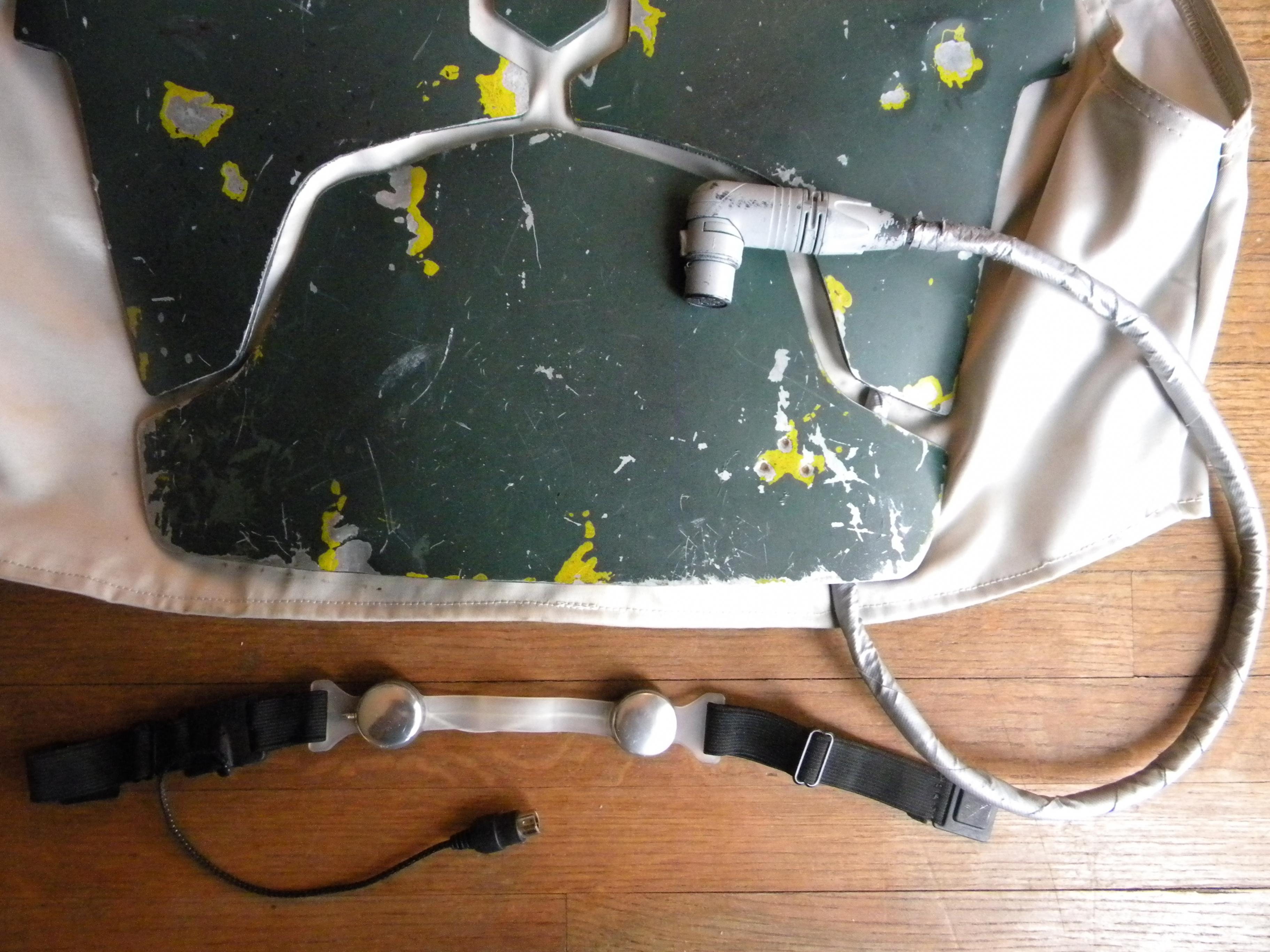

- I added two wires to the 3 wire XLR that currently supplies power to the chest displayed and wrapped in gray gaffer's tape.
- I replaced the 3-pin XLR panel mount and right angle plug with 5-pin versions.
Jet Pack now houses the Amp and it's battery, battery for Chest Display and battery for Beacon. Power for the Chest Display and signal for the speaker is supplied via the XLR cable. I use an IASUS NT3 Throat Mic.
I will be replacing the Aker board with a Honeytone Mini Guitar Amp board. Honeytone is more powerful and has volume, tone and overdrive!
The last two photos are reference photos from TDH Gallery.
