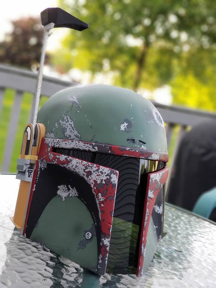

My ESB helmet is 90% completed (need to do interior and finish rangefinder) and was done with Humbrol enamel paints with a combination of airbrush and topical damage.
My old build thread on that -> Lowberg's ESB Helmet Build

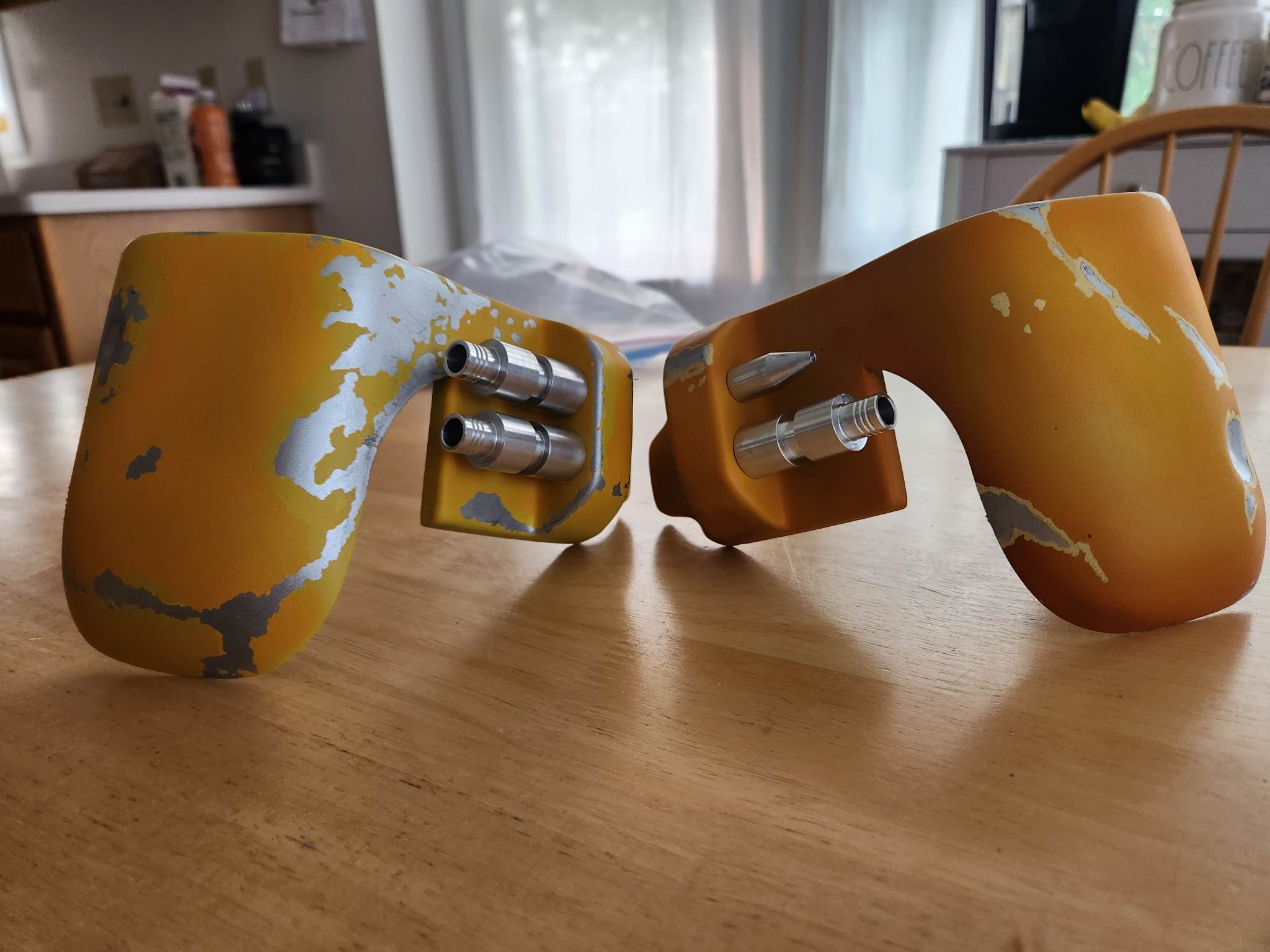

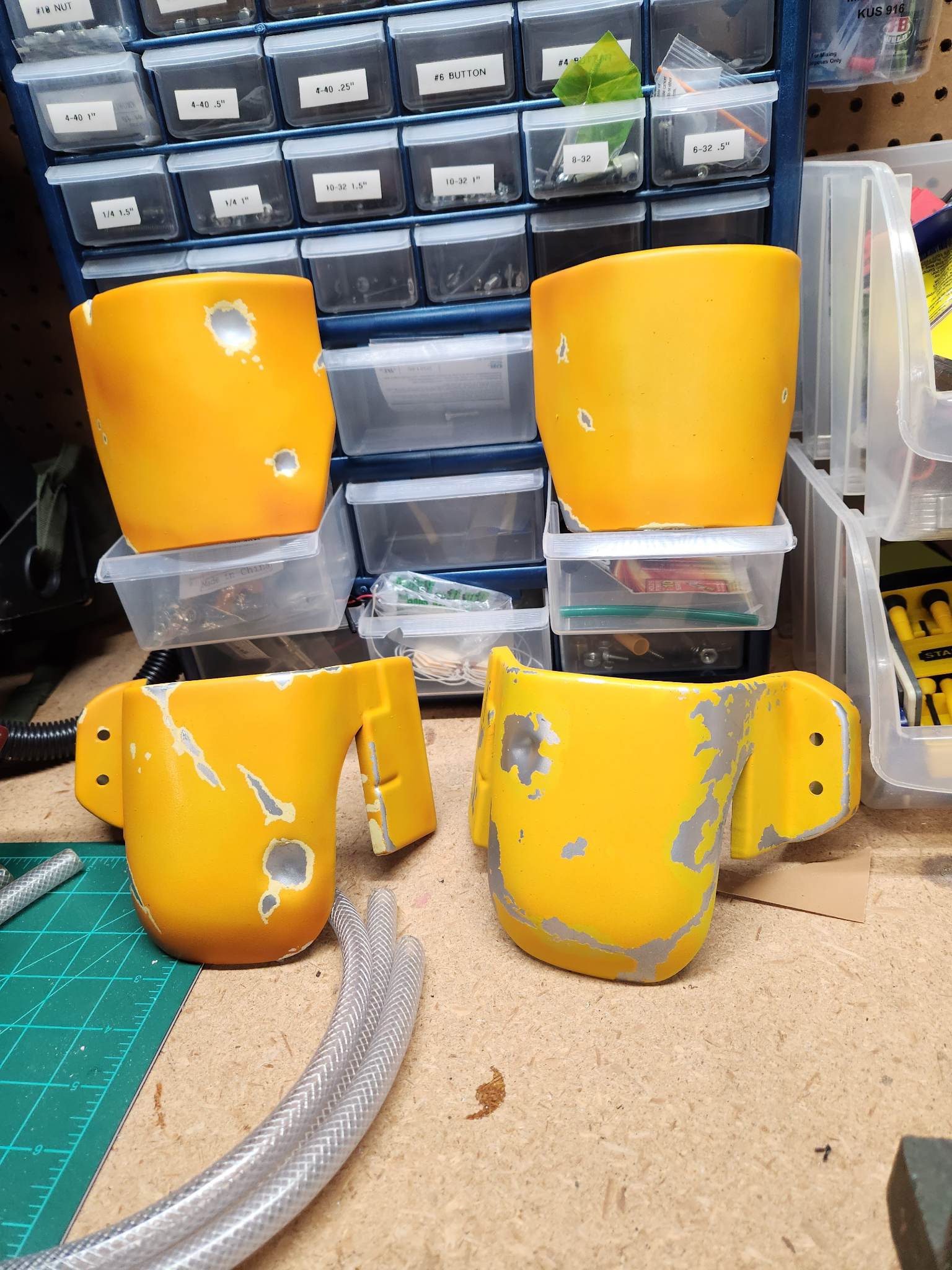

This weekend's main project was to tackle the shins and elbows.
I did a base coat of Krylon sunflower yellow over silver, but ended up adjusting the yellow color with Tamiya acrylics (yellows, orange, and browns) as the Krylon was just too bright as a base. I tried to do the two tone yellow layering that's seen on the ROTJ SE left knee, came out okay but I'll tie it all together in weathering! Sand colored damage outlines was applied topically with a mini brush.

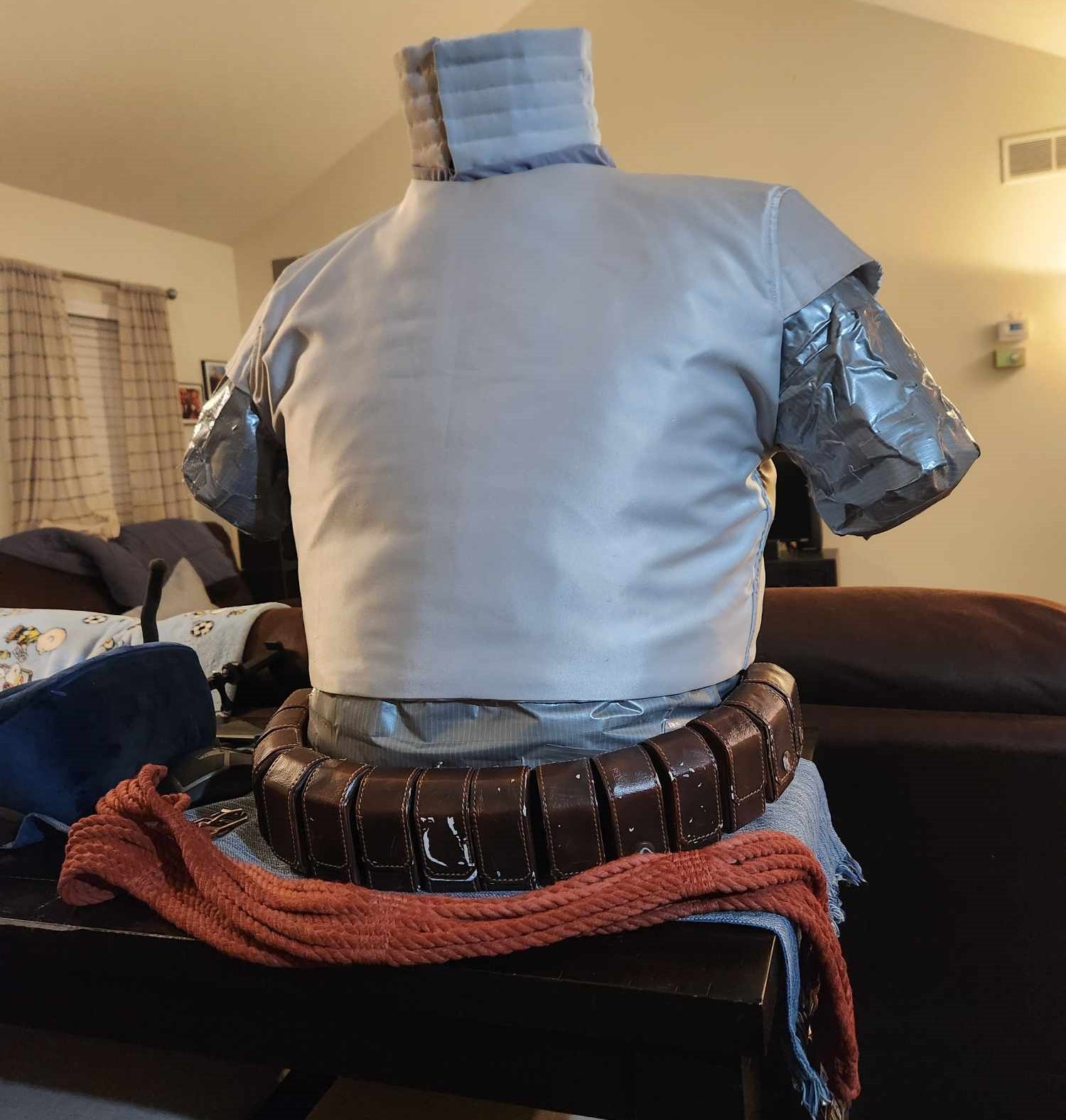

I was able to score some second hand items off of the cargo hold which will make my life easier, one of which is this incredible SE ammo belt made by Woodman which also just happened to be the perfect size for me. I also dyed my own girth belt for this project
Most recently, my wife helped me make some braids based off the SE photoshoot reference.
We used cheap halloween costume synthetic wigs for the 4 different colors.

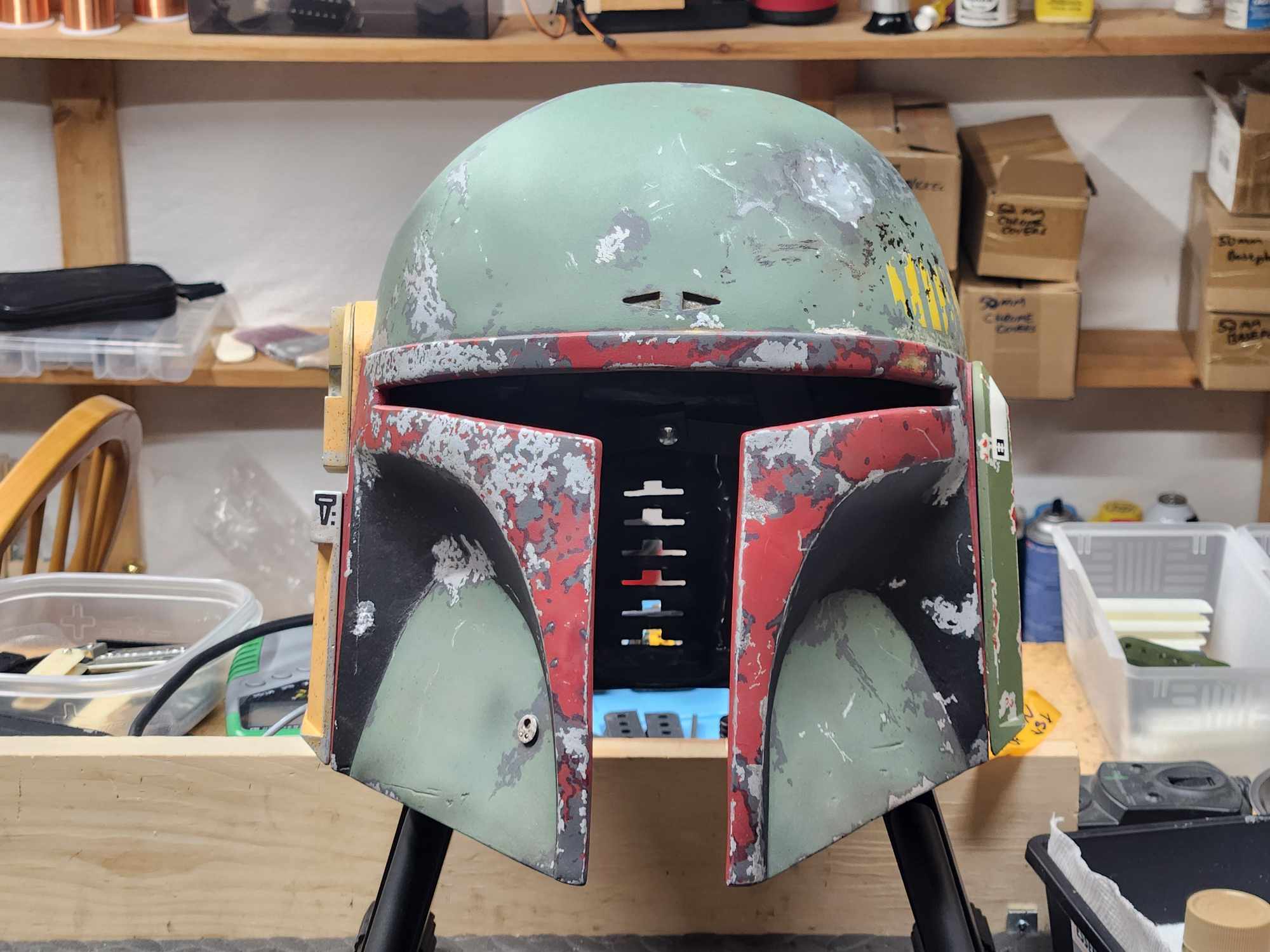

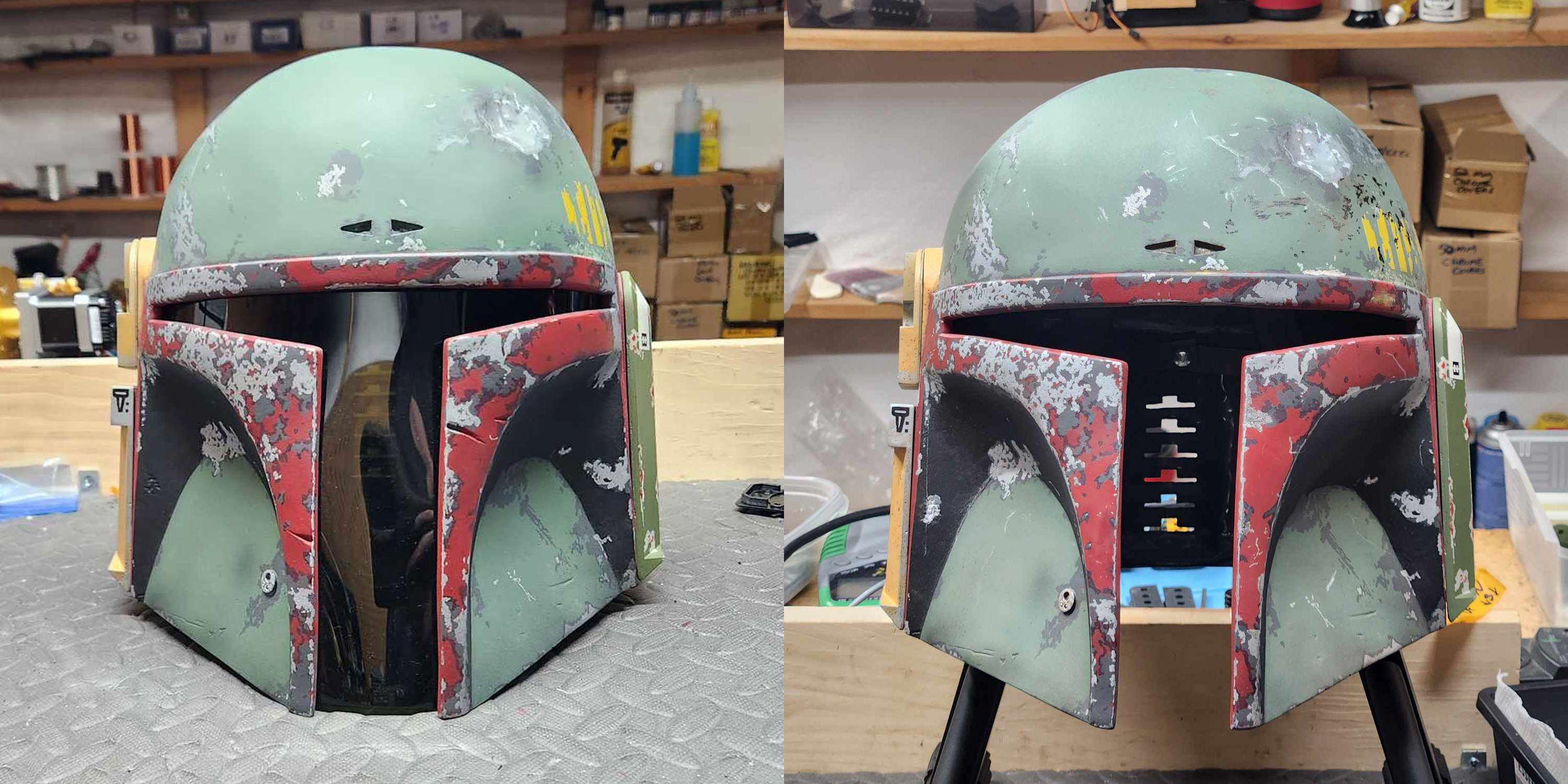

Today I made significant progress in updating my helmet and converting it to the ROTJ SE version. I painted my helmet inspired by the ESB paintjob about 7 years ago. It was my first adventure into the world of building Fett related things, and at the time I had no intention of doing a specific costume. The casting I used originally was some GMH iteration and had damage/gashes cast into the mandibles. I tried my best to work my magic and fill these areas without doing a full re-paint of the mandibles. It was tedious to do and I wish I did it at the very beginning of the helmet build, but I think it came out nicely for what it is, and the repair job is not very noticeable.
After that was taken care of, I went over reference photos of the SE costume photoshoot and StarWars Celebration IV galleries to "Convert" the paintjob to the ROTJ SE promo version. This included touching up the damage, adding scrapes and scratches, the dirty greasy splotches, and some subtle weathering.
Left is before the conversion had begun and right is where I'm at right now

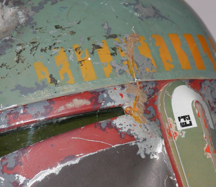

I have to do the simulated crack that runs up the left side of the helmet and into the killstripes but I'm still thinking of how to do it.
It looks exactly like bondo to me but not sure If I want to go that route...
Used bondo for the "crack" repair. Didn't come out as great as I'd hope but still looks pretty good.
Also jbdubz pointed out to me what appears to be some odd small blue marker lines that appear on the SE lower right cheek and back right panel. It was painful to do to my helmet but I love weird wonk and stuff like this in props so I added it :)

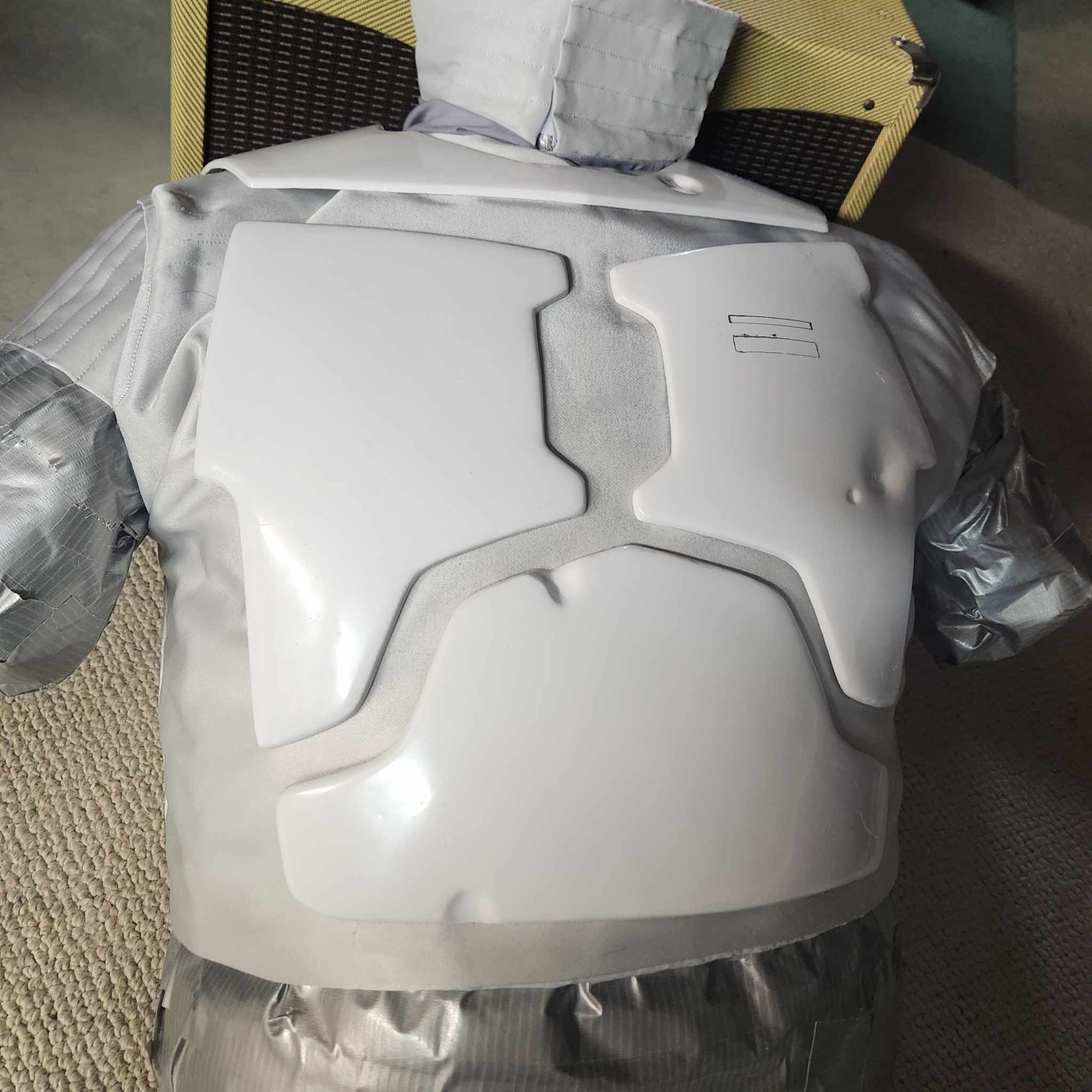

Began trimming my MinuteFett armor. I used some strong sheers to rough cut the armor out of the vac formed sheets and used a pencil to trace around and highlight the inner edges. Then with a medium speed dremel sanding wheel, lots of patience, and a steady hand, I brought all the return edges in down to about 4mm height checking my progress with a machinist's ruler along the way.
Shape of MinuteFett's armor looks really good. I bought his larger size and I think the spacing will work out pretty well for my build.
I'm going to use the jewlery pin attachment method for easy positioning.

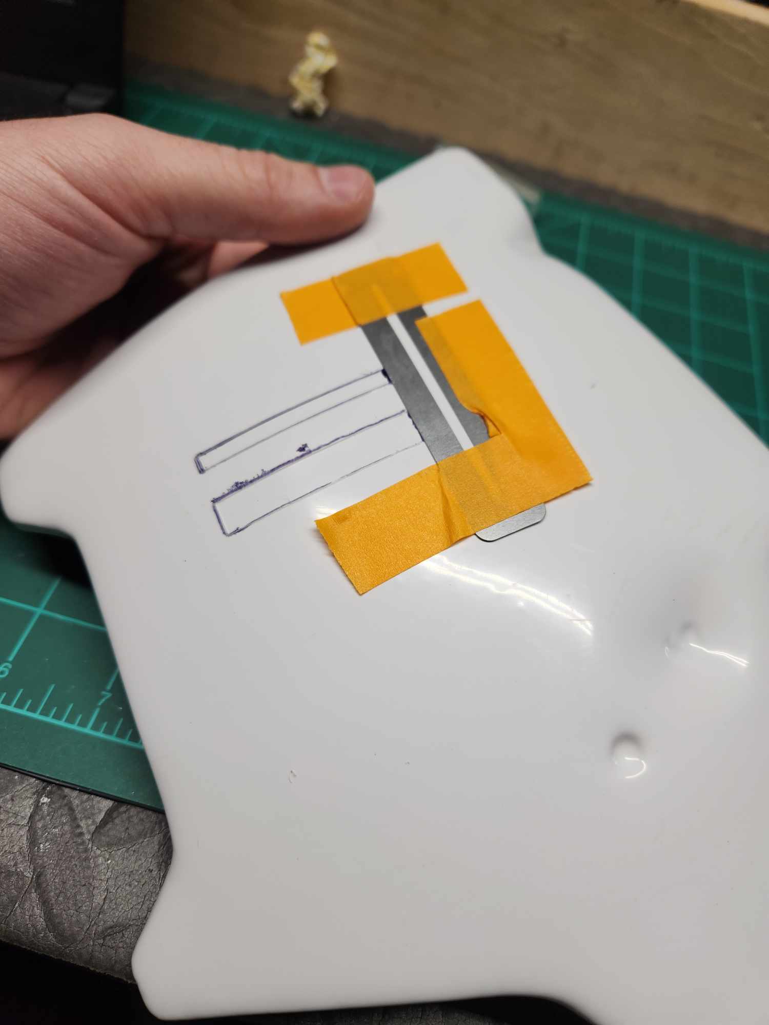

I traced the display cutout onto my left chest with a template I made, and used a thin flexible piece of metal as a razor guide to score all of the edges.
Needs some cleanup with a file/sanding stick but turned out pretty good! This was super stressful!

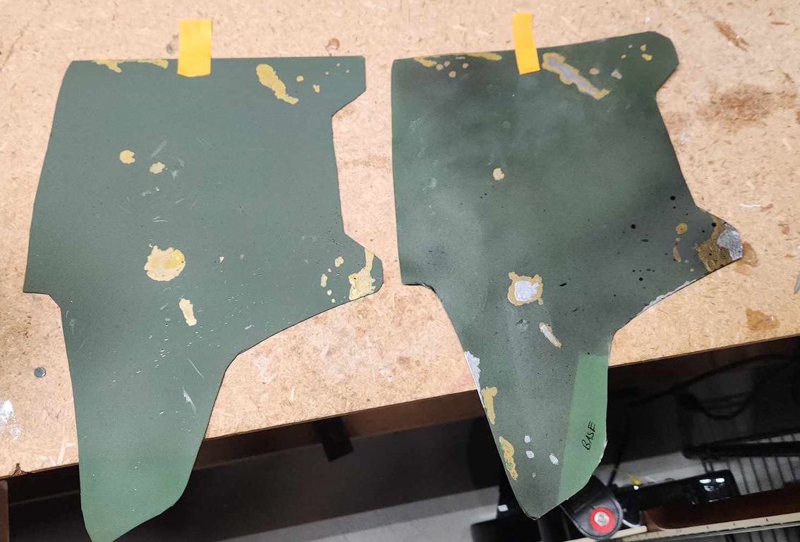

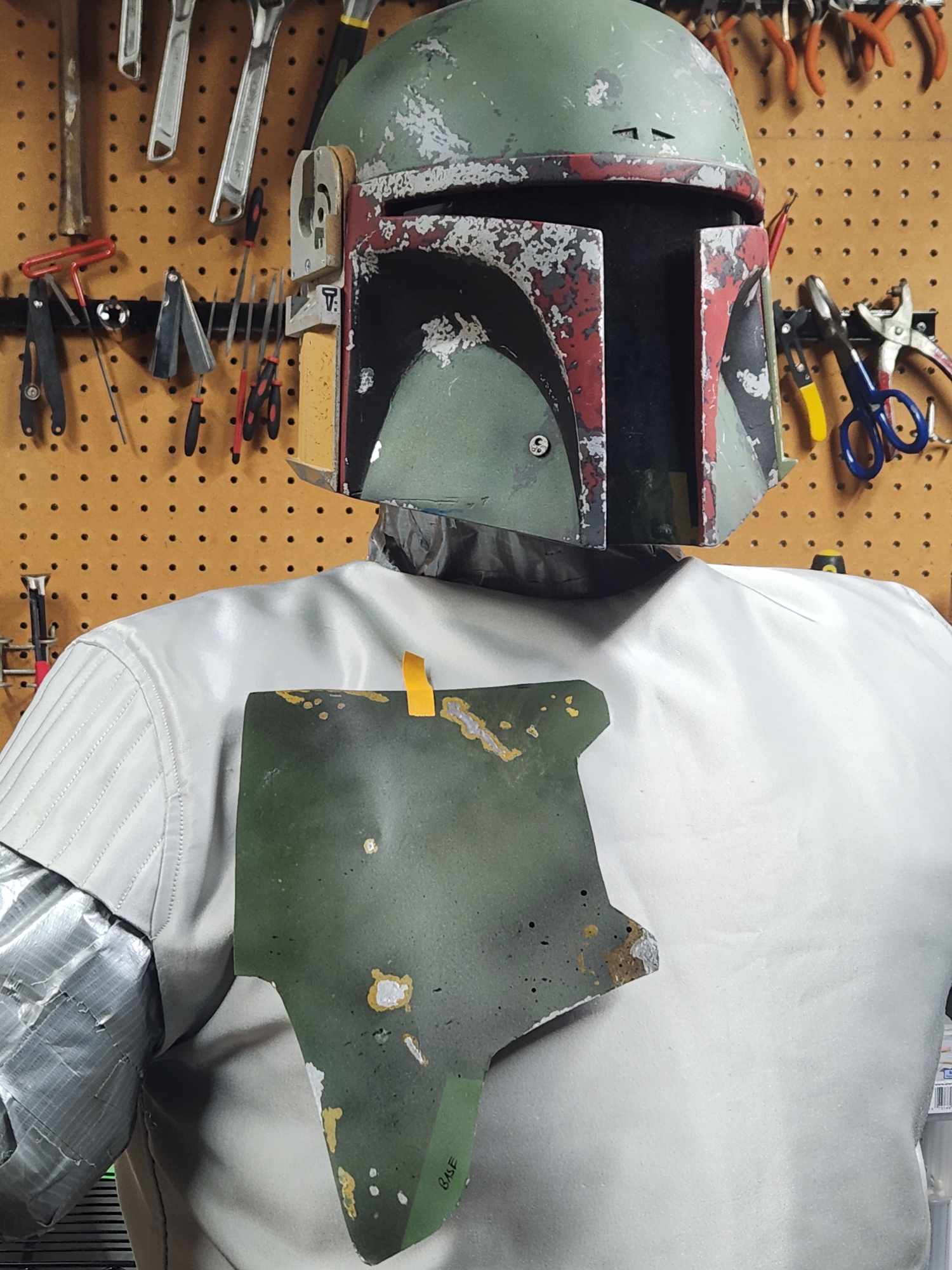

Did a test run for armor colors on scrap plastic (bottom right)
I initially tried Archive X acrylics, but they just did not want to play well with my airbrush or paintbrushes, so I went with Tamiya paints which I know work easy for me. I did a few combinations of green (Tamiya Deep Green misted with Tamiya Olive) for the base and then misted burnt umber and black for weathering. Went a little heavy handed on the black so I plan to go really light with that.
You can see how much the color changed as I taped off some of the base greens for my reference later.
Any feedback is much appreciated!
