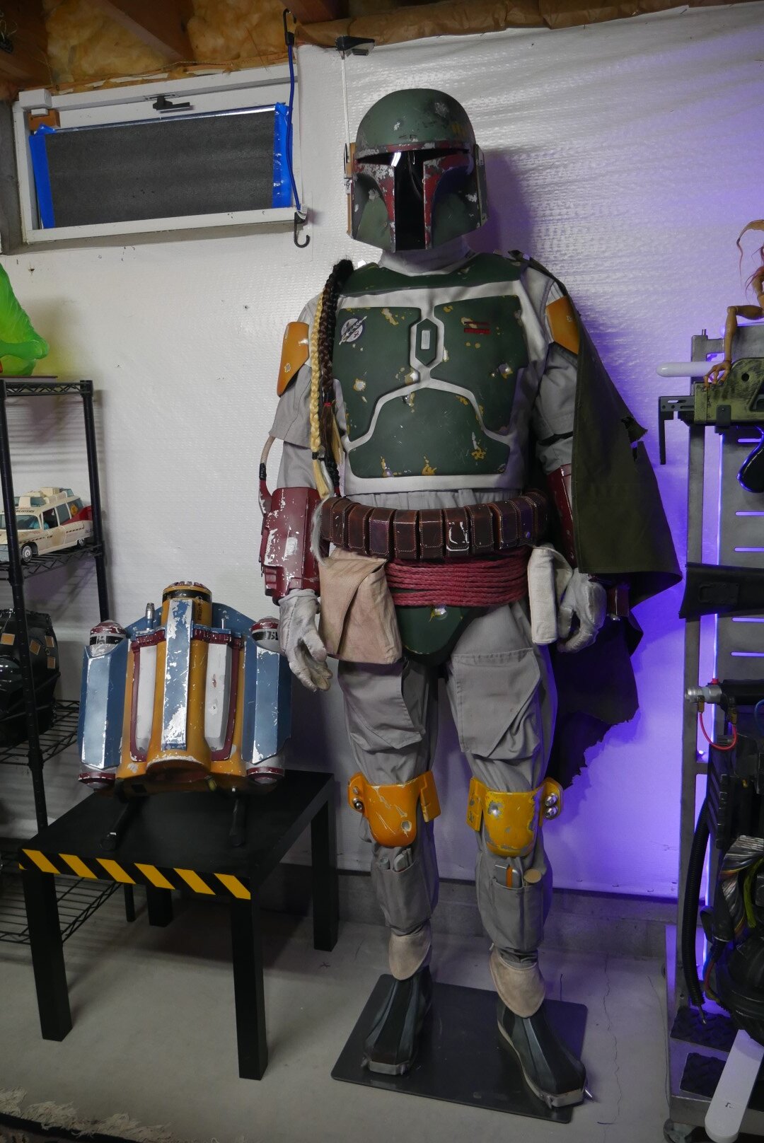

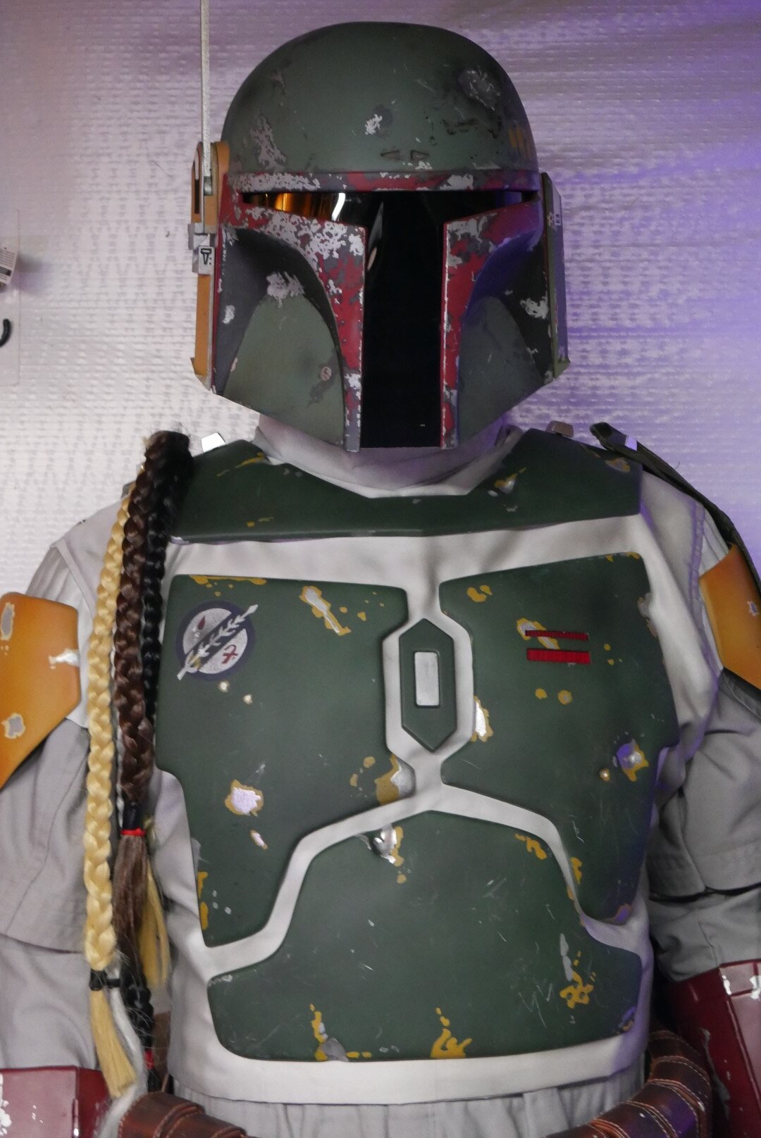

I finally got around to doing more work on my original GMH helmet I painted myself. I love my Uhbif helmet, but it was important to me to finish up my first one as it is what started this journey for me! Mine is far from perfect, but I do really like the green tone better on mine and the flatter finish matches my armor better. It's pretty much complete now besides the MQ-1 circut board!
I also got a mannequin to display my build on. It's a super heavy duty department store type mannequin so it was really a pain to get dressed, but I got it so cheap locally it was hard to pass up.
The costume that is never actually finished continues!!

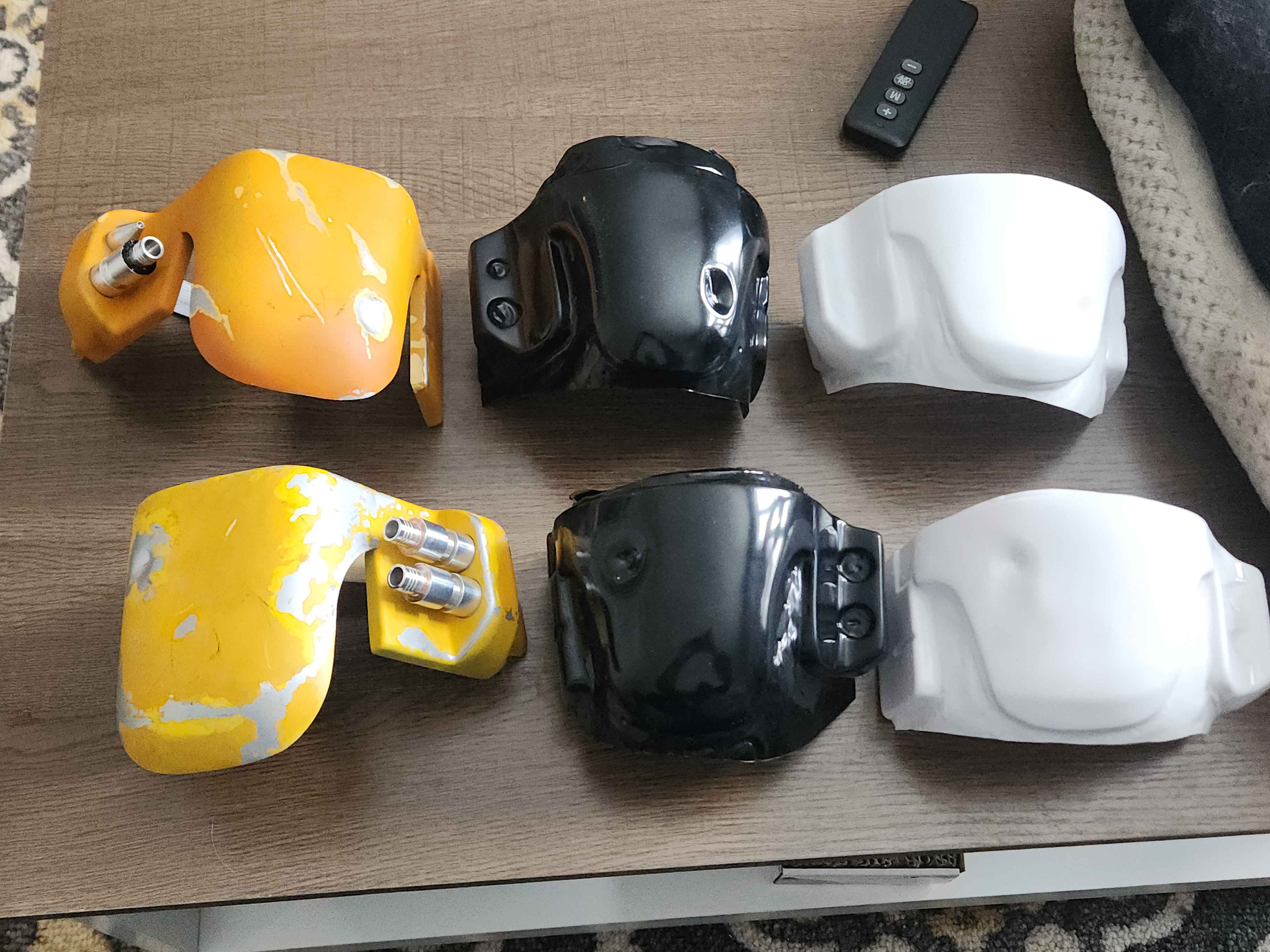

The next project will be upgrading my knees, my original knees are oversized and made of very thick styrene which had no flexibility to wrap around the leg and very heavy. This caused some floating and sagging that annoyed me. Not to mention the overall shape was not super accurate.
I have a spare set of Minute Fett SE Knees, but they seemed a little too small and wasn't crazy about the shape (they look kinda squished to me).
Neo Fett hooked me up with their new SE knees (Black ones below) and wow the shape and sizing is very accurate.
For comparison
Painted: DHPFX
Black: NeoFett
White: MinuteFett
Neo Fett's sculpt for knees is fantastic. Looking forward to painting these up!!!

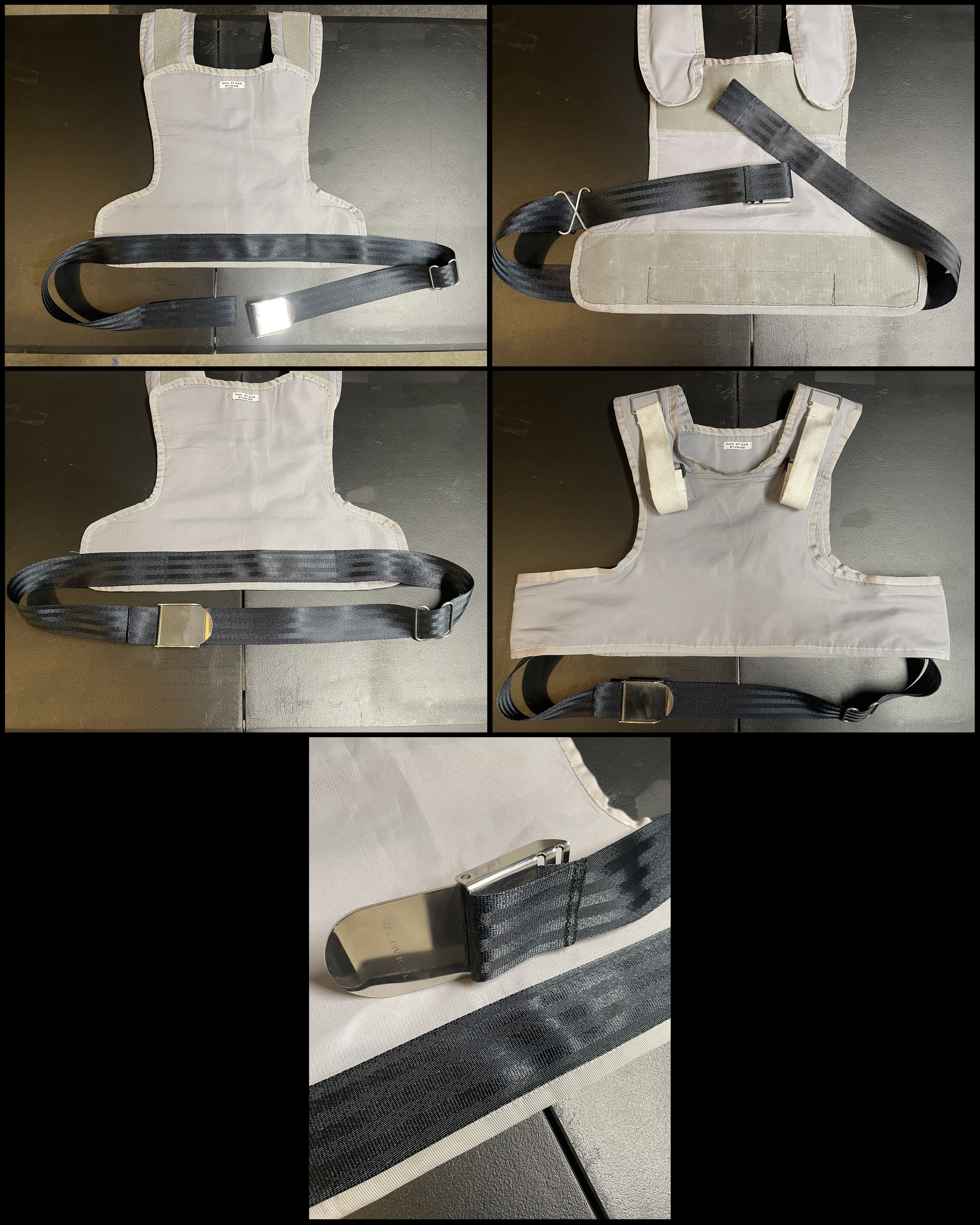

Yeah, I have the same issue with my MoW Soft Harness....
Just murders my Shoulders after about 3 hours of use. I wore it for a 10 Hours during a Con Troop (Served with the 501st and then just walking around the con) When I got it off, I was a hurting unit for about 2 days. Just a dopin' up on Advil.

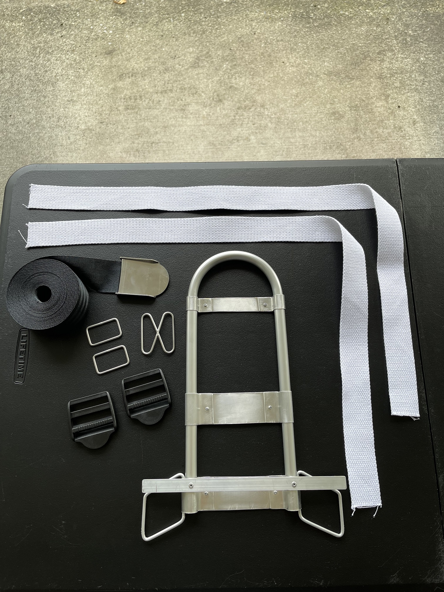

I do have an Older Gen Big Dane Harness. Was waiting to lose some weight (Which I've done/accomplished :cool:(y)) before I begin sewing mine together.....
I was wondering how well the weight distribution is wearing this rig. It sounds as if it is fantastic! Gotta get a moving on mine!

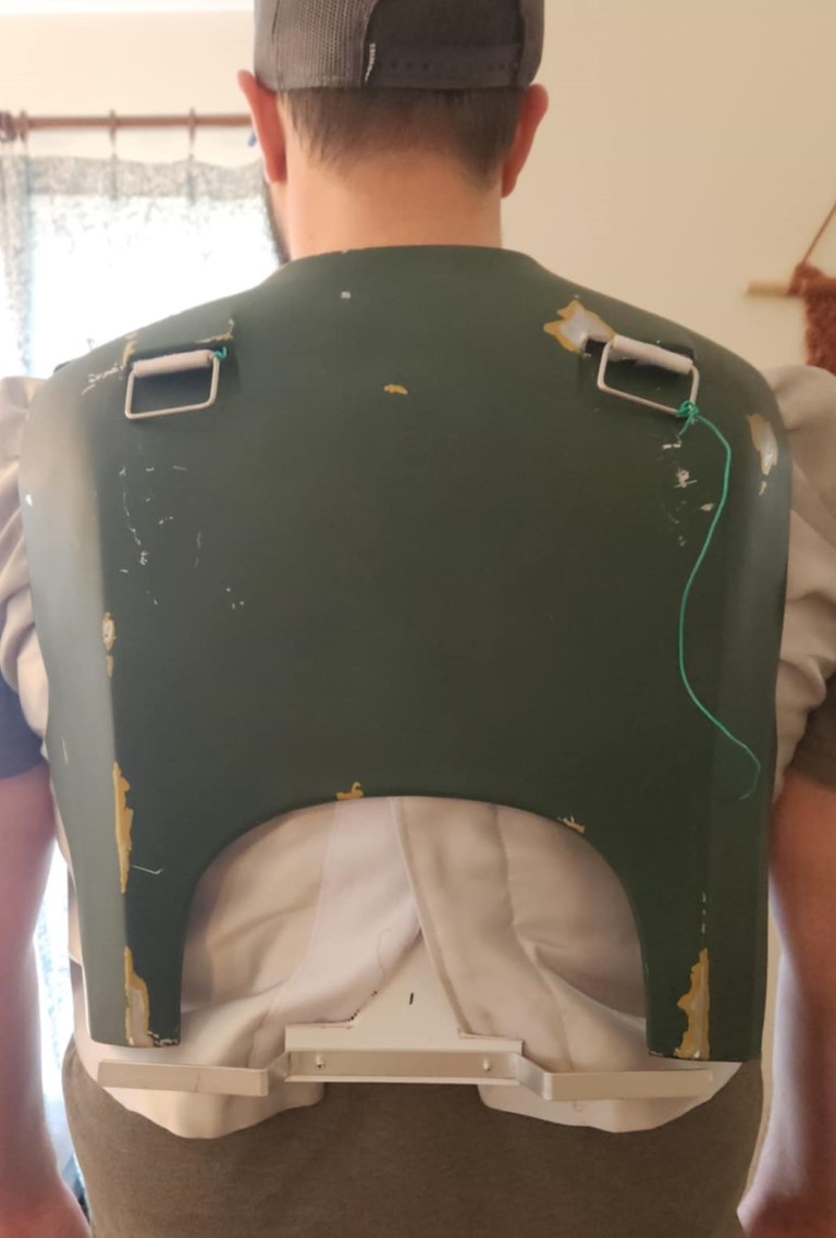

Oh also, I like how you have that green wire hanging there. I presume that it is to connect to the other ring, yeah? As a way to prevent the rings from retracting back into the back armor - prior to Jetpack hookup? I have a similar setup using a tie wrap and carabiners holding the rings together. I usually drive in my Fett Costume to wherever I'm going, then just have to put on my Gauntlets and Jetpack.
(y)
Best,
-Iron
Yea green wire was an idea to help my handler (Often Mrs. Lowberg) fish the straps through the vest and armor slits during suit up prior to the jetpack being put on. I have plans to replace them with some sort of removable lanyard hook so they can be taken off after the straps have been fished through.

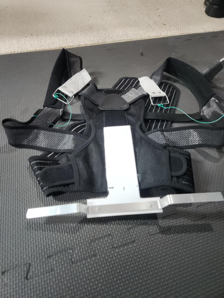

Glad I'm not the only one who was looking for a viable solution to that problem. Here is my setup. (Tie Wrap and two S-Carabiners)
Again this keeps the rings out and from retracting back into the back armor while I travel in the vehicle. I have the person helping me, tug the white straps down then remove my 'Ring Keeper' doo-hickey and then place my jetpack.
-Iron

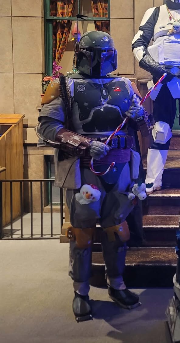

I had a chance to fully test the faux scuba harness with lower support bar literally Velcro'd to my DIY soft harness via styrene plate.
I wore it for probably 4hrs and somehow worked perfectly without shifting and moving at all, rock solid.
Having the lower bar made a big difference taking some of the downward weight off my shoulders.

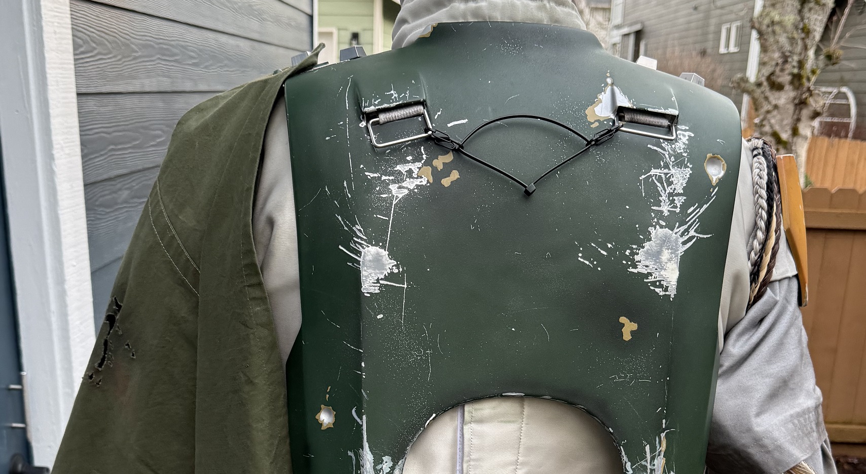

Looking good! Back in action. As you can see from my pic/post back on July 30th (2025) by back armor is suffering the same from the jetpack repeatedly moving around and scratching the paint up. I may need to address that too.
Happy Thanksgiving by the way!
-Iron
Your build looks fantastic!
