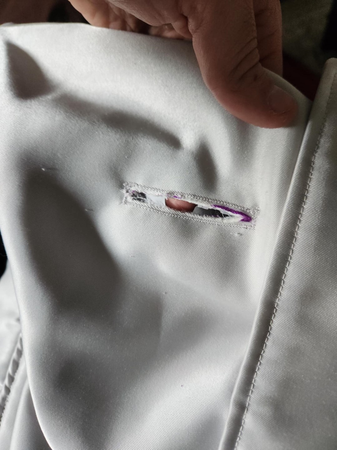

Sewed some button holes for the straps in my vest

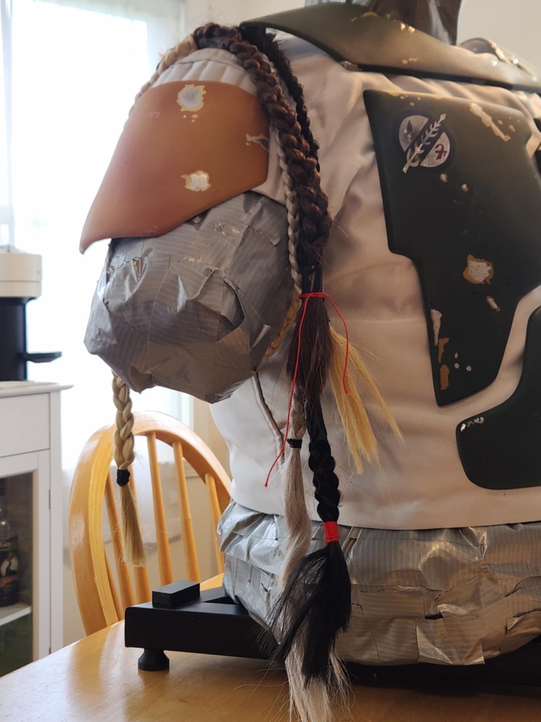

Did some re-working of the braids my wife helped me make (She did all the braiding, very thankful for her!!) . The SE braids are very confusing because they rotate all over the place in the promo photos and by the time they were documented in the costume exhibit photos they were more or less completely falling apart. I tried my best to dial them in to the promo photoshoot photo version, but had some help understanding the chaos from other's build threads and looking at some of Woodman's interpretations of the braids.
I heated some of the ends to curl and tatter them up a bit and re-did the length positioning and tying of them.

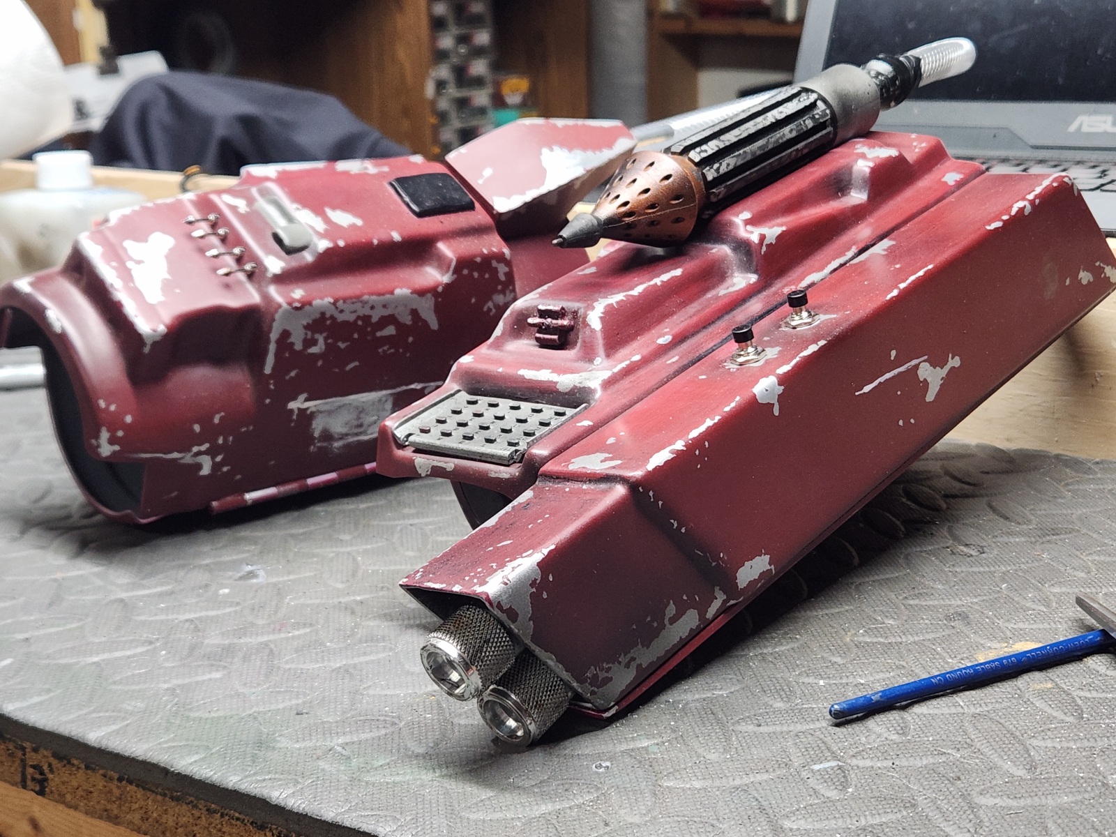

Circled back around to revisit my gauntlets which I intially painted first over a year ago.
My gauntlets kit was missing the track-like strip under the flame thrower so I scratch built it out of styrene.
I also went back through the references and added some missing damage and scratches. Installed machine craft replicas darts and flame thrower tips and did some additional dirt and grime weathering. Calling these done!

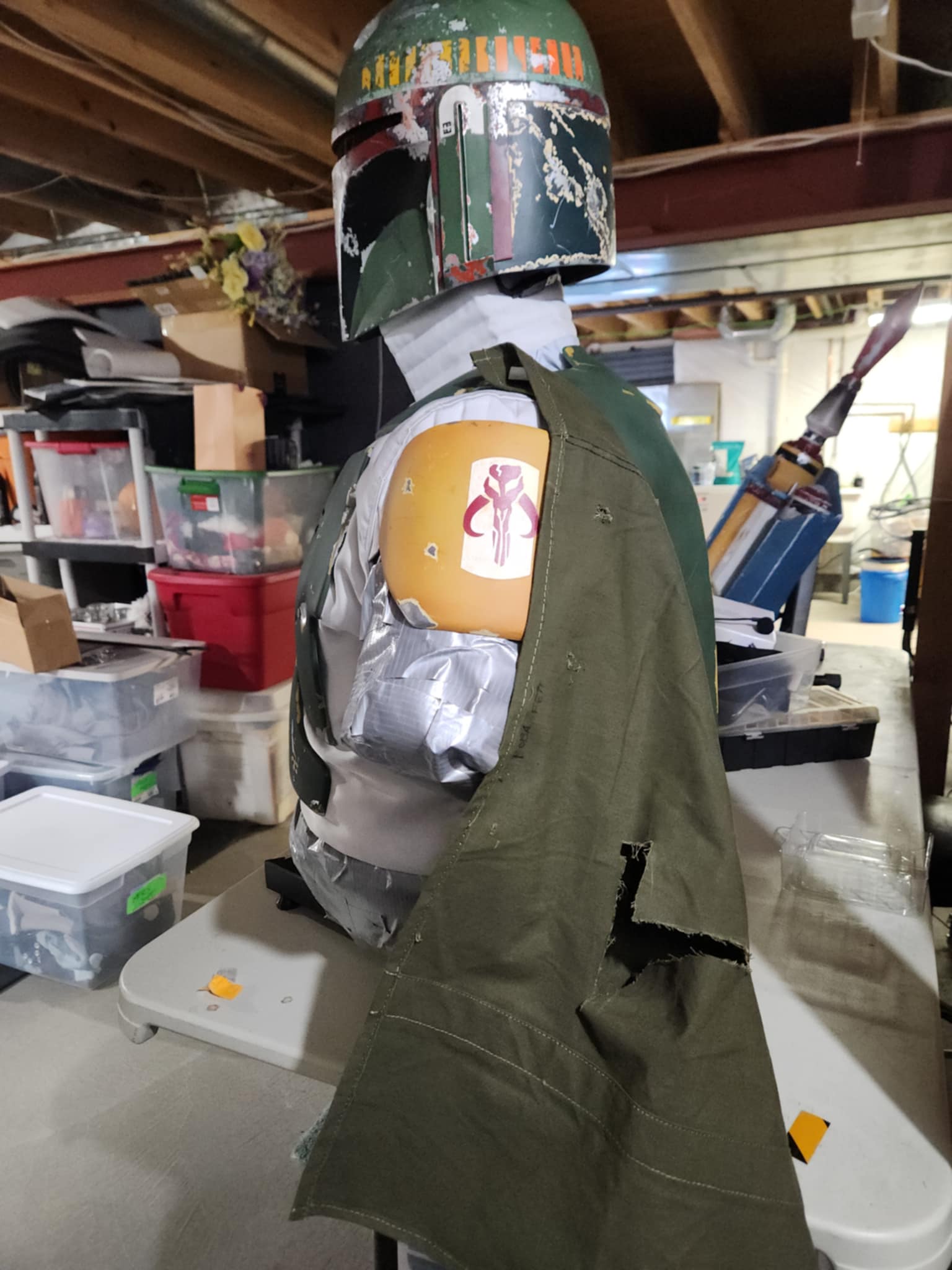

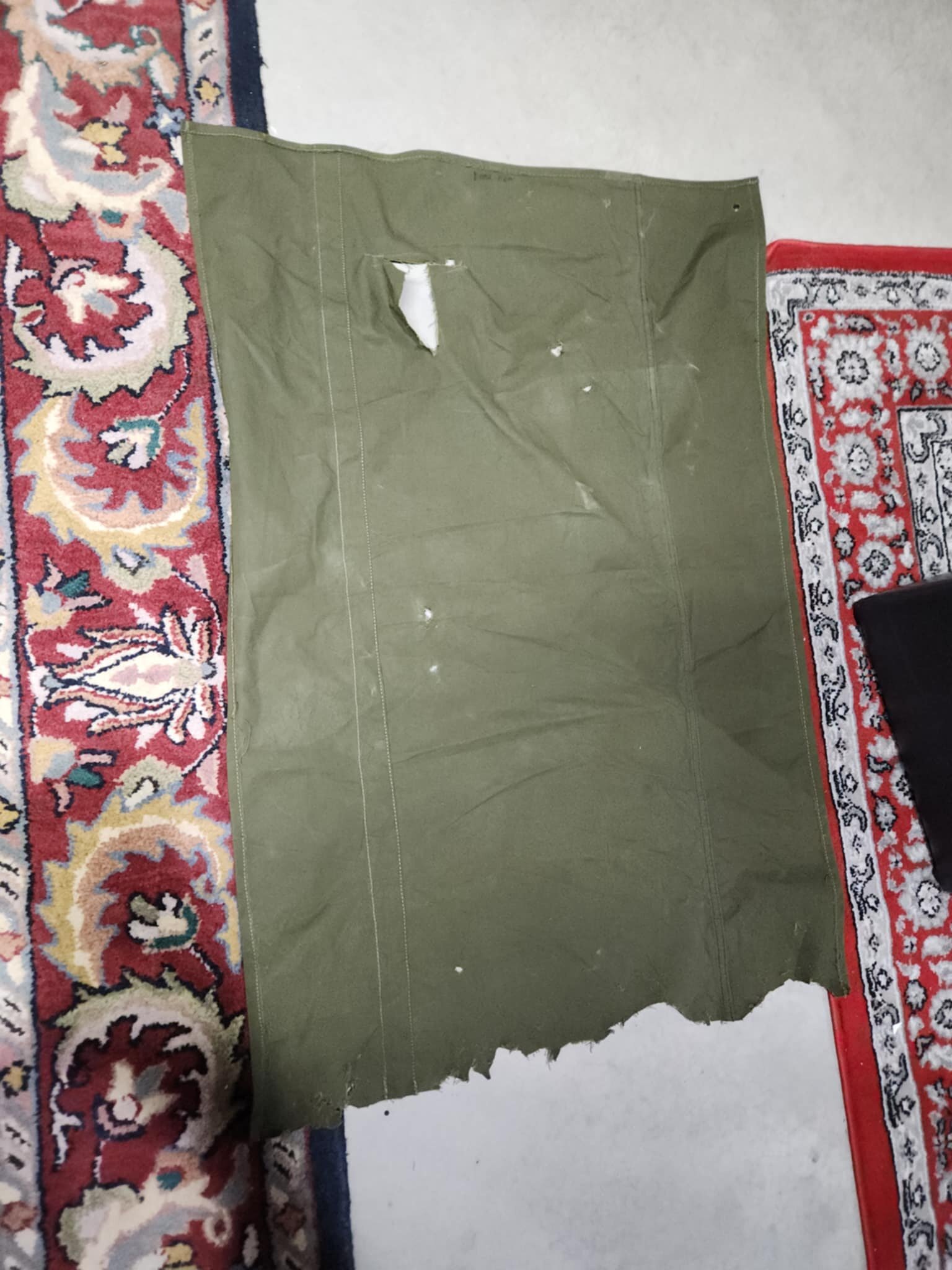

Worked on my cape tonight, adding in all the holes and rips I could find between the promo photos and the exhibit photos. The big tear near the top was scary but I really like the look of it so I wanted to include it.
The SE cape is attached with the hand written "Boba Fett" top edge text as the face-up side, but the top right corner is pinched and twisted around before it's bolted on so the "back" of the right corner is face-up as well.
easier to show here:
This allows it to have a nice natural twisting look as it hangs.

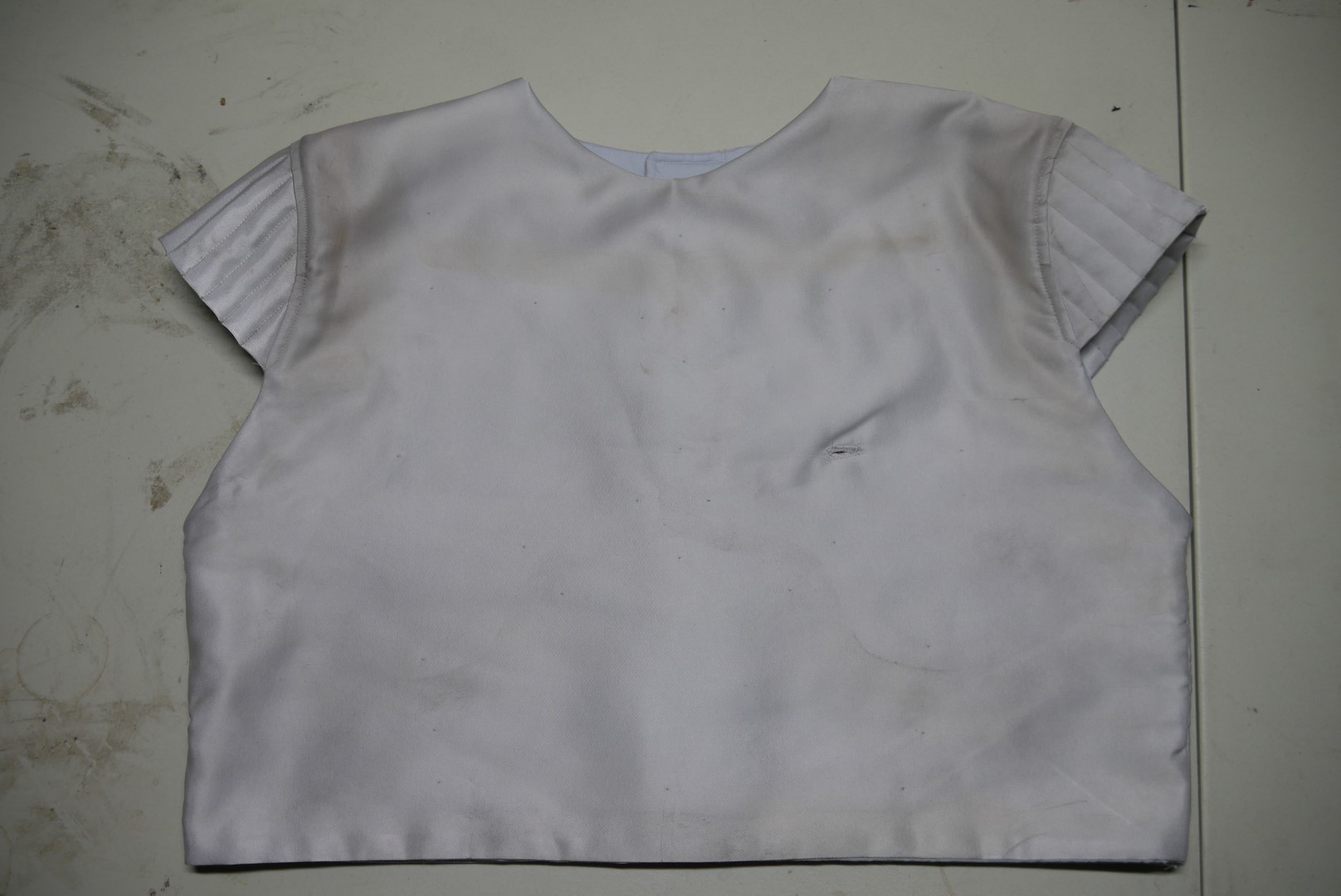

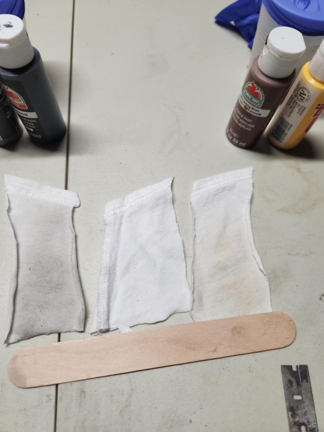

I hate weathering all together lol Speaking of, I've began to weather my soft parts. I tried using crushed up chalk pastels but they didn't really take to some of the material, so I ended up with using watered down acrylics airbrushed. A greyish black and a yellowish brown. I want to go very subtle with the weathering on this build so I'll probably do a bit at a time, assess and add more if I need to.

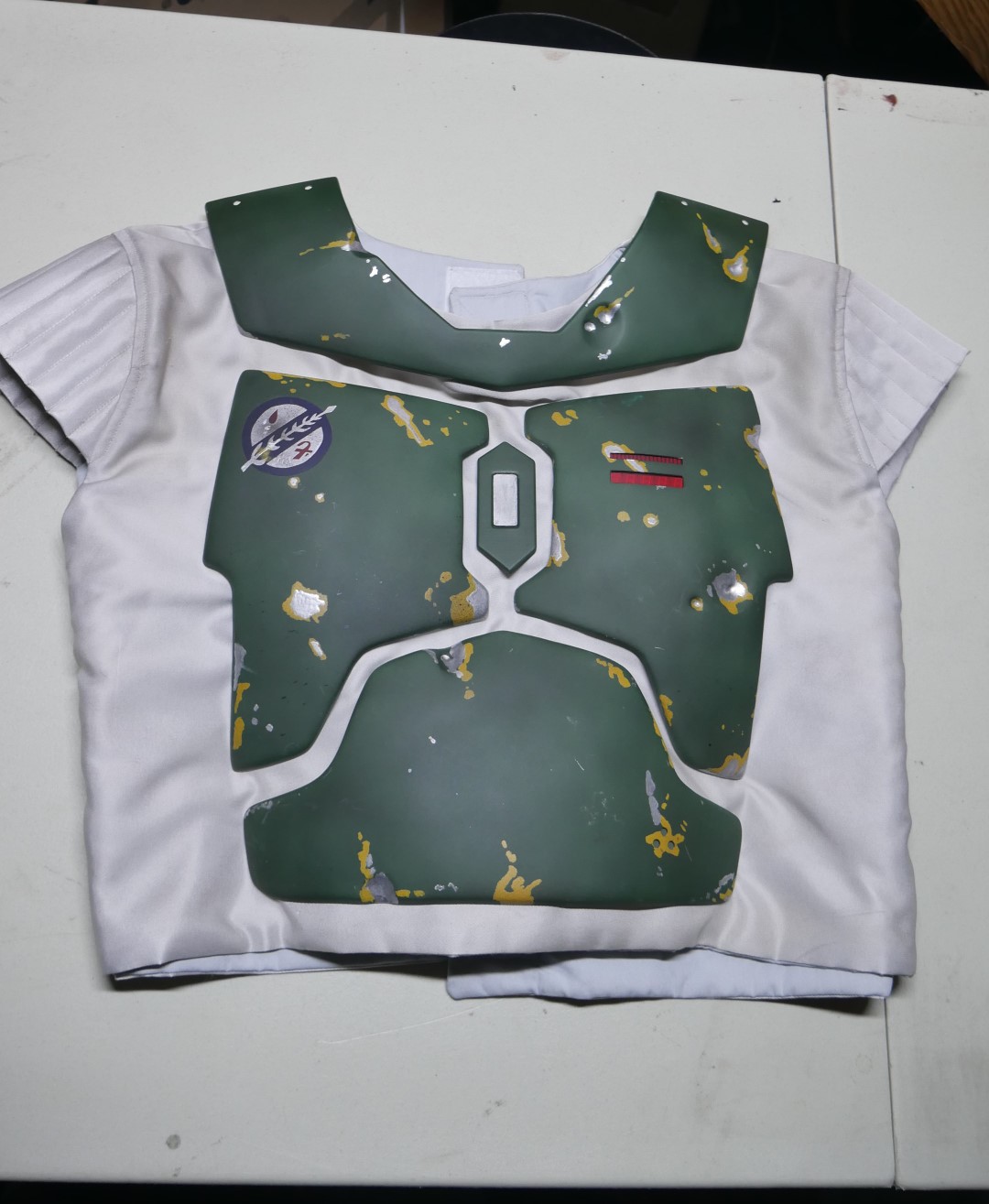

I did a very light amount on the flak vest, mostly around the shoulders/pits areas to give it a subtle worn look, like it's been sweat in and washed a few times.
At the same time, since I removed all my armor. I decided to add a top coat for protection. I realized in previous test suit ups that banging my gauntlets into my chest armor is going to be un-avoidable so I wanted to add something to help with durability. I ended up going with a few light coats of Testors Dullcote enamel, which didn't change the look I already had too much. Just added a tiny bit of satin sheen in bright lights.
I had to re-mask all the silver damage with liquid latex before applying the dullcote, because it kills reflectivity of metallic paints.
Green armor back on the barely weathered vest.

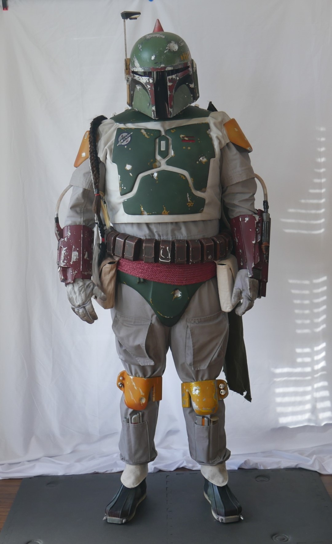

Did my first full suit up today, which was a lot of fun!!!!
Few small things giving me trouble....

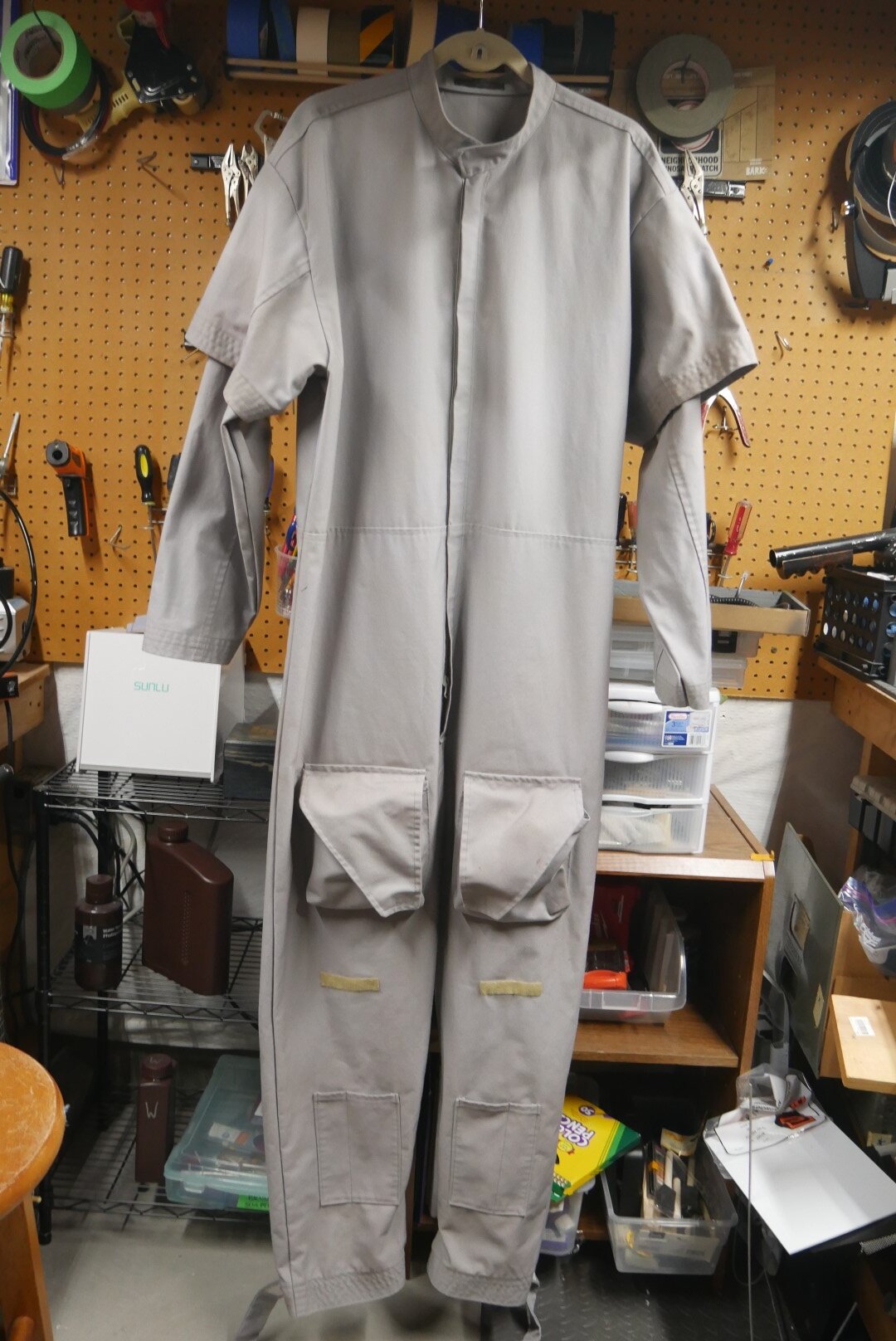

My knee armor wants to fall because of the heavy metal greeblies so I added a strip velcro on the flight suit to help keep them from slipping down. This helped but but they are still back heavy and and the greebly part is sagging causing the bottom front to point outwards away from my legs. Maybe more velcro on the front lower area to keep it pushed down on the leg?
Second is more of a quirk to the SE Promotional configuration, the left arm rocket hose technically goes behind the back armor, which is super weird. We shoved it back there and it worked but kept slipping out. Scratching my head on how to create a secure attachment point that's behind the back armor.

Looking good! Larger pieces of velcro will help keep the knee pad flusher. I would also throw some more weathering on the fight suit, pouches, and spats. Gets washed out in bright light/flash but overall looks awesome!
Yea I see what you are saying, yesterday I misted a ton of greyish black weathering on my vest, the lighter pouch, and my lower legs and it still doesn't show much on camera lol Anyways re-suited up, added some glue on the greeblie side of the knee straps (the snap on that side was allowing rotation) and the knees are sitting much straighter now. Belts and cod slipped down a bit but I just have to crank down that inner belt and should be set, I'm shaped like a barrel so not much hips to hold it up lmao. Super hyped that this is pretty much wrapped up!

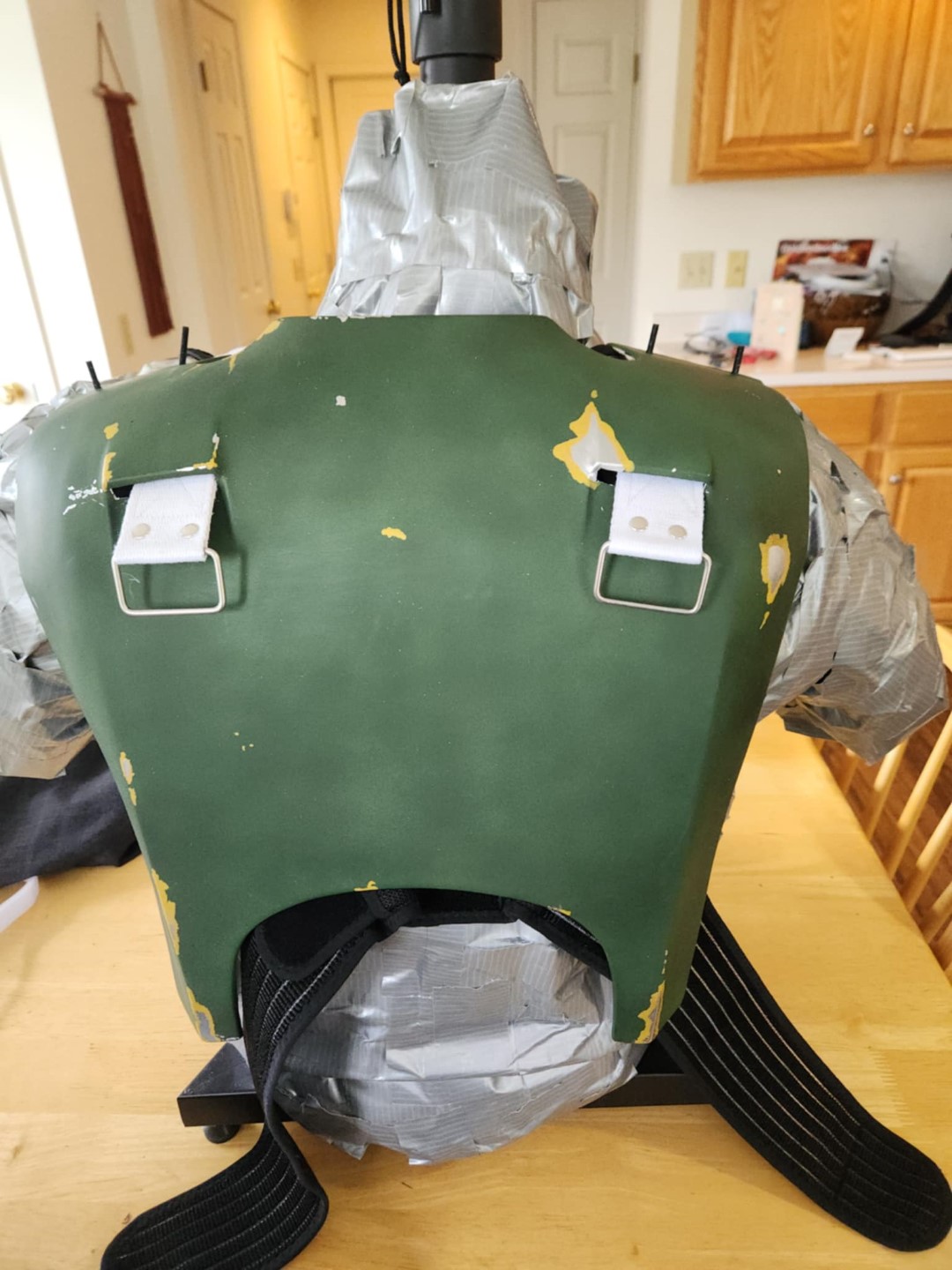

Jetpack Sag - The jetpack harness I made has elasticity to the arm straps, and is only a 2 point harness. This is causing the weight of the jetpack to stretch the arm straps and thus make the mounting tabs extend out the armor more than they should be. As a temporary fix I want to either shorten/move the white mounting straps to make them shorter, and as a long term fix I want to replace the shoulder straps with nylon or a material that won't stretch.
