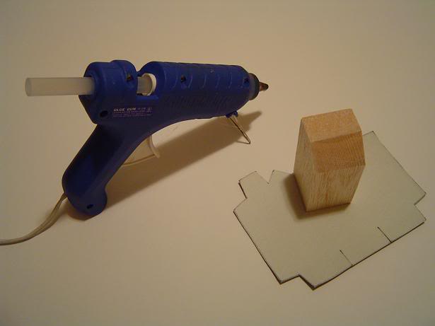

Tools of the trade

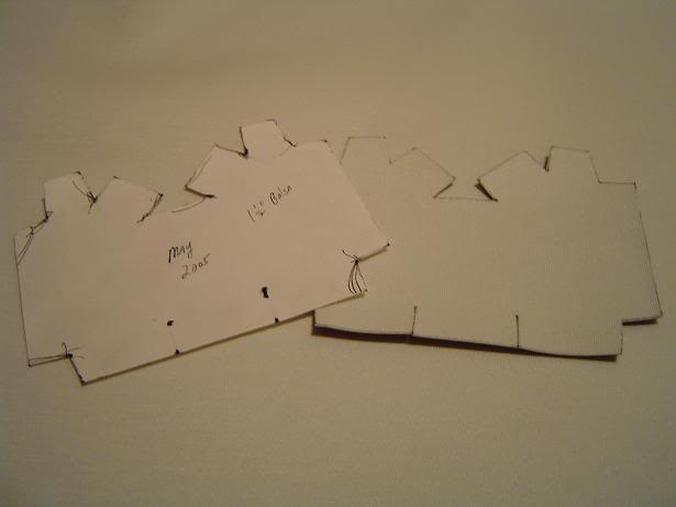

Pouch Template
Ready to glue...

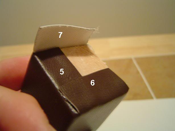

This is the order I spot-glued:

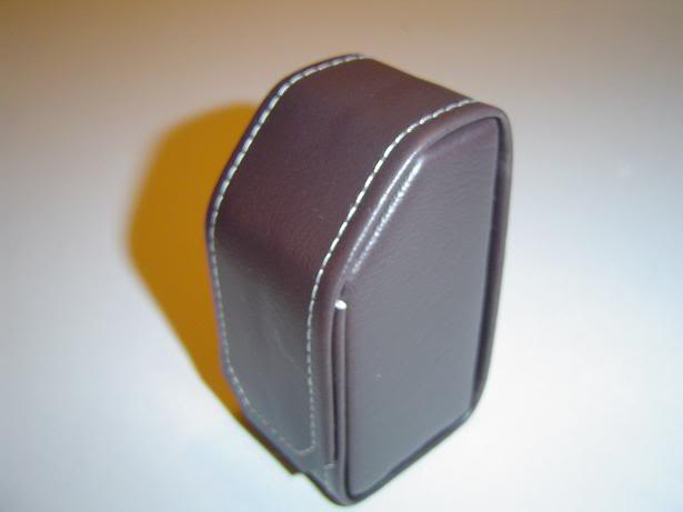

Then the bottom...
And finally, the top:

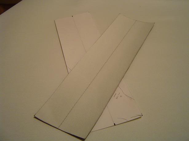

Now, the flap template

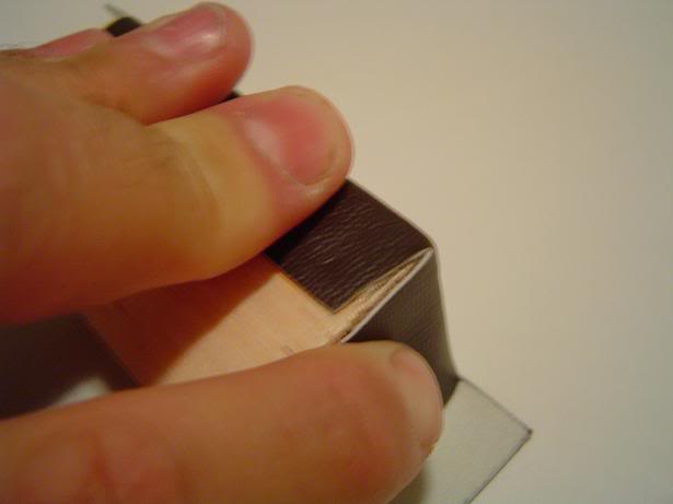

After spraying with 3M Adhesive Spray, press the sides to the center:

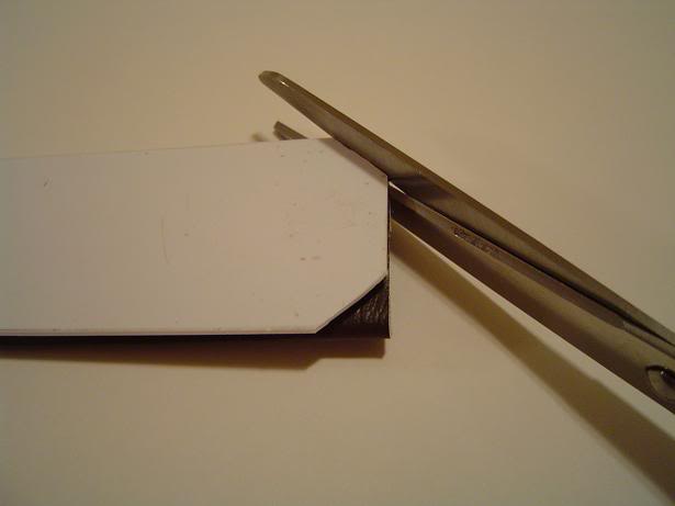

The back of the flap should look like this:
On one end, cut the corners (I used a plastic template)
Another look at the corners:

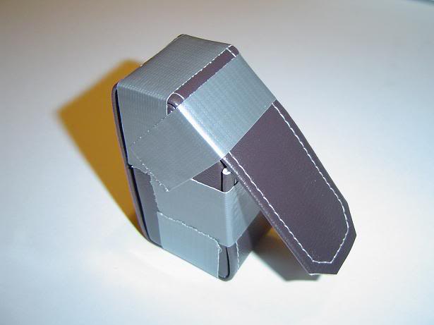

Gluing steps 1-4 (see digrams above)
After the glue dries for steps 1-4, glue the front flap
And finally, the finished pouch!

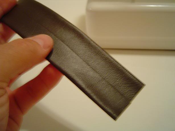

For the main belt, I use the same approach as the pouch flaps: 5" wide, 3M spray, folded into itself, makes a 2.5" wide belt.
