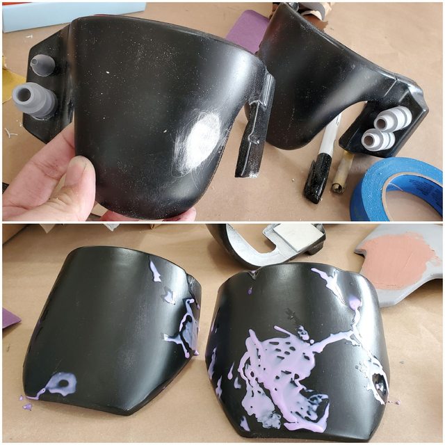

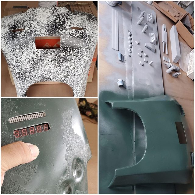

Here's a test spritz of the wall texture and paint. This can let dry, then spray more to build up. I applied at different angles on the gear to prevent a regular spray pattern.
And we're off!

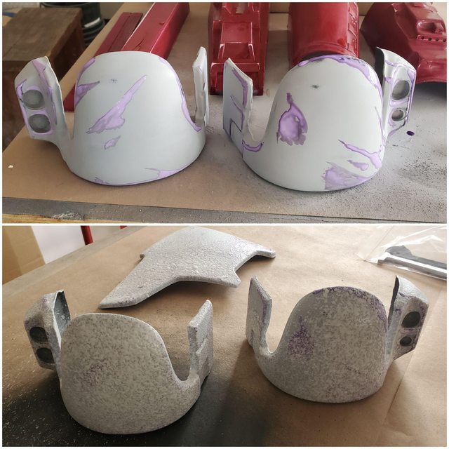

Based on these images of Boba's repaint and Cobbs existing damage, I've decided to use Cobb as a reference for masking since we get a full episode of the armor in sunlight. Here you can see the patterns more or less match. So I went with it. It makes sense that a repaint would follow the reference since I couldn't find any good details from the repainted kit in the episodes.

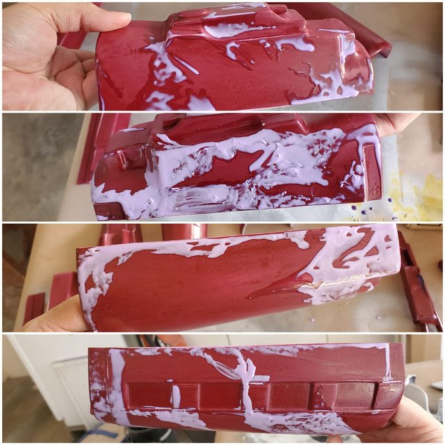

I used Humbrol masking fluid and the wall texture to sort out damage placement. Where there is bare metal, I masked. Where there was existing paint, I let the texture do its thing.
I'll share this because I didn't pay enough attention and assumed an RotJ armor set will fit the bill, but there is a dent in the right chest that is not there on this new set. Here's my paint coat for lighting check, and then the fix applied after I sanded everything off. (ESB doesn't have this dent and I've found that ESB has visual influences on the new costume as well)
Like wise, the knees has a dent that needed to be added. Shoulders were based on Cobbs damage. All by eye (sorry) no stencils. Figured the armor is gonna look a mess with the texture anyway.

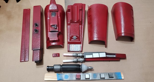

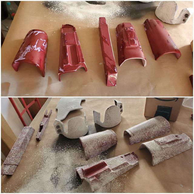

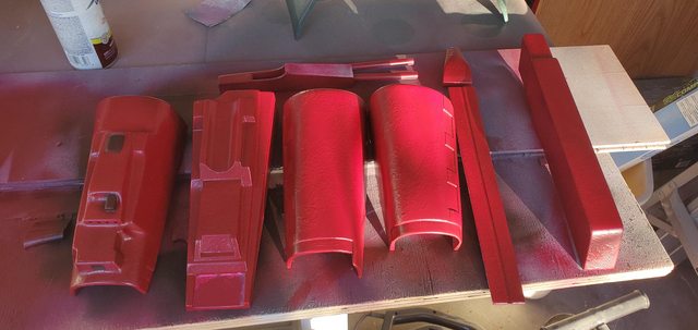

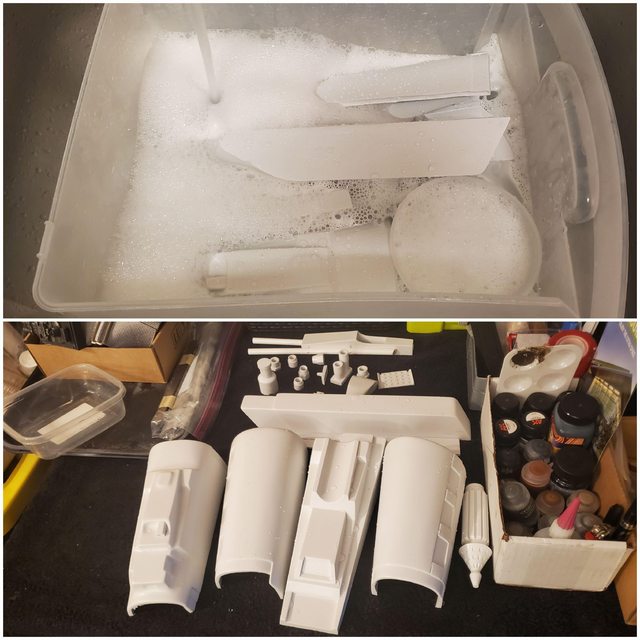

Gauntlets were prepped with a soapy bath and sanding session. Primed, painted with a base coat of Claret Wine, lightly sanded, then masked and textured. Damage again is based off Cobb Vanth's kit.
Somewhere along the way I cut a rectangle out of the back matched to the back image in "The Believer" and masked damage was loosely based on RotJ and typical damaged areas.
So by now... I was looking something like this:

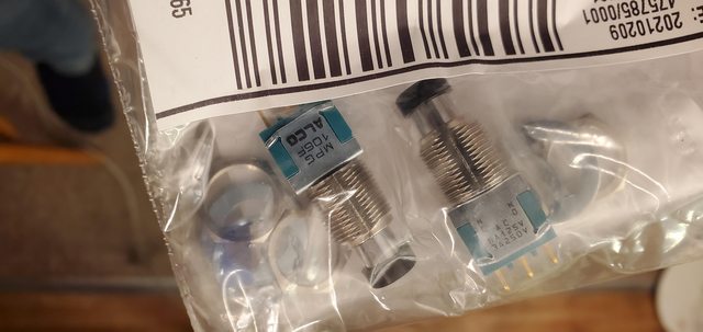

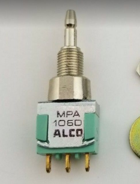

Parts are still coming in as the client sends them to me, including these switches for the gauntlet blaster. Which appear on Cobbs, but I can't quite make out on Boba's, but there's something there. Also, the 106D appears on Cobbs, but there's something else on the new Boba set I can't make out in images, so I left these off for the time being. RotJ Hero has them optional, so again, loosely based on that too.

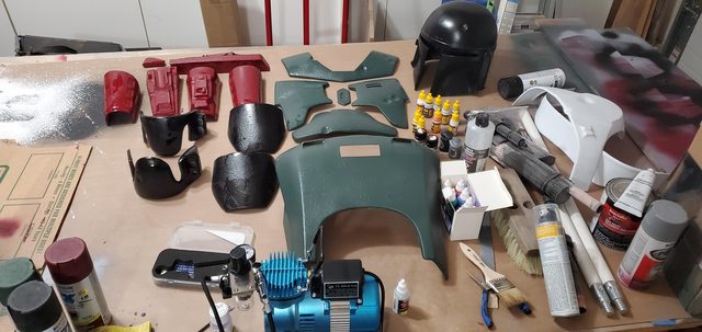

Gauntlets were textured, the top coated with Colonial Red, however, I found Colonial Red to be too bright, but it was a good base color. I spritzed a light coat of Claret Wine to give it color variation and the deeper burgundy color.

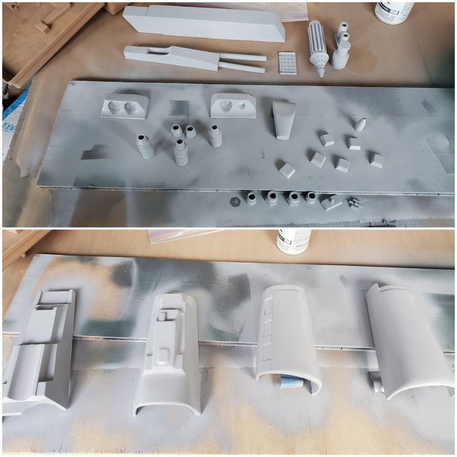

Did a quick airbrush on the kit as well as installation of the greeblies. In this photo, I still need to paint the bronze/copper bits. I masked off the gauntlet side to airbrush on a matte black and taped it off for the white squares (this is like an ESB addition to the RotJ look) Also to note is there is for sure a Red collar stud. The others appear silver/gunmetal and so I made a gray one for kicks (my own interpretation of the costume due to lack of images)

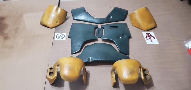

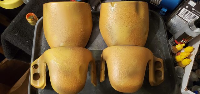

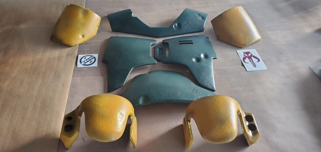

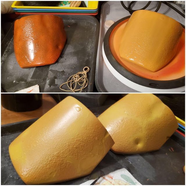

On to the shoulders. I did an orange airbrush base coat, then did a rust yellow over top for color variation. A lighter yellow was airbrushed into the lower grooves from the masking for color. Black was added for shading and weathering. The same steps were repeated for the knees.
Note: there are very few references of Boba's knees besides the color. Even when he sits on the throne it's difficult to see, but that's also where I noticed the dent in the right knee. Damage was based on Cobb and the left knee is loosely based on RotJ. (We see the right knee on Cobb and again when Boba suits up for the first time, but dude has FOUR dart launchers! I built the kit as RotJ.

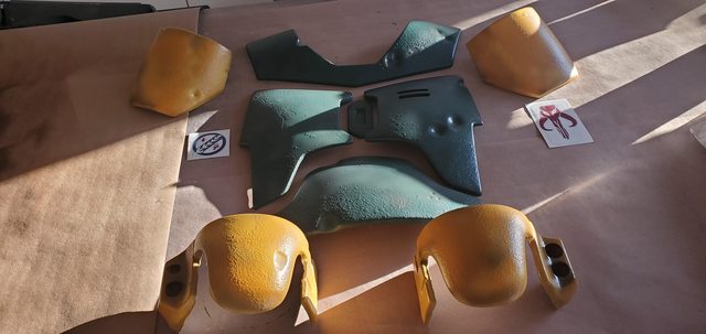

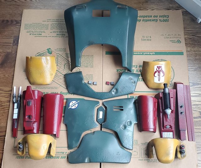

Back in the garage I revisited the armor with airbrushing details using two shades of green and black added for color. As the sun set I was able to get lighting checks with sunlight, indirect sun, and indoor lighting.
Here's gauntlet darts installed (colored rings are based on ESB's red and black) as well as chest LEDs and decal set. The LED set I have appears to be the classic set, not the new scanning bar of the new look, but that's an easy replacement if accuracy is critical (but then that throws the whole costume into question. Just doing what I can with what I've got but I'm totally okay with the pros coming in and telling me exactly what's there and providing references, heh)

Maybe its my phone or my eyes, but i cant make iut the names of those mig paints for the armour.
Couldnt be a gem and post the names or codes for them could you.
thanks in advance
thanks in advance
Matte Black (use to darken colors, carbon scoring)
Orange (Base for knees and shoulders)
Light Rust (top coat for knees and shoulders)
Gold Yellow (tones/shading)
Medium Green (tones/shading)
Light Medium Green (tones/shading)
