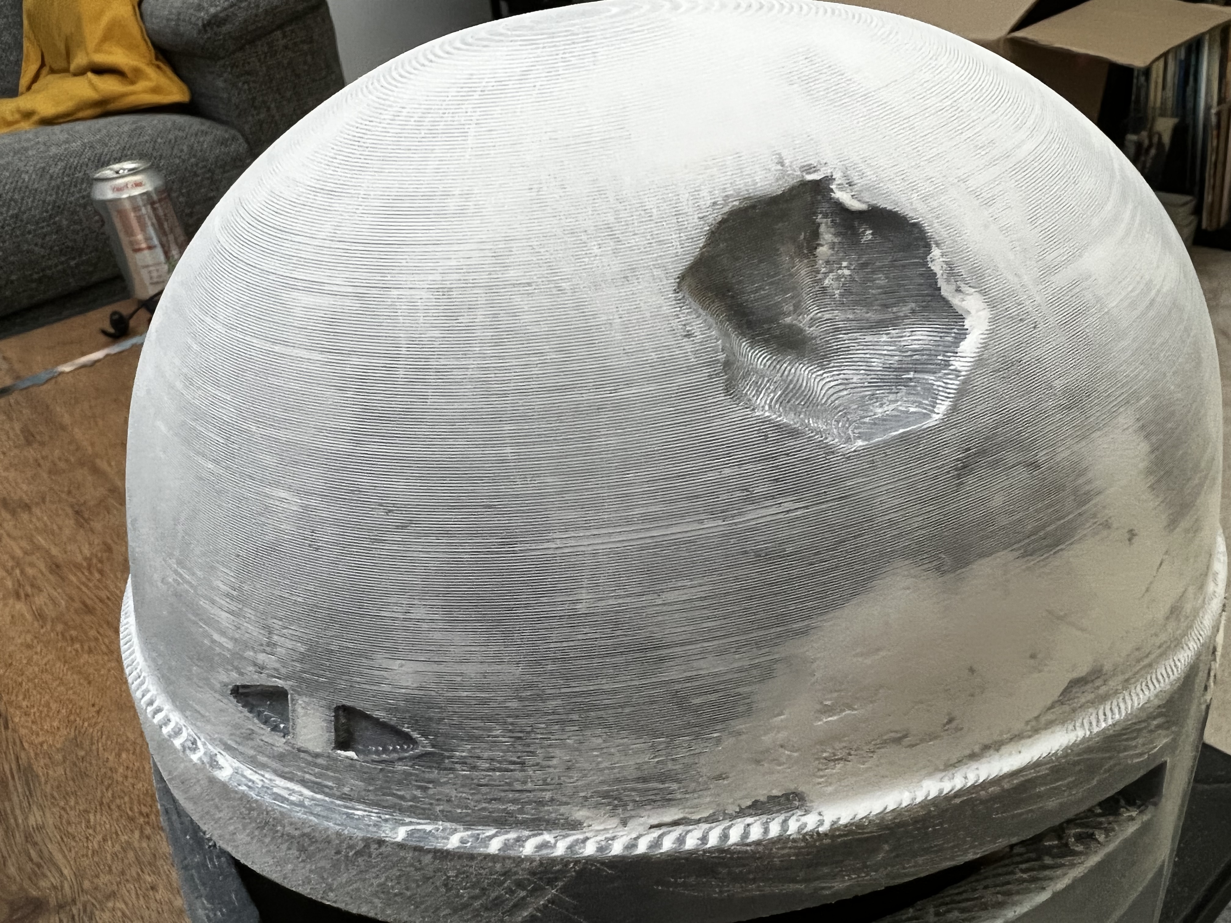

I got this on Etsy from a seller called 3DPingCrafts. Print is good, feels nice and sturdy. I ordered the raw kit so it needs a lot of sanding to get the print lines out. I didn’t take any pictures before I started but this is mid way through filling and sanding the dome. Back panels have been done and feel smooth as a baby’s bum.
An area of concern for me early on is the dent. I have no idea how I’m going to get in there and get those print lines out. I may be better off just going to town with filler and re-sculpting it. Or maybe the etching tool on my dremel? Don’t know yet.

Possibly a few coats of primer / filler and light sanding should get rid of most of the print lines in the dent. Just go slowly with the sandpaper pads from hobby lobby they’re pretty small and should get into that area nicely.
I’m in the U.K. so no hobby lobby here but I know what you mean. I’ve got lots of time to kill before my BM helmet turns up so there’s definitely no rush! My usual process with heavy print lines is to give them a good scuff with some super low grit sandpaper, like 60 or 80, before smoothing out with a 120. Then I give it a pass with some filler to take care of the deeper lines, sand that back with 400 and then a coat of spray putty which I sand with 800. Coming along nicely so far.

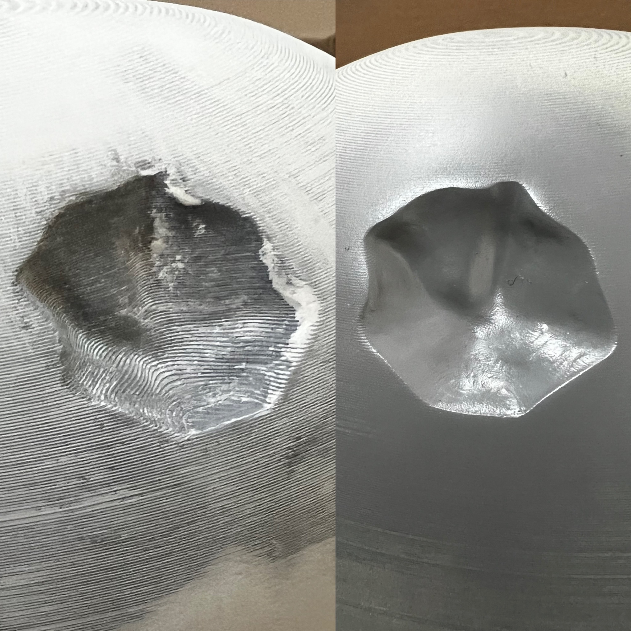

Here’s how the dent is looking now (before on the left).
Happy with this but it was a nightmare! I went the dremel route in the end, used the engraving tool and just let it lightly buzz the surface to grind out the print lines. It was a case of it looking worse before it could look better.
Once I got the lines out, I hit it with a round of filler, then spray putty.

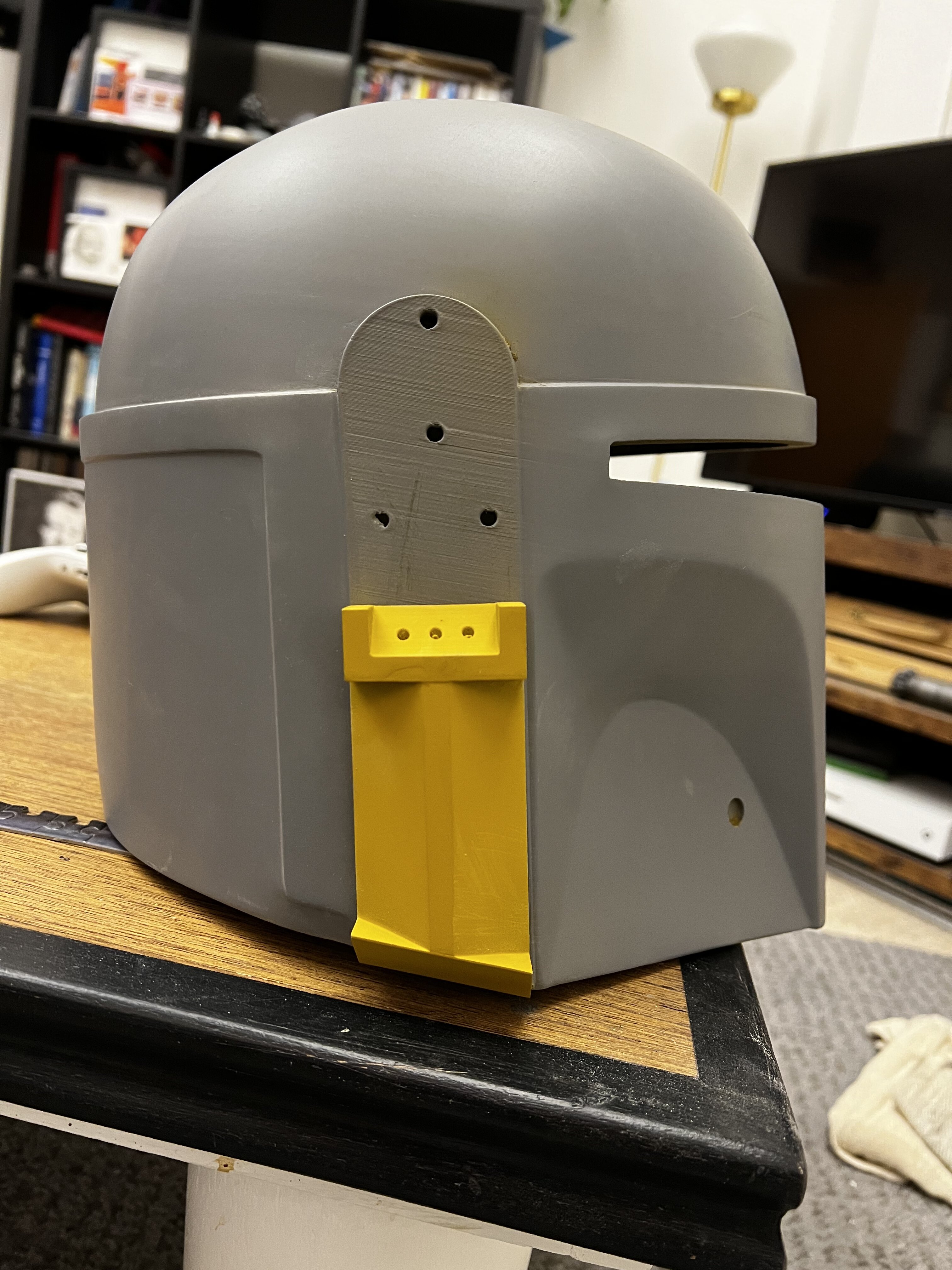

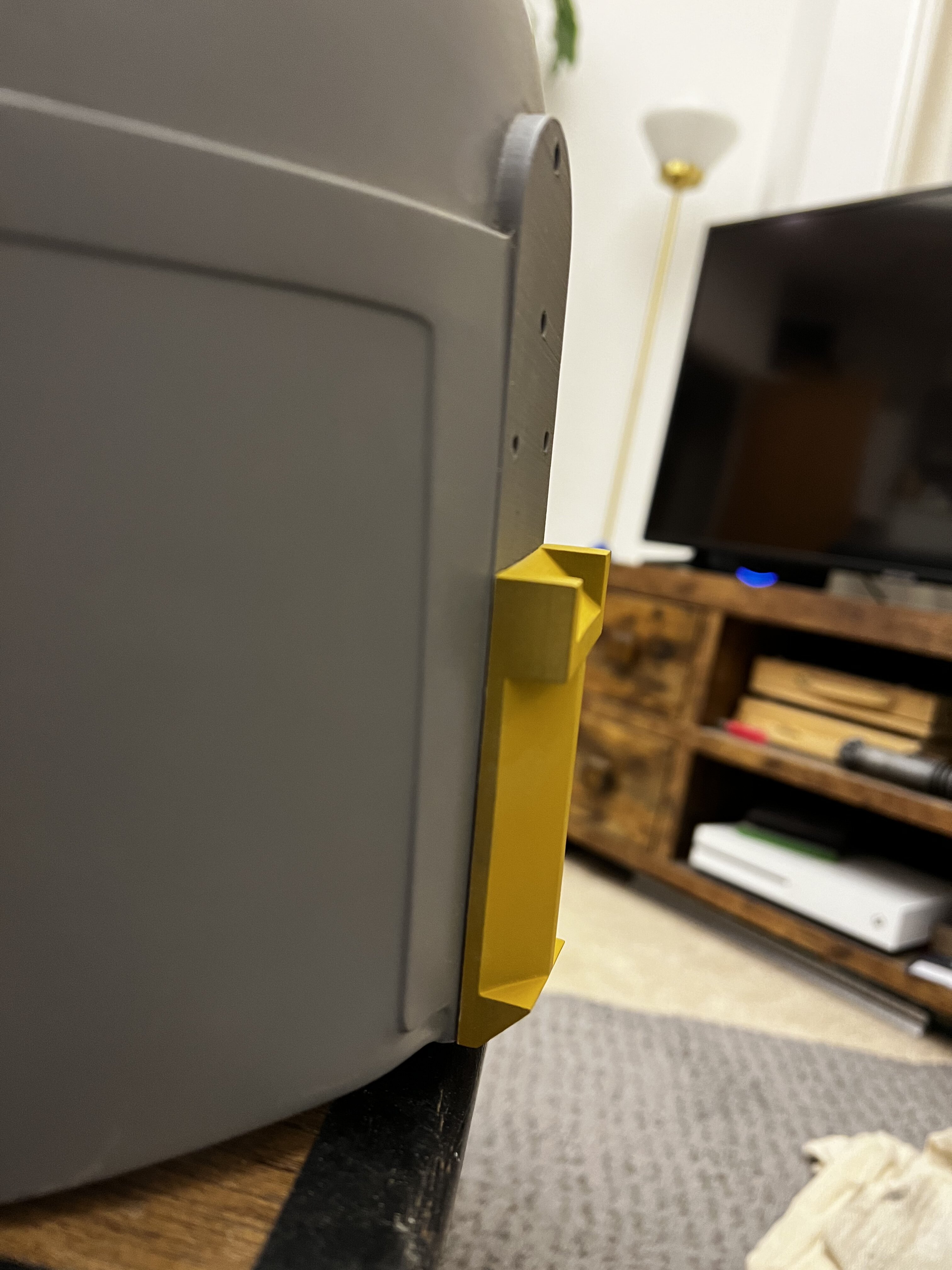

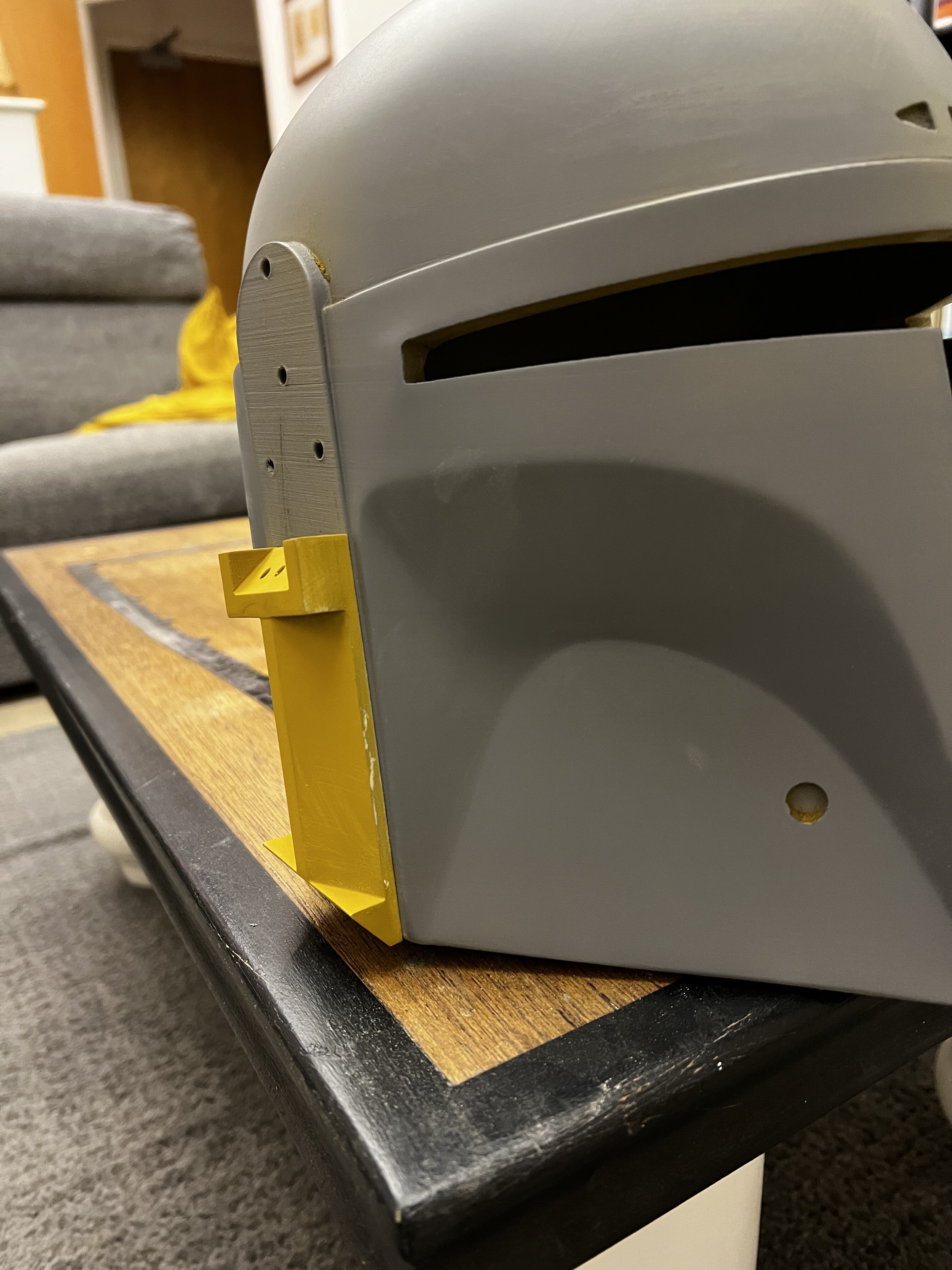

Some more sanding/priming/filling done and got the lower right ear attached. I used metal epoxy putty to attach the bolts to the ear piece. Haven’t done the upper right ear yet because the bolts I have are domed and won’t allow for the cap to sit on top so I need to get some countersunk bolts. Also, is it me or does a grey/yellow colour scheme kind of look awesome?

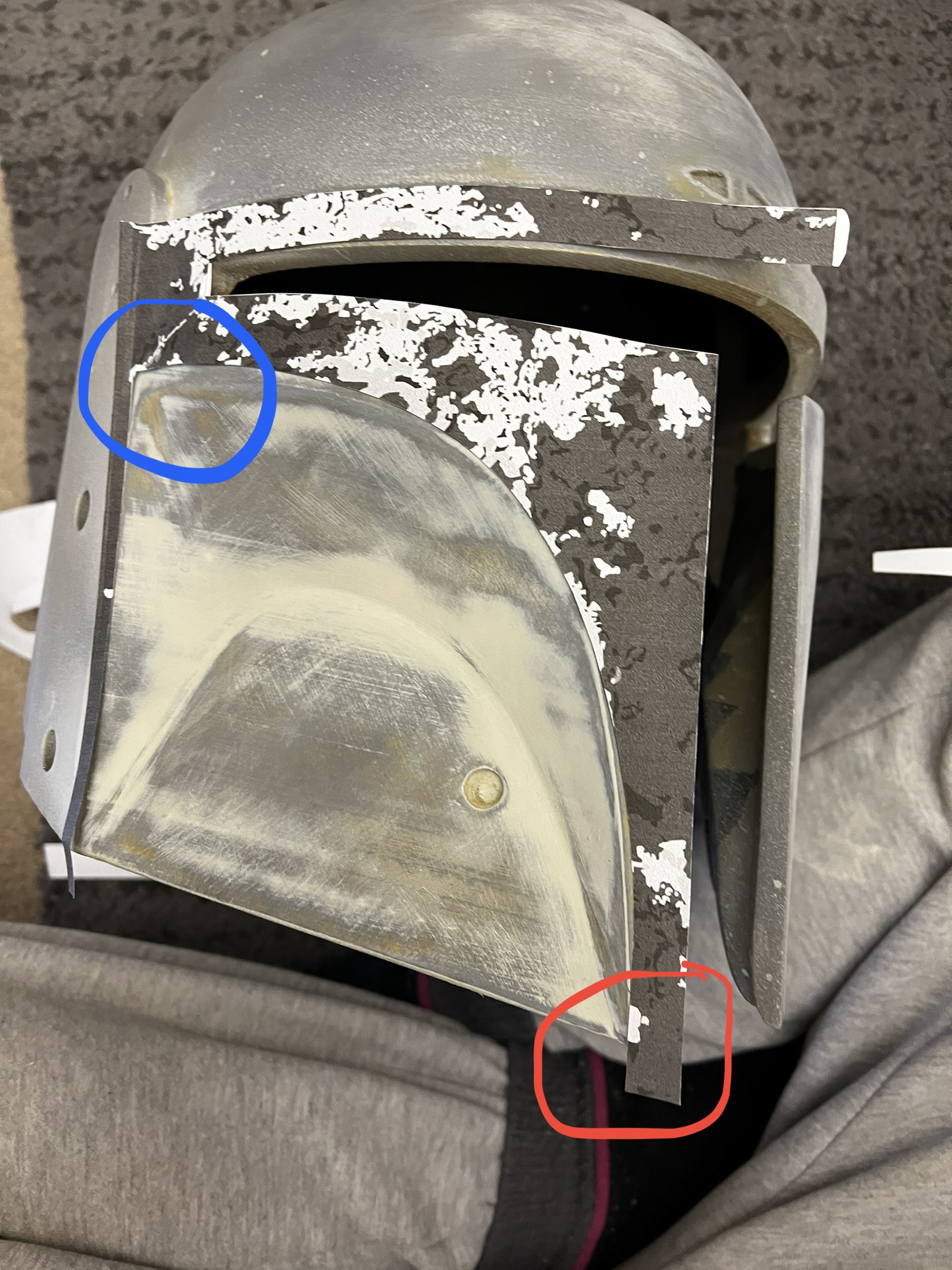

I’ve run into a problem. Started printing rafalfett’s templates but I cannot work out how to scale them. You can see in this picture, it looks too big in some parts (red circle) but too small in others (blue circle.
How on Earth do I do this?

Ok, so I thought this would solve it for me but I’m still struggling.
I have the RH rear panel aligned with the bottom of the trim and and edge of the rear slot panel. So far so good:
But, this leaves this edge nearest the ear WILDLY misaligned and I can see it’s too long
Ok, so I need to make it shorter, but the bottom left corner is already too short:
I know I shouldn’t expect perfect alignment but this feels nowhere near good enough to proceed with painting and I can’t see how any amount of stretching the templates is going to fix this.
You can see my problem a bit easier when you look at my traces template laid over Rafal’s:
It looks ok for the most part but if you look at the bottom, it needs to be wider but the top looks like it needs to be narrower. Not really sure if this level of disparity is normal or how to proceed if it’s not?
All I can assume is that because it’s just a cheap-ish Etsy buy (£65) the proportions are likely to be all out of whack.

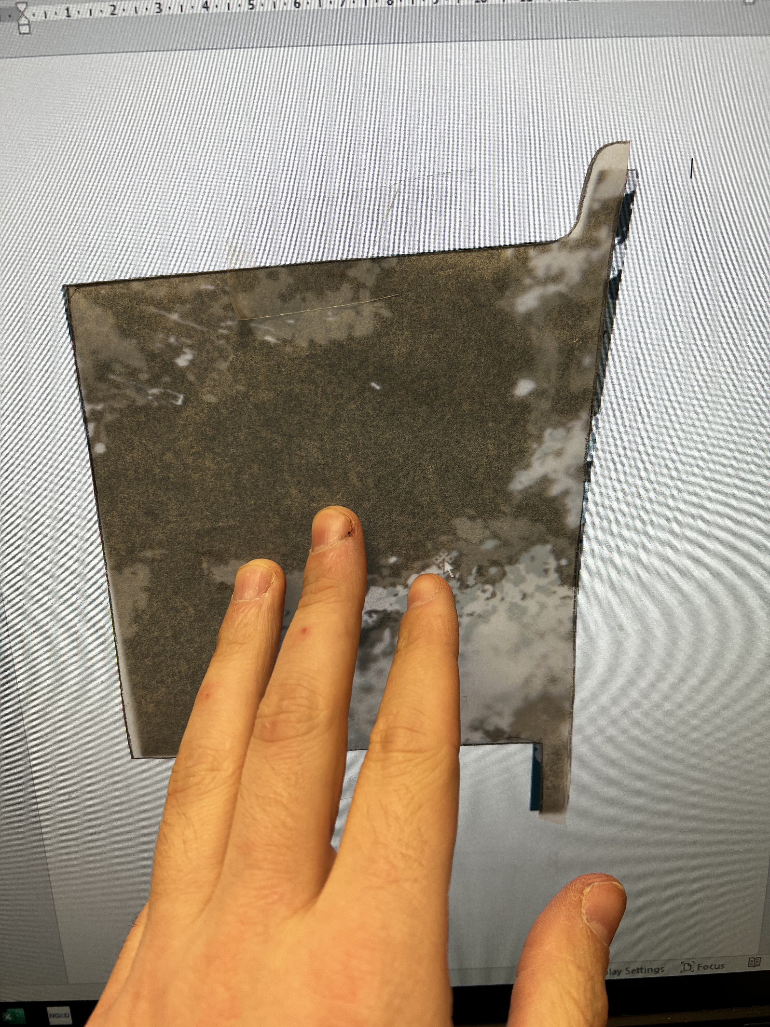

In which case, since I’m not overly concerned about accuracy with this lid - I only got it to practice airbrushing technique and keep myself busy while I wait for my BM helmet (ultimately it’ll end up a display piece) I’d be happy to warp/skew the templates where needed. It’s just a matter of finding a program I can do that with
Photoshop is good for that. I’m sure there are others, possibly even free ones online, but PS is what I use.
Yea, I don't have PS and can't seem to find a free option that has the kind of function I need. I'm at a bit of a loss to be honest ?
The template you printed out looks pretty close. Honestly, even with Photoshop and other graphic programs, you will hardly ever get it 100% exact.
Just after my last comment, I decided to take one last shot and re-visited a free online editor called Pixlr. Turns out they have a 'distort' option which allows you to size and stretch the image from each corner. I'd NEVER do this for a helmet I planned to troop in but as I say, this one is just for fun and anyone who comes round and sees it on my bookshelf is not going to know. I think/hope that is problem solved.
Hope it works out for you.
Thanks mate, but it's not really working out. It came out ok with the back panels but once I got to pieces like the mandibles I realised i't not going to be a good enough solution.
Even once I get the templates to fit, their so distorted and pixellated I don't think I'll be able to see what I'm doing.
