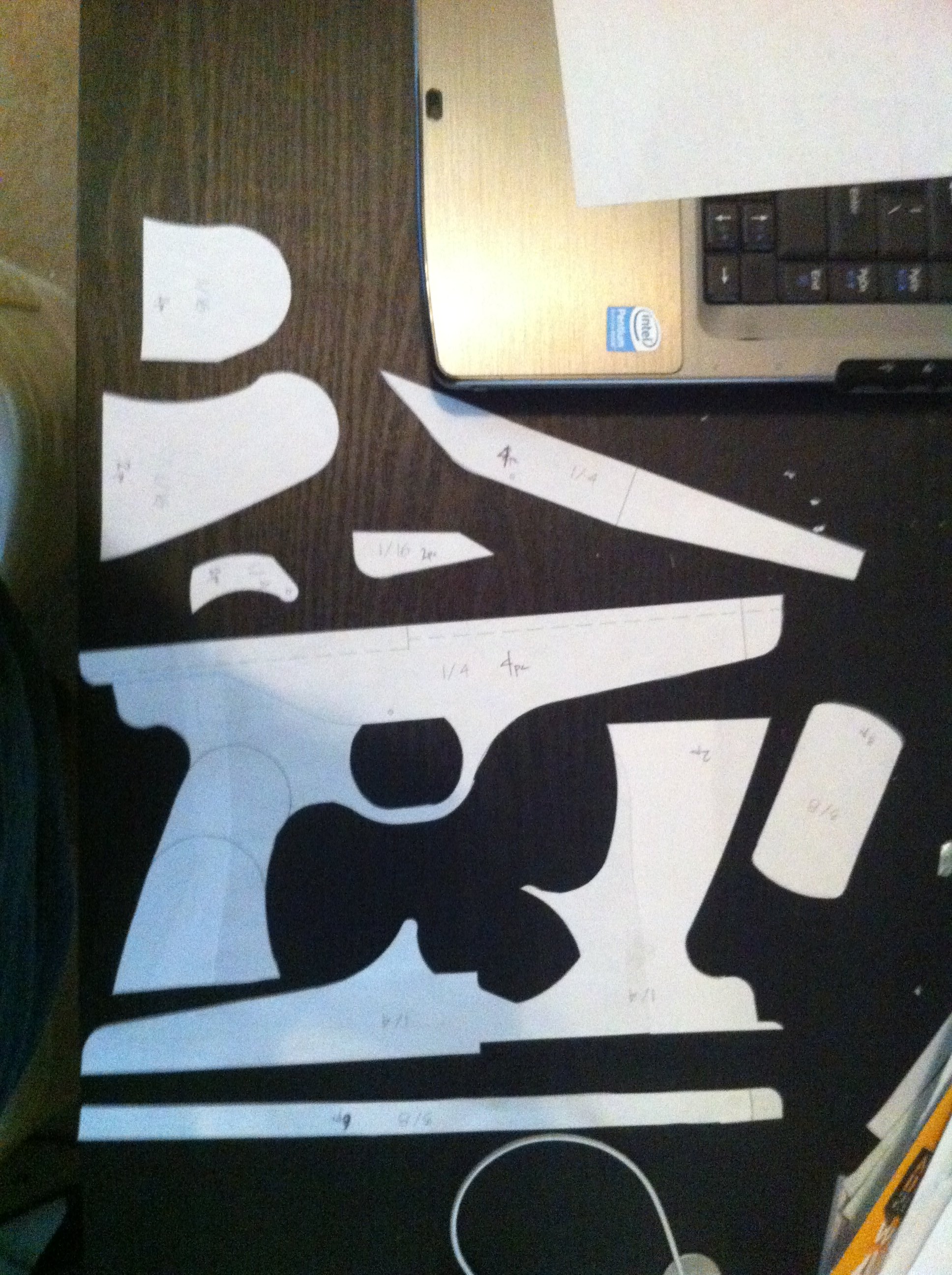

Yesterday, I was waiting for paint to dry on my chest armor and started looking through the jet pack templates to get a game plan, when I came across the WOF sidearm templates. Since I've never attempted to scratch build anything like this before, I figure I'll start with something not as intimidating as the jet pack. So, here we go...
1st- I printed off the WOF templates. Alan seems to have made this look relatively easy...:) All the templates are labeled with the thickness of each piece. For this build, I have choosen to work with 1/8" (3mm) Celtec, which I understand is very much like Sintra. Once I printed the templates, I cut them out.

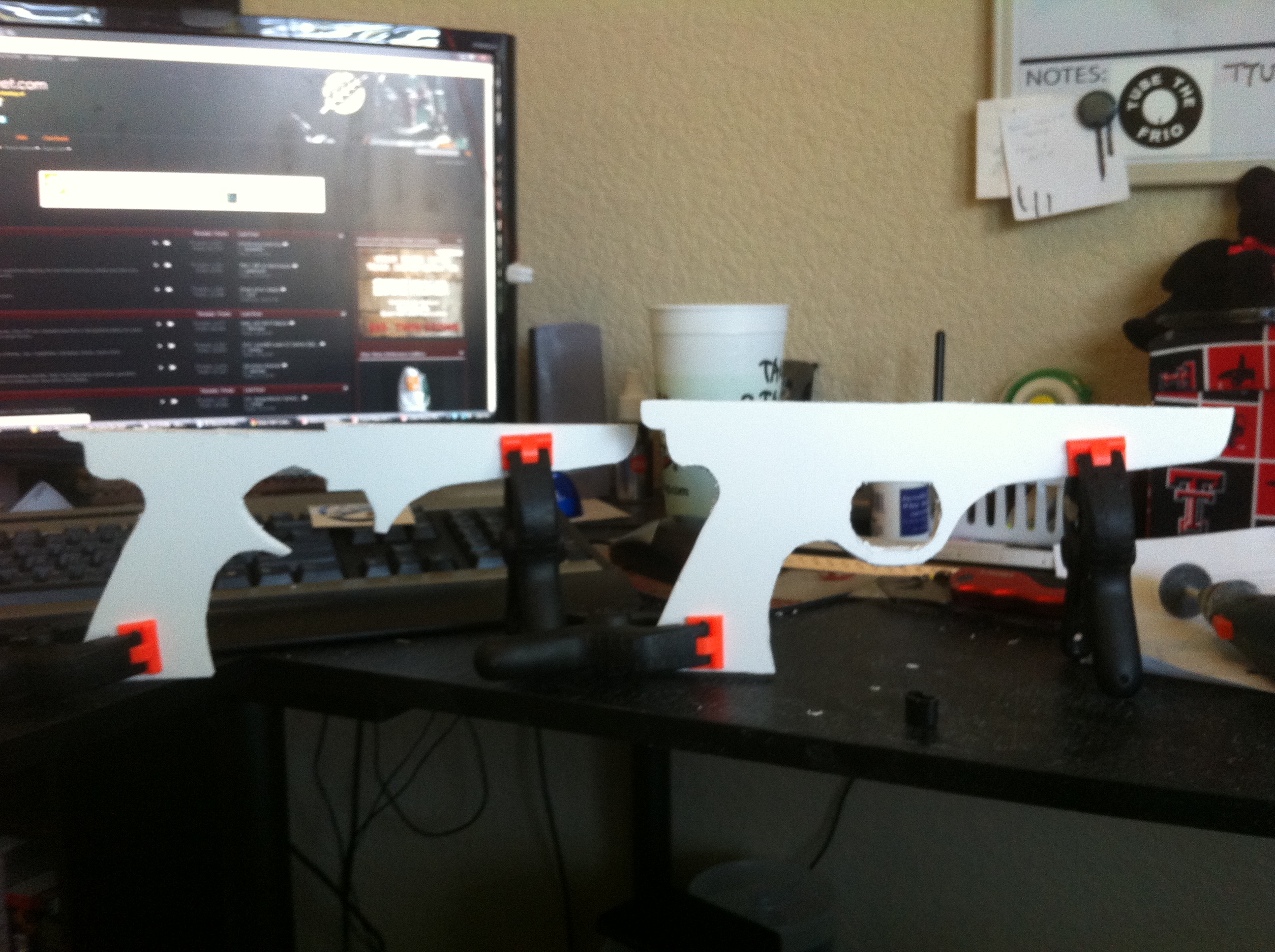

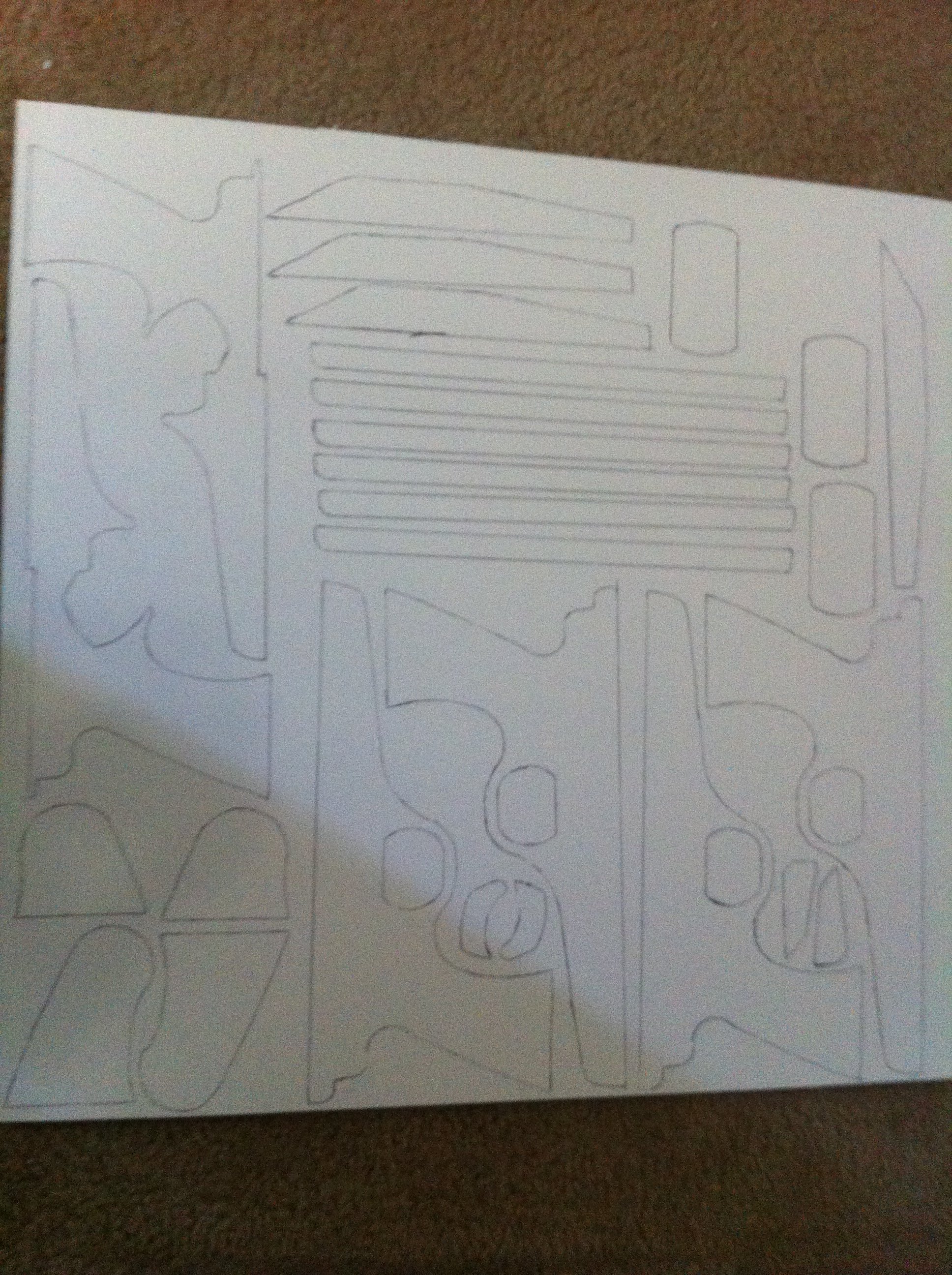

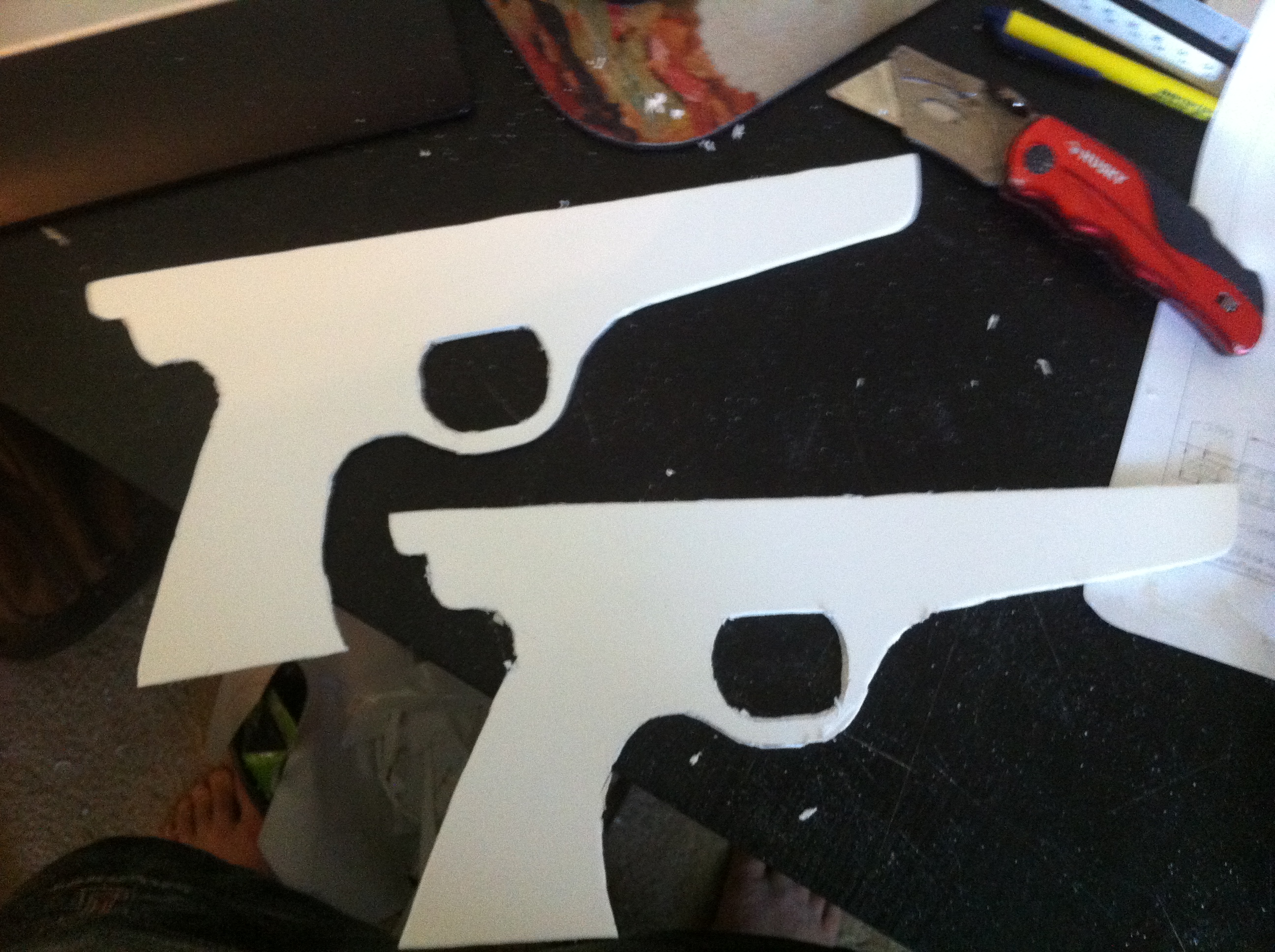

Then I traced them onto the Celtec.

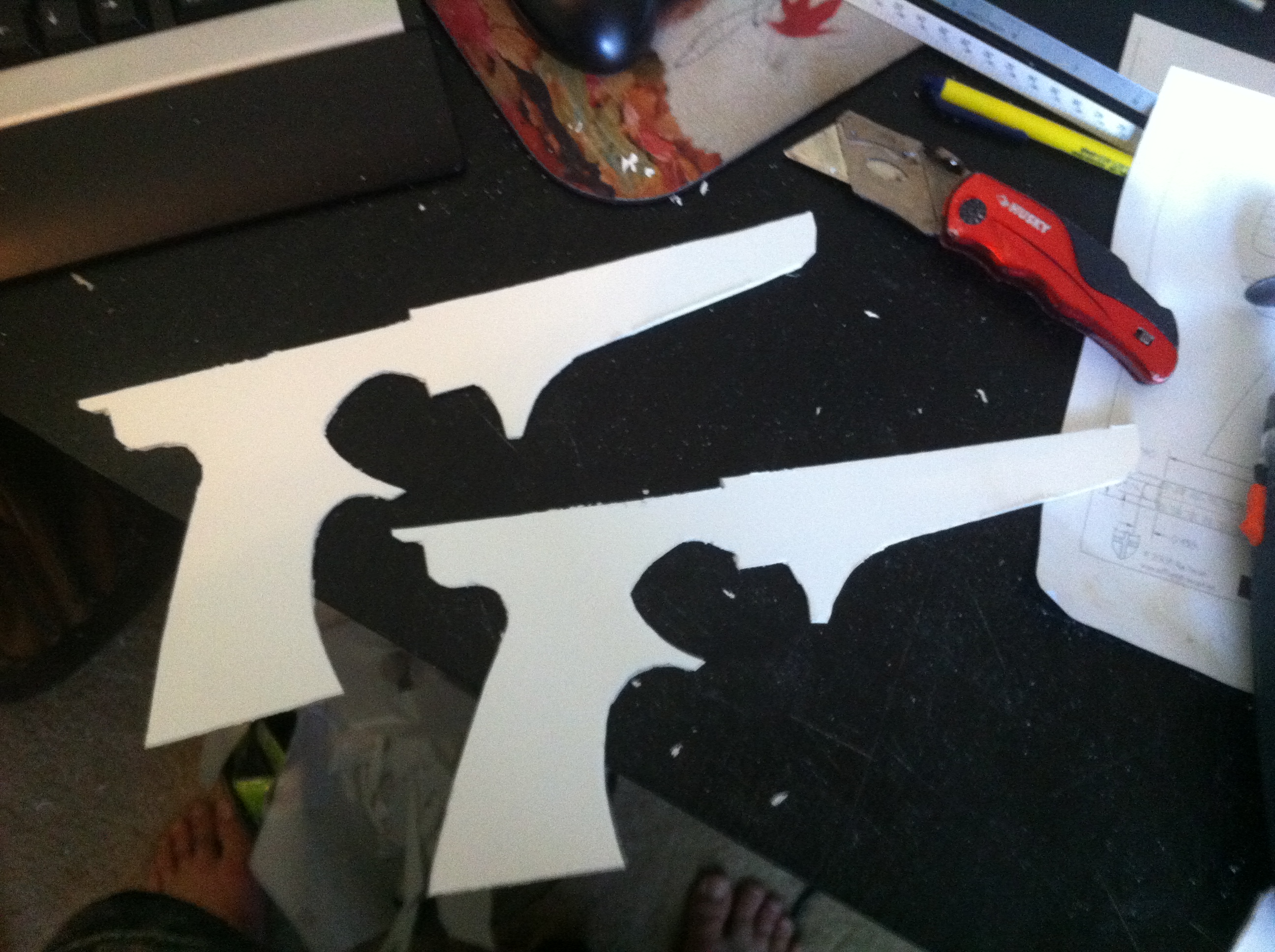

Now it was time to give the dremel a little work out! It was 103 here yesterday so I decided it would be smart to do this in my office...:lol:
This stuff gets EVERYWHERE!!! and sticks to EVERYTHING!!! Don't do this in your house. Your wife won't be happy!
Here's the cut out pieces.

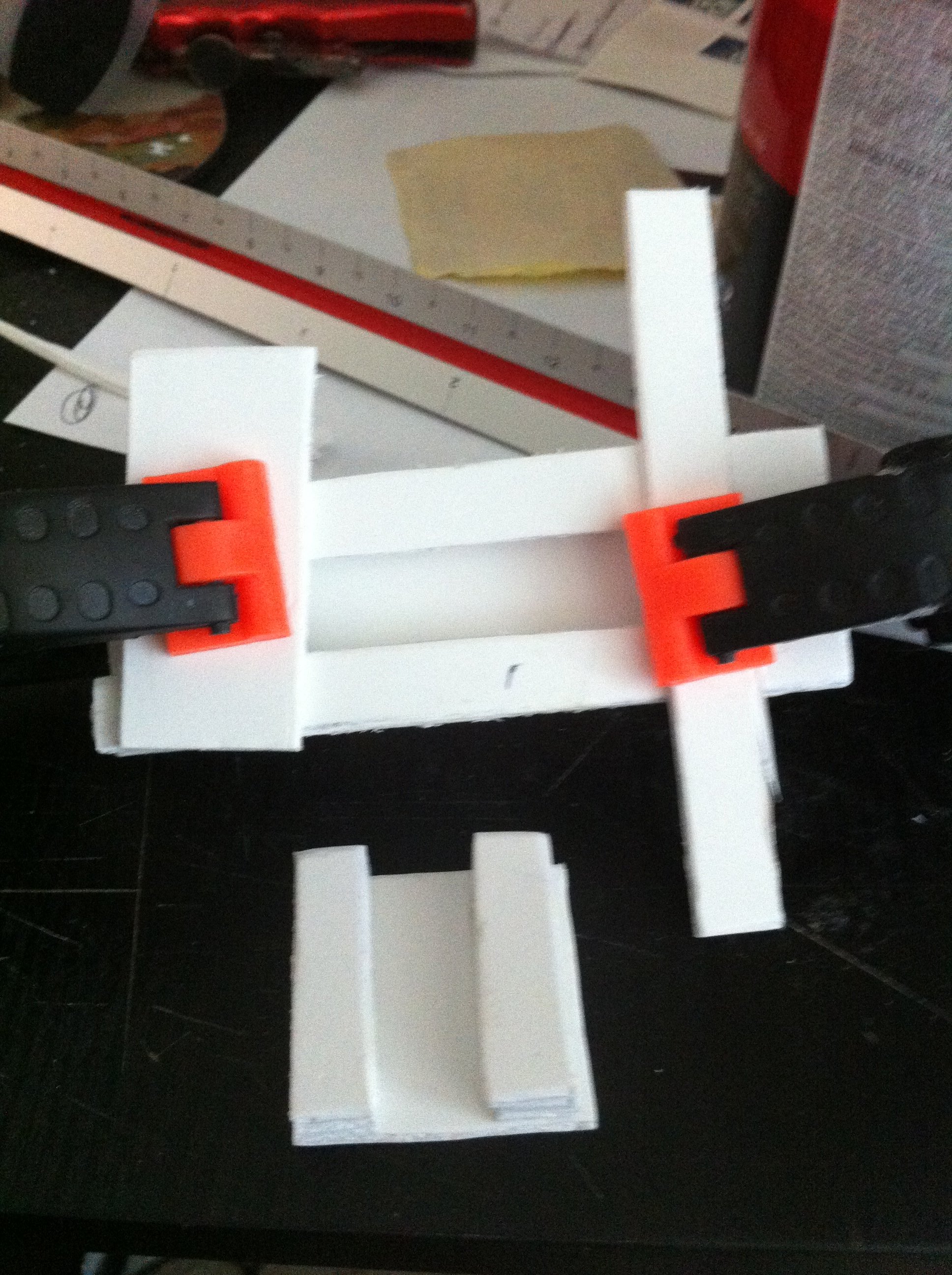

I was watching a RKD video the other day and he recommended this stuff:

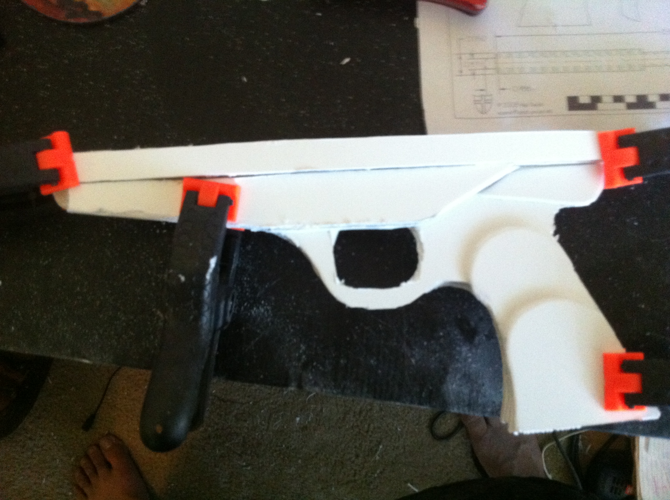

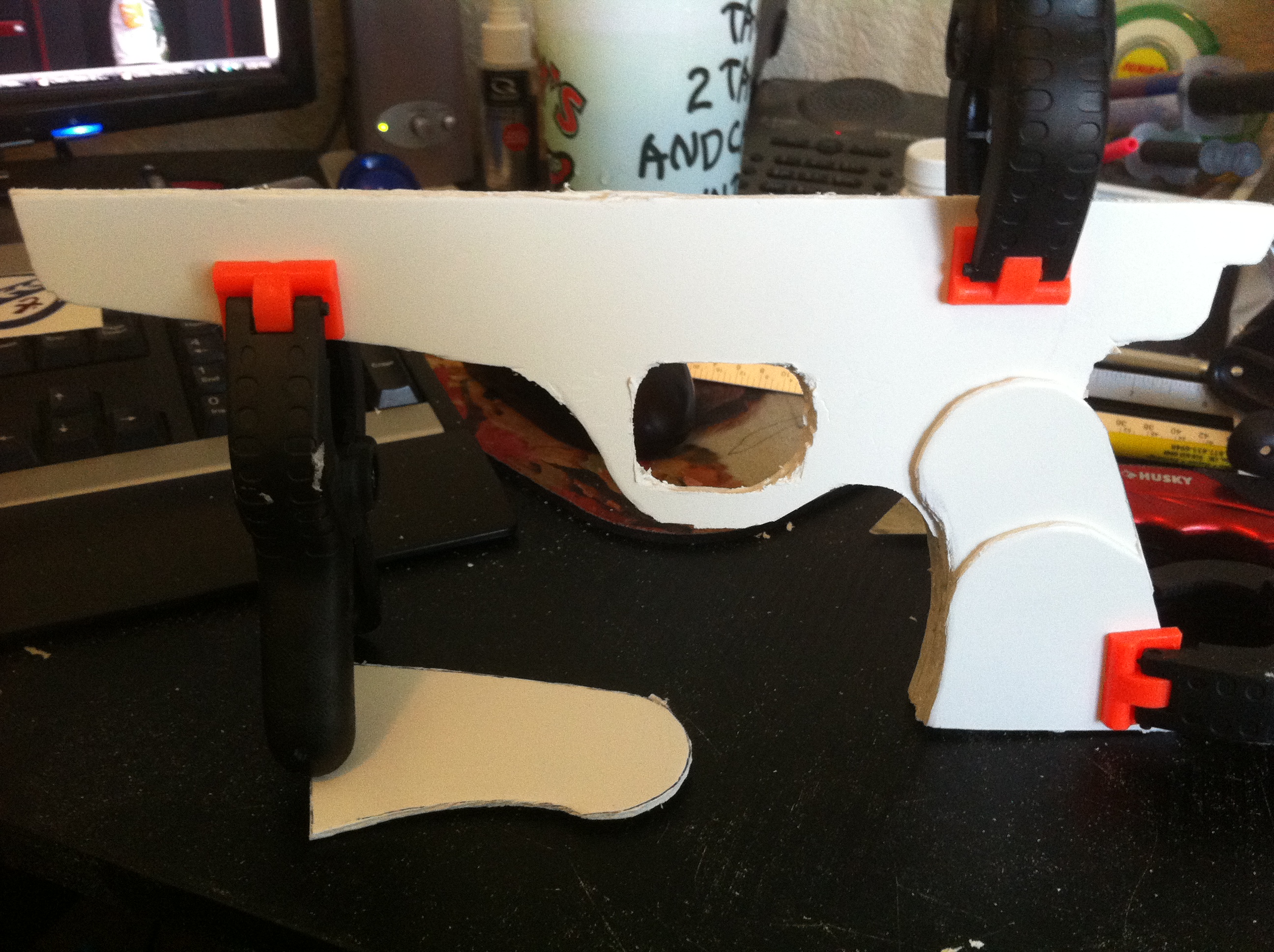

So , I followed his lead. Seems to work pretty good. I just mixed it like any other epoxy and smeared it in the pieces and clamped them together.
From here, I just dry fit the rest of the pieces, so I can figure out the best plan of action.

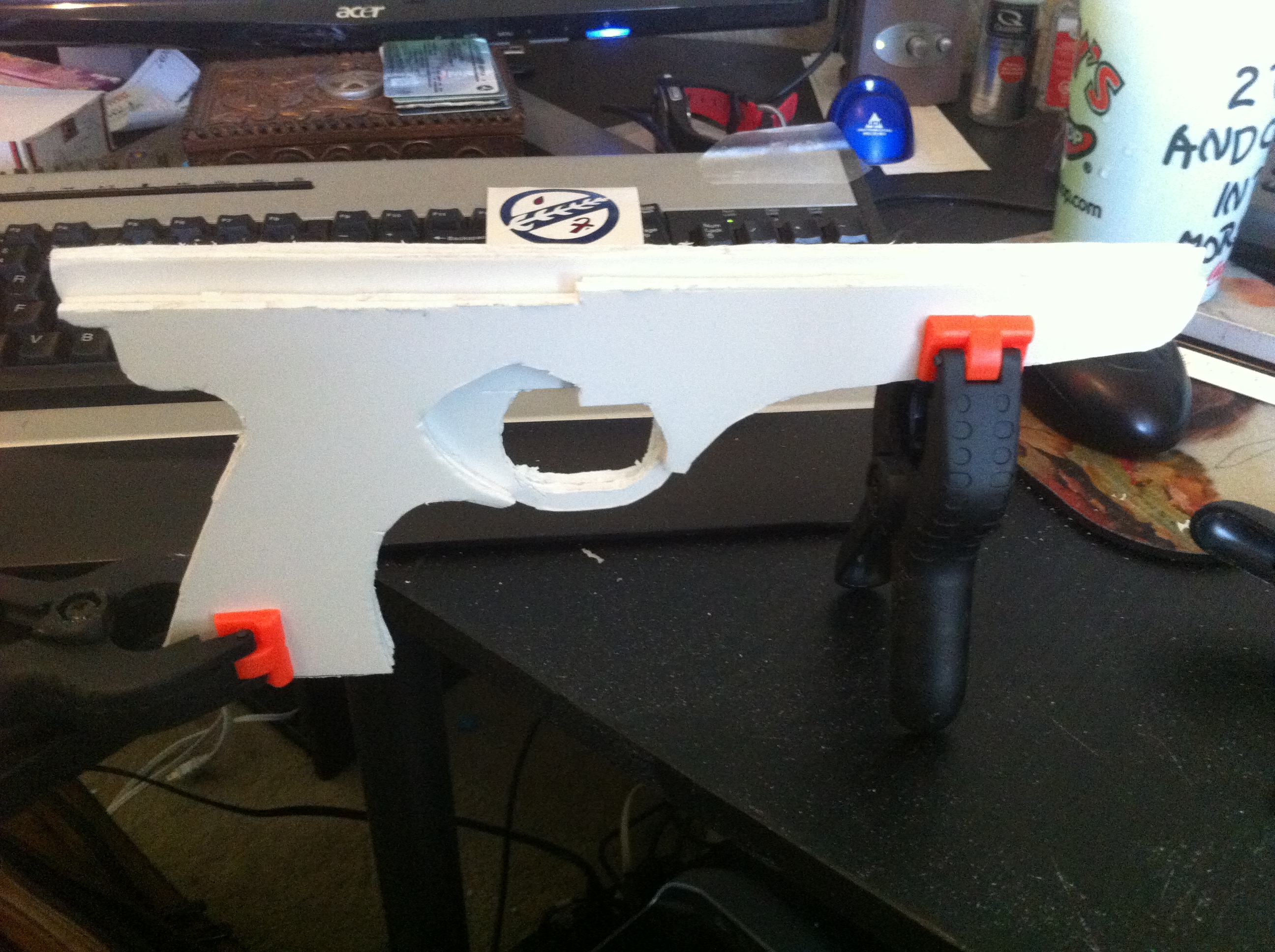

So here's what I'm thinking this morning. I'm going to glue up frame and grip pieces, but not the upper rail or or lower rail (technical terms...:)). This will allow me to drill through the frame and trigger (gotta figure out a spring for that too...) and cover the pin with the upper and lower rail. Or, should I attach the upper and lower rail and drill though them so I could remove the trigger in the future should I need too? Not sure why I would need too, but always nice to have options! :)

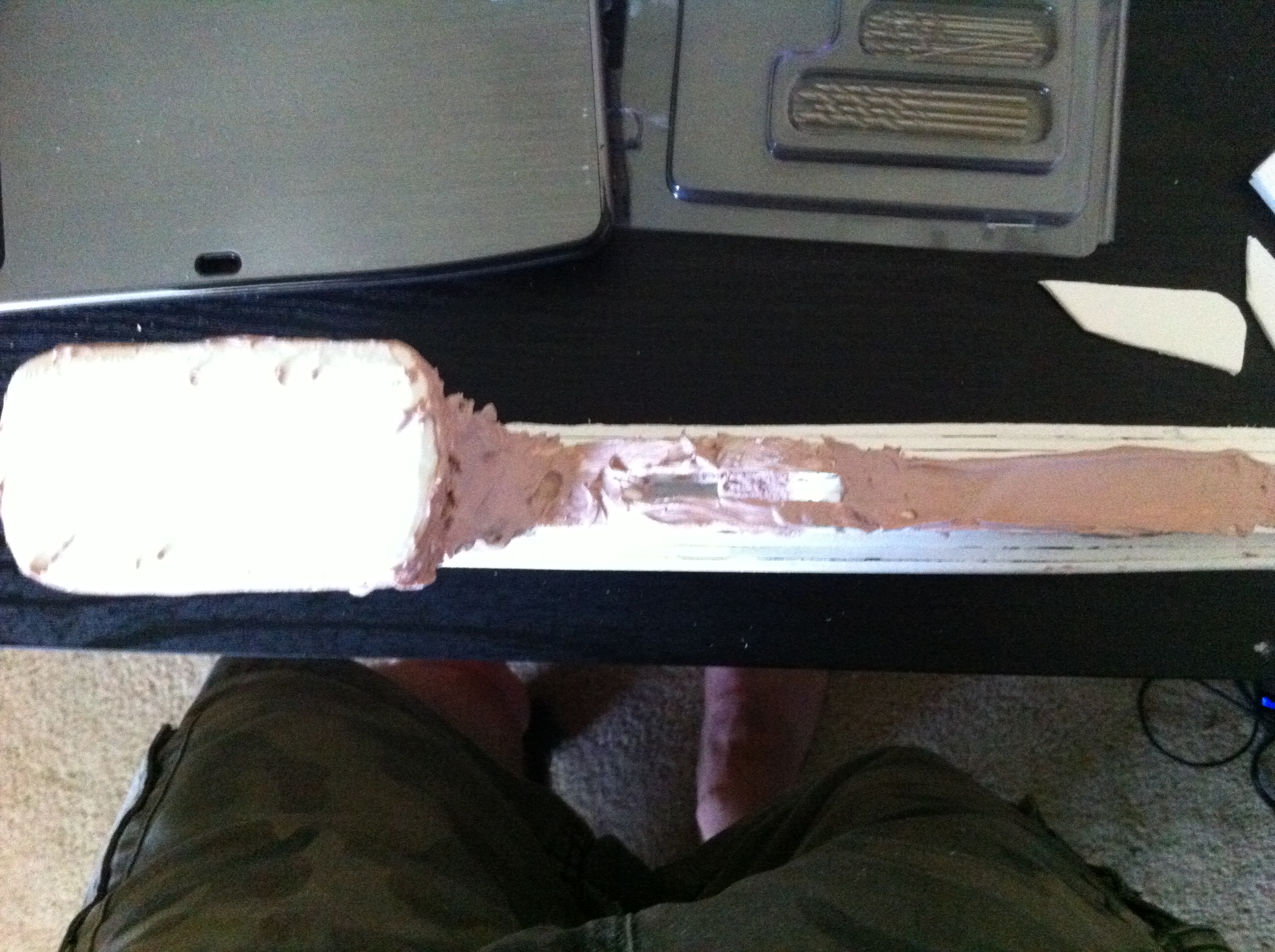

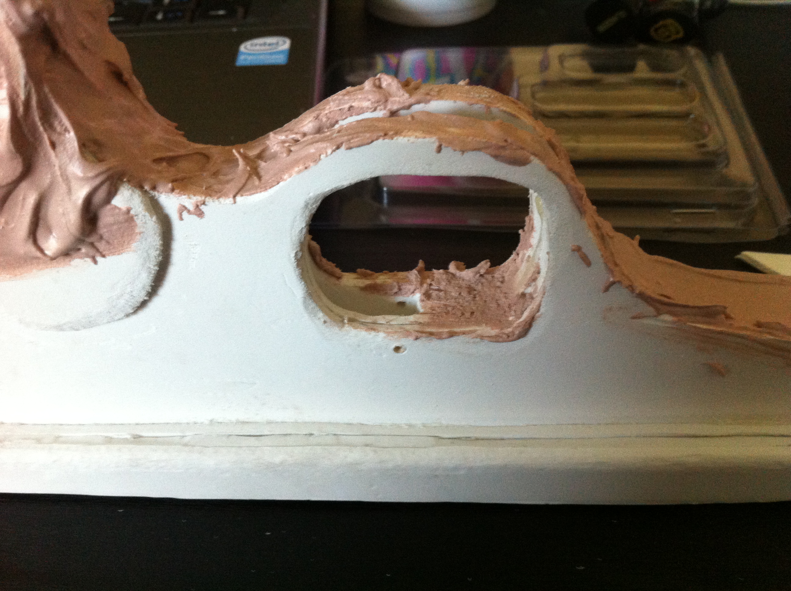

Once I figure this part out, I will sand it down and then hit it with bondo (something else I've never worked with) and sand it again.
Thoughts anyone?

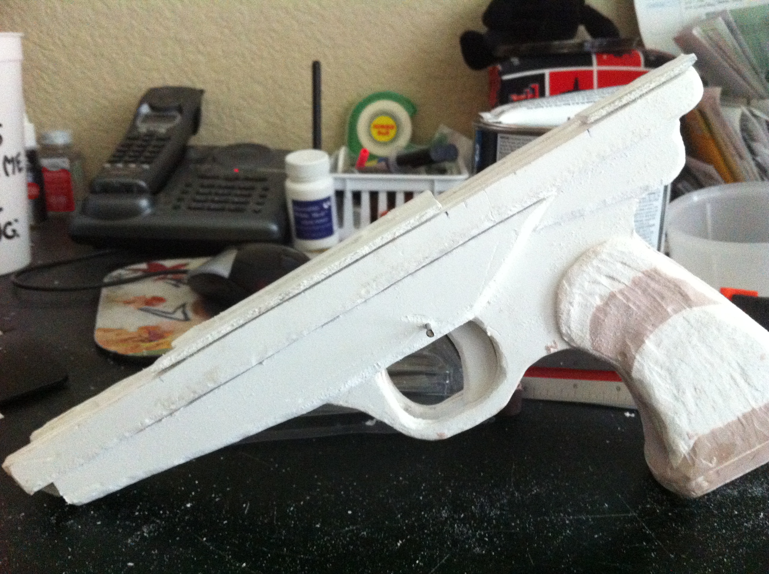

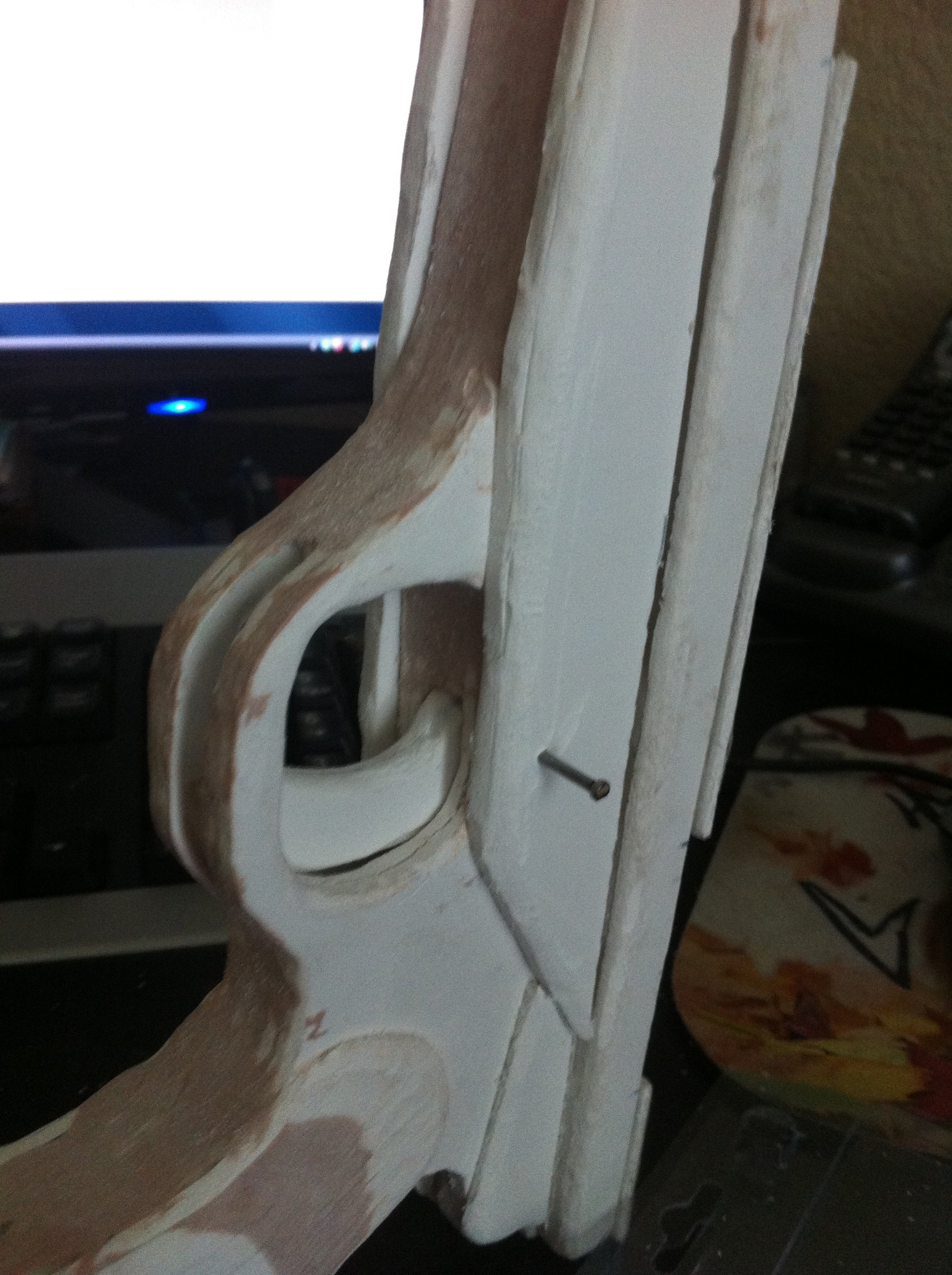

I haven't had a lot of time today but here's what I got accomplished... I trimmed up and fitted the trigger. Drilled the hole for the trigger pin. And laid some bondo around the handle and trigger guard. This way I can finish up the trigger area, install it and glue the lower rail on each side. This will allow me to really start shaping the components.

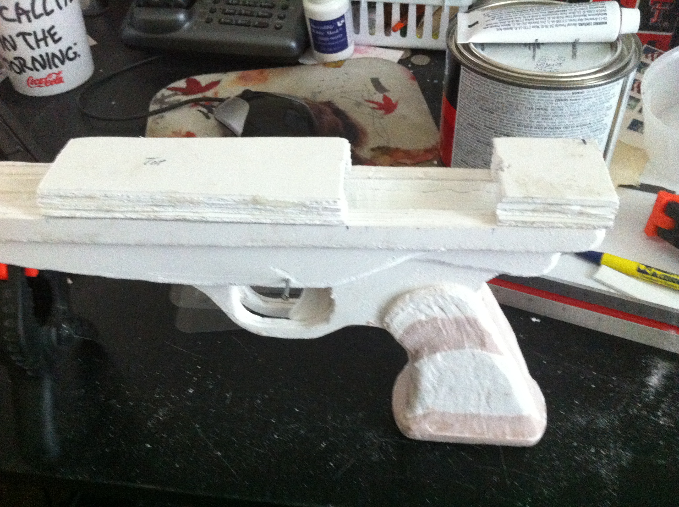

I went ahead and added the 2 side pieces and and drilled through them for the trigger pin and then set the 2 rear side pieces. I also cut some pieces for the frame work on the top or cap pieces that will enclose the bolt.
Then I cut out the rest of the frame work and glued it up.

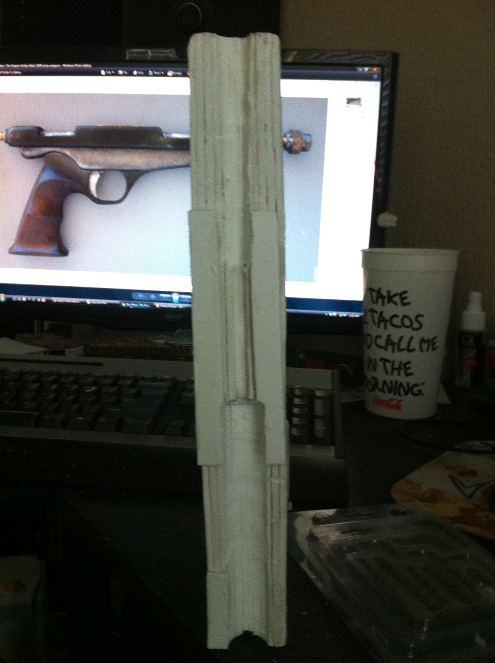

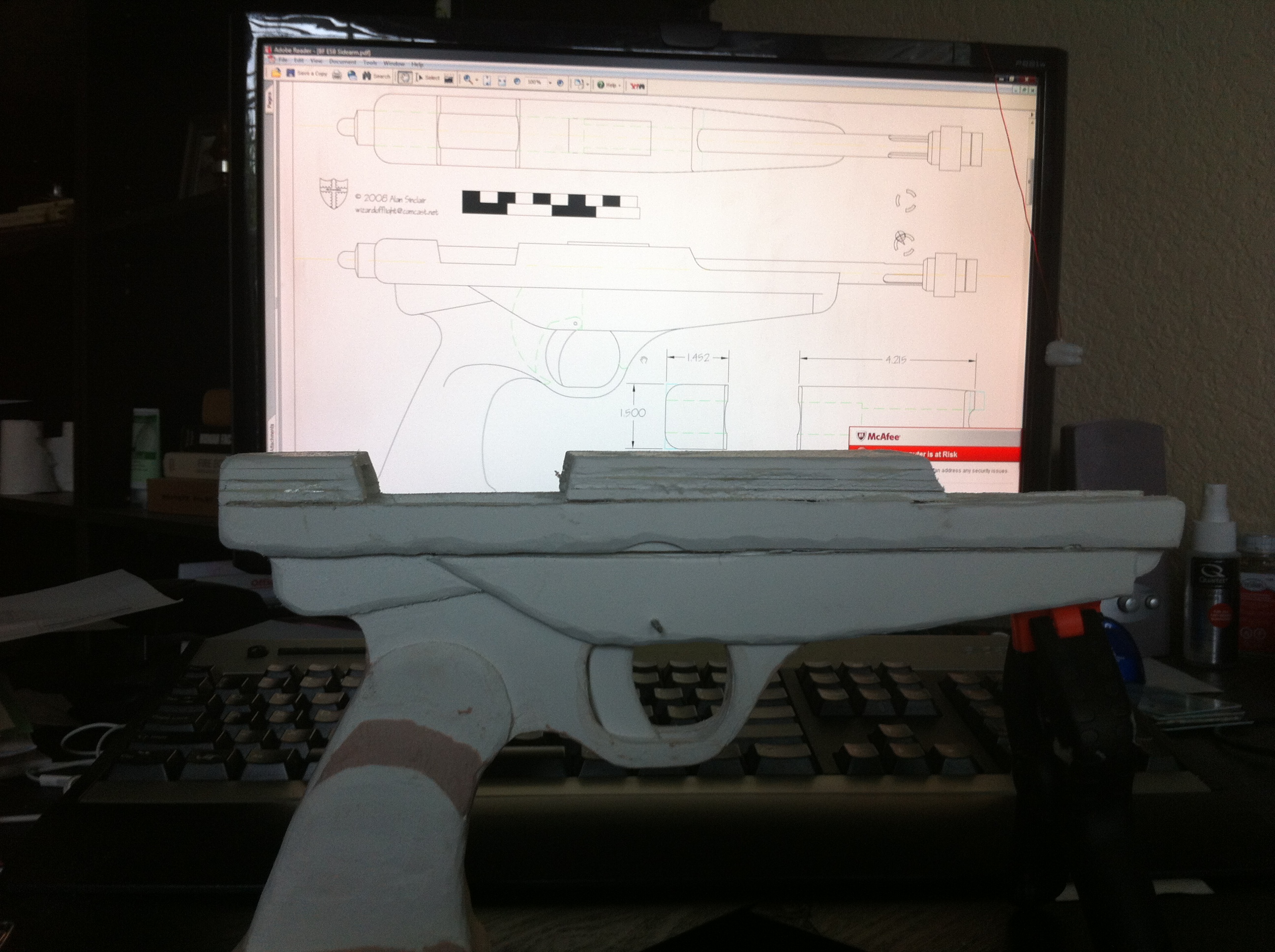

While that was drying, I took a 3/4" and 1/2" sanding bit and routed out for the bolt. I decided to go with 2 separate pieces since you don't see where they connect and I don't have to find 2 pieces that "marry" together perfectly... Hopefully this will make it easier in the end :)
I am pleased with the lines and they way she is starting to come together!
Here it is with the top cap glued in place.

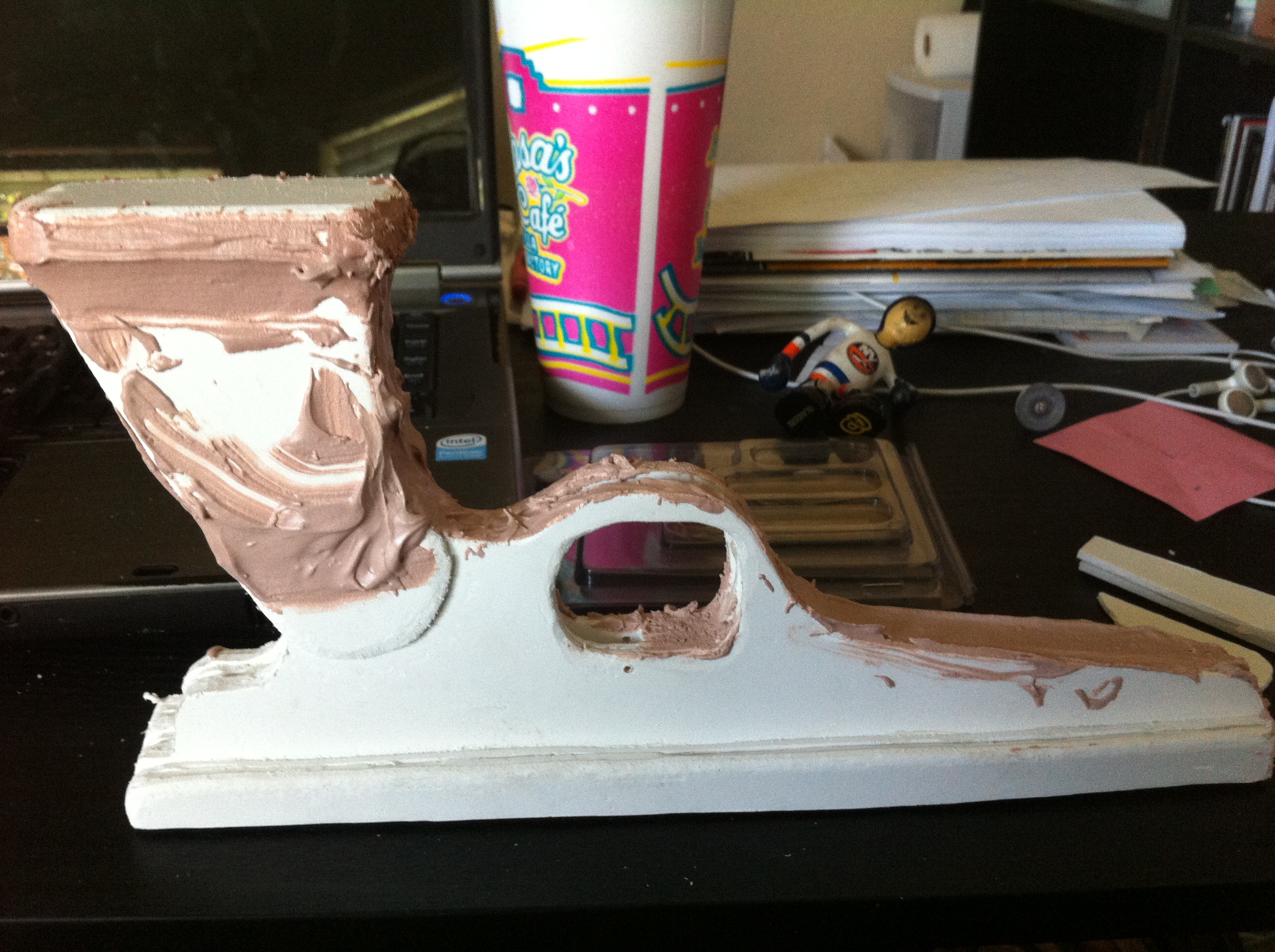

Now I just have a lot of sanding to do before I hit it with bondo. Hopefully I can get that done tonight or in the morning.
I know this post is only an hour or so later, but I couldn't wait to start sanding! :lol:

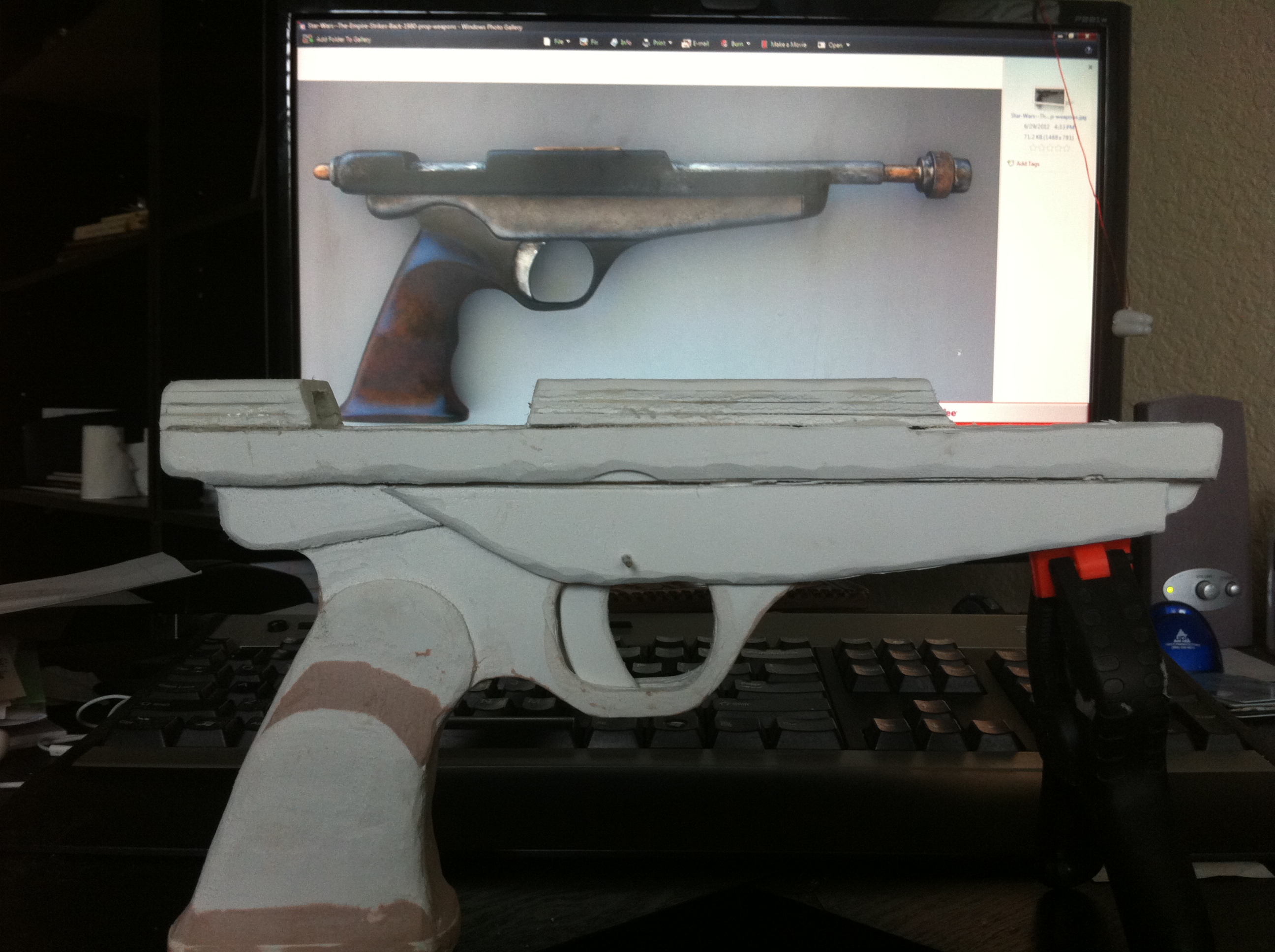

I put a reference picture in the back ground for comparison as well as the WOF assembly file.
Let me know what y'all think!

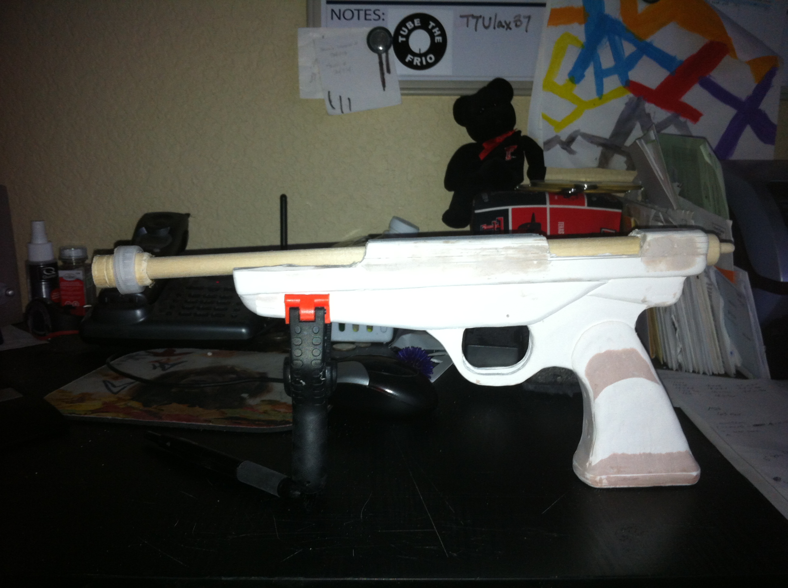

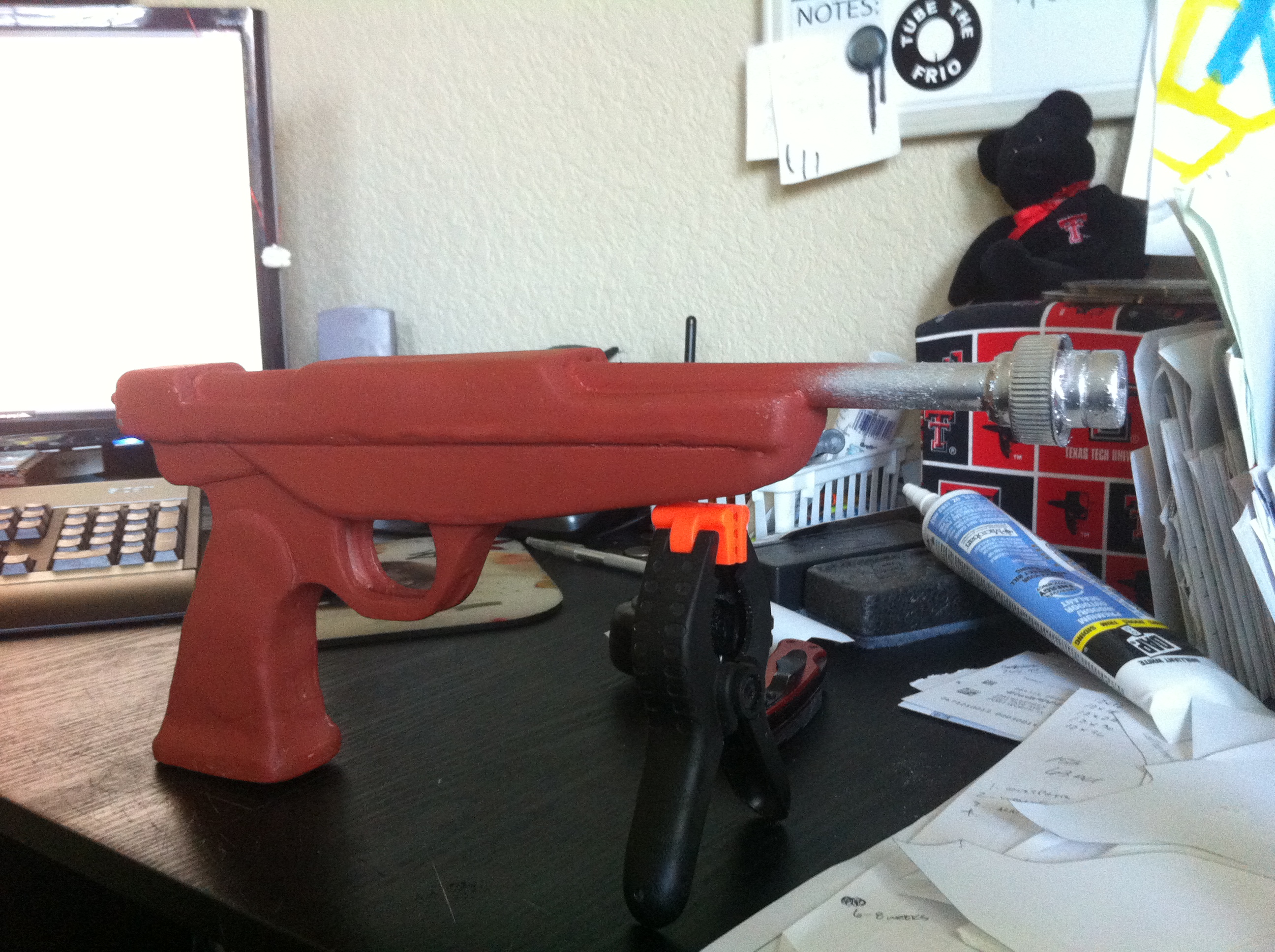

She's starting to look like a side arm! I used 1/4", 1/2" and 3/4" dowels for the bolt, bolt pin and barrell. For the knurled piece on the barrel I used a battle cap.

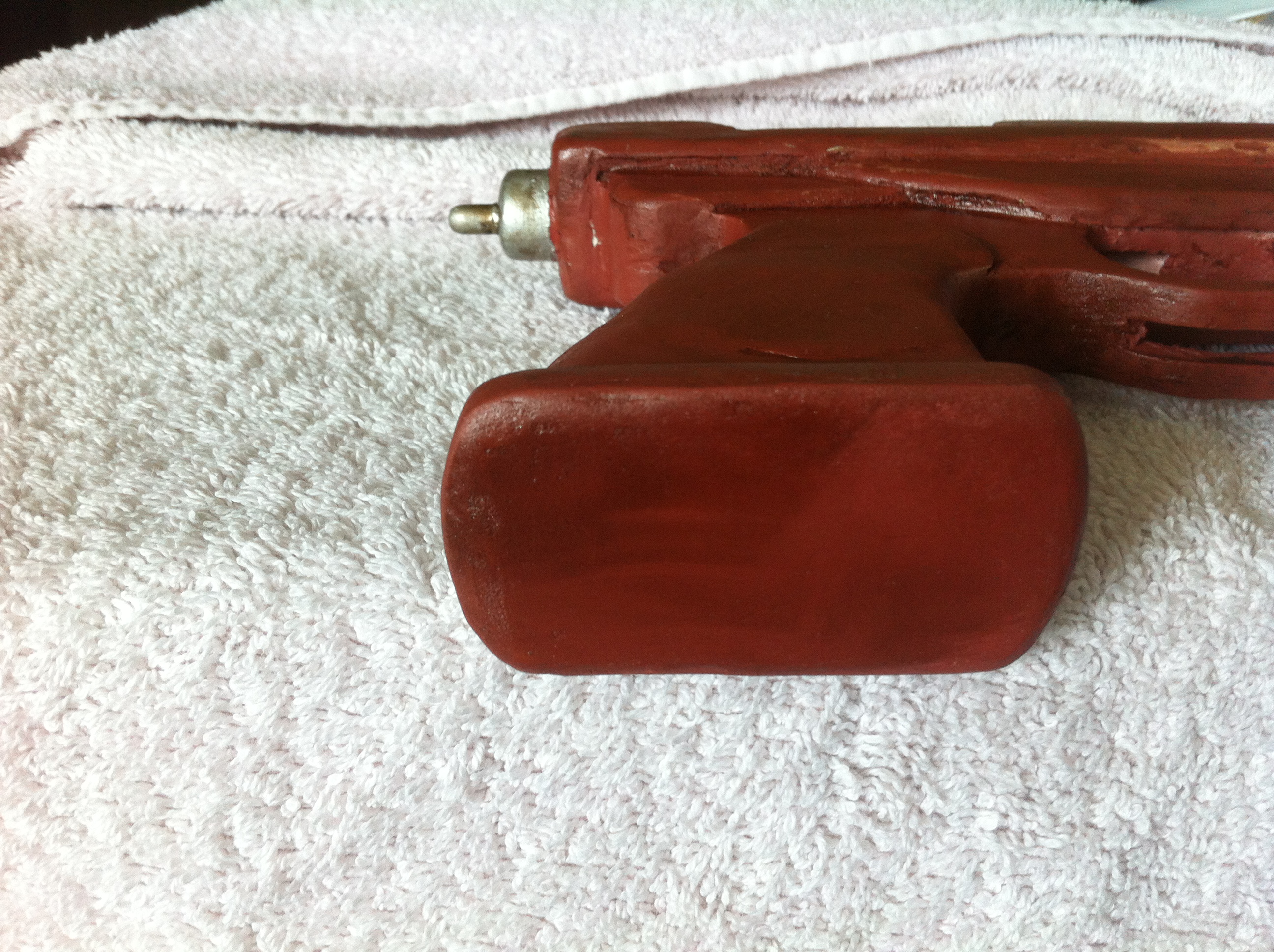

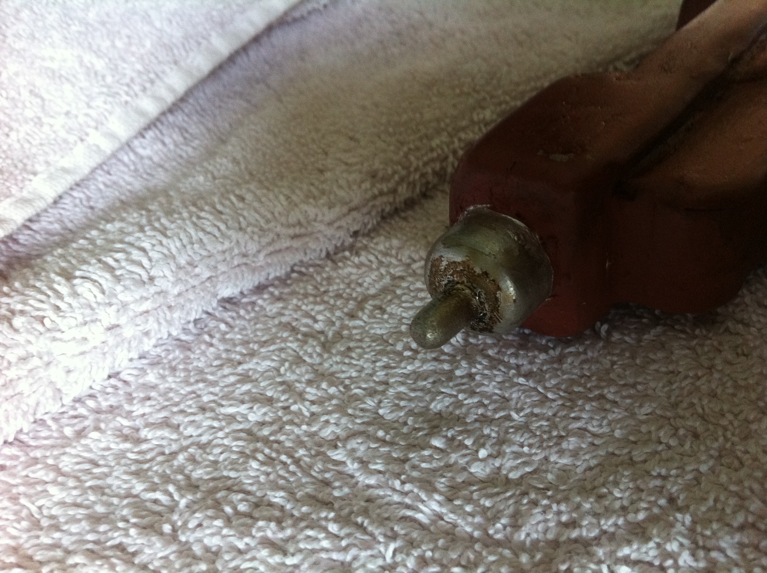

Here's a picture with test colors. I think the orangey reddish color will work out once I get some walnut stain rubbed on it. I test painted the barrel to see how the bright silver was going to look. Again, I know I need to weather this thing with some walnut stain, but I can kinda see where I'm headed now!
Thanks Phantom and Raf!!! It's been fun, but ready to move on to the JP!

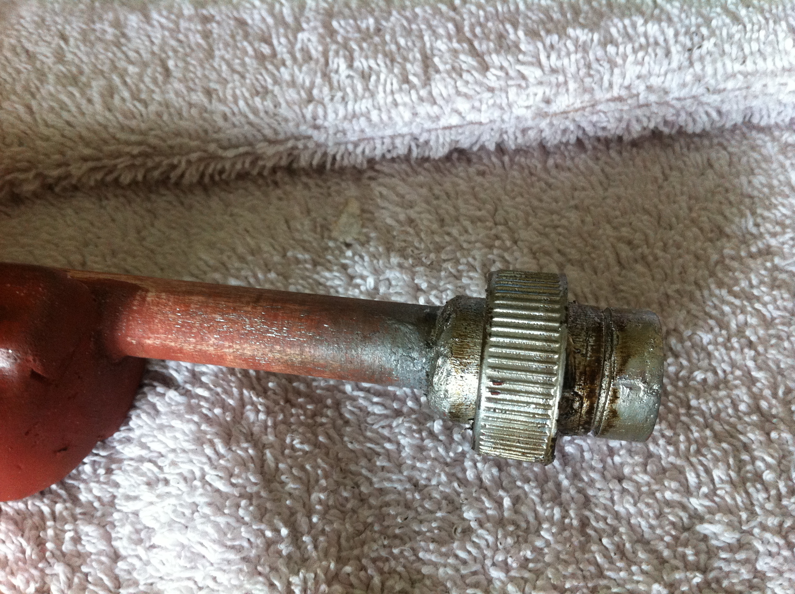

Once the bright silver dried, I found out that I didn't sand the dowels enough. I could still see the wood grain through the paint. So I started sanding and then thought I better take the opportunity to see how the weathering will look. I rubbed a little walnut stain all over it. I found out that walnut stain will take the paint and primer, right off the plastic if you rub too hard! Oops!!! I think the waethering is going to have to be done in stages to get it dirty enough. Here's the pics...
