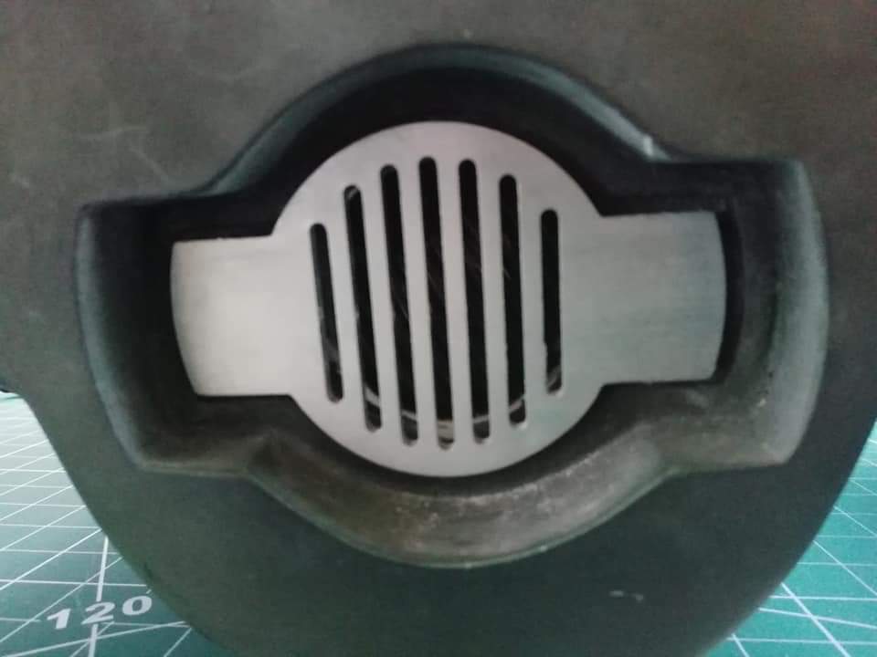

Fitted mine into the jetpack eventually with the speaker coming out of the exhaust vent.
