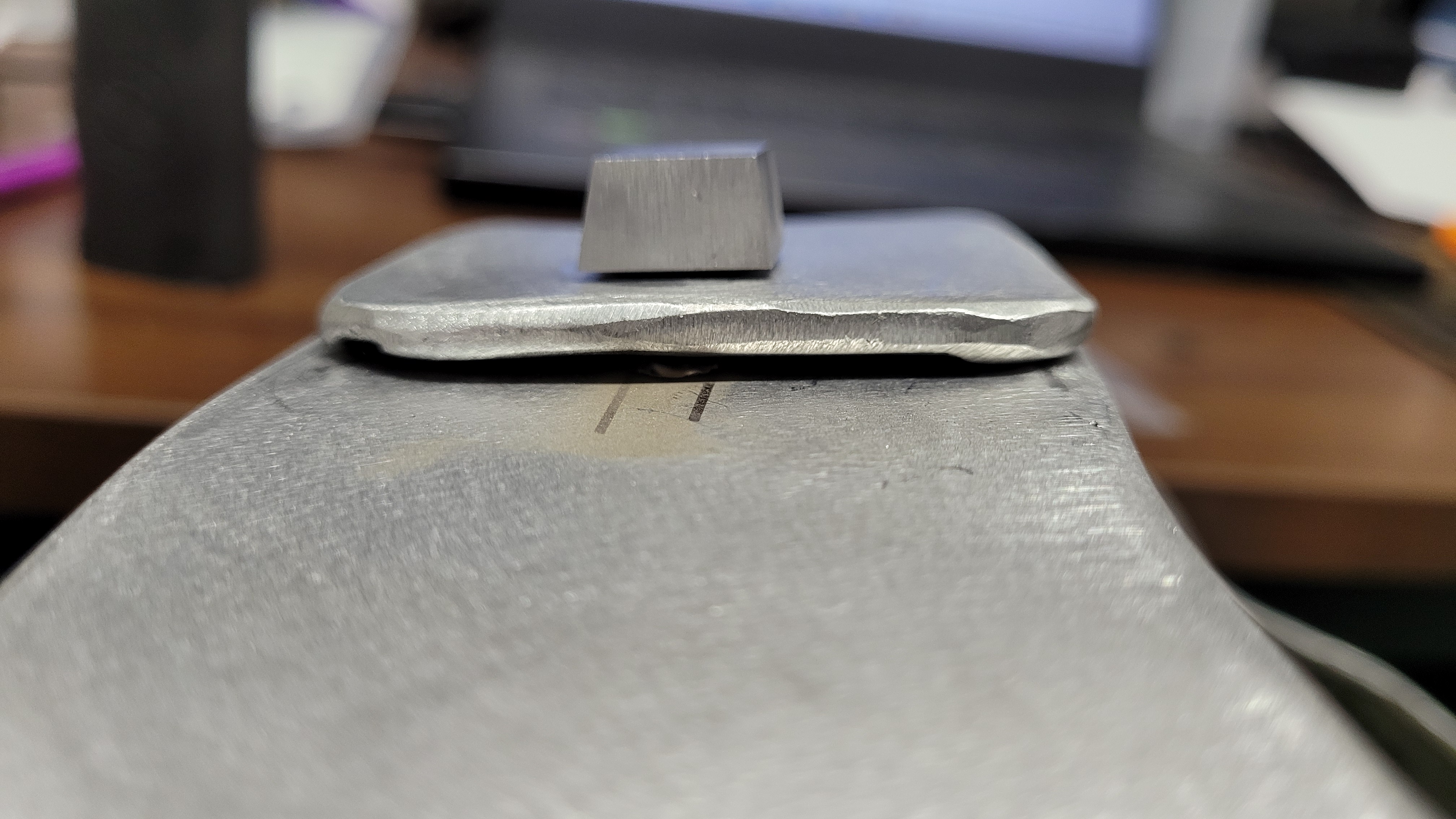

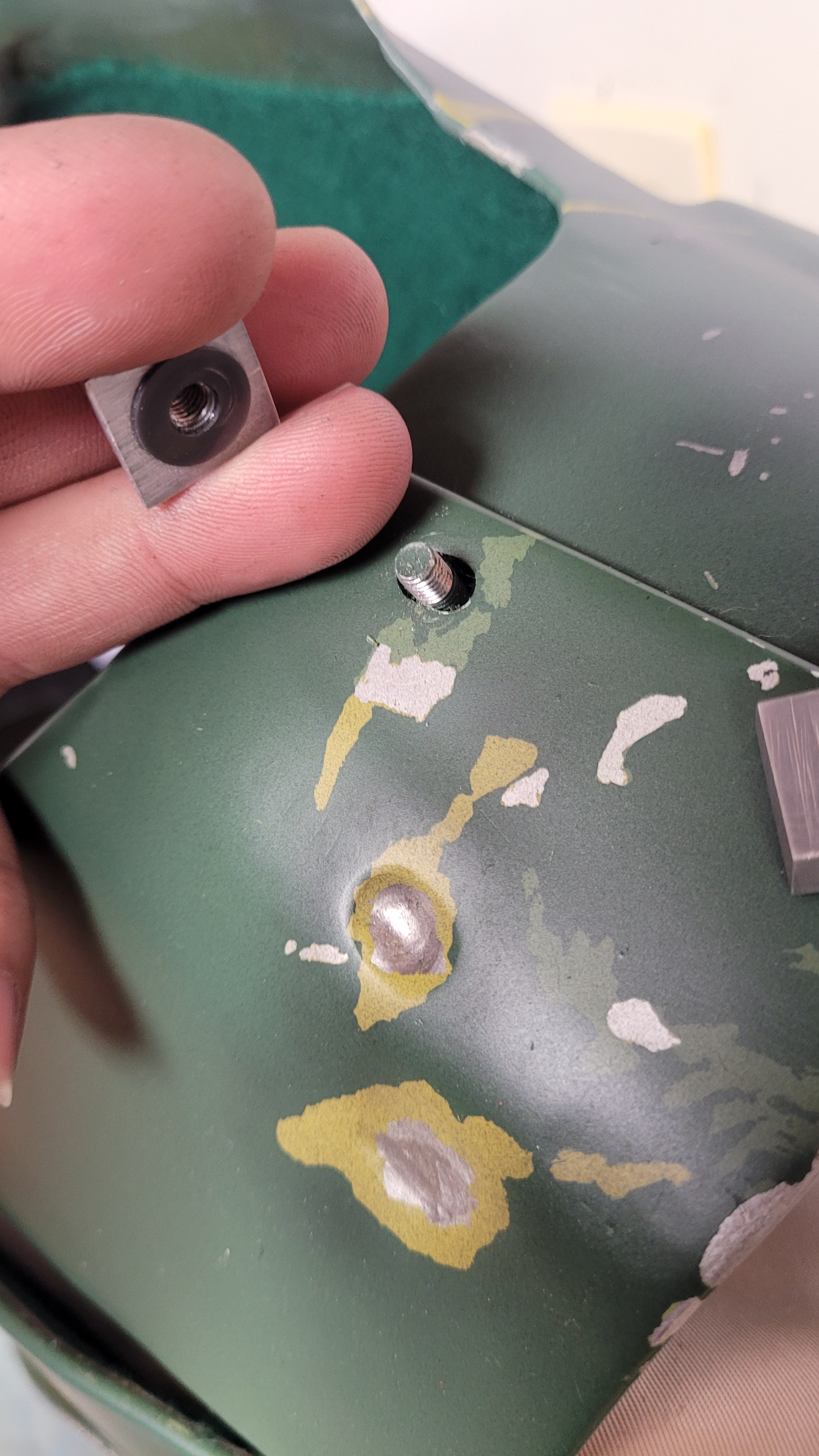

In my case, all of my armor pieces are made out of aluminum. Connection points between armor pieces are a danger zone when it comes to paint destruction no matter what material is used. Examples of these areas are the collar and cod pieces. Aluminum might be worse due to its rigidity. Another place would be the squarish nuts pressing against the armor pieces that assemble these sections.
I have aluminum nuts for these areas rather than plastic so I decided to use plastic washers. These washers could be superglued to the bottom of the square nuts. I included photos below of what I will use at these points.

Wear Points List
1. Armor overlap locations
2. Keyboard Key Nuts: Plastic washers between the keys and armor are a possible fix
3. Jetpack lower aluminum bar: heat shrink tube slid on and heated to provide a rubber coating is a possible fix
4. All over! A good clear coat will protect the majority of your paint while transporting, wearing and storing your armor.

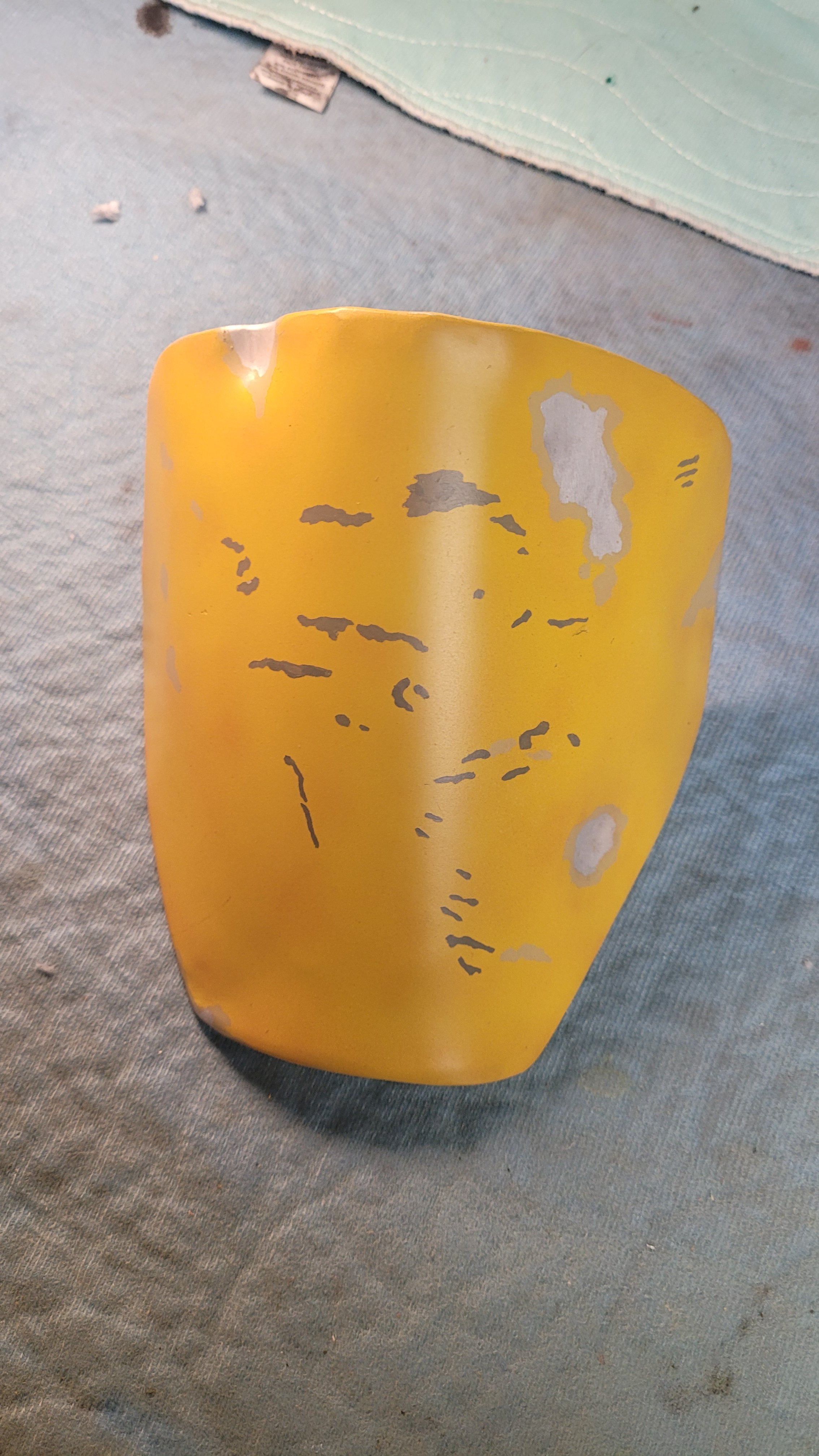

There's going to be areas paint will come off with ware and tear. The connecting points with the keys and the area with the jetpack harness are the most scratched and worn. It's happened on all the screen used costumes as well there's not much you can do to prevent it...even with a metal base.
To answer your other question...most painters use a nice clear coat to add that extra protection.

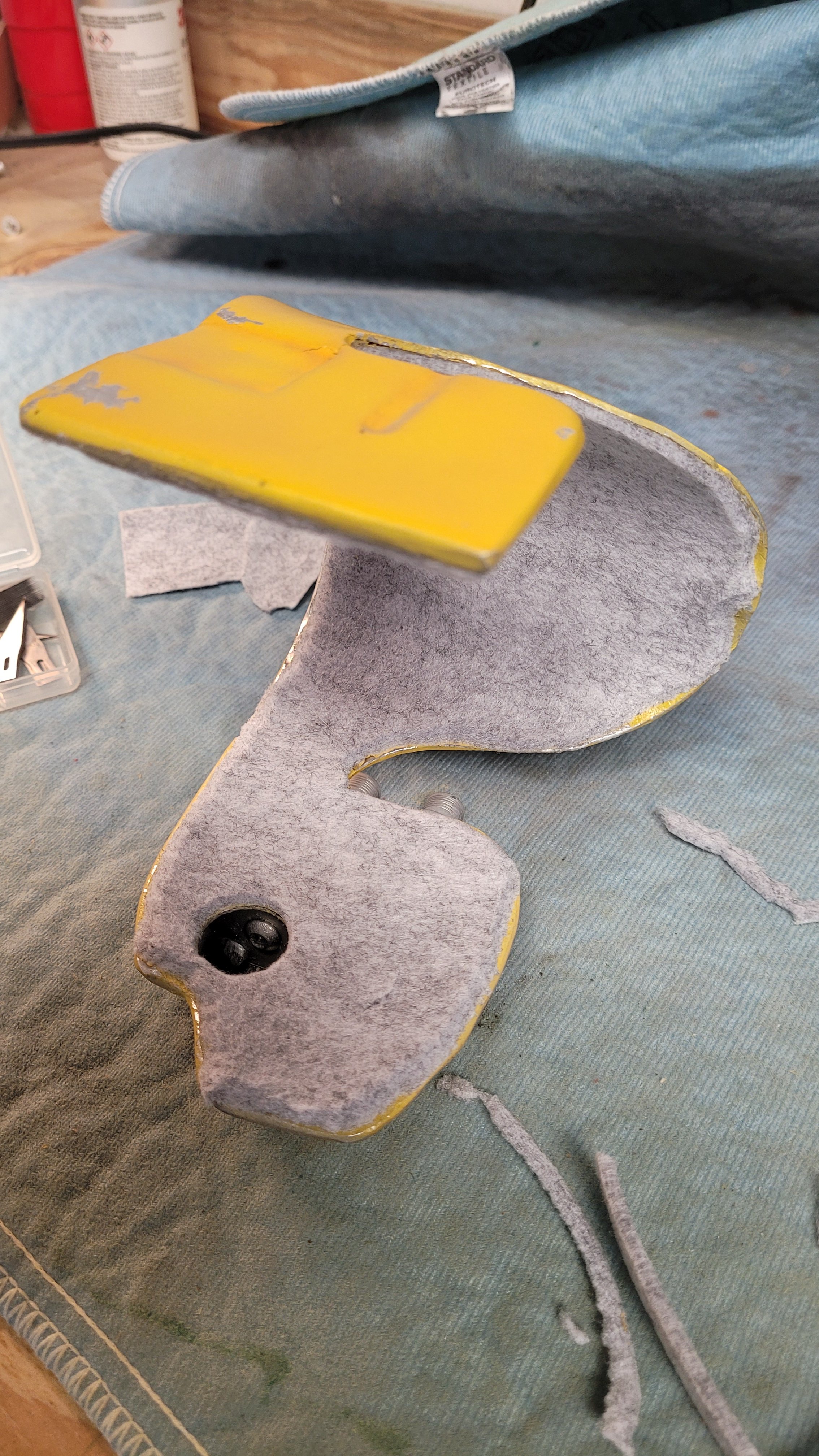

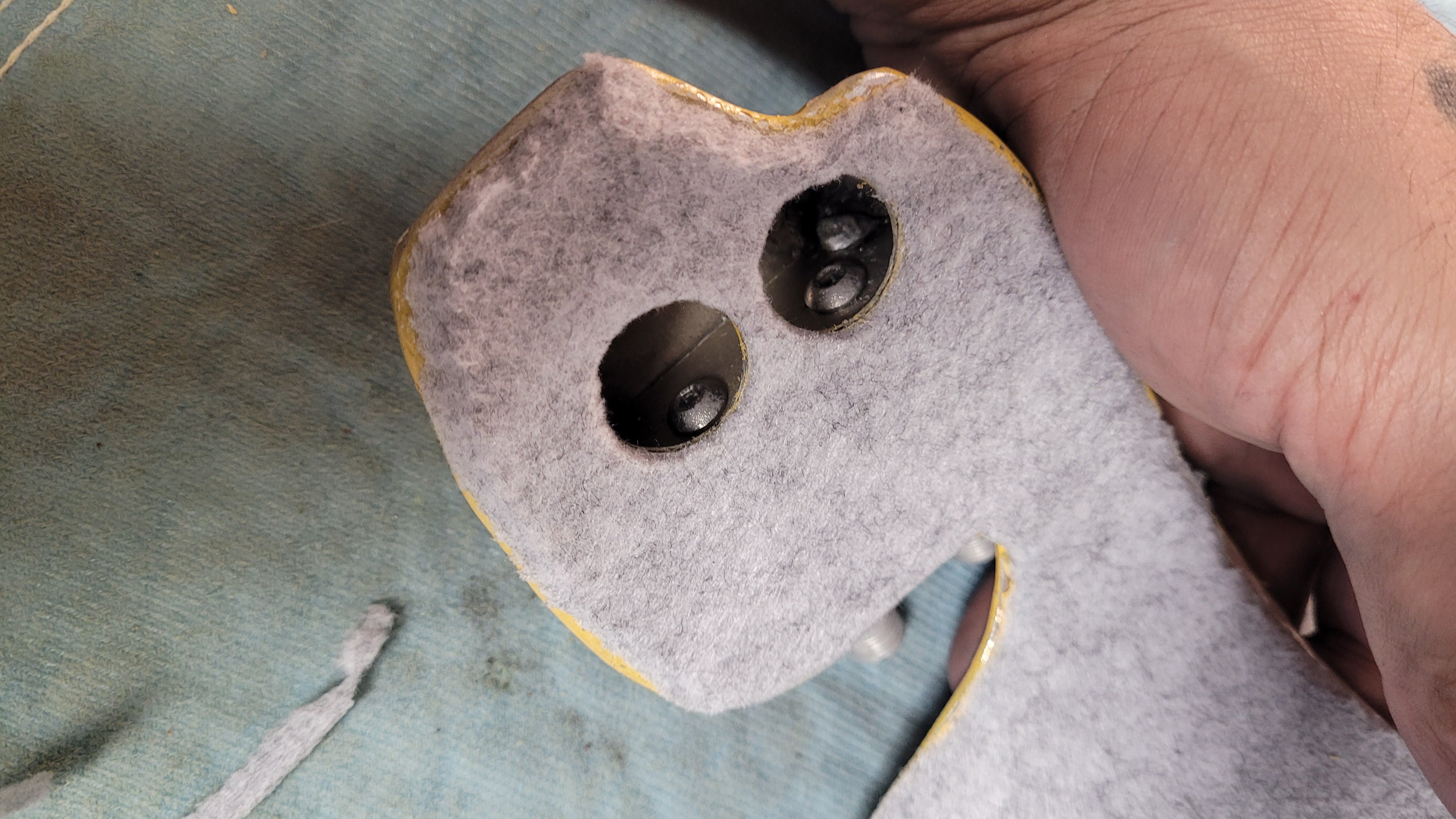

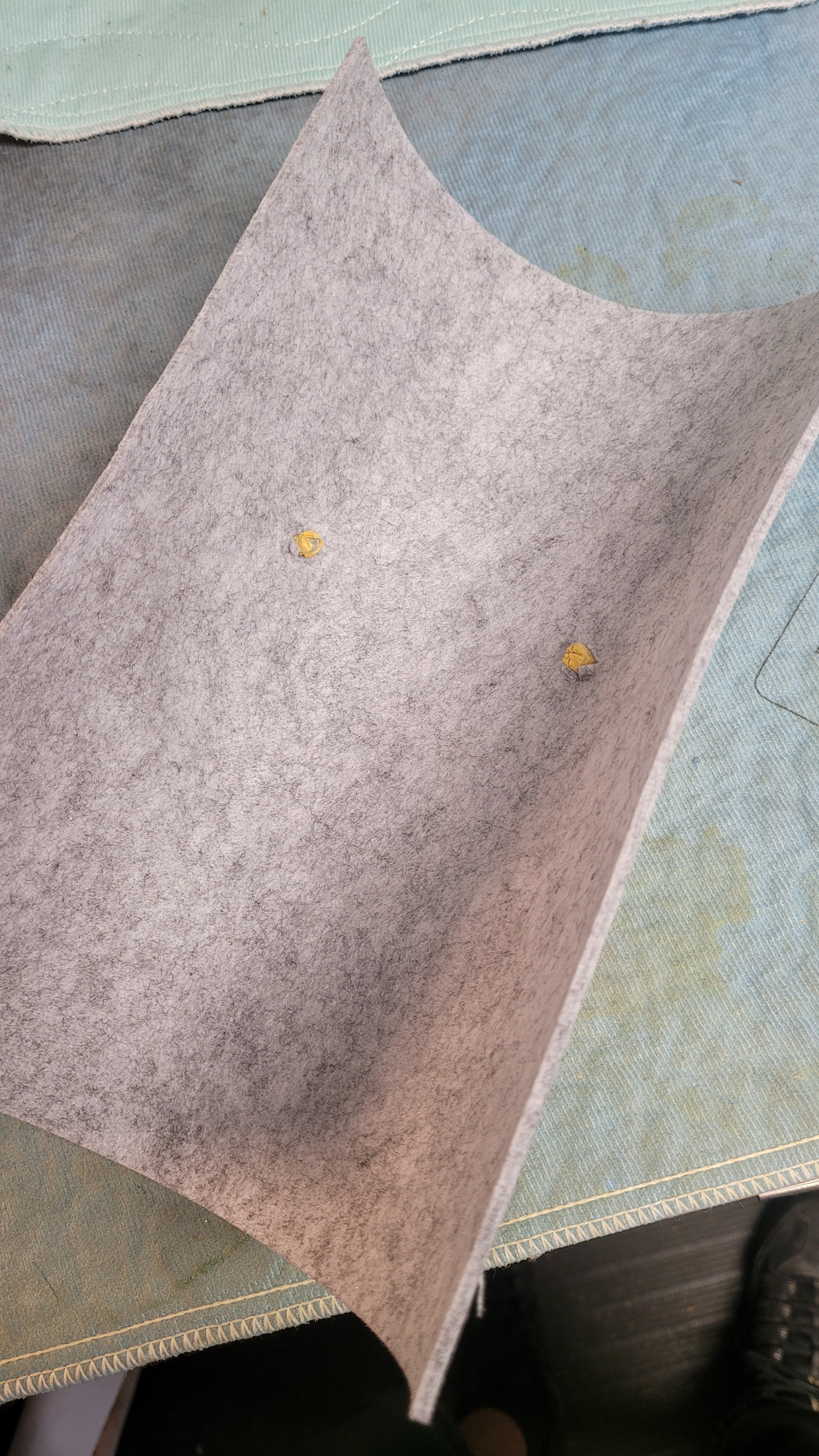

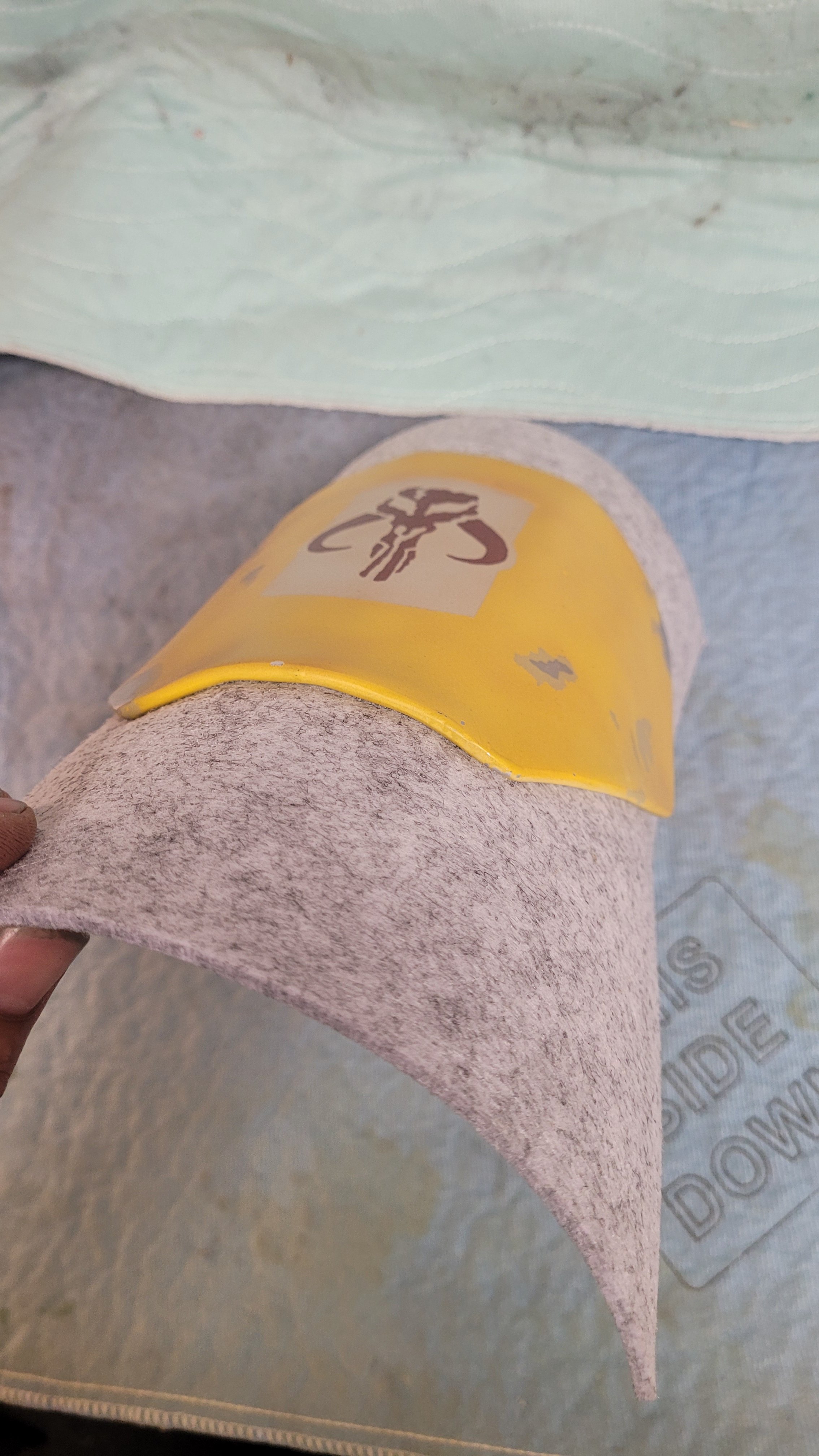

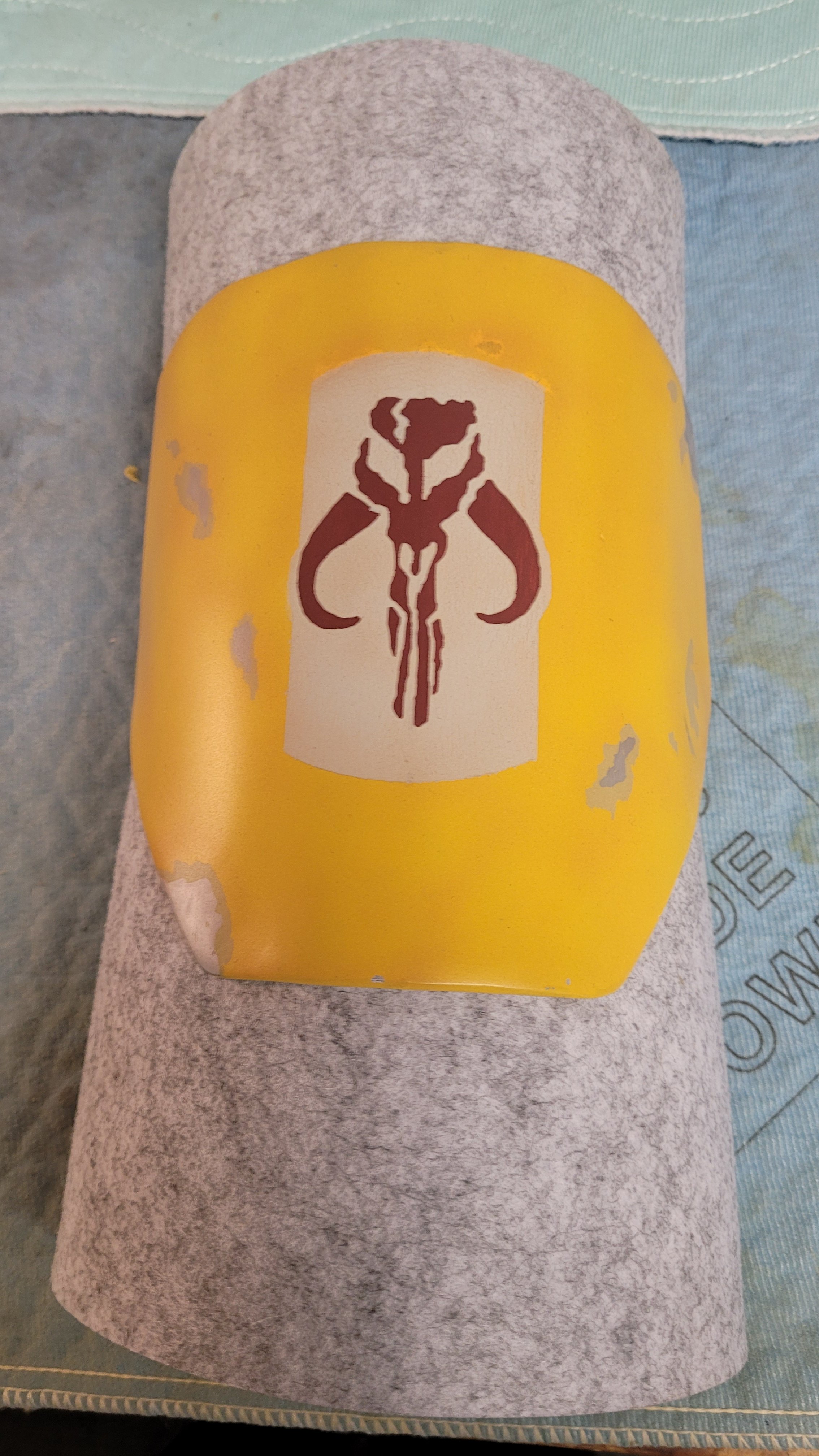

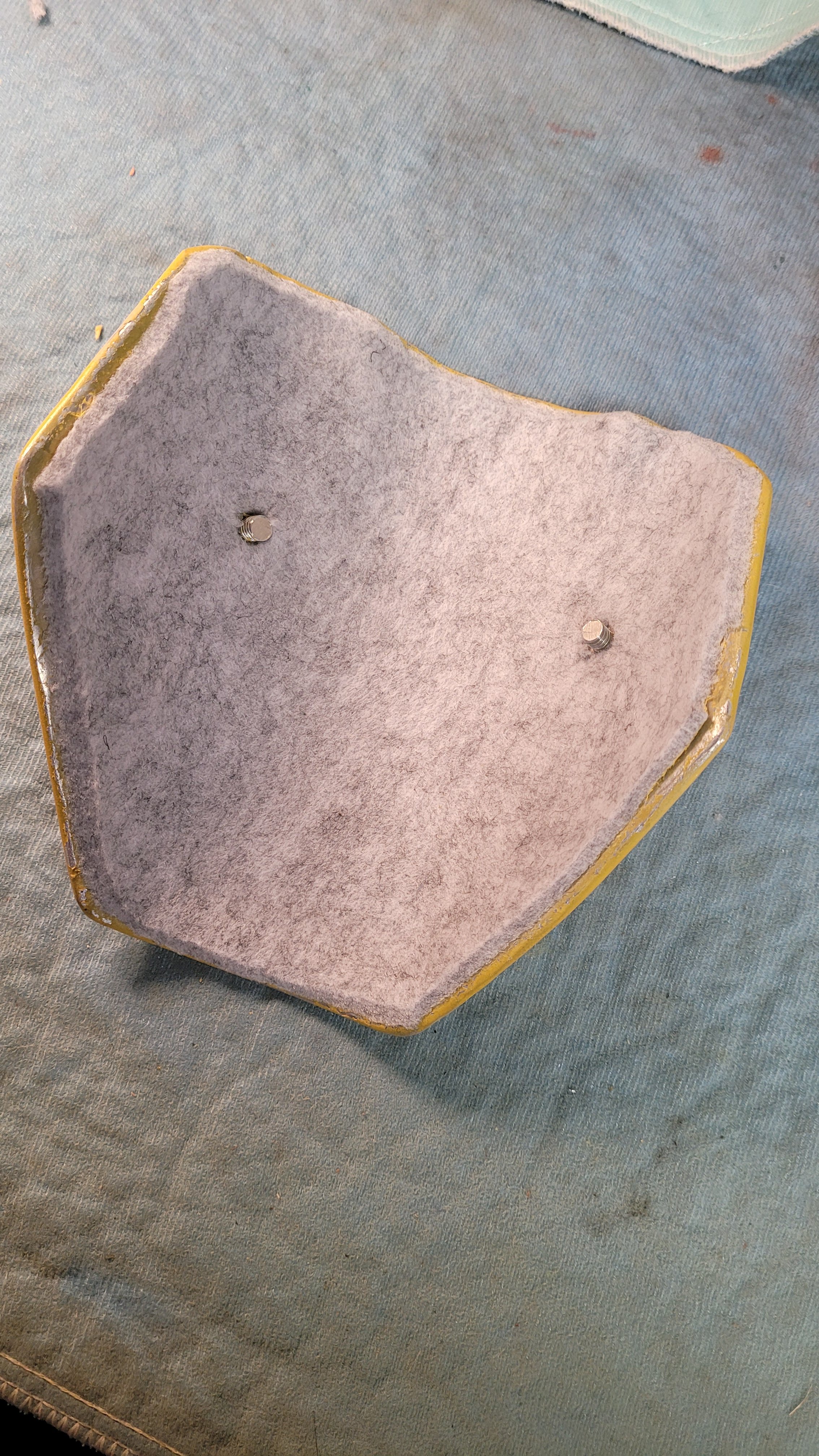

I was thinking about using some felt on the underside of the armor pieces where they overlap each other. This may prevent or delay some wear between pieces from movement or shifting as the armor is worn.

Well here is my felting in action. So far it's done a good job at the hinge points of the cod piece and kidney plate. The square aluminum greebles have done a GREAT job protecting the paint as I've taken them on and off numerous times with zero damage to the paint.
