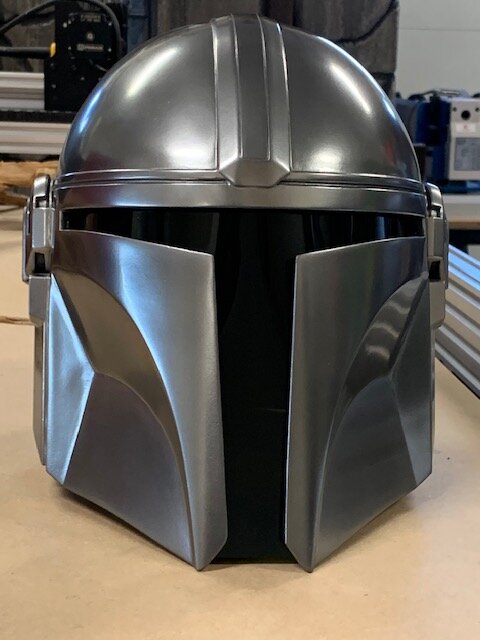

Ok so I just went for it. Painting is not my strong suit but I am getting better at it. These are 3D printed parts slightly modified. The helmet is a print as well.
I painted the helmet a base gunmetal silver, clear coated it and wet sanded with 600 grit before shooting a light coat of Alclad II chome and buffed afterwards.

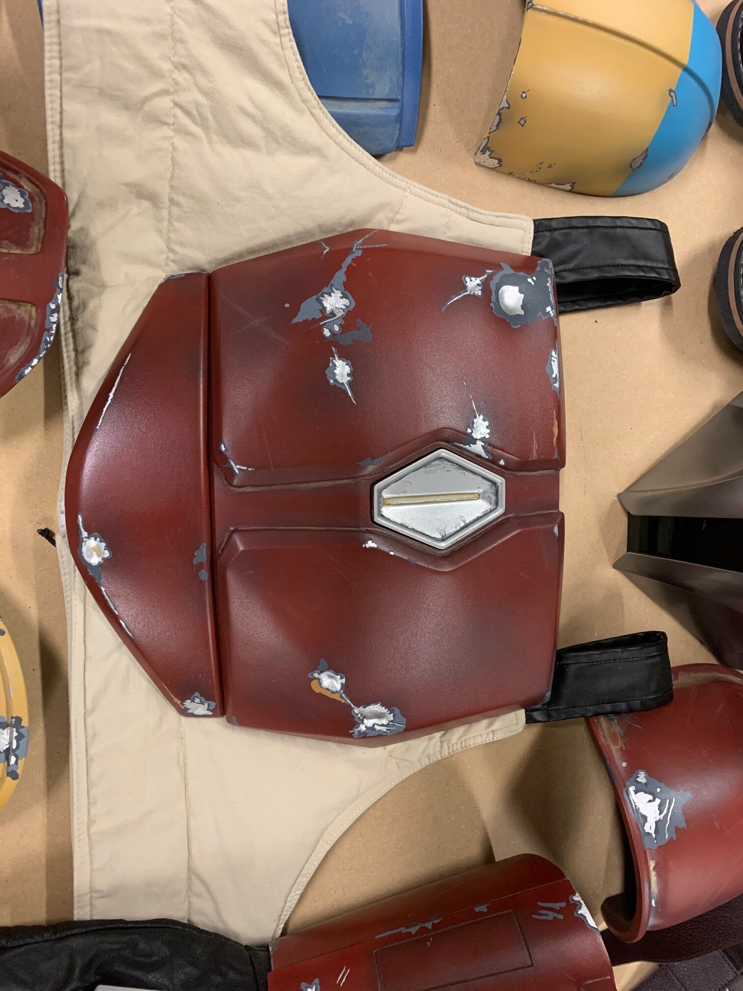

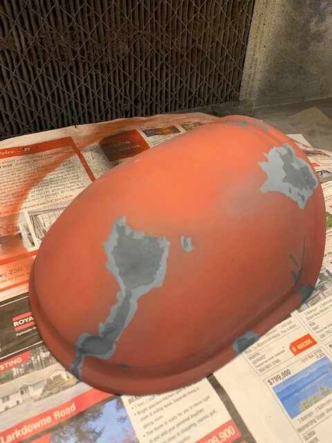

The chest and ab were painted a base of rust primer and then I airbrushed a custom mix of craft store acrylics for the deeper red. The chips were painted freehand with the same acrylics, again, using a custom mix. Everything was sealed with a satin clearcoat and then the silver of the dents applied.

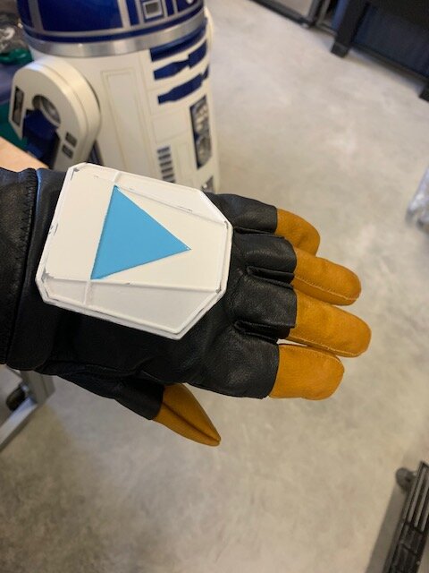

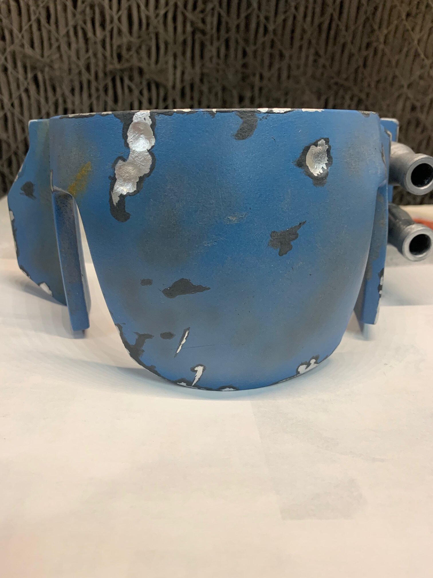

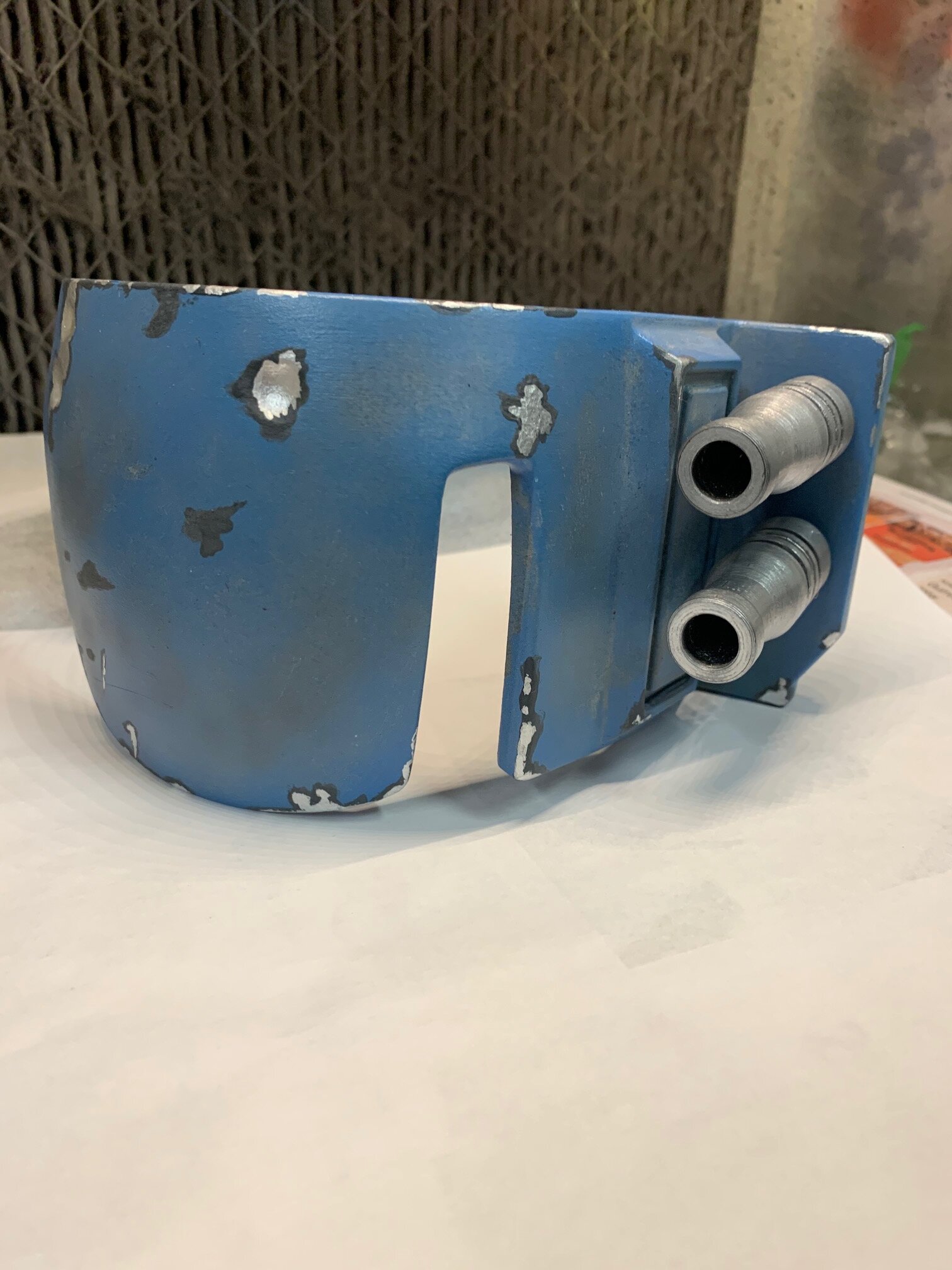

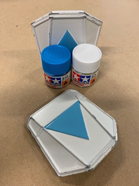

The hand plates are printed. I painted a krylon satin white and then used a mix of Tamiya acyrlics for the blue. This is actually my second attempt at the blue, the first was too dark for my liking. The way to mix the blue is start with white and slowly add the blue. If you start the other way then you will already be too dark and have to waste a lot of paint trying to lighten it up. The chips are a dark grey.

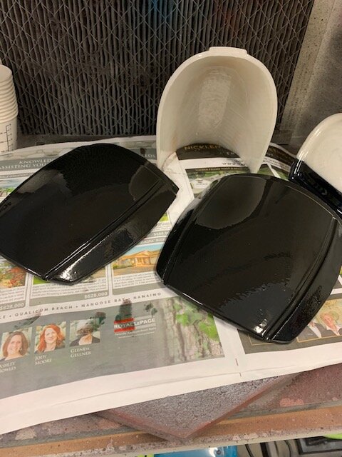

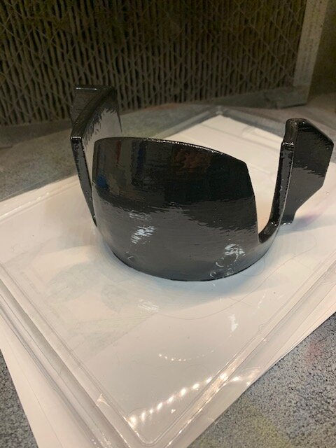

Printed off some more parts this weekend and have started epoxy coating them. I wish I had started this in the beginning as it fills some of the print lines and is a good base for finishing not to mention adding durability to the parts.

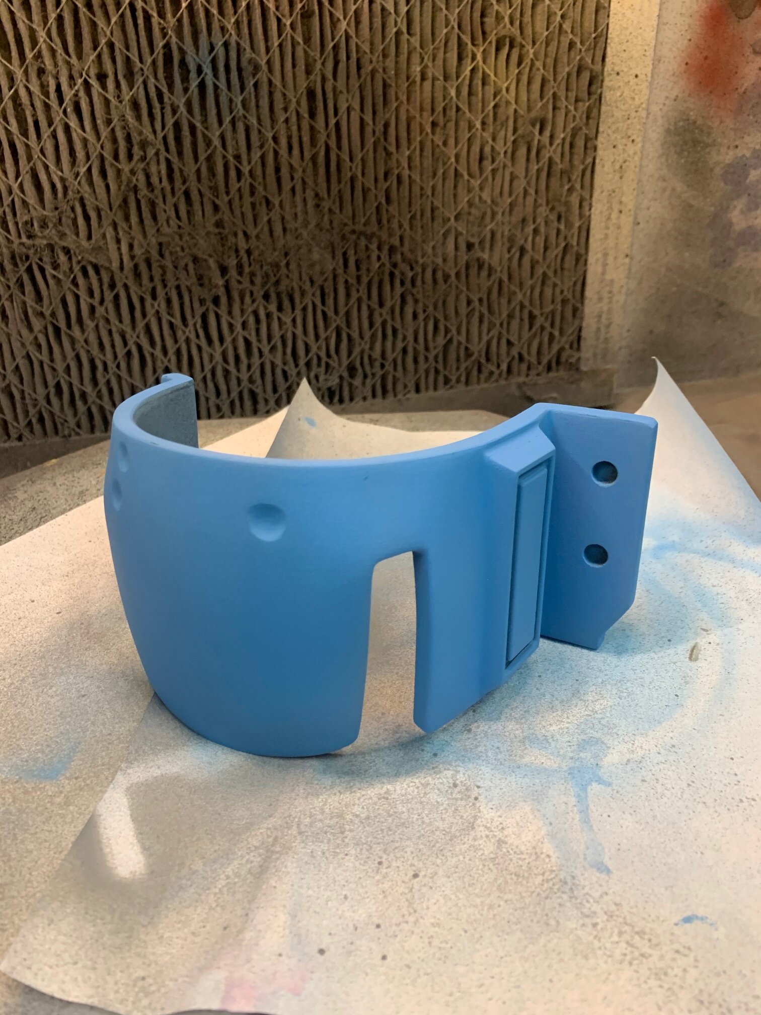

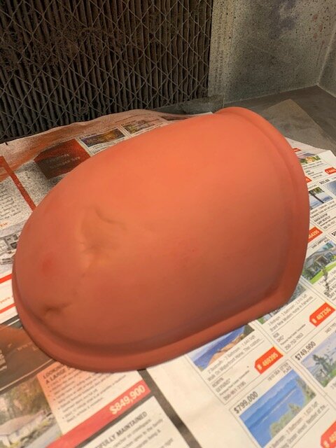

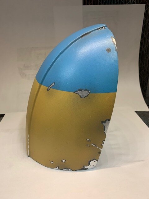

Finished painting a shoulder bell last night. I used the method outlined above but took some progress pics so you can see the difference in every step.
The added red over the primer is subtle in the pics but once everything is clear coated then it really makes a difference and breaks up the monotone color.

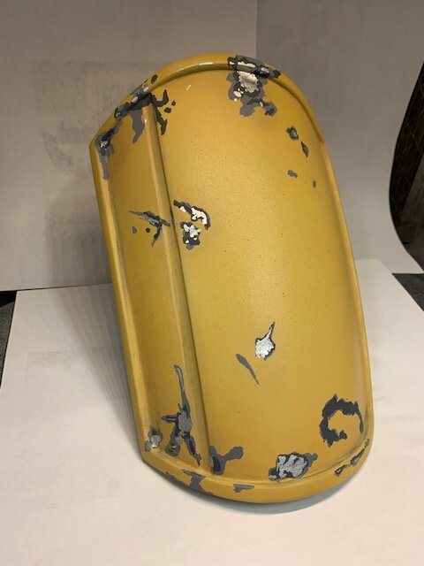

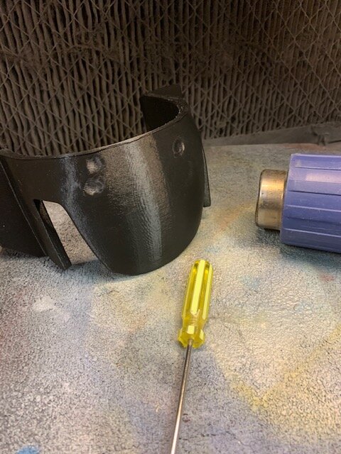

Working on the knee armor. Printed and epoxy coated. I had printed off the undamaged version by mistake so I whipped out my heat gun and was able to press in the damage with the handle of a small screwdriver.

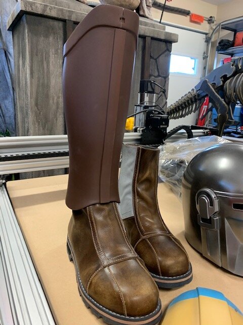

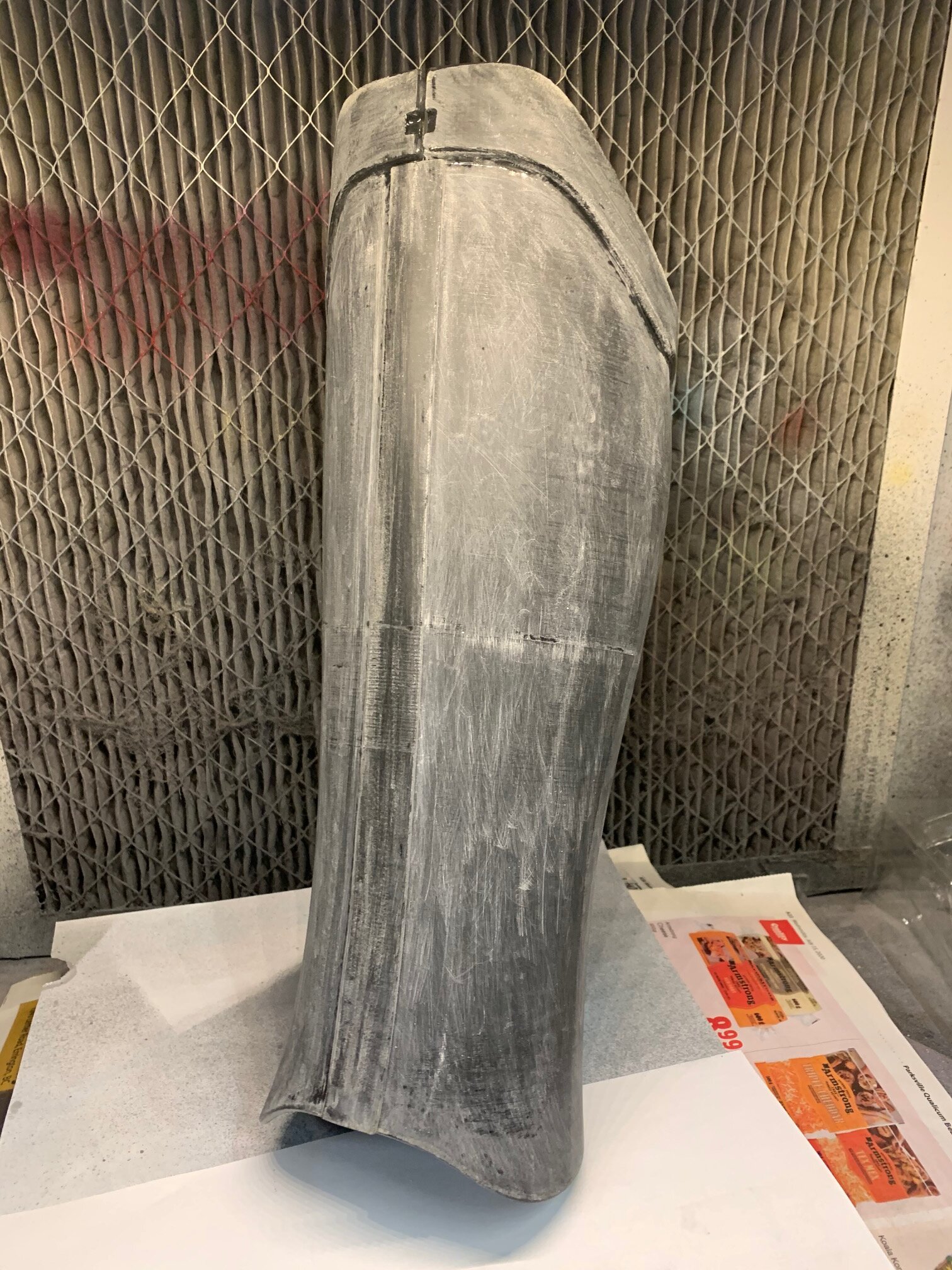

I'm working on the shin armor and have a quick coat of paint on it. One thing I have noticed is that it won't work to well with the Crow Props boots. The boots have more leather at the top than needed and you have to kind of fold the top of the boot in order to get the armor on. One the pants fabric is tucked into the boot I am pretty sure the armor will always want to pop open. I think I will print a larger size and see if I can get a cobbler to modify the boot somehow.

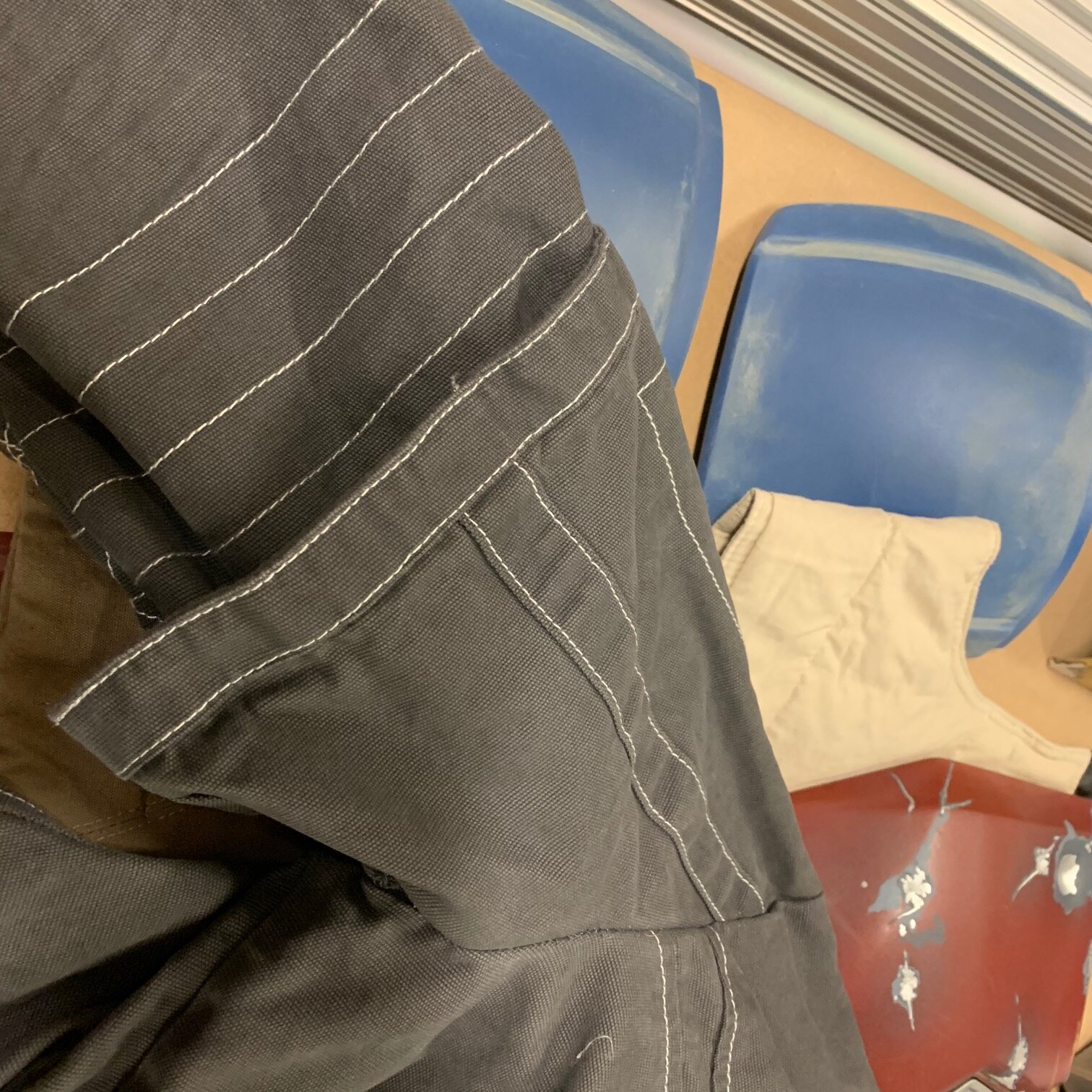

I just received my soft parts the other day and couldn't be happier. I decided on the Cosplaysky costume based on the stitching details present on the sleeve back that I didn't find on some of the other seller's offerings. First thing I did was ditch the sewn on armor parts and give it a wash to loosen up the fibers and get rid of the pin holes from the sewn armor. If you want to dry it in a hot dryer be aware there will be some shrinkage but not too much. I bought the large sized suit and shrunk it slightly so it fits me well now. I'll get some pics up in the next few days.

It's been awhile since I have updated this thread but have been busy working on things. First, I received my order from Cosplaysky and am very happy with the finished product. Of course the first thing I did was rip off the crappy armor and give it a wash to loosen up the fibers. Even though I am not going to use most of the costume, for the price I paid I think it is excellent value for the 3 pieces I am using. I did end up re printing my chest armor at 93% as I am about 5'8" tall and I think it fit my frame better. Shout out to Steve for this as I have followed his build thread.

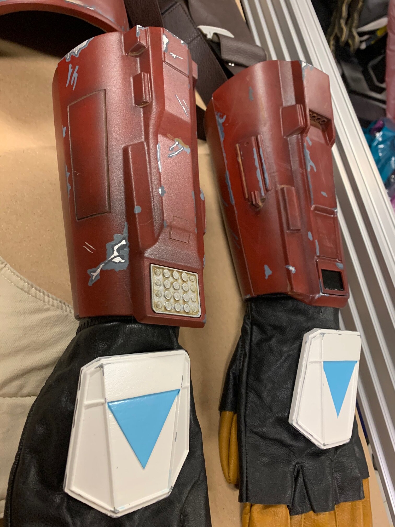

I have finished printing and painting the gauntlets. Just some details to add but I think I may try to spin these on my metal lathe. This is a new tool for me but I luckily I have a machinist friend willing to give me some pointers. Hell, he would probably spin everything off for me but I don't want to lean on him like that, I'd rather learn a new skillset.

Is the boot being weird resolved? Or is it just annoying? I was thinking about that since I don't have the shin armor yet and asked for 13 inch calf circumference.
I decided against modifying the boot and am making a new set of shin armor. I have taken the existing file and stretched from front to back so it doesn't look too wide from the front. I will end up needing a bit of padding as I have chicken calves but it should work out in the end. For the record, the top outside circumference of my boot is about 14.25"
